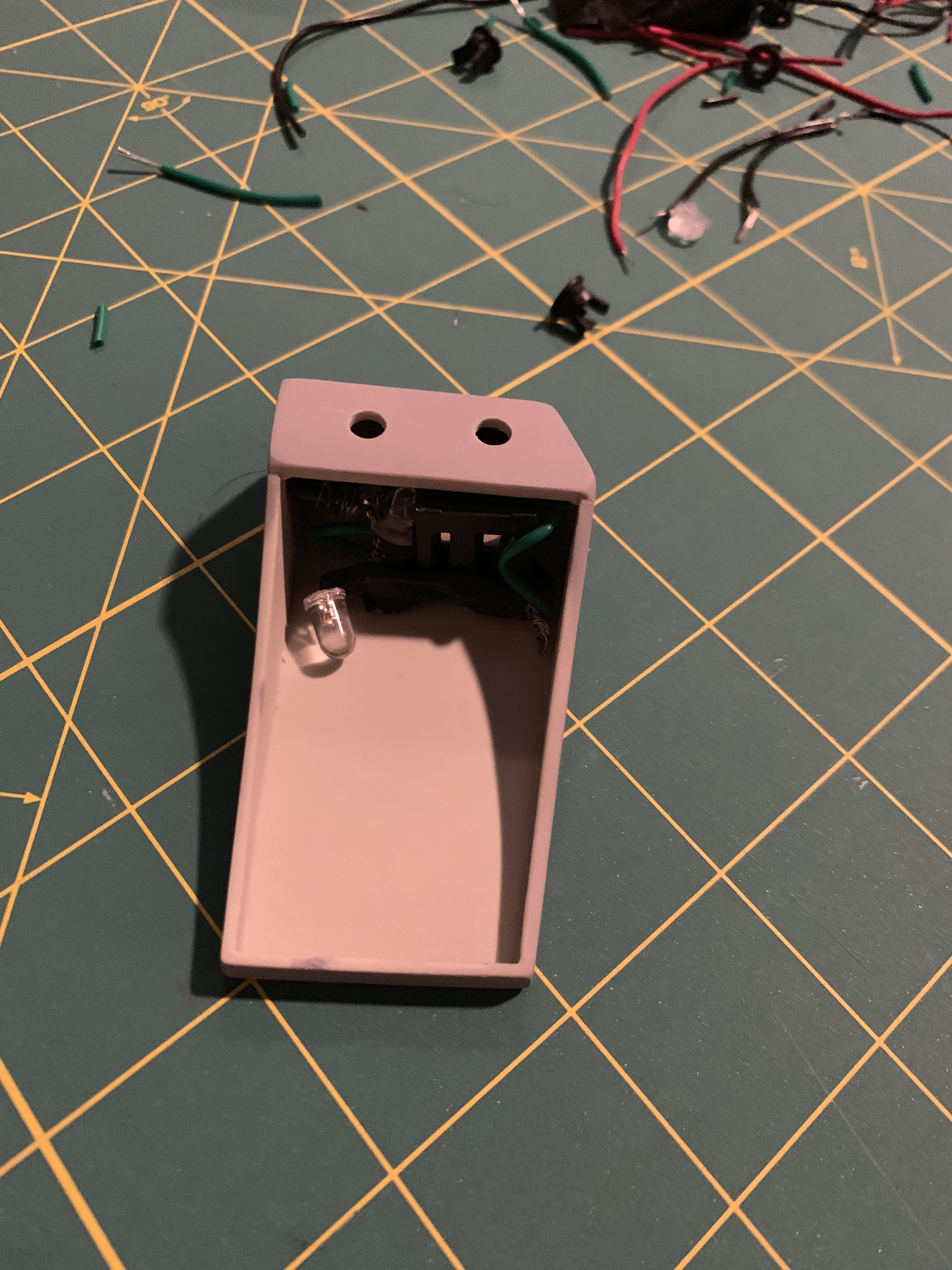

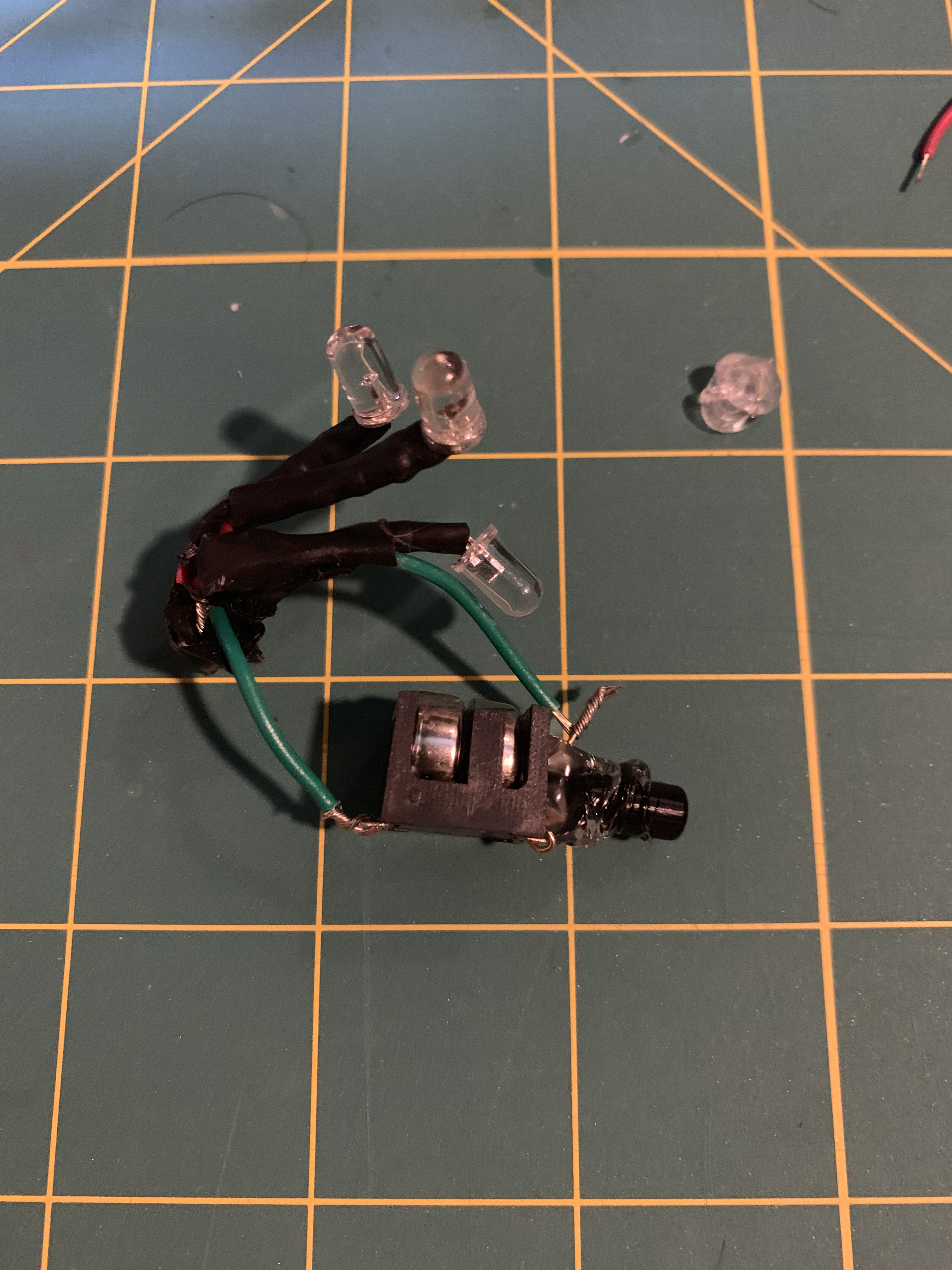

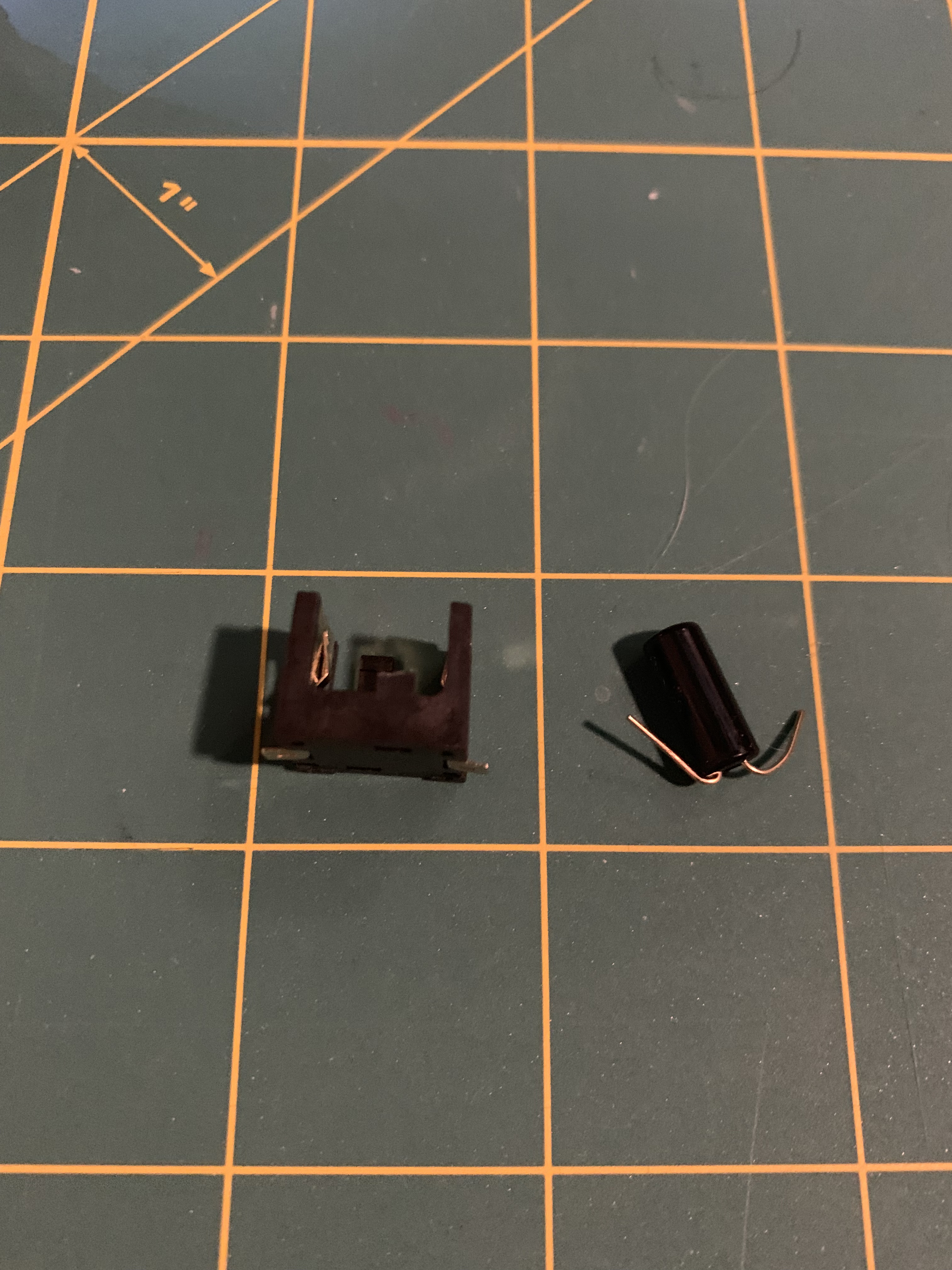

I picked up a dual LR44 battery holder for $5.00 on eBay, a $0.70 SW-520D tilt switch, and some left over LEDs I had. It doesn't look pretty, but works like a charm............
I attached one end of the tilt switch to the battery holder, wired the steady red, flashing red, and steady white LEDs together (with the positive sides attached to the other end of the tilt switch and the negative sides attached to the other side of the battery holder). Did a test fit and tried it out.........
Nothing is final here (the LEDs are not in place yet nor is the lens). This was just a proof of concept to see if it would work, and it did. I'm very pleased with it and can start prepping the helmet for paint and assembly.
