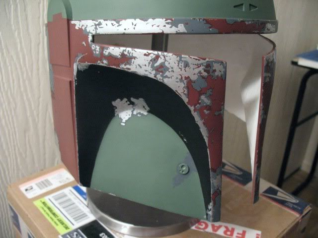

We have half a face! Got the left cheek areas done. I finally put away that pesky PRR Maroon :lol: and went back to gray and silver. For the gray areas on the lower cheeks (and later, the dome) I darken up my Polly Scale SP Lark Dark Gray with a few drops of PRR Brunswick Green until there's a noticeable contrast. The SP Gray by itself is too close in tone to the PO Green. (Not my trick. . . I think that's one of the things Lee mentioned in his color thread.)
I'm also doing my helmet as the screen-used version rather than the exhibit version. So there will actually be less damage on this one. If you're familiar with all the ref pics of the ESB helmet, you'll probably notice a couple of scratches and chips that aren't on my helmet. That's the reason why.
So here she is for tonight.

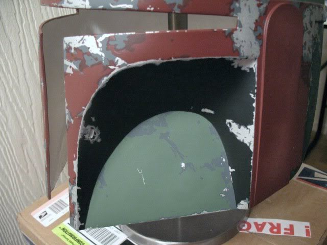

OK, I'm done with the cheeks and have moved up to the dome!
The right cheek went a little quicker than the left. There's not as much detail. I'll do the Borden connector later once I'm doing my final weathering.

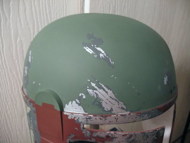

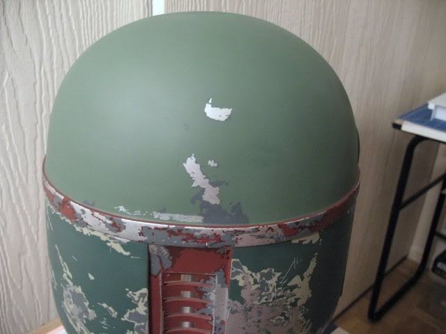

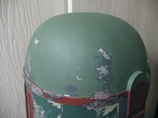

Alright, working slowly around the dome now. To take a break from painting (a short break) I went back and began putting in some of the really fine scratches on the dome. I use a compass point to do this, scratching down to the raw white gelcoat. I try to match their position as closely as I can to my reference pics.
I painted the damage behind the right ear, then went back and did the fine scratches in that section as well.
Barely visible above is the cat scratch section over the right eye. I've done the silver portion already, and later I'll go back and do all the little gray "breaks" in and around the silver portion. :)

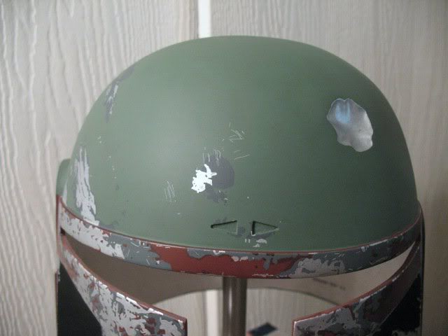

Anyway, just showing the latest stage of the dome painting.

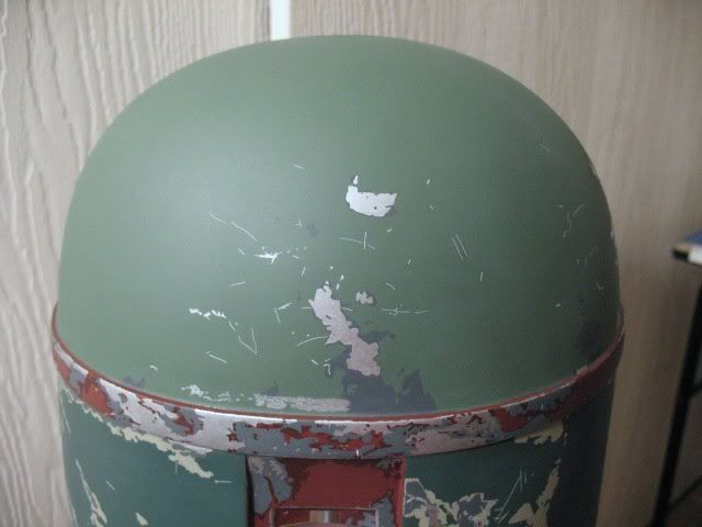

I finished the cat scratch area, plus the small areas around and above it. These have some reeeeeeally fine detail, and I spent a good amount of time with my gray color, trying to get the shapes and proportions correct.
I then moved around to the front of the dome, adding the gray and silver details above and around the forehead triangles. The triangles themselves will be weathered with powdered pigments once final weathering begins. In both of these new areas, I also went back with my compass and added the very fine scratches. I try to work each new section as I go so I don't get overwhelmed with hundreds of tiny scratches at the end of the process.

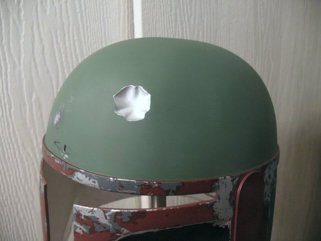

Finally, THE DENT! I went ahead and painted in the dent to give a guide for placing the damage around it. I won't paint the damage around the dent until after my killstripes are on.

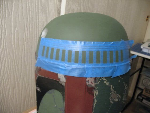

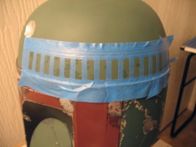

I begin by measuring the helmet against the reference pics to try to figure the size and position of the killstripes. For the FPH, these are the measurements I came up with:
-- Distance above the red band: 6 mm
-- Height of each stripe: 24 mm
-- Width of each stripe: 8 mm
-- Space between stripes: 6 mm
Once I determine the size and spacing, I mask off the 'basic' shapes using blue painters tape. I'm very careful to make sure each spacer strip remains vertical in relation to the red band. It's much better to check and reposition before you start painting.
Here's what it looks like at this point.

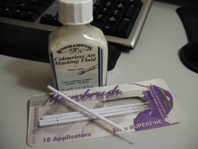

To mask the damage on each stripe, I return to my good ol' Winsor & Newton masking fluid and a microbrush. These are fantastic! They come in several sizes, and are sold in packs of 10. They're cheap and disposable, and come in really handy for a lot of different projects. :thumbsup:
Following the reference pics carefully, I apply masking fluid within each stripe. It doesn't take long for the fluid to dry. Below, the masked areas look kind of shiny.

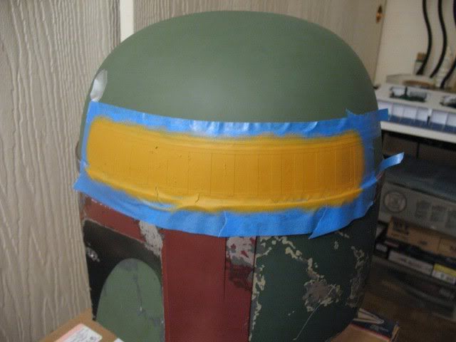

One last step I take before I begin painting the stripes is to mask off the rest of the helmet (again) and shoot the stripes with Testors Dullcoat. This serves two purposes: it seals the edges of the tape, preventing my yellow paint from bleeding under, and it gives a nice matte surface for the paint to adhere to.

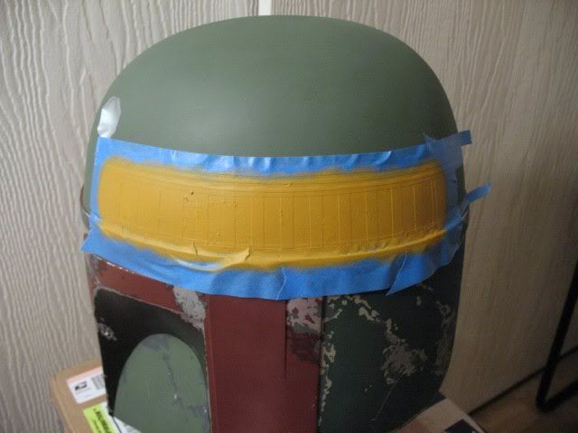

After the dullcoat dries, I apply Polly Scale UP Armor Yellow with a dense make up sponge. I let it build up slowly, applying 4 to 5 coats, waiting a short time between applications. The sponge is dense enough to prevent any stipple marks, and the Polly Scale paint dries so evenly it really helps the final appearance.
After about 5 light coats of yellow, this is how the stripe area looks.

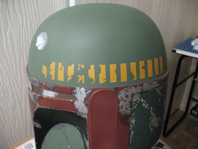

Finally, once all the above steps are done, I unmask. I use a small piece of tracing paper to rub off the dried masking fluid, then some fine tweezers to remove the tape. I pull the tape off slowly, making sure I don't pull up any of the yellow.
So after all that, here's how the stripes look.
Lots of work for such a relatively small area! :p
Next will be doing all the damage around the dent, and the damage that streaks back behind the dent over the stripes. Getting close! :D
