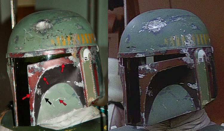

With soooo little ESB reference material have you taken 'best guess' from screen caps and used a reduction on say.. C4 reference material?
Well, that's pretty much it. There are TONS of pics from the exhibits over the past few years. It's easy to see some of the stuff that happened after filiming, such as the famous 'crack repair' in the corner of the left eye.
By comparing the exhibit pics to the screen caps, I sort of weed out the stuff that isn't in the screen caps.
Here's an example:
If you look where the arrows are pointing, there's lots of scratches and stuff on the exhibit helmet that aren't on the screen cap. Also, all those little black scuffs between the dent and the killstripes.

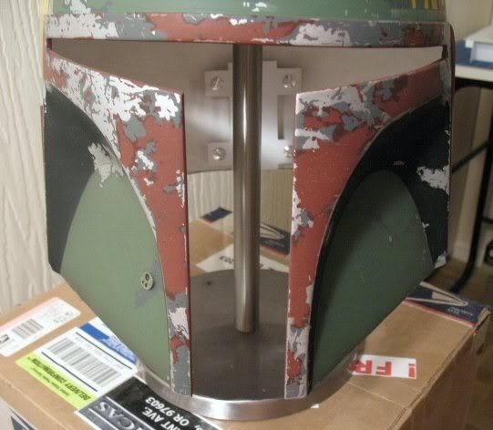

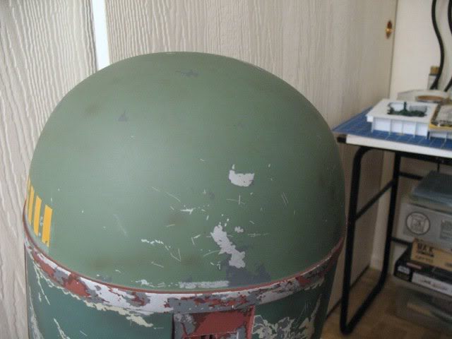

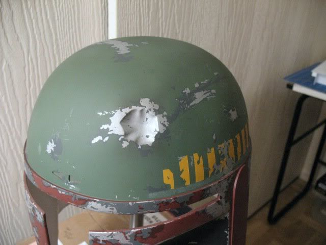

Weathering Stage 1 complete. I did some weathering with pigment powders in several shades. I used an ash gray, a tan 'dust' shade, weathered brown, and sooty black for some of the darker shading.
Most of this stage of the weathering is for the dome and lower cheeks, although the upper cheeks received a bit of a gray/brown mix. Here are a few shots after today's progress.
First, the lower cheeks. They received a random mix of ash and dusty brown, very subtly altering the pure PO Green color. A darker brown was applied along the line between the lower cheeks and upper cheeks and then feathered into the center. The very bottom got a blend of dark brown and black, fading up into the base color.
Note: This part of the weathering is pretty subtle. Not sure how well the shading will show up in these pics.
The dome received the same mix of ash and dusty brown, breaking up the evenness of the dome. I used the darker shades to make the blast residue around the dent. It may not show up well, but it streaks back above the gray/silver chipping.
In several places on the dome, I kind of scrubbed in some of the darker brown with a small stiff-bristled brush to lay the foundation of those greasy looking brownish stains. I'll go back over these areas with some Citadel inks to darken them a bit.
On the back panels I used mostly black, dusting the powder on with a soft brush and letting the color build up slowly. Like the dome, it helps to break up the darker blue-green color and give some variance.
Haven't really touched the mandibles at all yet. Those will come later! :)

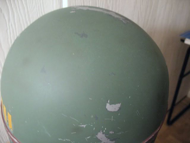

UPDATE: November 28th

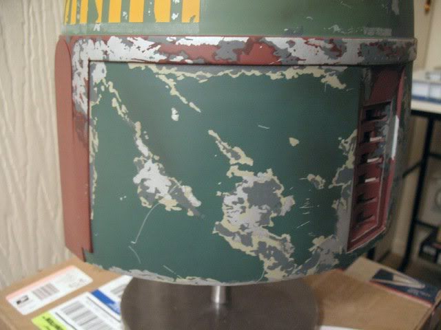

Weathering stage 2 complete. For this step, I took some lightened versions of each color, and an old toothbrush, and did a whole lot of flicking.
For each color break, I remasked the rest of the helmet to confine the weathering to the area I was working on.
For the dome and lower cheeks, I mixed some Concrete into some Panzer Olive Green and thinned it way down till it was very watery. With the toothbrush, I flicked tiny droplets all over the place. On the cheeks, I concentrated on the center portions, and on the dome, I did it more on top, then kind of faded it down toward the red band.
It kind of gives the effect of the paint being more faded on the top of the dome, and breaks up the overall evenness of the green.
It's kind of hard to make out in these pics. Maybe I need to upgrade my camera. . . again! :facepalm
I used the same technique on the 'red' areas, using Polly Scale Rock Island Maroon. This gave some variance to the Boxcar Red. (In all these pics, the final tan spatter has been added as well, so the red spatter is probably not even visible.)
The same was done to the darker blue green panels on the back of the helmet. But the effect is so subtle, the camera couldn't even get the different tones. :(
As I mentioned above, the helmet received a tan spatter as well. This is mostly concentrated on the front portions.

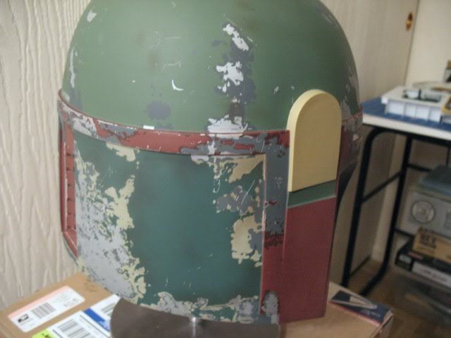

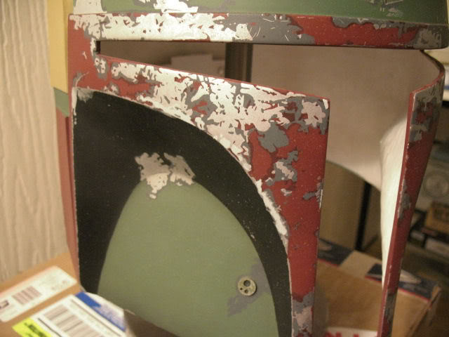

UPDATE: November 30th

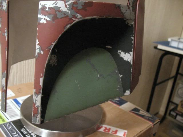

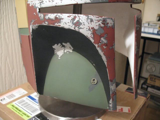

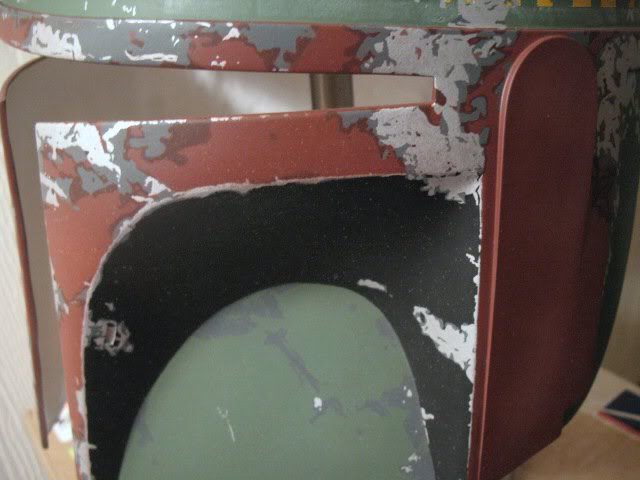

I'm very close to being done with this puppy. As I mentioned before, I went back and repainted over some of the silver areas, giving it back some of the "glint" of metal. I didn't do this to all the silver, just in certain areas matched to the reference pics.
I also went ahead and added the weird pale color on some of the damage areas. It took me a while to decide to do this, but I really like how it came out! I searched through my whole supply of paints and tested them by putting small dabs onto a piece of plastic I had painted silver. I tested some pale grays, light greens, and light blue grays. I finally decided on a "craft acrylic" by Delta called Blue Wisp. I think it's a really close match. It also changes appearance depending on the lighting, which is precisely what this color does in the reference pics.
Here's some examples of how the appearance differs.

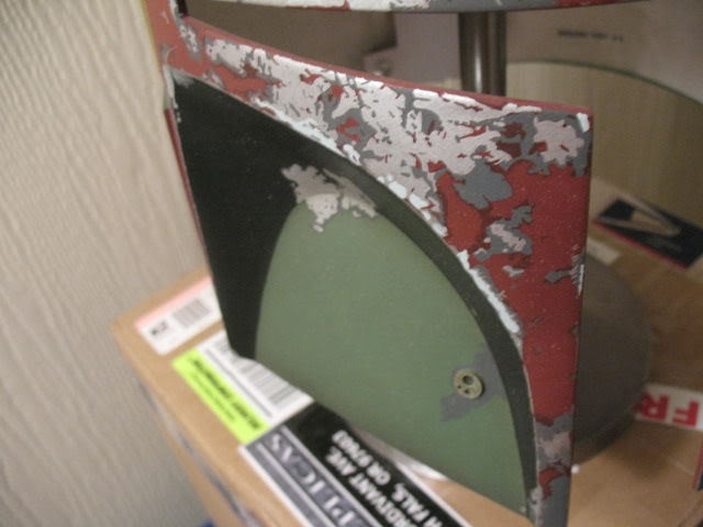

First, the right mandible. In the first pic, the pale color almost blends in with the silver background. You can notice it more toward the visor area, where the light starts catching it at a different angle.
With the camera at another angle, the pale shade is more apparent.

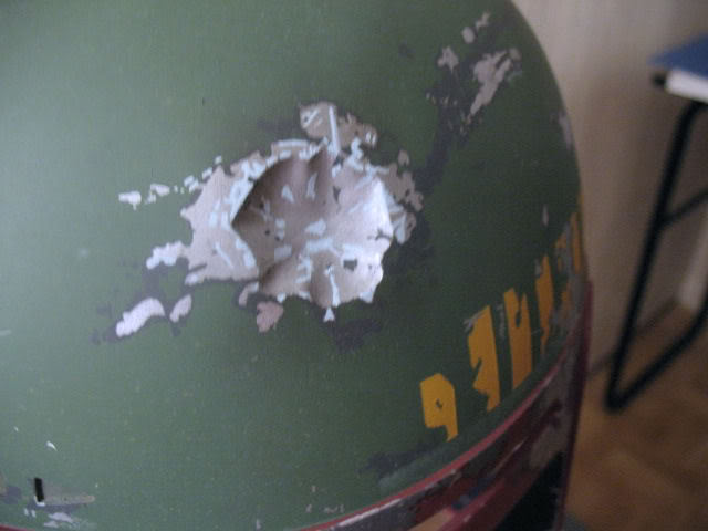

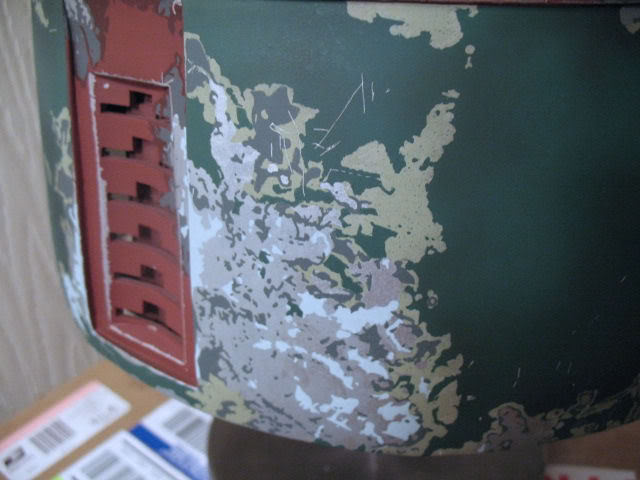

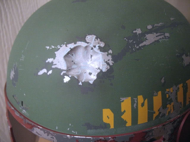

Next, the dent. In the first pic, you can make out some of the pale shade.
But with more indirect light, the extent of the shading becomes more clear.

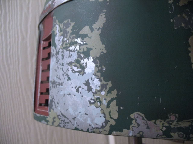

And finally, the back. There's some of this shade just to the left of the keyslot area, and small specks within the keyslot area itself. But it's most apparent on the right panel. The first pic shows how it blends.
This next shot shows how it becomes more visible under different light.
