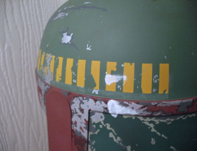

OK, the helmet itself is done. :) I added the thumbprints, and a mix of brown and yellow inks for the greasy looking marks. They reflect differently too, so they look darker or lighter depending on the angle.

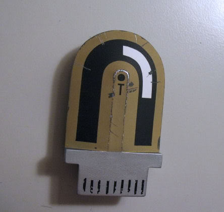

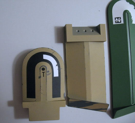

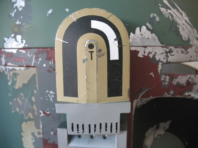

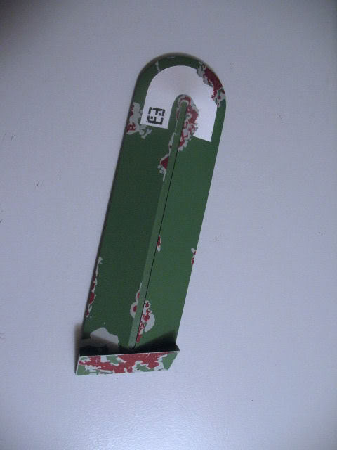

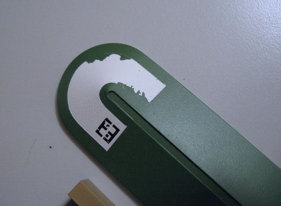

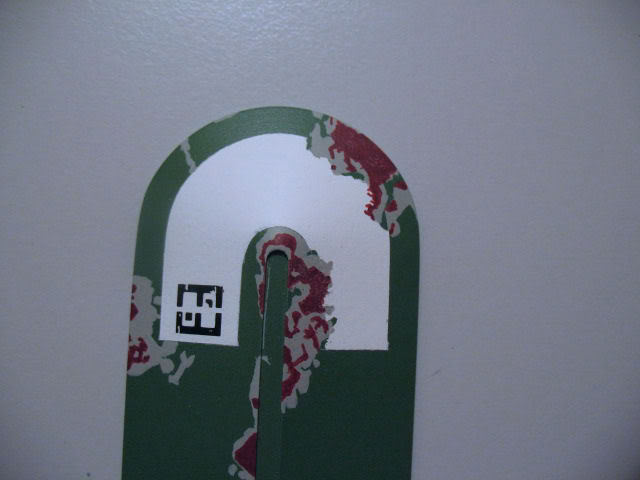

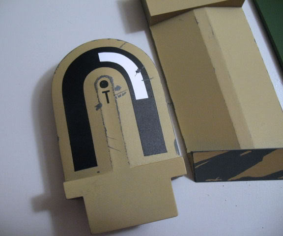

I tried a different technique for the black arch (and the white arch on the left ear.) I wanted to try to paint them this time! Instead of using vinyl decals, which give me heart palpitations when I try to line them up and not ruin them :lol:, I marked the arches by scratching through the paint with my compass, then masking along the lines. I painted the black arch with Floquil Engine Black, which is the nicest, smoothest flat black paint I've ever used. The white stripe within the black arch was a part of a white decal. I didn't want to risk masking over the Engine Black to spray the white, only to have the black pull up.
Here's a couple of shots.
I stopped at this point to dull coat the parts, and tomorrow I'll mask them off and paint the portions to remain raw metal. I'll use Testors Metalizer Stainless Steel for that.
I used the same technique to mask and paint the white arch on the left ear. For the damage within the arch, I applied some liquid mask before spraying the flat white.
For the black symbols, I used rub-on transfers. I used 2 capital Es, and 2 'dots' from question marks! :) Then I added scratches using a brand new X-acto blade. The T and circle on the RF ear are also rub-on transfers.
So, now I have to do the gray and red damage on the left ear, and some silver on the RF ear, and that will pretty much be it! :D

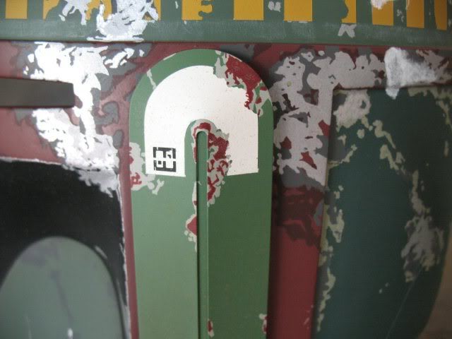

I completed detailing on the ears today. For the left ear, I added the gray and red damage. I used Testors Camoflage Gray and Polly Scale Rock Island Maroon.

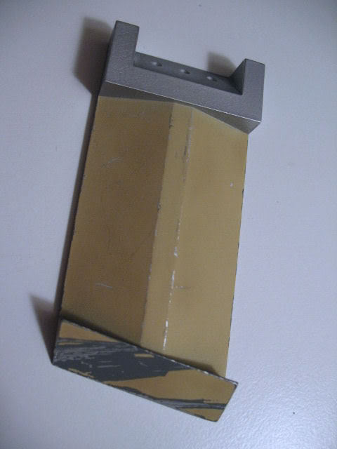

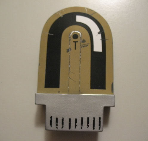

For the range finder ear, I added the little silver chips and scratches, and masked off and sprayed some Testors Metalizer Stainless Steel for the exposed metal sections.
Once that dried, I buffed it with a soft cloth to bring up the shine, and began adding more dry transfers to do the detailed markings.

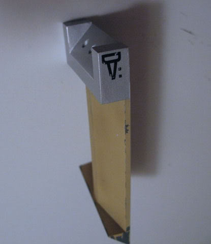

The symbol on the front facet of the lower ear piece is made up of a D, a V, and 2 'dots' from question marks. They were then scratched with a very sharp #11 X-acto blade.
(NOTE: After carefully studying one of the reference pics in our very own TDH Image Archive, I'm fully convinced they used rub-on transfers to do these markings. It's apparent that the vertical V part overlaps the horizontal D portion!)
On the upper ear cap, the 9 lines were made with capital I transfers. I scraped them before rubbing them onto the ear cap. I took one of the ref pics and mirrored it so I could do the damage backward. :) Then I flipped the sheet over and rubbed them down.

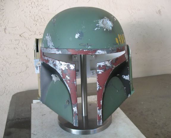

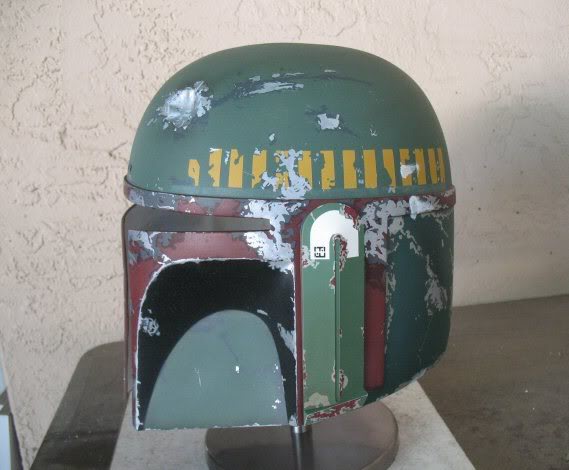

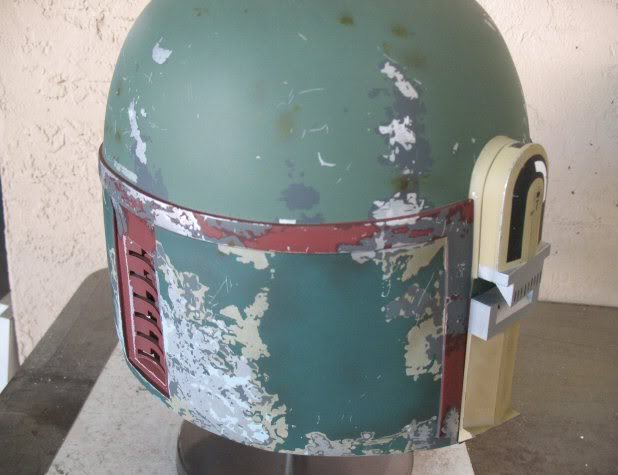

So here are my final pics. These were taken out on my balcony, with the camera set properly this time!! These are in natural, indirect sunlight.

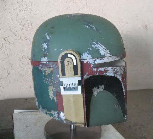

First, a couple of overall shots from the major angles.

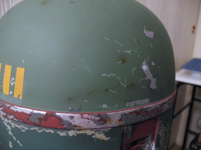

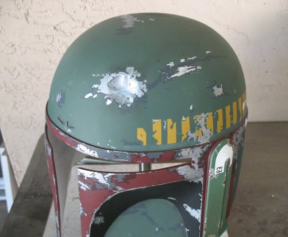

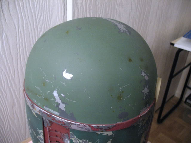

Next, a few different angles and detail shots. Here's a high angle of the dome.

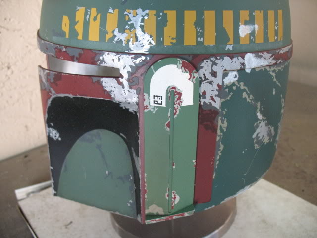

The left ear and kill stripe area.

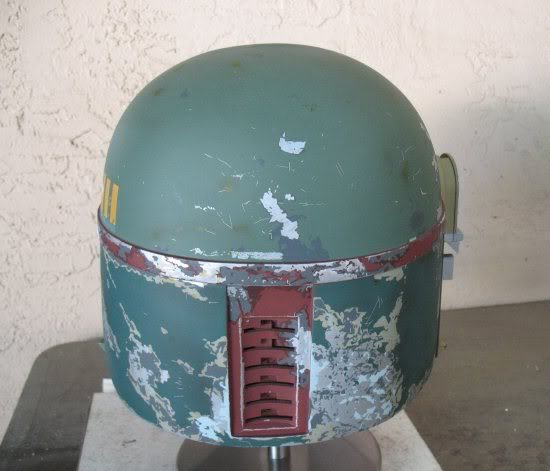

A rear angle showing the staining on the dome and color variation on the back panel.
The RF ear cap and left ear.
In a couple of these shots, it's easier to see where I went back and brightened some of the silver after dullcoating.
