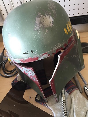

HELMET BROKEN.JPEGI was working on putting the lens on and this happened. After shouting and drinking a few beers I have calmed down. What can I do??

Does the piece fit neatly? Some glue and then filler on the inside should fix it up. Not sure how it'll affect mounting your visor though.
Damn....
best way to fix it is to glue or epoxy it. Then grind into the crack line a bit to make s small trough, and use a filler to fair it in. That sucks man....
two part epoxy glue. Time consuming but absolutely permanent.
Feel for you brother but nothing is undoable. You'll do it!
Good luck.
I use UHU 2 part epoxy but there are many out there.
It can be salvaged. Try two part epoxy to join the pieces and reniforce the inside with a few layers of fiberglass resin and fiberglass mat. Then try glazing putty to smooth the seam on the exterior.
