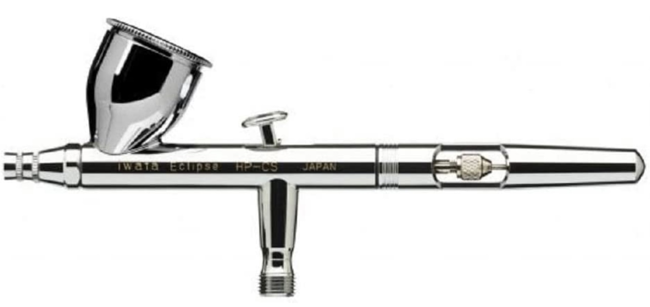

My airbrush is an Iwata Eclipse:

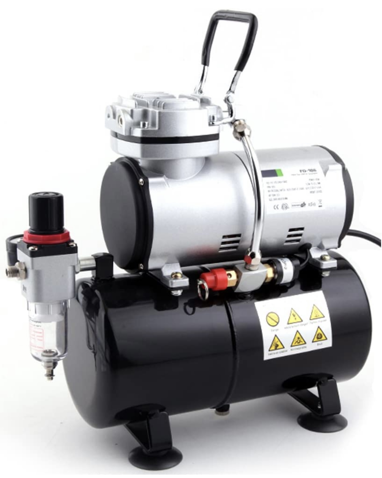

My compressor is a Fengda FD-186 which I highly recommend if space or noise is an issue as it is very small and very quiet:

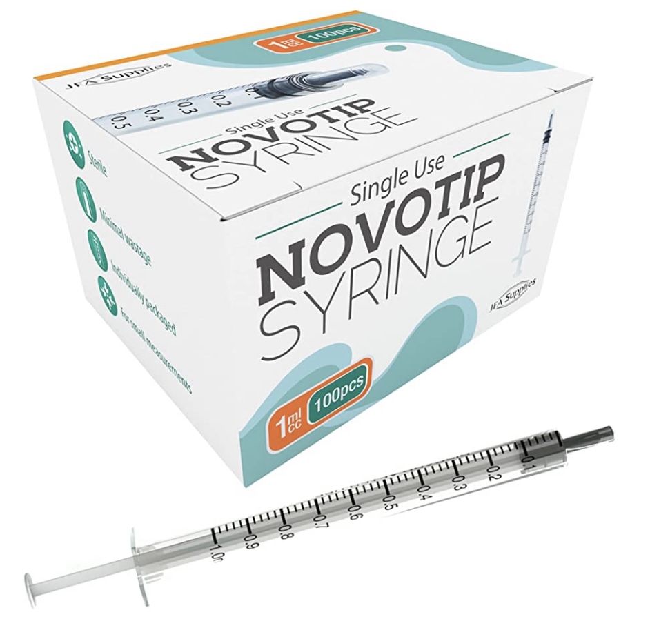

For measuring out paint and thinner, I use these:
They’re disposable syringes. They come in boxes of 100 and that’ll last a long time - certainly enough to do a whole helmet. They have 1ml capacity. Do you need to be this precise? Probably not, a lot of people will tell you to thin your paint until it has the consistency of milk but for beginners this can be a little vague. The other benefit of being precise is that between this and keeping the air pressure consistent - anytime you get a spitty output, there’s a 99% chance the problem is that the airbrush needs cleaning. It takes all the guesswork out of solving the problem. If/when your airbrush does need a dismantle, be sure to look up a how to video on YouTube for that make & model. So this is my process:
I use a 1:1 ratio of white spirit to paint. This is another positive of white spirit because when I used the humbrol thinners, I had to do 2:1 thinners to paint. So, not only are you paying £12 for a 28ml jar but you’re using twice as much every time.
So, draw 1ml of white spirit first and ‘squirt’ it (slowly) into the airbrush cup. I put the white spirit in first to avoid the paint settling at the bottom of the cup and potentially clogging the needle.
Then, draw 1ml of paint - make sure you mix the paint in the tinlet first, a toothpick in small circles works good - squirt that in the cup.

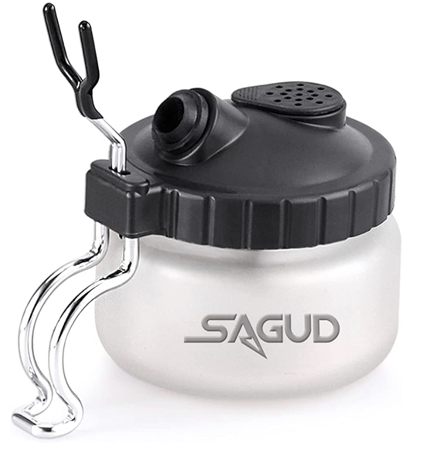

Once you’re done, you’ll want to ‘flush’ the airbrush so it’s relatively clean for the next time you use it. Firstly, one of these is essential:
You will need your hands free when doing most of the above and flushing the airbrush involves spraying raw white spirit - something you’ll want to limit having to breathe in and this’ll help.
Basically, you’re repeating the steps for painting but just using white spirit. 0.5ml or so stirred in the cup, backwashed, and then sprayed into the pot. Once you’re done with that, give the inside of cup a wipe around with a rag.

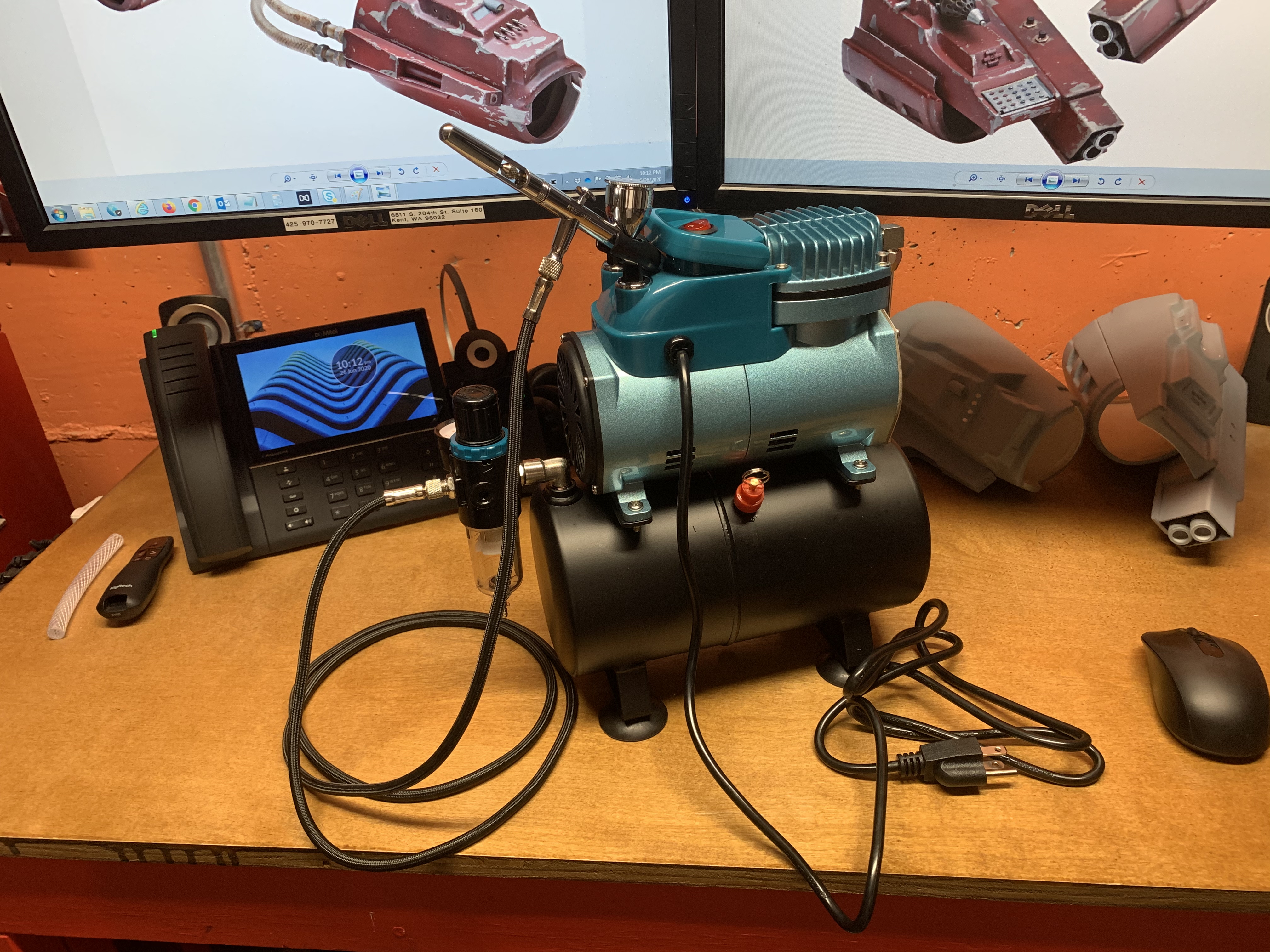

Yeah, I love my iWata HP-CS Airbrush and my Master Airbrush TC-40T Compressor!
My whole ROTJ Fett Kit was done with this and thus far has not failed me. I only had replace my "Needle Chucking Guide with Auxiliary Level", cause my butter fingers dropped it and it snapped. But the OEM part was readily available and not hard to find (Amazon).
