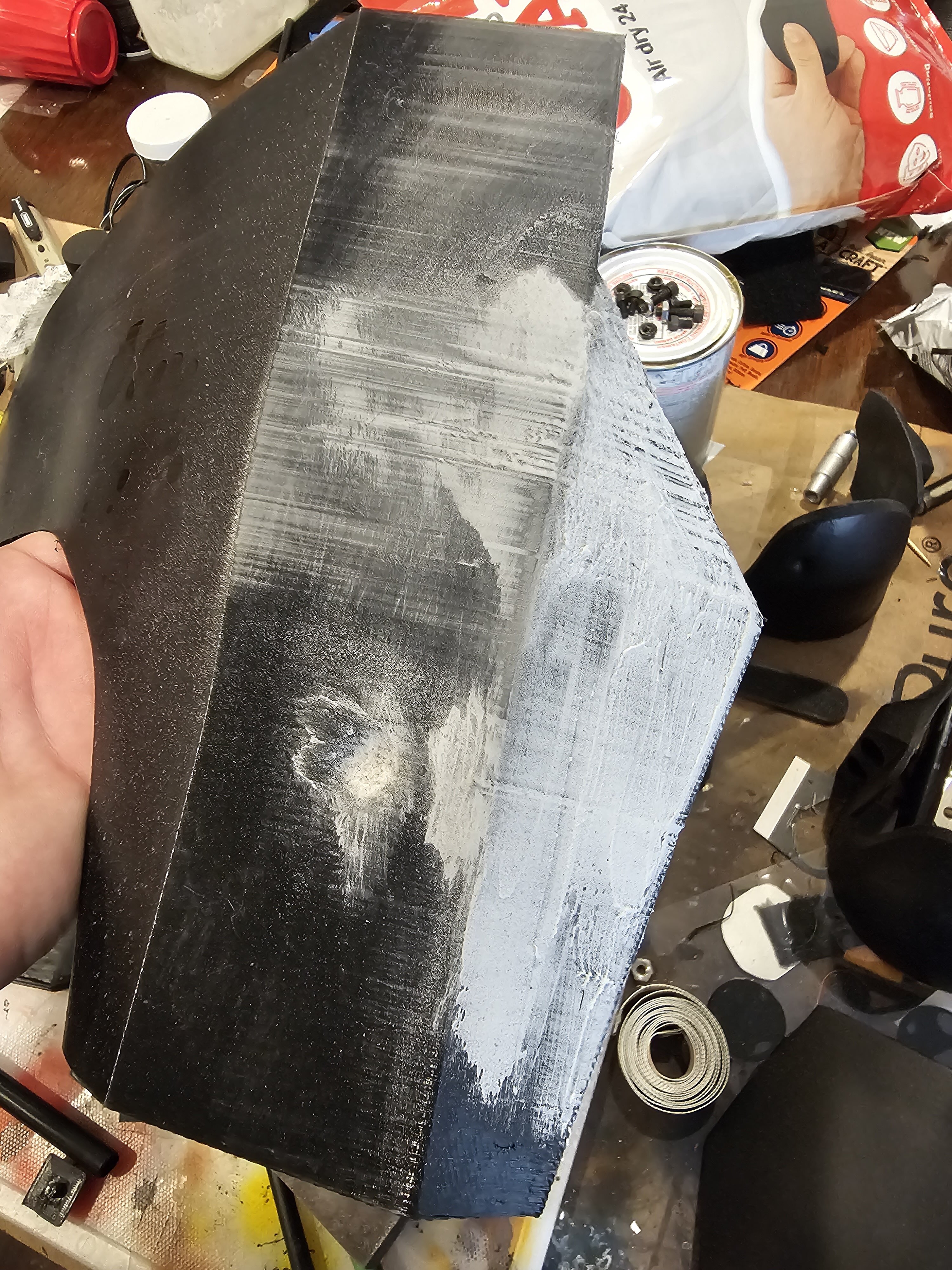

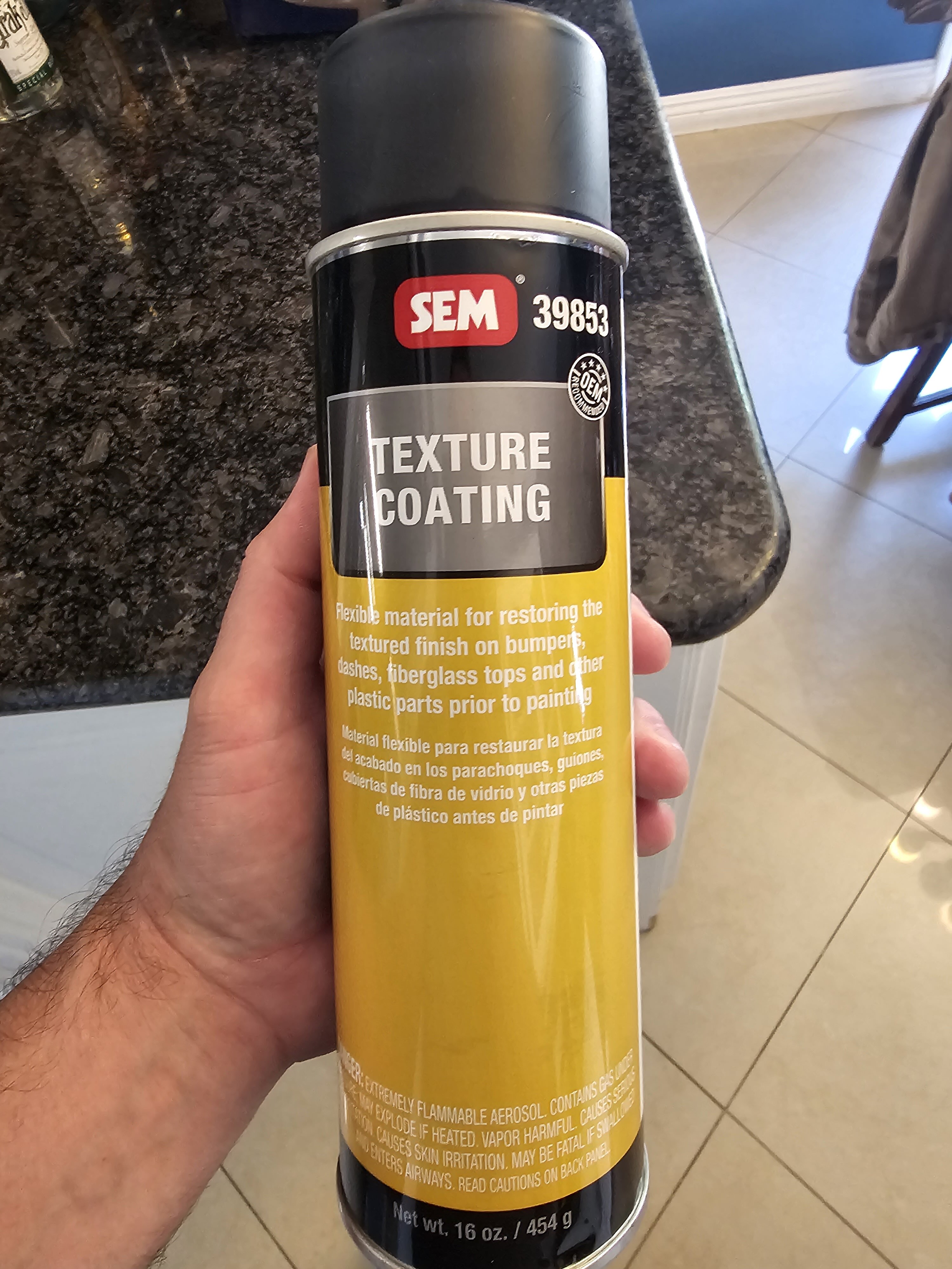

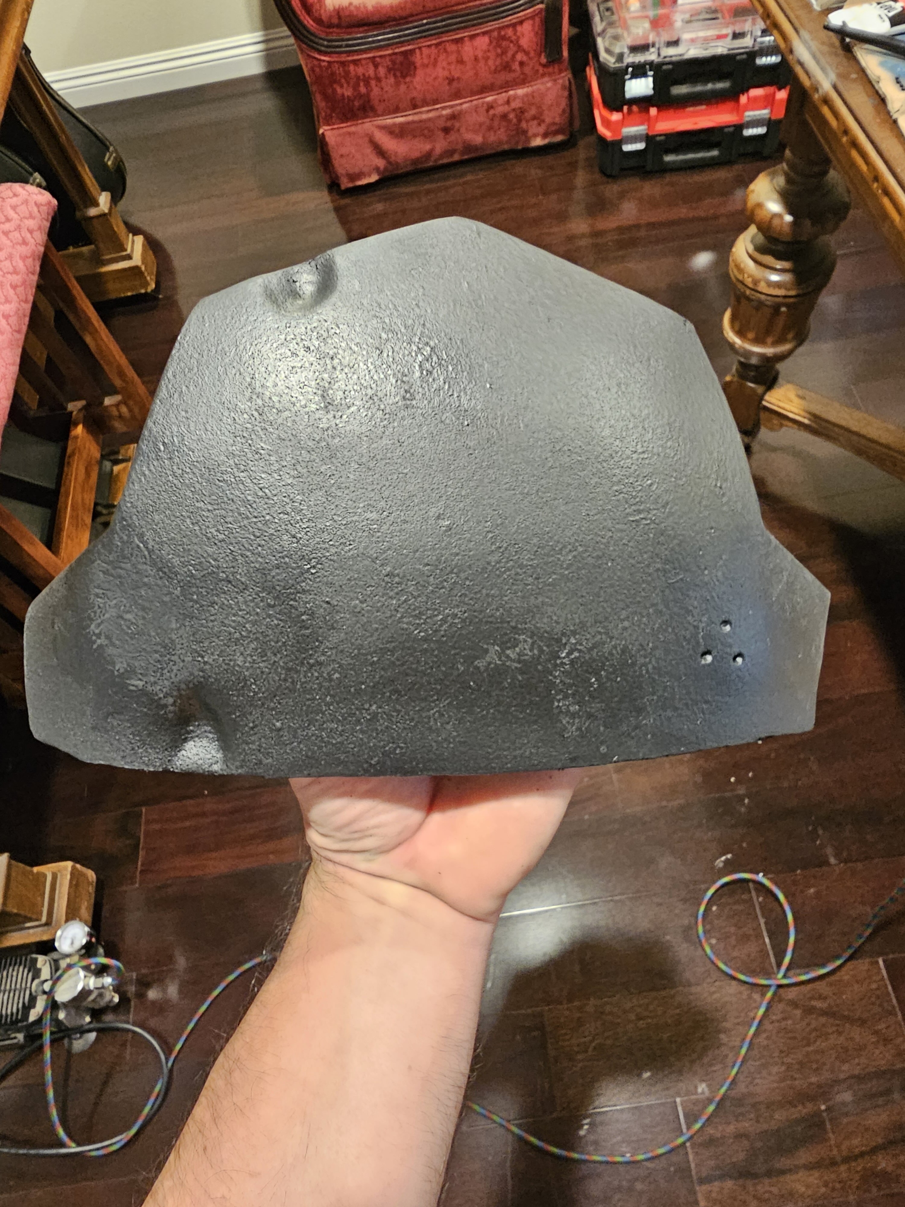

Once the part is trimmed and any major errors fixed I start filling the print lines. I went through several different materials, truck bed liner, epoxy filler primer, etc. Eventually I found SEM Flexible Bumper Texture Coat. As you can see in the pics I use it like a filler primer. Use light "wet" coats. Too thick and it will crack when dry. But thin coats sand fantastically and won't crack, although its not as flexible as the part so it can craze some. It makes a tedious process sooooo easy. I use foam sanding blocks at 100 grit.

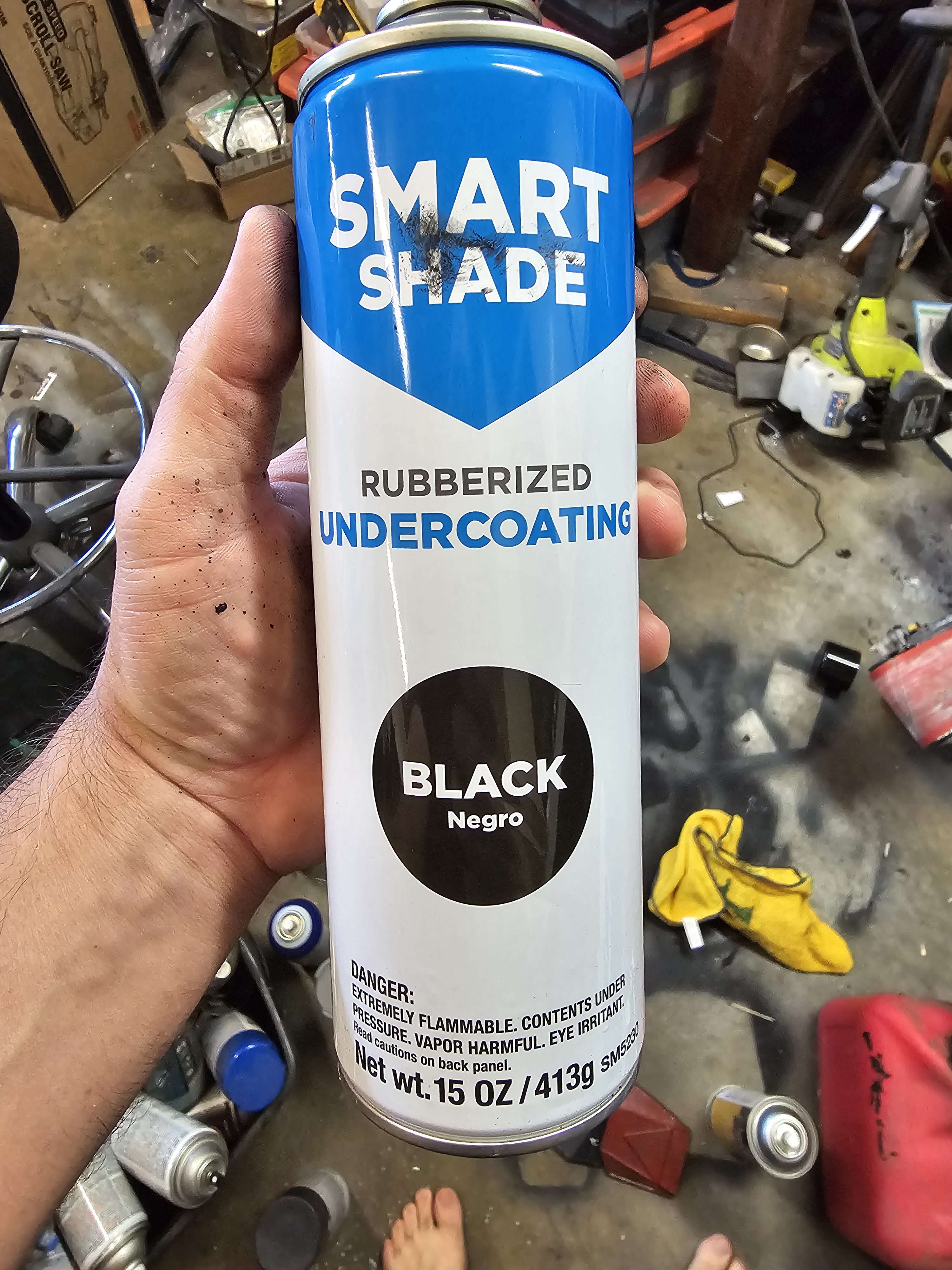

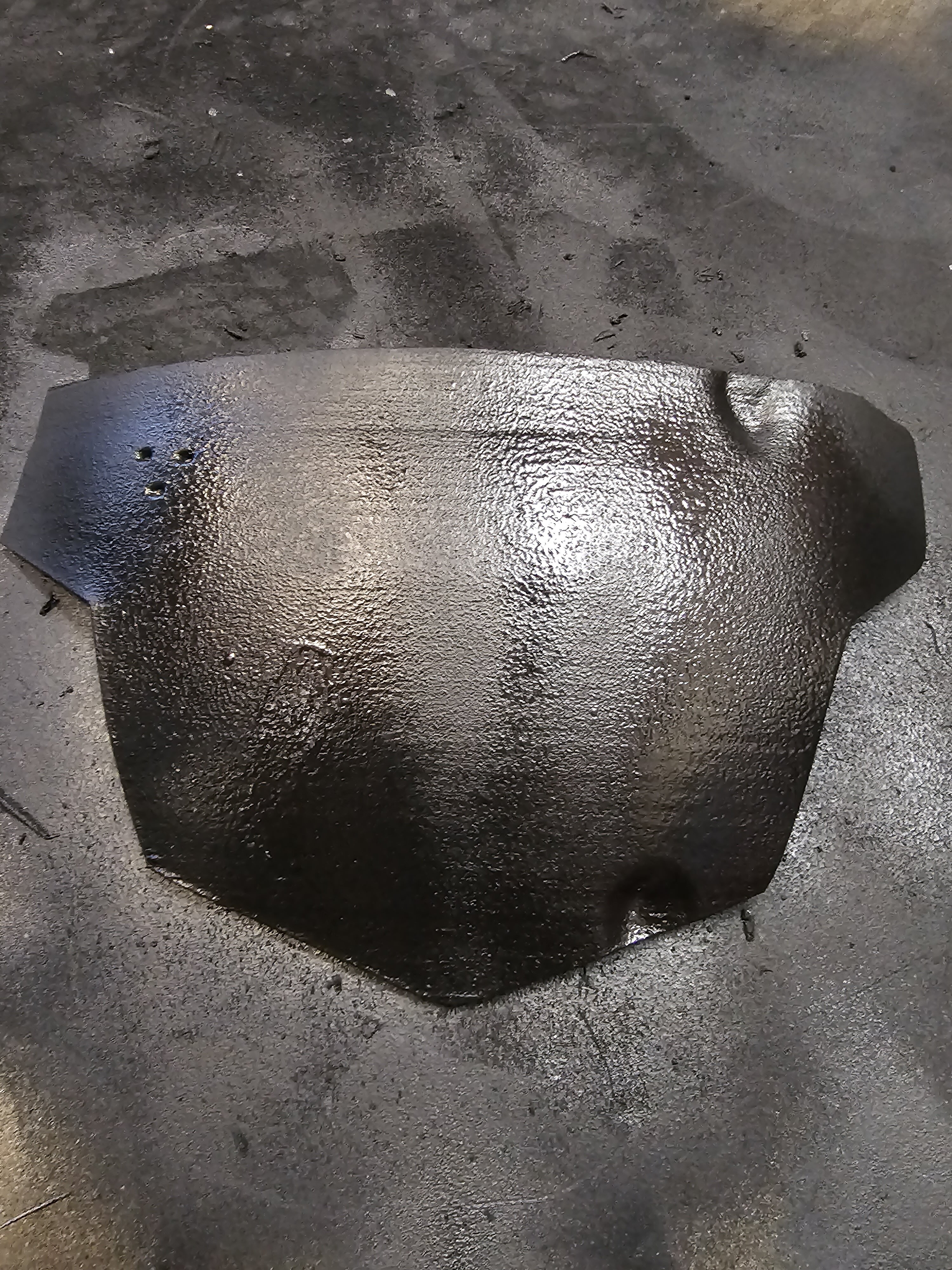

Once all layer lines are gone, usually 2 to 3 coats sanded in between each, I top coat it with Smart Shade rubberized undercoating. This stuff does not sand at all, so only use it as a last layer for getting the post sarlaac texture. You can use a rag to splotch it and add grainy texture, but it sets very fast so be quick. Because it is rubberized it flexes with the print and will make sure than any tiny crazing lines from the SEM coat won't show through. It takes paint very well.

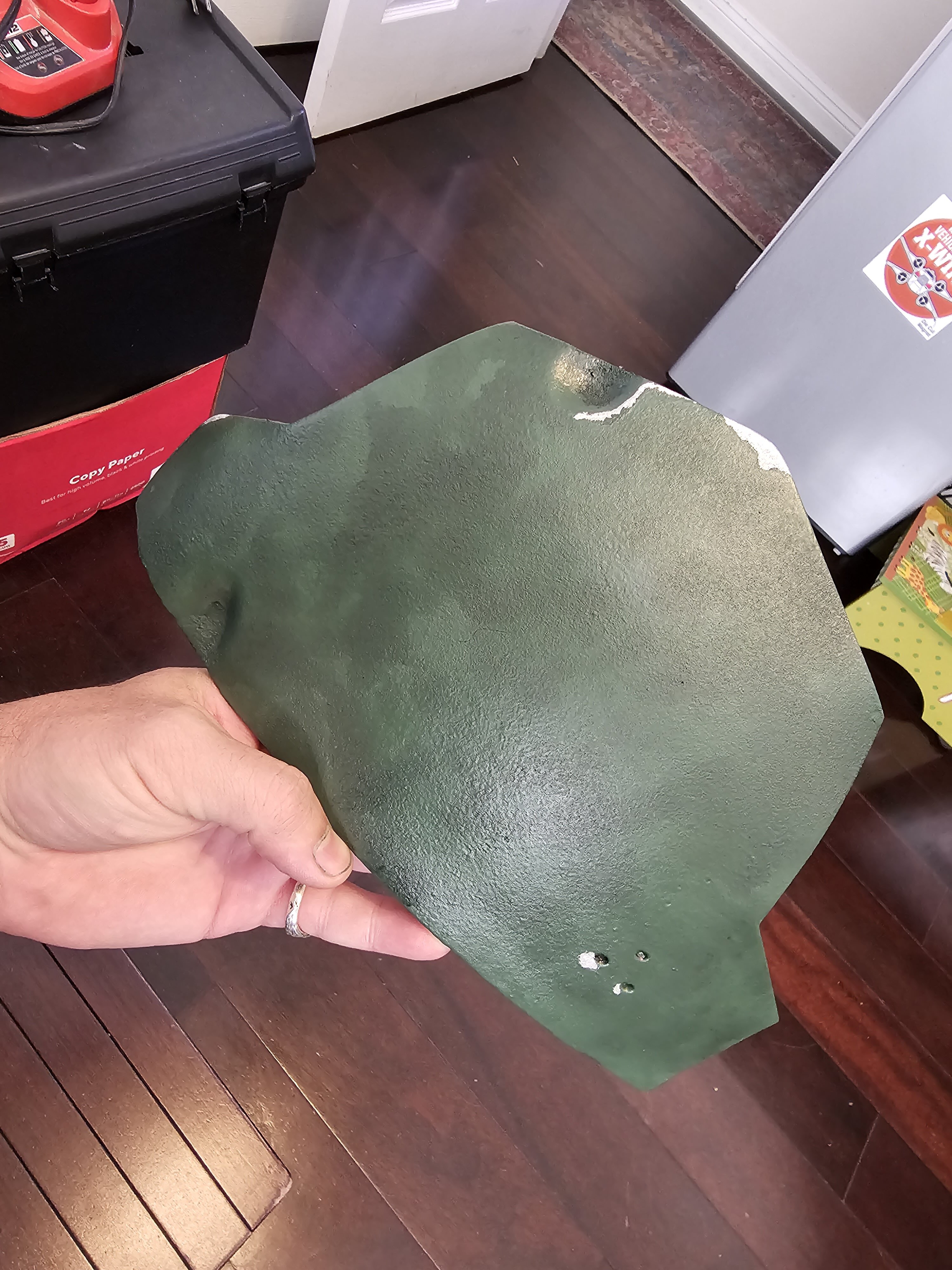

Speaking of paint, the paint has to also be flexible! No primer is needed at this point. Fortunately the Montana Gold and Black spray paints are pretty flexible and I have't seen any cracking or crazing so far. Just paint and weather as normal!
