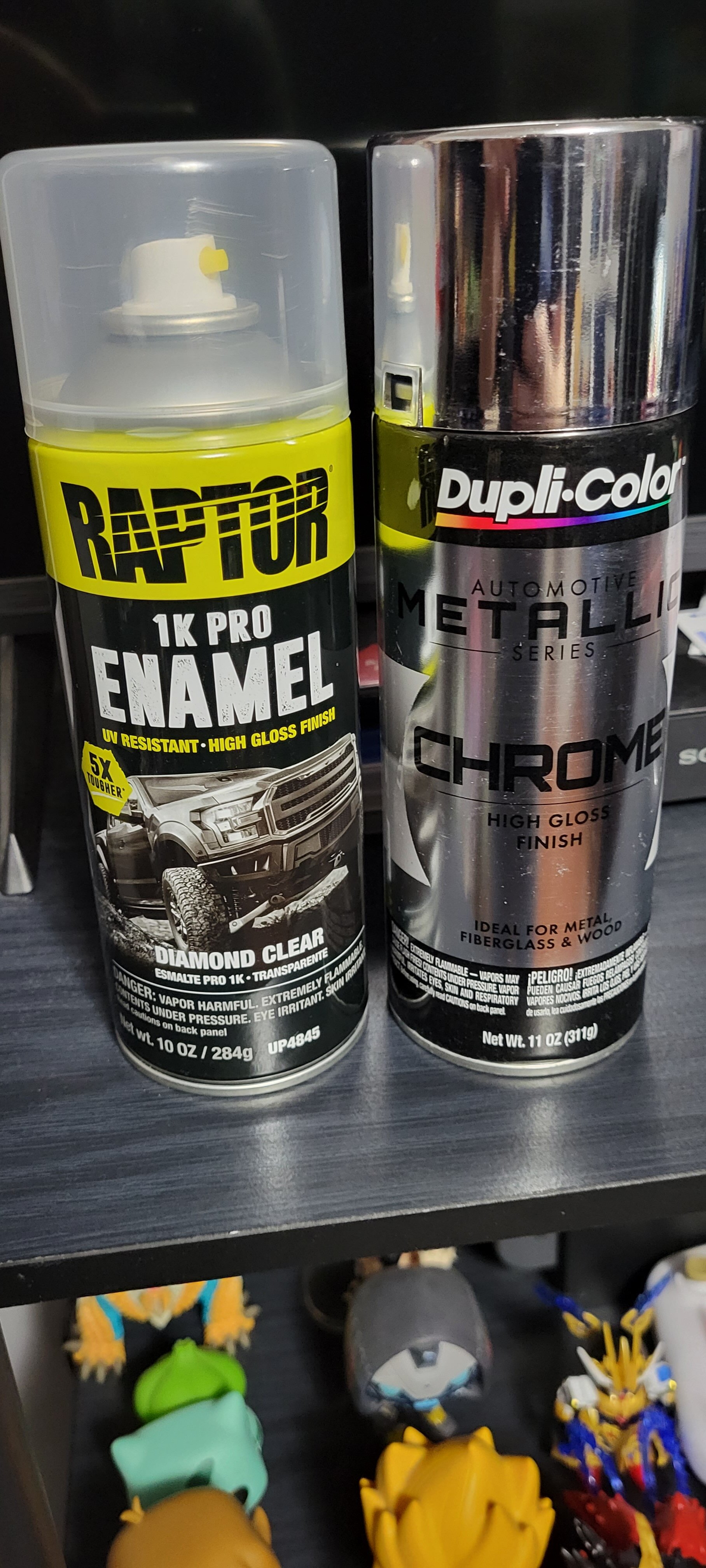

Hey all I'm new here and pretty new to Star Wars cosplay. I'm building a Din cosplay and I have everything done, but I have one thing left to take care of and I need some help. So for the chrome/silver I went with a chrome rattle can spray paint because it was the most cost-effective. But when I used this clear coat it turned the peice I sprayed grey after a few coats. Im looking for some help on how to clear coat this without turning it grey. I have 1 other clear coat i can try but im worried it will do the same. An i know if i leave it uncoated the chrome will be ruined in seconds. So if any of you have any advice or know of anything i can use, id really appreciate it.

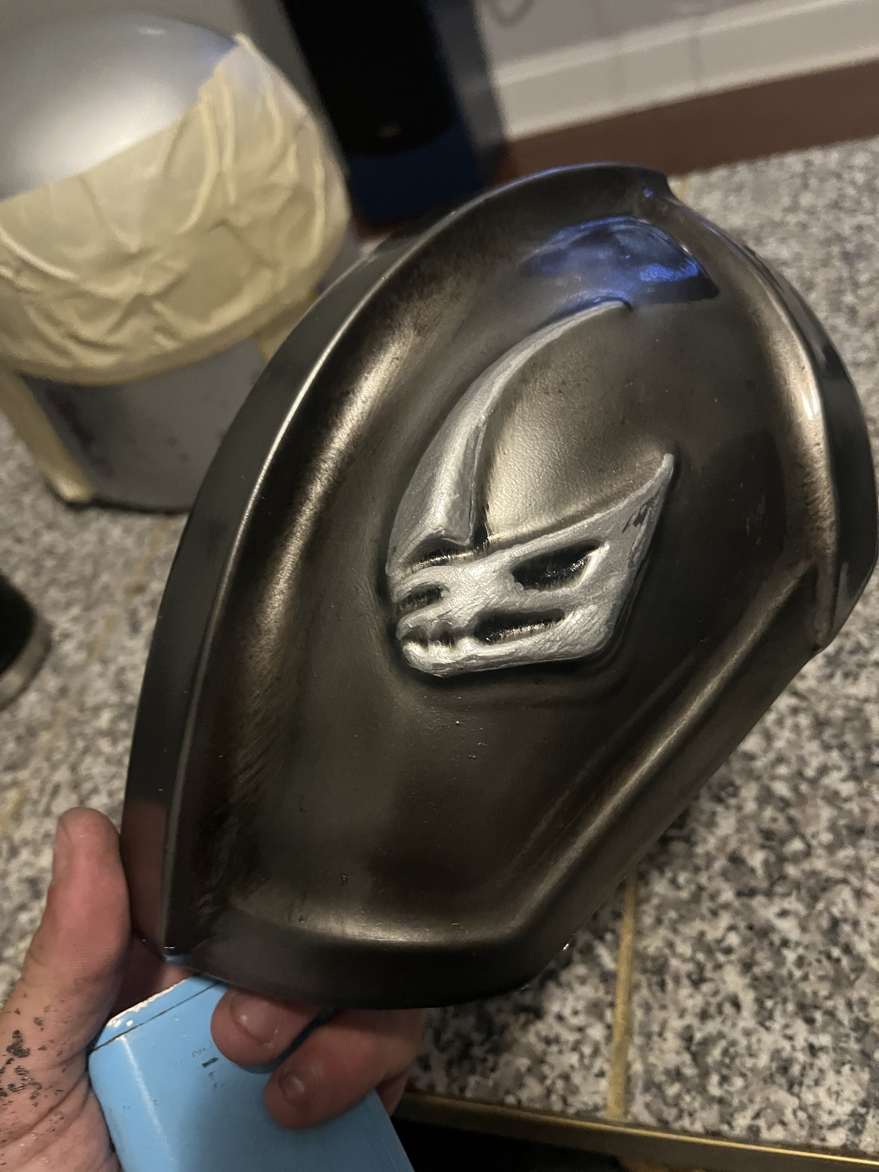

This is my shoulder piece after weathering with black artist oils and coating the sigil with moloto chrome pen to make it stand out
