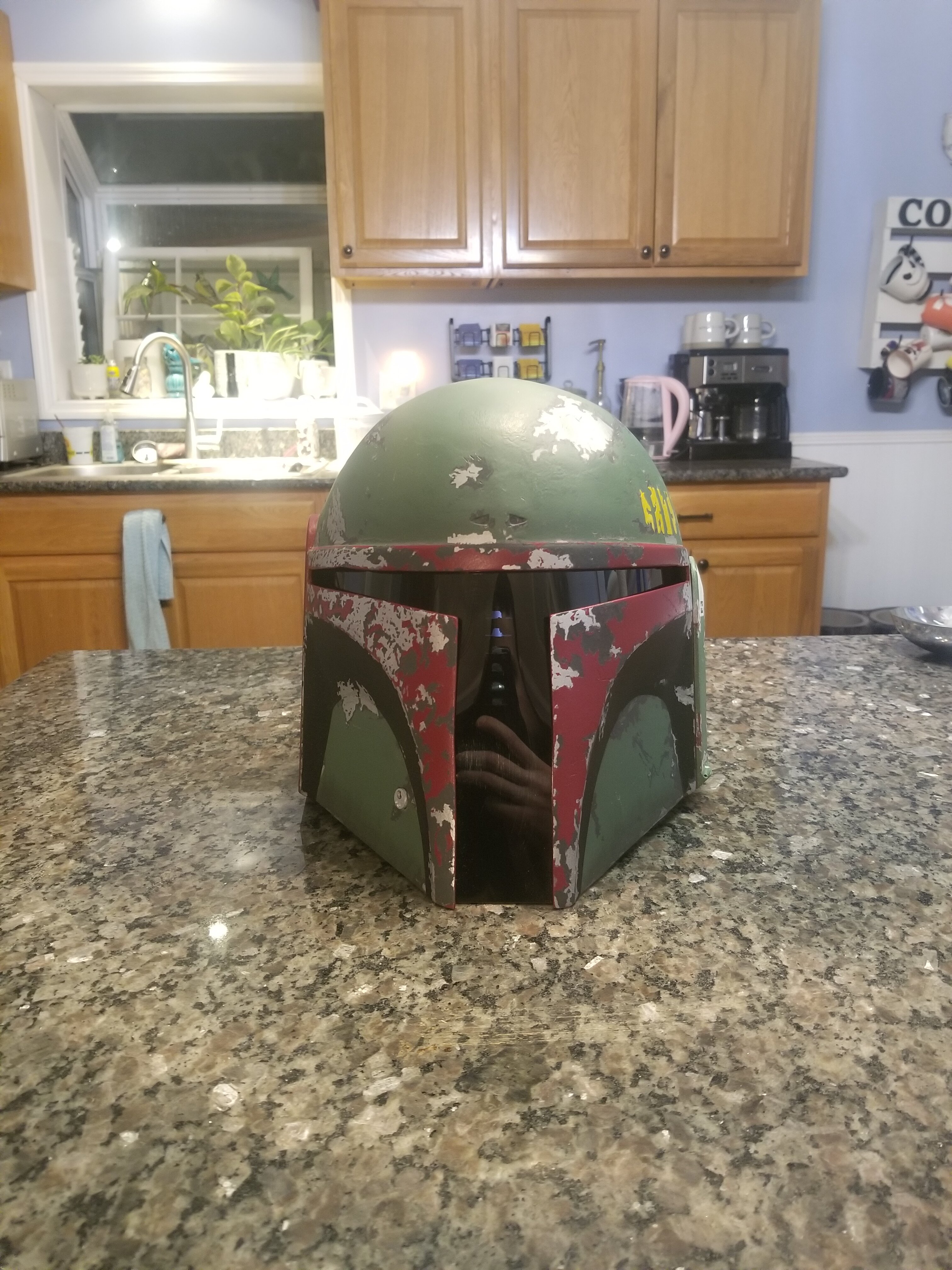

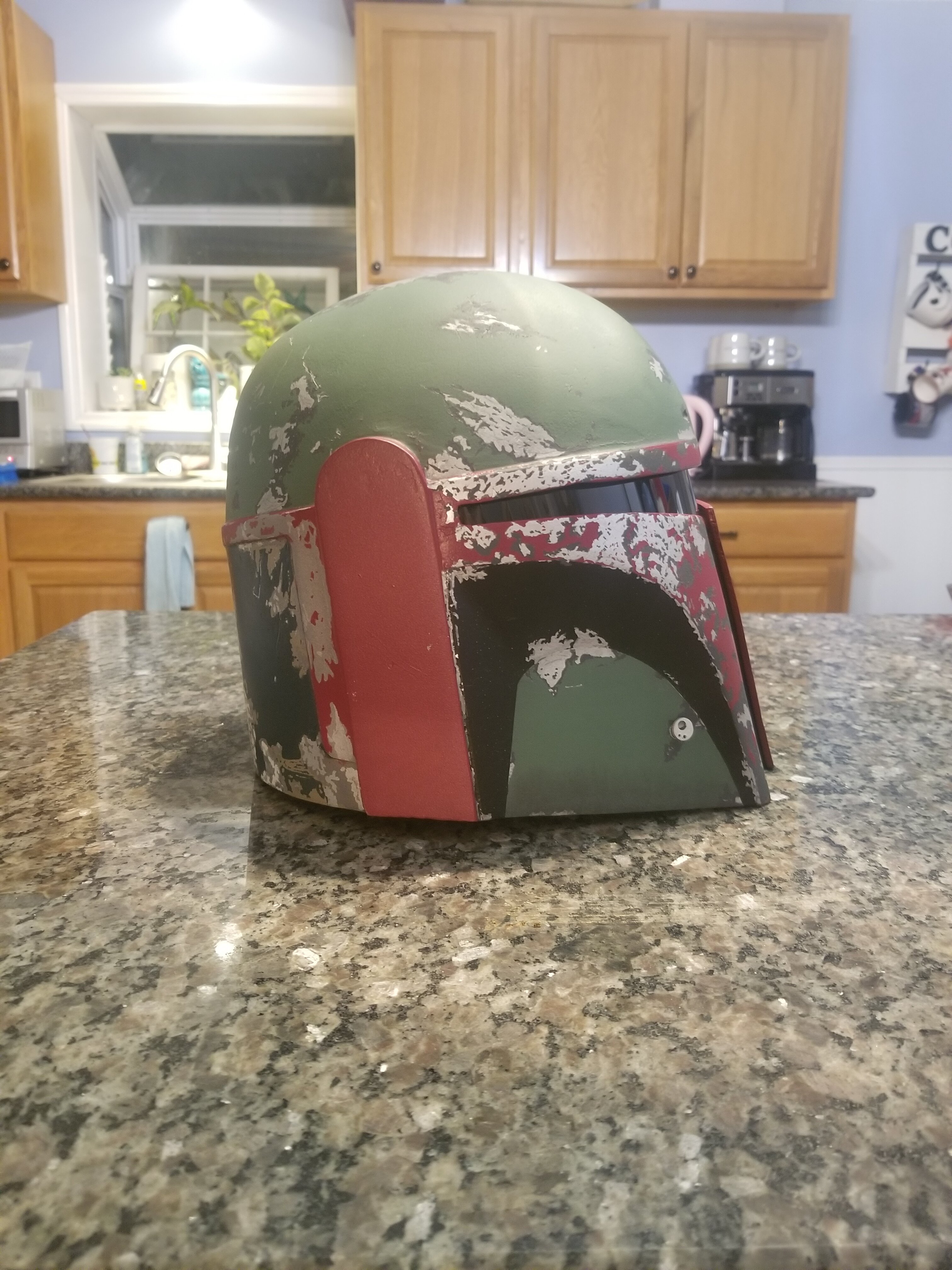

I have a 3-D printed helmet I have painted on since last December. I never intended on building a full outfit, but now that I've gotten all the armor and I'm halfway through the armor painting process I'm wondering if this helmet could meet 501st approval standards. I know my kill stripes need painted and the back panels need to be "more green", rangefinder, ect, but I'm more so talking about the shape. Would it pass approval standards? Thanks for your help and info.
Once the helmet is complete it should pass basic approval *but* depending on the local GML they might have an issue with the sizing and detail of the physical damage of the dent.
Thanks for the feedback! I may end up getting a nice helmet to paint and erase all doubt. What ESB helmet would you recommend if you were to start an ESB build right now?
That helmet have lots of issues, but at least you had a canvas to practice your painting technique and colors. For official versions go wit RS Prop Masters or Machine Craft Replicas, for unofficial versions search Etsy.
Thanks Raf! I used your paint templates to get this done. Couldn't have done it without you. When I started this project I didn't really know the difference. I was broke, and wanted a Fett Helmet, so went the 3D route. Studied your stencils/templates for countless hours. Eyeballed them best I could, and went after it. Now that I'm this far along and have absorbed more knowledge I'm thinking my helmet cast isn't up to what I feel it should be. You're right about the practice for sure. I bet I re-did those rear panels probably 7 times ha. It appears I have some work cut out for me. and possibly some more curse words to utter along the way with a new helmet lol.
That flare/warp down the middle of the t-visor would be a blocker for me, but I’m no GML and I’m working through my own submission.
But the geometry of the face of the character seems critical to me.
Nice job on the paint!
Thanks for the feedback! I think I'm planning to get a new helmet and start over. Painful, but I want the helmet to look right.
