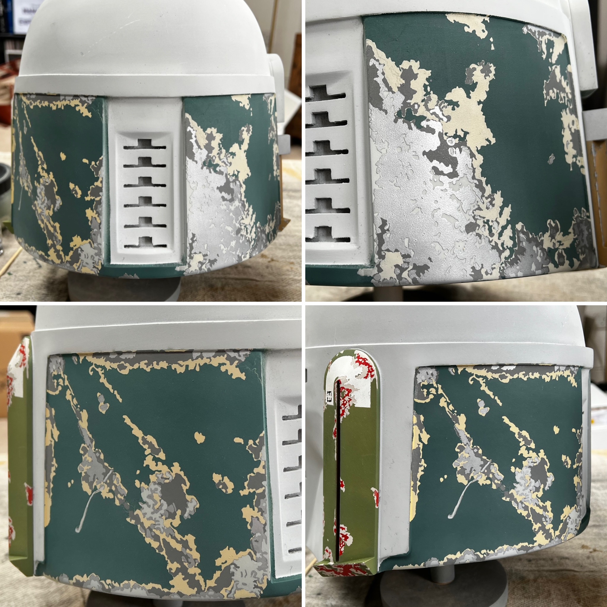

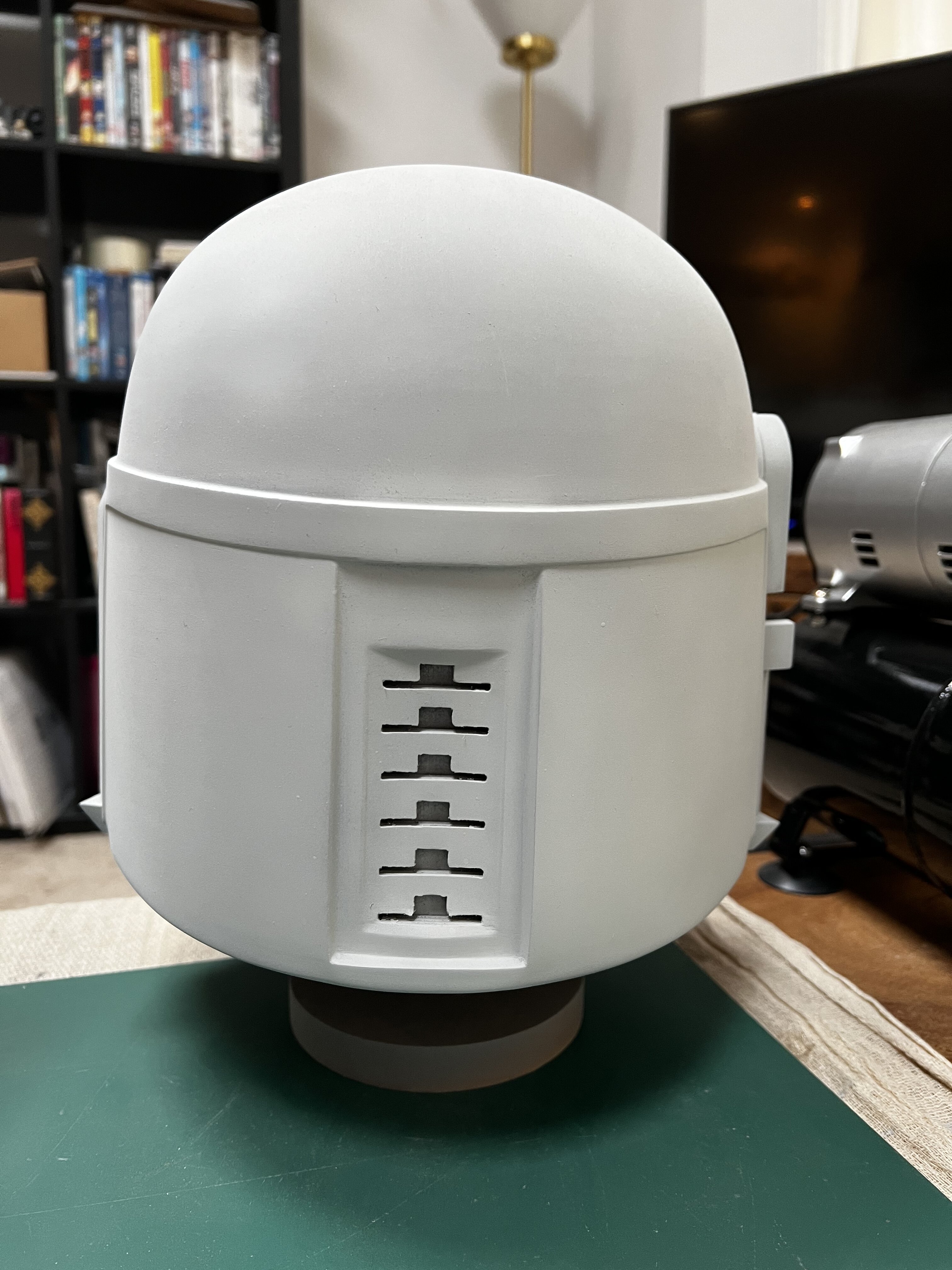

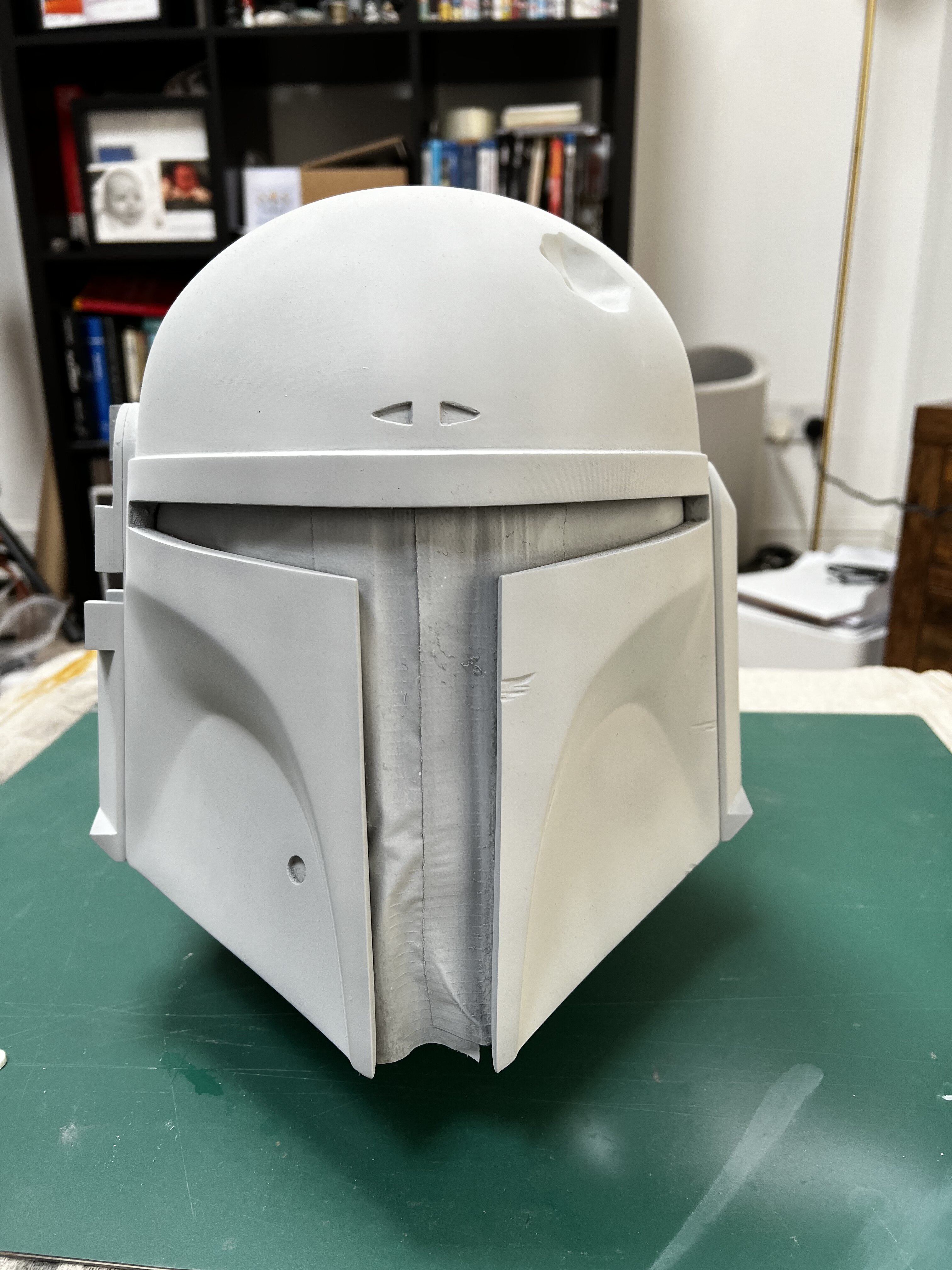

Anyway - the photos are after the base coat of 147, from before I started the main painting, please feel free to point out all the bad stuff! (Physical damage was added by me)
Here’s some more photos of where I’m currently up to:
Just looking at the print I'll chime in about the accuracy compared to the hero helmet.
1) Overall shape is off. This helmet looks more like a realization of a clone wars style Mandalorian helmet especially where the mandibles pinch and appear sharp instead of evened out if that makes sense.
2) The Dent is too large and the helmet is missing accurate physical damage and the bow in the visor area. Some areas in the print like details behind the ears are soft.
3) The ears aren't separate pieces like they are on the hero.
Just to say, the ears are separate pieces - I just have them bolted on in the photos.
Appreciate you chiming in though! I agree it looks like more of a generic Mandalorian helmet than a BF
