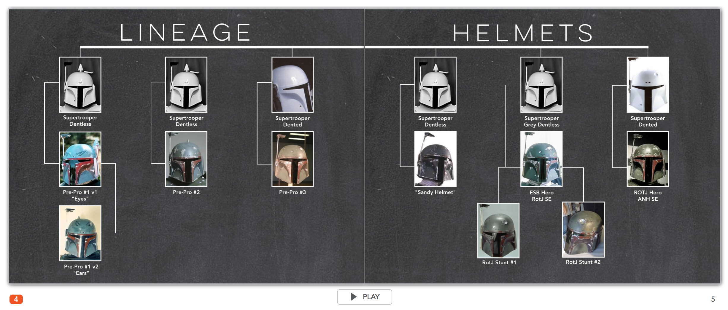

Were all six of them done in white gelcoat? Browsing TDH I found this lineage chart that refers to the ESB supertrooper as grey, but I can't seem to find why it was listed as such. Does that insinuate the ESB helmet was done in a grey gelcoat? Or painted/primed grey??
The ESB helmet was primered gray.

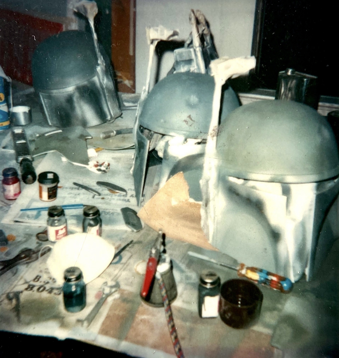

The helmets Daydream Productions did arrived already painted white:
They were then primered and repainted with a high high likelihood that the white remains underneath. Seeing as how it was so rushed that they masked the ears off in place on the helmets rather than remove them for paint:
