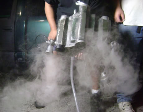

Jet Pack thrusters test with smoke machine
I like the idea of using some type of smoke machine so that the fog is constantly misting out. Was this fog machine plugged in? If so, how did you get around the cables? Wear a battery pack?
