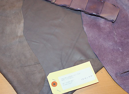

Okay, Finally got the picture of the leather I bought from Vogue Fabrics. It looks a bit grayer than it does in real life, but you get the idea in comparison to my skirt leather colors and my mock-hood leather color.
Just a quick question about the veil and hood - who has used the predyed pigsuede? Have you added any dye to it or weathered it in any way? It looks wa too purple to me and i was wondering how best to make it work. Yours looks a nice color MM have you done anything to it?
Also the Shin Guards, are they leather covered for sure? They look plastic-ish to me, shiny in a way. Moncals yours looked good, were those leather covered, how did you do them?
One way to "get it less purple" is to put it out in the sun, so that it could fade. Yah, the purple suede from Tandy is too deep/dark/purple. Mine is actually moleskin fabric temporarily, until I can find a shade of the pigskin I like.
Your mock hood color is very close if not perfect MM!
That is the only advantage I can think of for living here in the middle of the desert - being able to bleach out that pre-dyed purple pigskin! :lol:
It's just the regular purple pre-dyed one from Tandy. I opened the box and thought "what am I gonna do with that?" The color was horrible! ZIA suggested sitting it out in the sun. We've got plenty of that here, so it sat out in my backyard for 10-14 days. Kept bringing it in and checking against the cardboard standee! "Nope... not done yet!" ;)
