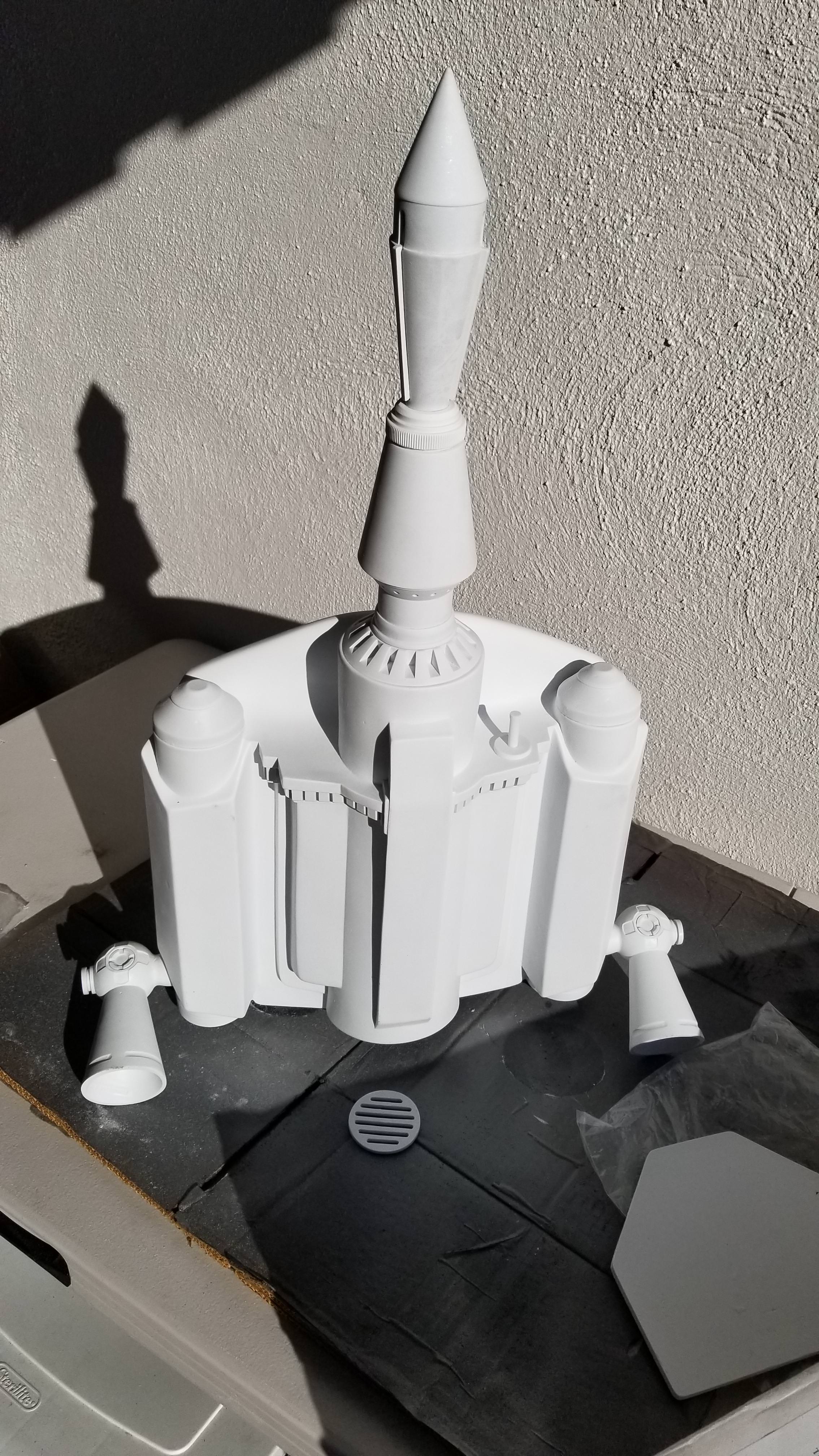

Got a few hours of progress in today: Jetpack paint prep! Boring stuff, but needs to be done for a nice canvas. Got everything sanded to a good stopping point and have a few WIP photos for those interested in cleaning up the Man of War jetpack. I hear Man of War is moving to soft parts only? Or at least not doing hard part/resin runs any longer? Either way, I was fortunate to pick up one of his last ones then.

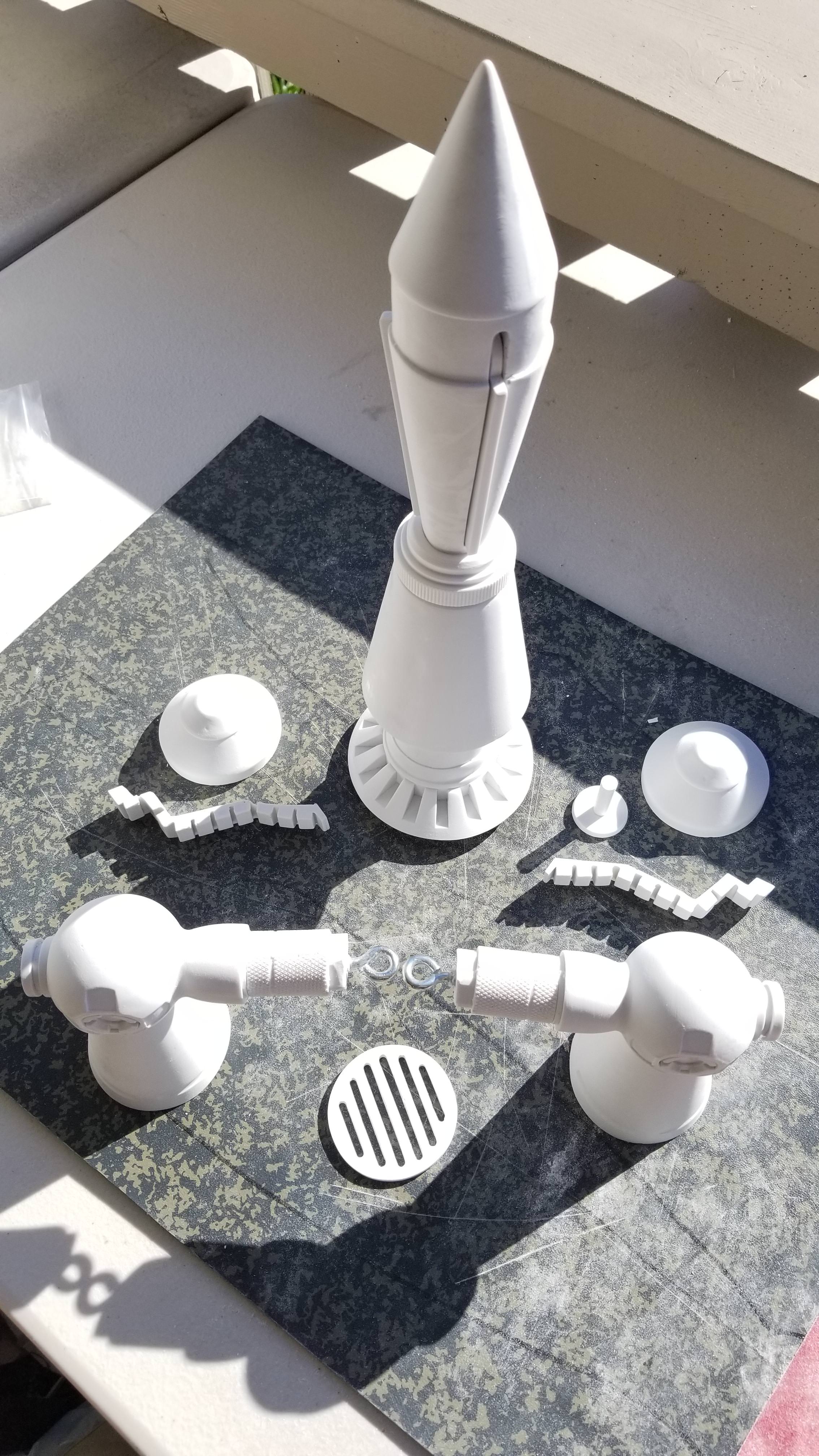

Here's a quick look at the parts after they were sanded down and rocket assembled.

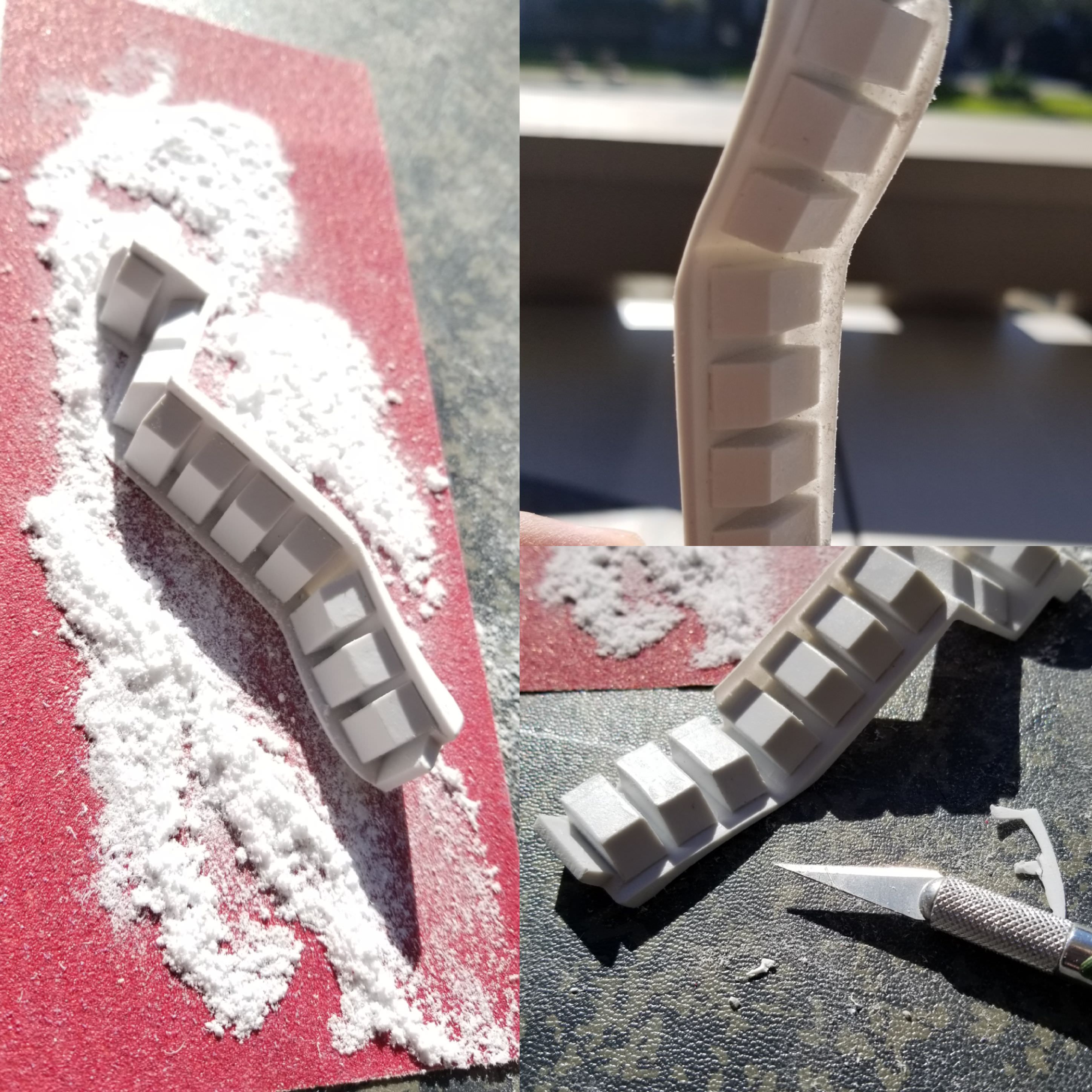

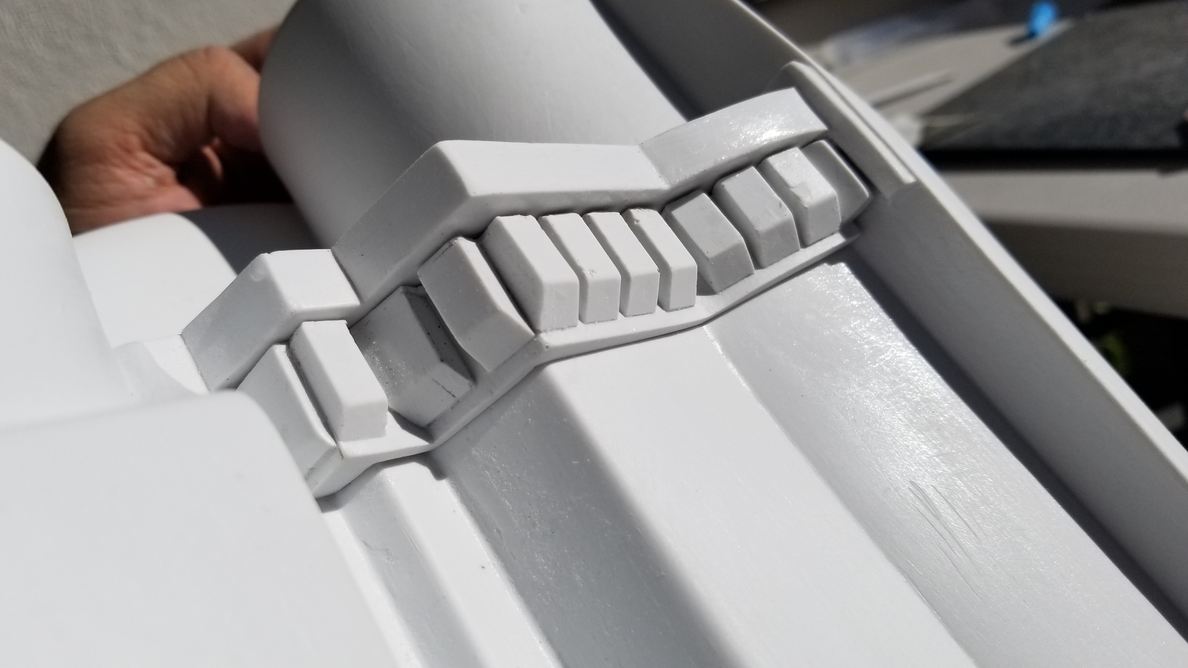

Piano Keys! The part of the jetpack I've never paid attention to until I had to grind off a bunch of resin and use an x-acto knife to cut away the rest of the flash. Ended up grinding down the block until it was thin enough then dialed it in between the corners
I ended up attaching the piano keys to the pack after I sanded it down. The pre-shaped resin fit in pretty good, but I ended up using a heat gun to reshape the keys for a tighter fit on the corners.
In the previous posts above, I noted how many seams there were to the casts. Fortunately they just came off with sand paper and didn't need any bondo work. Should be a nice smooth coat once paint comes in. Here's an after photo of the sanding for those wondering if they should clean up the lines. Yes, yes you should.

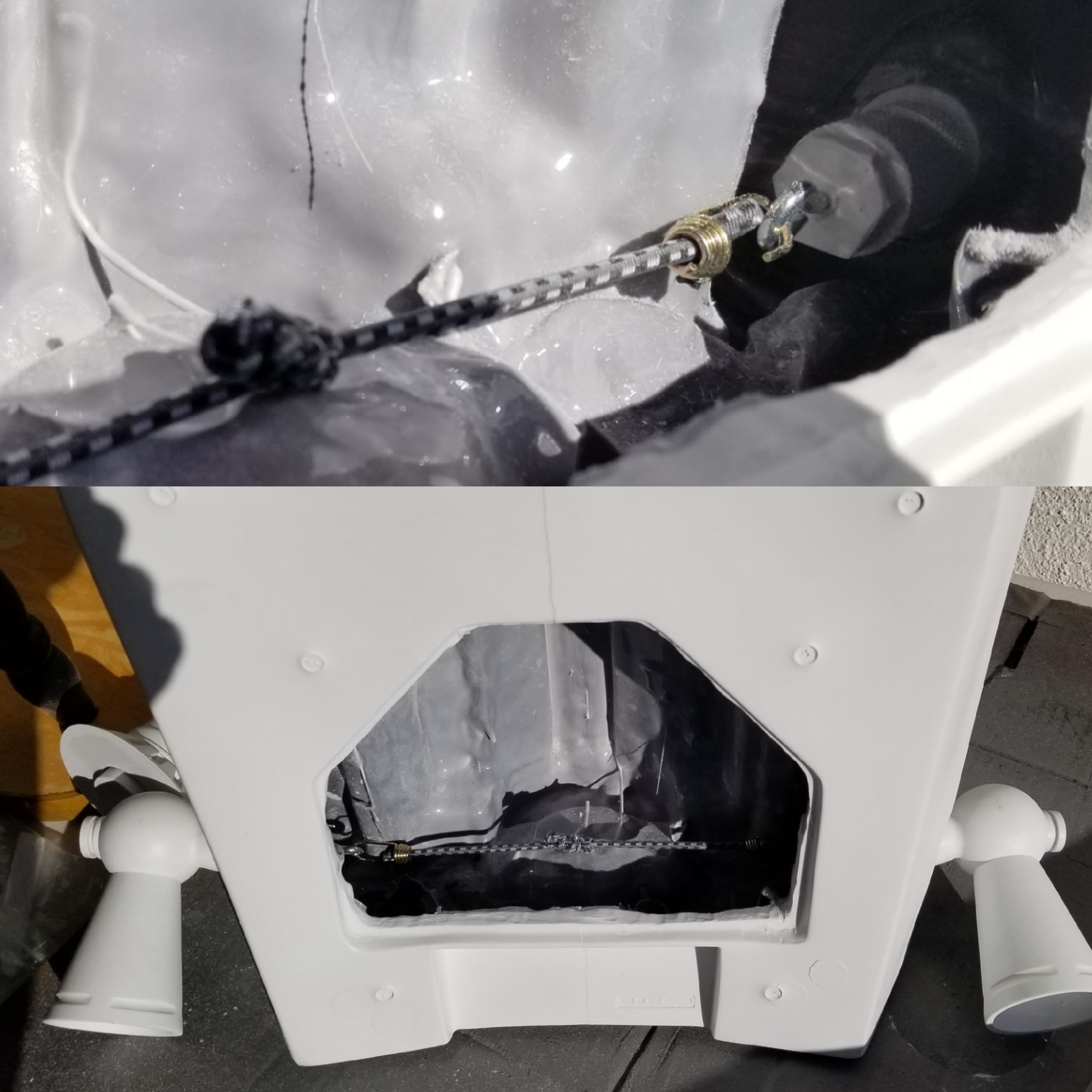

I didn't spend much time on the back portion. But you can see the bungee installation on the eye hooks. I believe this should work. I knotted up the cord a bit to snug the fit more, but it appears that the thrusters will move freely if bumped.
And here it is! Almost in its glory. Still need to order the MachineCraft Replica's beacon and get the dental file for the stabilizer, but this thing is ready for paint! Pretty stoked to have gotten to this point. I will likely magnetize the rocket to the pack for disassembly and packing.

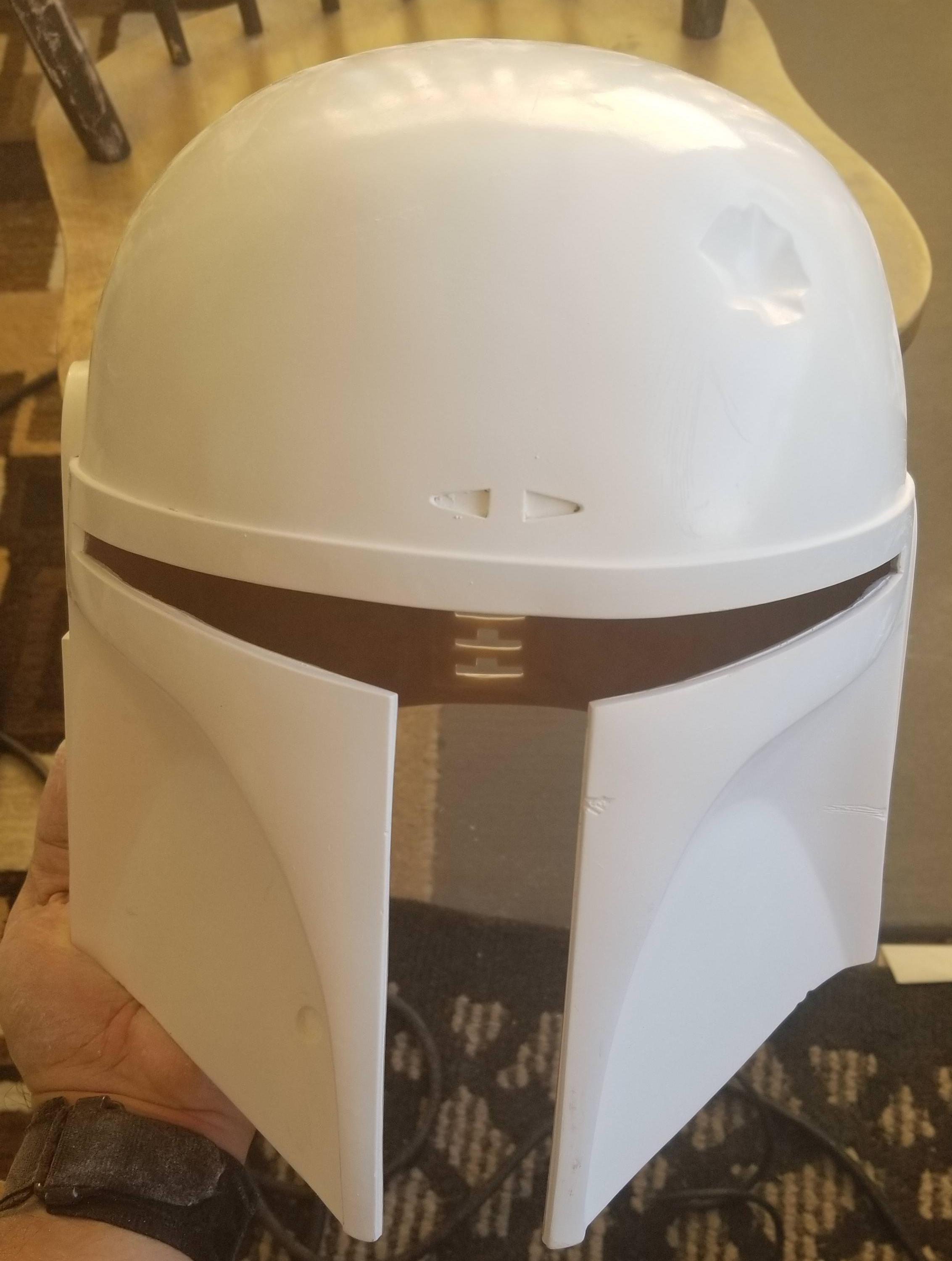

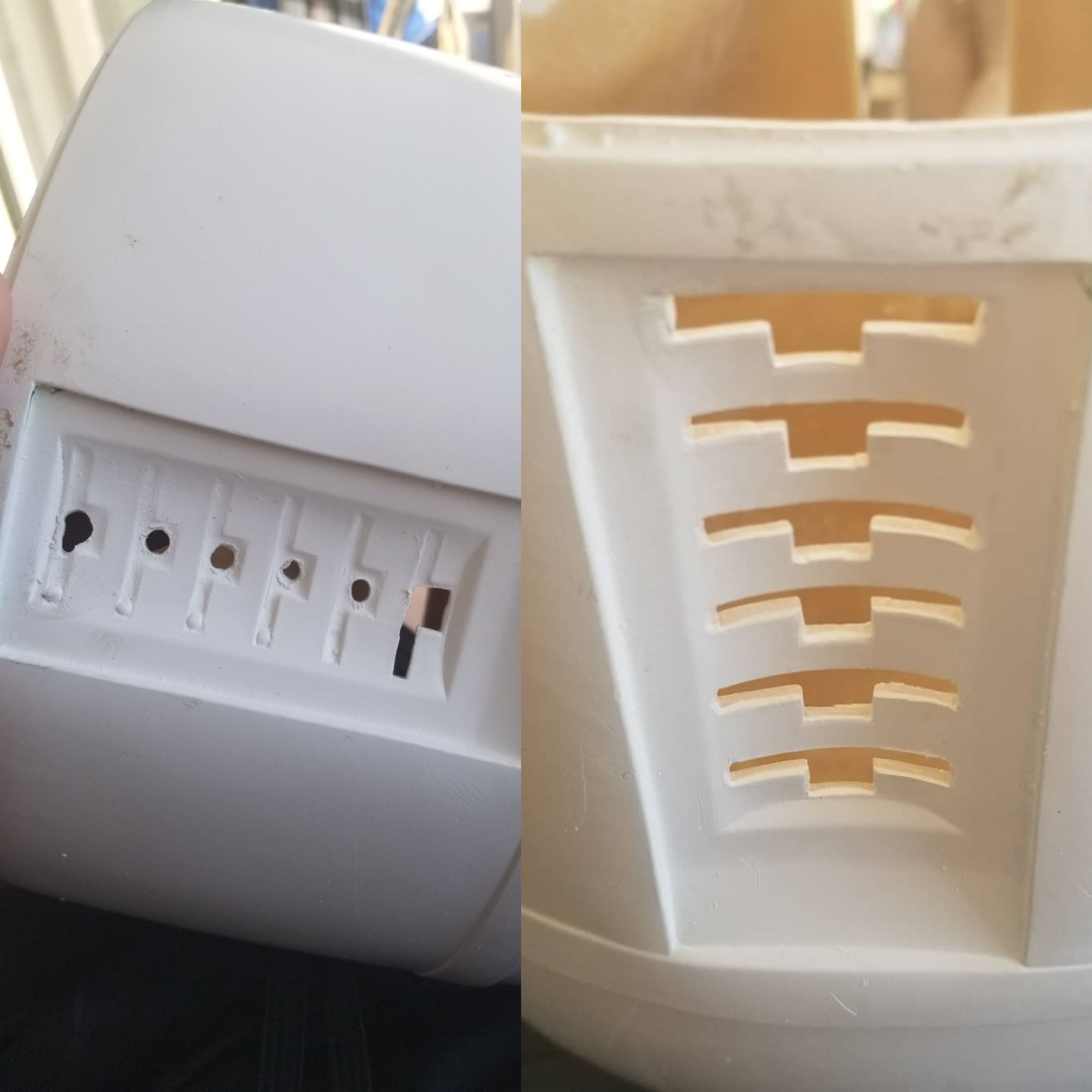

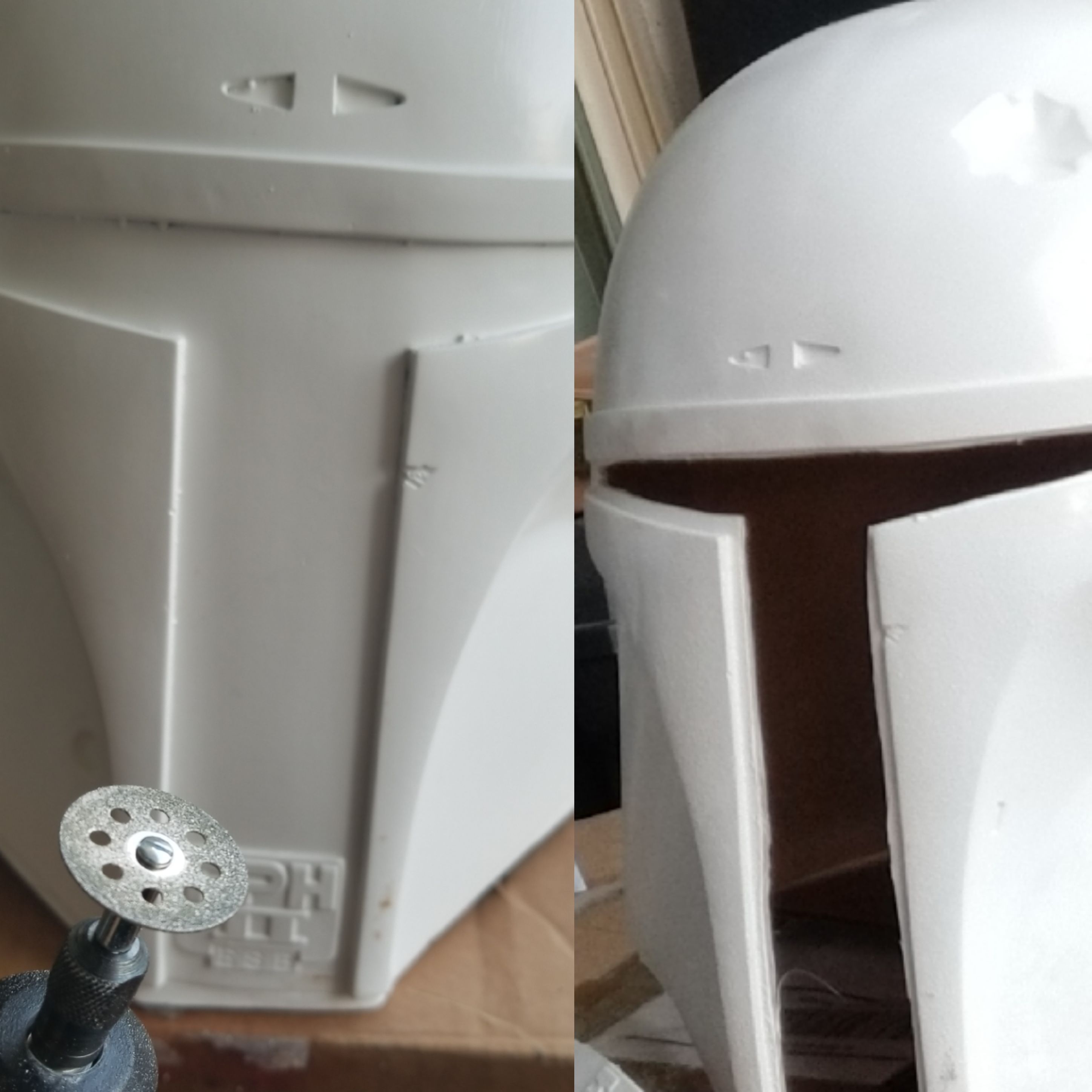

Minor update while the holidays roll through. Put some time cleaning up Wasted Fett's FPH2 helmet. Great to work with! The filing and sanding was pretty easy going. Key slots are like a rite of passage.
Working on this helmet is a new thing for me. My first bucket came from NME props, The Mercenary, and when I received it, it was cleaned up and visor was installed. With Wasted Fett's I used a diamond dremel blade to cut out the visor. This was my first time using a dremel blade and working with a quality helmet like this. You can imagine my caution and see how far away I made the cuts. I didn't want to chance hitting the actual helmet itself.

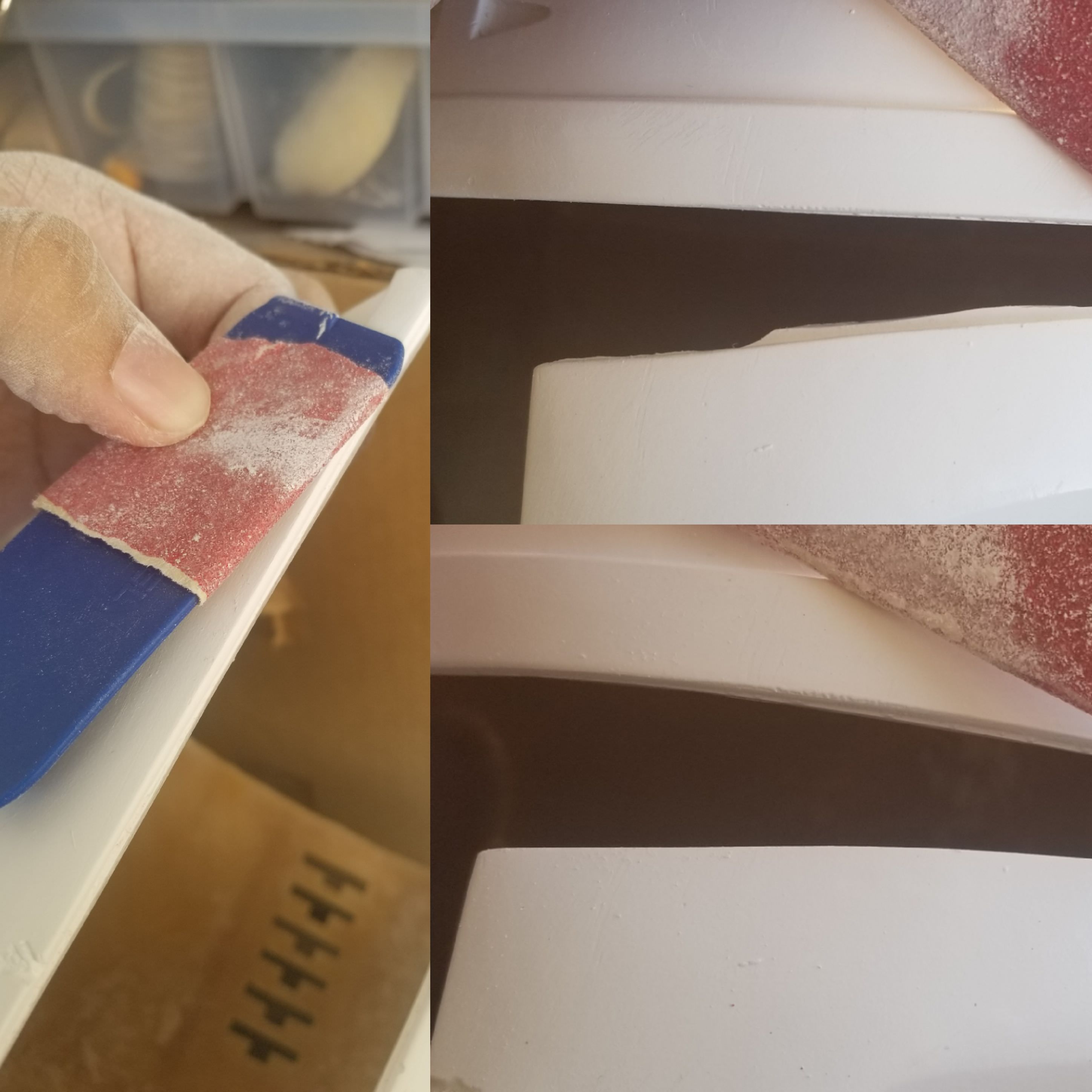

I had originally planned to file out the helmet, but the work was slow going, so I got a piece of 100 grit sand paper and wrapped it around a piece of plastic and made a thin sanding block to work the edges of the helmet and clean it up. It worked way better than I expected. I hear others use painters sticks or scraps of sintra.
For the corners of the visor I took a small file that I used on the key slots and trimmed back the left over cast before using the sand paper stick to smooth it out.
Here it is, edges and key slots cleaned up. Still need to lightly sand the surface and clean up the range finder and ears. The details on Wasted Fett's FPH2 is great. There are scratches in the helmet that I know should be there for the paint, but I'll probably lose some of that detail in the prep. All good. It's nice to know that the quality and workmanship is all there though!

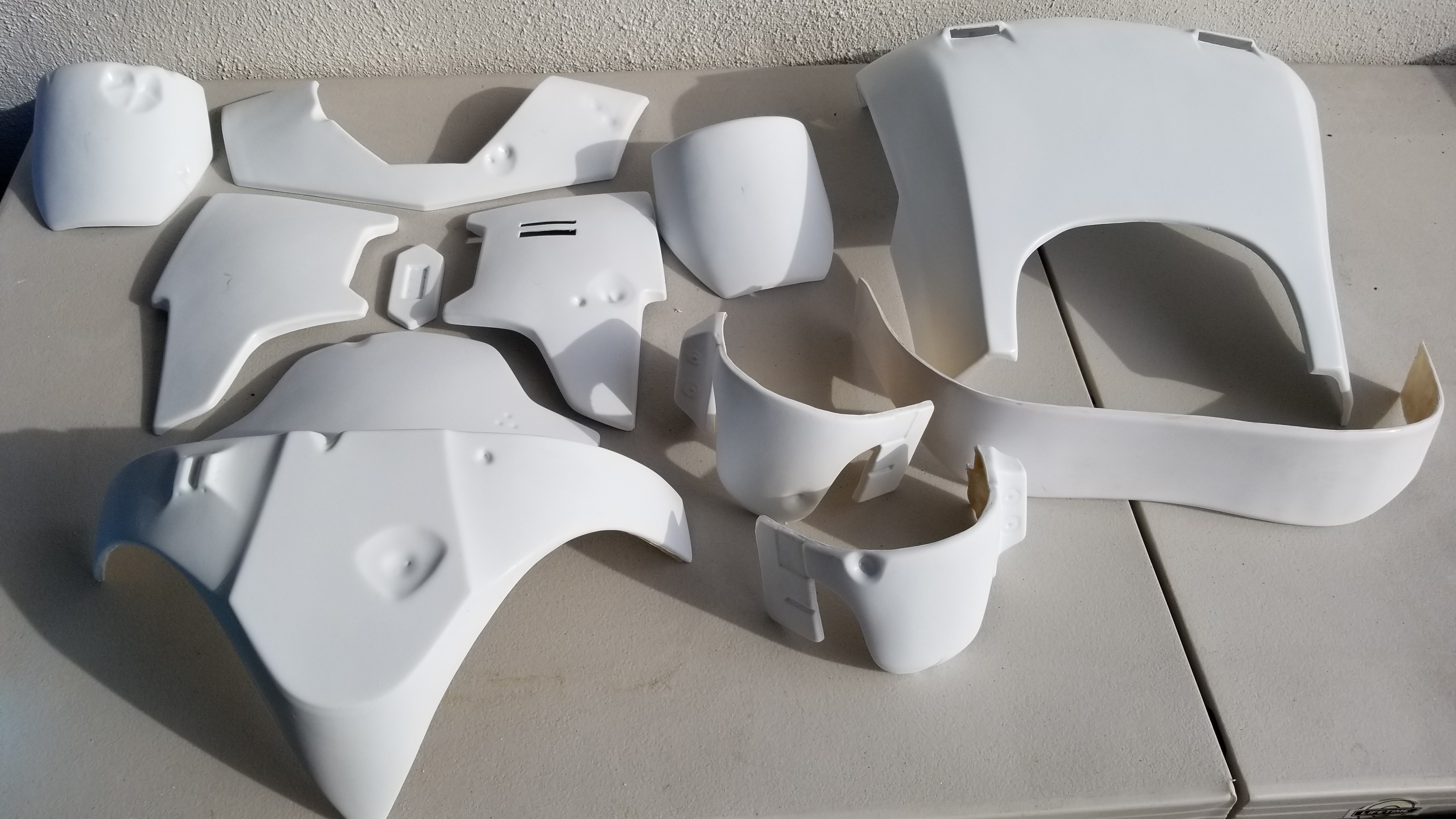

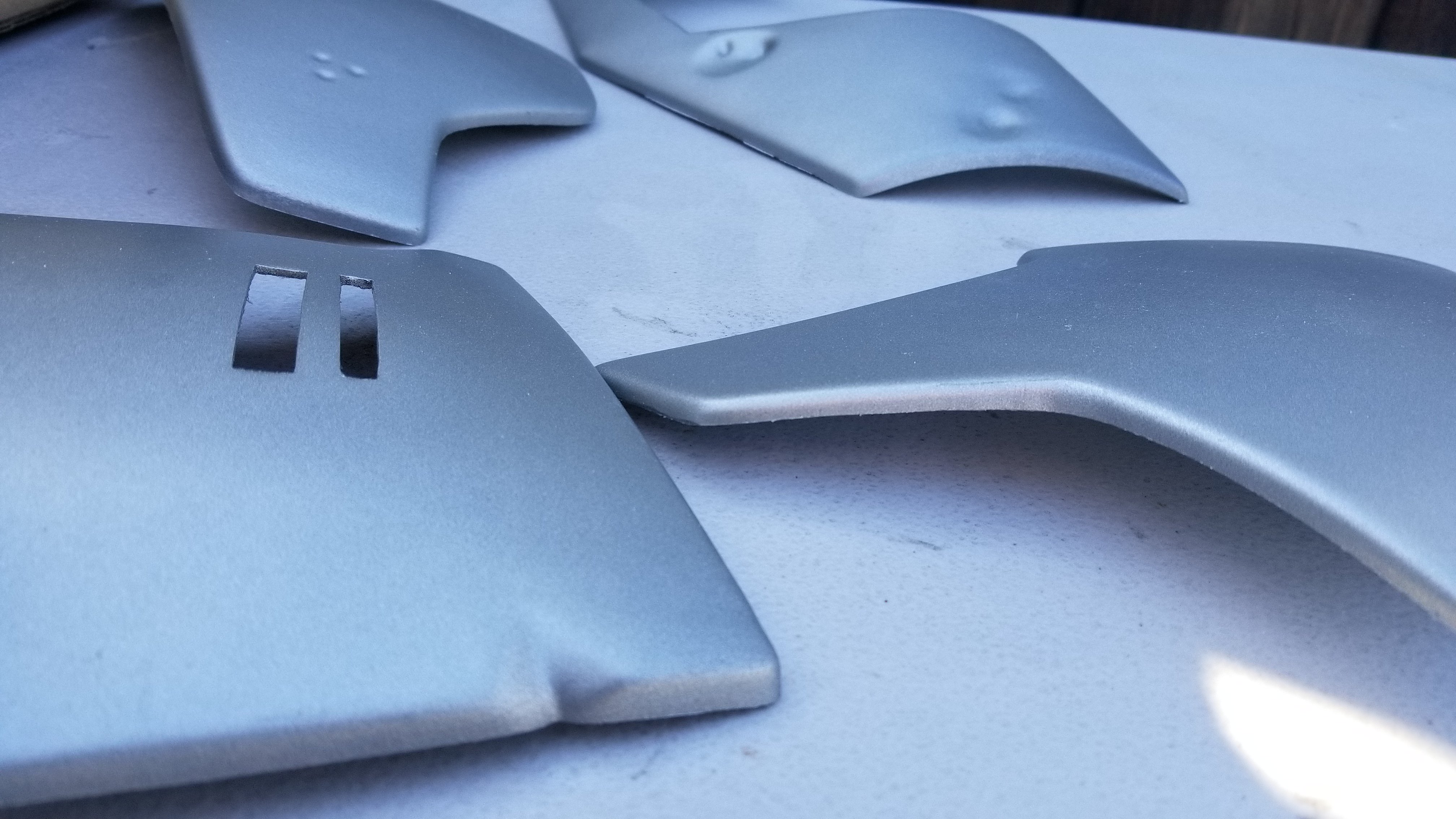

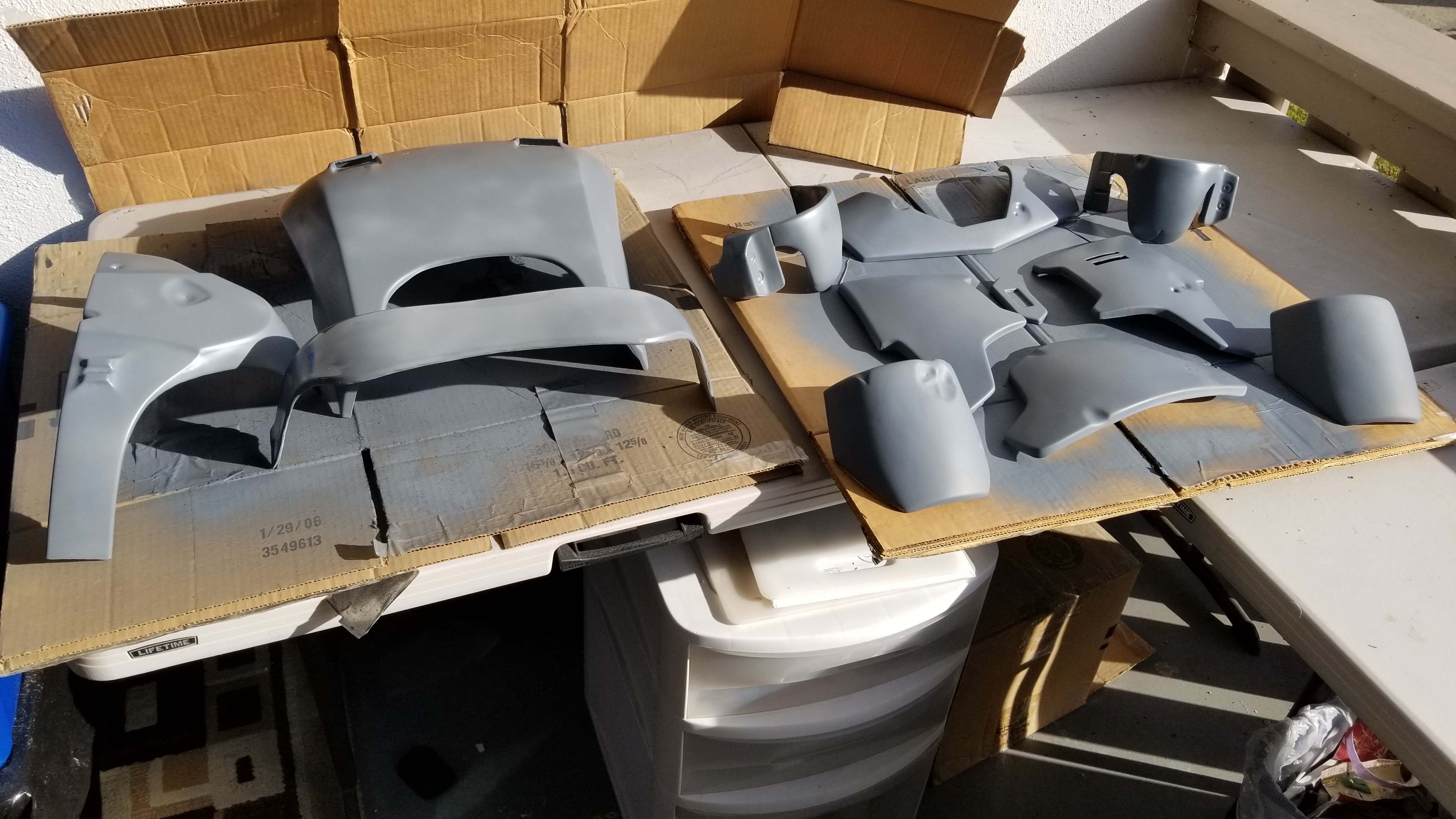

Another slow but steady WIP update. Finally found some time to belt-sand the armor rough cut then smooth out the edges and sand the surfaces for paint! Primer down, silver added. Now to get some masking fluid...
Also filed out the chest LED area. This looks to be about right?

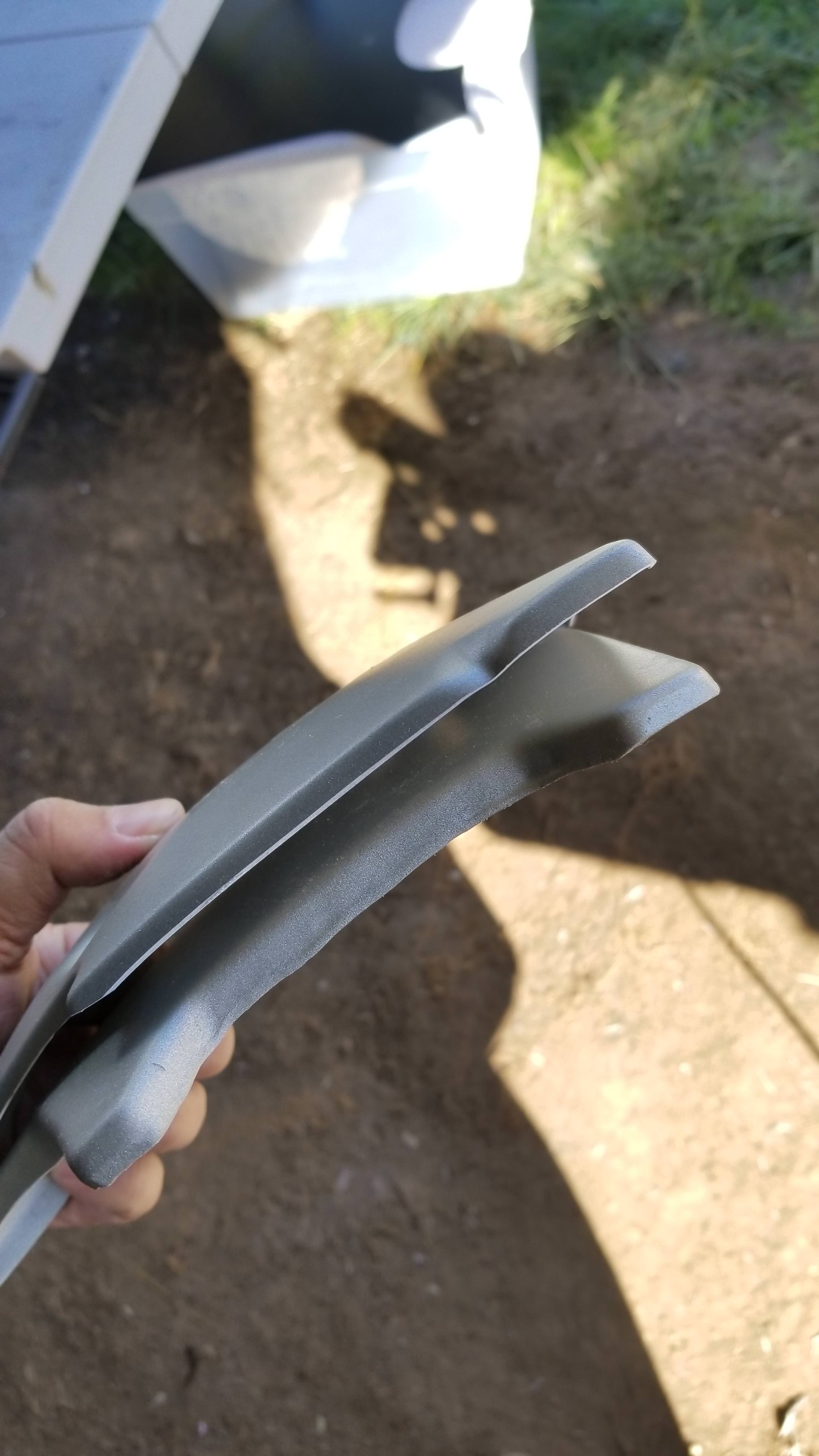

you need to further trim your armor, theres too much return edge
Great! Thanks for the heads up. I felt that the chest pieces were still too thick on the sides. The curve made belt sanding difficult, but I can revisit it with a dremel. Any other thoughts on the return edge before I get to trimming it? I was afraid that I'd make it too thin and trimmed to the curved edges of the mold. Trimming down the back shouldn't be a problem. What thickness am I looking for? I read it was 3mm, but am hesitant to trim that thin.
edit: Did some digging around the forum and seems 3mm is the way to go. Best to handle this now!
Are you speaking specifically of the the chest/belly armor? Or are there other issues you see? Thanks again.
the chest and ab plate are what I see as being too thick possibly the collar....take a look in the gallery to see how much return there should be gauge as best you can

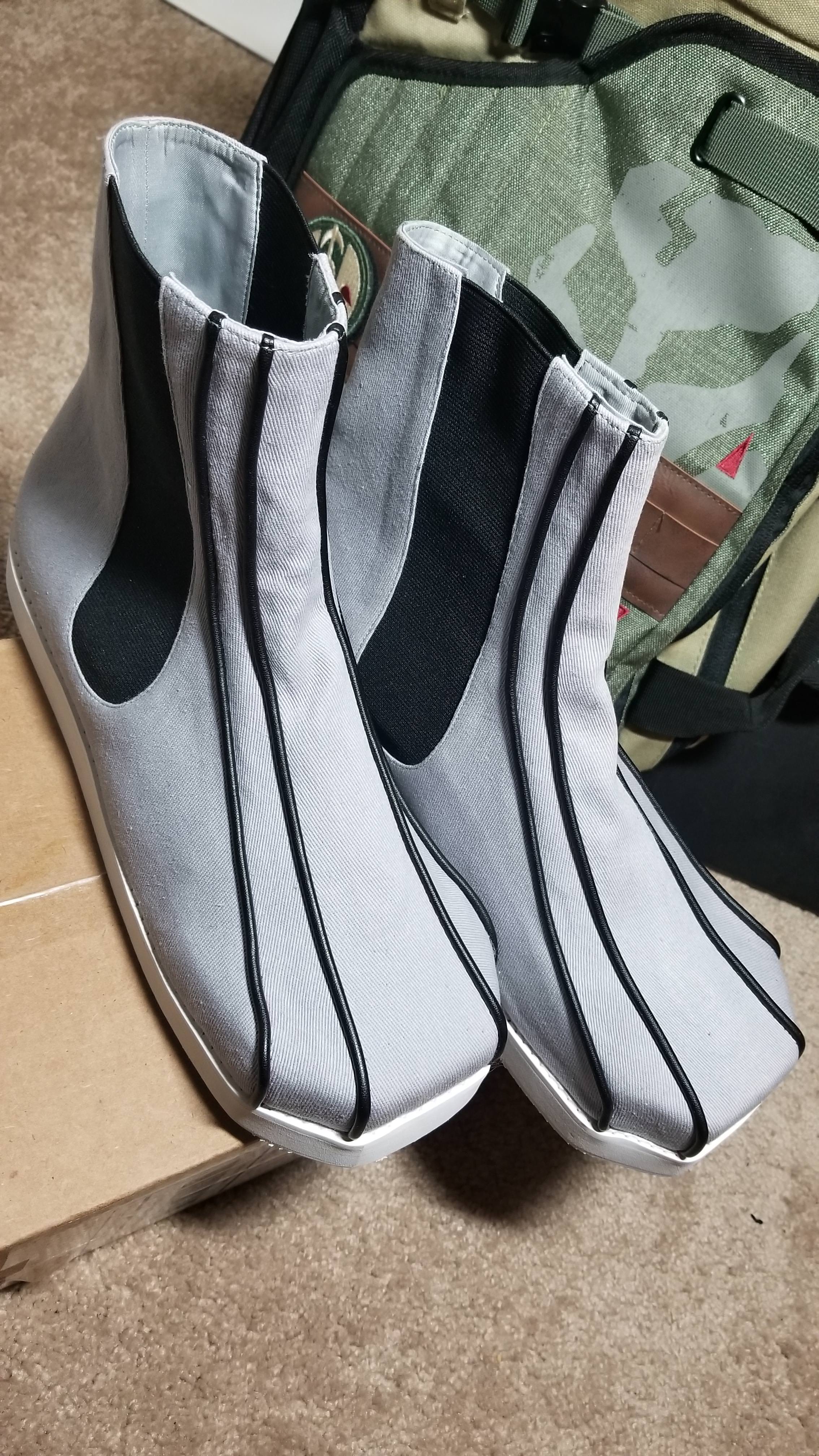

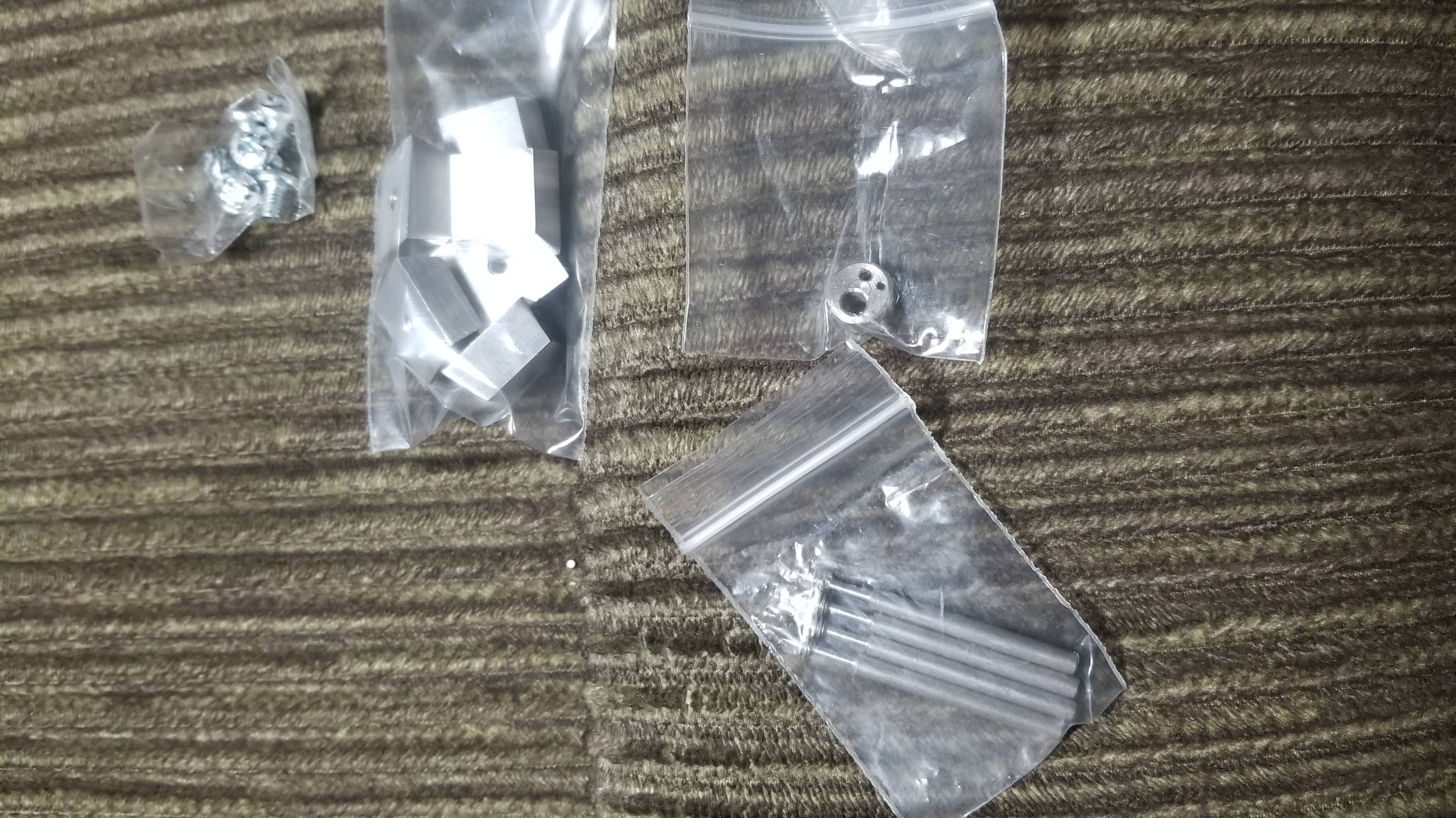

During the holidays, a few items arrived! Boots via Man of War and cod / collar studs, gauntlet darts, and borden from Machine Craft Replicas.

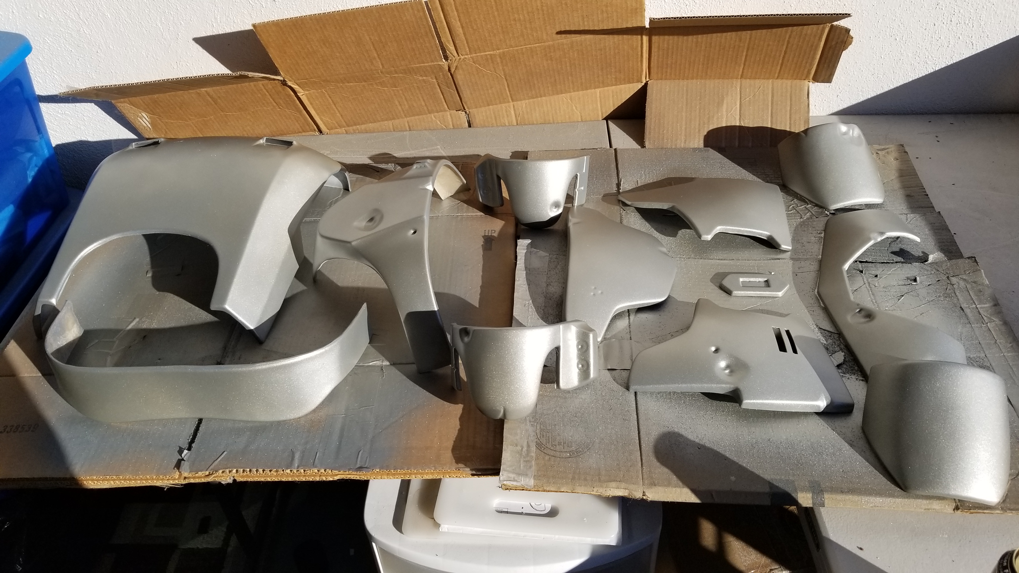

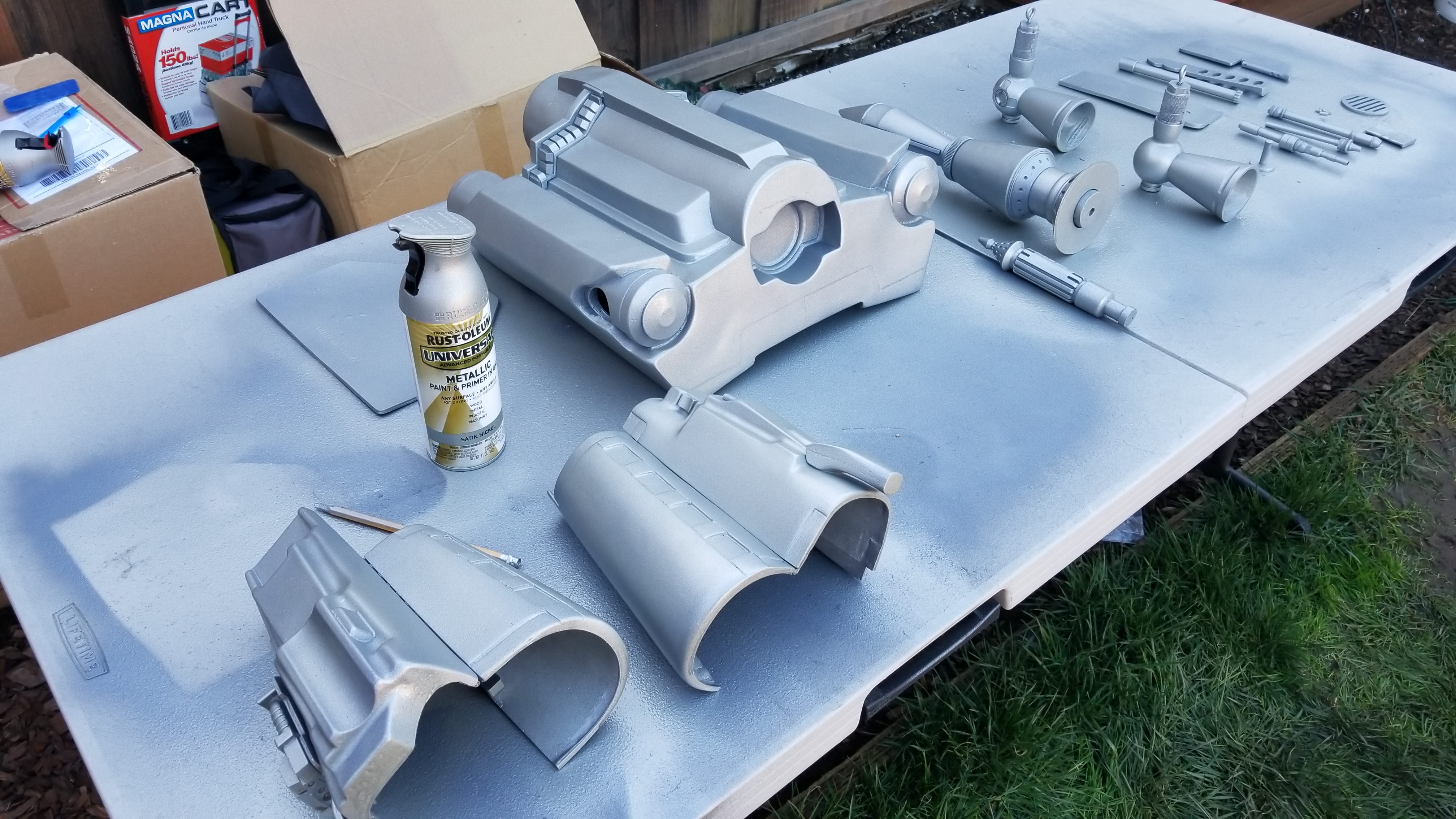

At the first anticipated Armory Party of the year, it afforded me some time on the belt sander and some open air to lay down the primer and silver base coats on my gauntlets and jetpack.
In a previous post, it was noted that the return edge of the chest armor was too thick, and bringing that to my attention is greatly appreciated. Here's a before and after of the thick edge compared to the trimmed armor. I was hesitant to trim it this low, but in the end it looks much better.

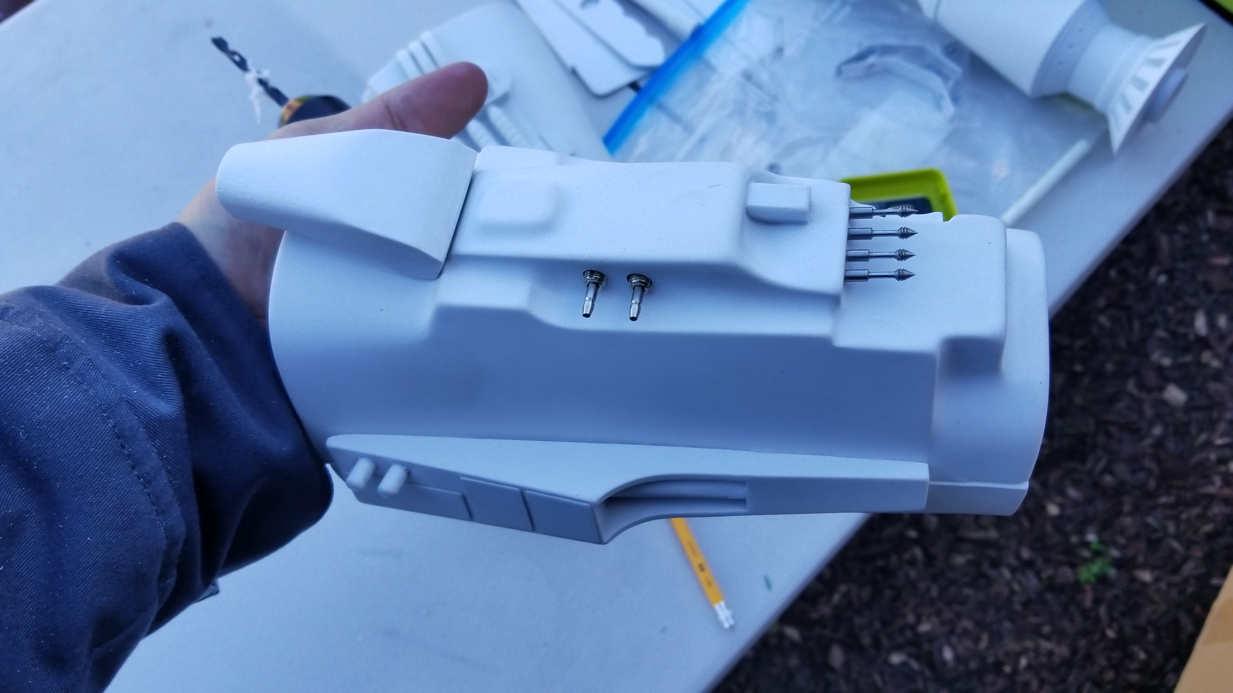

Also found the time to dry fit the Alco push button switches and gauntlet darts. Stoked to finally have these fitted.
Spent the whole day watching paint dry. Put on the flat gray primer and followed with Satin Nickel for the base layers.
Now that these items are primed, I'll start on the masking fluid as I can. I'll be doing a layered paint job with some thick top coats to really give the armor and gauntlets a realistic chipped look. Really looking forward to the next time I can put down some paint. I have the Spruce Green (?) for the gauntlets and jetpack and hunter green for the armor. Great to finally get some extra time on the kit!
