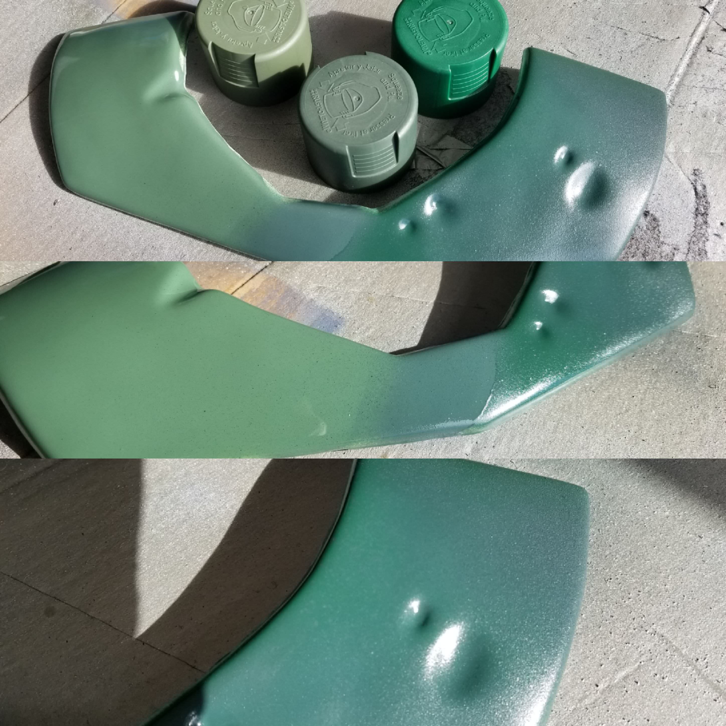

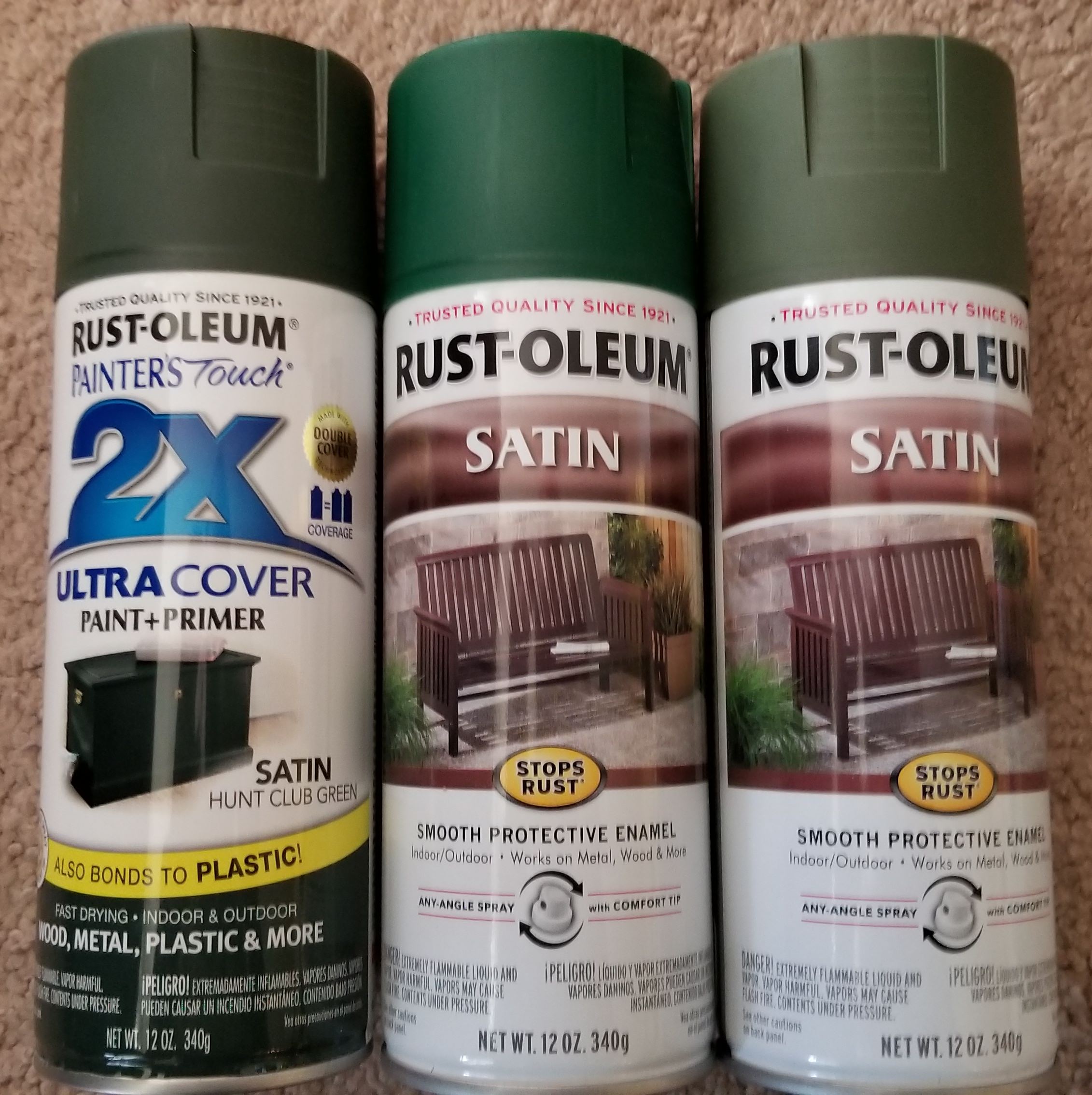

Regarding some paints, I have the following, but am open to other options, as there are lots of different approaches to painting. If I have to change the colors or method, I'm only out a couple bucks.
From left to right is Hunt Club green, Hunter green, and Spruce green.
I had planned to use Spruce green on the jetpack and gauntlets.
Hunter green as a base on the chest, back, and cod then Hunt Club green to add shade variation on the plates. (hand painting other colors)
That's probably the simplest and least creative method without investing into airbrush and paints. Looking into painting techniques on other peoples kits, airbrushing and mixing colors seems to be the most professional approach. It would be my second time lifting an airbrush, so to take that route will require some additional resources.
I have some spare material, I suppose I could crash course my plan and see how it looks. I'd hate to put down the green and dread the decision. Any thoughts on painting approaches? Thoughts on these rattle can colors? Ditch it all and go airbrush? I hear there is a TDH color map and key for shades.
Here's a quick rattle can test:
Spruce green on the left - used for gauntlets and jetpack base
Hunt Club green in the center - color comparison
Hunter green base with Hunt Club green misted on top to give color variation on right side.
In daylight the colors are easily seen. Under my usual painting lights it's difficult to see the changes.

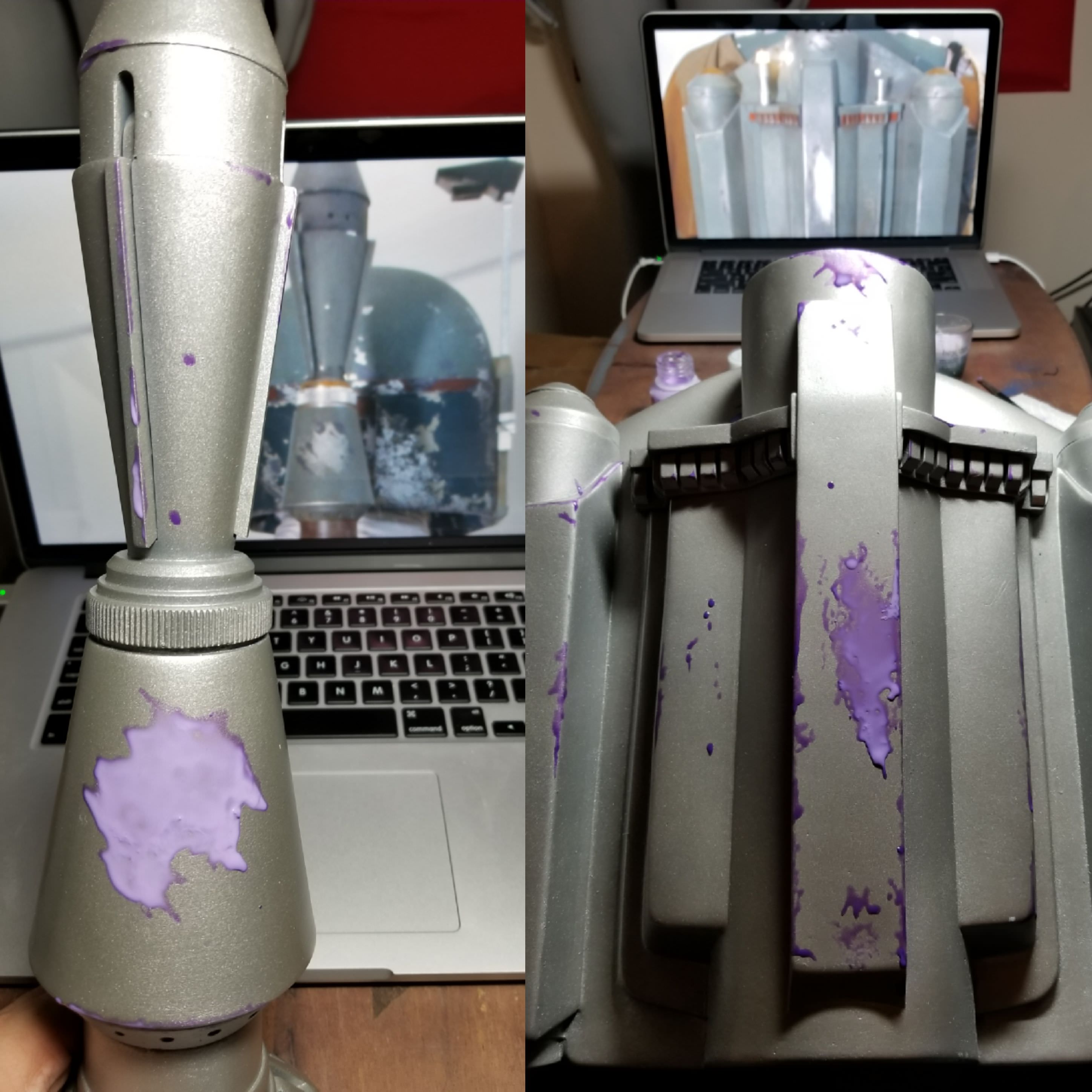

Updates! The Spruce green colored items are masked with Hubrol fluid. I really like that stuff. Easy to apply, but say good bye to your brush if you don't have a solvent for the masking fluid.

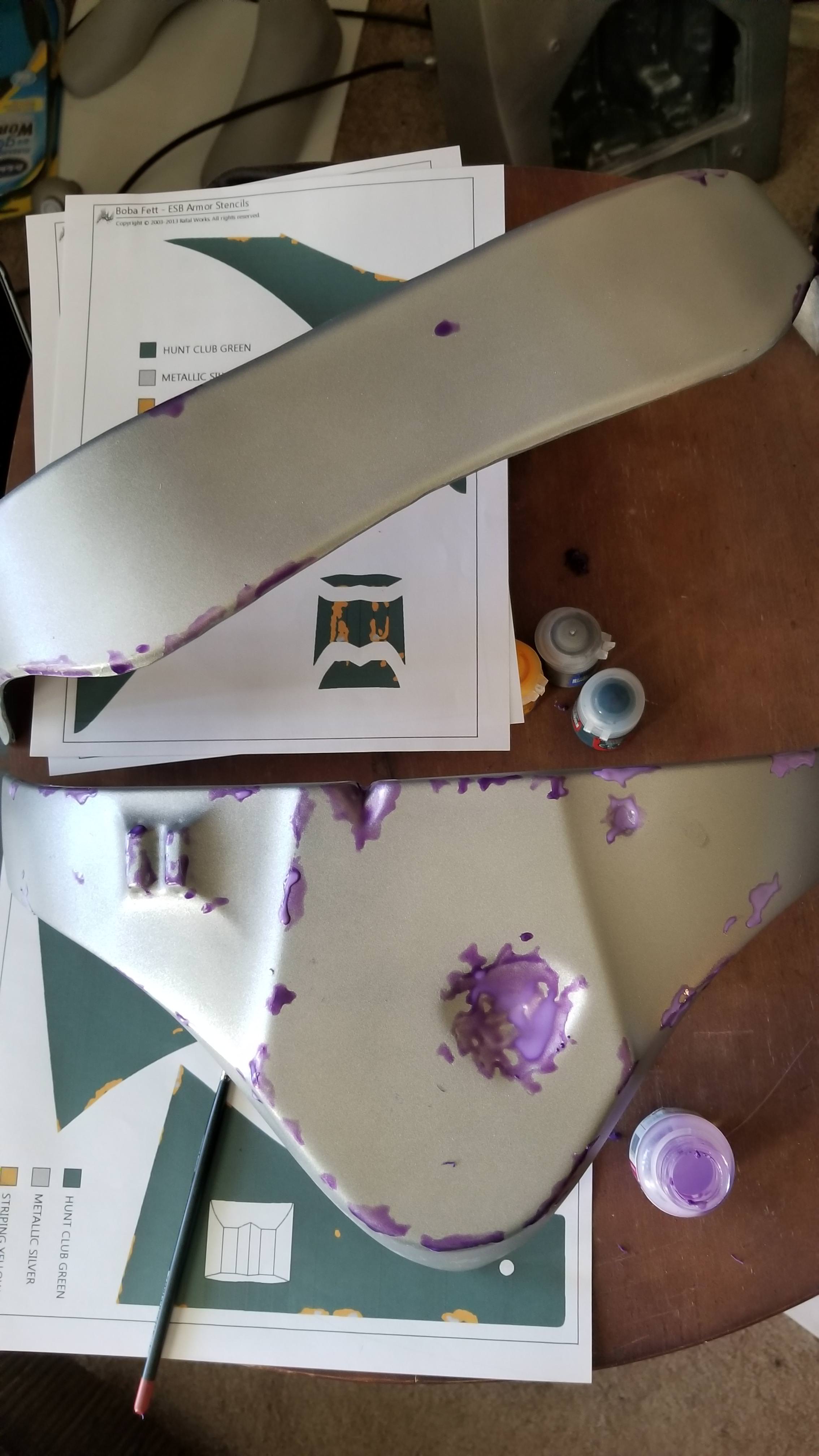

Here we go! First layers of masking fluid is down. I may consider changing the jet pack paint from a layer to topical because it appears that the silver is revealed from rubbing away the top coat versus a paint chip from a blaster bolt as seen in the helmet and armor.
Updates!

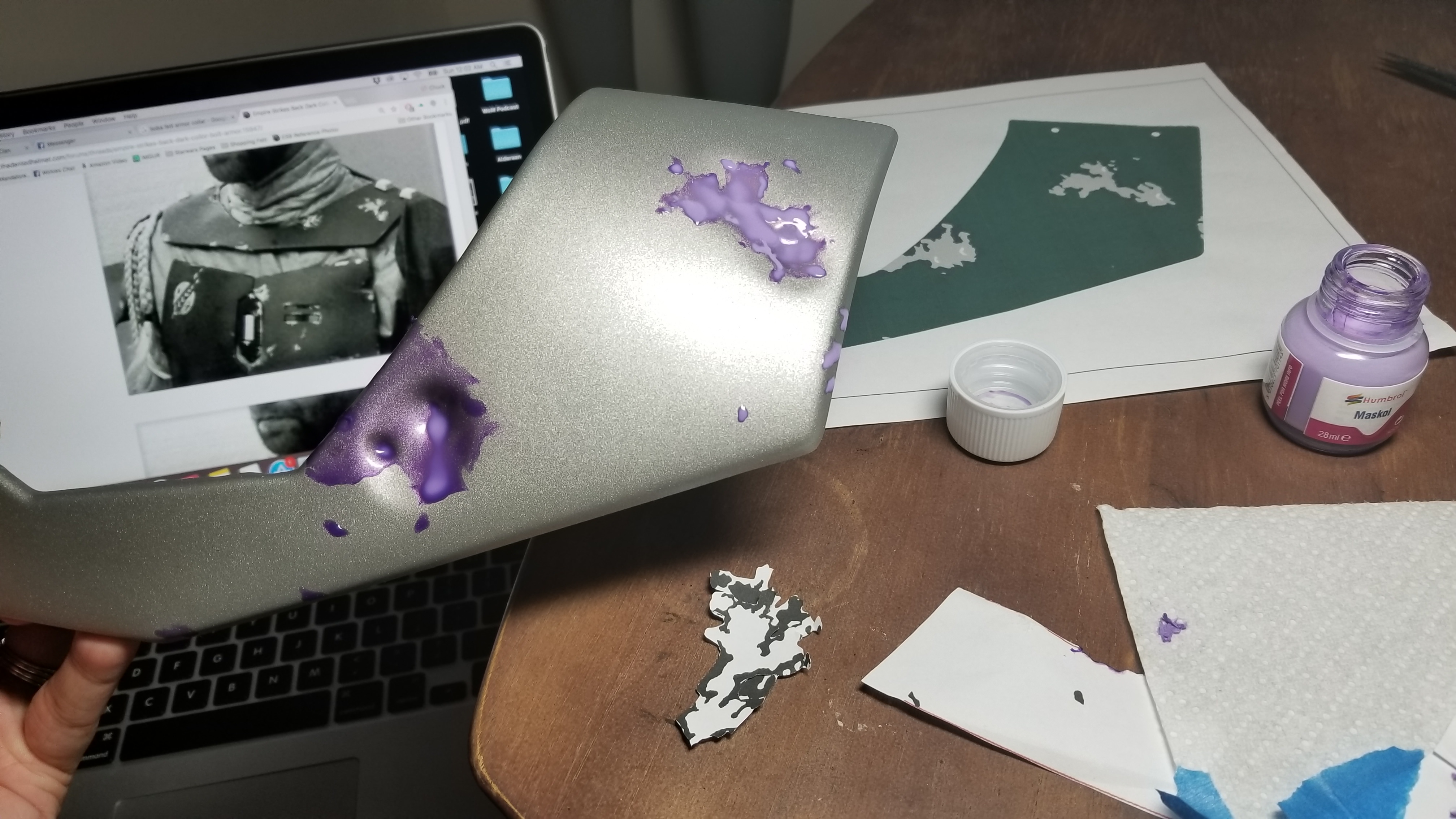

Masked the armor parts using stencils provided from RafalFett. The Hero armor from Wasted Fett and the stencils are not sized to match. I suppose a I could have magnified the image before print with some testing, but meh. I ended up using the stencils as a guide line and free handed the markings, which will take from the accuracy, but will suit my needs. Also to note is masking and layering vs topical painting for weathering effects. For some parts I ended up opening the file on my laptop and sized the image to fit the size of the armor plate and matched the markings. Have a look and be the judge.
I could not, for the life of me, locate a single Humbrol vendor, and I went to 5 separate paint vendors in my area...Decided to stick with rattle can colors: Hunt club and spruce green. Will have to sort out some airbrush colors to dial in weathering.

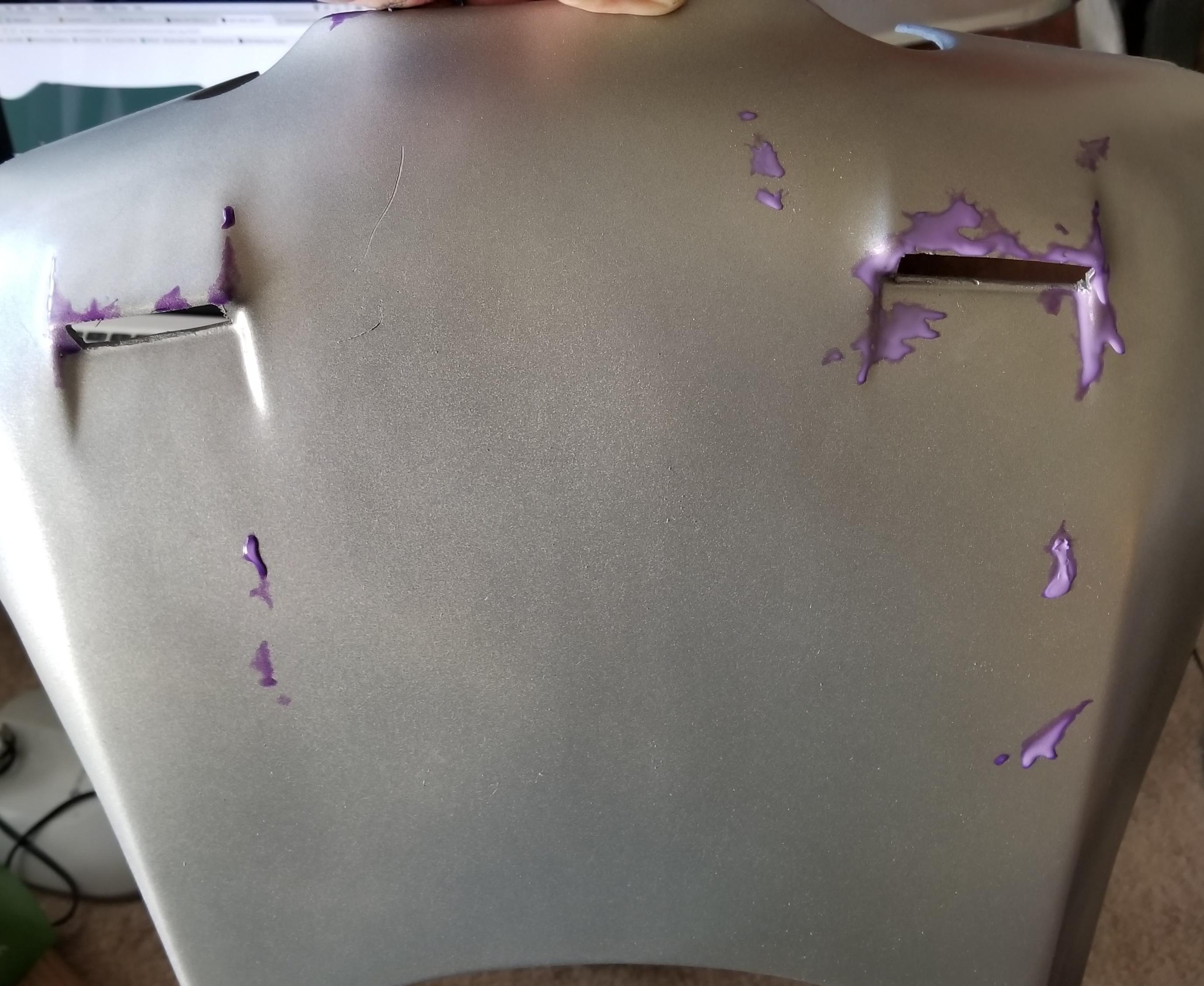

The collar was the first attempt. I've masked the silver and gray portion as a single part and will hand paint in the gray as a middle layer between silver and green. This is when I discovered the stencils were proportionally incorrect and began to free hand instead.
Left chest plate masks yellow and silver and will hand paint yellow as the middle layer.
The right plate has very little silver weathering, but a large patch of dark gray (base metal), and a darker green/gray (lark gray). With the recommended colors, I didn't feel like it was a match and decided to mask the silver and dark gray area on the left. I will be painting over the silver area in gray to still give the chipped look and will topically apply the lark gray areas as a stain to the paint rather than a chipped layer. (added the masking in a later photo)
The back plate was pretty straight forward and just used the online image to guide the mask.
Same with cod and kidney.

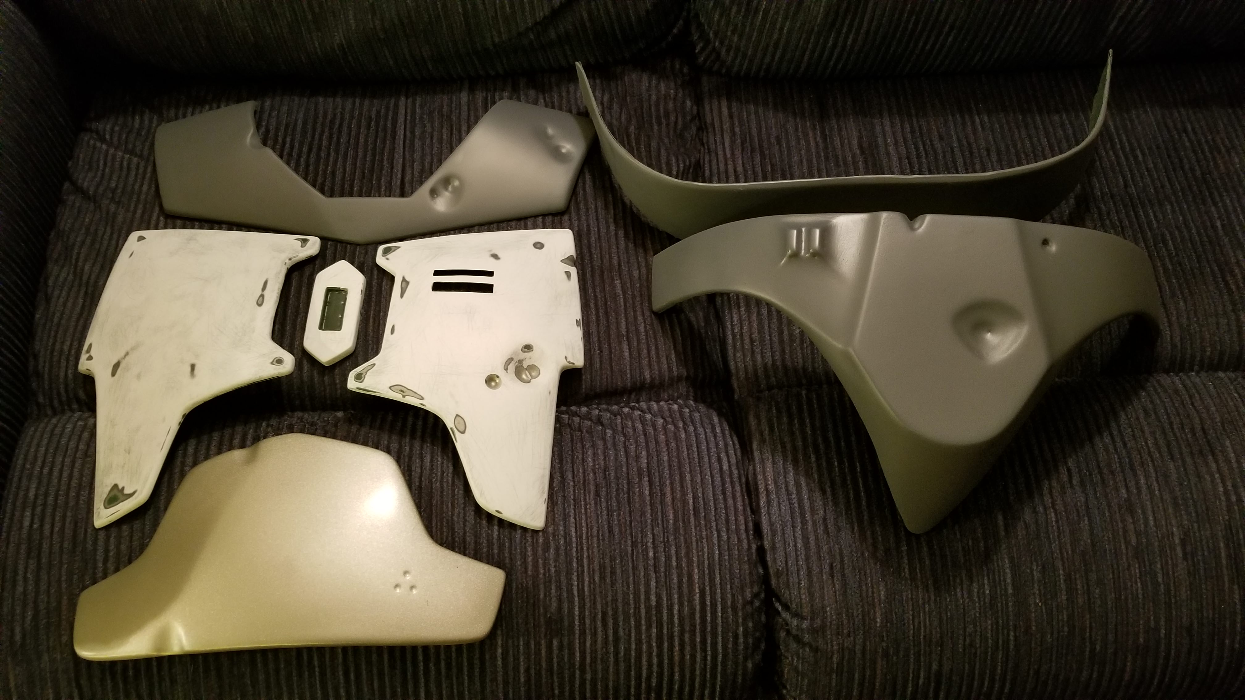

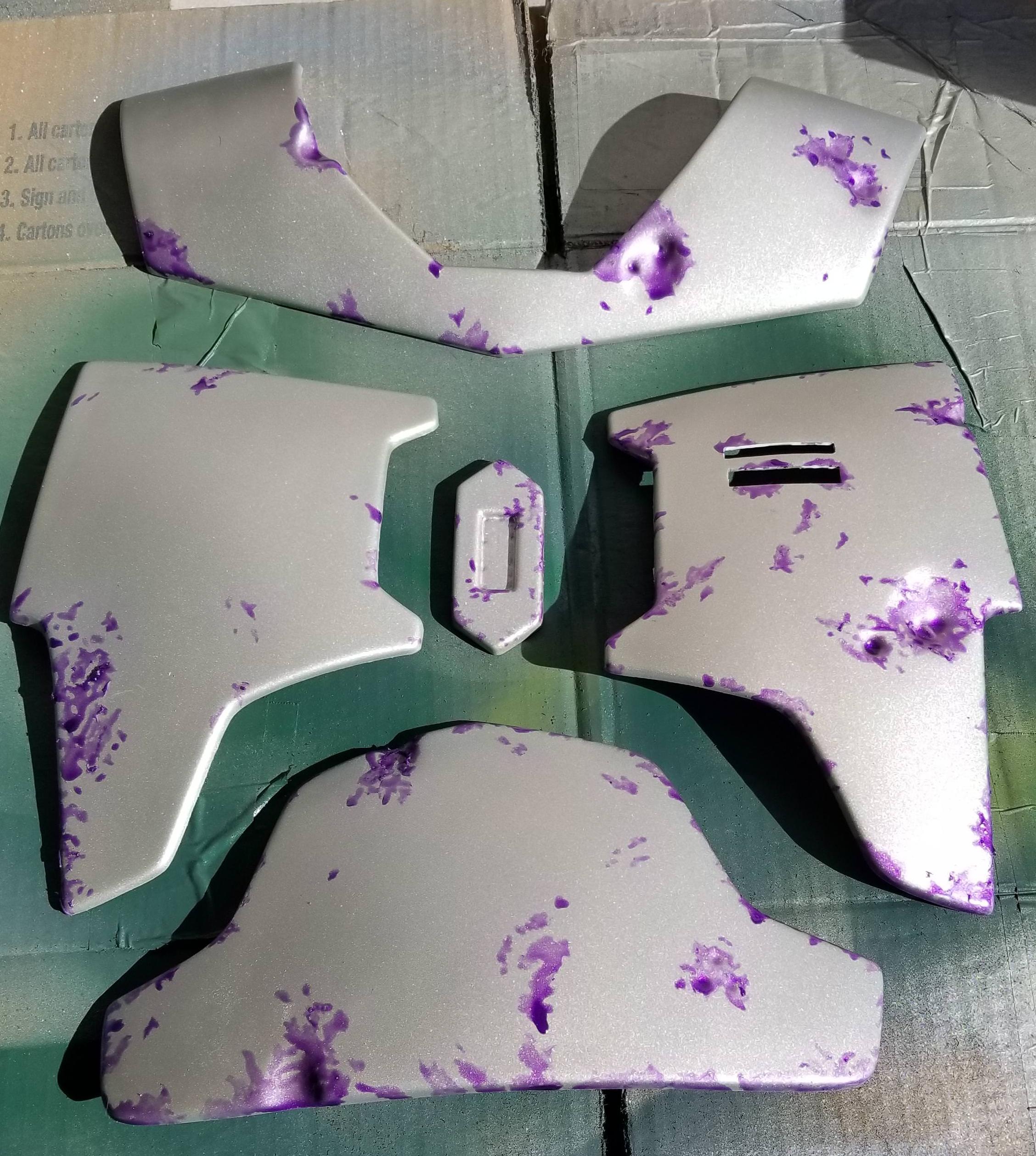

Here's what I came up with before laying down the Hunt Club green layer.
Now I wait for the paint to completely dry and cure before I start peeling away the maskol and applying yellow and gray. Achieving the carbon scoring and weathering appears that I will need to airbrush on the damage to get the best effect, perhaps touch up the green to give it that brighter color I see from the Bespin hallway.

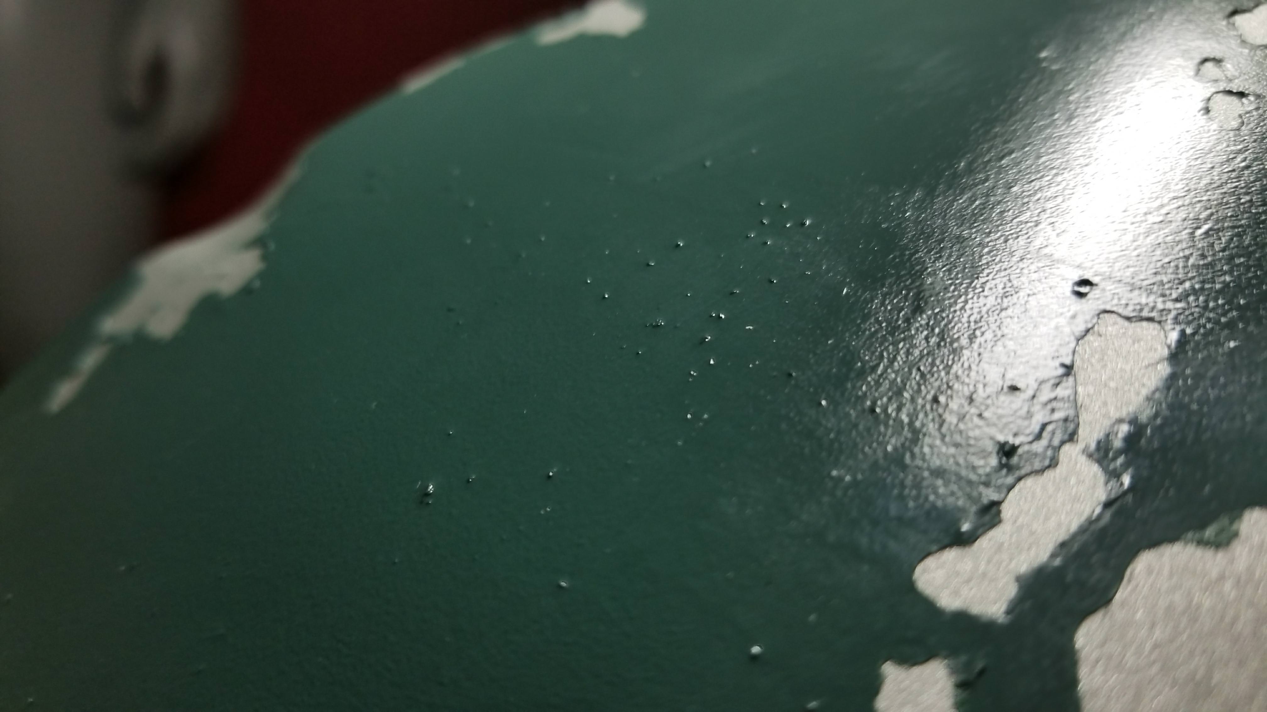

Just got a lesson in patience when I decided to paint on an overcast, relatively cold morning instead of waiting for the sun to be out... the rattle can decided to gunk up and spit debris into my top coat on the ab plate and pool with lack of heat to cool it fast enough...
The Horror: good job, noob.
Fortunately only the ab plate took the hit, but I'll have to strip it down and lay down new coats, which will likely set me back a week just on this one item. A lesson in patience indeed.

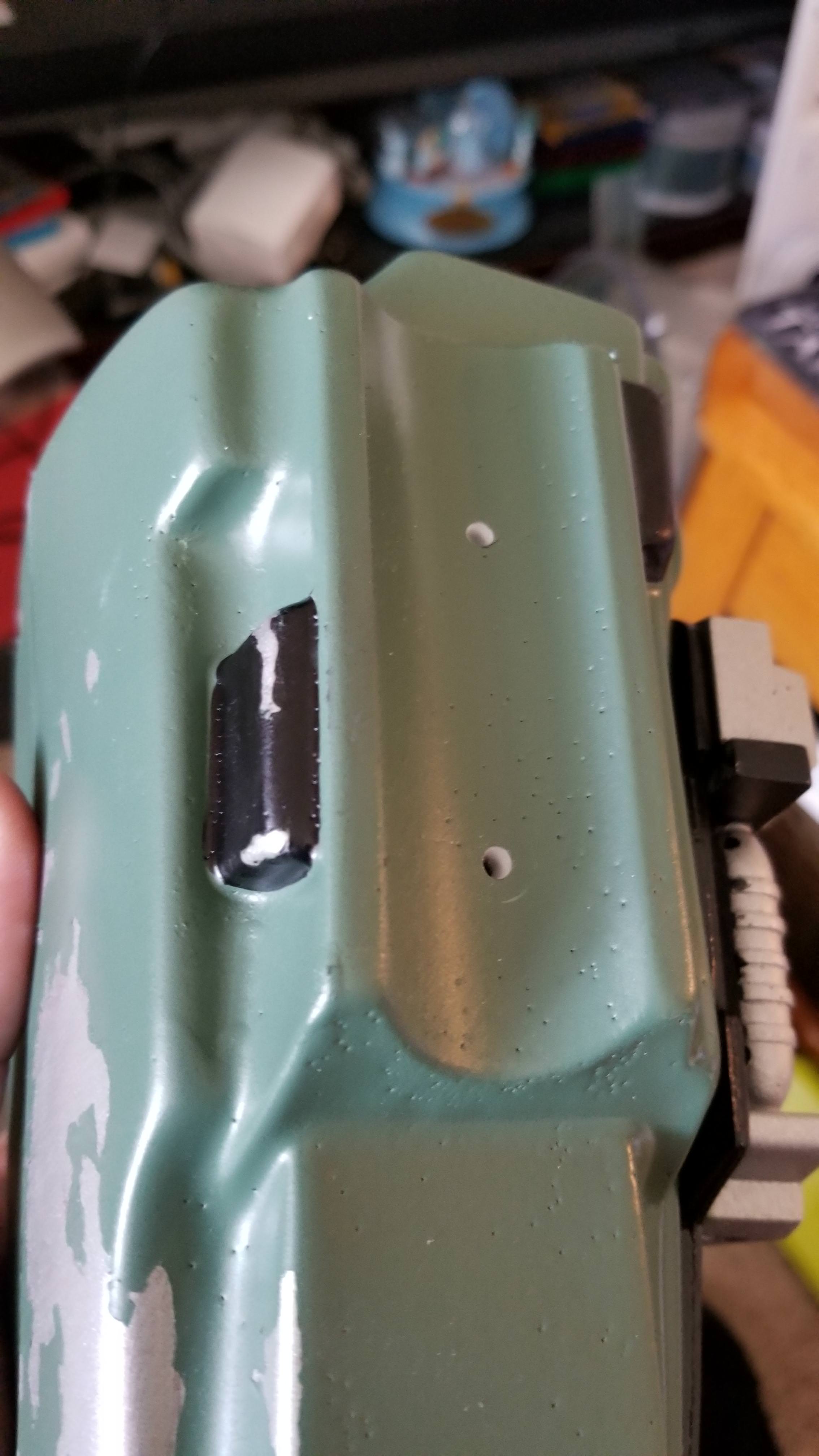

I decided to take the opportunity to test the maskol and started to strip it away. Here's a side by side of the result. Granted, I didn't wait for the paint to completely cure, but I'm scrapping the paint job anyway.
Not too bad. Definitely want to have thicker coats of the maskol for a better result, but even the pieces came off with little difficulty. Just rub a ringer across the top of the layer and it rolls right off. Obviously the longer you wait for the paint to cure, the less will pull up on the edges of the maskol; semi wet paint will pull on the edges and peel up more than intended - you can see the differences in some parts. That said, the result is good and detail stayed.

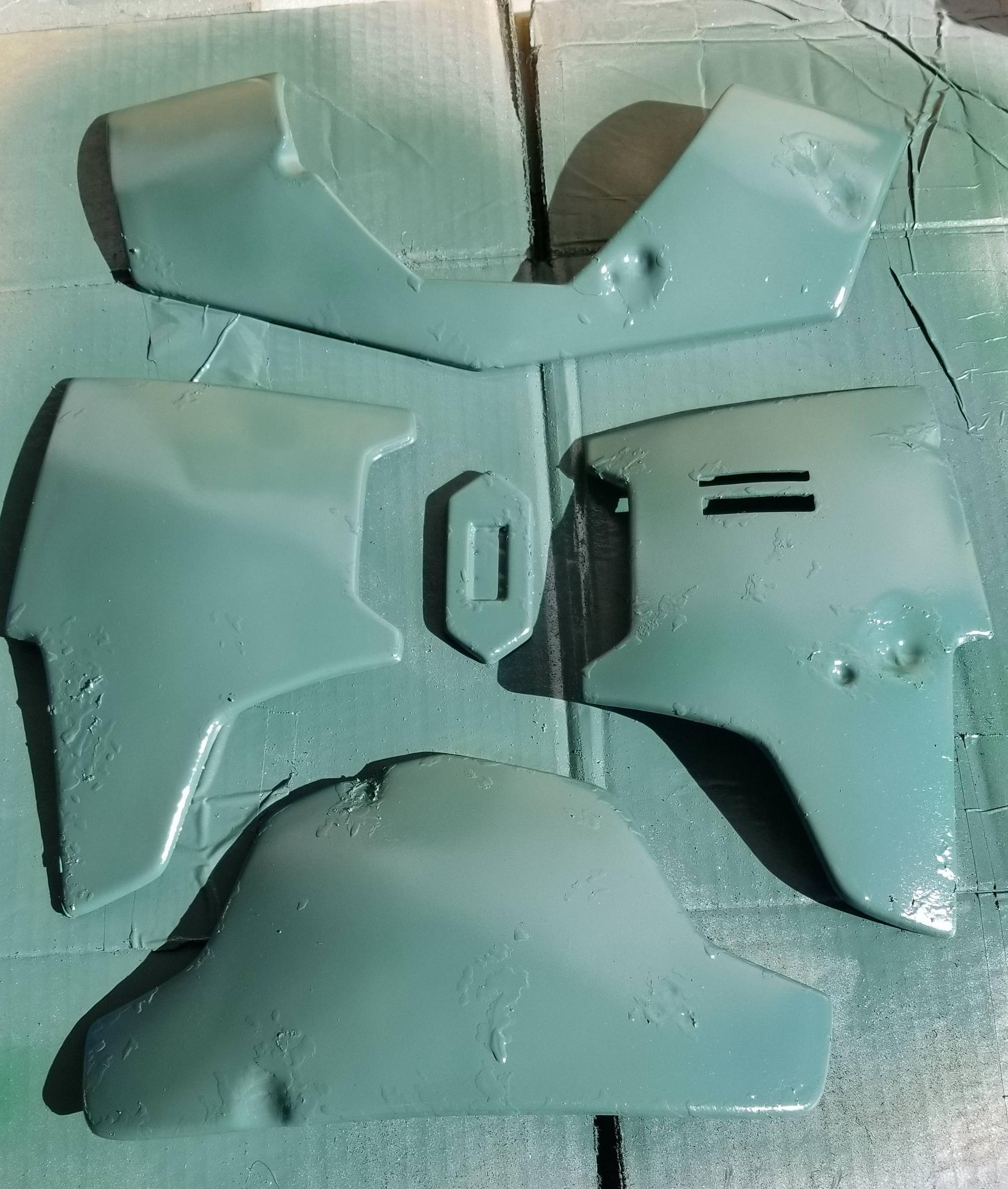

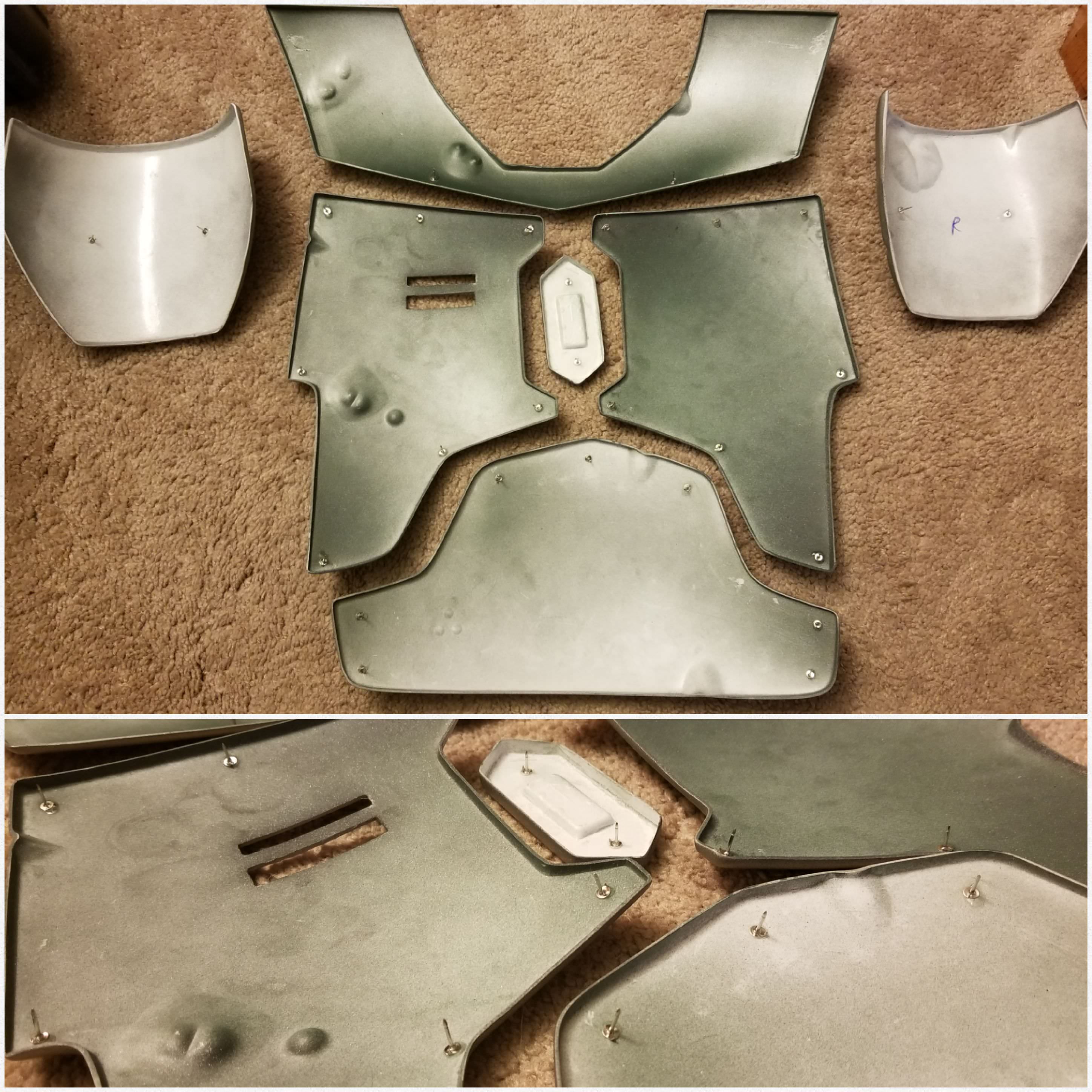

After screwing up my rattle can paint job, I decided I didn't like the color after all and achieving the weathering would have to be airbrushed anyway. Add to that the Flight Suit, boots, and cape can all be airbrushed for weathering, so I broke down and invested in a relatively inexpensive airbrush with a few needles, compressor, and ordered the appropriate paints from Humbrol online.

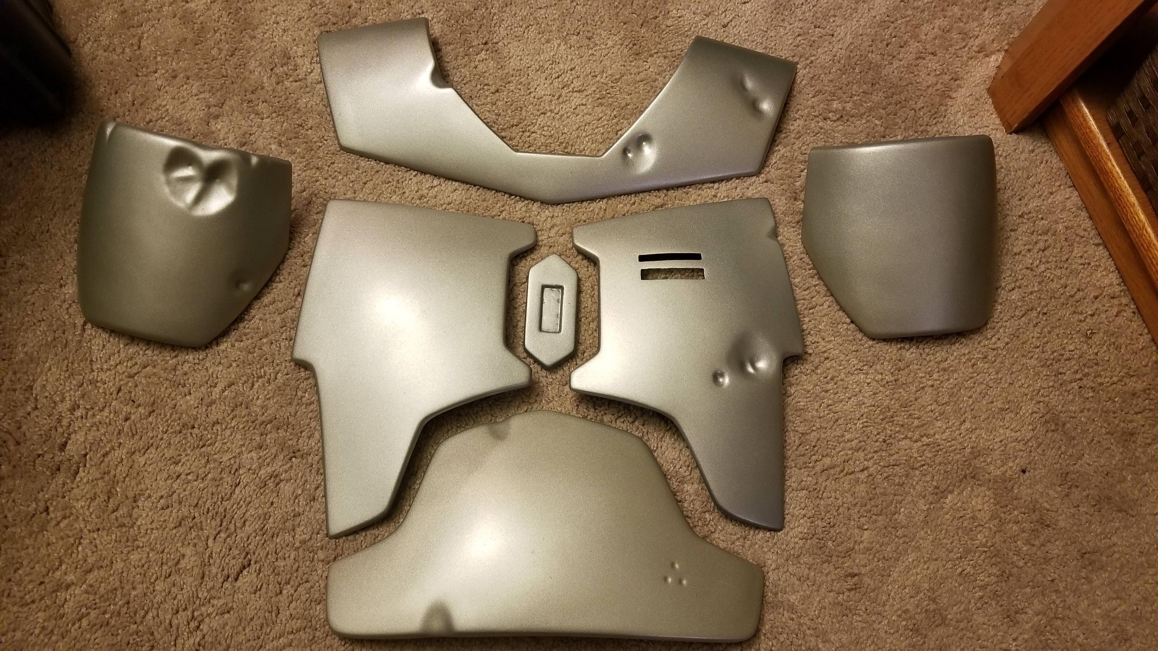

I've finally finished stripping and sanding the original rattle can color and have started to prime the pieces back to masking prep. Fortunately the shoulder and knees are still primed. Here's the current state as of last night:
Never doing that again, and let me just recommend to other first time Fett painters: Just do it right, get the right colors, and invest in the airbrush... I've already dumped a bunch of money into the suit, what's another couple hundred bucks for a sweet tool that will be used on just about EVERYTHING. At least three other folks told me the same piece of advice and now I'm kicking myself for trying to cut a corner.

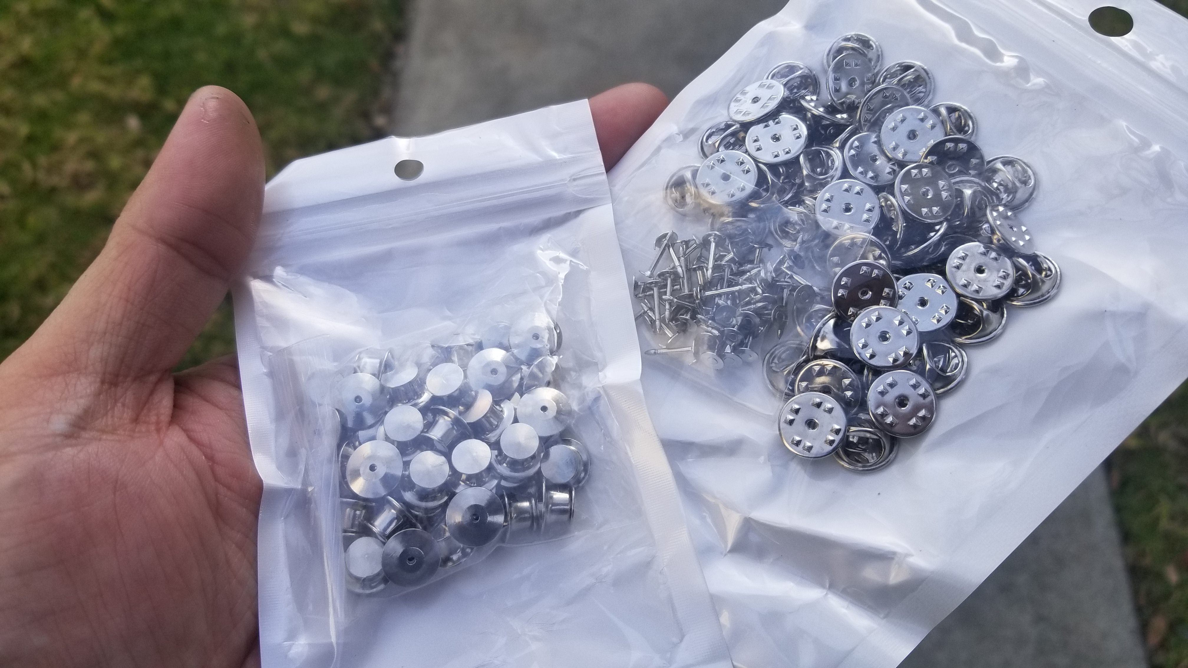

Locking back pins for armor attachment. Fettastic's post on attachment method seemed simpler, cost effective, and user friendly, so I jumped on it too. Should be an easy replacement if it doesn't work out, but appears this will be a great method.

Once the weather warms up, the last primer/base coats will be going down, masking again, and then I can take the airbrush for a spin. Progress is ramping up! Finish line is still a ways off, but it's coming down to the last laps.

I decided to scrap my paint job with the rattle can, got everything back to masking prep:
Attached jeweler pins with locking backs for attachment method, using Fettastic's method. Haven't attached them to the vest yet, but used super glue and covered the bases with epoxy putty. Feels solid, looking forward to testing them on the vest.

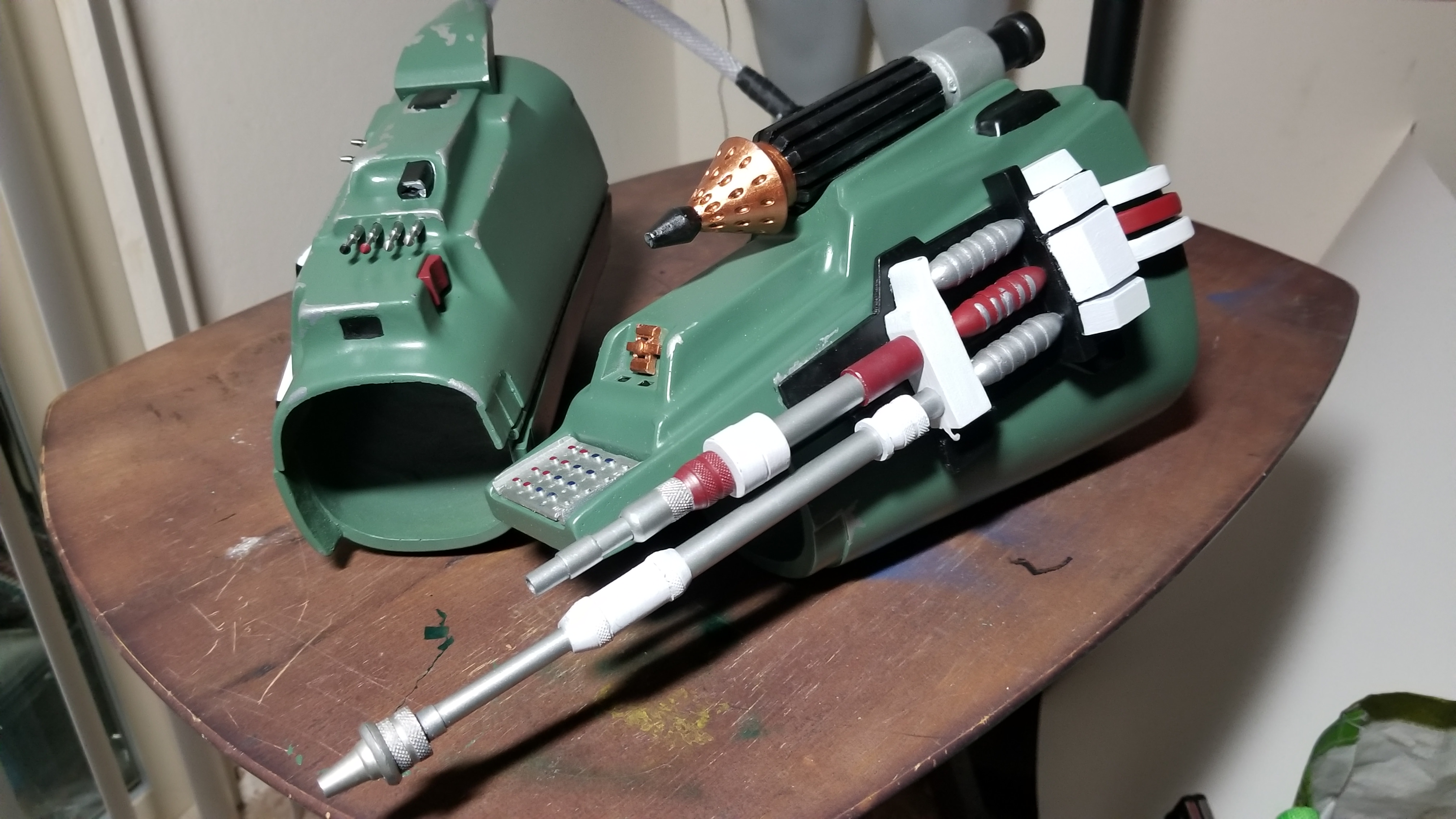

Got the Spruce Green base coat down on the Gauntlets and Jetpack:
Drilled in screws for the rocket mount.
Then went nuts working on the Gauntlets into the wee hours of the morning. Calling it good for now, will likely revisit touchups before completion.

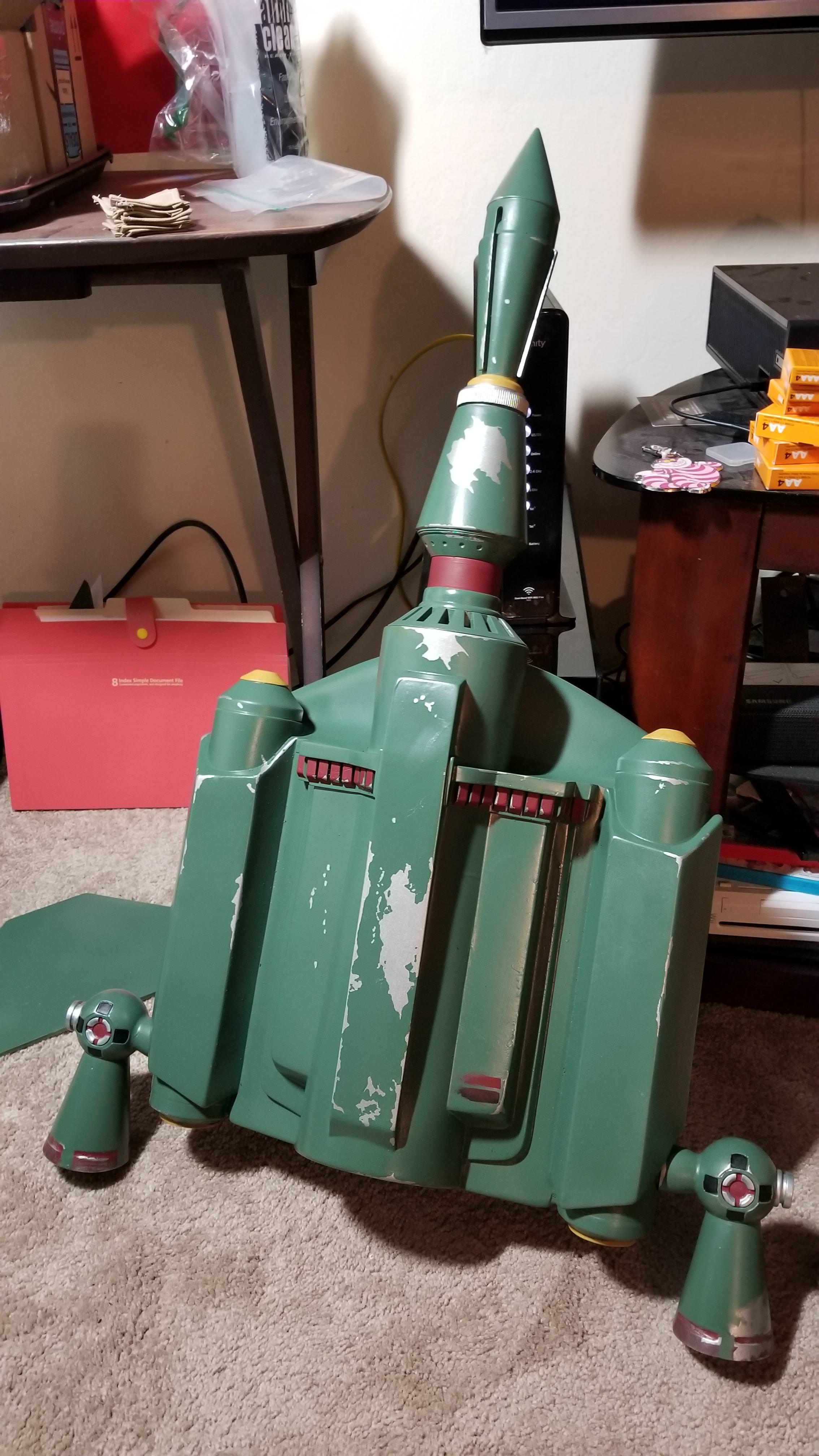

Also put some time into the jetpack:
Waiting on the beacon to ship and want to get some color variation with an airbrush soon.
