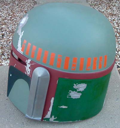

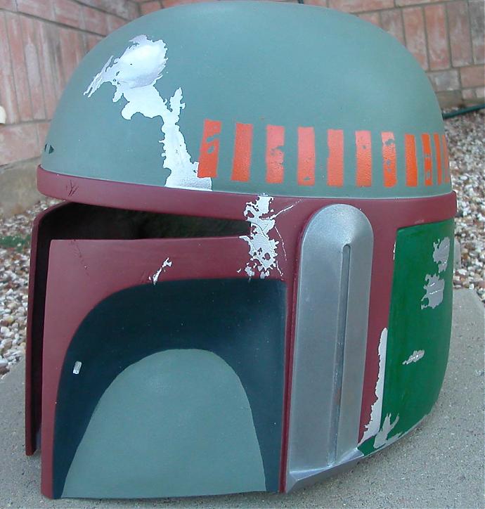

Here some more picture goodness.
Thanks Spidy for posting that pic!!! :)
And thakyou MJA for the complements. Its definitly hard to wait for something you want so bad but good things always come to those who wait!!!

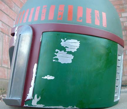

Here are some pics showing better the silver wethering that is now on the bucket... obvisouly its only a start but it shows well the reverse masking that I am using. All of the silver is handbrushed on this sukcer!!!
Enjoy... more to come!

This reverse masking method, by this do you mean a topical application of the silver ?
Looks fantastic BTY - looks like another thread subscription for me here !!!!:)
PGH, thats correct. It is indeed all topica. I simply drew my damage areas, masked the areas around them... painted my silver on and removed my masking fluid. This eliminates the tape pull up problem that so many have on there buckets. :)
Evan,
This rocks, your effort on this is nothing less than incredible.
I only asked because the silver looks so "smooth", like it was sprayed on.
What brand is it, goes on really nice.......
the trick isnt the brand, its the amount of paint on your brush. You want very little slver on the brush to achive this... your just basicly creating a coating that your smoothing over the area. As it starts to dry, I like to hold it to the light and see if I missed any brush strokes, and just brish over it again in a different directon softly if there is.
I am currently using allmost all Humbrol enamles on this. My silver is 27002 Metal Cote. Super strong when it drys, not like some that seem soft. But you want to do thin coats and let them dry inbetween, Otherwise the paint cannot cure correctly.

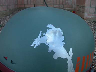

I know some miss this detail and Ripcode was asking me about it so I will show some pics highlighting the dark gunmetal like color found on the dent.
To achive this effect I am laying down the silver first then remasking the area after all the silver is down and adding this gunmettal color by missting it over. I will show some examples of this in the coming days.
