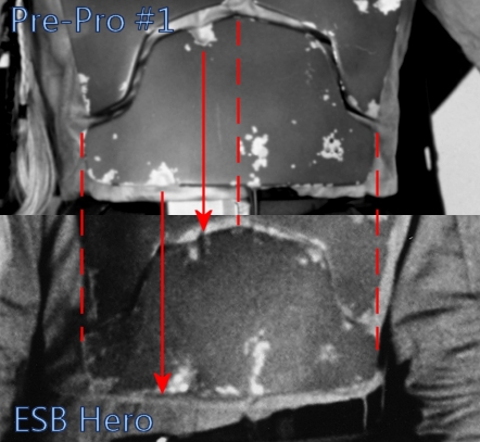

Also, a confirmation from RafalFett -- Do I see it correctly that I should go with the ESB version when doing Pre-Pro 1 armor?
--Jonah
Most of the ESB armor parts will do for a Pre-Pro #1, but you'll need an abdominal plate that has the upper and the lower dents in different positions (fettpride has this type of abdominal plates):
While the upper dent is pretty close, the lower dent is positioned more to the right.
On a side note: you can see the repainted Pre-Pro #1 abdominal plate in the AoSW/C-IV exhibits, while the ESB Hero abdominal plate was repainted and now is part of the ROTJ Hero suit, which is present in the MoM, DaG and SWtE exhibits.
