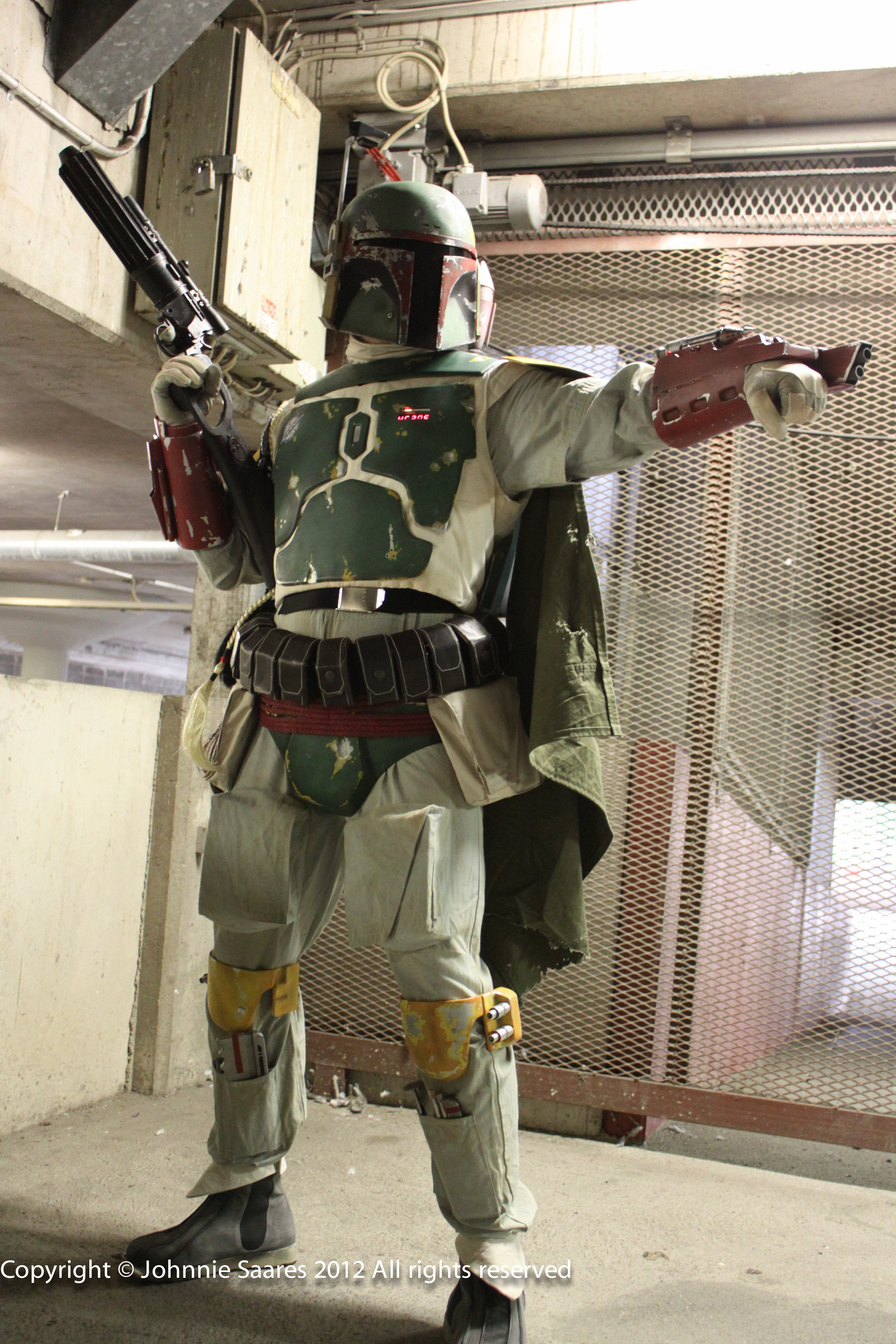

Chibi, thanks for the kind words and yes I remember your build and costume VERY well (I think I even saved a few pics to show other people your work on it). You did an outstanding job on it!
