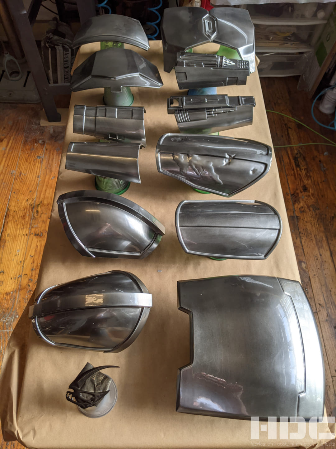

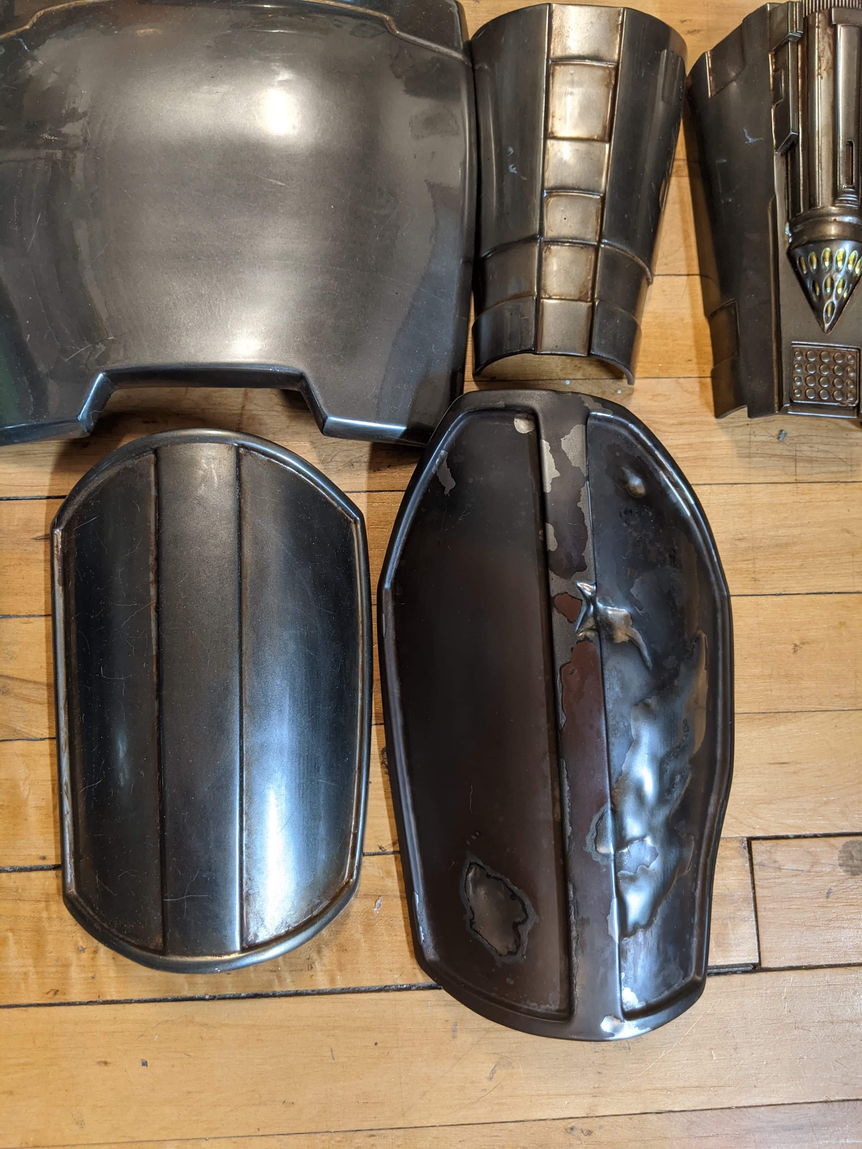

Could you let me know how you end up attaching the armor? What specific kinds of glue and velcro you use? Was researching magnets, etc, but would love to hear what you decide to go with! I have all of my armor ready to go, just need to figure out an attachment method.

Thanks man! I ended up stitching industrial velcro (soft side) to my suit. I glued the hook side to my armor using E6000 (currently drying, needs at least 24 hours to cure).
I'll take some detailed shots once it's all secured!

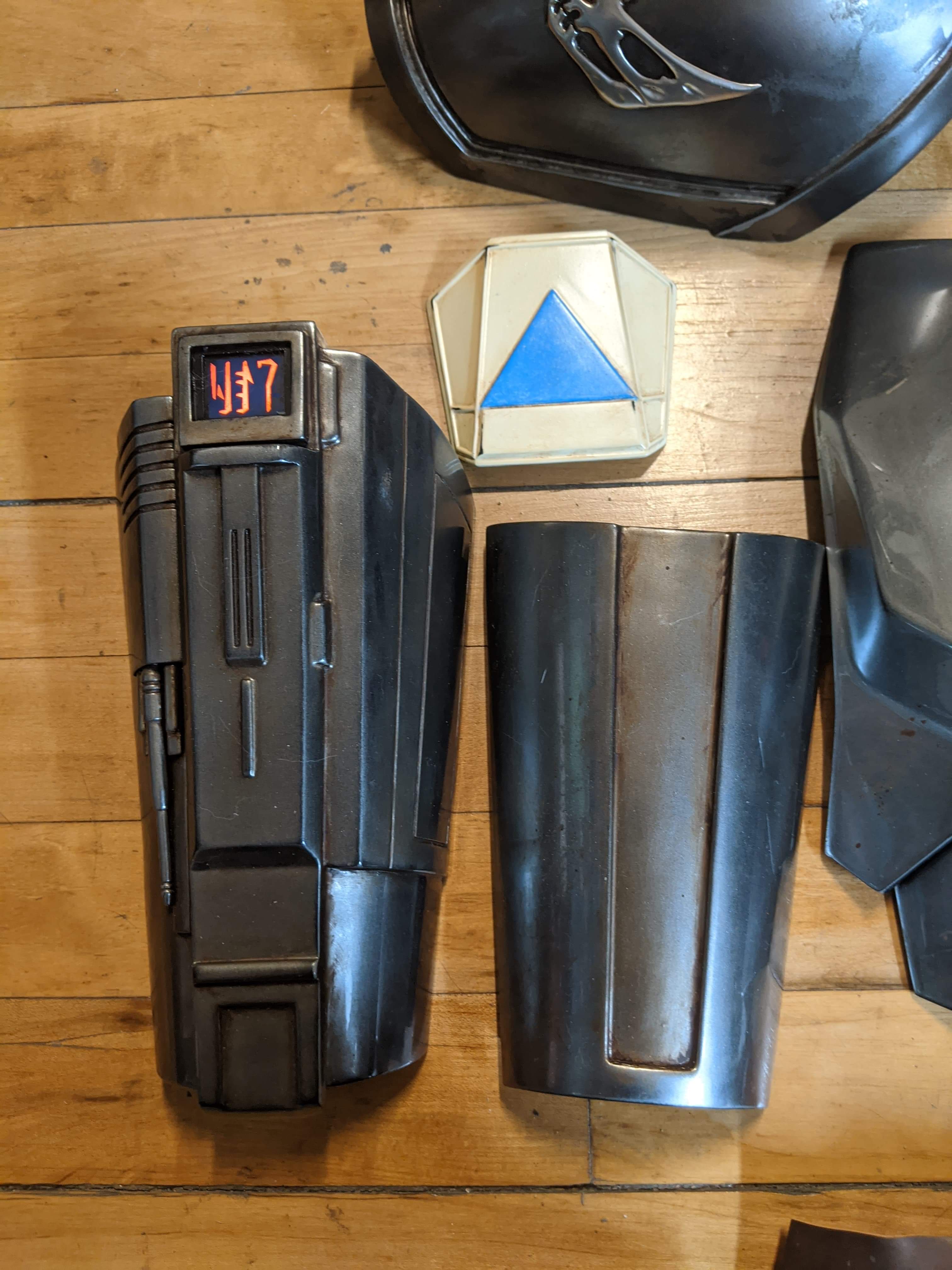

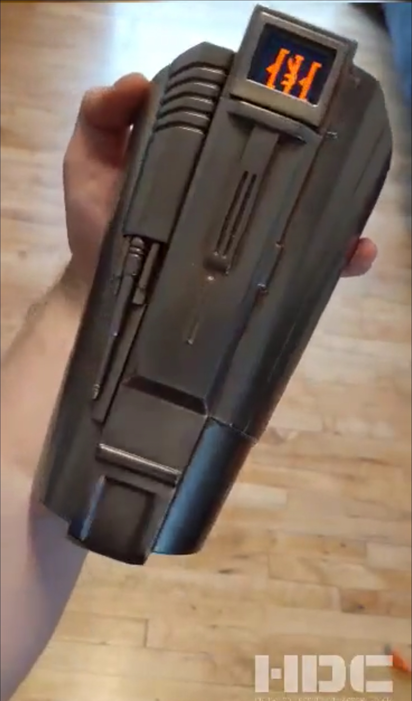

Also curious as to how you’re securing the bracers - both keeping the two halves attached, as well as how you’re stopping them from sliding around on your arm.
They're a pretty tight fit, so they won't slide. If they did I'd probably either pad it a bit with foam or use some velcro to pin it to the sleeve of either my flights uit or gloves.
The bracers have velcro hinges on the inside on one side and magnets on the other. So they can easily be opened and closed :)
