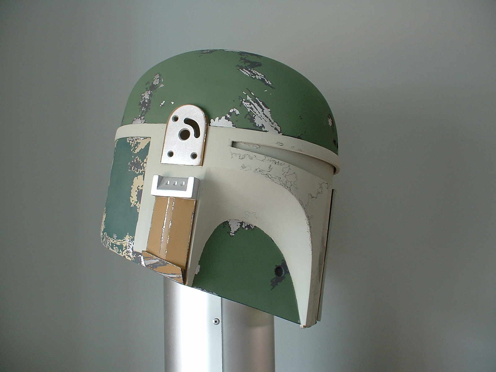

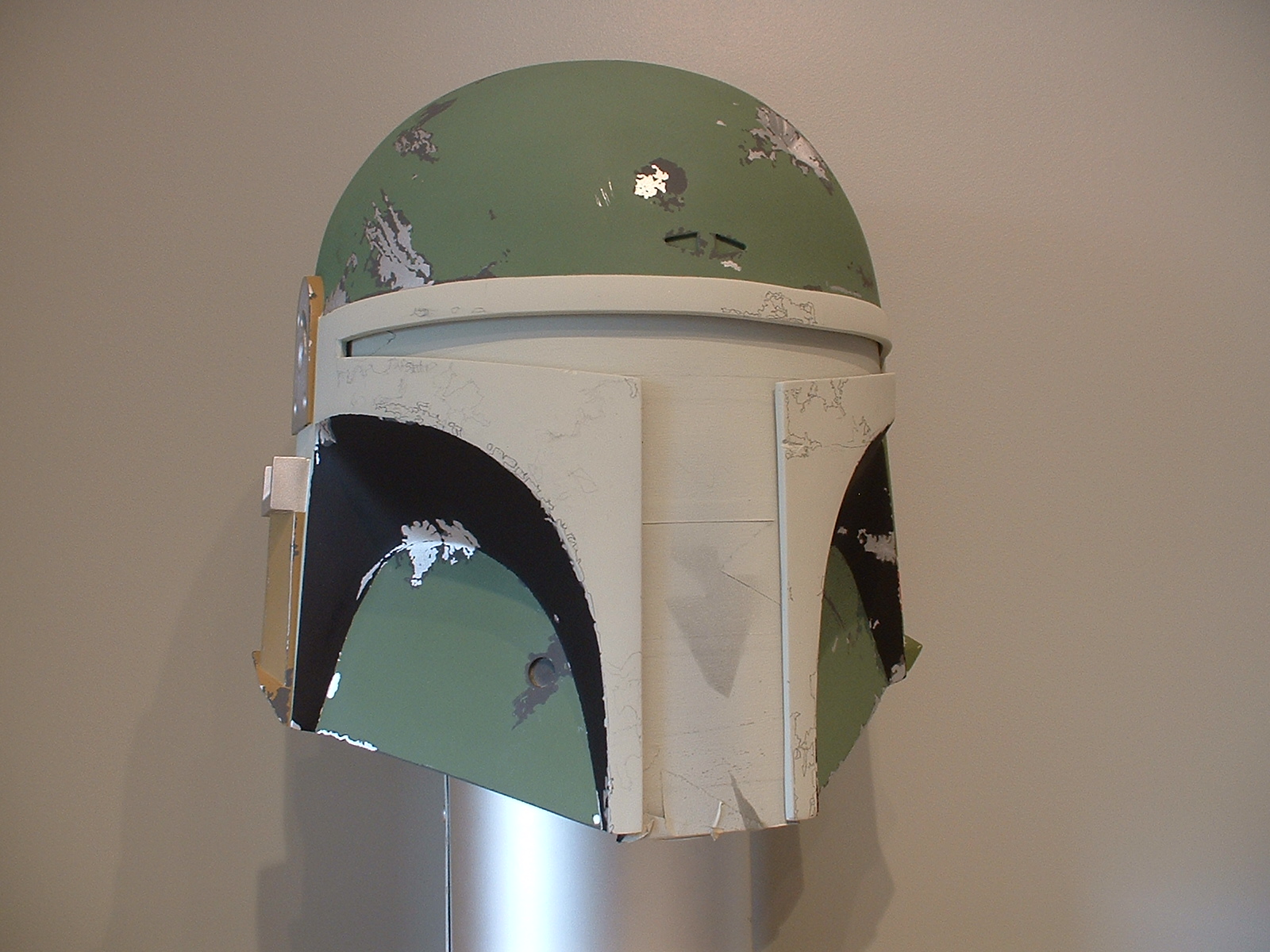

Just masking them now...I love this threadSo what's next? The black on the upper cheeks?
Garret, just to know, after every layer that you apply, do you do something on it? I say that because, maybe, if you mask the painted area it will peel off...
I don't know, so please tell me, tell me![]()
The Humbrol enamel paints seem quite tuff ( they adhere to previous coats 100% ) so liquid mask or tape will not lift the paint between layers...
32. mask entire helmet except dome and lower cheeks, liquid mask grey 147 areas in dent, on top scratch and above keyslots on dome back.
33. airbrush silver no.11
34. outline silver damage with pencil, liquid mask, airbrush grey no.27 in and around dent only, liquid mask grey 27 detail in and around dent, airbrush grey no. 79 onto dome and lower cheeks.
