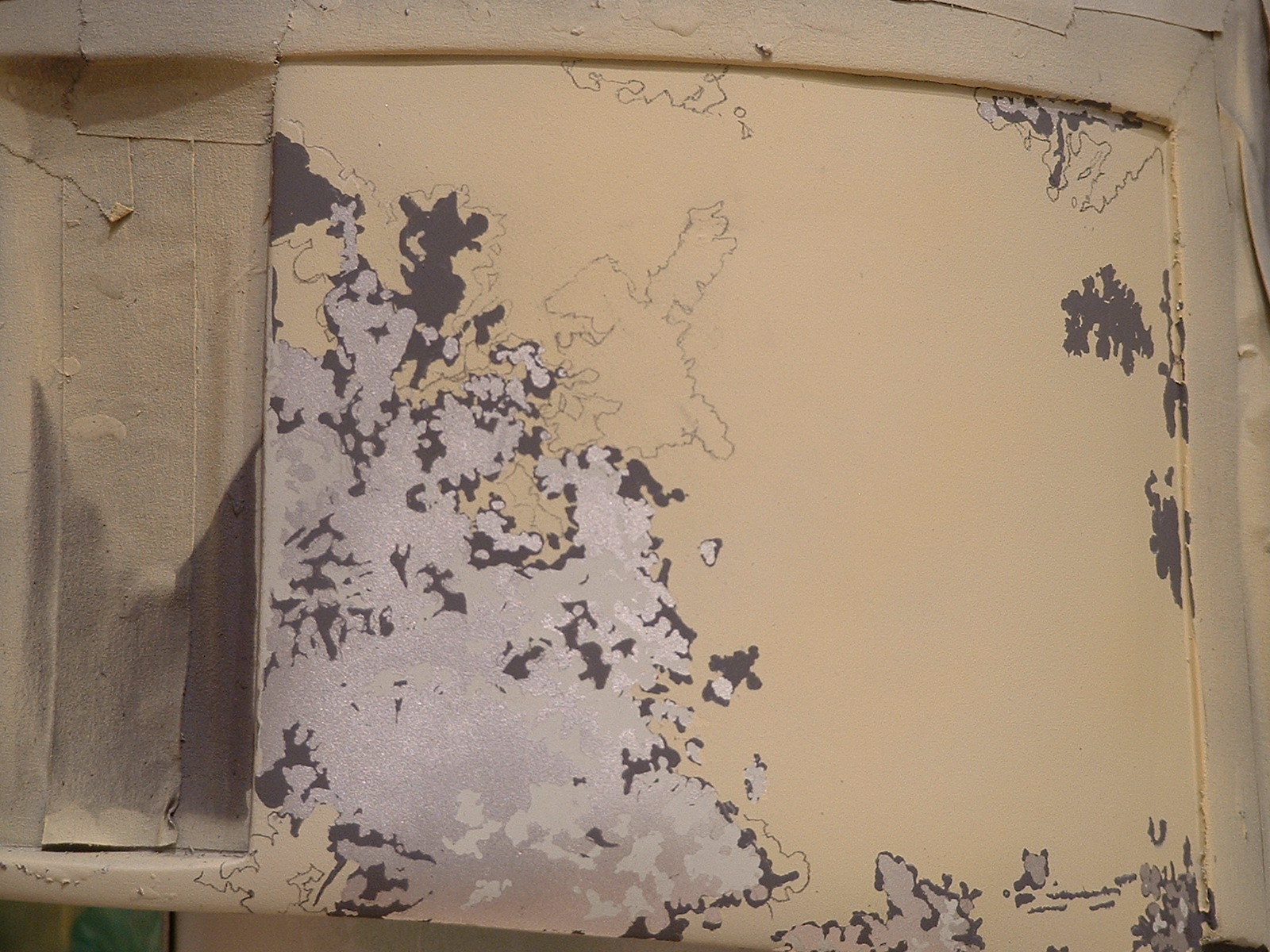

16. liquid mask light grey, silver and mid grey.
17. airbrush grey 28
18 mist beige 103
I 've always had mixed feelings about the 'creaminess' of the beige layer, its difficult to gauge as the green layer seems to reduce its tone. I've misted 103 on top of 28 so if needed i can use wire wool to buff the colour back slightly...

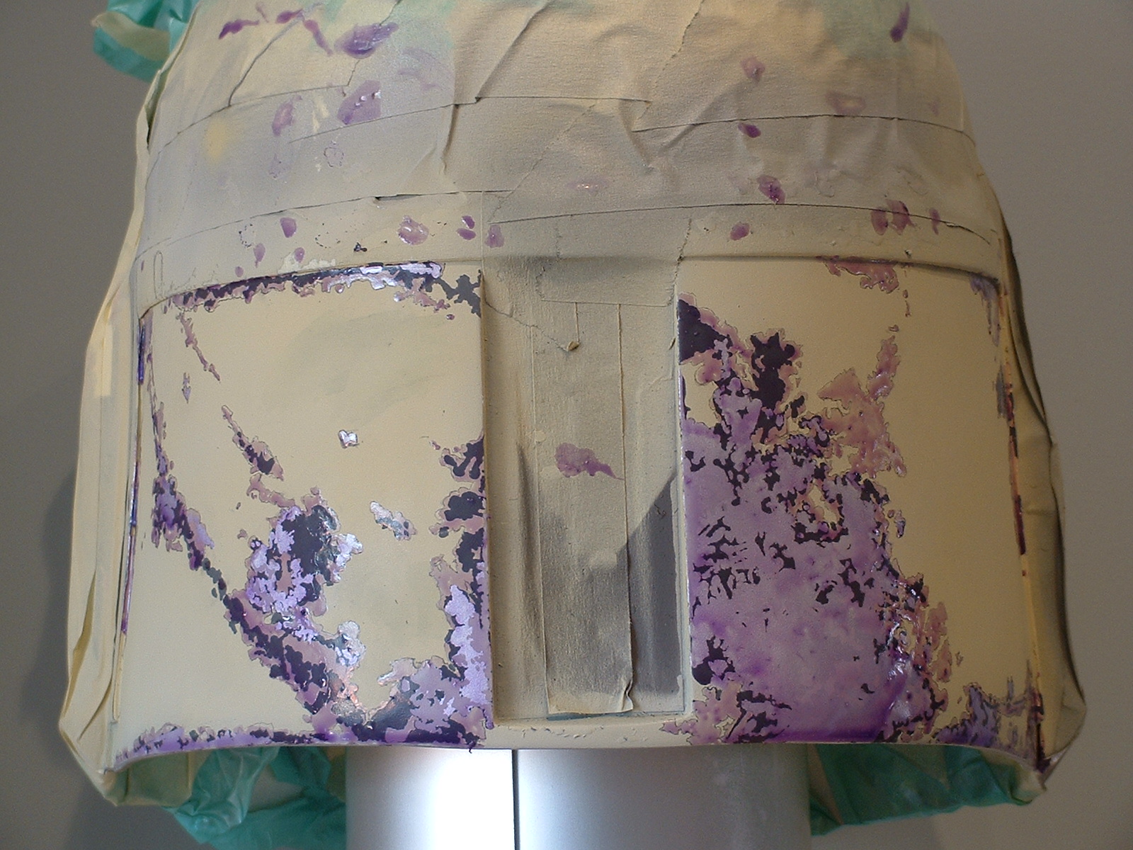

19. outline fine grey detail within R/H back panel silver area, liquid mask then airbrush grey 79
20. outline final layer on back panels...
tip: look out for the shape of the green areas!

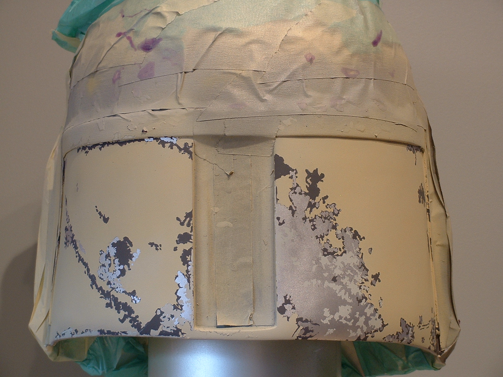

21. liquid mask silver, grey and beige areas

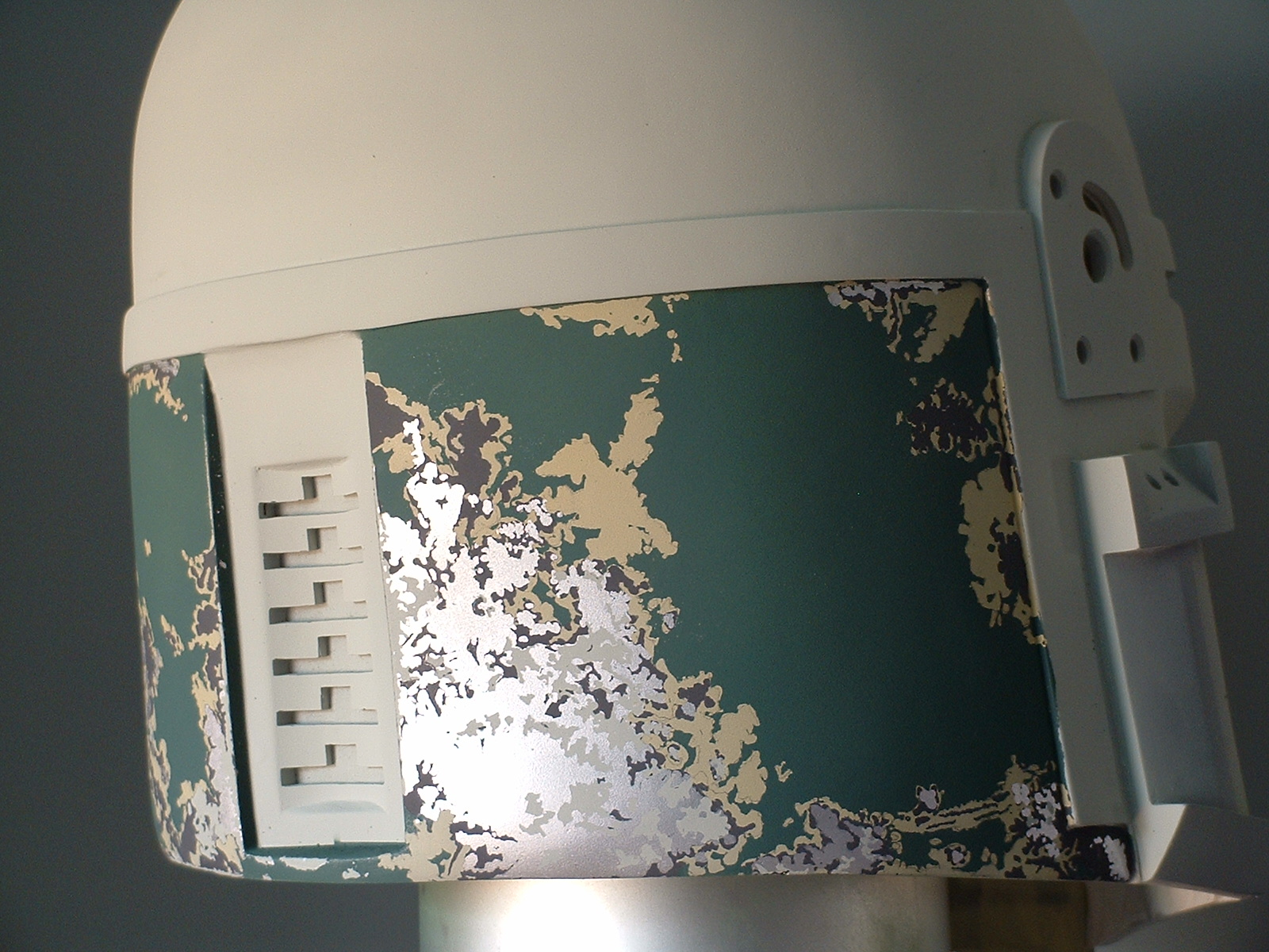

22. spray 76 and 96 mixed 1:1
tip: try to keep this layer slightly thinner so the grey and beige show through in certain areas!
I went slightly too heavy with the paint, so the grey i was hoping would show through this layer is not really visible, when totally dry a buff with 0000 wire wool may work and will also tone down colour intensity...

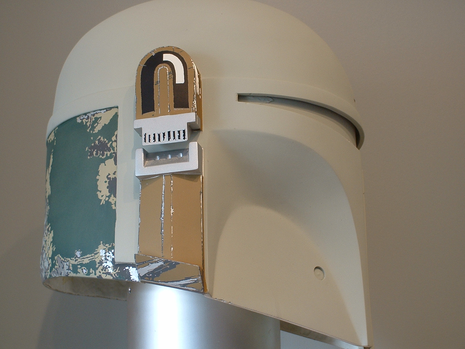

23. a very light buff on the back panels with 0000 wire wool. The aim here is to thin the green layer slightly, don't over do it, it needs to be very subtle!

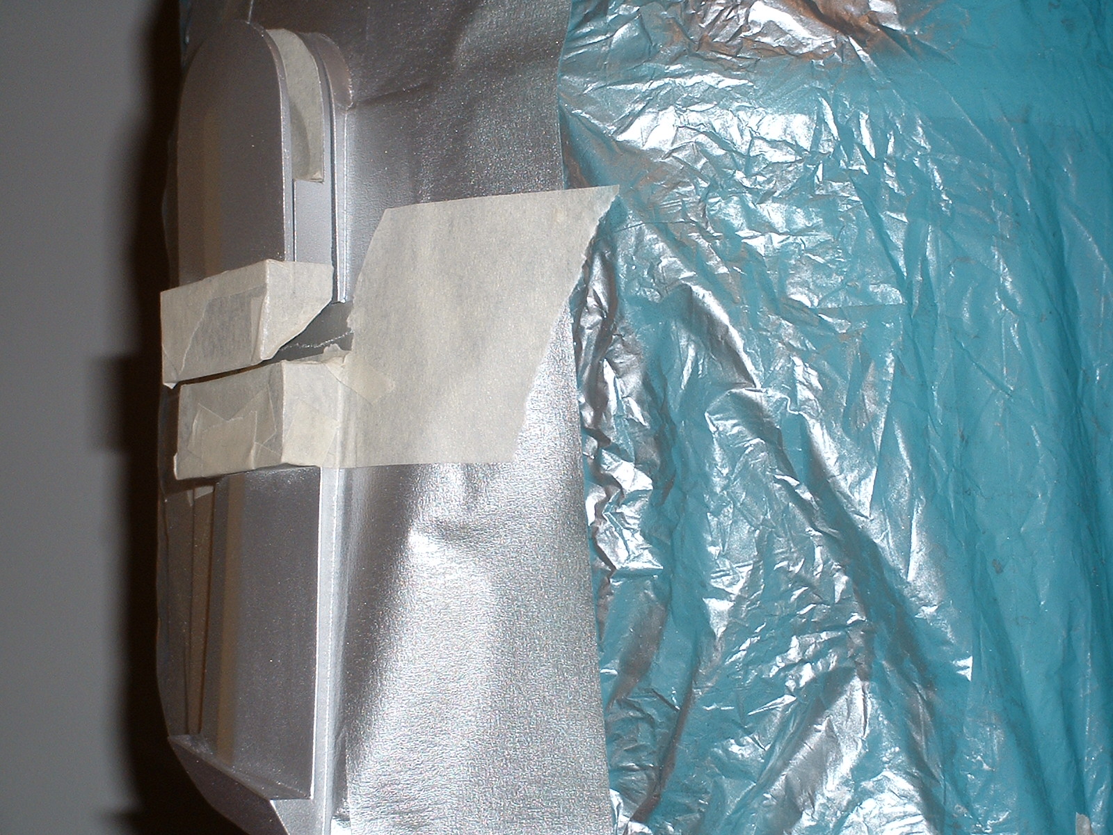

24. mask entire helmet except R/H ear pieces. Spray R/H ear pieces silver no. 11
25. masking tape R/H ear sections to remain silver including inside where the stalk locates. Mount ear pieces onto helmet.
26. liquid mask silver damage, airbrush grey no. 79.
27. remove liquid mask, liquid mask silver and grey damage, airbrush sand no. 93.
28. draw on in pencil black arch and white half arch on outer cap, trace the white arch onto a piece of masking tape, cut the white arch out with sharp knife.
29. liquid mask black arch, airbrush white no. 34.
30. apply masking tape half arch, airbrush satin black no. 85.
31. using thin strips of masking tape, mask the nine stripes below black arch, brush on satin black no. 85.
