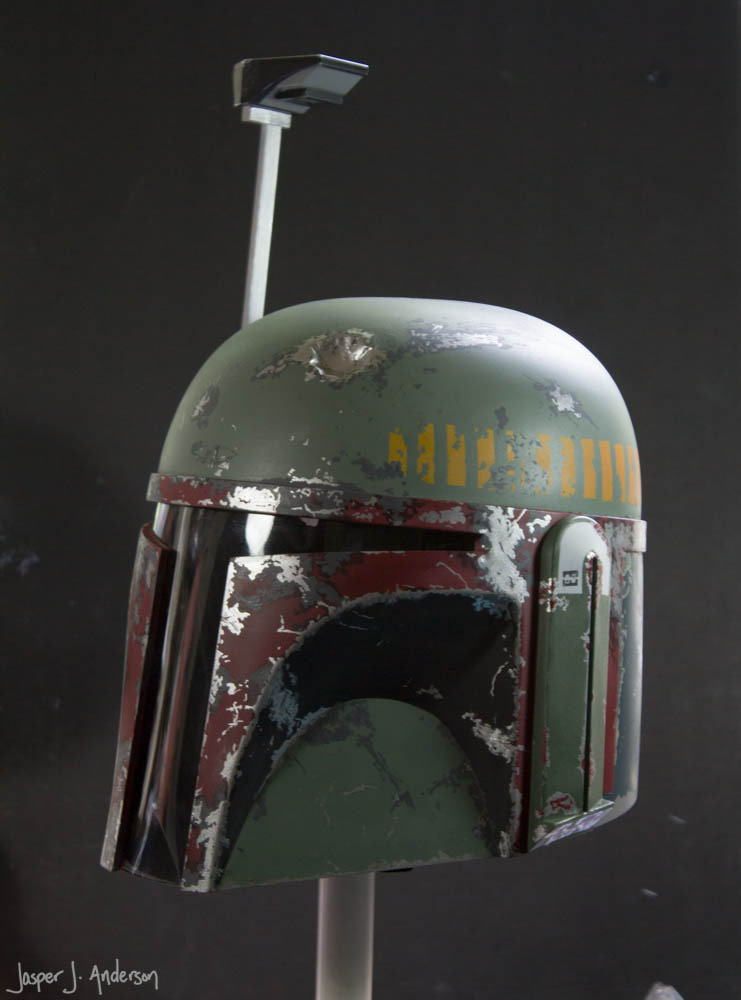

Hey guys, I'm new here, just joined when I heard about these Target helmets on the RPF so I could learn how the pros on TDH paint them. I'm finally (nearly) done painting my Target Boba. Wow, that took a lot longer than expected. Gives me a lot of respect for you guys who do these so well here on TDH (looking at you, Superjedi). I may still shorten the RF stalk a bit (I extened it with K+S brass rectangular tubing, but may have overdone it slightly) and add a bit more general weathering and missed details, but it's been a fun project! I used mainly Model Master enamels, since I don't really have any experience with them. Tried to get the right colors off the shelf, but ended up having to mix most of them, and still didn't quite hit them on the nose. As a learning project, though, I feel it went pretty well. Who knows, I may repaint the whole thing one day, haha.
Mainly a topical paint job. I used a combination of templates from Rich D and RafalFett as a guide for the first pass of color in each zone, and freehanded the subsequent layers, so nothing's truly exact. I stenciled the decals by transferring templates to blue tape with graphite paper, which turned out to be a really easy easy to get them done. I haven't decided how I want to tint the visor yet, so there's just a piece of fabric behind it for now.
The dent shape was corrected somewhat with Apoxie sculpt. At some point, I'd like to fix the shape of the RF, too. Anyway, just posting to say thanks for the incredible resource, TDH!

View attachment 92300 View attachment 92301 View attachment 92302 View attachment 92303
Wow, absolutely incredible paint job! Nicely done!
Hopefully you'll stick around, nice to have new blood!
