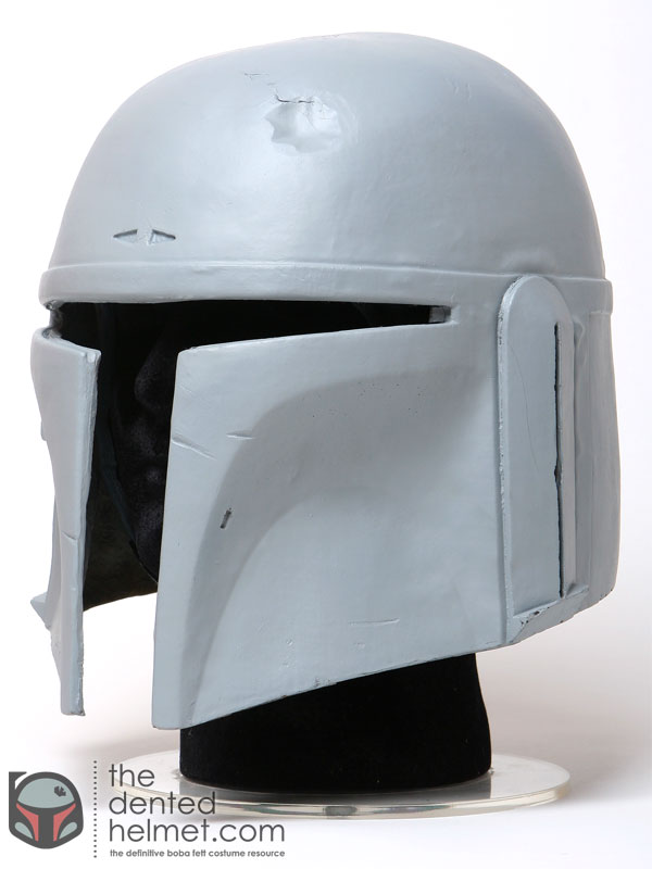

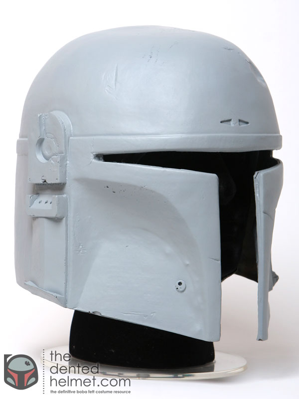

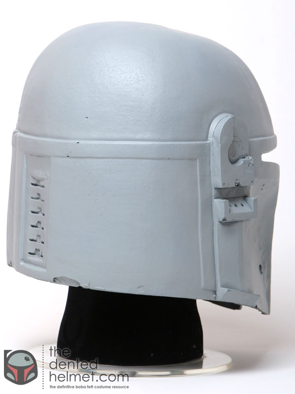

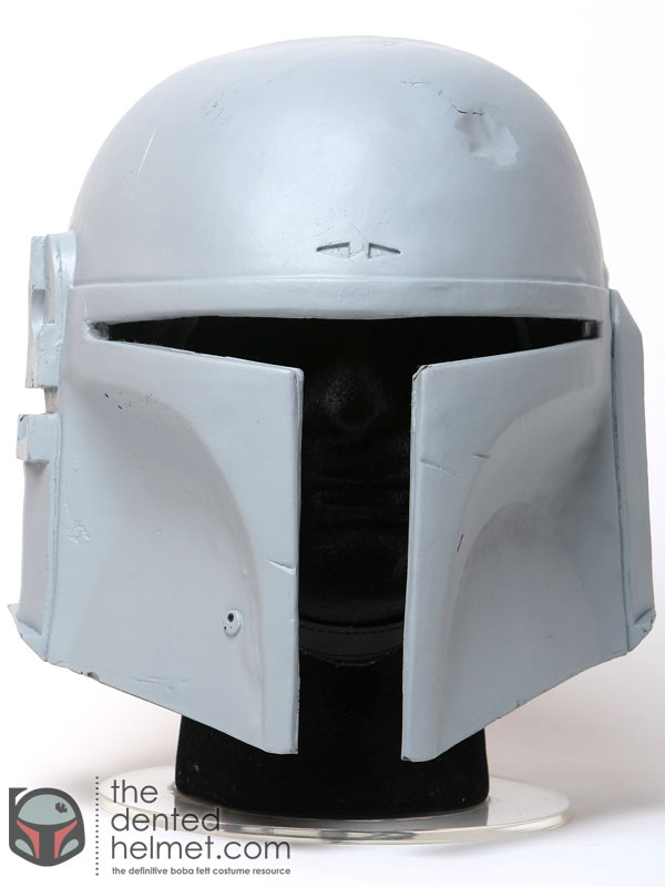

In my last article, “First Sons” I introduced you to a new Boba Fett helmet casting and discussed its history. However, I didn’t talk a great deal about the helmet itself or go into details about it. In this article I will share with you some of the incredibly cool details which separate this helmet from virtually any other (except for the Ken Tarallo plug, which is its “brother”) as well as some of the areas where the helmet suffers clear differences from the Preproduction #2 Boba Fett helmet.

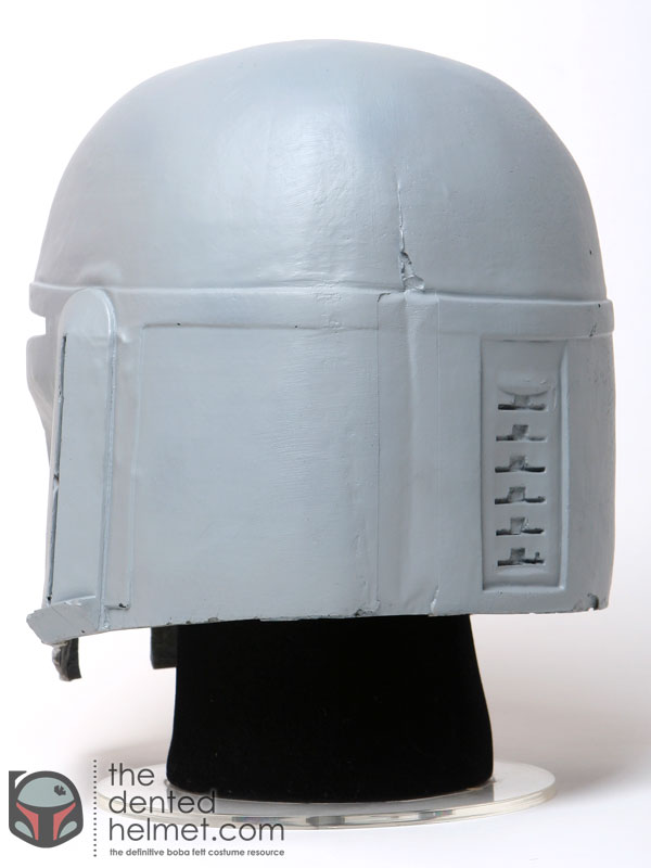

Before going into the details, here are images of the helmet from all angles, so you can get a clear idea of the good points as well as the areas that are a bit less than what one might hope for:

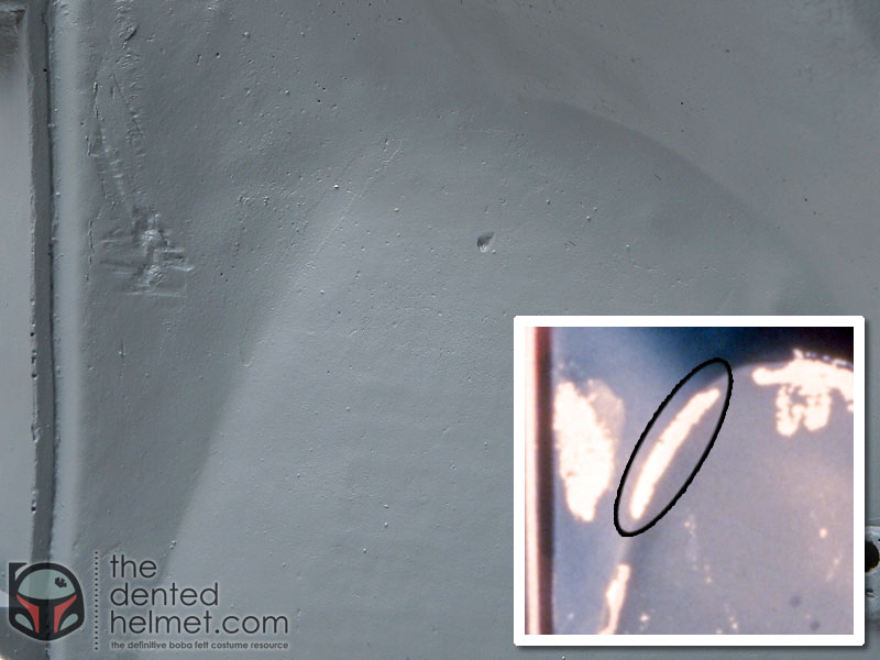

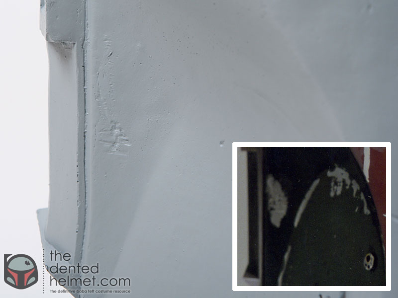

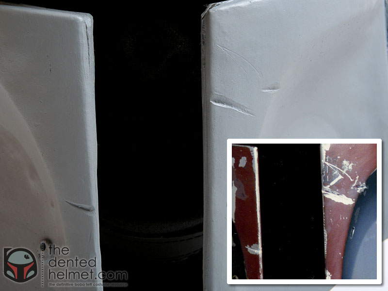

As mentioned previously, this helmet was weathered and painted by Sandy Duhvetter. While the Boba Fett helmets were painted to have a worn and damaged look, there are a few key places where the helmets were physically scored, scratched, etched or otherwise physically damaged. There are literally dozens of light scratches and scrapes on the Grant McCune Boba Fett Helmet that match the original Preproduction #2. Some of the more telling scratches are on 1) the right side of the dome, 2) the right mandible, as well as the left mandible, 3) the cheek just in front of the rangefinder ear, and 4) the non-rangefinder cheek.
Grant_McCune_Boba_Fett_Helmet_Dome_Scratch.jpg Grant_McCune_Boba_Fett_Helmet_Mandible_Scratch.jpg Grant_McCune_Boba_Fett_Helmet_Left_Cheek_Scratch.jpg Grant_McCune_Boba_Fett_Helmet_Right_Cheek_Scratch.jpg
Painted Weathering
The physical weathering marks to the helmet are all very heavy and deep and traces of a few of them can be seen on much later generations of this line of helmets, such as the "Lava" helmet.

Rangefinder Ear / Microswitch

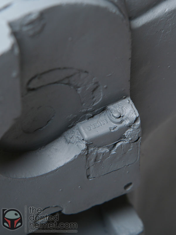

Years ago, Jeremy Bulloch, who played Boba Fett in the Empire Strikes Back and Return of the Jedi revealed that the lights on Boba Fett's rangefinder lit only when the rangefinder was in the down position, and while some costumers have recreated this functionality with a mercury switch, a momentary push button is seen peaking out of the Return of the Jedi Hero helmet which is on tour with the Star Wars: Magic of Myth Exhibit.
As the Preproduction #2 Boba Fett helmet was cast with the upper ear cap removed, the microswitch was cast into the mold and is very apparent in the Grant McCune Fiberglass Helmet as well as the Ken Tarallo Ultracal plug. Not only is the switch itself visible, but also the screws which hold it in to the helmet and the size and shape of the cutout in the ear which houses the assembly. For those who don’t know, the switch is a Honeywell Microswitch.

The Dent
As many know, the dent in Boba Fett's helmet (for which this site is named) was not originally in the 6 helmets that were produced for the Empire Strikes Back. The dents were added after Boba Fett's costume was changed from a generic "Super Trooper" to a single unique character. One of the great aspects of the Preproduction #2 Boba Fett helmet is the clear marks around the dent where it is obvious a hole was drilled into the Super Trooper helmet and the Boba Fett dent was added. While there is a crack in this area on the Grant McCune fiberglass helmet, one can still clearly see the area around the dent that does not match up to the rest of the dome. This is where the dent was inset into the helmet.

Warps

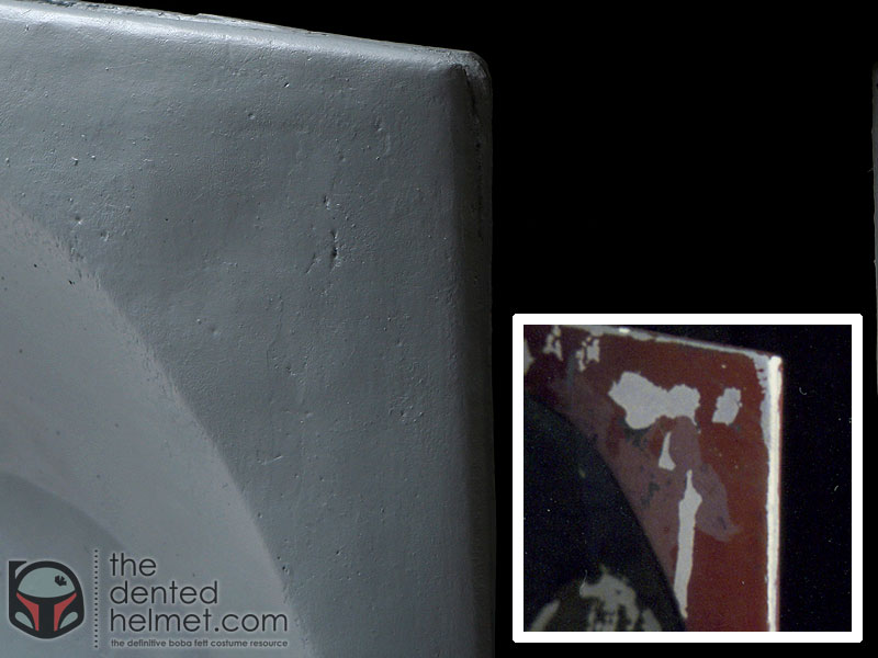

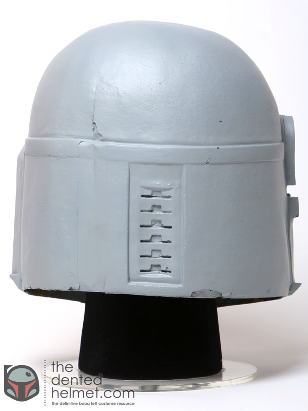

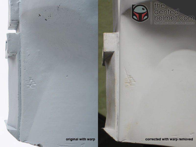

The first and most striking issue with the Grant McCune helmet is that there are several areas that are warped out of shape or sunken. All the detail, including scratches and paint chips that can be matched to the original Preproduction #2 Boba Fett helmet remain in these areas, but the areas themselves are slightly warped. It is interesting to note that the Ken Tarallo has issues in many of the same areas but often the areas on the Ken Tarallo plug are less exaggerated or are actually inversed and where the Grant McCune helmet bows in, the Ken Tarallo bows out, neither matching identically to the original Preproduction #2 helmet. I would love to be able to give you a clear answer to why this is, but the truth is, we simply don’t know. Was it bad spots in the original mold from which both helmets were cast? Was it a lack of support of the mold? Are these warps due to the Grant McCune helmet being cast from the mold years after the Ken Tarallo plug? Might it have something to do with the Ken Tarallo plug being made from UltraCal and the Grant McCune helmet being fiberglass? We just don’t know. All we know for sure is that the issues are present in both helmet to some degree but are much more prominent in the Grant McCune helmet. This can be seen most clearly on the lower rangefinder ear and on the right side of the dome.
Grant_McCune_Boba_Fett_Helmet_Seams.jpgSeams

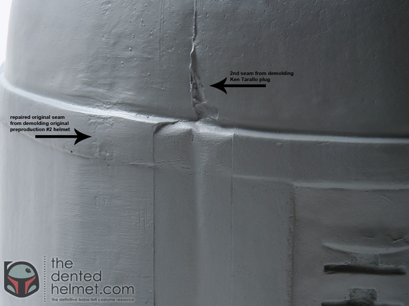

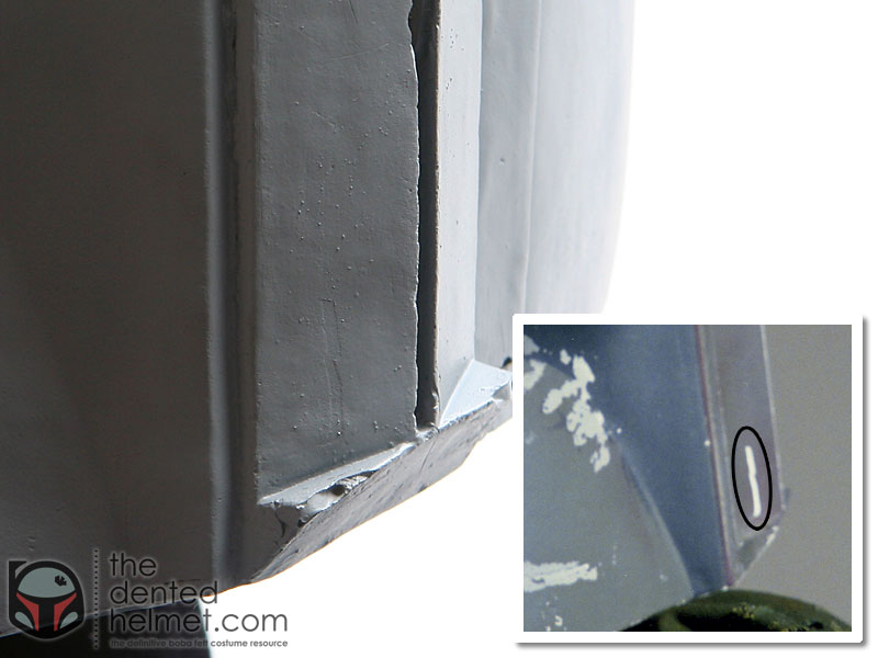

As we talked about in depth in the last article, both castings have two prominent seams up the back of the helmet with the left seam (from the original mold) being exactly the same while the right seam (from the second mold) being opposite of one another. The original seam has created a number of issues in both helmets in the exact same way which include, a drastic warp or dip in the band on the back of the helmet, a flat area where the seam was repaired and sanded, and a slight misalignment of the dome along the seam line.
While the second seam on the Ken Tarallo plug is simply a deeply etched line (where Ken forced the plug from the mold), the second seam on the Grant McCune is a bit more invasive, as the mold was taped from the inside and that tapeline can be clearly seen in the mold.

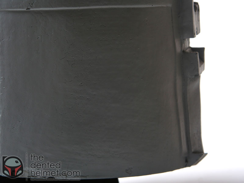

Texturing
On both the Grant McCune fiberglass helmet and the Ken Tarallo plug there is an odd texturing that is not present on the original Preproduction #2 Boba Fett helmet. While it is only speculation, it is believed that this may be from the use of a reinforcing loosely woven material like burlap or cheesecloth within the original mold. Burlap is a traditional reinforcement for plaster mother molds but is sometimes used with flexible molds for reinforcement. Just for the sake of clarity, we are not stating this as absolute fact, just as an educated deduction based on the evidence available. Whether the mold was supported with a woven material or not, it is clear that some type of imprint that appears to be woven in nature was left upon both the helmet and the plug.
Grant_McCune_Boba_Fett_Helmet_Crackle.jpgCrackle Texture
There is a crackle texture on both the Grant McCune fiberglass helmet and the Ken Tarallo plug, although it seems to be much more promiment on the Grant McCune helmet. What this texture comes from is unknown. On the Grant McCune helmet, it is most prominet on the rear dome of the helmet. This texturing is not present on the original Preproduction #2 Boba Fett helmet.

There is only one crack worth noting and it is unique to the Grant McCune fiberglass helmet. It runs up from the dent toward the top of the dome. This is simply a gel coat crack from age and poor handling.

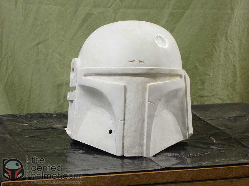

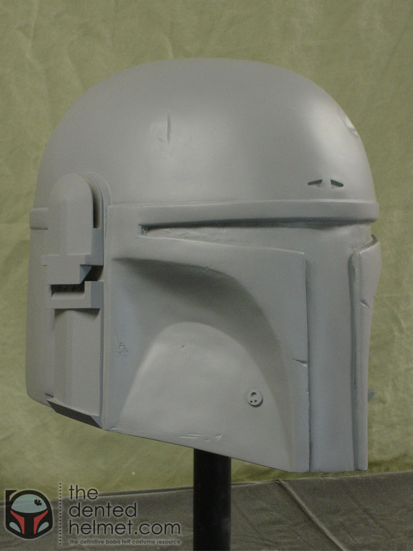

While I will let Chris go into more detail if he desires, he took the Grant McCune helmet, made a mold of it and then pulled a helmet to be his new master to correct. One of the things we wanted to focus on was not ADDING material to the helmet and where possible to retain as much of the original as possible. Chris discovered a very unique method for heating and massaging the warped areas back into shape. The results are nothing less than astounding as he was able to straighten the ear platforms, and dome, all without adding material to the helmet or covering details in the warped areas.
While the warpage was the primary issue with the helmet, there was also the texturing to deal with and while I hated to lose the original paint texture, which is extremely fine, I asked Chris to glaze the crackle texturing and very carefully sand the surface of the helmet in the areas where the woven texturing was the most prominent. I also asked him to correct the crack at the dent and clean up the two seam areas in the rear of the helmet.
Grant_McCune_Boba_Fett_Helmet_Casting.jpg Grant_McCune_Boba_Fett_Helmet_Master.jpg Grant_McCune_Boba_Fett_Helmet_Seam_Correction.jpg Grant_McCune_Boba_Fett_Helmet_Warp_Correction.jpg Grant_McCune_Boba_Fett_Helmet_Crack_Correction.jpg
The final result of a considerable amount of work on Chris' (Fettpride) part is that I have the original Grant McCune fiberglass casting, completely intact and untouched, for my personal collection, and I also have a corrected casting to finish into what I believe will be my final Boba Fett helmet. Big thanks to Chris for taking the time and effort to do this for me and help me fulfill a ten year dream!
While the corrected casting is still in transit at the time of this article and I will be sure to show more photos when it arrives, here is a sneak peak from Chris' workshop.

Came across a slightly better teaser pic I took and thought I'd share. Obviously, I've not been able to work out my photography kinks over the years. I'm sure Art will show this off for what it really is if anyone is still in doubt. But until then, here is a better representation.
