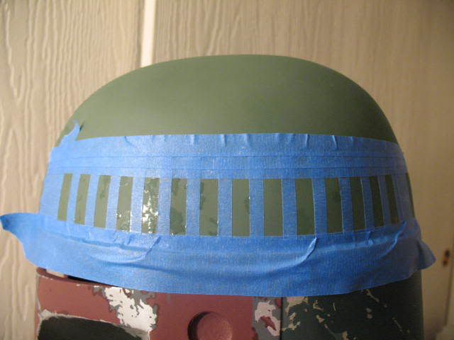

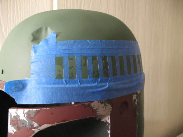

After that I started on the dome. One of the things that can make or break the appearance of the helmet is the kill stripes. With each bucket I paint, this is the most nerve wracking part for me. To place the stripes, I measure my reference pics and tape them off using that blue painters tape. I have found this to be an extremely useful tool. I've never had a problem with too much tackiness, and I haven't (yet) had it pull up any underlying paint. I'm very careful to let my base coats dry for at least a couple of days before putting any tape on.
Once I have the basic outlines taped off, I use Winsor & Newton's masking fluid to mask off the chips within the stripes. I usually do this by eye.
Here's a couple shots showing the stripes masked off. I have my camera on the close-up setting, so there's a weird fish eye effect. The masking fluid appears shiny in the pics.

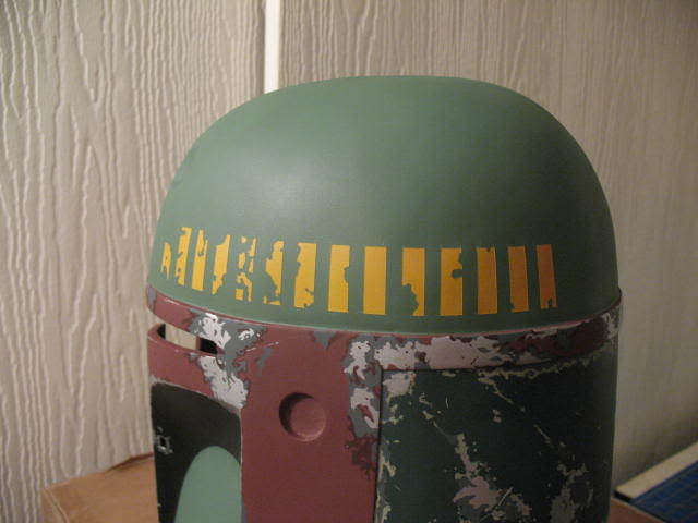

After everything is masked, I apply some UP Armor Yellow with one of those dense little make up sponges. I apply several light coats, letting each one dry for about 15 minutes in between, until no more green shows through. Once the yellow is dry, I brush on some reddish-orange pastel powder, making it heavier on the rear stripes, and kind of fading as I come around toward the front.
Here's how the stripes look once they're unmasked.

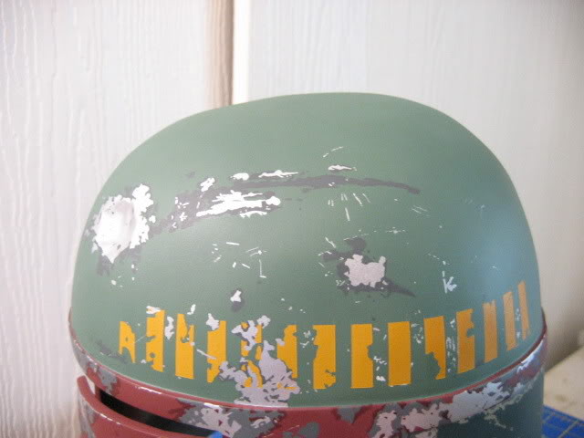

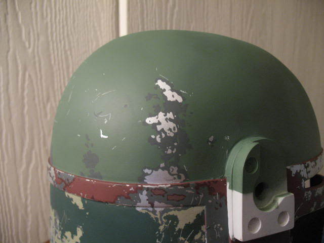

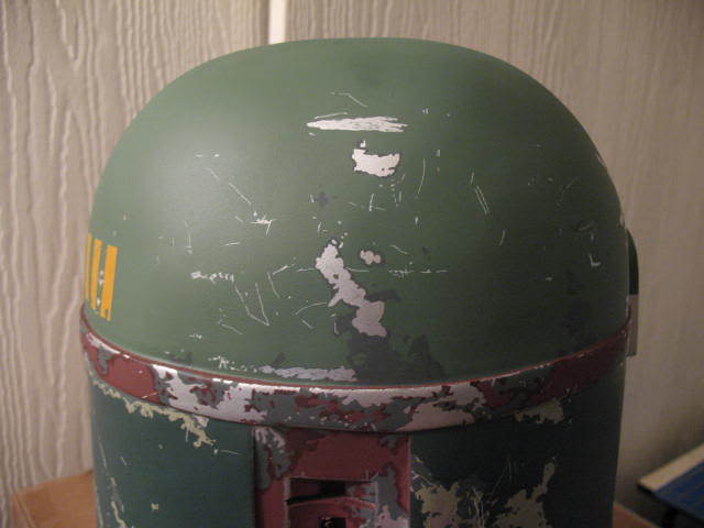

After the stripes were done, I began on the damage on the dome. I started from the killstripe area, and worked around the back of the helmet toward the right ear.
Here's the killstripe area. All the tiny tiny thin scratches were made with a compass point, following closely with the reference pics.

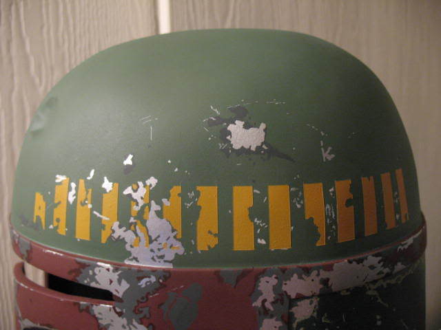

Here's the rear view. What a jumble of scratches on this section! :eek:
And finally, the area just behind the right ear. This is a good stopping point for today. . . cuz my wrist is cramped! :lol:

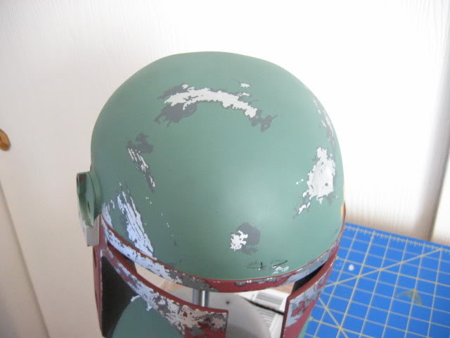

Cat scratch fever!! Du-du-du! Cat scratch fever!! Du-du-du-duuuu!! :lol:

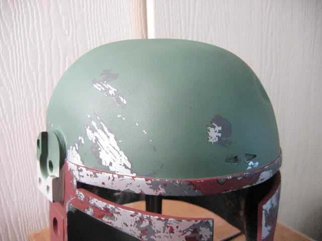

Ah, the famous cat scratch. I've worked pretty much the right front half of the dome. I think this is pretty much as far as I'll get today. I was hoping to do the dent, but like with the "face" area of the mandibles, this area is one of the most important, so I want to be sure I have plenty of time set aside to tackle it!
Here's a couple of angles of the dome so far.
Once I get to the dent, that's pretty much going to be it for major painting on the helmet itself. :thumbsup: I still have the ears to paint and apply decals to, then some "spatter" and pastel weathering on the whole bucket!

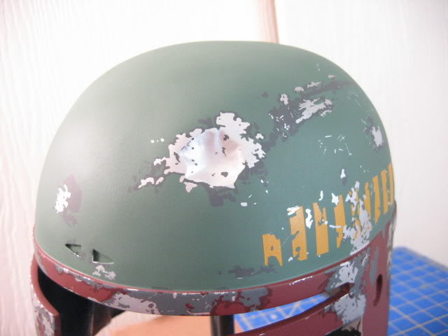

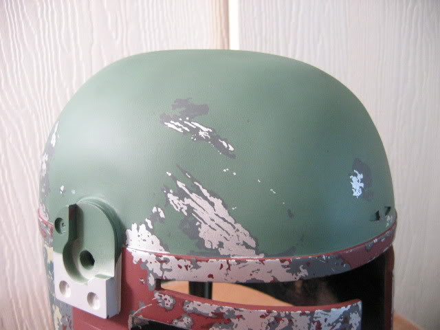

And finally, the feature without which this board would have a different name: The Dent! :lol:
Took my time with this area. There are several good 'head-on' shots of the dent itself, which makes outlining it much easier. But it's harder to find a good angle for that big scuff that trails back from the dent itself. I had to use a couple of different pics and play with the position a little bit to get it placed properly.
This area is complete! I had a discussion with Laan before I got started about whether he wanted a "screen used" paint job, or an "exhibit" paint job. The exhibit helmet through the years has gathered some extra damage, including all those strange black marks between the dent and the kill stripes. So those will not be added. I tend to prefer this look myself, and when I eventually do another helmet for myself, I'm gonna go with this look, too!
I dunno if it's my old camera or what, but the colors are really getting blown out. :facepalm But here are the newest pics. :thumbsup:
All that's left now on the bucket itself is the big scrape on the top of the dome. That'll get done tomorrow, and then it's on to the ears! 8)
