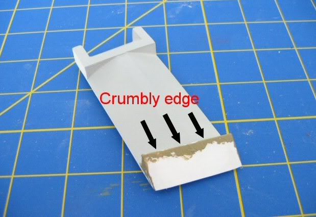

Well, while sanding the lower right ear piece, one edge of the wedge shape at the bottom kind of crumbled away. There must have been some bubbles just under the surface.
I didn't take a "before" pic, but here's the area in question.
So, I did some expedient battle damage repair. :) I took some .010" styrene sheet, and cut out some pieces to reshape that sharp edge. A flat rectangle for the bottom face, and 2 smaller triangles to cover the top wedges. I sanded them as close as I could to the resin, then filled the edges and corners with some automotive putty. Now I'll have to wait another day to sand and reprime.
But that section of the ear will have a nice smooth edge again. :thumbsup:

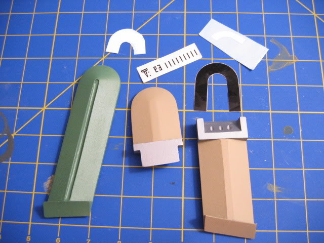

For the RF ear parts, I used Floquil Earth over a base coat of silver. This is what Lee recommended in his legendary color thread, and it turns out great this way. :thumbsup:
After they were dry, I masked them, and sprayed some Testors Metalizer Stainless Steel on the "exposed" metal areas. This will dry overnight, then tomorrow I'll buff it with a soft cloth.
The left ear was painted with Testors Acryl RLM 83. This is where I go off the Rogue Studios trail just a touch. I think with his last update, he said to use POG, just like the dome and lower cheeks, but after poring over the reference pics, I really feel that this is a slightly different green. I've used the RLM 83 on all the helmets I've painted so far, and I think this color looks really good.
Here's how the ears look.
Also in the pic are the vinyl decals I'll use. They're a mixture of what Marrow Sun supplied with the helmet, and some leftovers I got on one of VashDStampede's last helmet decal runs. Vash did this latest batch with the small white arch "pre-damaged" which makes painting that area soooooooo much easier! ;) I have cut out the black and white arches really close to the vinyl, but this isn't necessary at all. It just helps me to place them on the ear pieces.
I'll also be using some small dry transfers in place of some of the tiny black decals.
Not shown is the arch that's built into the right side of the helmet. I masked that off and sprayed it with Earth over a silver base, too.

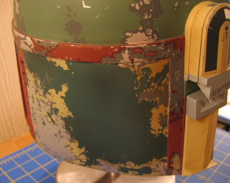

Here's the right cheek, showing the Borden connector in place. On Marrow's v.3, it came as a seperate piece, which was really great for painting purposes! :thumbsup: I've always had trouble figuring exactly what color this thing is. Nothing in the reference pics has ever leapt out at me color-wise, but I think what I came up with looks pretty OK.
In the above pic you can also see some of the pastel weathering that I applied. Over most of the helmet, it's a random mix of black and charcoal gray, but in certain areas, I used a brown tone. Like at the bottom of the left ear here:
