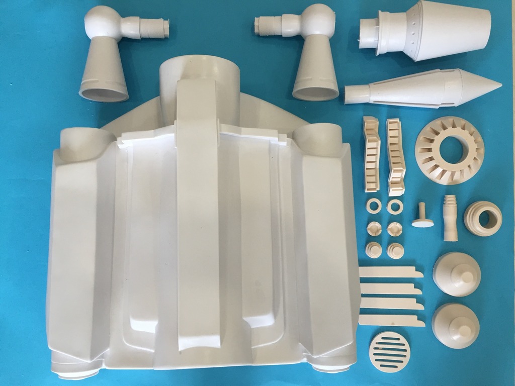

The thing is so beautiful and nicely detailed, but it comes with a whole collection of pieces, and I wonder... have someone who owns MoW packs, did something special other than gluing the pieces together? I am targeting for a removable rocket (in either possible way) and thruster nozzles.
For example:
- Separate rocket and way to hold in place?
- What pieces did you attach permanently and which you didn't?
- Back cover attachment methods?
- Top side caps attachment permanently?
- Thruster nozzles attached differently?
I will be adding/upgrading to metal collar, lighted beacon, stabilizer and possibly the side activation buttons. Please, post your mods and any ideas for easy building.

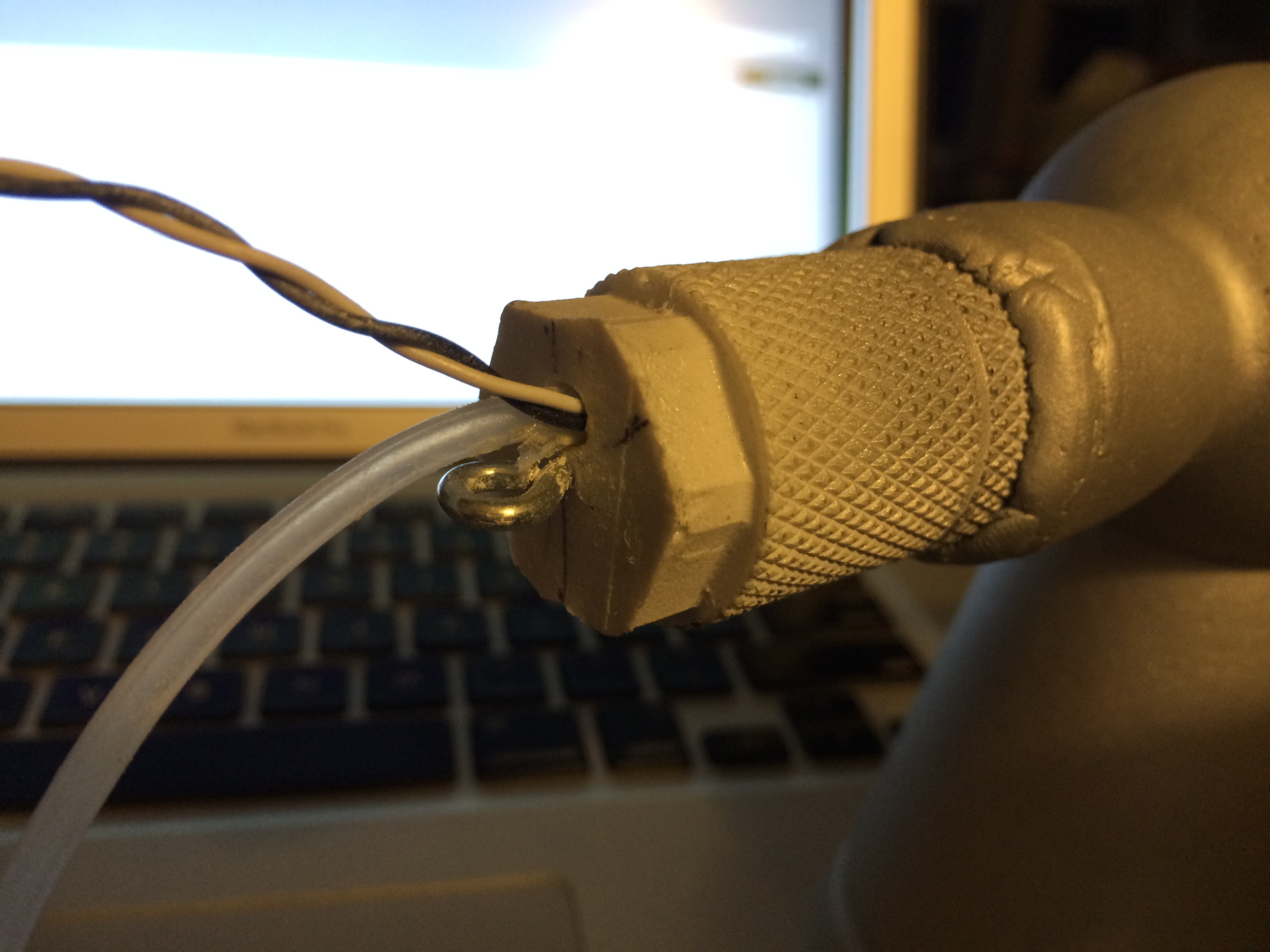

I've gone with the removable nozzles, and have found a small bunjee cord to hold them in. I drilled out a bit in the center of the nozzle mount, and added an eye-hook. I also added a bit of Sugru mouldable plastic around the nozzle to help hold the proper angle (but with more careful cutting on the jet pack body you may be able to avoid that).
I also drilled out a hole through to the center of the nozzle and threaded a small tube through, to allow for the "smoke effect" to be added later. I've pulled some wire and installed an extra momentary switch (from the left gauntlet) on the right-side nozzle to use for operating the "smoke effect".
I plan to hide the switch behind the "activation button" on that nozzle, that I have cut off and cored out.

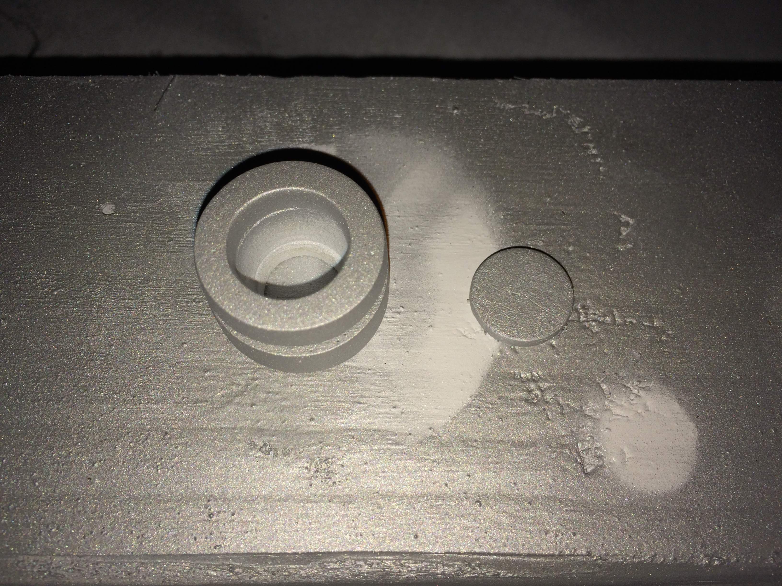

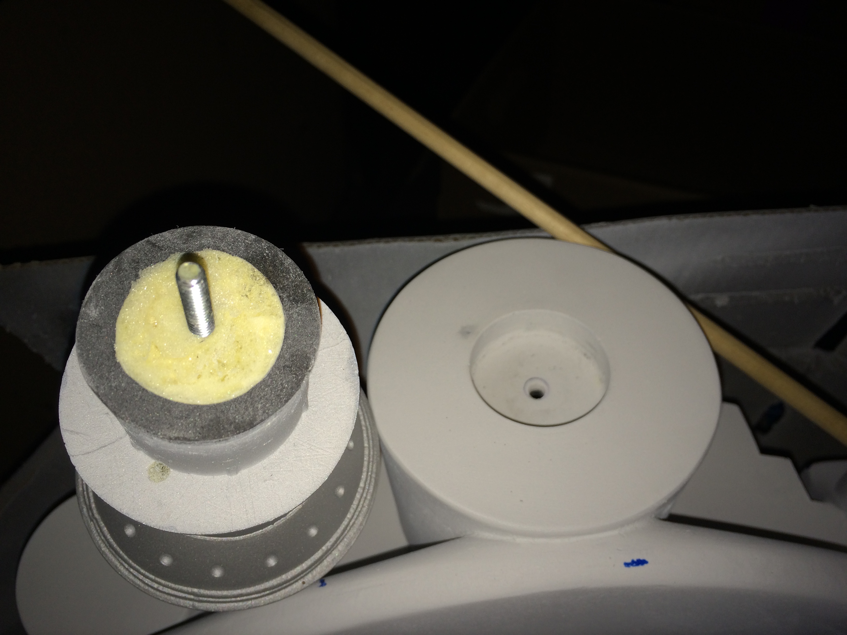

I've decided to go with the removable rocket assembly as well, mounting a spare bolt into the base of the rocket and drilling the corresponding hole into the jet pack body, held in place by a wingnut and washer (plus more Sugru on the base of the rocket and inside where the washer sits). I secured the bolt in the rocket using expanding foam, but I think if I did this again I would use JB weld or something with more control (the foam kept expanding for days and was a general messy pain in the bottom).

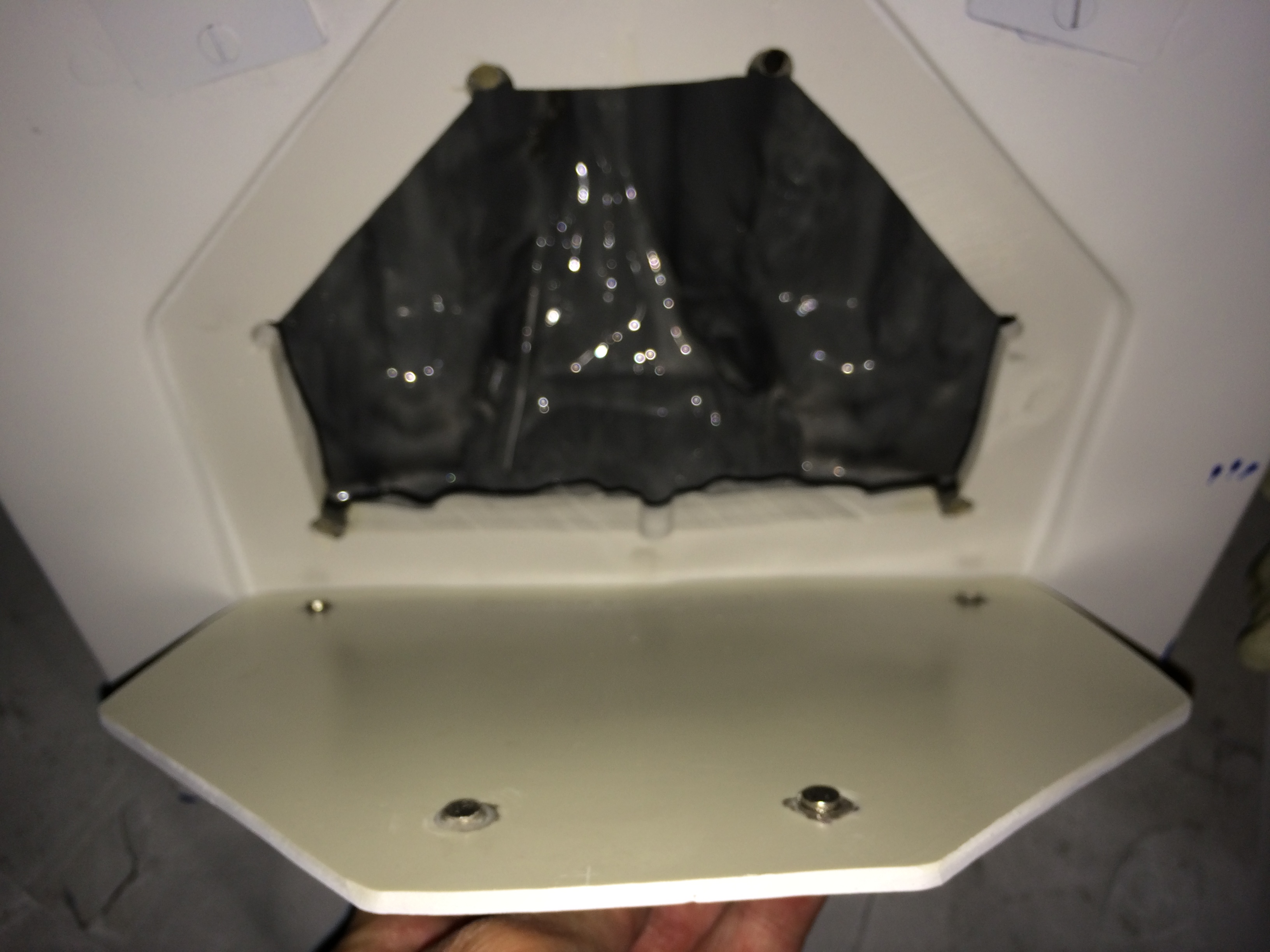

Lastly I've mounted some rare earth magnets to the door and into the holes inset into the back opening to secure it.

The door on your MOW fit the opening? That's new...
Something I've realized as soon as I received it, is that the door is slightly bigger than the opening. Nothing like a good ol' trimming of the edges to fix that issue.
