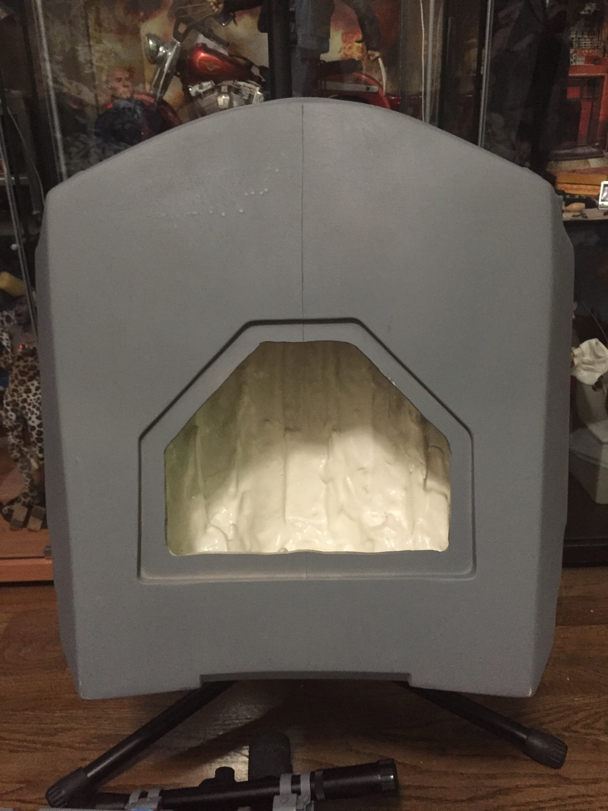

By the way, here is what the rocket top looked like when I cut it down which shows why I needed a new one:
The back also doesn’t have the recessed shelf for the three greeblies, so I will be making that modification soon.

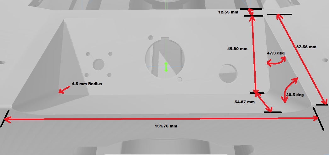

By the way, does anyone know the measurements of the back recessed area? I’ve been looking, but can’t seem to find drawings of the depth and angle.

Here are my measurements to the best of my ability.
Thanks again Chris! That’s exactly what I needed. So by those measurements, the inside angle will be @ 102.2 degrees. I was originally going to do 90 degrees, so thanks for the correction.

You can also download the jetpack model from Shapeways for free (you'll have to create a free account fo that) and open the STL file in a free 3D editor to better visualize the model. Seeing a particular area from multiple angles makes a great difference.
Lazerjock
The pack I took the measurements from is from RafalFett.
VashDstampede
Thank you, that really helped. It also showed me how much work you put into these designs and I am awestruck by your skill!
Thanks Chris, this helped me out a lot.

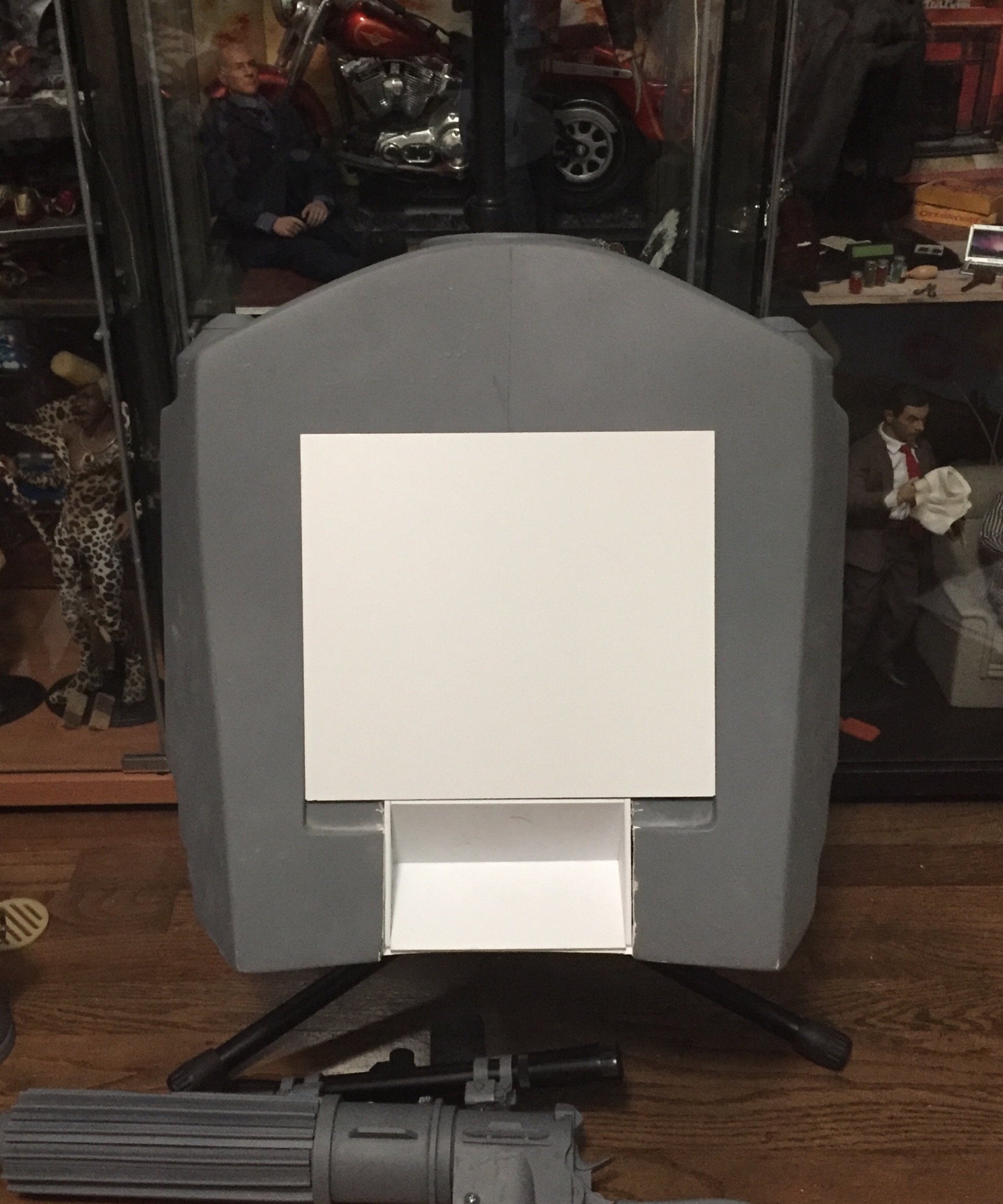

I did a mock up, how does it look?
I know the third greeblie isn’t the correct one, but I had that before finding out about the correct one. Surprisingly it is very close to the correct size.

I’ll sand and shape this tomorrow and hopefully be able to rout out the section for the cover.
I used sintra pieces to fill the large gaps so it wouldn’t add too much weight. I then filled in the smaller gaps and reinforced the back from the inside with epoxy putty.

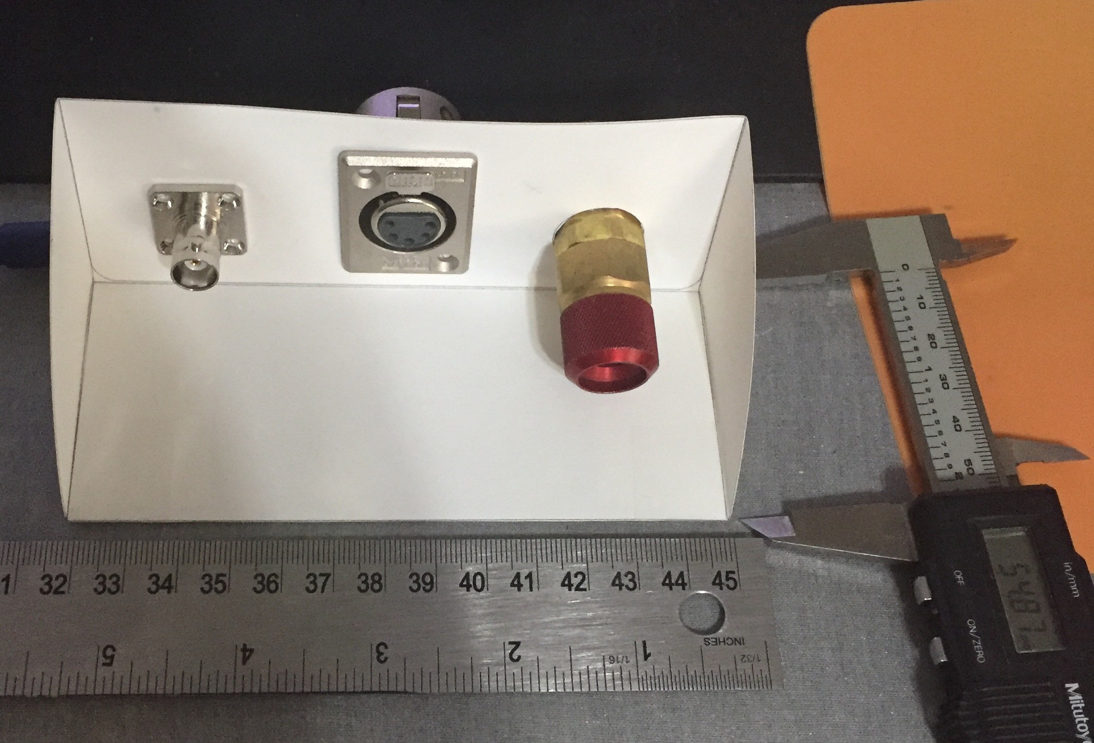

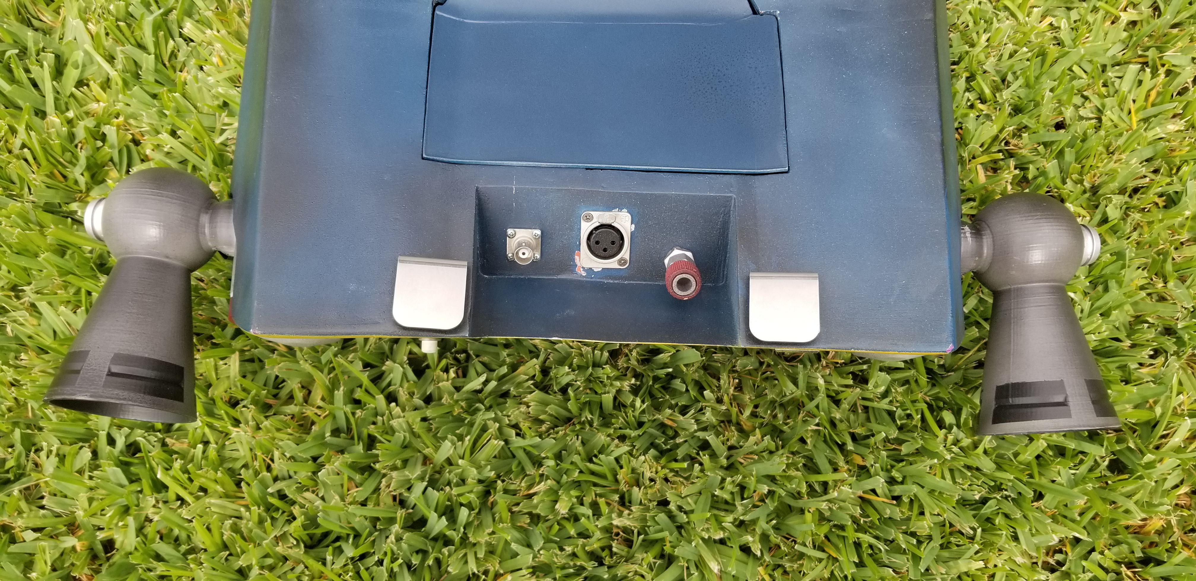

The 3rd greeblie was bothering me because of its bulk so I wanted to try to make it more accurate.
I rummaged through some brass parts I had at work and after some cutting, drilling and sanding of 4 different parts, I was able to come as close as I can to the actual part.
It’s no longer functional, but I think it looks really nice. Too bad no one will ever really see it when displayed.
It does help to quiet down the OCD a bit.
Before and after shot:
