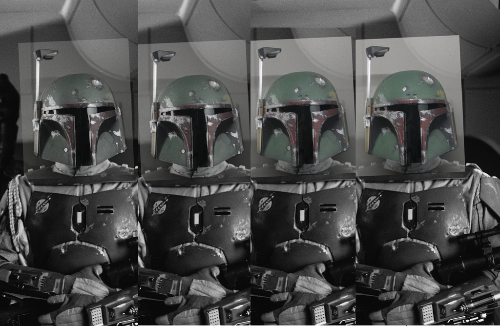

Ok so here is a compare side by side and an overlay i did with the pic of my helmet i posted above and the "between shots" screen cap.
Now i didnt do this to inflate my ego or anything lol..i just honestly wanted to see how close it was to the visual i was seeing in that shot. The angles of the photos are very close which is why i decided to give it a whirl. I think my helmet looks pretty close, and i did add that 1/4" width to the bottom of the helmet. the ear platforms appear to have very similar angles.
As far as the overlay..well its not perfect... between the angle of the photo not being EXACTLY the same, and the size of the photo may be slightly off .......and well im sure the MR isnt exactly like the Hero. But i think my helmets achieve the look i was after, and that little bit of flare was added to them, which was my main point. :)
I did not modify the angles or anything of the likes on the DVH helmet when i did this overlay. I just scaled the pictures to match size as closely as possible and tilted it a bit to match the screen shot.

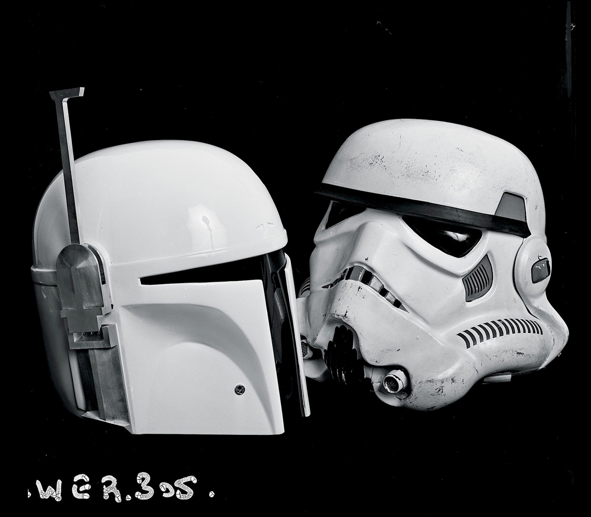

I'm actually almost positive the white helmet talked about above is the PP2 before it was sent to the U.S
Here is the PP2 before paint.

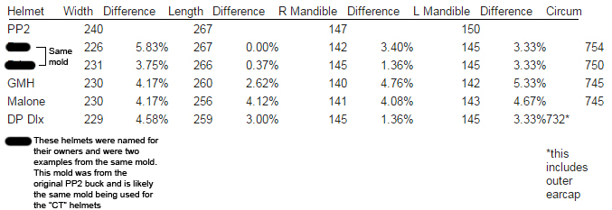

Some PP2 helmet dimensions follow and are compared to a few examples of castings that link back to the original helmet.
The ESB helmet is approx. 9 mm more in width. This may not always be the case depending on a few factors. Keep in mind the ESB is thin fiberglass. I've seen it measure a few mm less.
I have permission to post the above but I really cannot get into a discussion much more in-depth about the real helmets. But this is the first time dimensions from real helmets have been posted.. So Happy New Year!

Oh yeah, it is important that the people who soon will probably measure their various fanmade helmets remember this:
In regards to the width or length of a helmet it is not really a good indicator of how "close" it is to the real ones. You could stretch out the smallest helmet there is and get some pretty similar results. The information about the real helmets is solely intended to show variation between them.
It is almost a certainty that all the original helmets came from the same mold. You can see in the chart that two fan castings from the Same Mold can turn out pretty differently and it was the same case with the original helmets.
So if your fan helmet stacks up, awesome. But it isnt necessarily proof of anything.

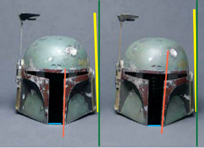

So i did this little diagram.. this pic is from the costumes book. it is the ESB hero (left)and the PP3(right). I still believe that the ESB helmet is unique compared to the other helmets.
The green line is vertical (or very close to it. I duplicated the layer and moved the line with the arrow key in photoshop as to not skew the line at all) i followed the line angle of the left ear on both helmets with the yellow lines. You can clearly see the angle difference there, as slight as it is, but it IS there.
The orange line is the different angle of the mandible on the one side. Again you can see how the PP3 is slightly angled (maybe this is partly where the MR pinch came from?) and the ESB hero has it more forced outward toward the bottom.
The light blue line is the difference is the bottom width of the visor. The line is the full width of the visor on the PP3. Again i duplicated the layer to keep the line the same size and just moved it over with the arroe key to put it at exactly the same place as on the PP3. It comes up just short on the ESB. Thus showing that the visor was likely pushing out the mandible which in turn has pushed the side of the helmet outward slightly creating more flare on the one helmet. It also made the "squint" on the visor area on that side less, or pushed upward on the ESB than the PP3. It would make sense that it may have also pulled down the brow, assuming it wasn't fully cured when the visor was installed. I know from experience that you can manipulate a Fiberglass cast to some extent if its not fully cured. The not fully cured fiberglass theory was also mentioned in Ponte's paint thread as to why there is the bulge on the upper cheek on one side of the ESB helmet only. The epoxy from the mounting plate likely warped the fiberglass, before it was cured. Again leading me to believe the helmet was pulled from the mold and assembled before it was fully cured, which can lead to plenty of distortions on a cast. Most of the anomalies seem to be on the left side of the helmet (right as we look at the pics) It looks like the entire cheek panel is twisted.
All these things are very slight but i think are something that can be seen, even if someone cant pinpoint it, the ESB helmet does have differences from the PP2, PP3 and ROTJ helmets.
