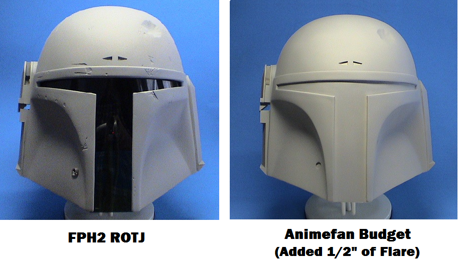

Since we're talking about flare...and whether it's there...here's a pic I'd like to share...
I took some time today and increased the flare on my Animefan budget helmet by 1/2". Heated in the oven on 375 degrees for 2 minutes. Then I put a rod in the base to hold it at the desired width and ran it under some cold water to cool it back down. Once cooled down I removed the rod and VOILA...FLARE! Here's a pic of it next to the FPH2 that I'm currently painting for starchild99.
thats pretty much what i did for my casts. I took one of my base MR casts and put a pvc pipe in it after some heating. then i made a new mold while the pipe was still in it. Pretty much did exactly what you did there. :)
