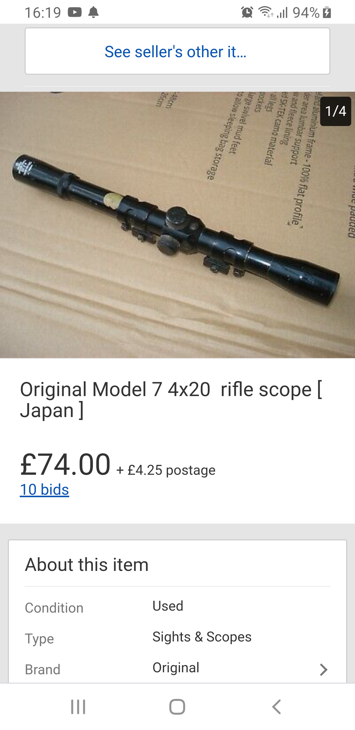

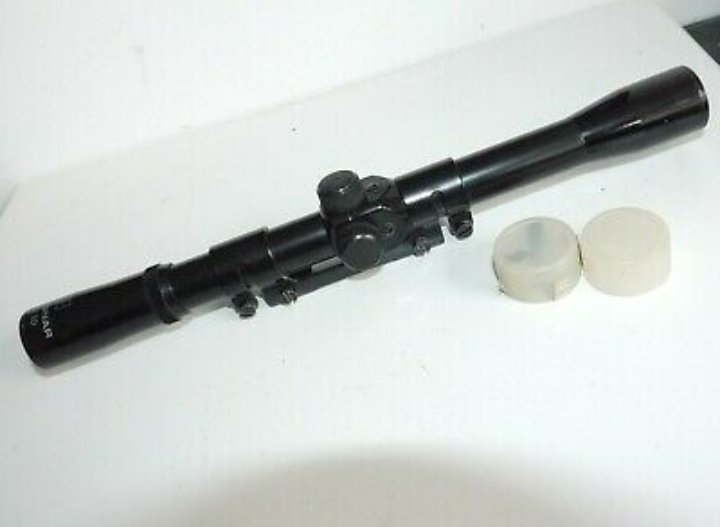

Thanks for the info and your opinion on costs. I’m looking for something accurate in terms of the actual scope, but it doesn’t have to be dead nuts accurate, you know?
This was the one that I found:
HUNTER rifle scope 4 x 20 with reticle, riflescope, japan quality | eBay
The windage knobs look “different”, and the photos are not the greatest. I pretty much assumed I’d just be using the scope itself, but the mounts and feet would have to be replicas created by someone here (likely sidewinder).

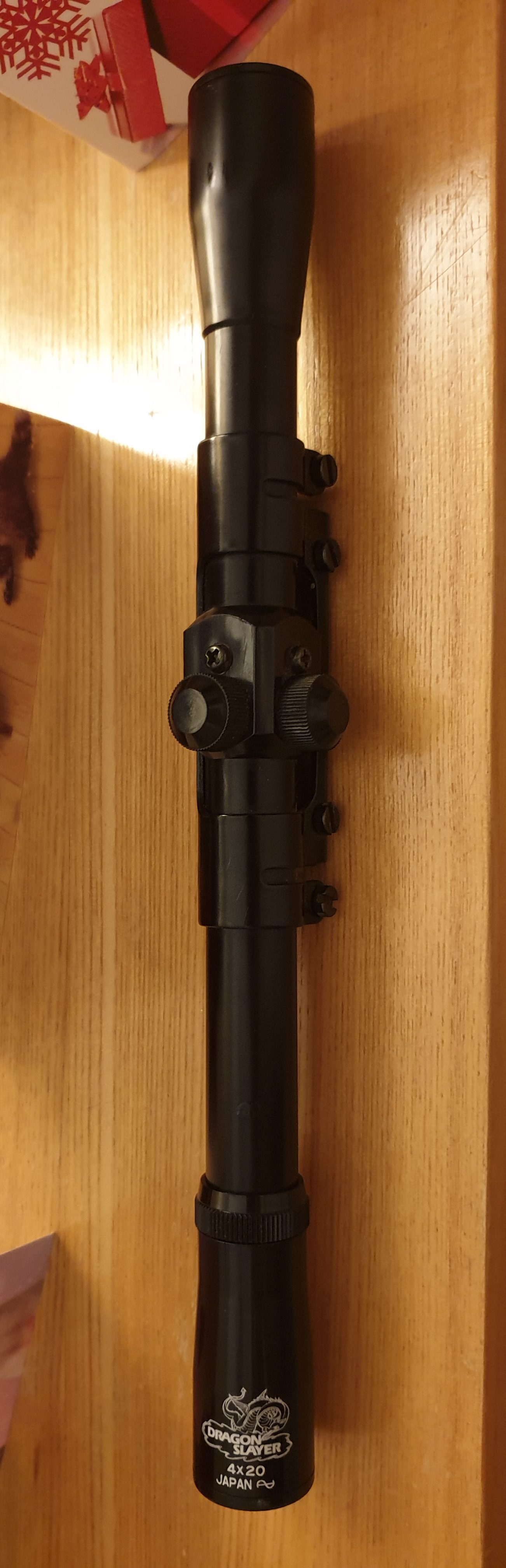

DRAGON SLAYER!!!!!!!
Edit: 3rd Jan 2021
I was too lazy to do this properly when I posted the picture of the Dragon Slayer. This is the updated brand list of complete scopes with the probable brands listed after. I now count 20 brands, which includes the 'EDNAR' brand that I added 3rd Jan 21. That's quite an increase from the eight or nine I had when I first researched this in 2012, or whenever it was.

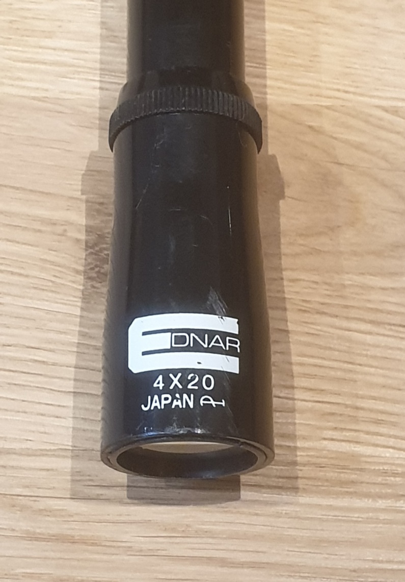

Ednar - new 03/01/2021

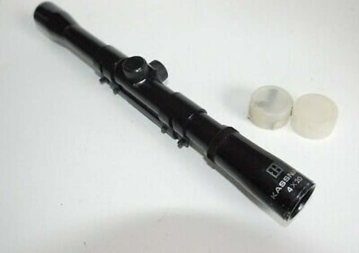

Kassnar (no infinity symbol)

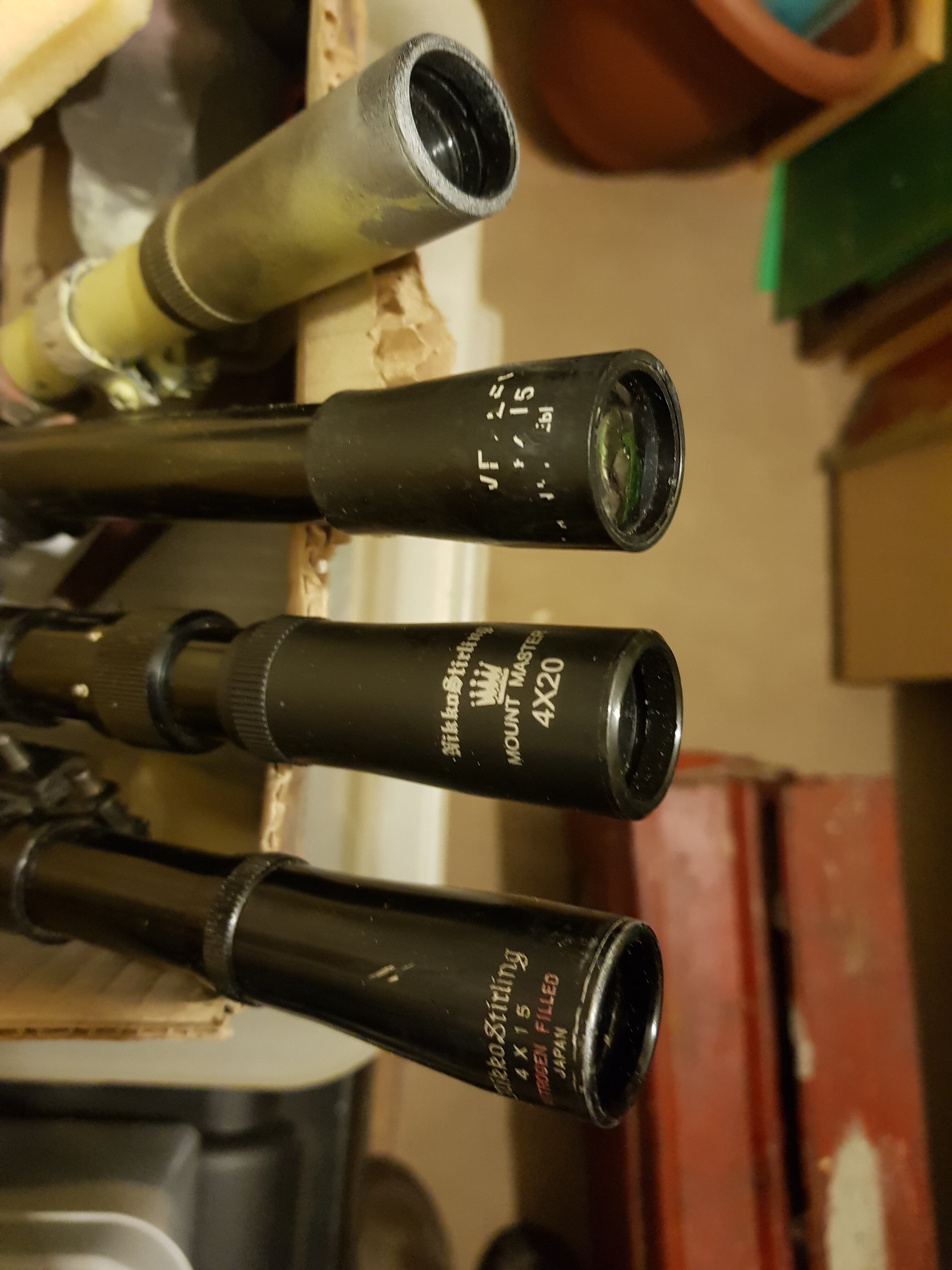

Gunmark
Nikko Stirling
World Famous

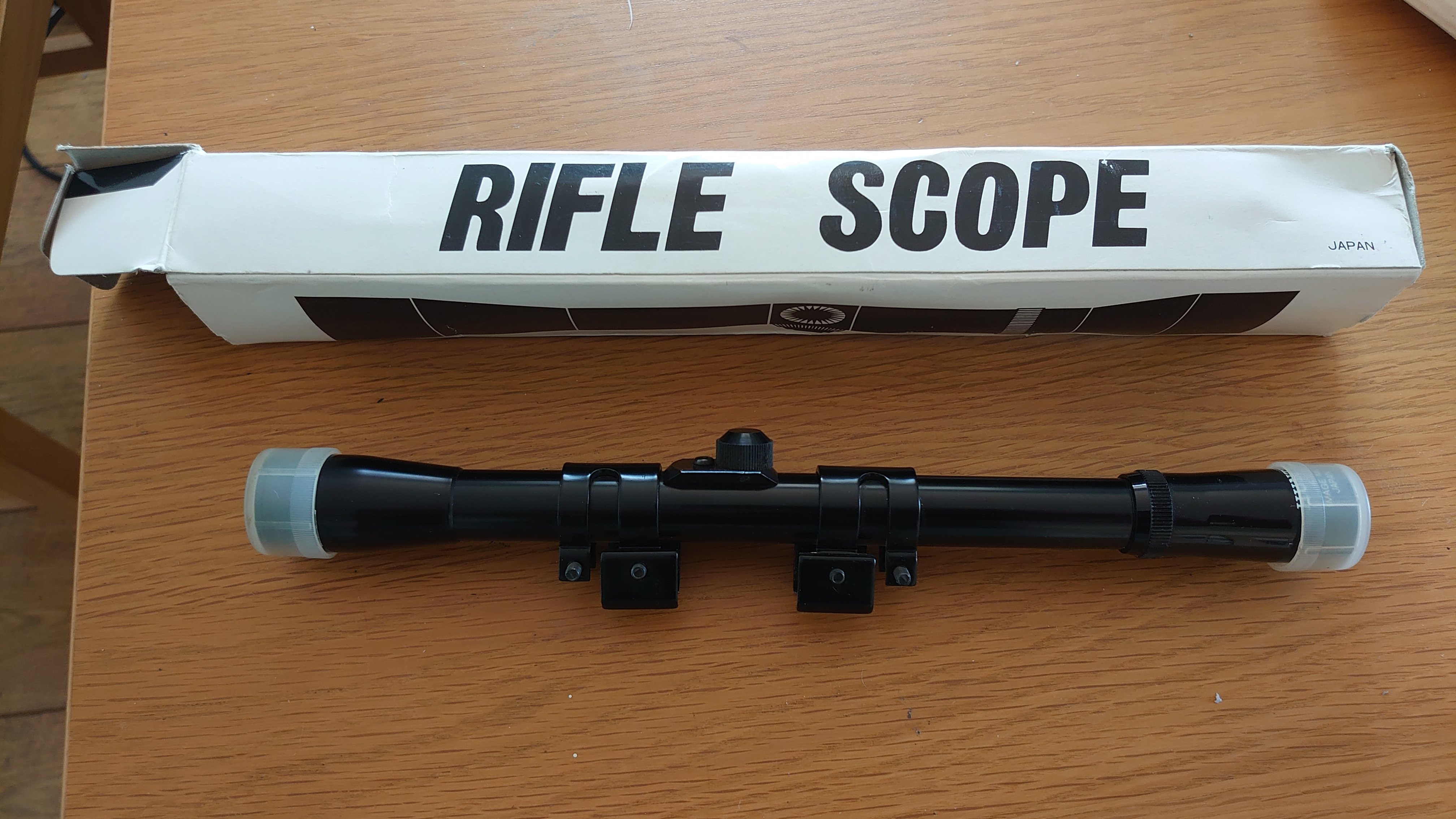

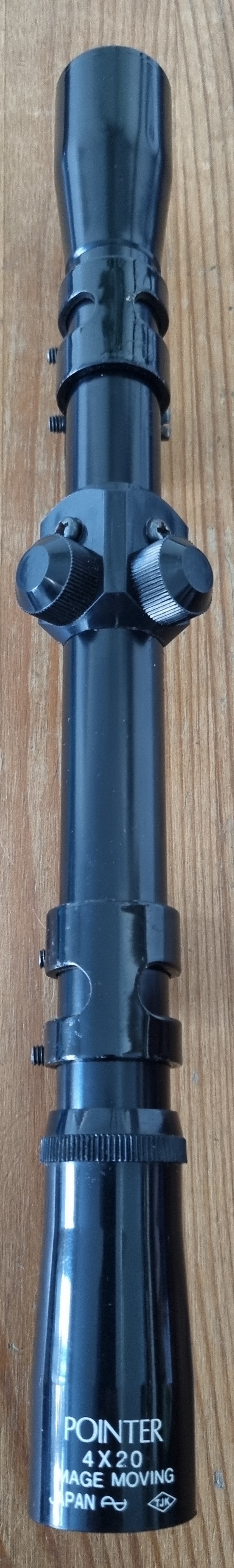

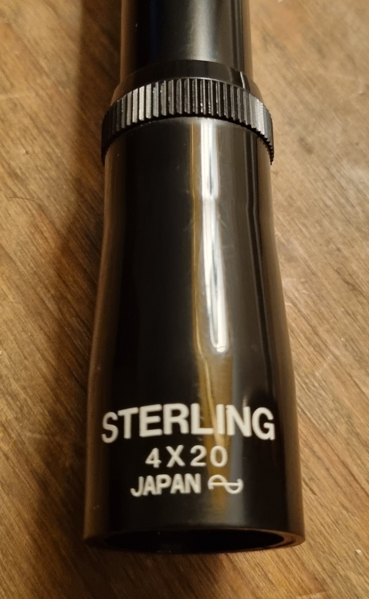

Hi all
what do you think?
Thank you

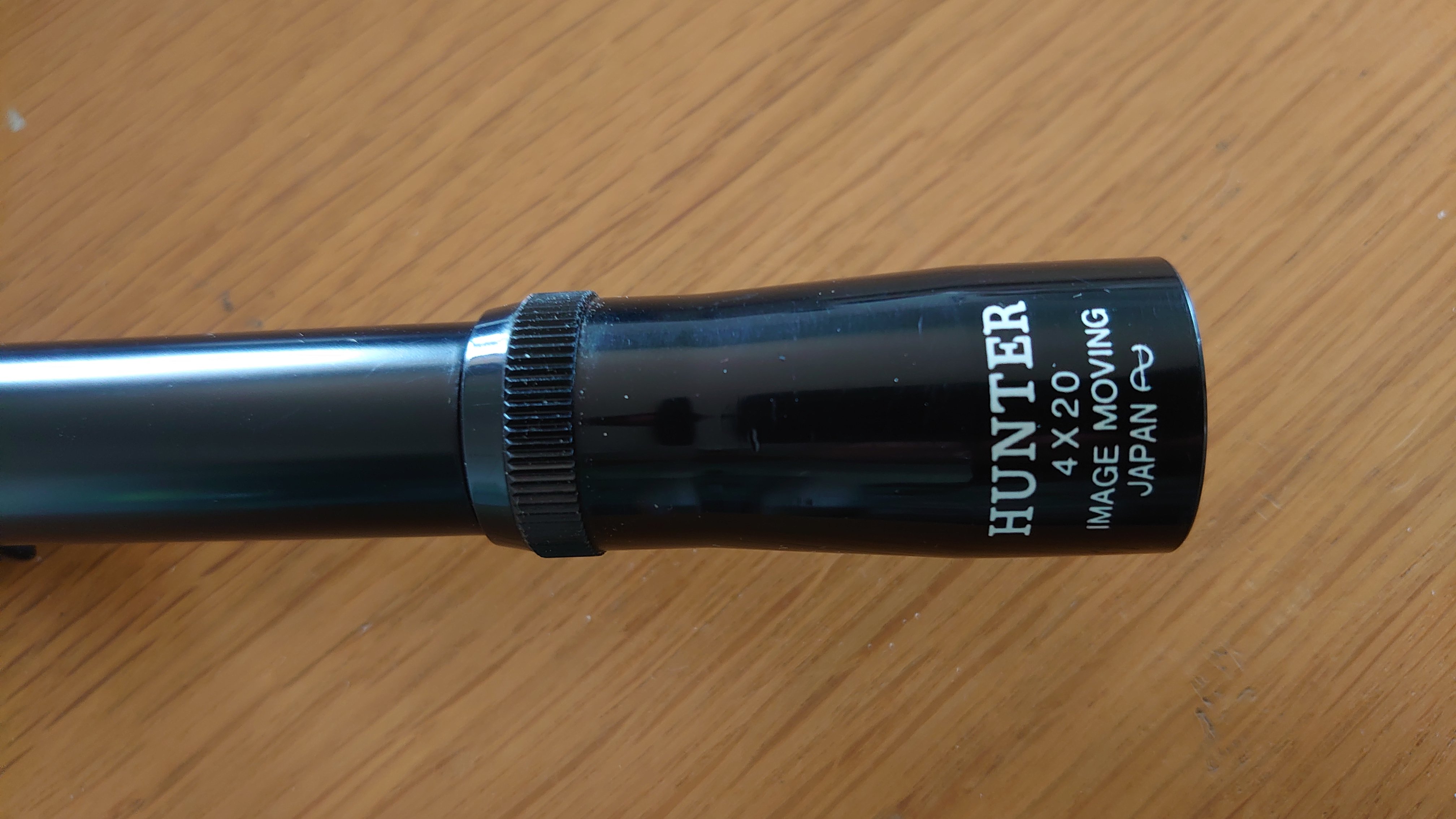

Hunter 4x20 Scope.
I’ve seen these in both type 2 and type 3. Hunter scopes come with Type A mounts. Difficult to find info on this brand due to the association of the word 'Hunter' with the word 'Scope'. I believe it is most likely that this is the brand used on the real props. See further down.
A Hunter 4x20 scope type 2 plastic eyepiece
A Hunter 4x20 scope type 3 plastic eyepiece (and inaccurate locking ring)
This scope belongs to Locitus and this photo is reproduced with kind permission of Mathias - cheers big man.
Hunter Scope with Original Mounts
A Hunter 4x20 original box

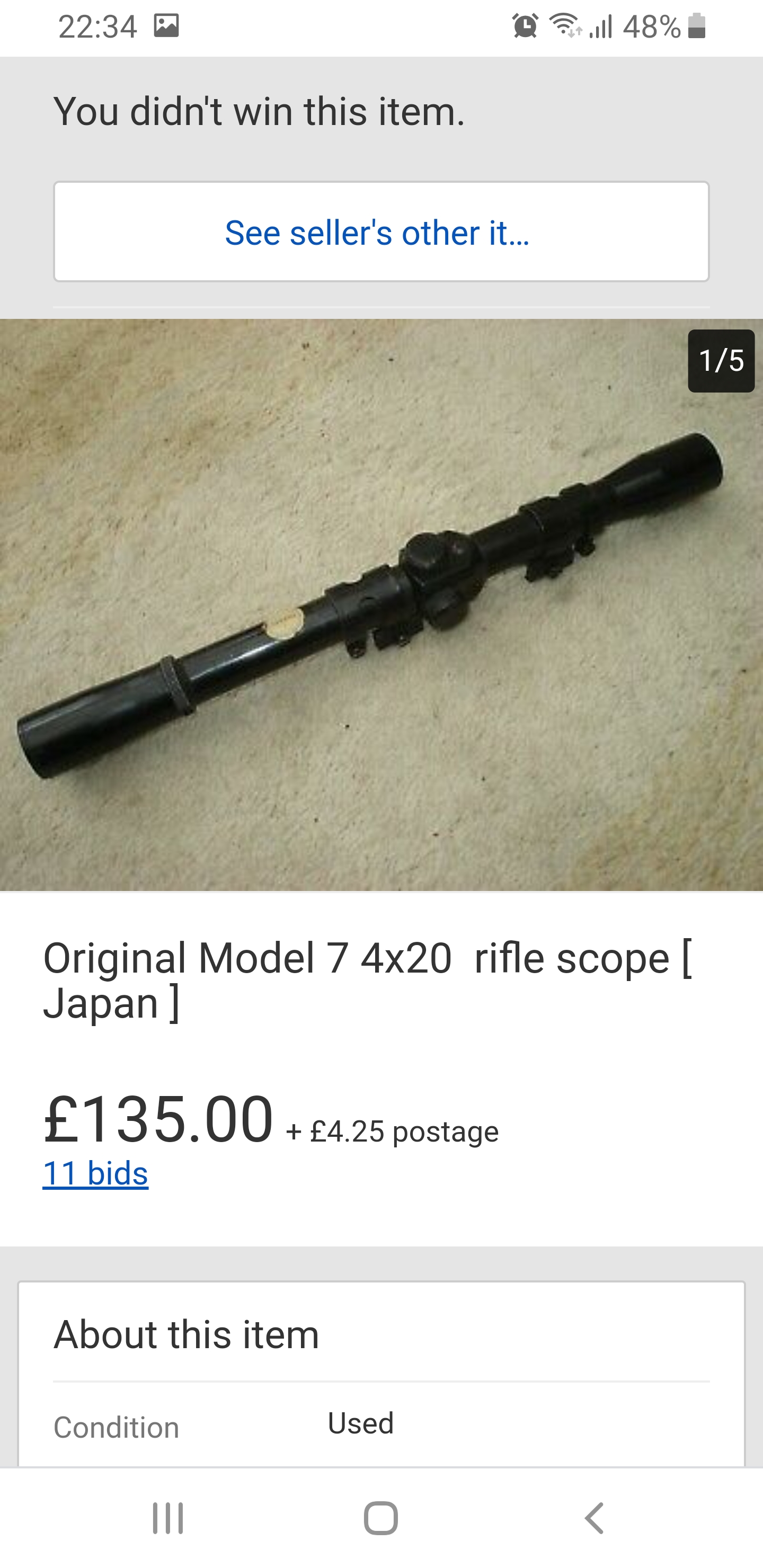

I was outbid on this today far before £135, i cant believe how much someone would pay for a scope, i saw a similar one last weekend for £25 but they had sold it and forgot to take it off website.

The model 7, as Marv says, is a Bowcaster scope. It is also found on the Evazan blaster. I did a similar thread for model 7s at the RPF. Most of the images have now gone but a shot in one of the last posts shows you what should be looking for with Model 7 scopes, and next to a Singlepoint.
The particular model 7 that you have pictured appears to be one of the rarer, and correct, models. The main tell is the locking ring, which is a straight, grooved, metal, ring with no tapered section. Assuming the proportions, and everything else is in order, I'll be amazed if you don't see that bad boy for sale at an inflated price at the RPF very soon. £200 - £250 and North would be my guess.
B0B4F3TT, word to the wise on prices, especially on prop forums where you might hope that everyone would have scruples - they don't. People will have little compunction making a few quid from knowingly selling on what they know is not what the buyer thinks it is; that was a primary motivating factor in the evolution of this thread.
Of course, many would say that it isn't the seller's fault if the buyer is ill informed. They might be correct, although I've little time for that attitude in what is supposed to be a collaborative community. On that basis, ebay is your best source for a really decent price. The last complete scope I saw was at the beginning of July. It sold for about thirty quid - Rhino brand. It looked in good order. A good price.
On one of these boards, around £100 is a still a fair price, £150 if it's an absolute peach. Any more than that and you're being stung. Found parts prices are out of hand - 6 grand for an MPP? I mean, come on...

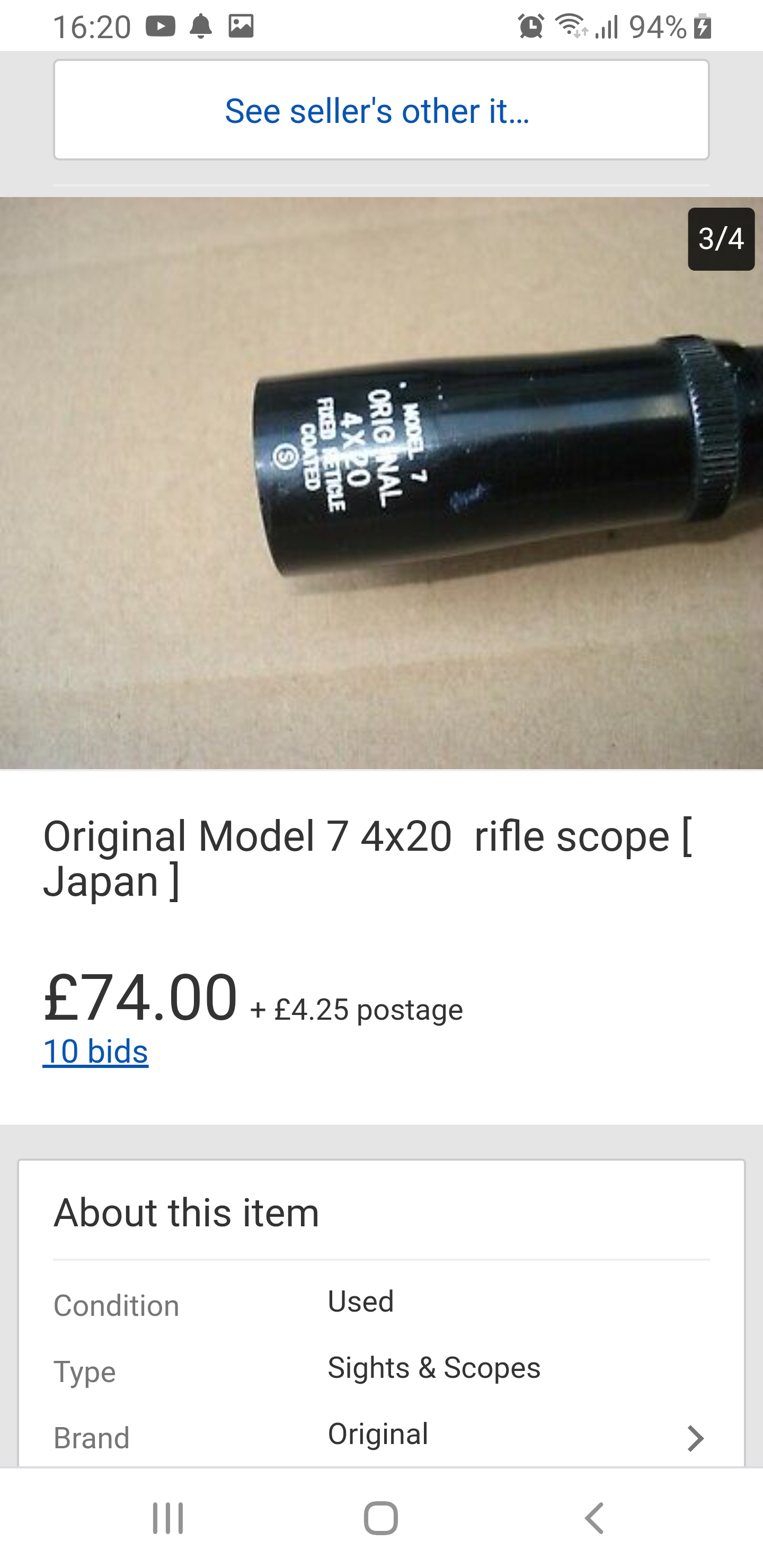

I just watched another model 7 go for £75 last night on ebay, not sure if exactly the same. I never knew they had so much value. Thanks for the heds up and look out for my future cargo bay listings for £200+. Only joking, its not in my nature to make money on people, especially the forum members, i think weve all spent enough already on our hobby without being stung by someone. Thanks for the info anyway, good to know.
A similar model 7, but not the same. The clear difference being the locking ring, although it will still be metal. The little tapering section wasn't on the first you posted. I didn't really look at the proportions between eyepiece and windage block, and between windage block and objective bell. Model 7s can be highly inconsistent in their proportions.
Now, assuming you can find one, you can mimic the look of the correct model 7 by swapping in one of the correct locking rings, however; a tiny screw in the thread on the scope tube of the tapered locking ring version it is being swapped into will prevent it from screwing all the way down. Small tells and small variations between models that the uber nerd will be able to discern.
The differences in Boba scopes/ASI variants are really very small in comparison. The biggest difference is that there are 20 different sets of brand markings. Other than that, they're remarkably consistent, and the differences are so small that hardly anyone will notice.
Well, that's 21. This one marked as 'Sterling'. It is not Nikko Stirling, because it is spelled differently. NS remains in the probable list because they make the 4x15 model of this scope.
This one came with the single piece 'type C' mount that is commonly featured on the Sussex, Webley, and so on.
First and only time I have seen this brand anywhere.

Interesting, ive had a few of these kinda scopes and never seen one spelled like that either.
Yeah, I don't think it's the same brand. I've had a couple of the NS scopes over the years, and Stirling has always been spelled with an I. Either way, it's 21. I'm sure there'll be a few more out there.

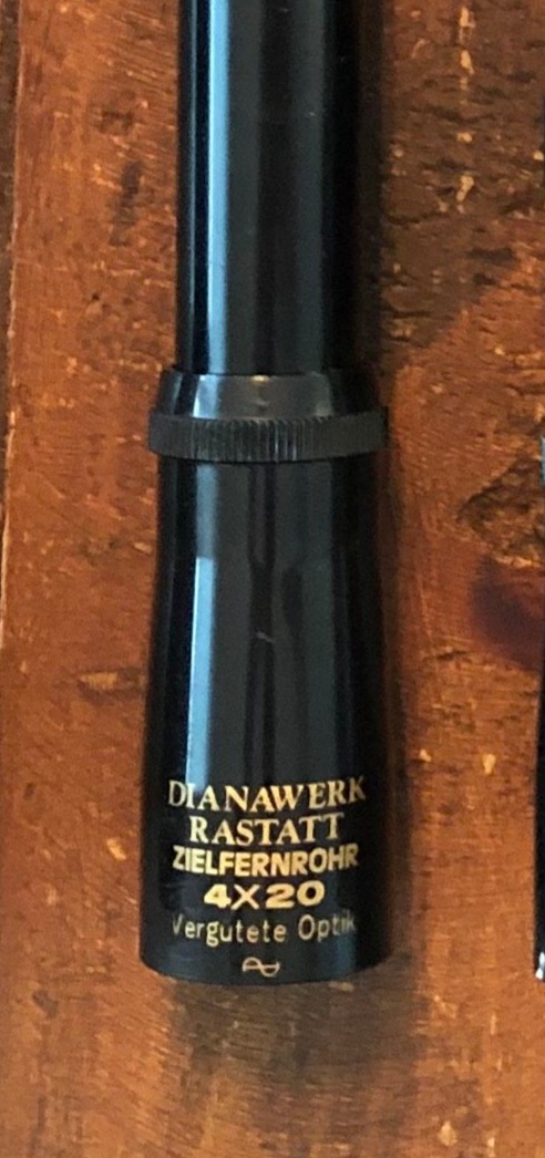

Well, thanks to bobasfett We are now at 22.
This is Dianawerk from Rastatt in Germany. Zienfernrohr simply means rifle scope.
Diana is the same brand as 'Original' and 'Diana Original', which is the Model 7 scope for bowcasters and whatnot. The branding on this particular scope means it would have been made after 1984.
Thanks Rob.
Pointer 4x20 Scope. This brings the tally to 23.

After years of saved eBay searches, I think I found my Holy Grail, and it didn't even come by African Swallow. Dirt cheap as well. So many times I've looked at scopes and gone through this list, but never thought I'd find a Hunter, even less a boxed one. Thank you so much for your work on this.
