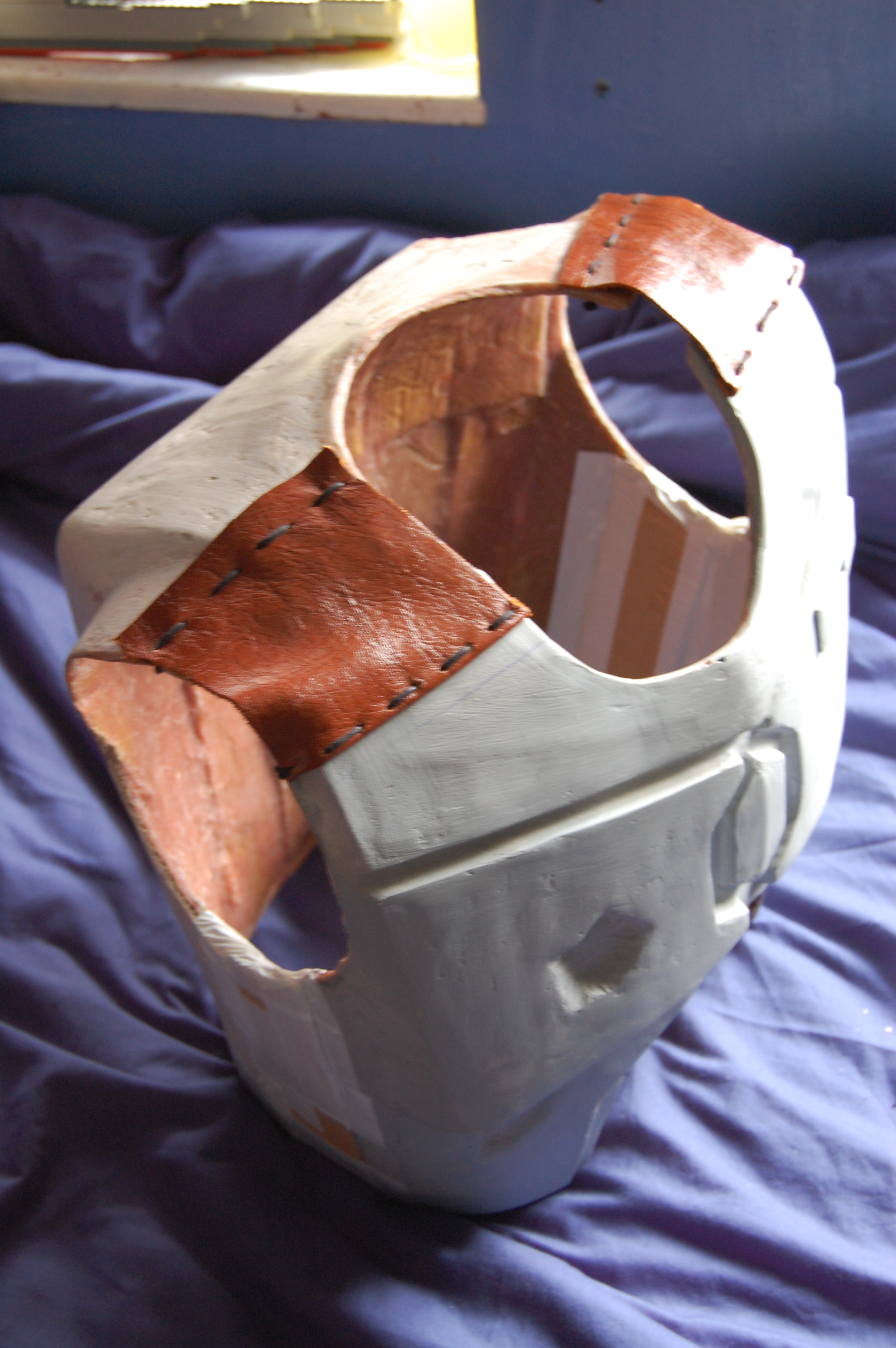

Found myself at a bit of a lose end this evening - rarity for me - but i seized the opportunity to work on my chest plate/back plate. I connected the front and back with leather tabs on the shoulders laced through the fiberglass plates, and tried it for a fit, only to find that it was a little tight and there were gaps where the plates did not sit flush.
Ive added spacers into the gaps, and taped both front and back together with the plan to fibreglass and filler over the join and then run a saw up both to give a clean straight join where they can be parted for wearing.
I'm really happy with the way it looks so far, and its really picking up on the clone commando vibe i was going for.

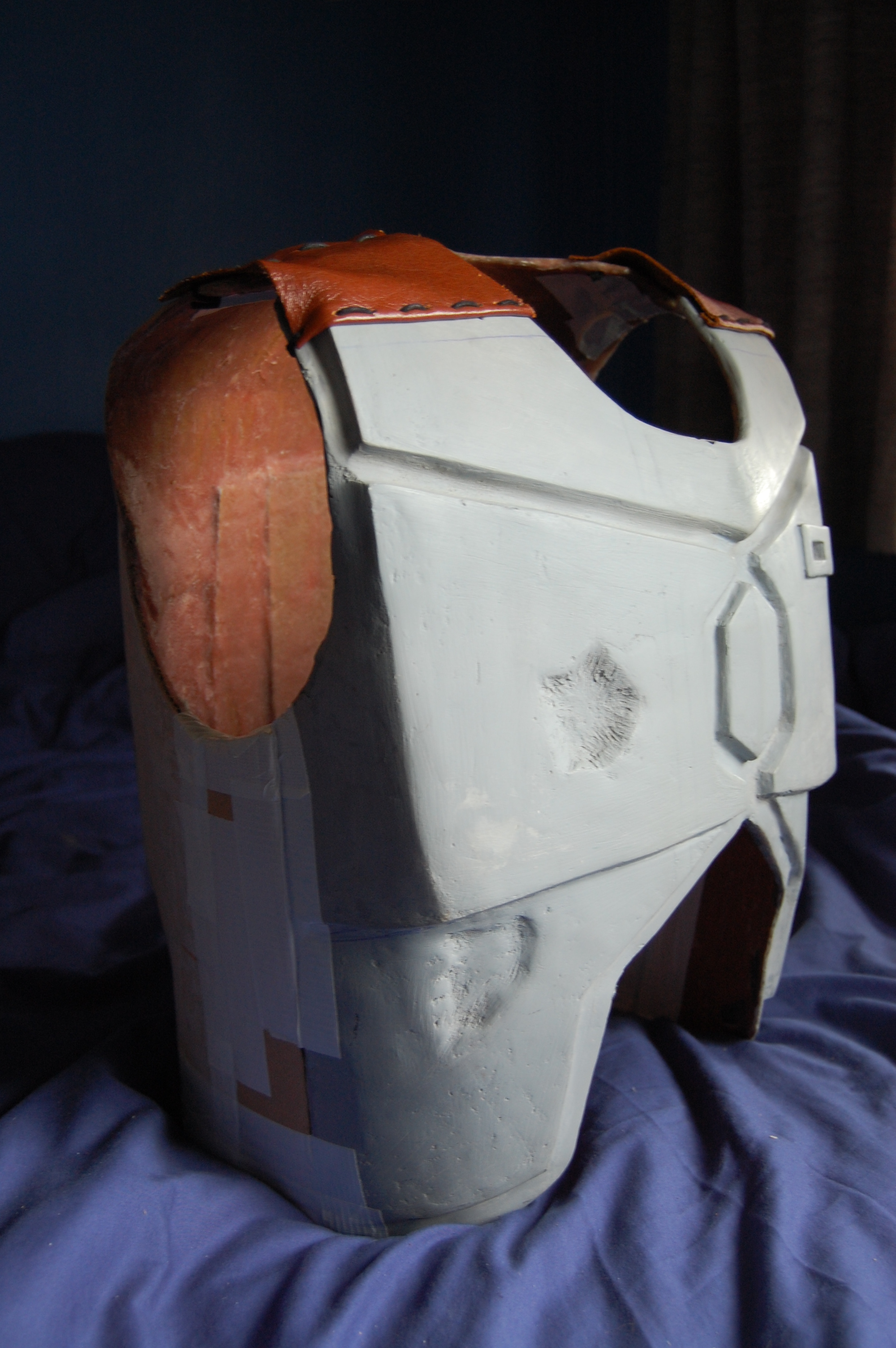

okay, here's the pictures as promised.
hopefully i will be able to get into my shed at some point over the next week and fibreglass the sides and get it sorted.

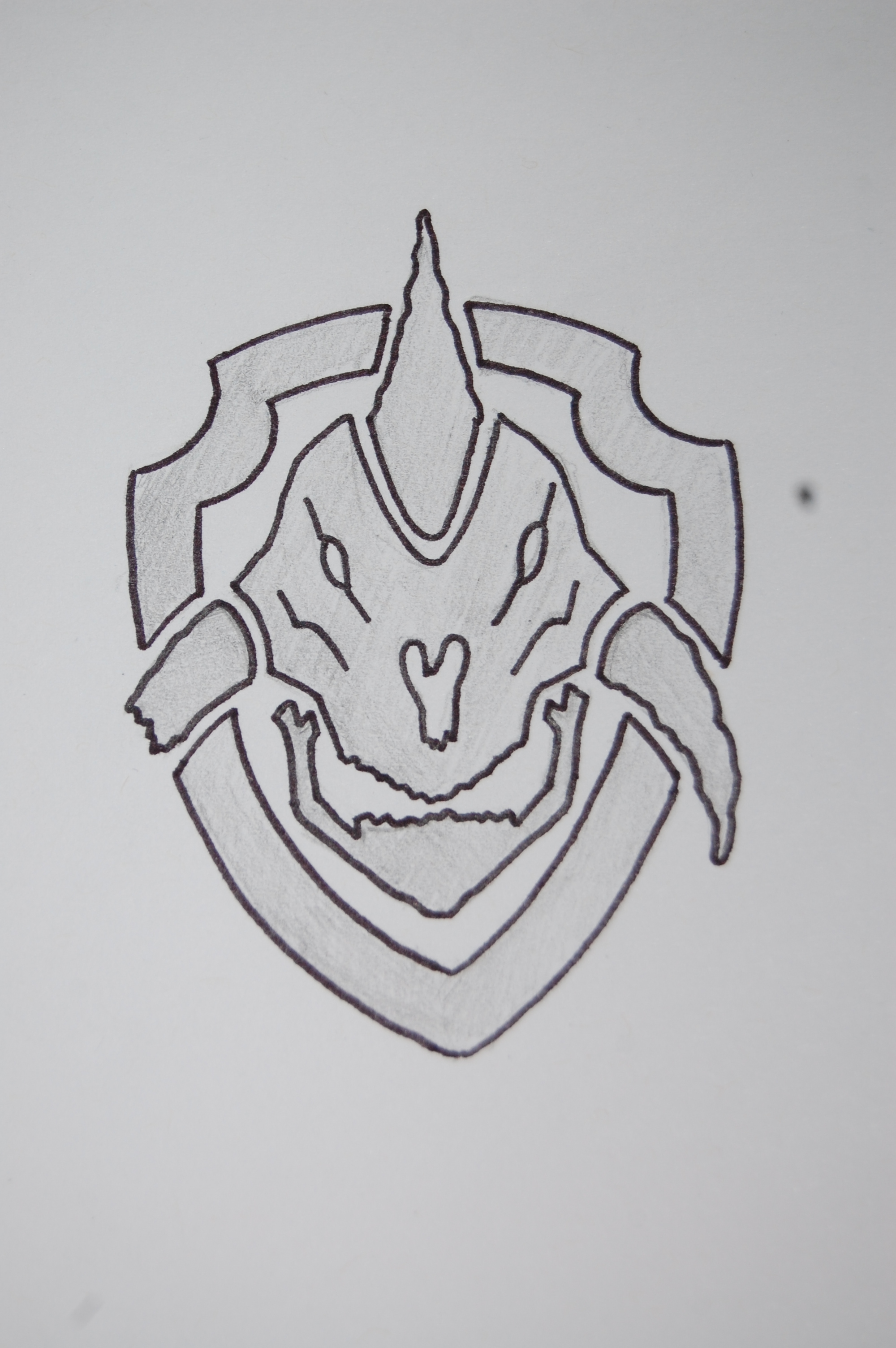

The thing i wanted to share with you all now though was the new insignia that i have designed for the right shoulder plate. As some of you may be aware if you have read the stories that i have written, you will know that my Mando was adopted by Kyr'am Galaar, an old mando member of the Blood Reek clan. The first version of the emblem was rubbish, i know that now. The second one was a lot better, but it was still missing something, so over the weekend i did a little bit of tinkering with it, and came up with this:
Let me know what you think

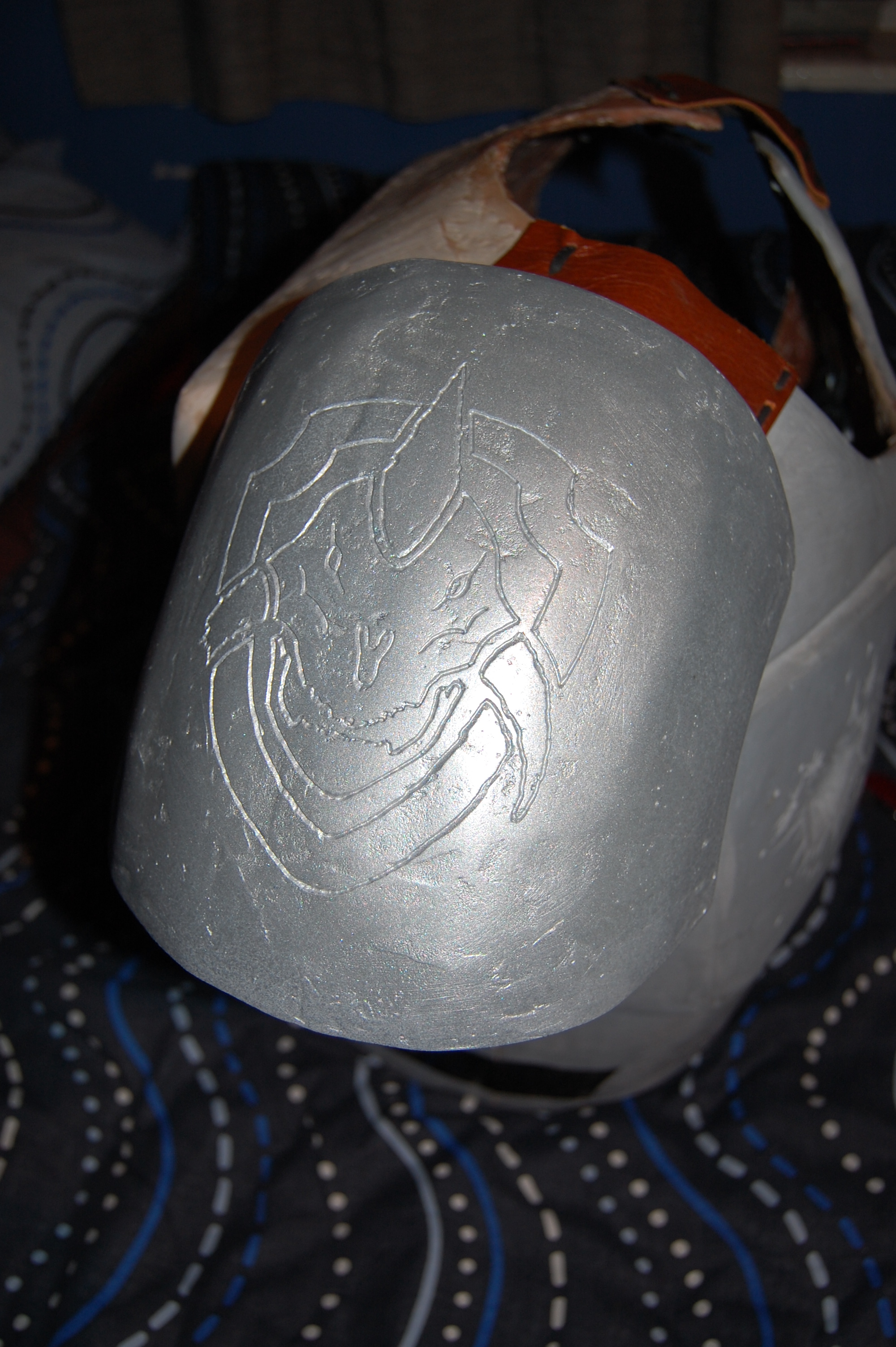

The fibreglass on the shoulder set and i gave it a layer of filler after to start smoothing it out. It will probably take another layer, but im not going to be too picky with it. I want it to still look like it has been cast, so not going all out for smoothness. Going to leave a few bits to look like the metal has pitted and worn. i think it will look better that way.
Im going to carve the clan emblem into the actual shoulder though, instead of having it painted. Once the rest of the paint is on, i will give it a wash of black and wipe it off, hopefully just leaving the black in the grooves and making it stand out a little more.

Shoulder piece is fillered, sanded, and the clan logo is carved into the plate. It has been fitted with a popper and it now attaches to the chest plate which looks awesome.

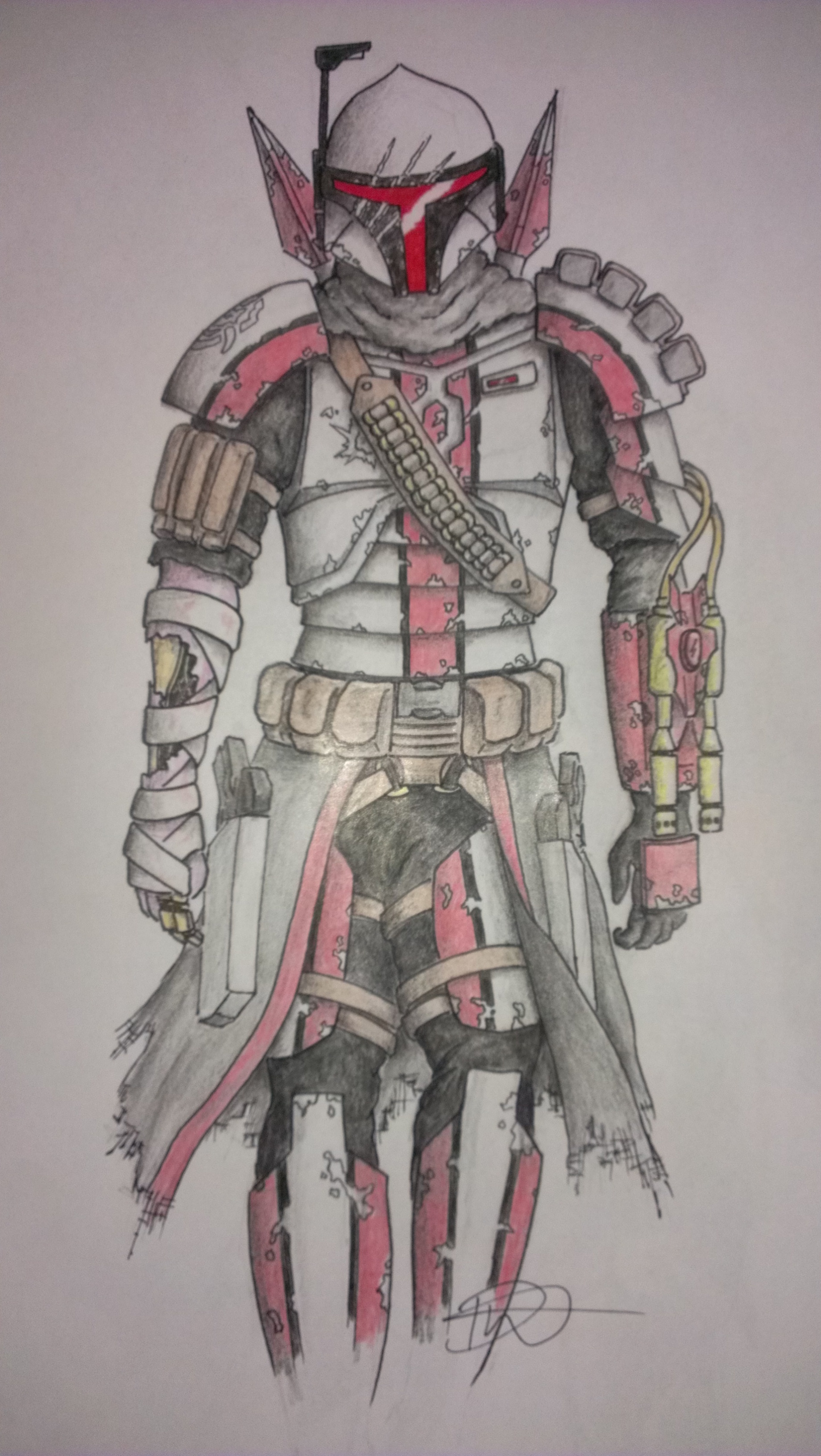

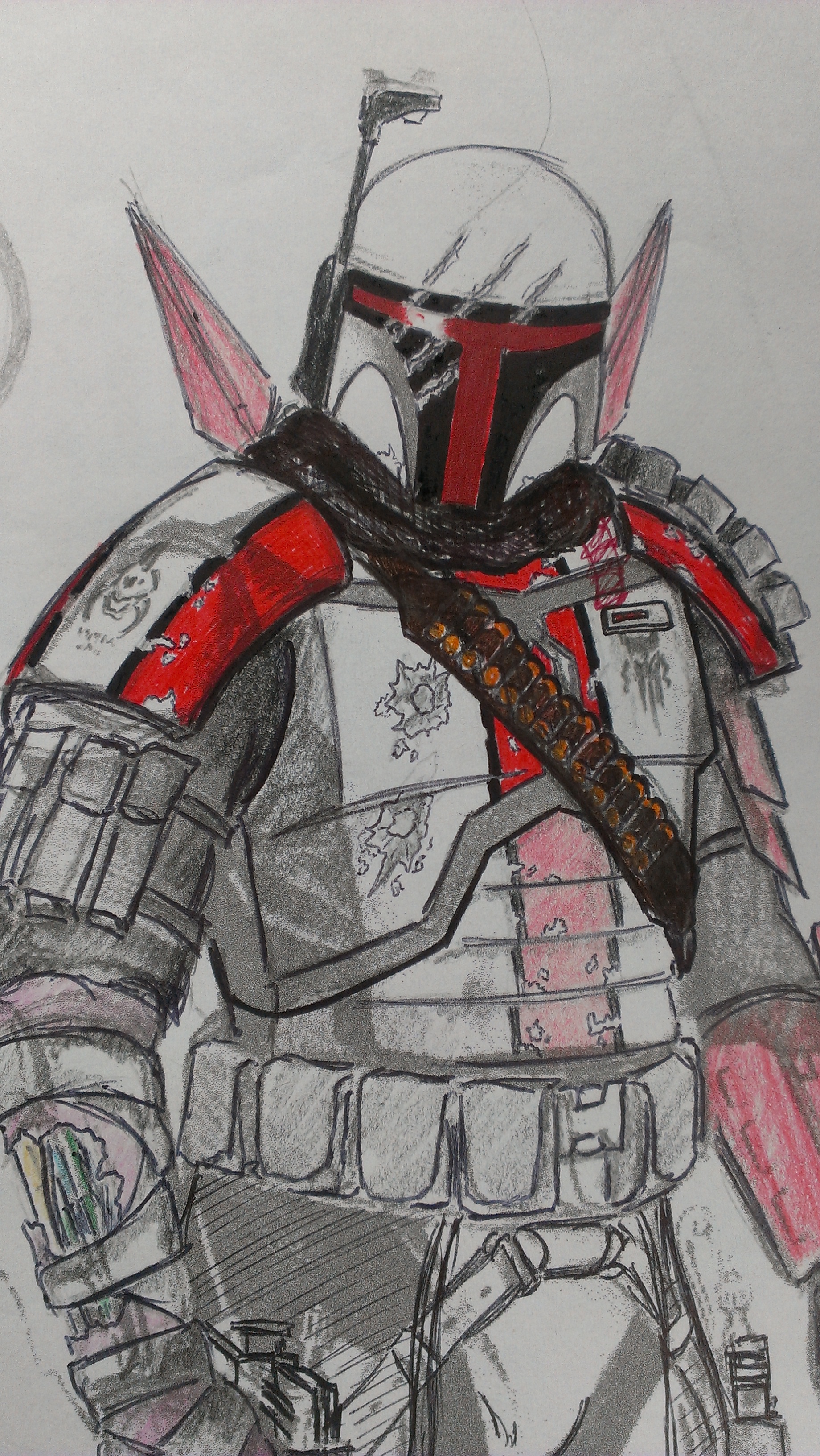

as promised, here are the concept doodles i have been working on. it shows the mods im hoping to make to the kit. nothing structural, just some additions to make it look bulkier (which is the look im going for... a walking TANK)
Ive added the weapons belt across the chest because it was looking a little bare. I know i had the paint work there and the raised panels but it still felt like it needed something. And the hood has two uses: one, it looks really good, and two, it hides the neck. it looked too open before.
I have also reinstated the thigh plates, but i still dont like the cod piece.
your thoughts would be appreciated.

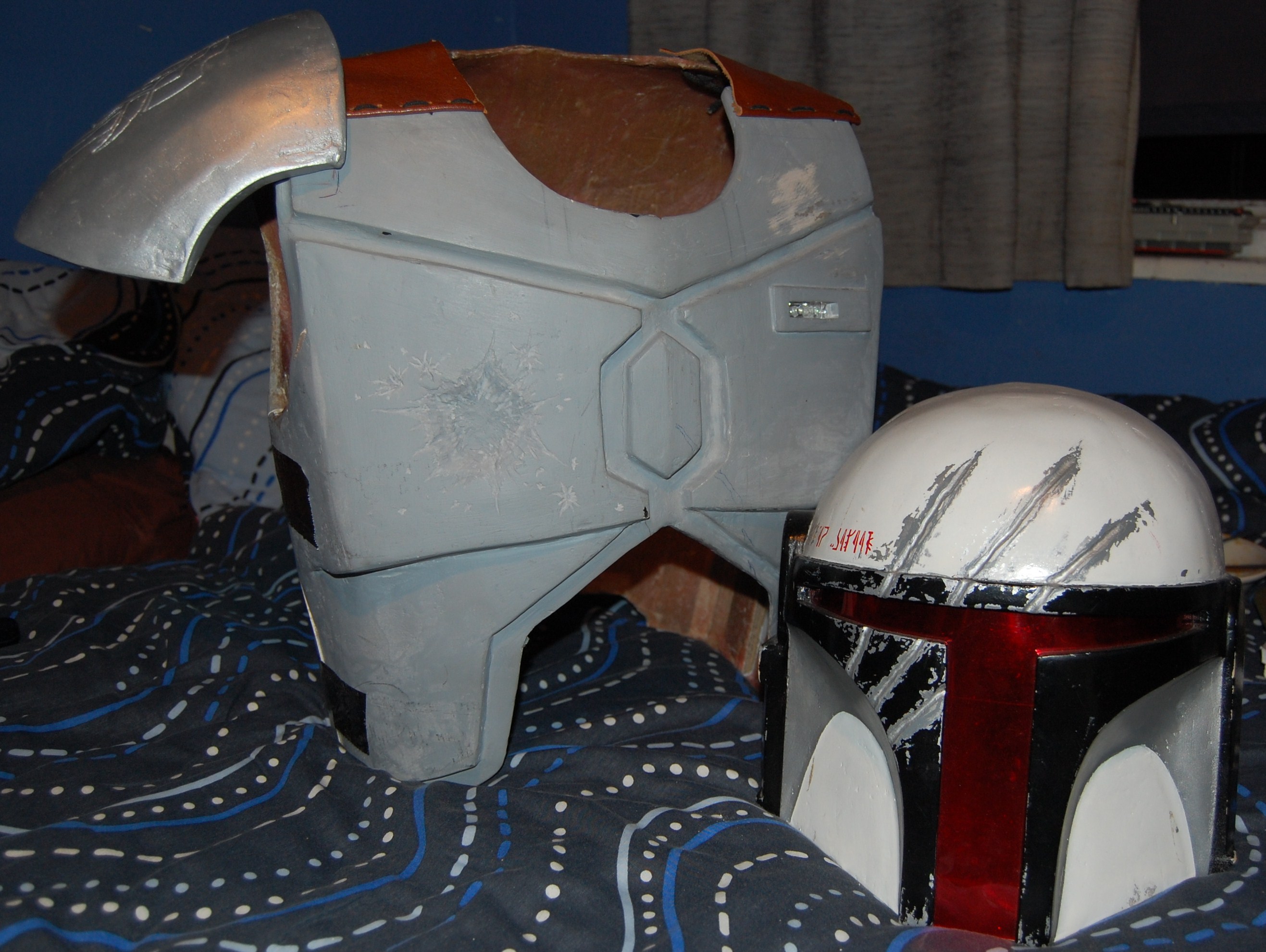

okay, long time no posting and very little progress. the armour as it stands now (chest plate, back plate, right shoulder and helmet) has been sat at the end of my bed for nearly three months with no actual sign of work. it sucks and it is totally disheartening to be faced with it every day.
but today, i felt like i made some kind of progress, and tomorrow i hope to put the plan into action.

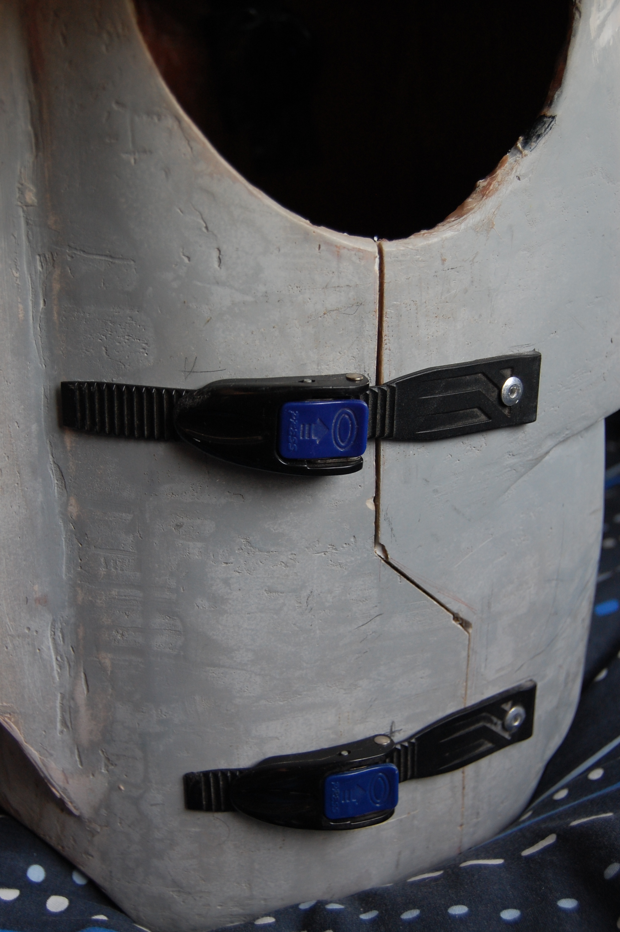

The chest plate and back plate hinge, and i needed a way to secure them together. i found some old roller blades and the clasps on them would work great. so tomorrow i am going to dismantle them and see what i can do with them.
As for now, i do have more concept pictures of other mandos (on another thread i think) and i have a few pictures of how my armour stands now.
any comments/feedback/input always welcome :)
heres something for you all!!! managed to get a few hours in the shed these past two days and made some progress.
the issue with closing the chest plate and back plate together has been solved using some catches from some old roller blades i had. nabbed the catches and installed them to the sides.
Also started work on the left side shoulder plate. its a bit rough and ready and need smoothing out, but im happy with the shape.
so here it is, test fitted!!
hope you like it! feedback welcome

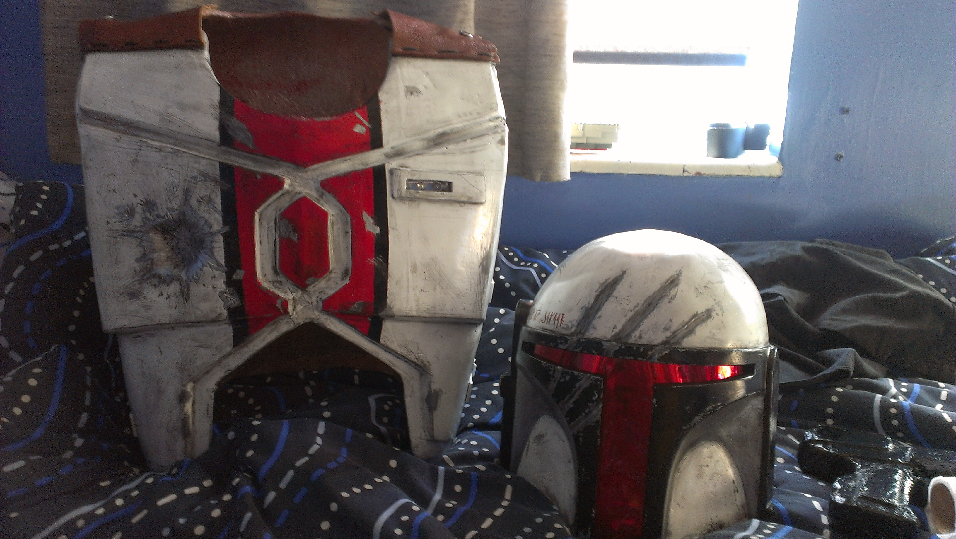

so after a few days of grabbing whatever time i can to work on my armour, i have some incredible news!!!

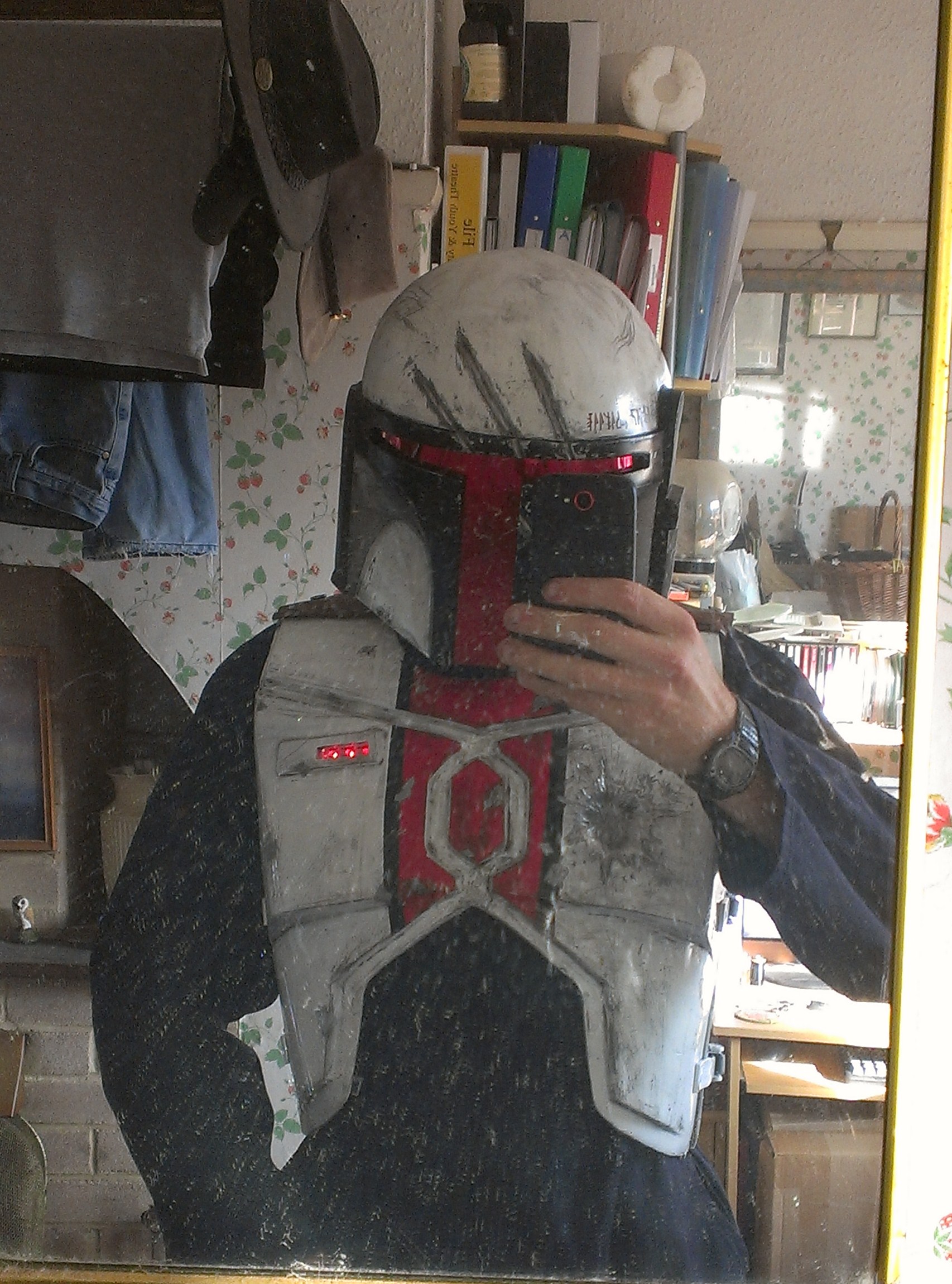

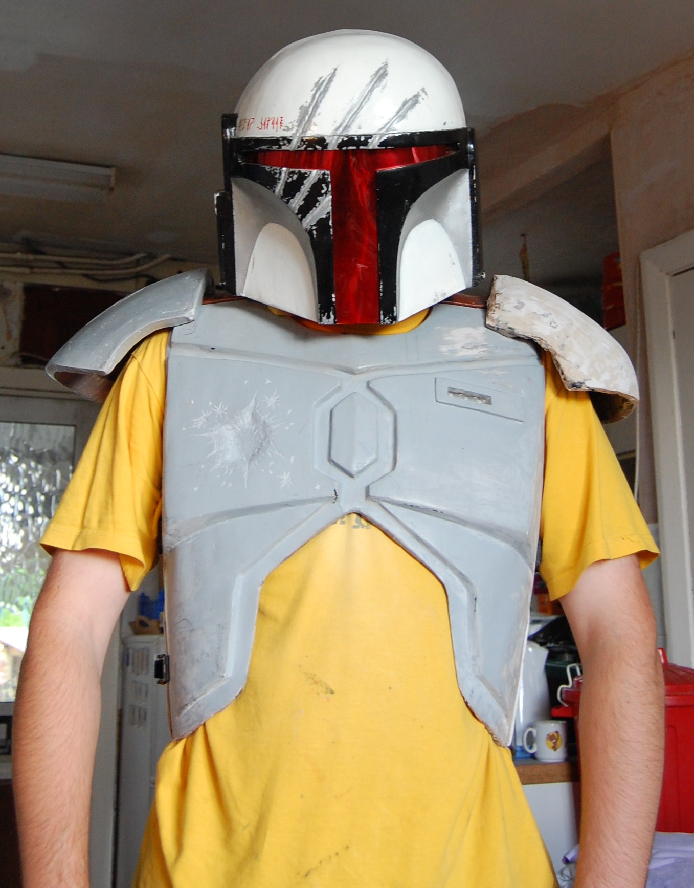

catches worked a treat on the chest and back plate, and after a bit of a rushed paint job followed by the classic weathering technique of acrylic paint and window cleaner brushed on and wiped off (to both helmet and chest plate) i would like to show you all this....

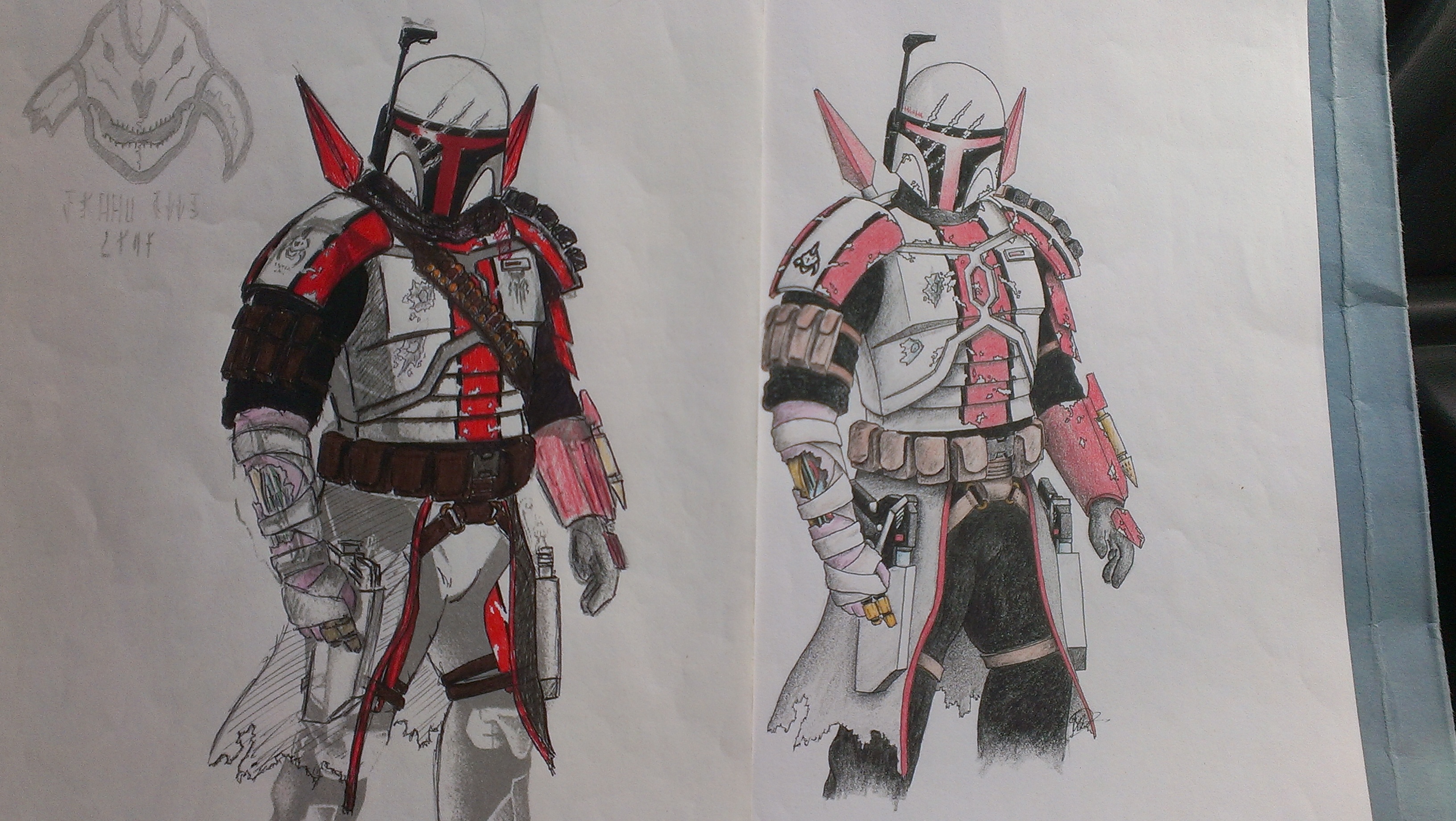

This is the updated and final plan for the armour, which i drew a few months ago and made a decision to not change it ever again!!! (already had 7 versions previous to this one)
Me wearing the armour...
side by side views.
would have painted the shoulders as well, but unfortunately i ran out of red spray paint.
Hope you all like it Vod!!!!

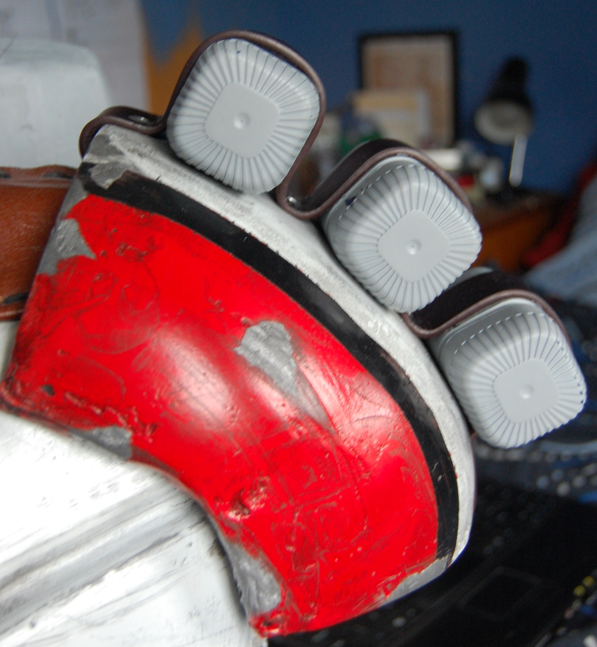

i have managed to find an old plastic bin to make the belly plates out of, have riveted them to some old seat belts and installed them on the chest plate. it all clips together brilliantly thanks to the salvaged roller blade clips, and ive been trying it out whenever i can to make sure its not too uncomfortable. its a snug fit, but it feels great.
also managed to get the "explosives" done for the left shoulder. still need to paint them up properly with grey spraypaint, but thats more an aquisition of paint issue!
anyway, heres the pictures.
hope you like them
