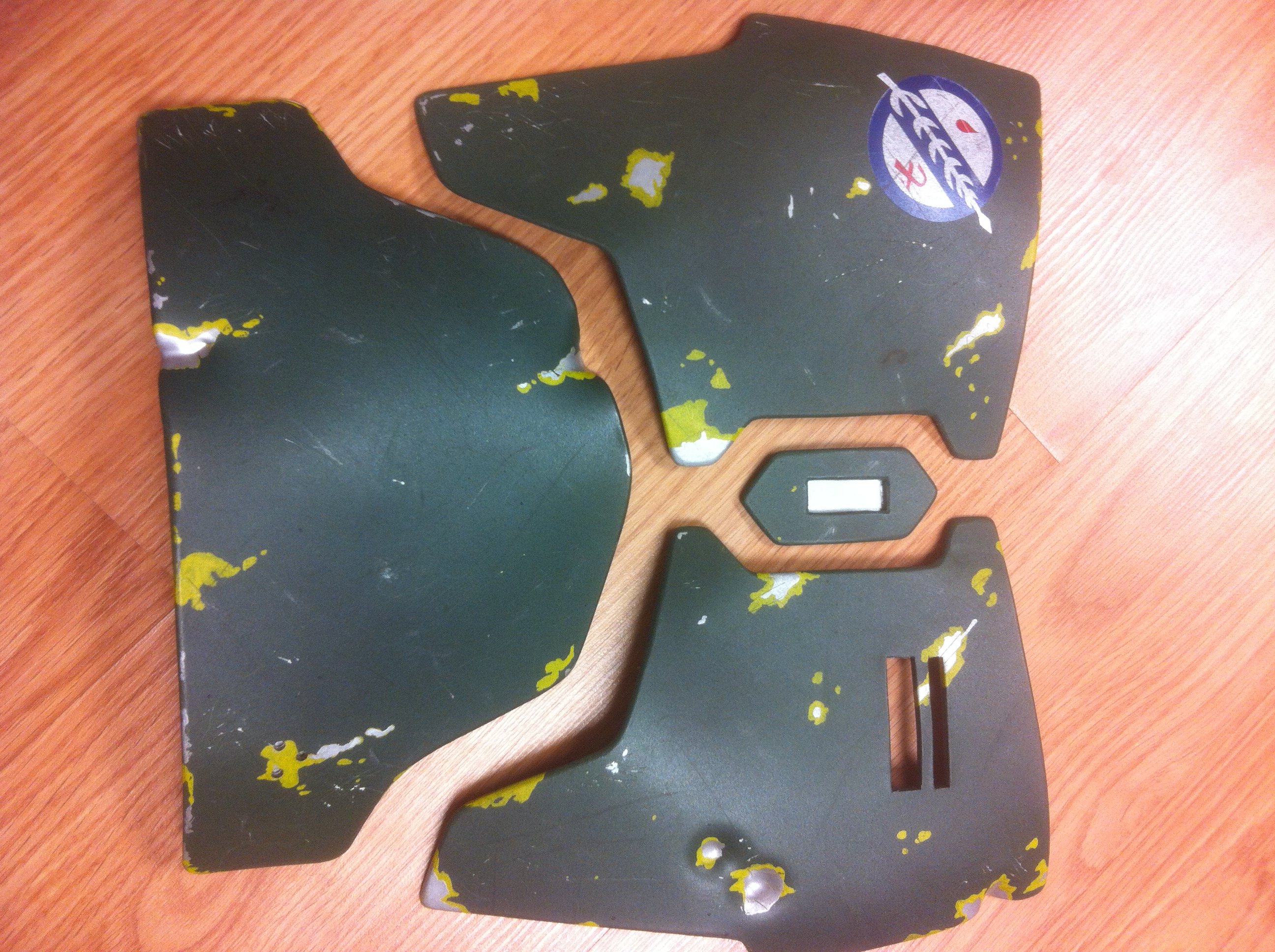

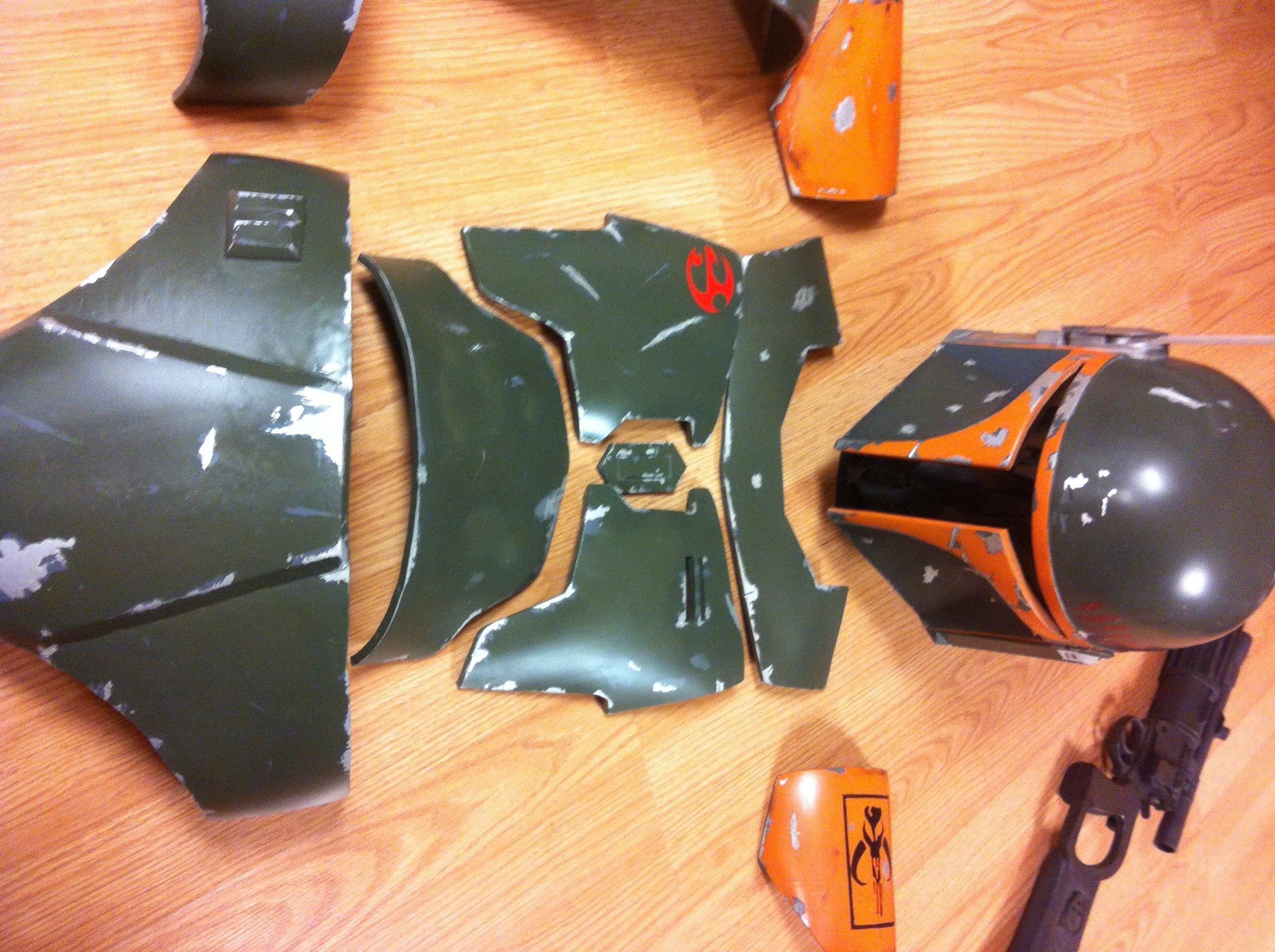

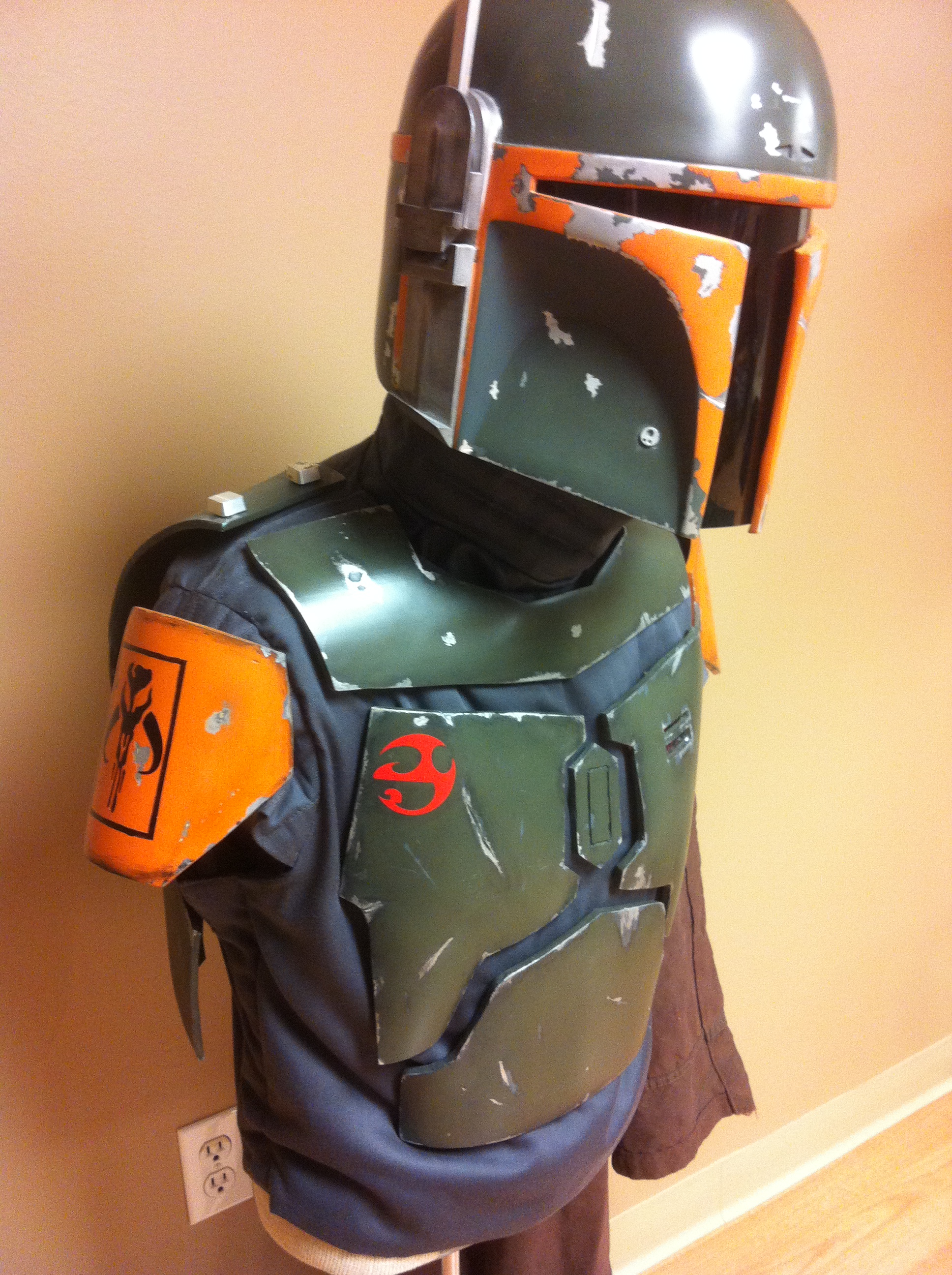

Seeing as I didn't want to repaint over the Boba paint scheme for the armor and fill in the dents, I decided I was going to make my own based off of the WOF templates and my set of Cruzer Jango armor. I wanted to use something sturdy, and I have had absolutely idea how to lay fiberglass out so I grabbed some old PVC pipe that was laying around my house and began to cut away with a my dremel tool.
This picture is the Boba armor

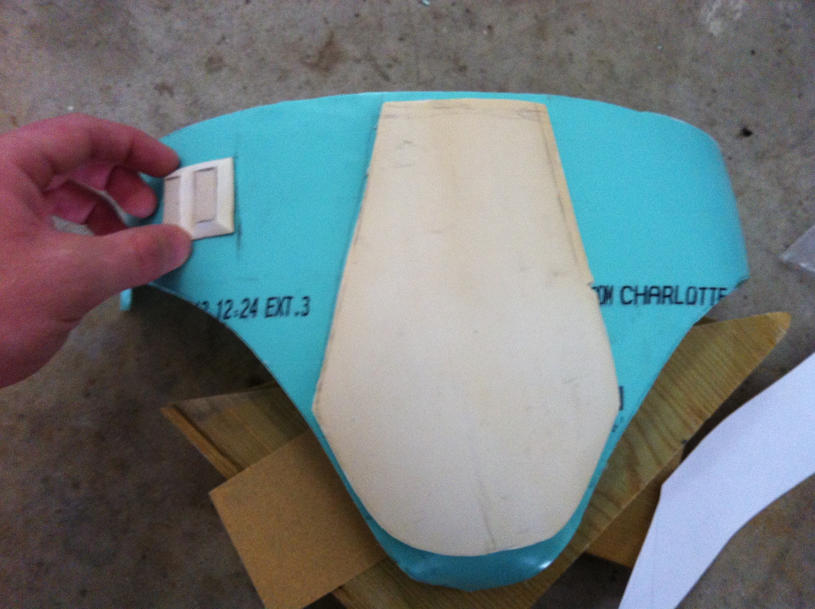

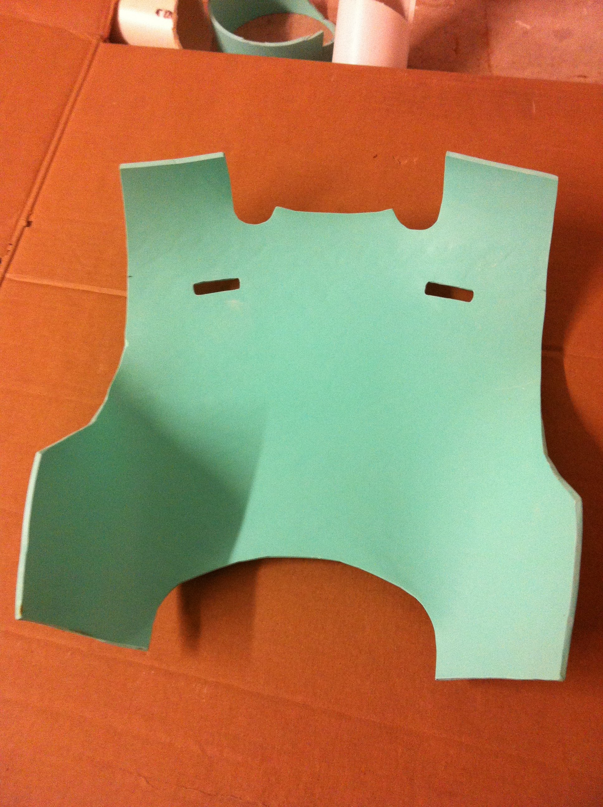

And this is the rough cut of the front plates.
luckily I just happen to be the size of my half mannequin that I own, so I was able to shape the pieces without having to figure out how I was going to do that by myself...

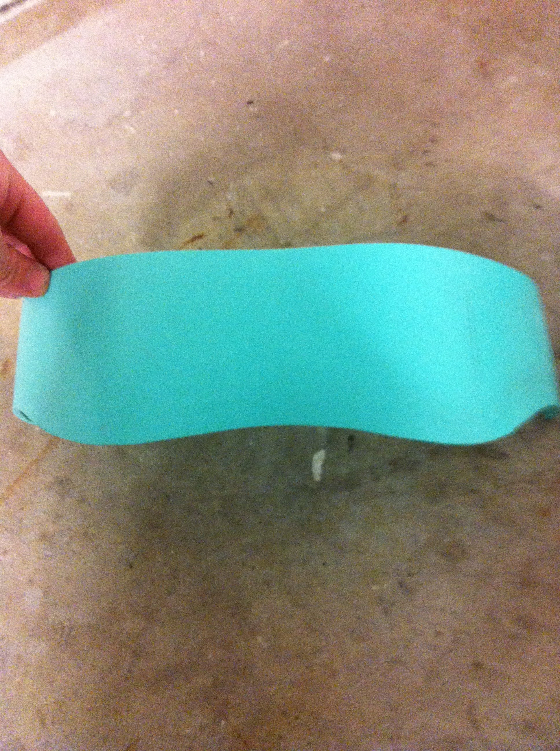

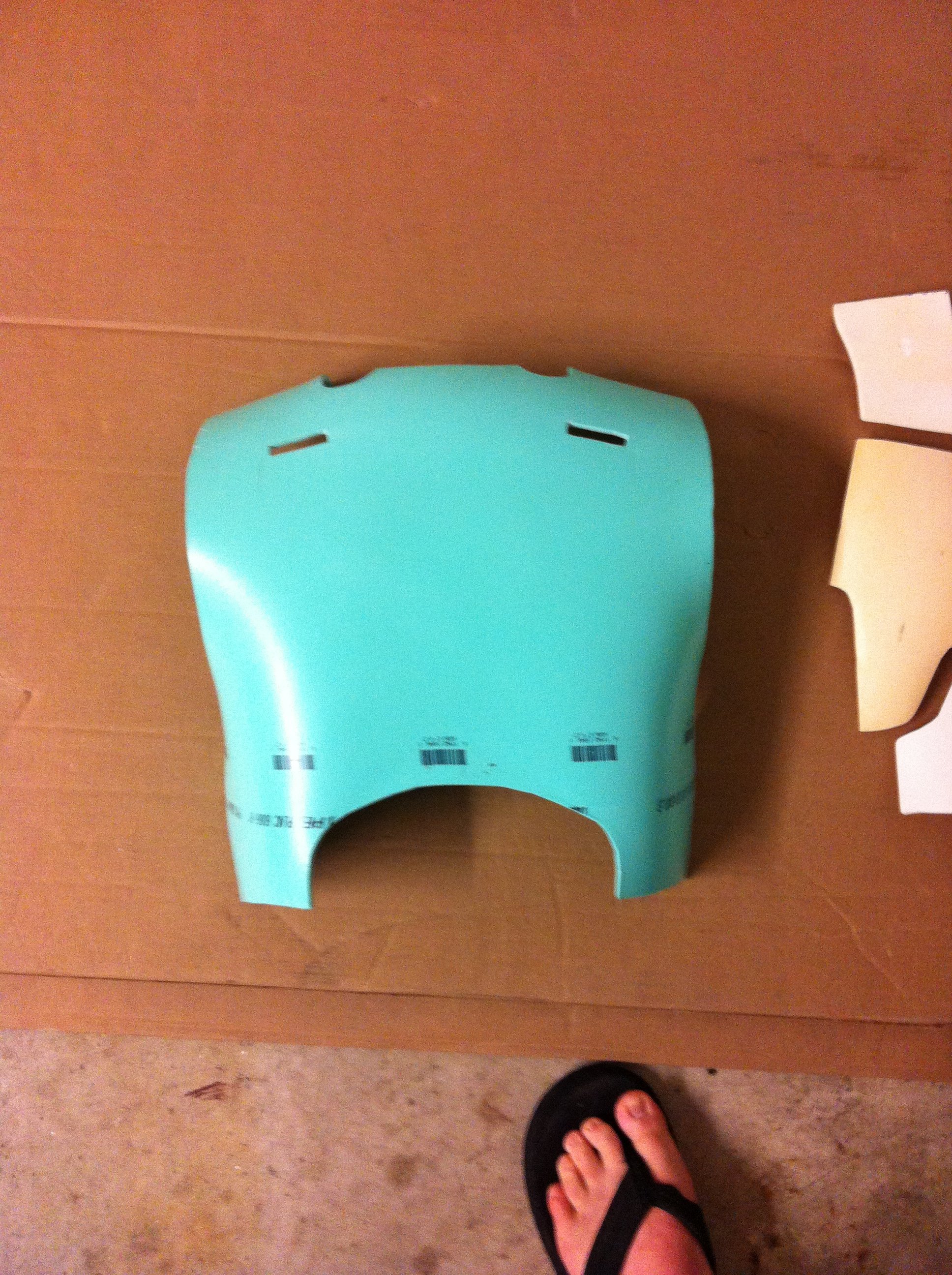

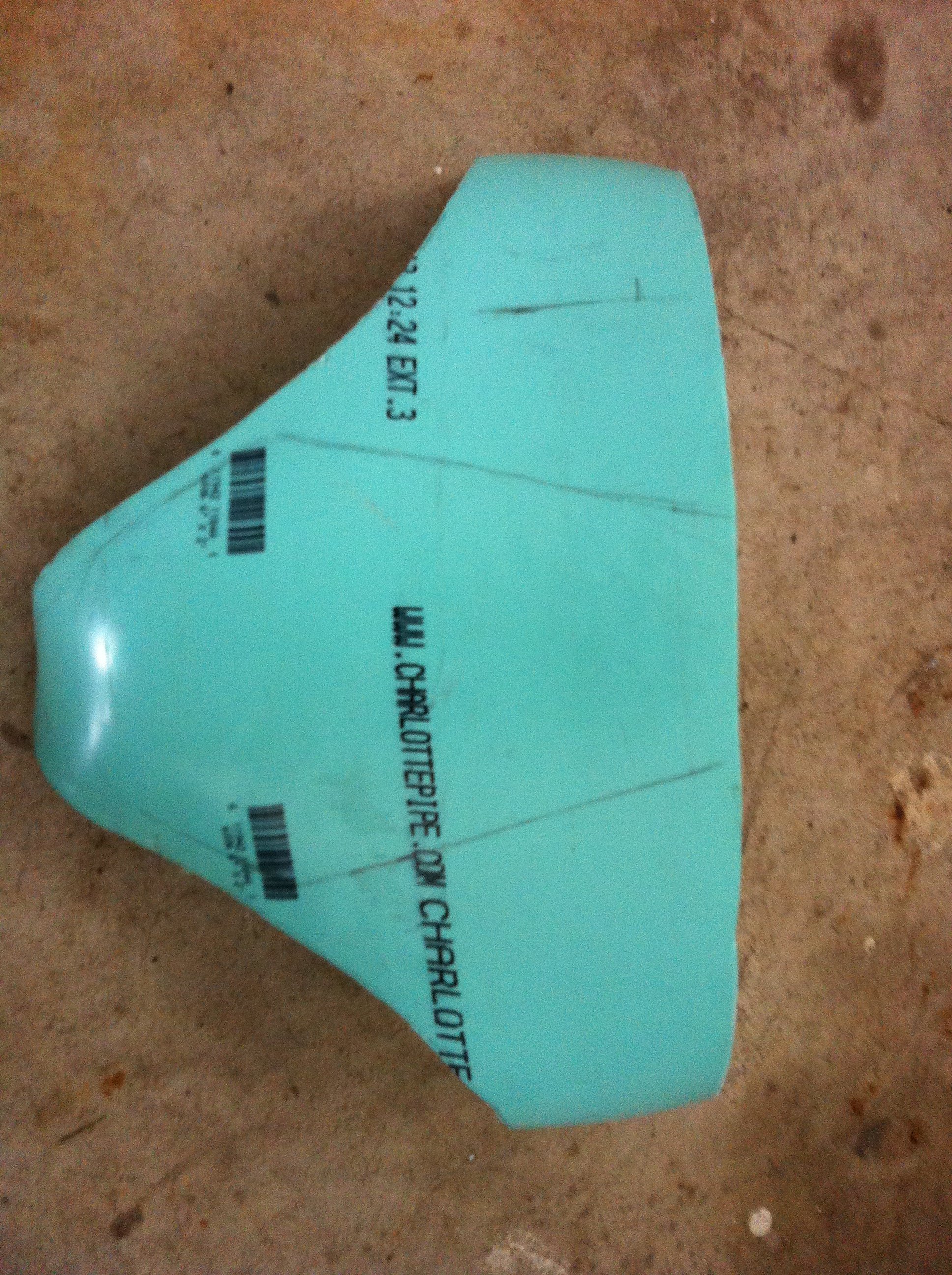

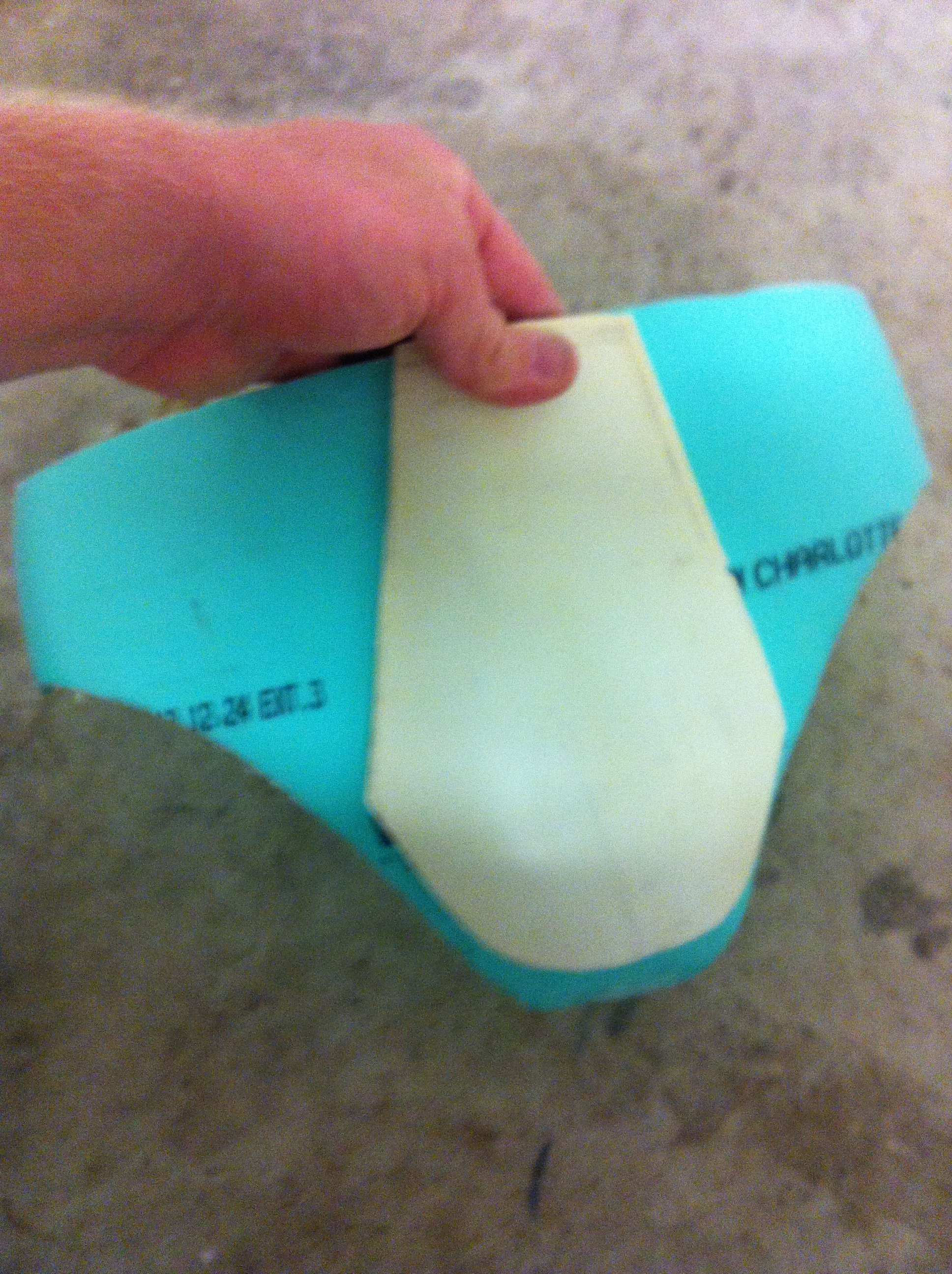

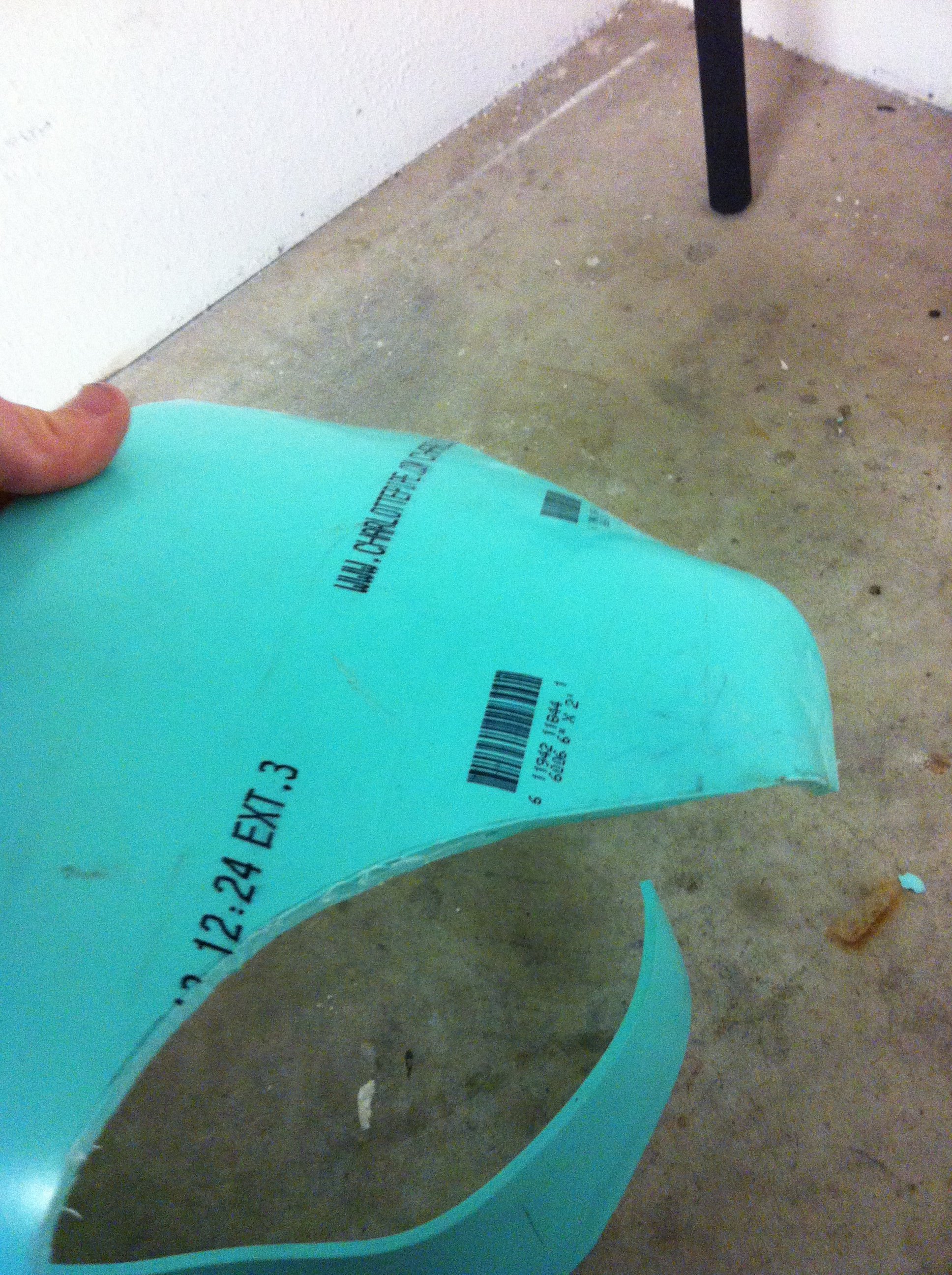

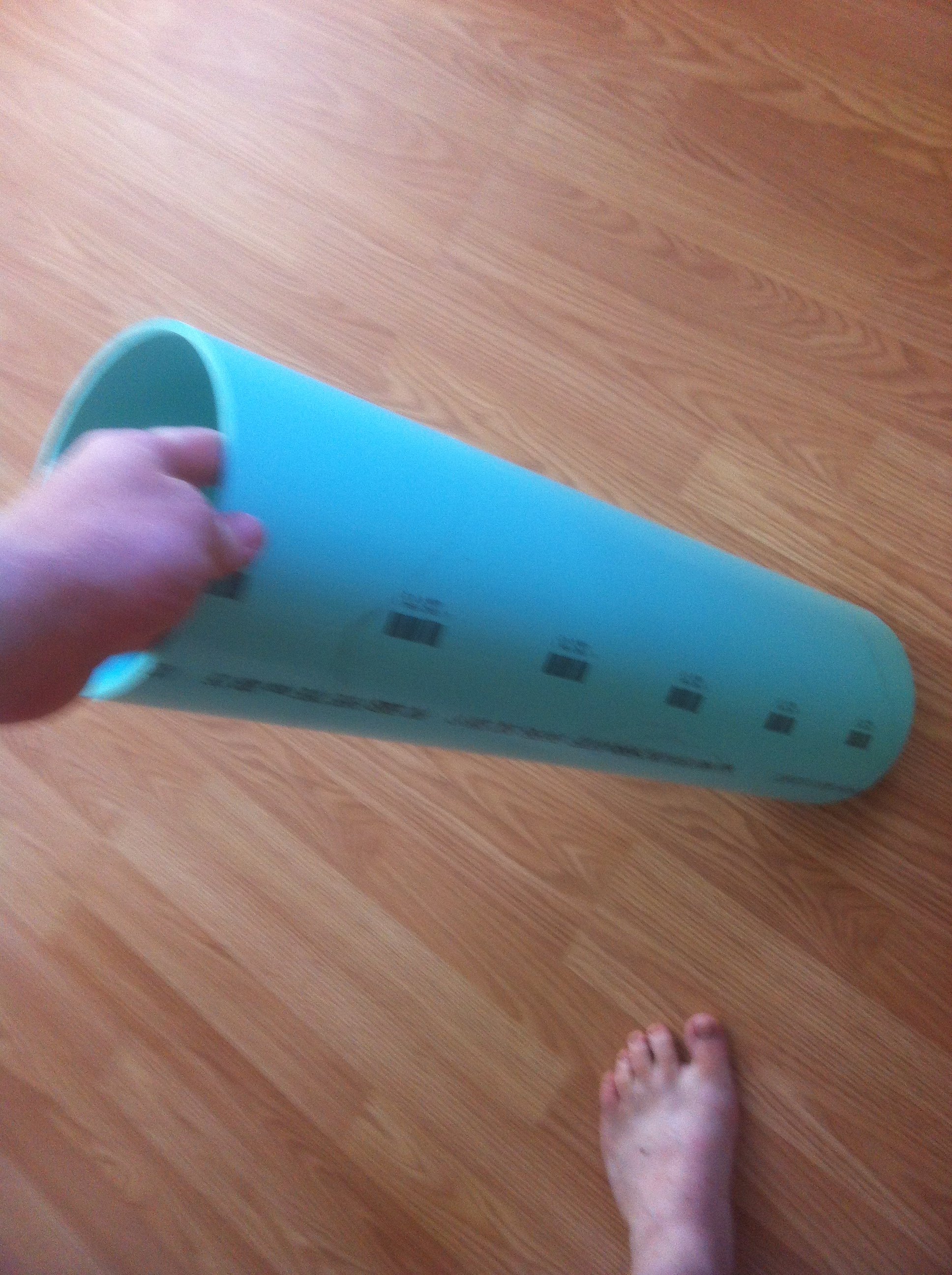

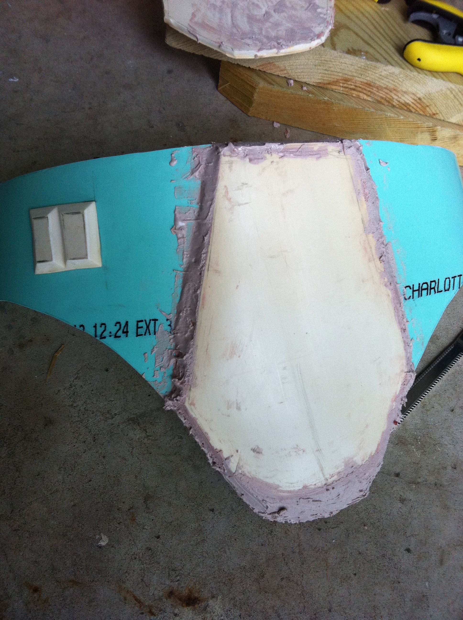

So after some trial and tribulation I was able to finally crank out 1 backplate from the pipe. (I can tell you if you do it by yourself it makes it infinitely harder than with an extra set of hands). So here is the finished product.
I couldnt get the edges as sharp as I had wanted on the lower fins, but they still turned out pretty decent IMO so I can't complain to much.

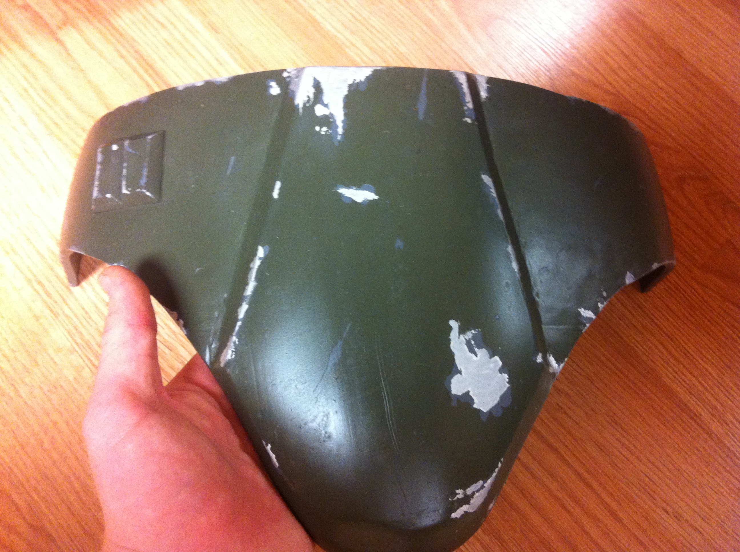

I also had a little bit left over from the original pipe so I decided I would cut out the butt plate and codpiece as well.
And here is the little button greeble on the right side also cut out of some leftover pvc pipe using a dremel tool
Here is what it should (I use that term losely) look like once I bondo the edges to make a smooth edge.

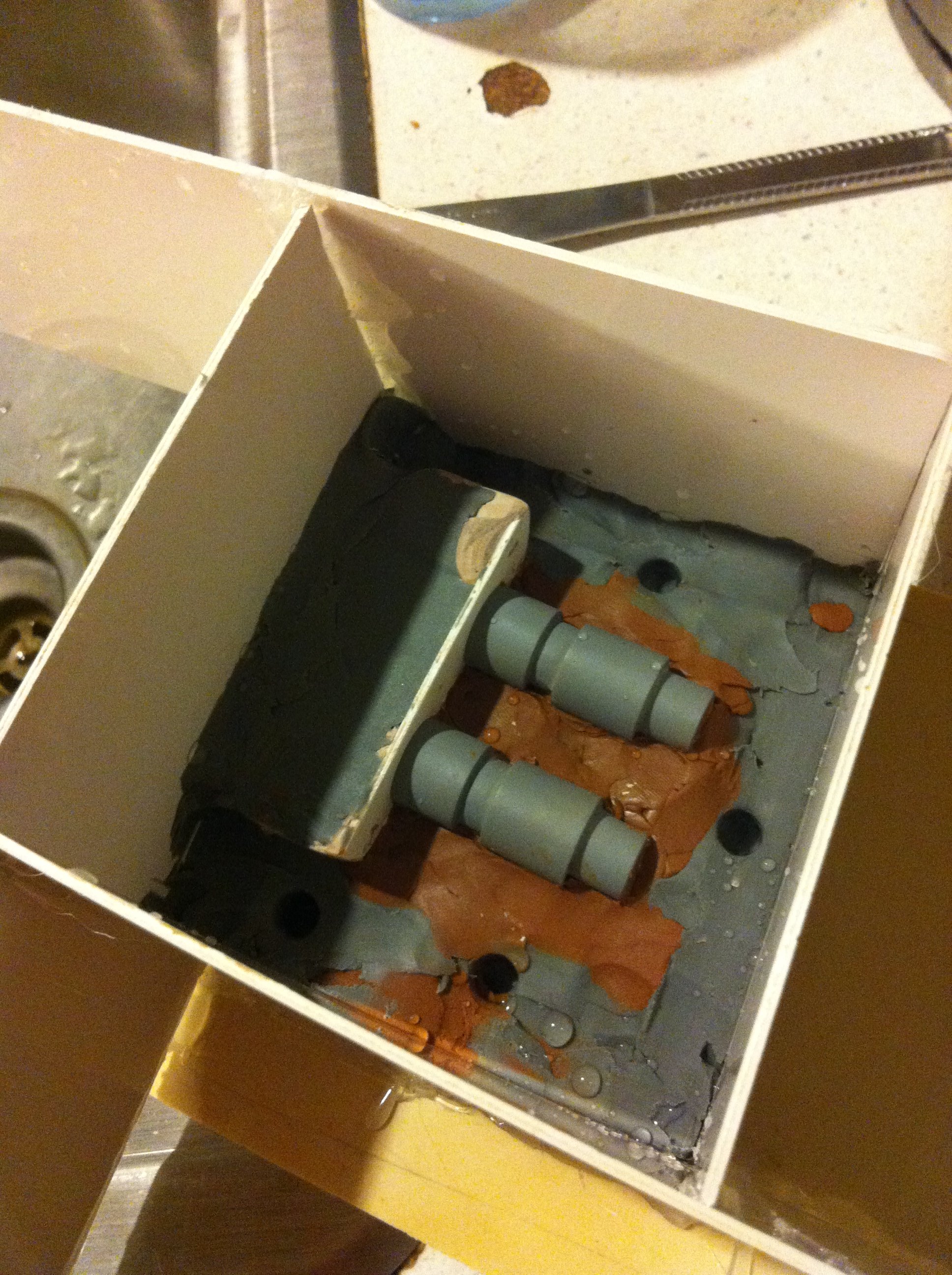

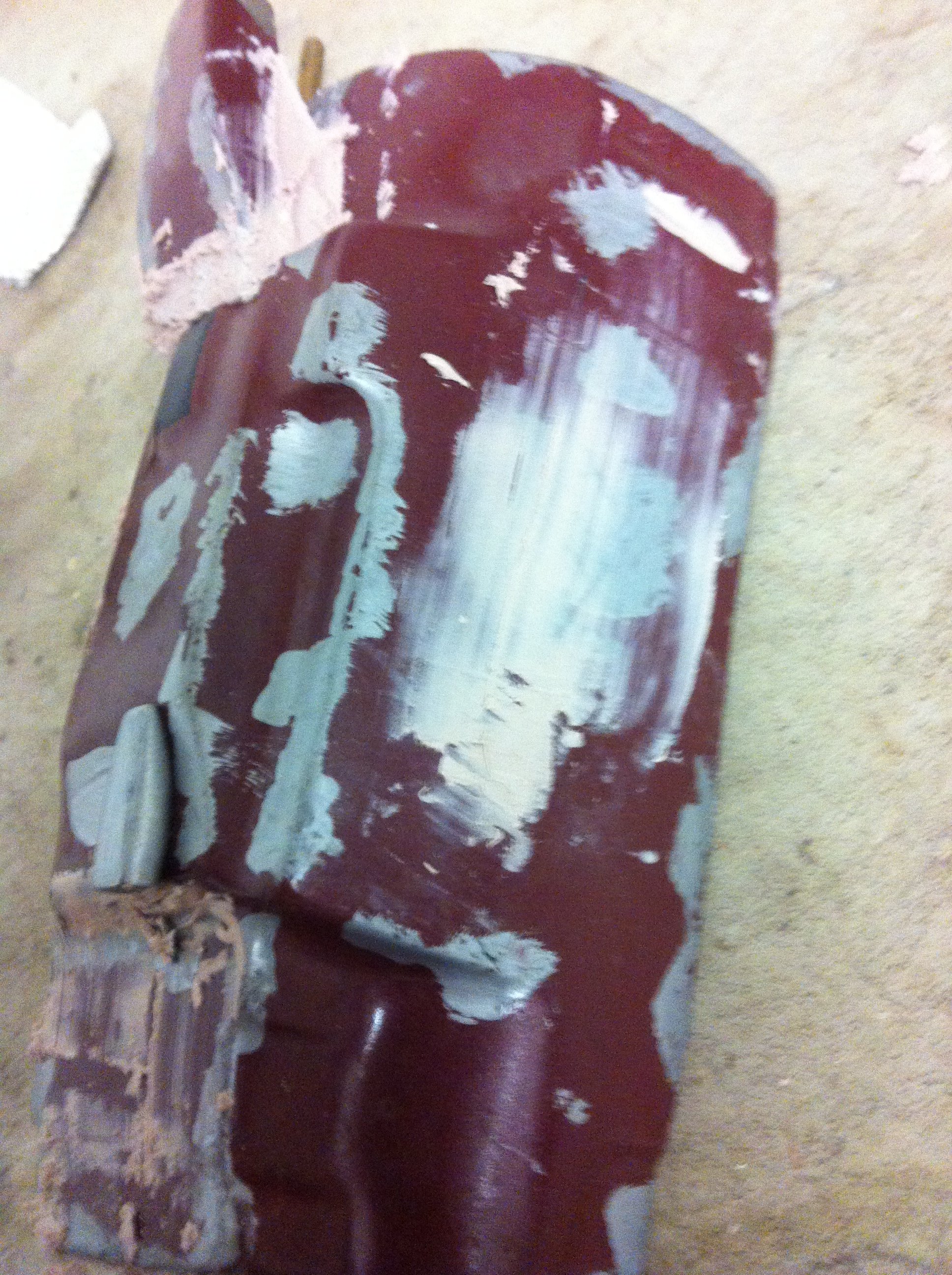

So my attempt at making a resin copy of one of my knee dart accessories was a flop and turned out terrible so I just scrapped the whole attempt at casting a resin copy and just ordered some more knee darts to complete the knees.

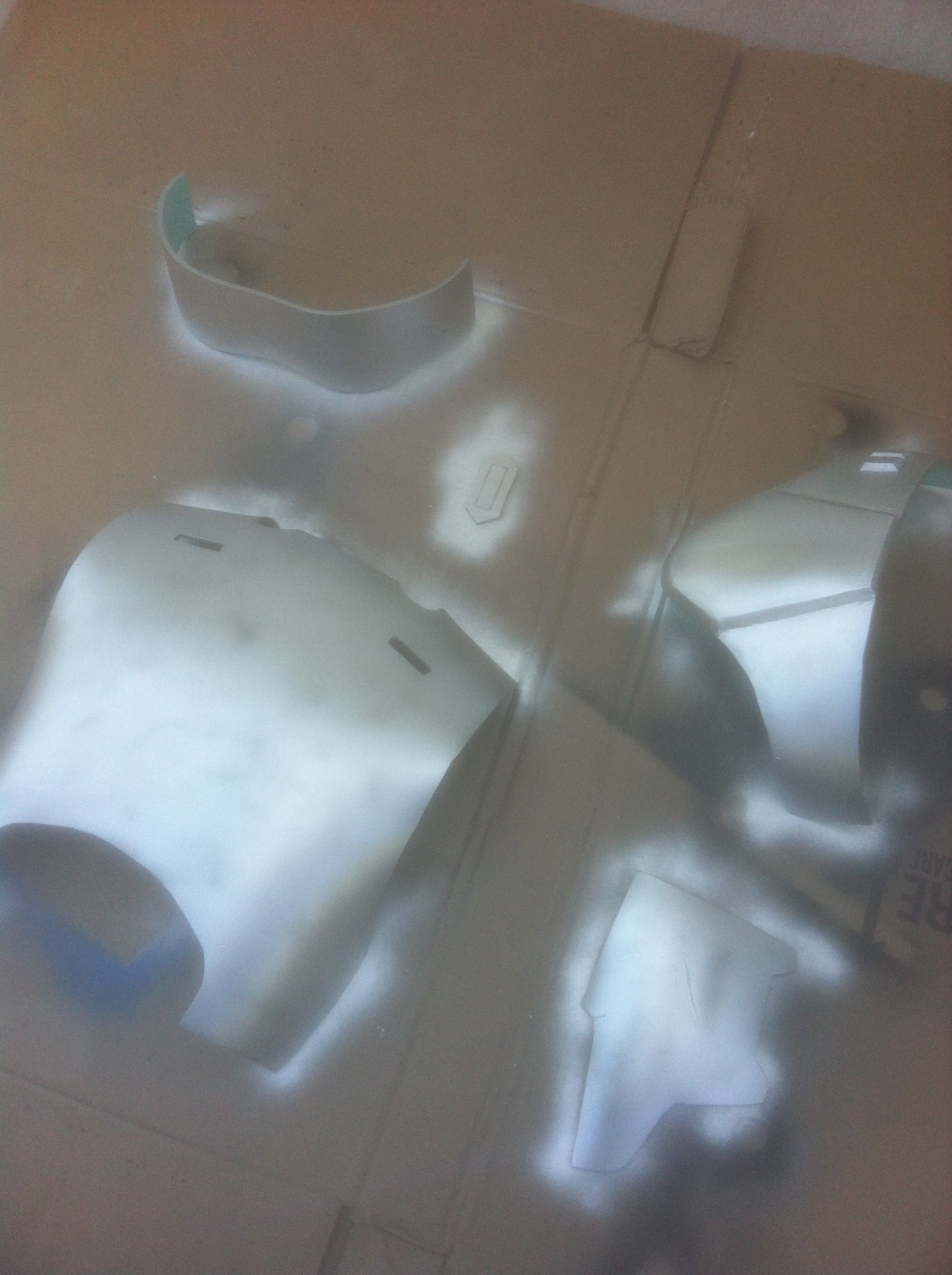

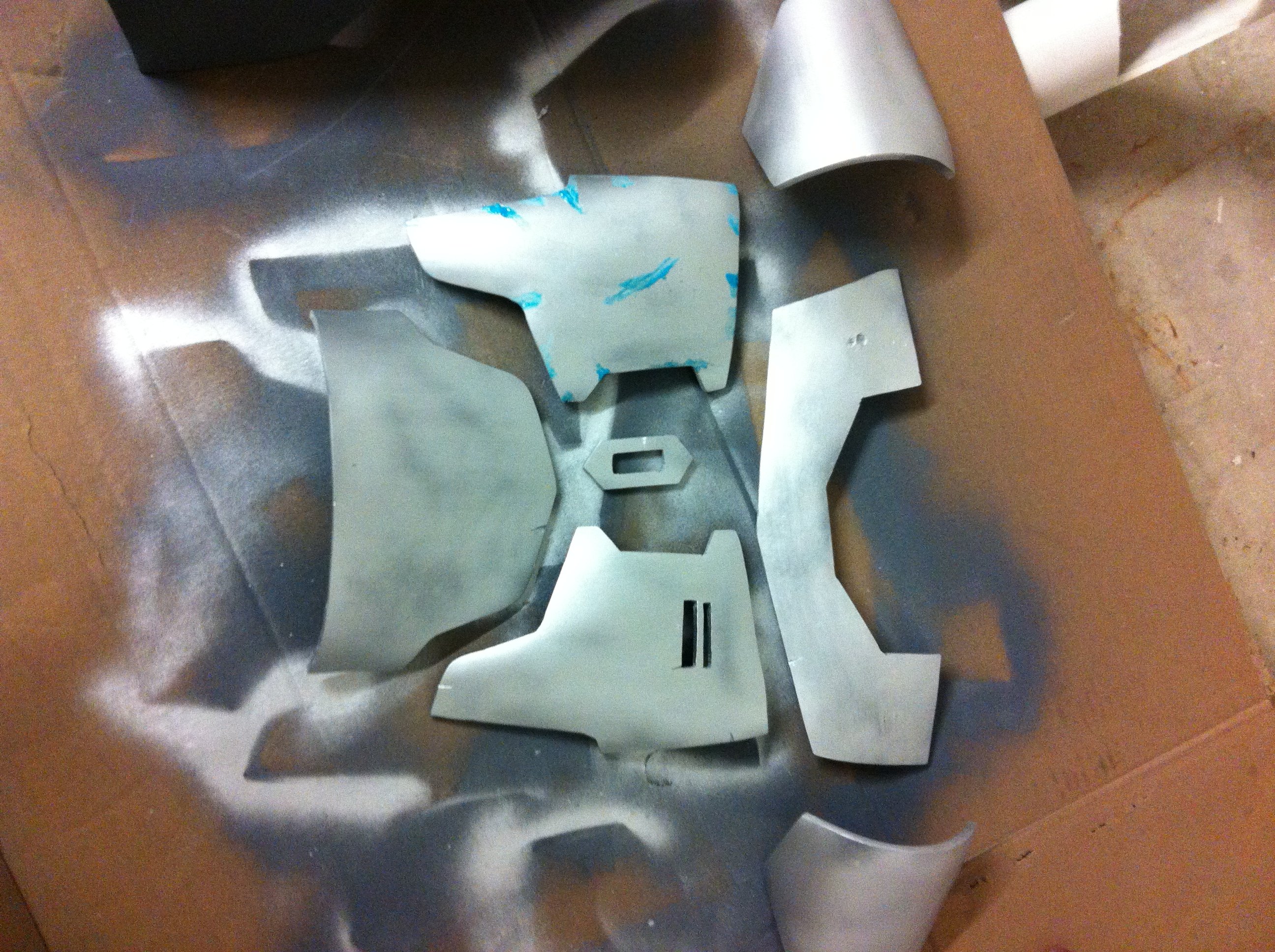

SSSOOO instead I thought I would try and knock out the armor. So I started with the chest pieces and shoulder bells.
And then next the cod, backplate, and kidney armor.

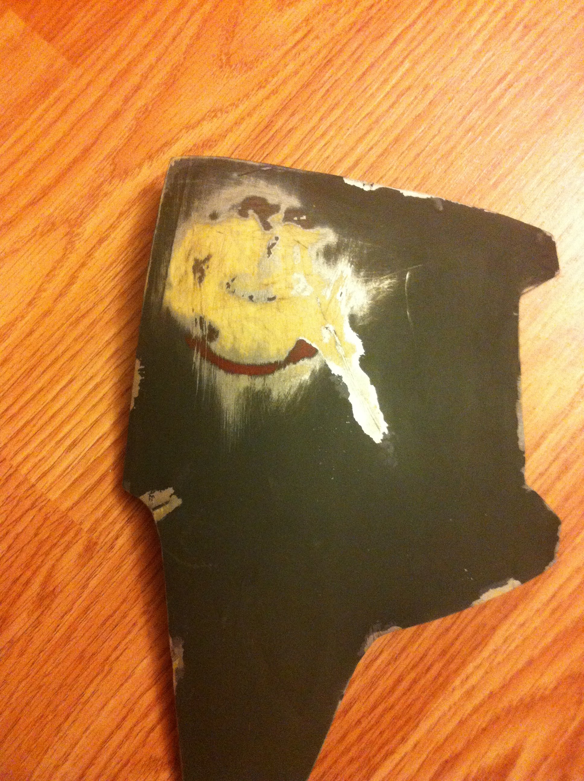

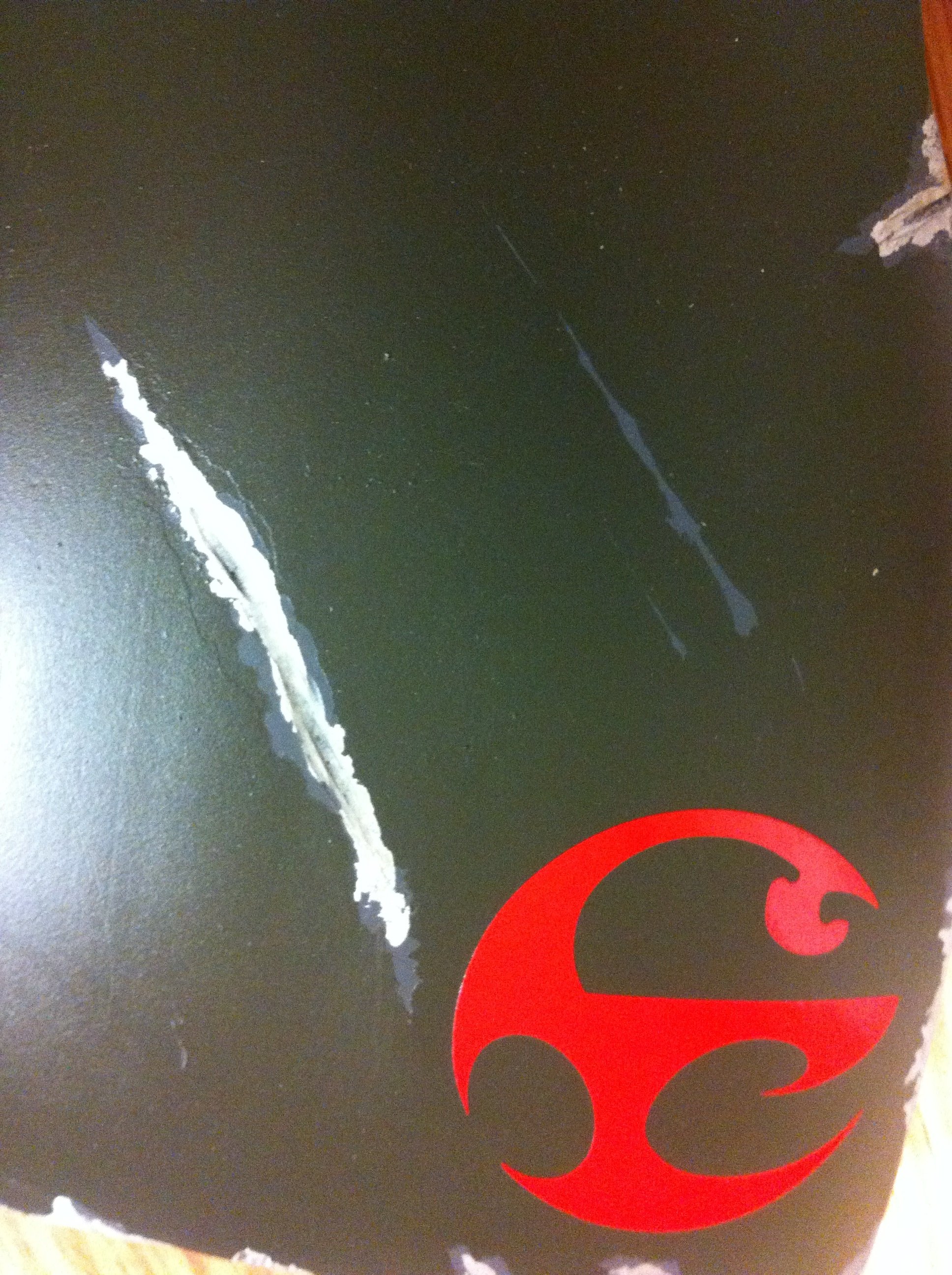

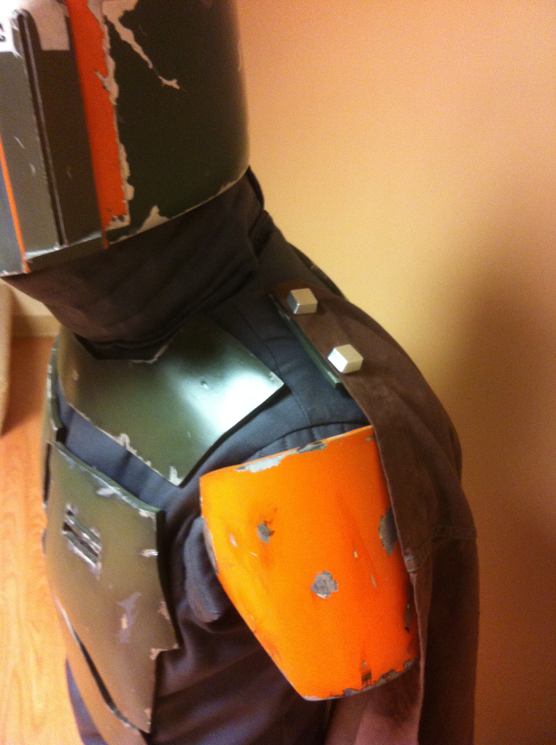

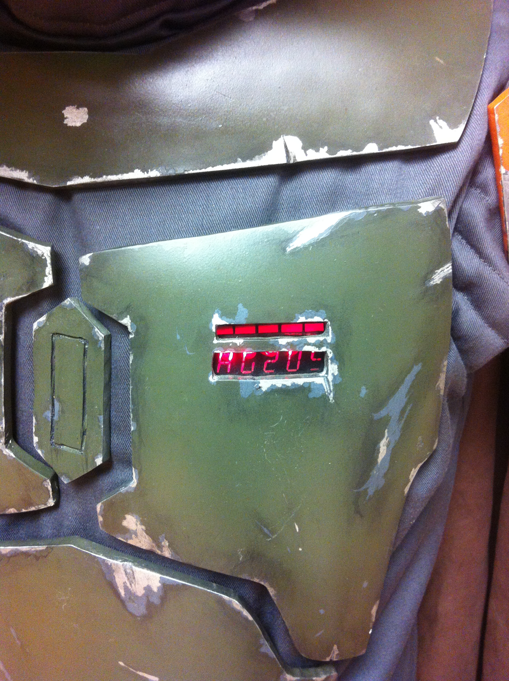

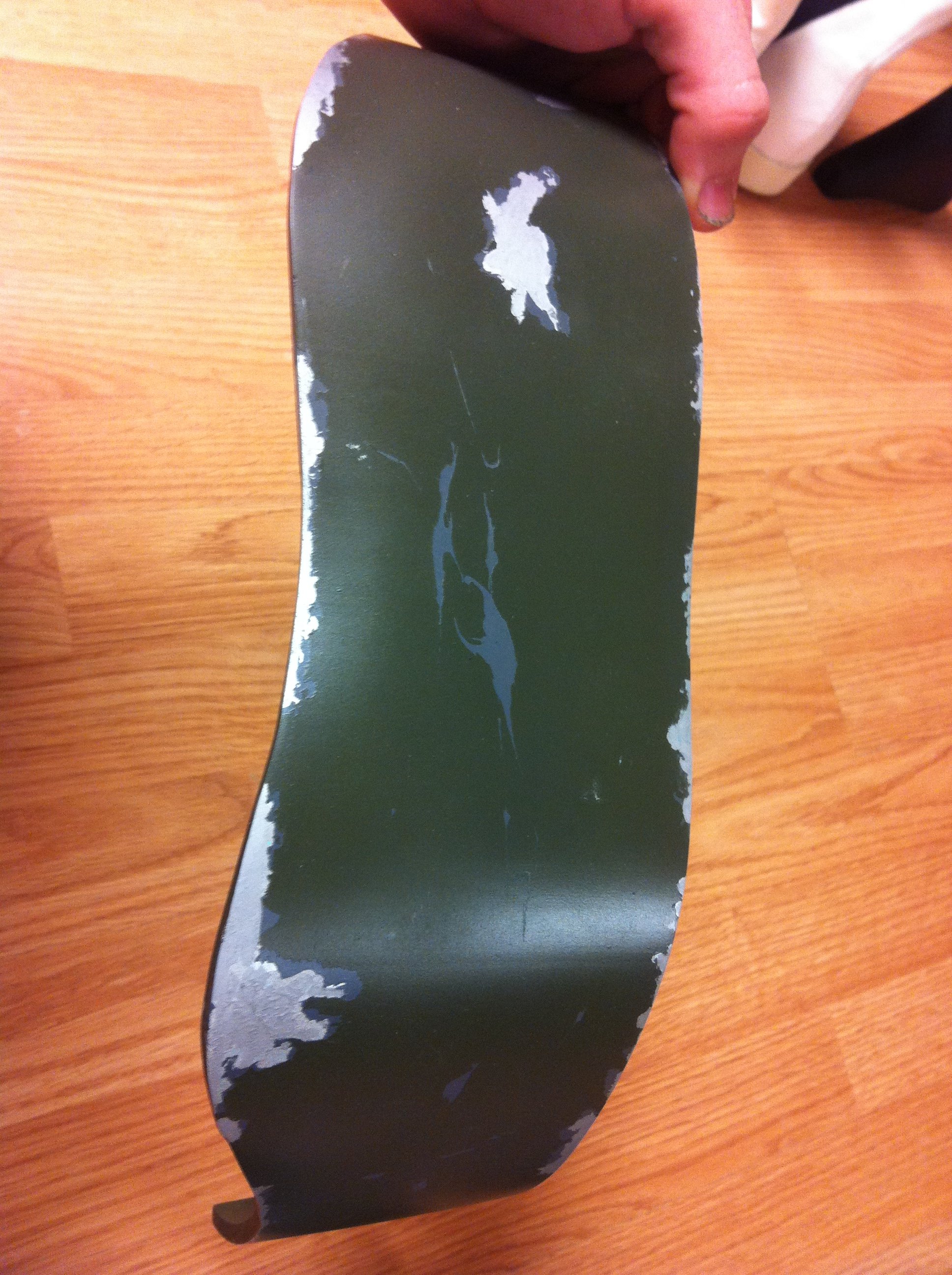

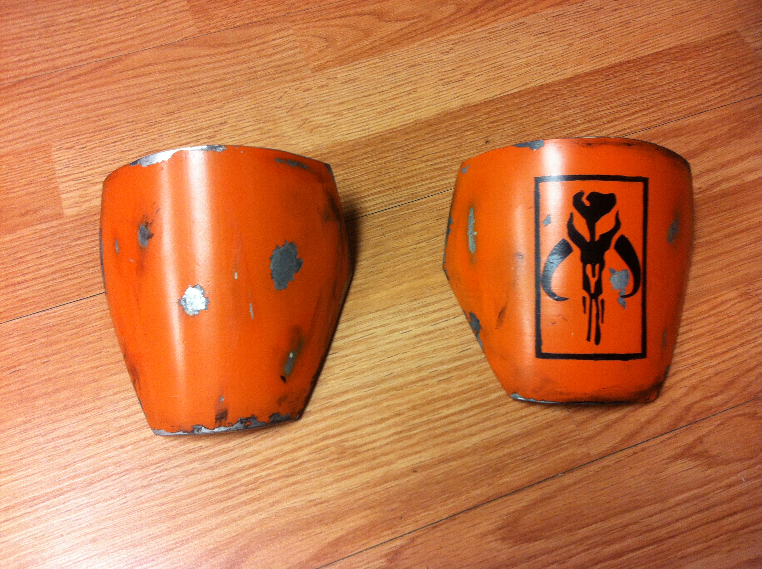

For the weathering I continued with the layered paint job and used some good old toothpaste as "masking" fluid.
Unfortunately, I tried to paint on the logo on the right chest piece, and messed up. So I had to restart the paint layers again.

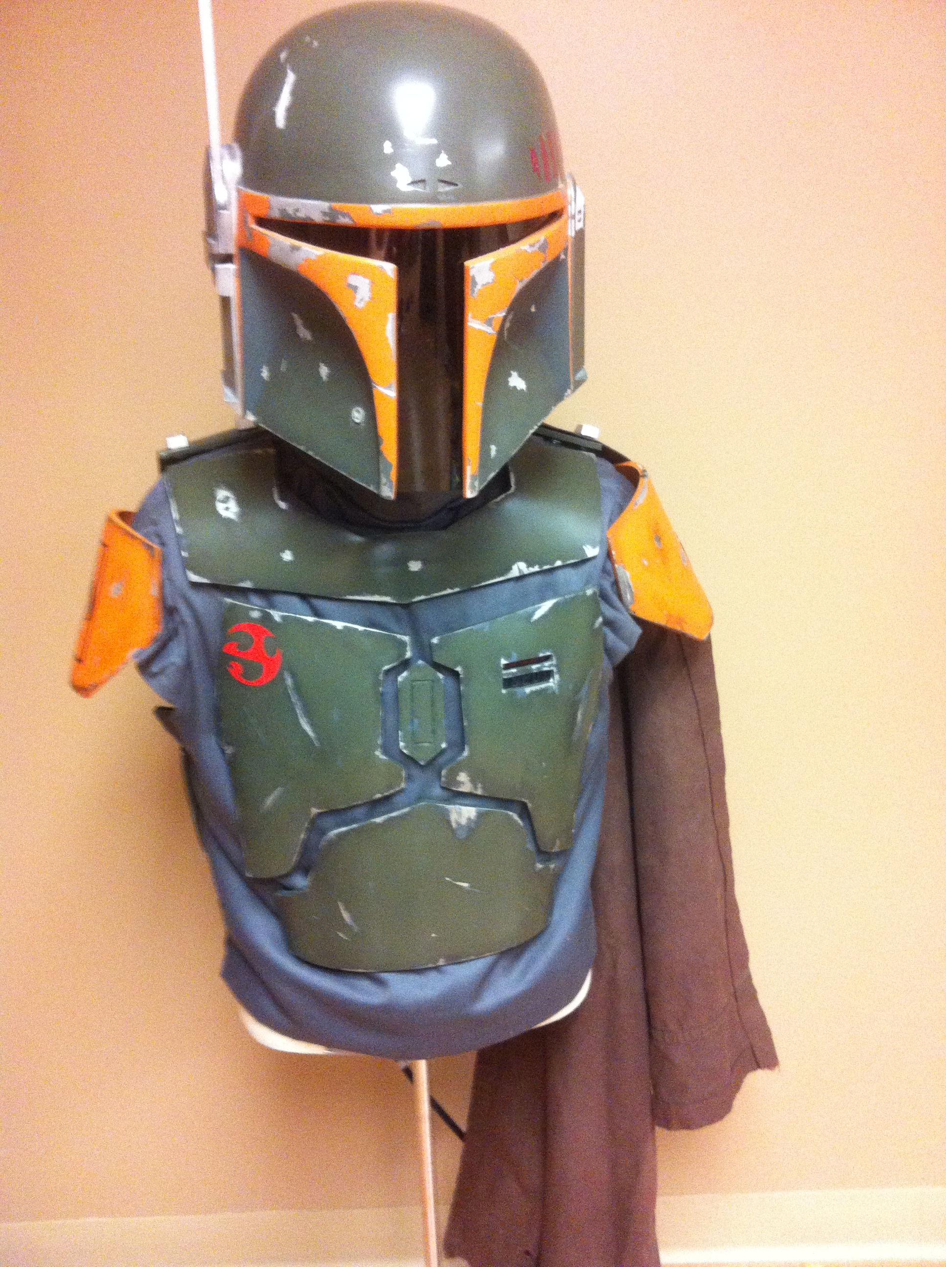

But I was able to transform that into this
A shout out to Scott for the awesome decal!

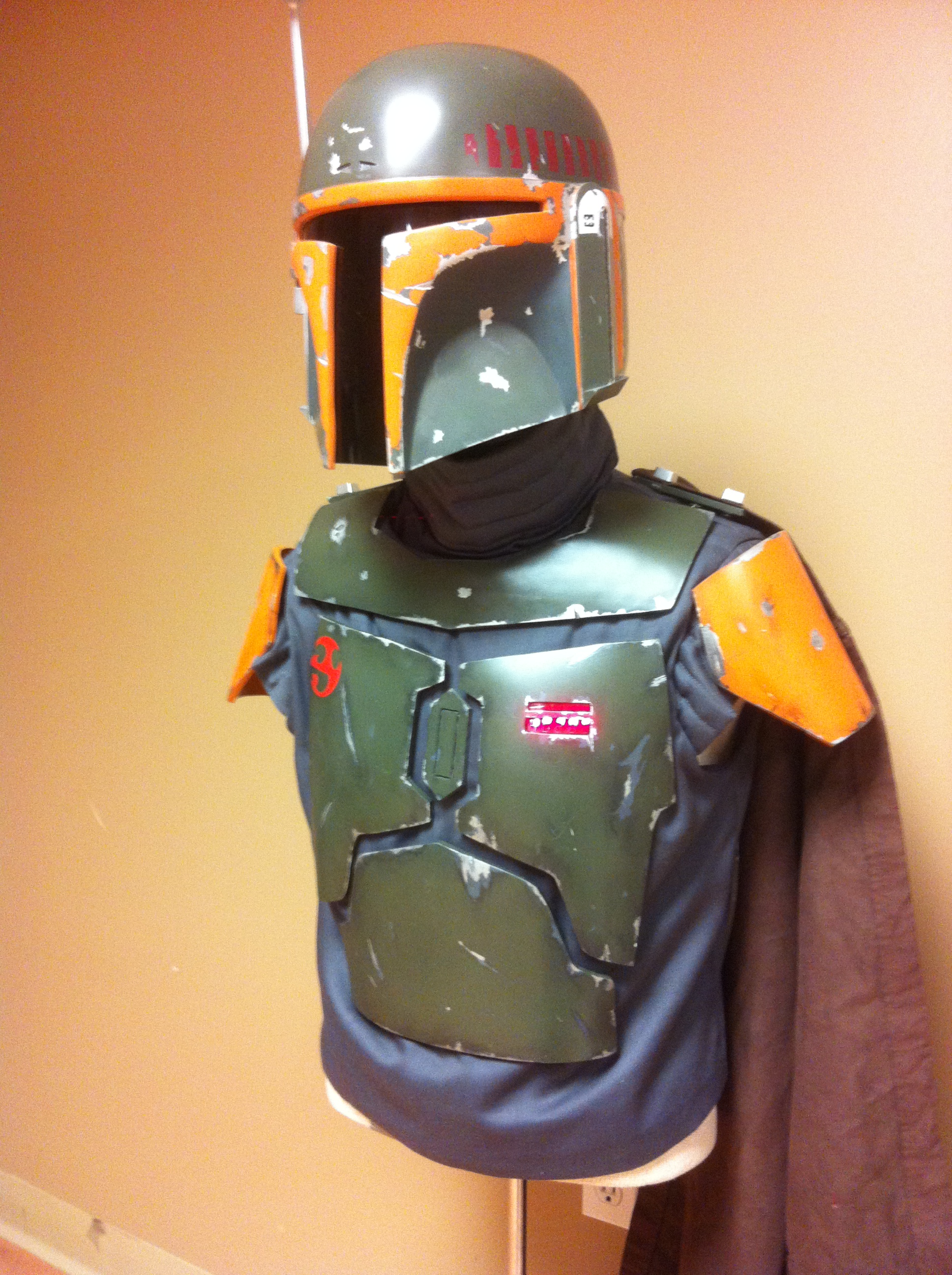

So when it is put all together with the helmet, it looks a little something like this.
I haven't decided if I want to put a whole bunch of carbon scoring on it or not yet since the helmet really didn't have any on it, but I will just have to see.

For the moulds I use Silicon from these folks Carbon Fibre Cloth, Epoxy Resin, Kevlar, Diolen, Equipment and Supplies for Advanced Composites - Easy Composites (after making a master copy from anything you can cobble together, card, wood whatever - then use a dental type Resin for the actual copies of Knee darts, gauntlet rocket's etc).

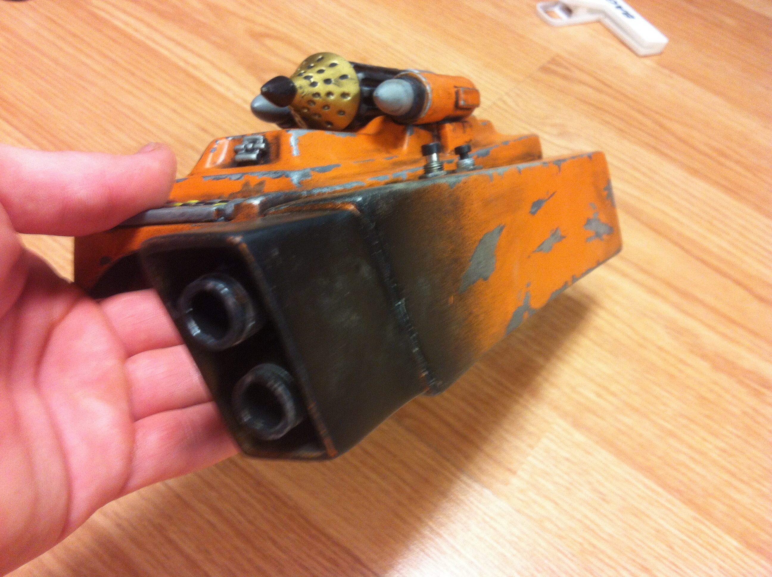

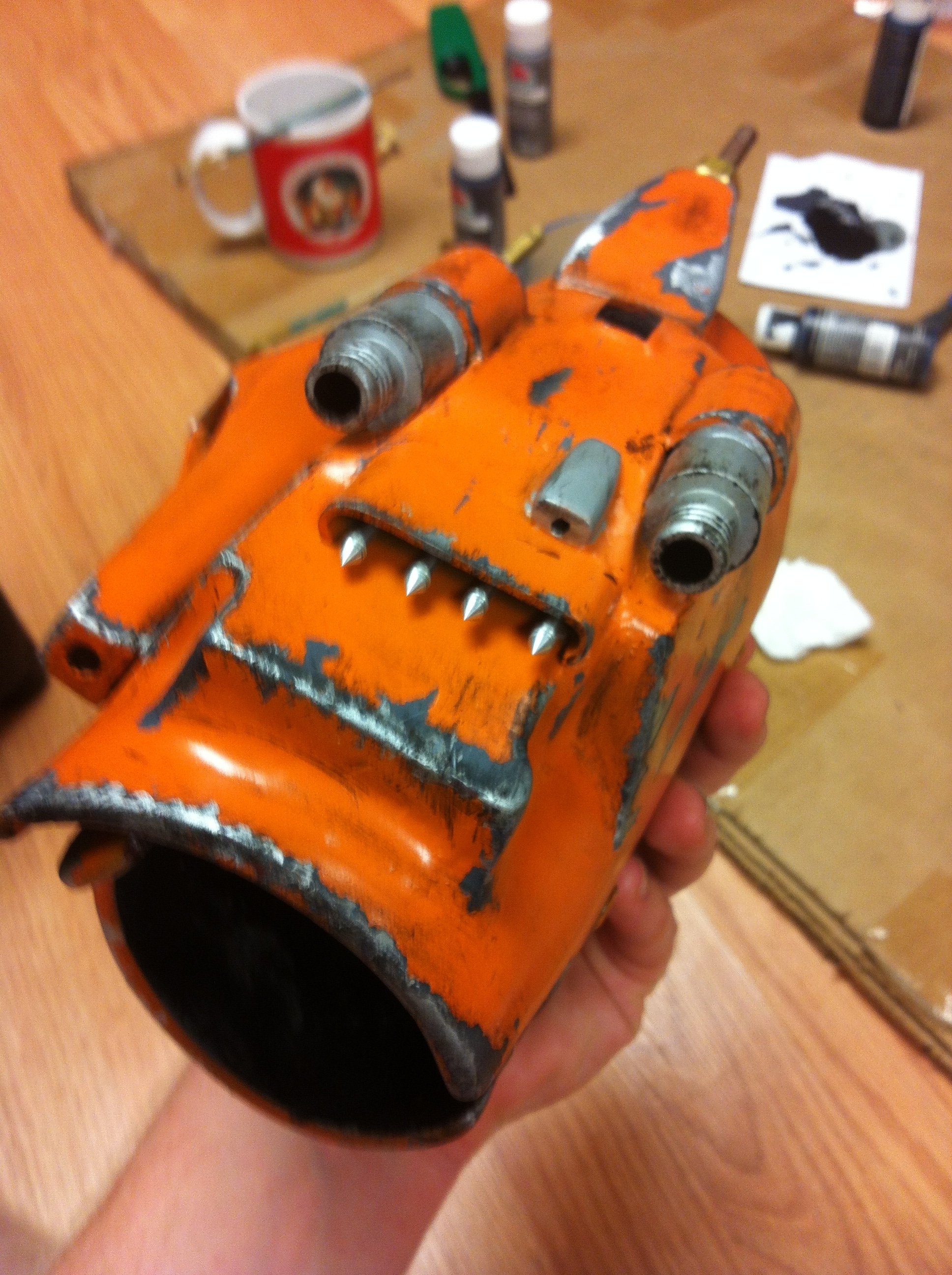

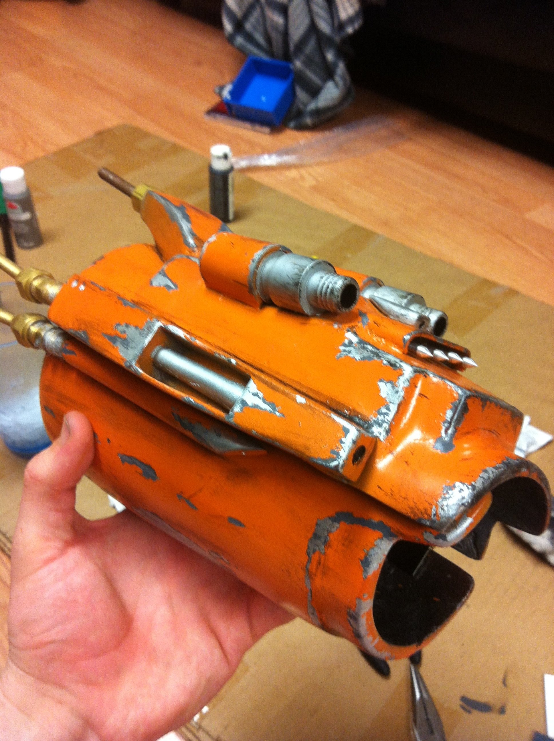

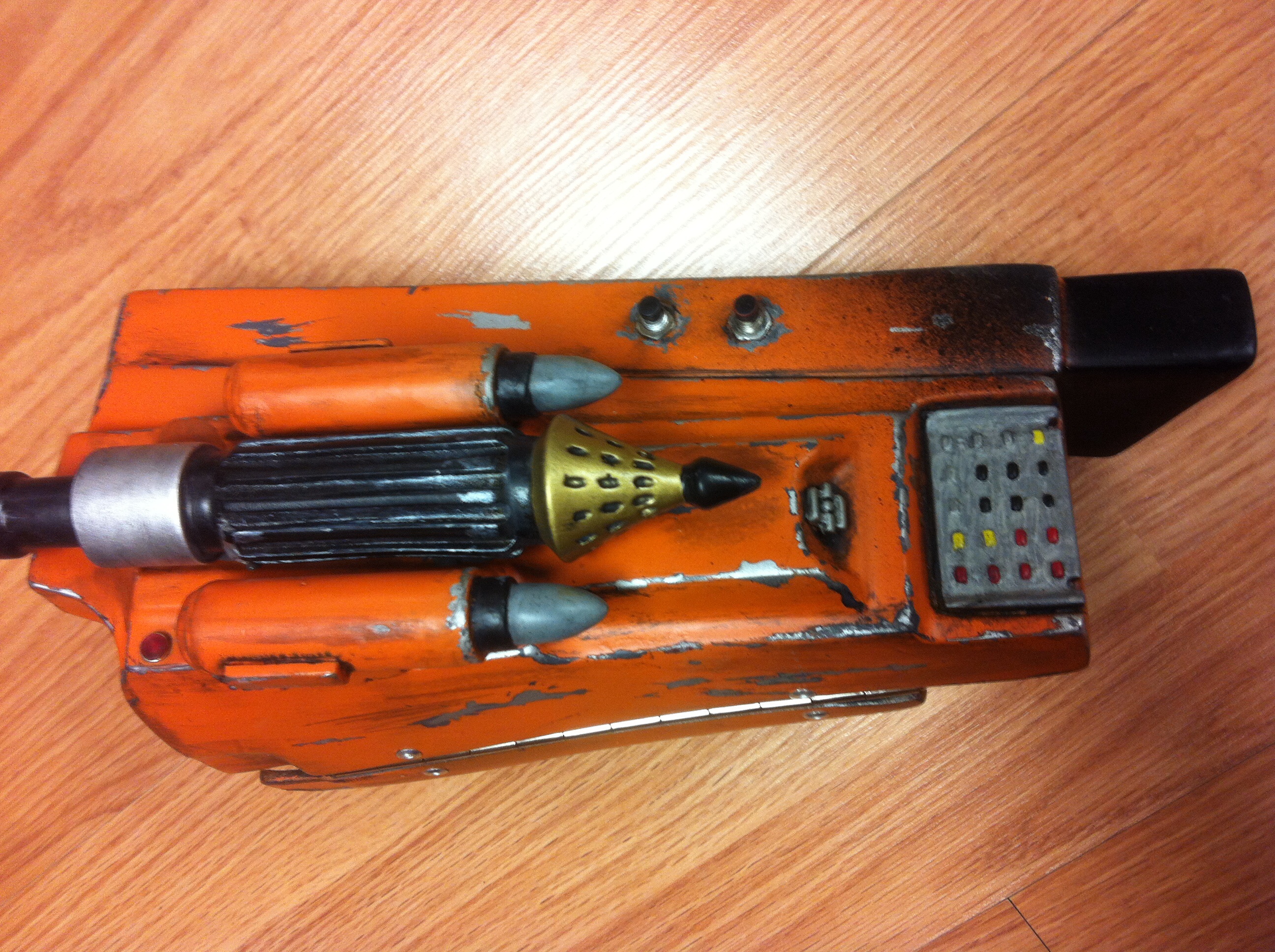

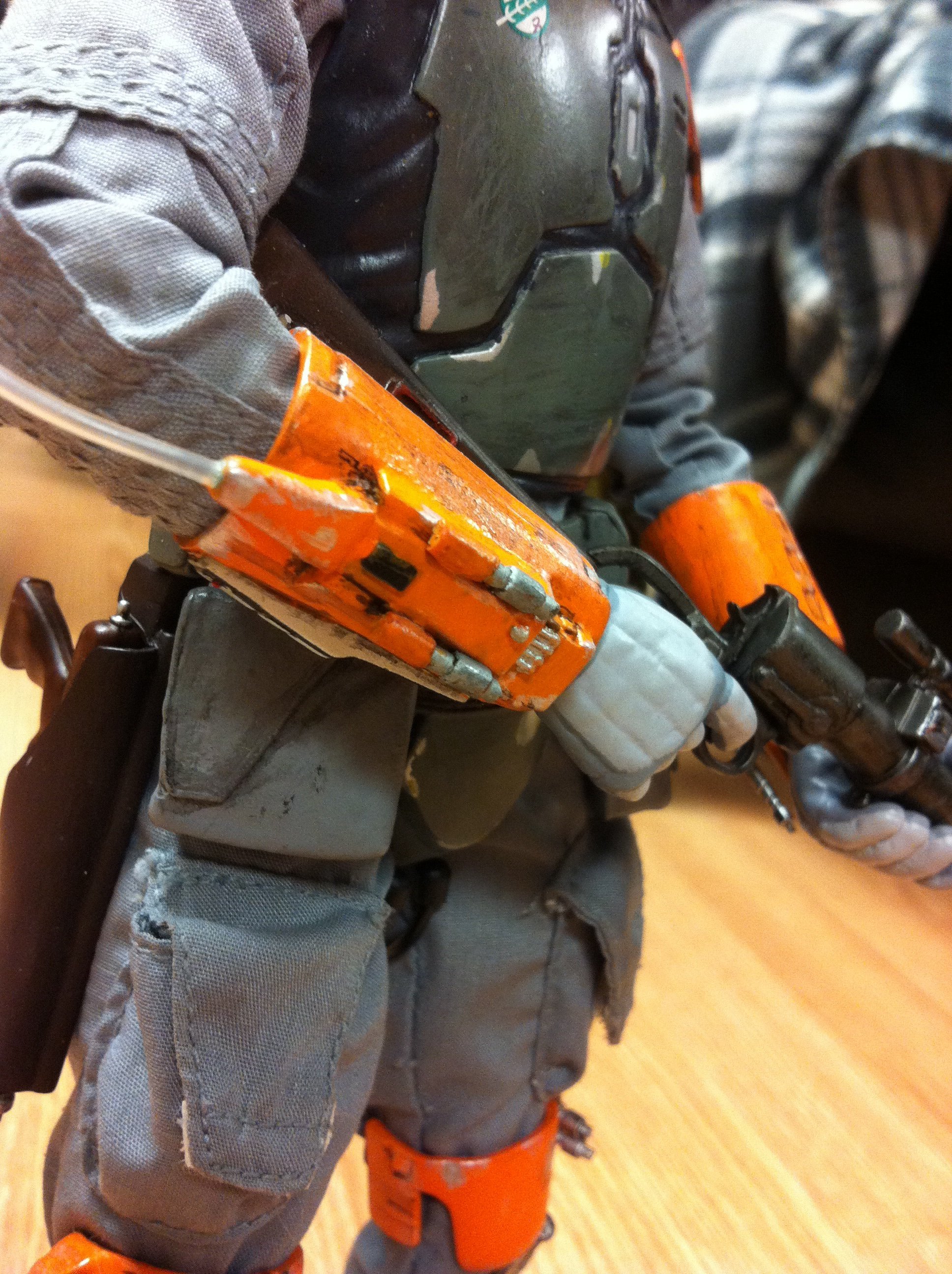

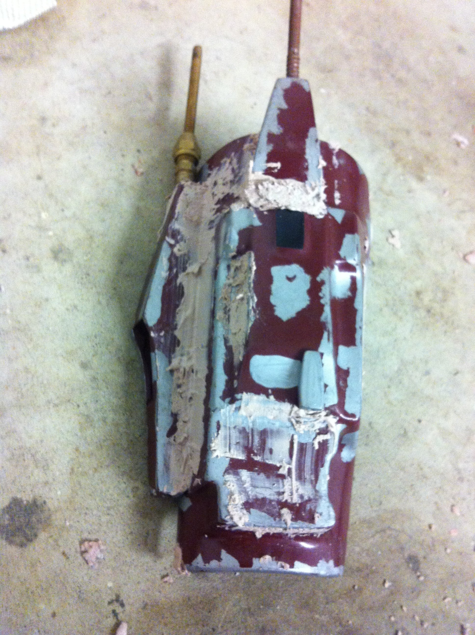

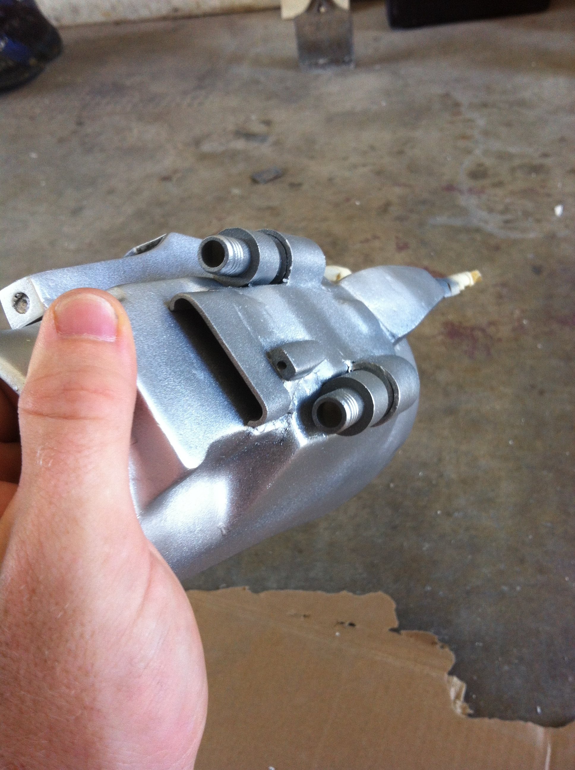

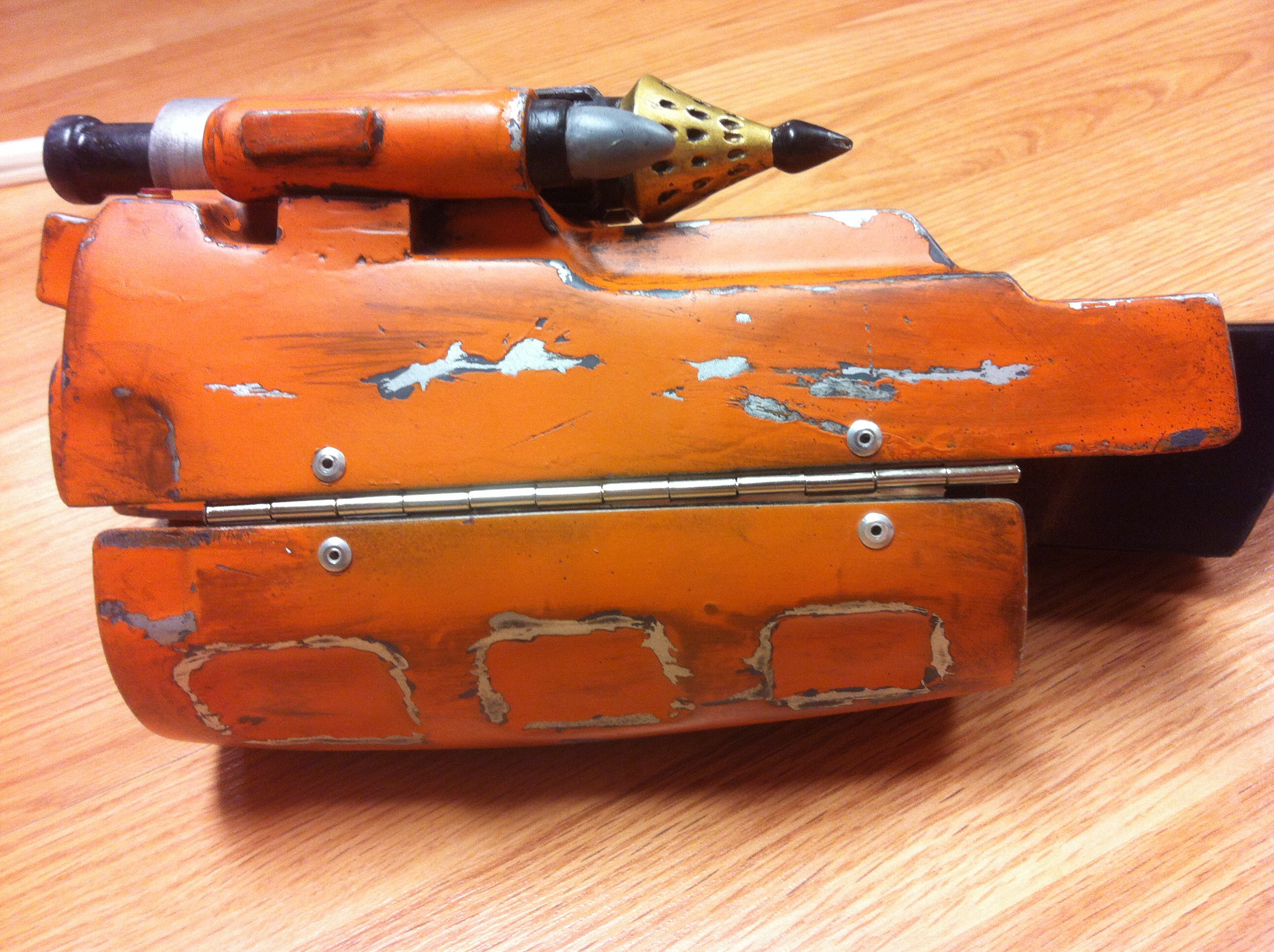

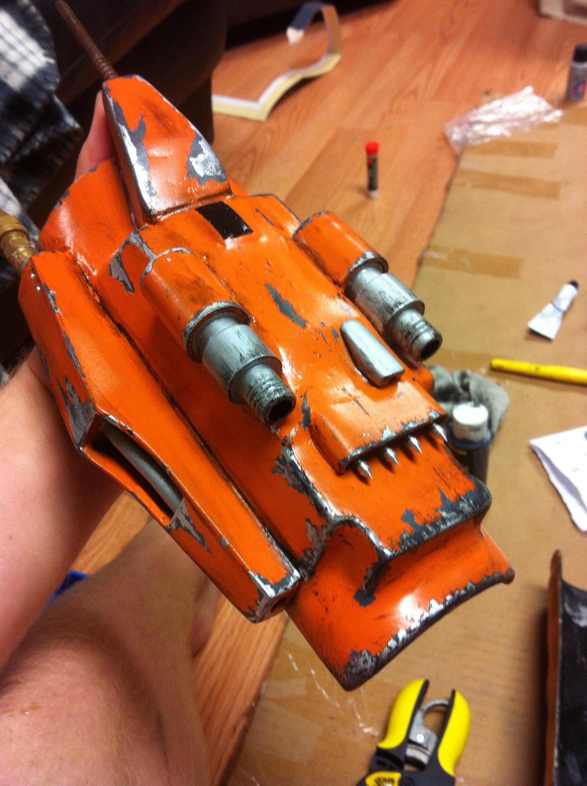

So a small update here, I finally have the right gauntlet finished so I thought I would throw up some pics.
So here is basically what I started with.

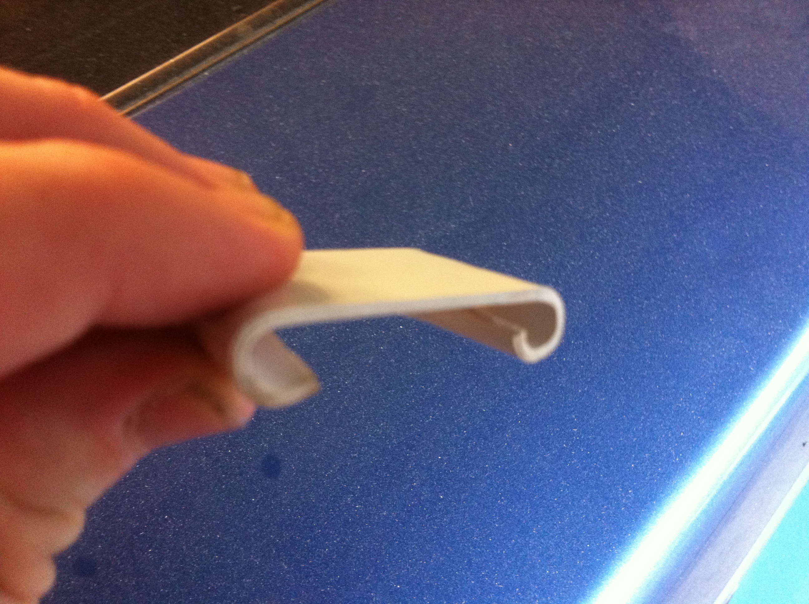

And in order to get this,
I took a piece of leftover abs plastic, heated it with a heat gun, and then curled it around a metal rod to give me the desired affect. Once that was done, I cut the excess off with my dremel.

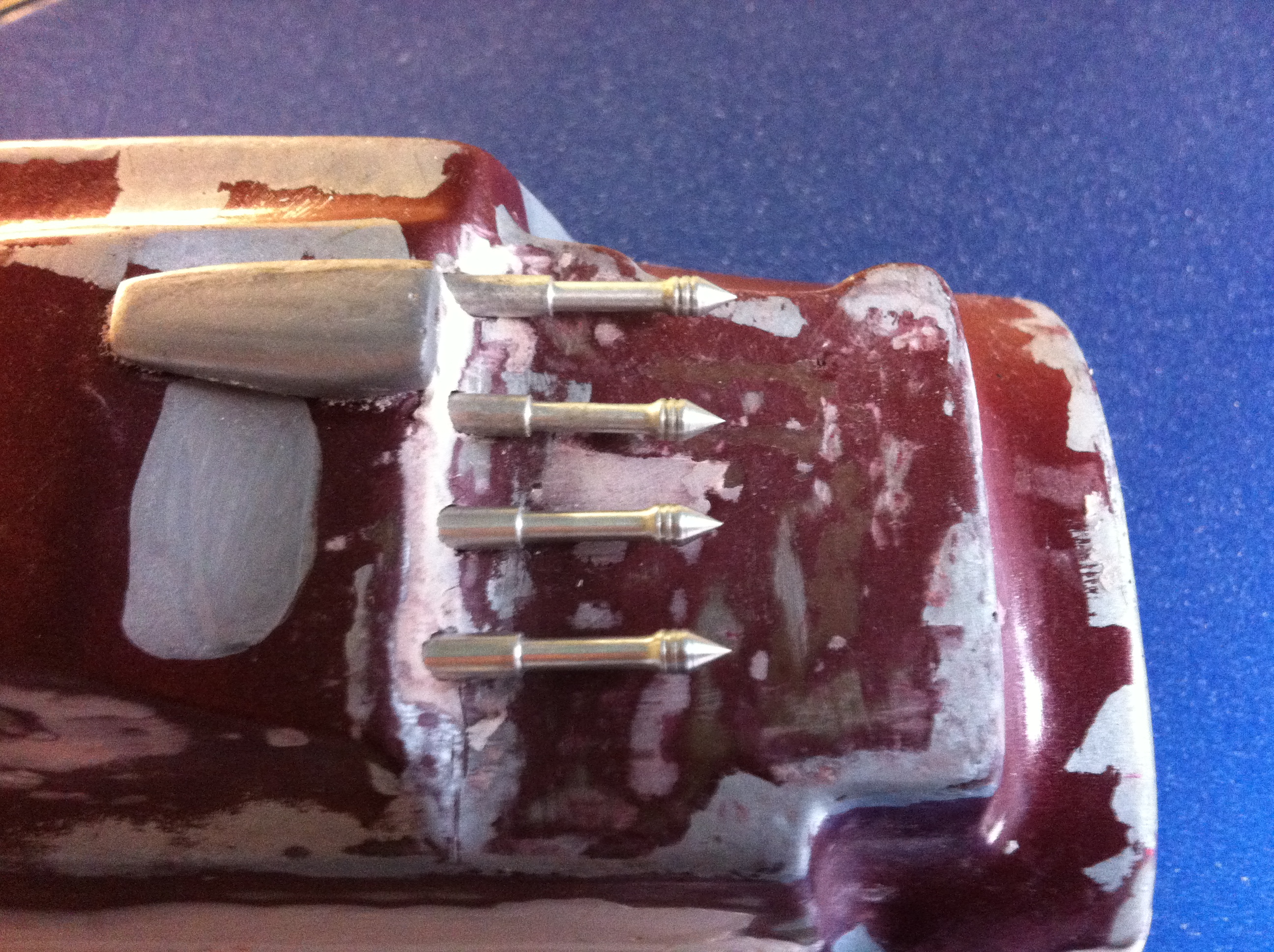

Once I did that same process with the knee darts, this was the end result.
And now onto the paint...
And finally the orange with a bit of it scrapped off.
And then the finished product with some black paint to add in the grime.
I again went with the layered paint job to keep the same style as the rest of the armor going, so now y next hurtle will be the left gauntlet (hopefully after hours of staring at your pictures Rich I will be able to give those rockets justice like you did haha)

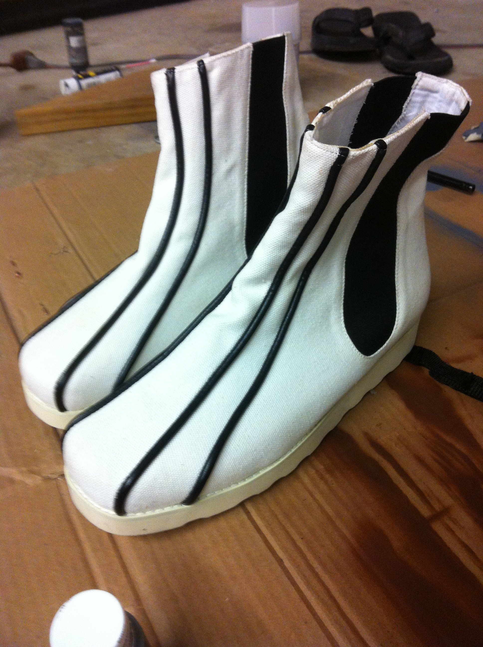

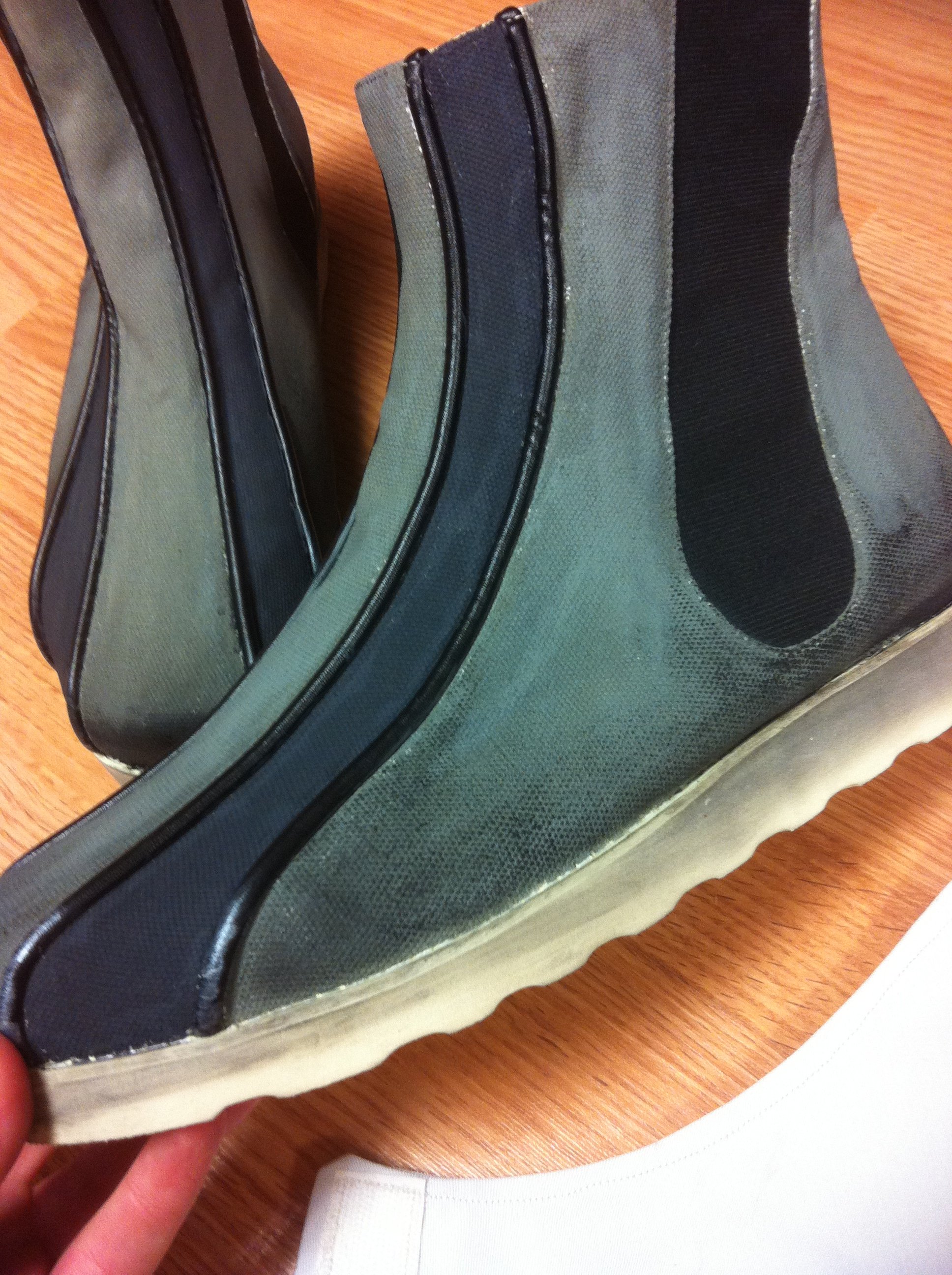

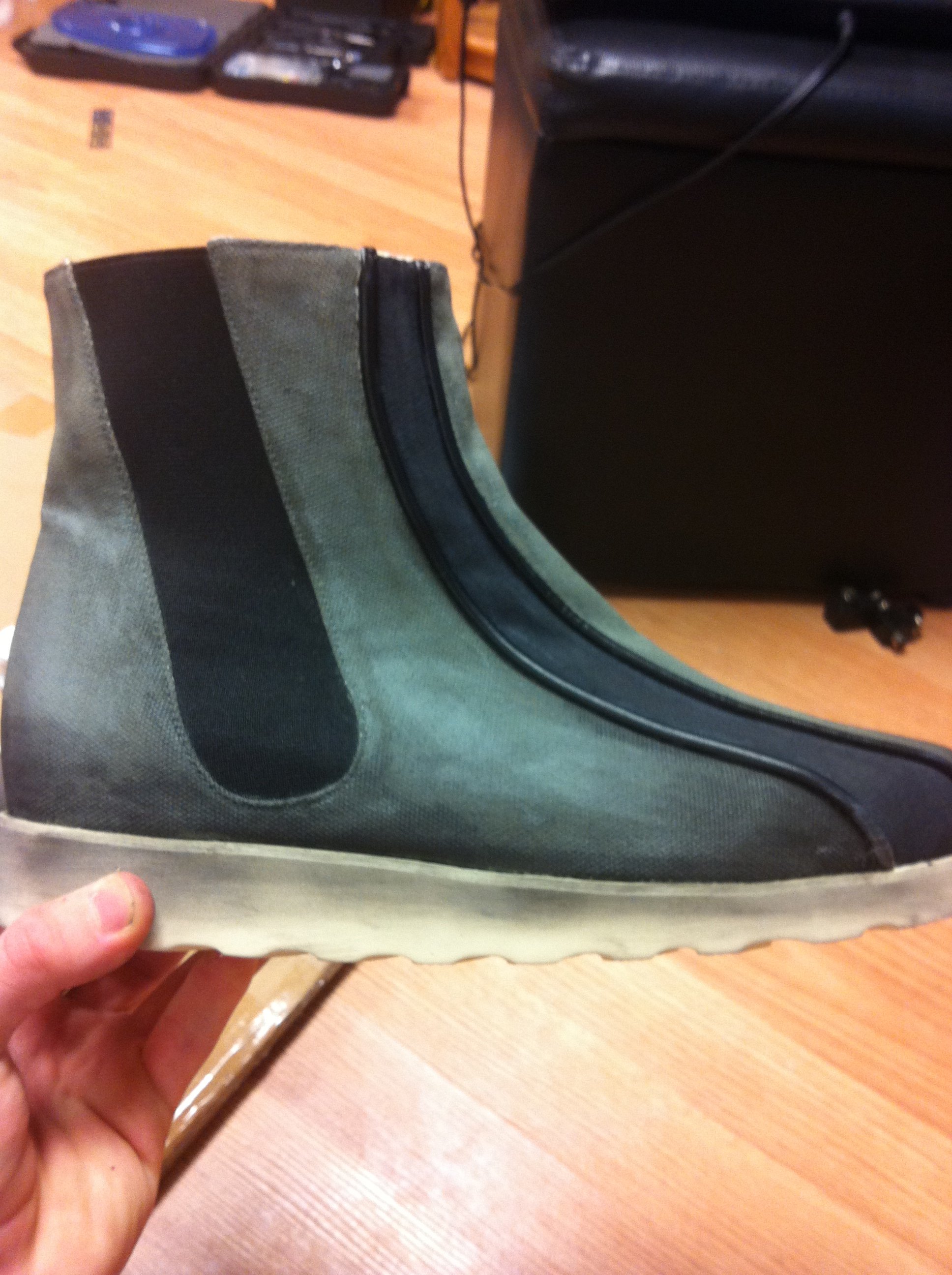

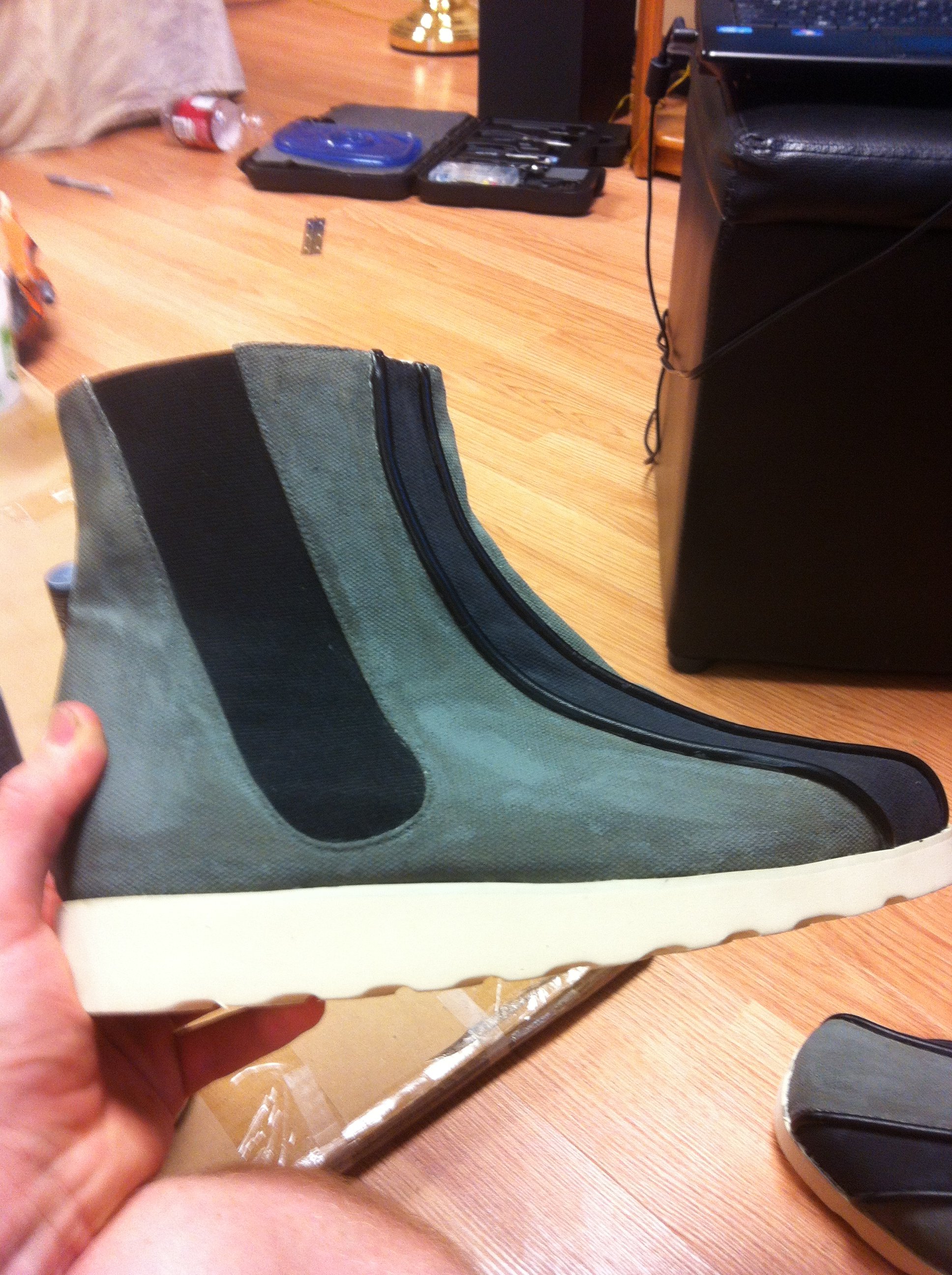

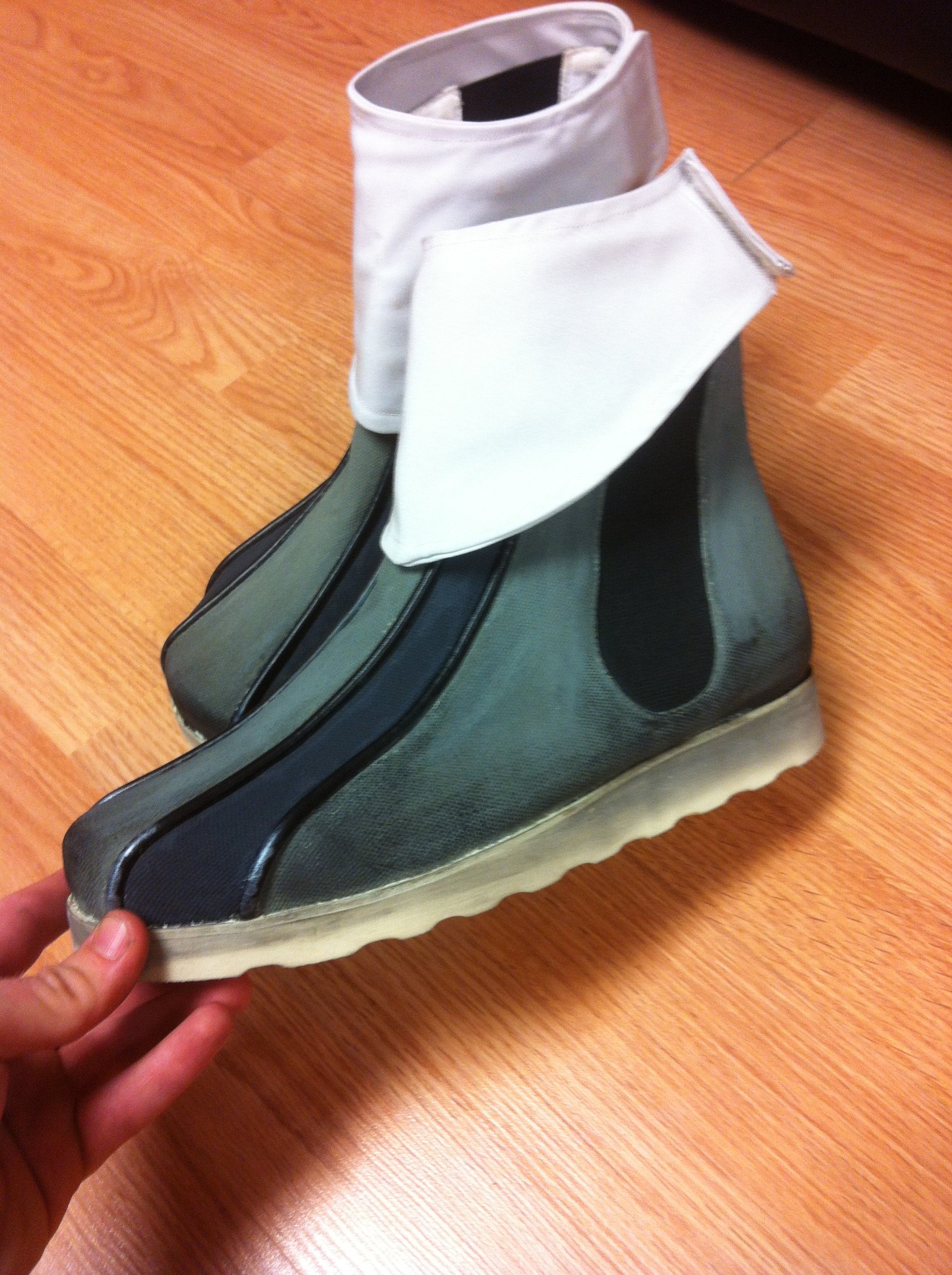

I was able to get some work on the boots done yesterday and decided I would post some pictures, So I started with the basic MOW (not sure what year they are) boot, and then pick up some cheap acrylic paint and go to town. I went with Apple Barrel brand "pewter grey" for the light grey and a "pavement" for the darker. I was really happy with the darker grey since it gave a slight hue of purple to it as well.
But he was the starting photo and then a photo for the edging.
And then the finished paint.
now to give it a little character.

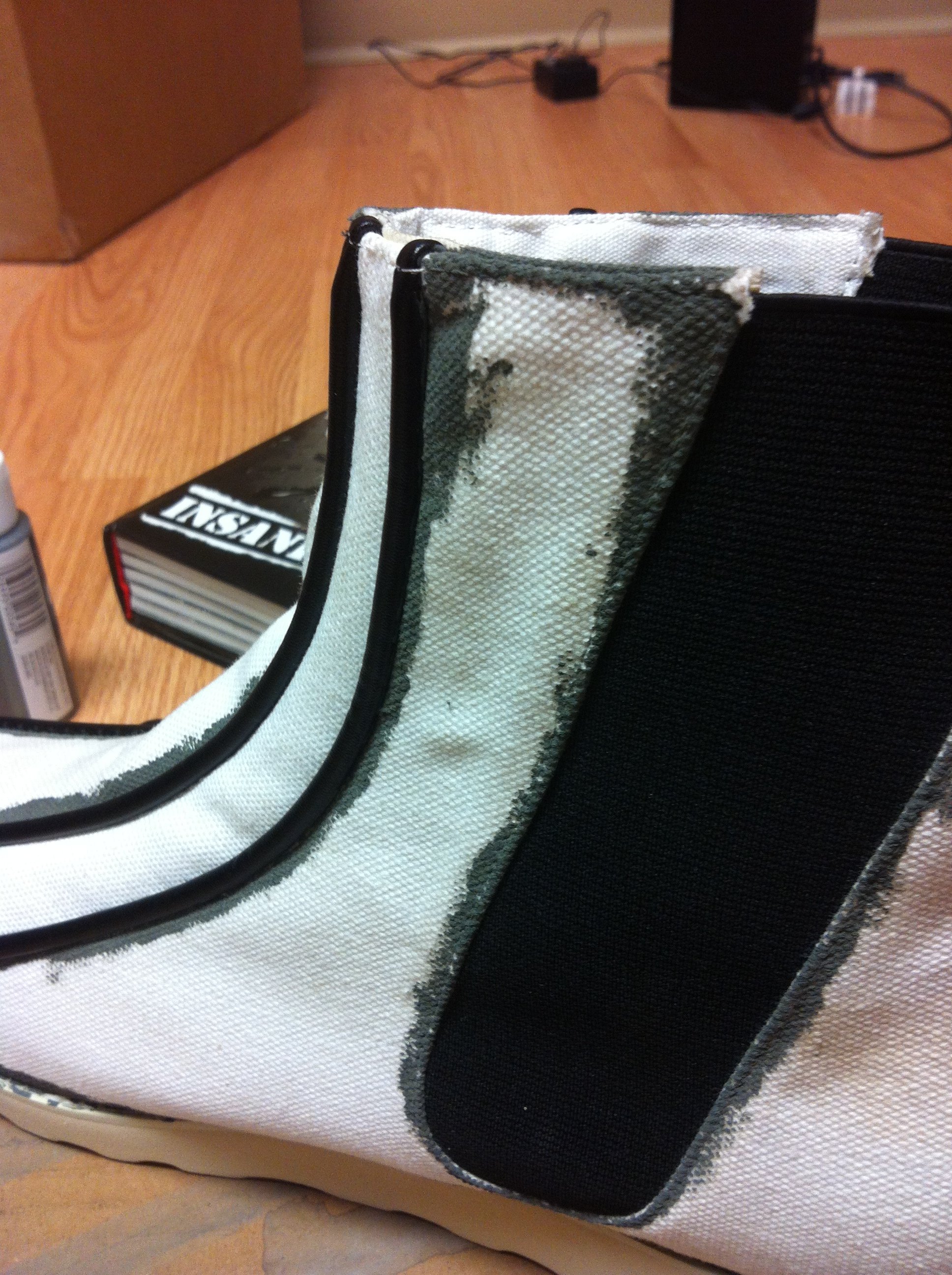

IMG_1409[1].JPG IMG_1465[1].JPG IMG_1466[1].JPG ,
Not sure if I am going to keep the spats lighter as they are and just weather them to make them darker (they are a REALLY light grey to try and match the contrast that Boba has with his flightsuit and spats, but my soft parts are still in the planning stages) or actually dye them a darker color and weather them. Hopefully I will get more done this week than I did last week haha.

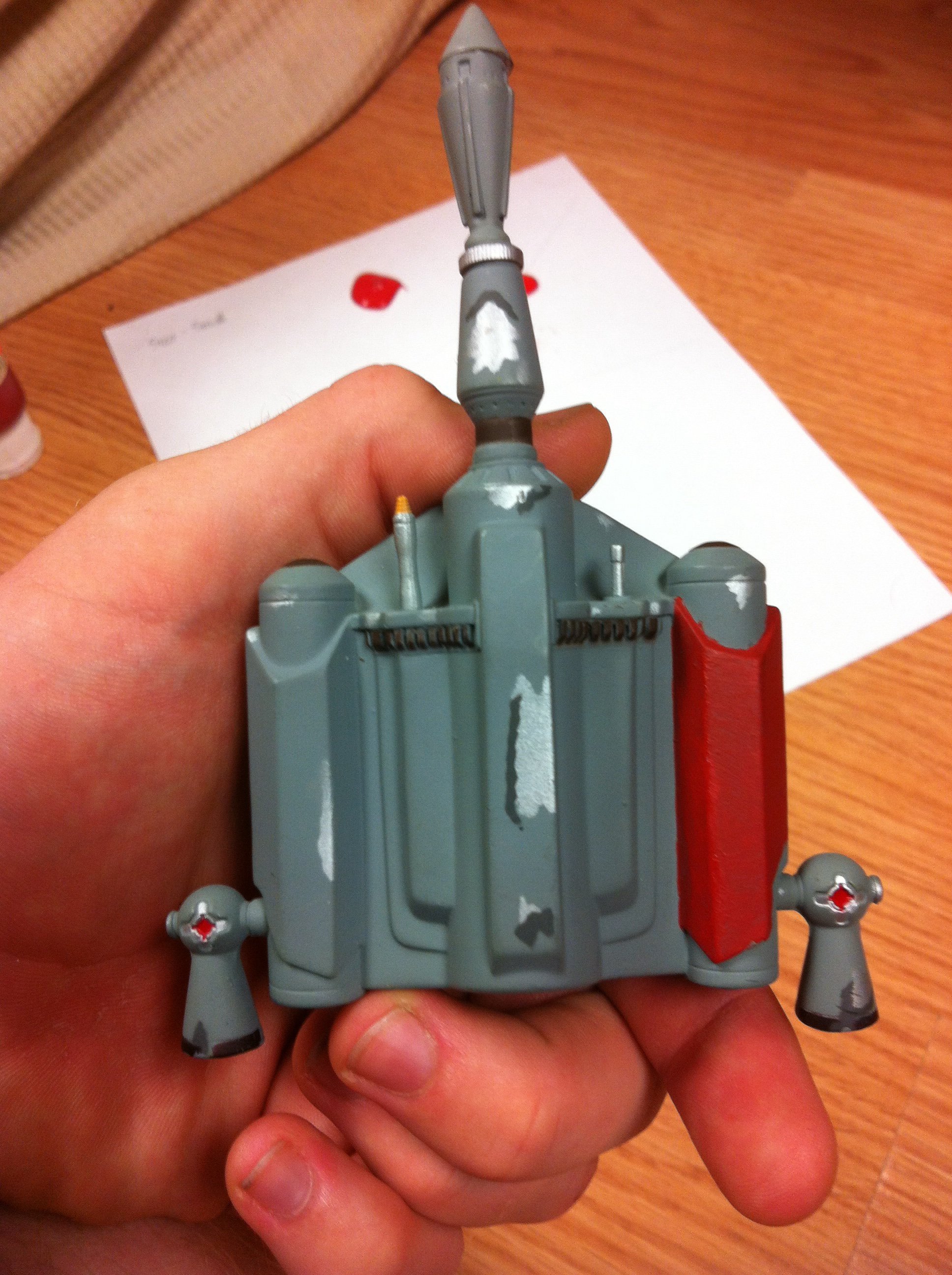

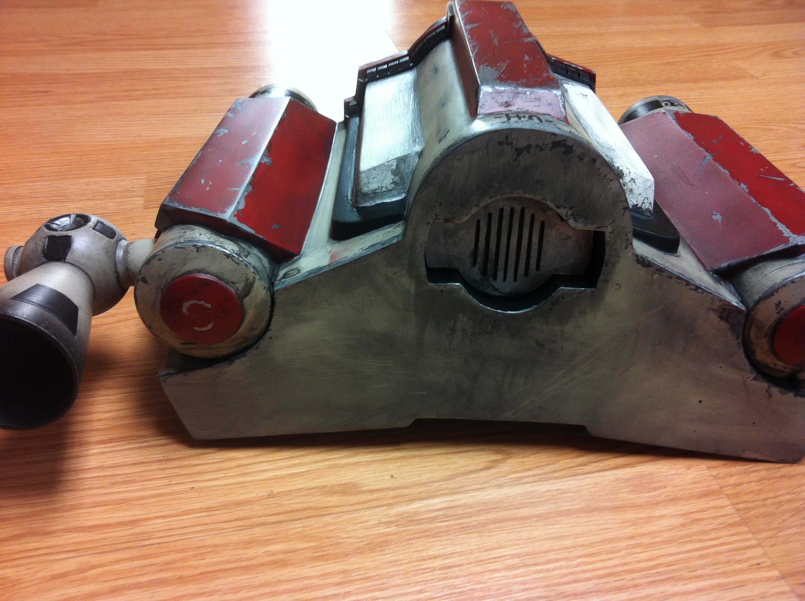

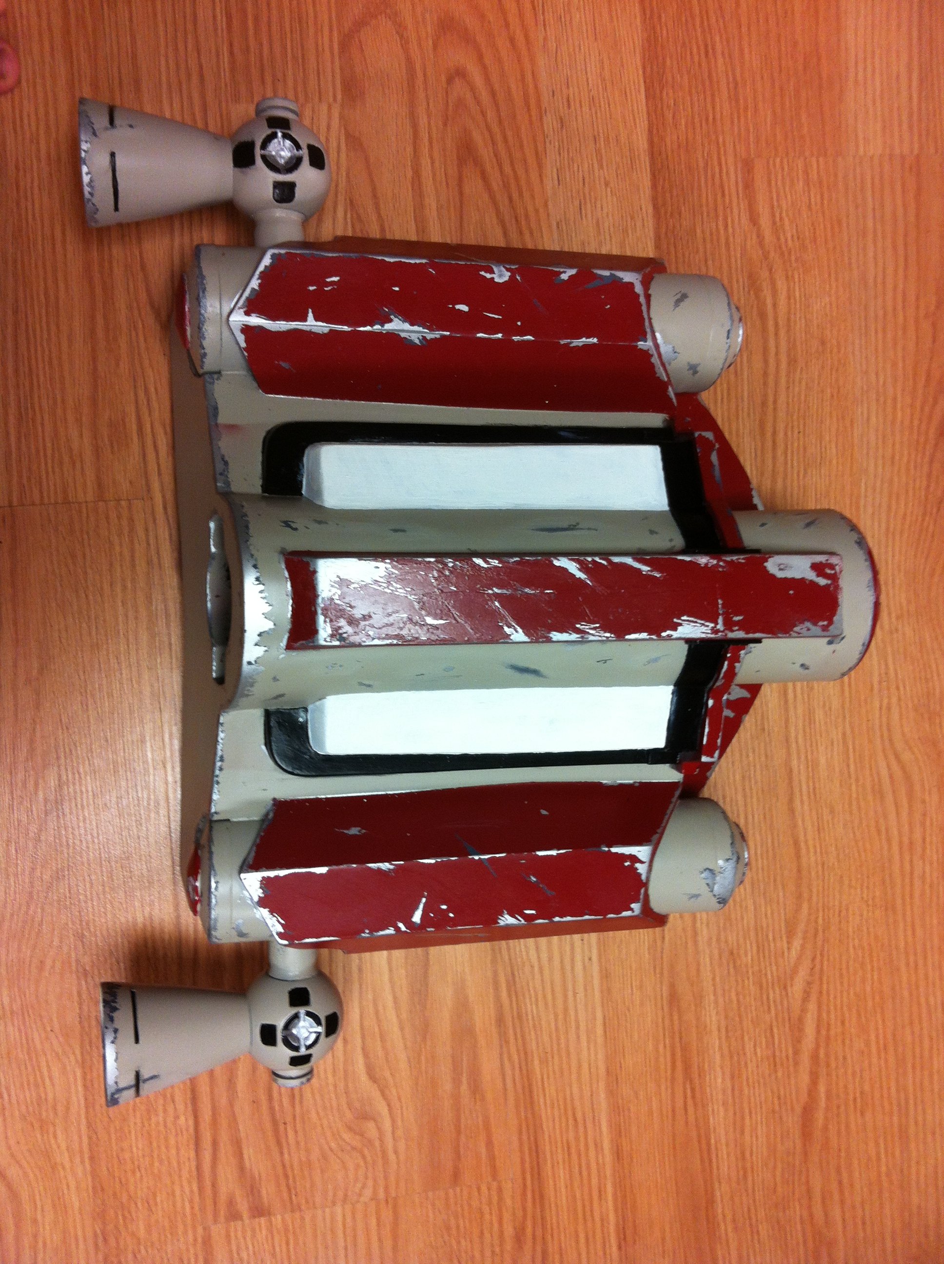

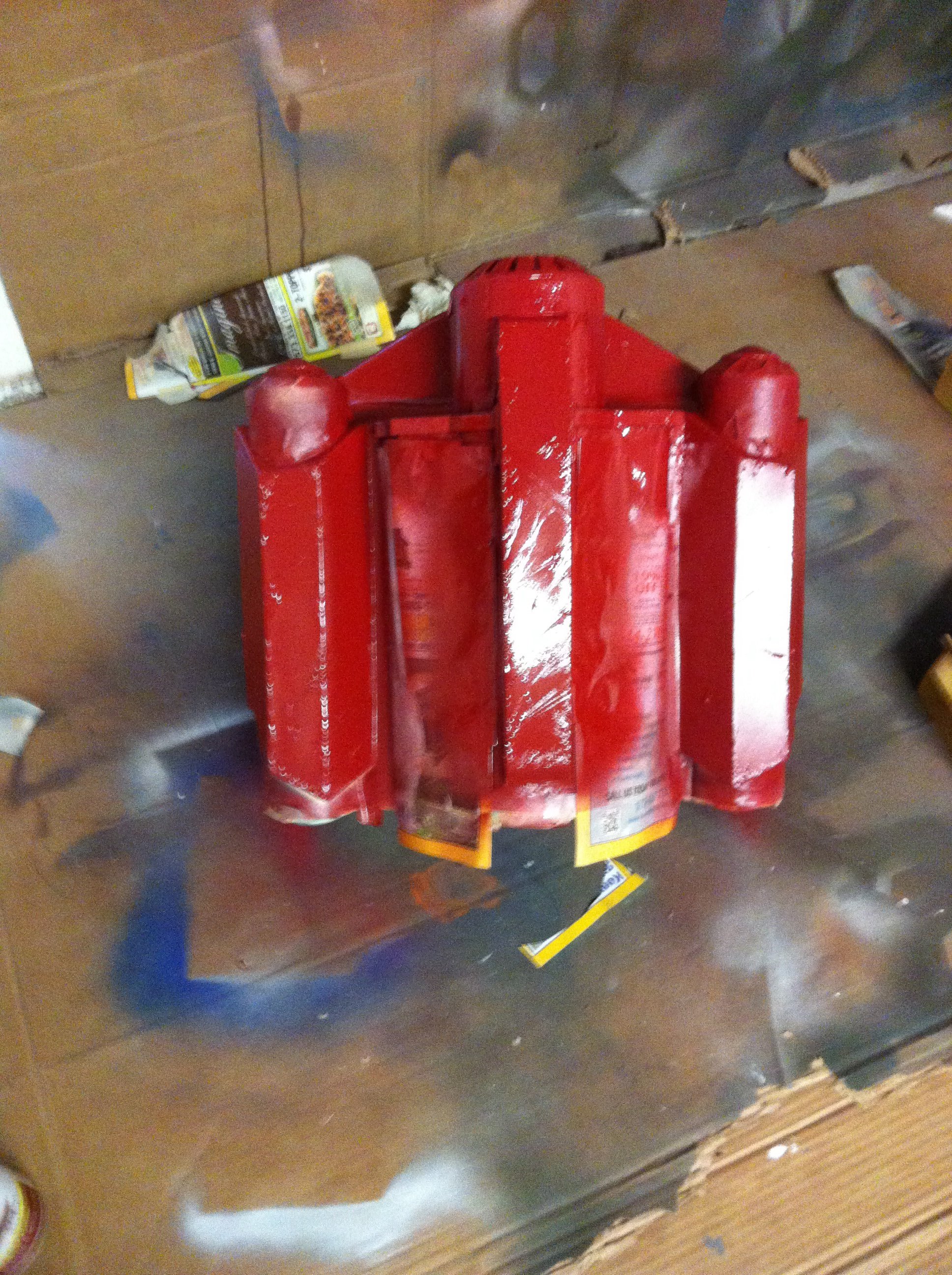

Jetpack update:

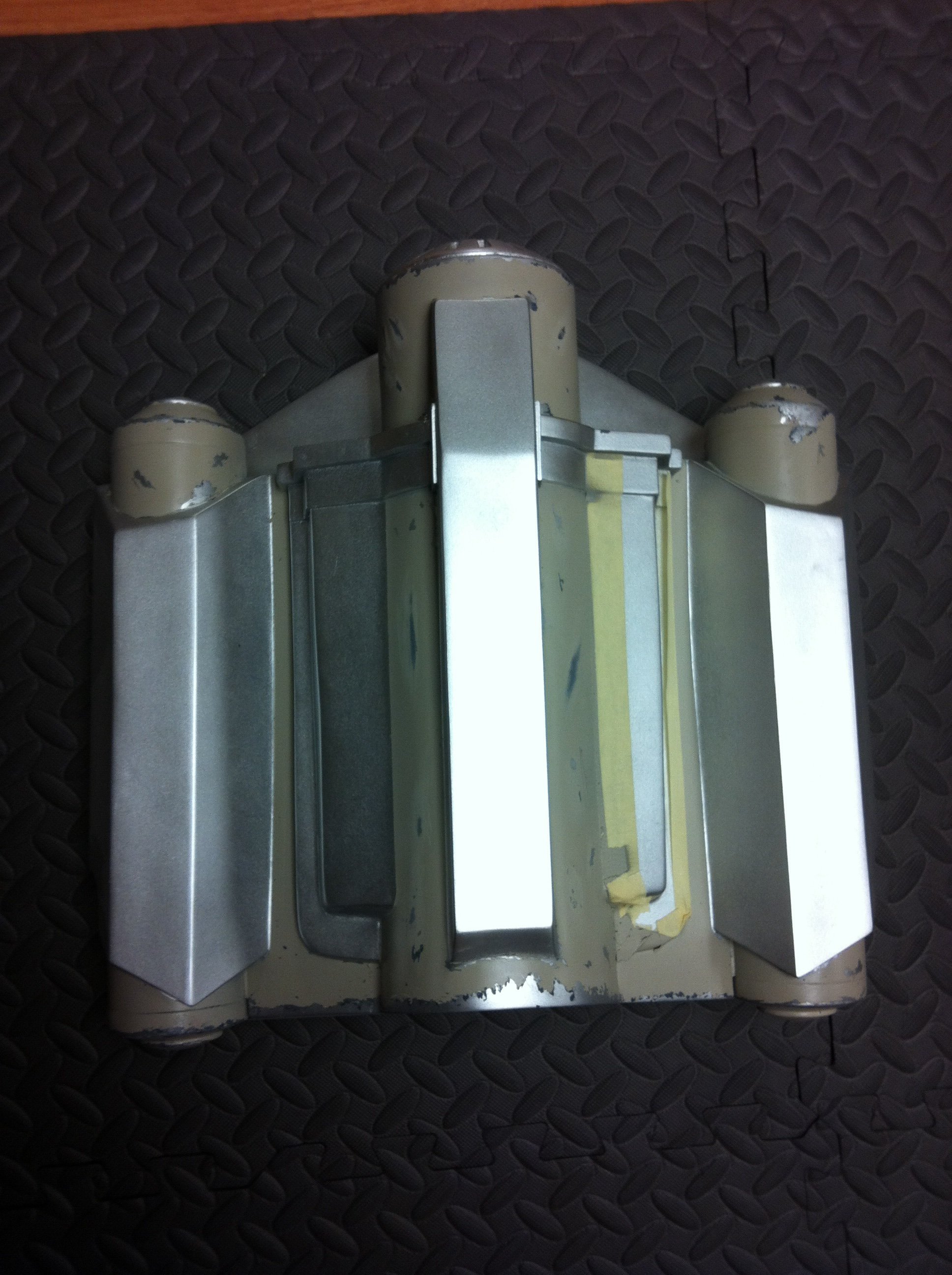

Started with a fiberglass pack from fetseven, and from what I can tell the details are spot on and the proportions are correct.
I decided to use the paint scheme adopted by JodoKast3 as my reference (I just loved the color combo). Although I will admit I took a little artistic liberty with choosing the red and went with a deep read rather that maroon. I also tried to match the tan color on the pack by using Krylon "Pebble" gray.

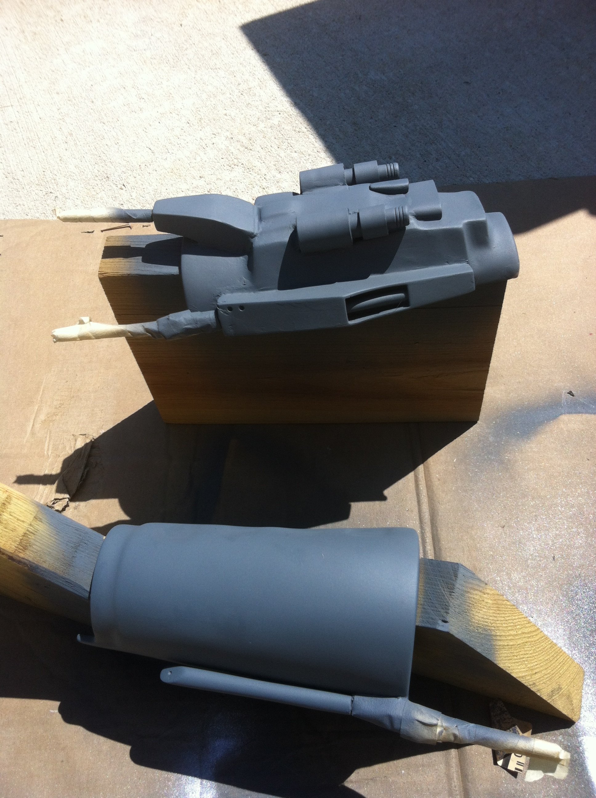

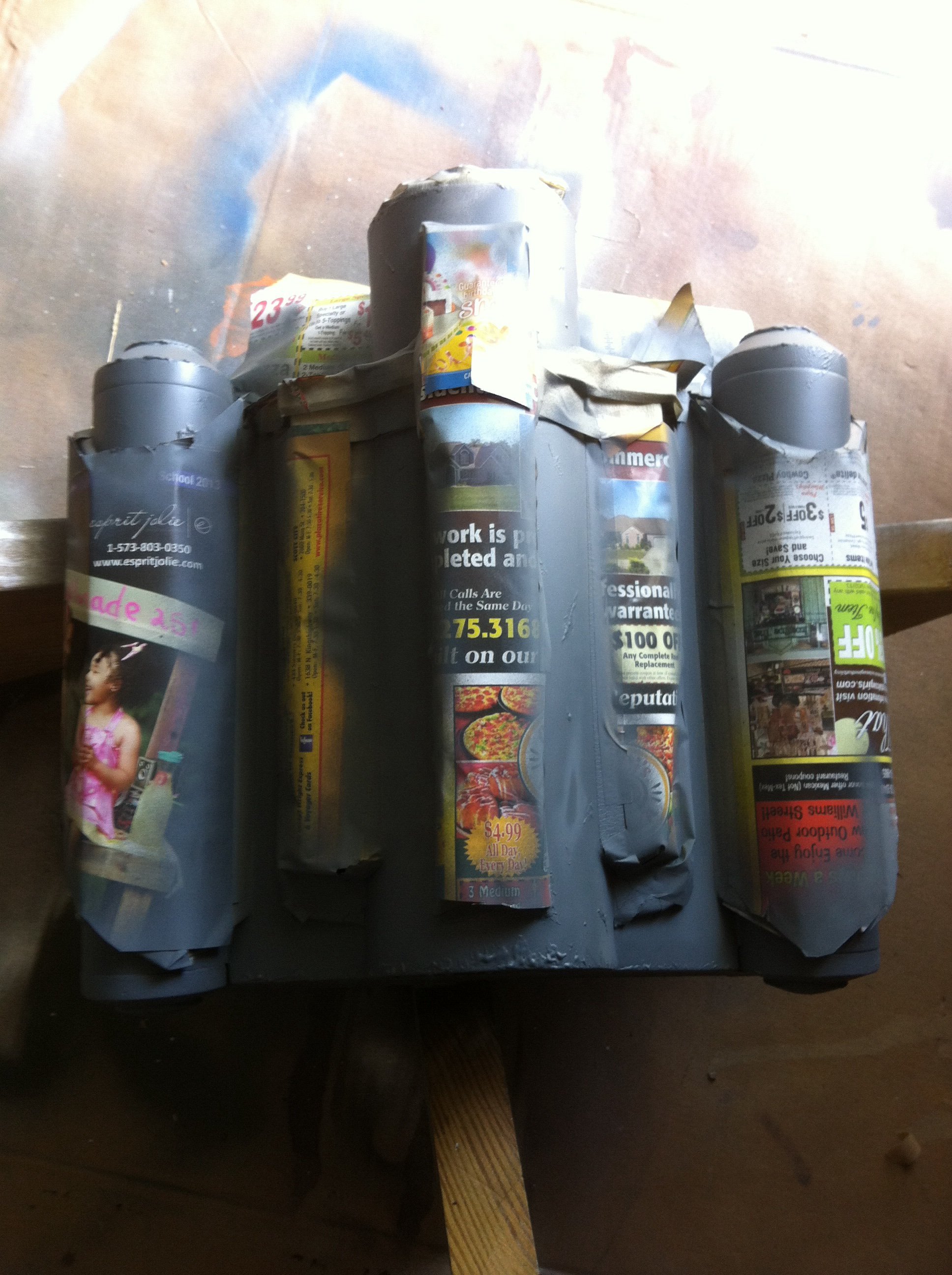

Here is the pack, primed and ready for the layered paint job.
Next I added the pebble gray

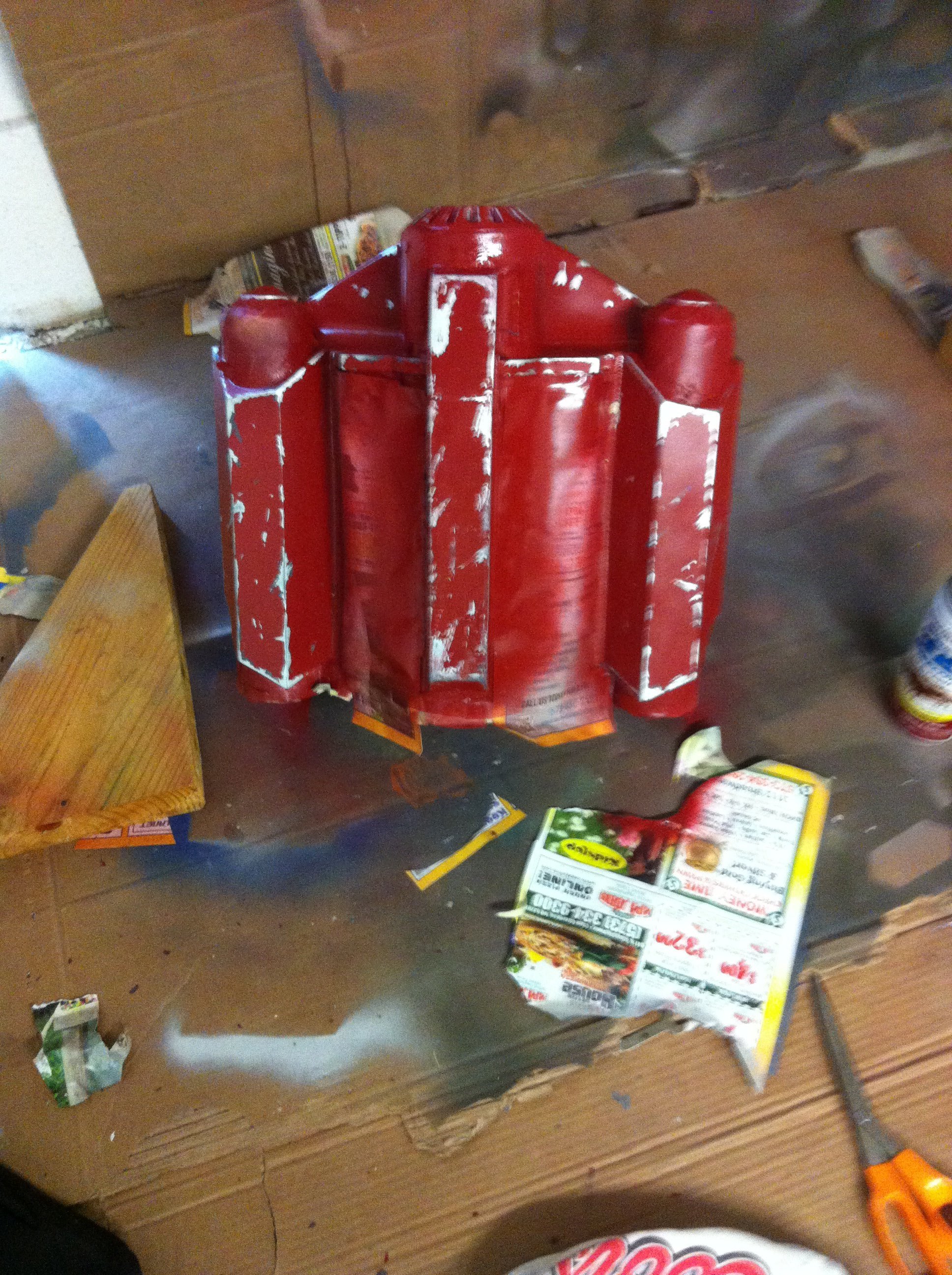

then added some red
A touch of weathering
And then hand painted the white and black, giving me a some what finished product
Now AT&T it needs is a little bit of dirt and grime (and a rocket of course) and she will be ready to fly.

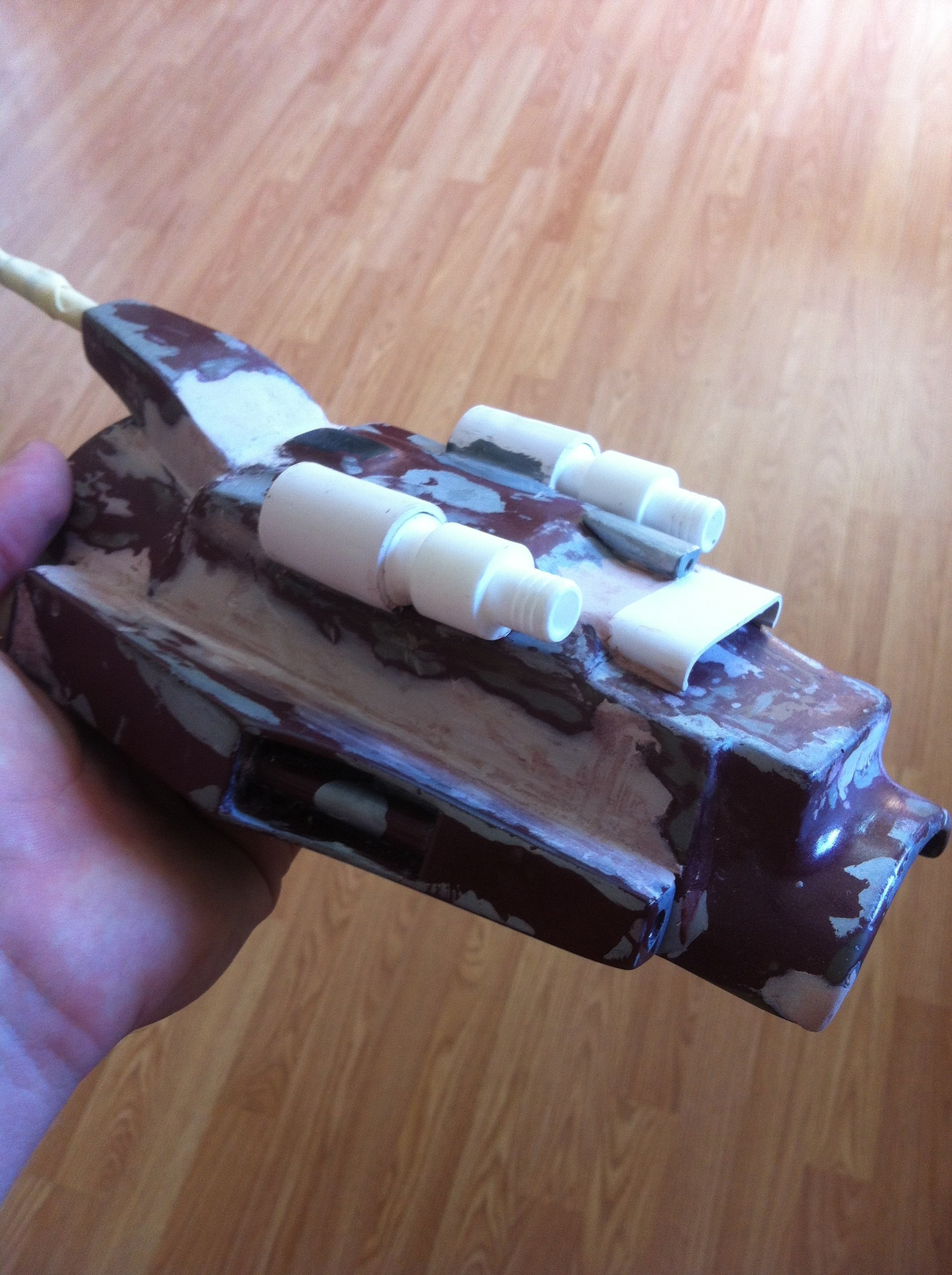

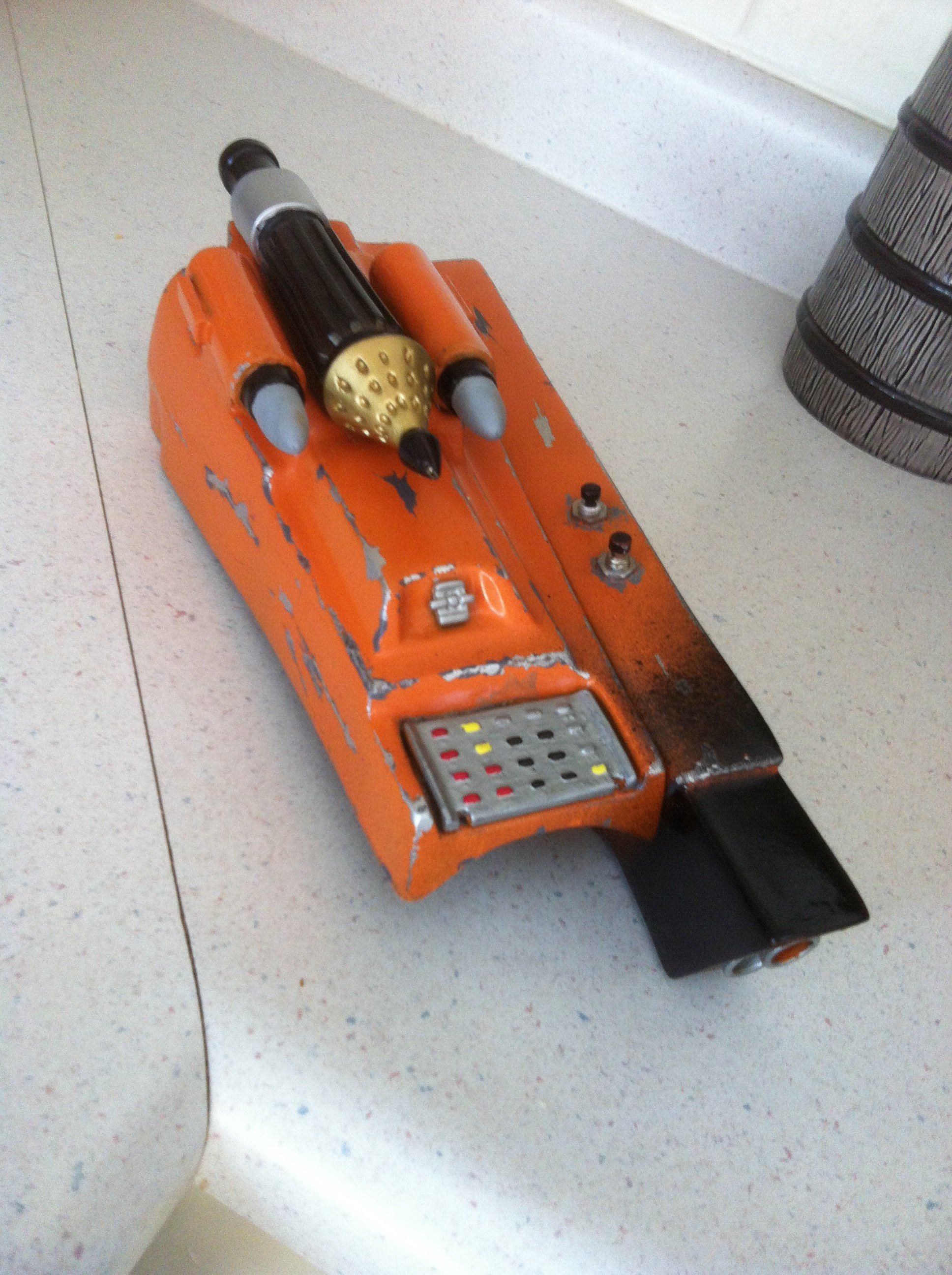

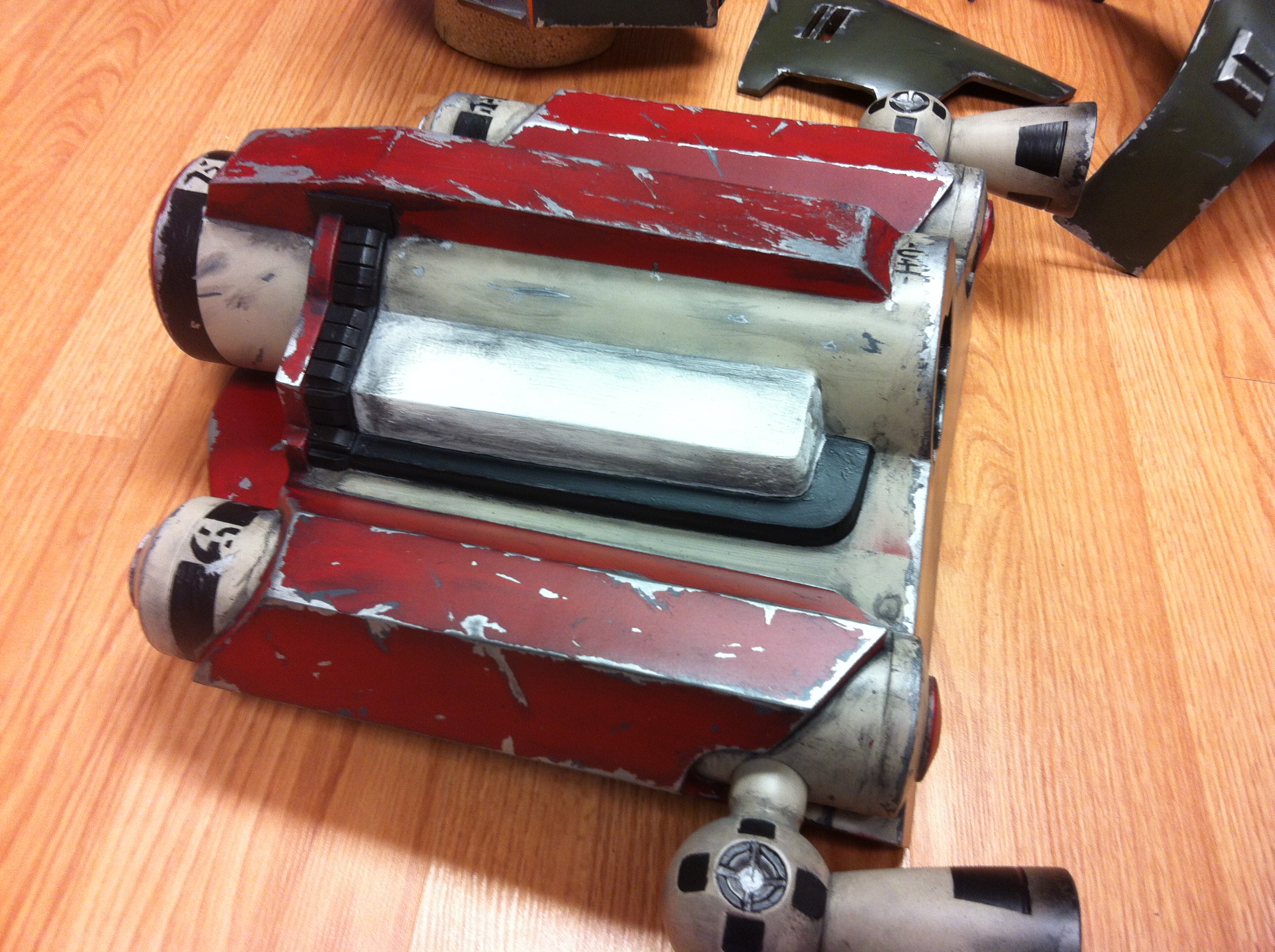

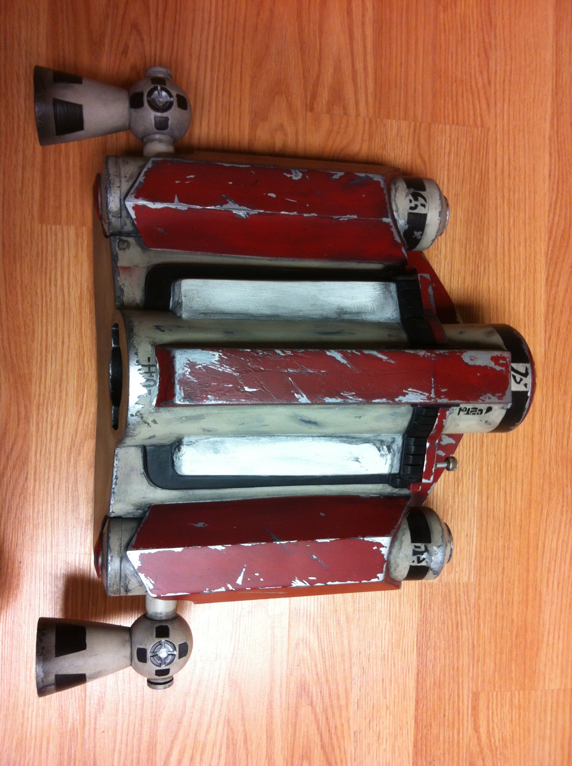

Small update on the jetpack, Finally got through with the weathering and adding the extra "markings" (most of it taken from Boba's ROTJ pack, but with a little twist) so in case people forgot, this is the before picture.
and then the after
I also made my own stabilizer out of some spare parts I had lying around.
The only thing I have left to add on is the beacon light, which I am trying to piece together at the moment.

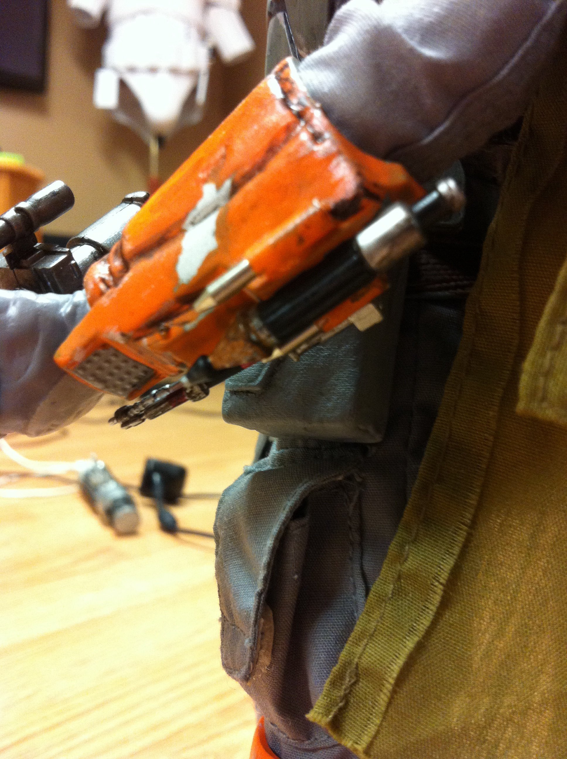

I know it's not much,and I still have to connect the other side of the gauntlet together, but I think all and all it's starting to come together, and again props to scar for giving me the scorching idea for the flame thrower. It makes the whole thing look great!

I know an update has been a while back, but I thought I would show what I have been working on during all of this time, so enjoy :)
For the light I used one of those bike lights that TK409 suggests on his website, I think it works quite well for 5 dollars. IMG_1726.JPG
The only thing thats left on it is making the cloth dirty and putting some burn marks in the cape.
Again if someone sees something that I am missing, just hollar it out. I am trying to pay attention to small details. A quick note, I separated the neck piece and back piece after some deliberation since the PVC pipe was so thick it looked odd stacked on each other. other than that everything should resemble what Boba's would be. more to come soon.

For a little bit of fun and some artistic expression, I painted the rocket top that came with my jetpack from FettSeven in a fashion that is similar to Boba Fetts, Since Kast impersonated Fett I thought it only fitting that the weathering over time my have been similar on his rocket. (you see a glimpse of the fett style rocket on Jodo's pack after Dengar saves him, although it has no coloring on it)
