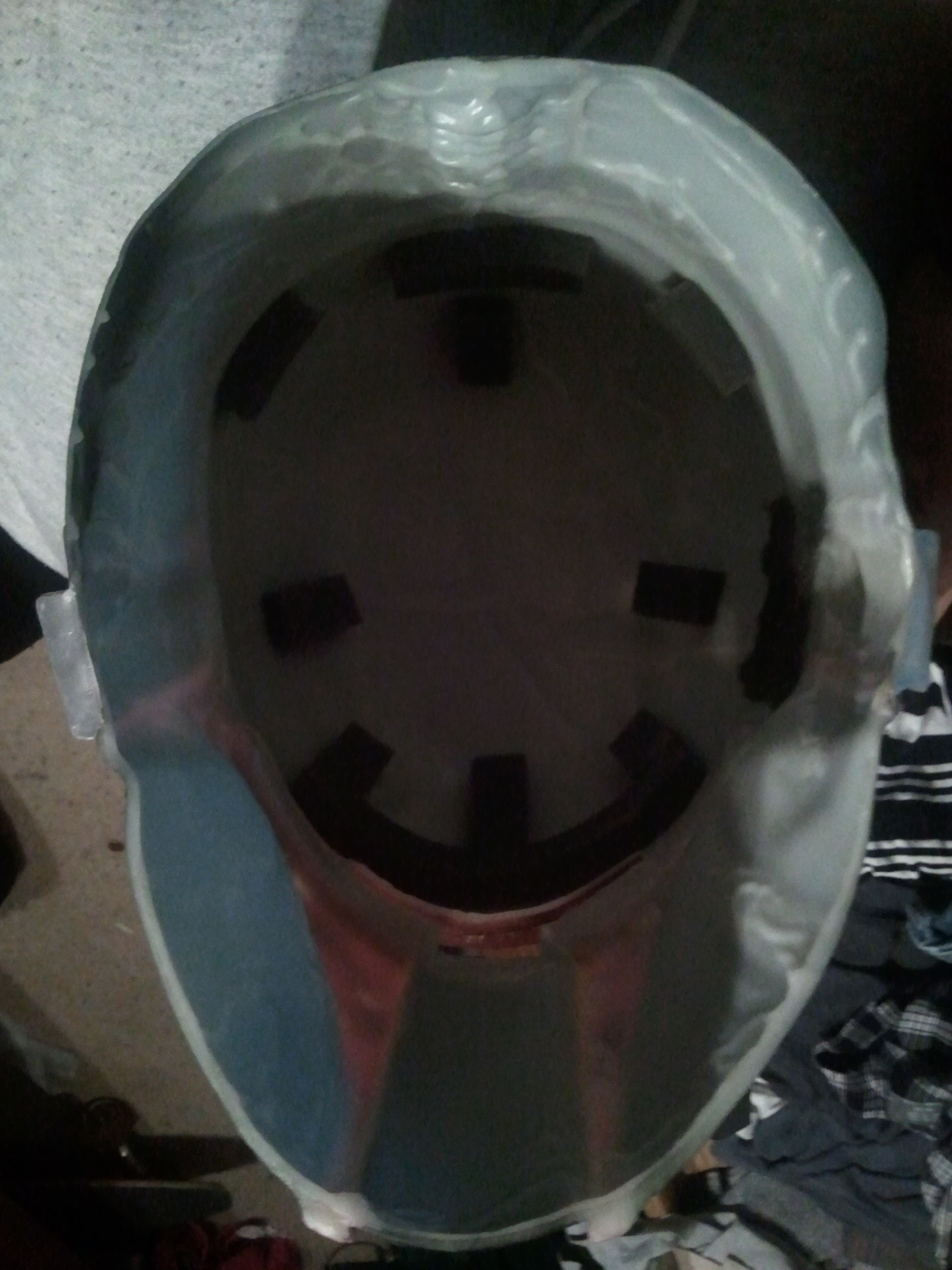

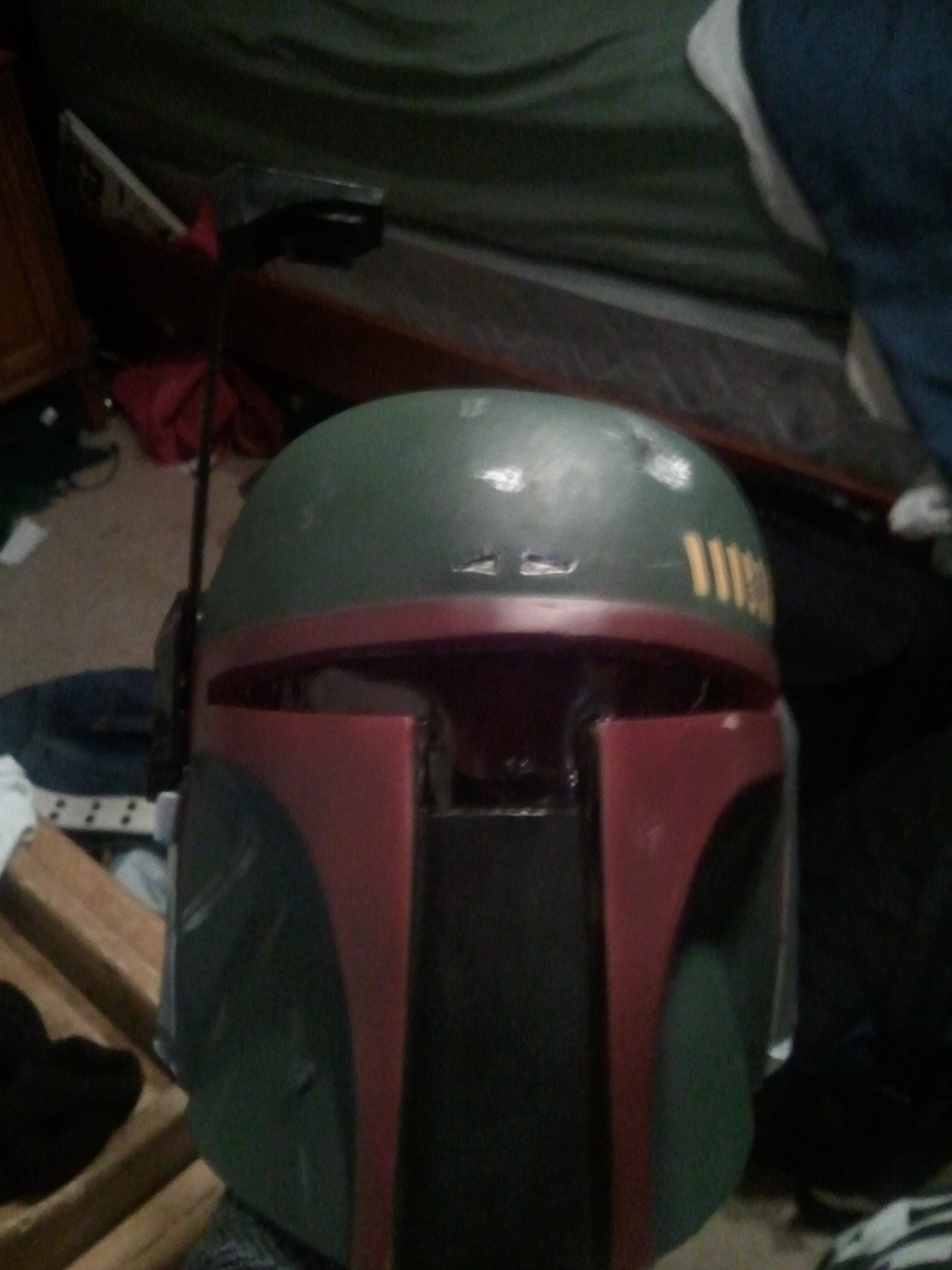

Hi, UnFathomable here. Just recently got permission to start a new thread. I recently bought a cheap rubies Boba helmet kind of low quality but it was my motivation (plan to make a new one eventually) I was so excited when I saw it that I knew I needed to buy it. Owning this helmet brought along the idea to make a full suit of armor. After little research I knew this was the place to go. Once I jumped on and browsed some threads I realized how expensive this will be. I am currently a Senior in high school and don't have the time or transportation for a job...
So despite that, what are some really cheap solutions to get me started on this project? Armor, materials, specific paint colors, cheap alternative material, anything that's not too money consuming will help. I can afford a little here and there but not much. I have already printed and cut the proper armor stencils for the torso Any help is much appreciated.

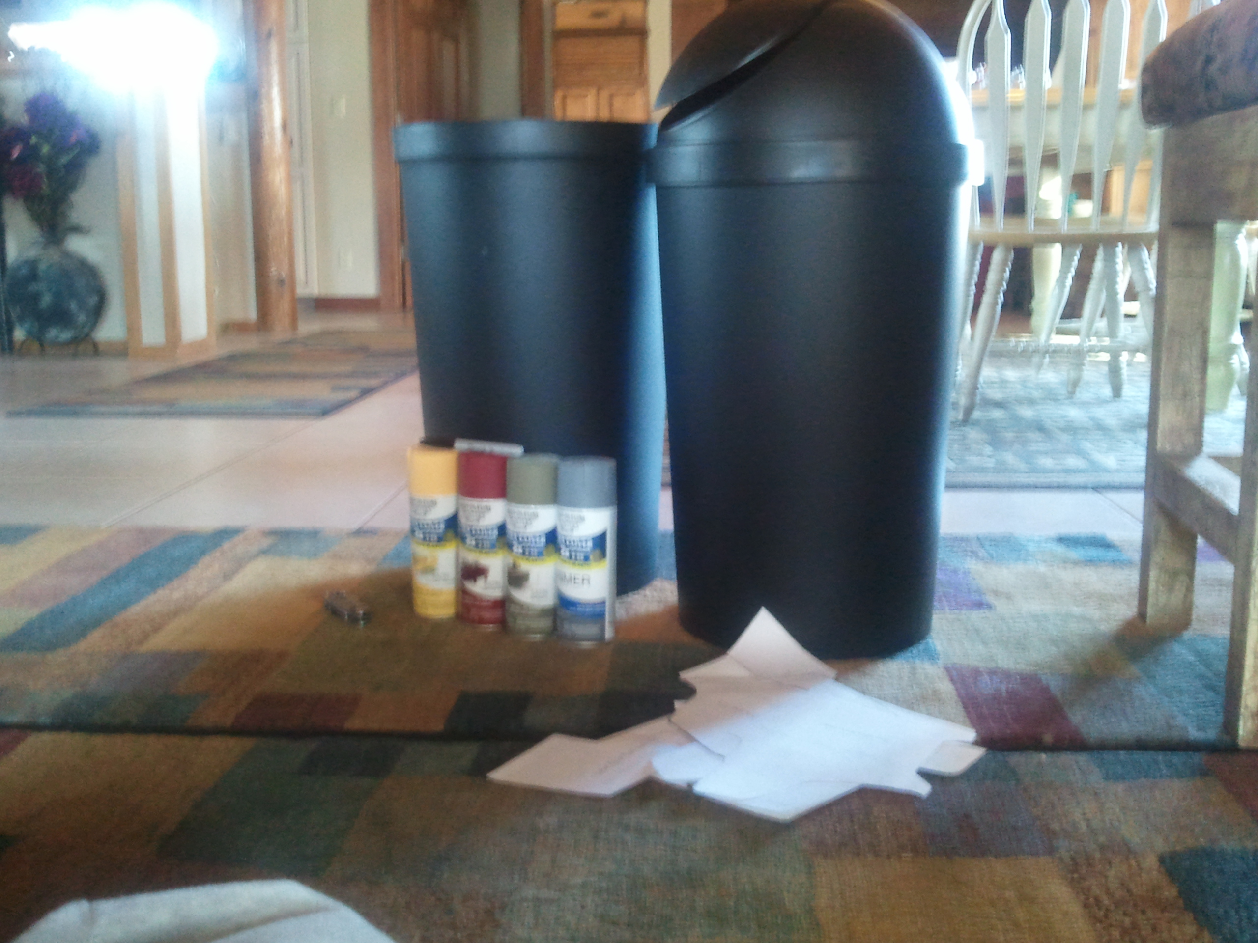

Well I decided for my first build I will do a garbage bin to practice and get a concept of How its all gonna fit and how to paint it so I dont put a set of rkd armor to shame.

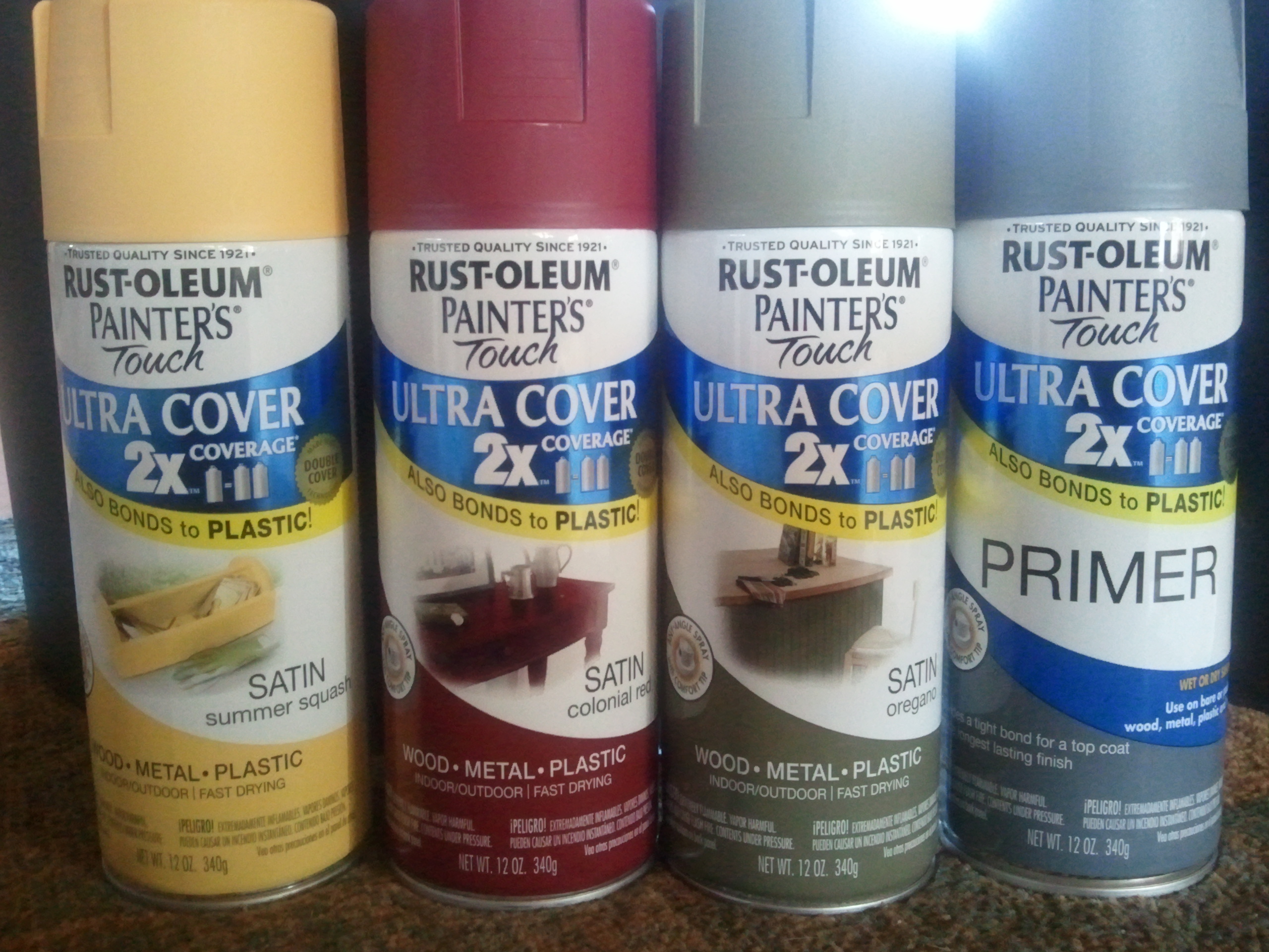

Hey dude! I started with primer and working with Rafa's stupendous stencils!
Then spray metallic silver.....Then mark the stencils with carbon paper underneath, Then put on your masking fluid (hair gel etc, But if you want better results than I got on my bin armour... I would recommend Humbrol Maskol or some other proper masking fluid)to mask out the bits you want to stay silver, then spray yellow, then mask off the bits you want to keep yellow, then spray green and then mist with a matt black... then peel off all the masking and spray again with matt black (misting). Inbetween each layer super light sanding, and if you want a more accurate paint job peel off the masking on every layer. Hope this helps!

Thanks again hobbit! Never thought I would be getting advice from the down under! Haha I am in the process of cutting everything up and was wondering what you used to cut the armor. I have been using a razor blade so far it just doesn't let me get a very good grip on it so it wears out my hand pretty quick. I have a dremel but not sure how well that would work.
