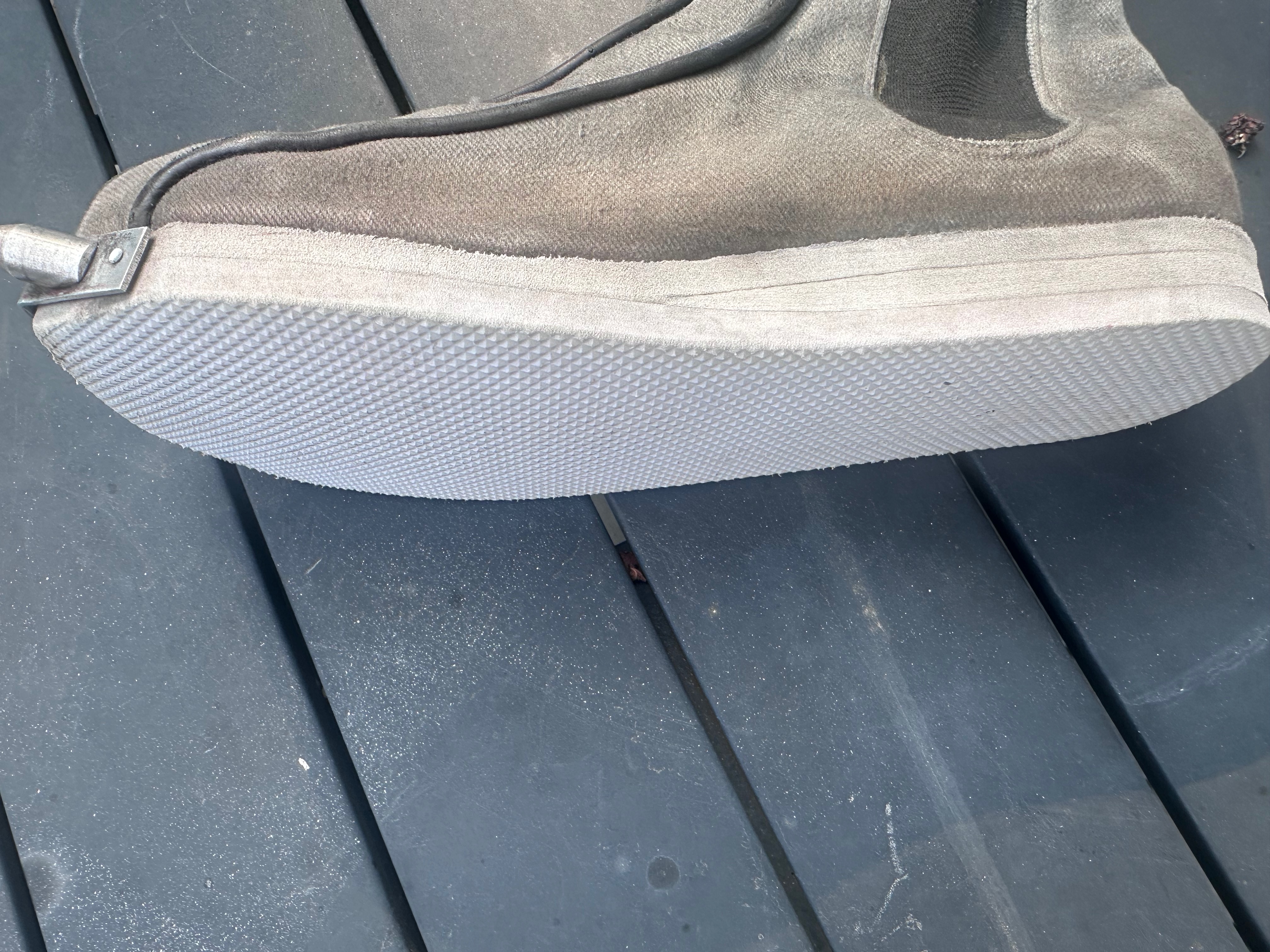

  2. The soles are made of rubber and are composed of 3 layers; the bottom layer is nearly flat to the floor with a diamond/criss cross pattern on the bottom (it’s hard to tell), the top layer conforms to the shape of the midsole, and the middle layer is nothing but a heel piece that fills the gap between the top and bottom. These three layers are all the same thickness. (or are they? I'll get to that later)

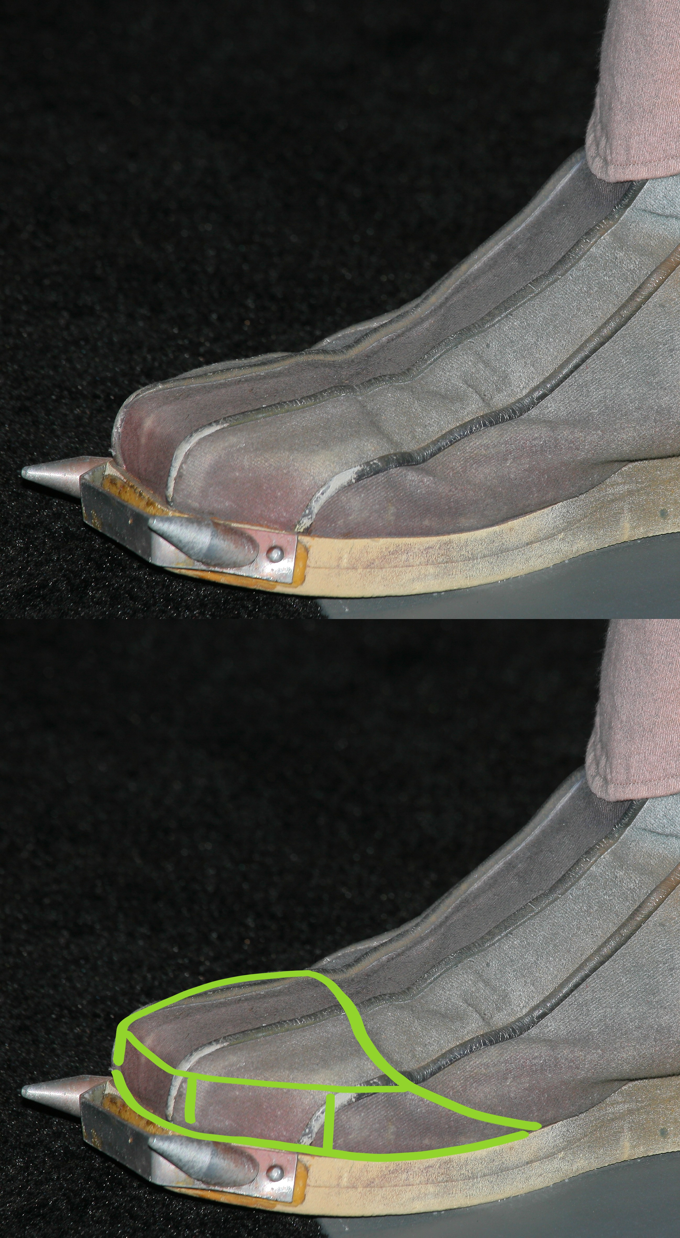

  5. The boots have a prominent toe lift. The height of this lift seems to vary from image to image and between costume versions, but this is most likely due to whoever was wearing the boots at the time.
  6. All the boots across every version of Boba Fett, like the rest of the costume, started out completely white. The fabric, elastic, rubber soles, and piping were originally white and painted over to give us the menagerie of dirty shades that we know and love. You can still see spots of white in the cracks between the piping and fabric.

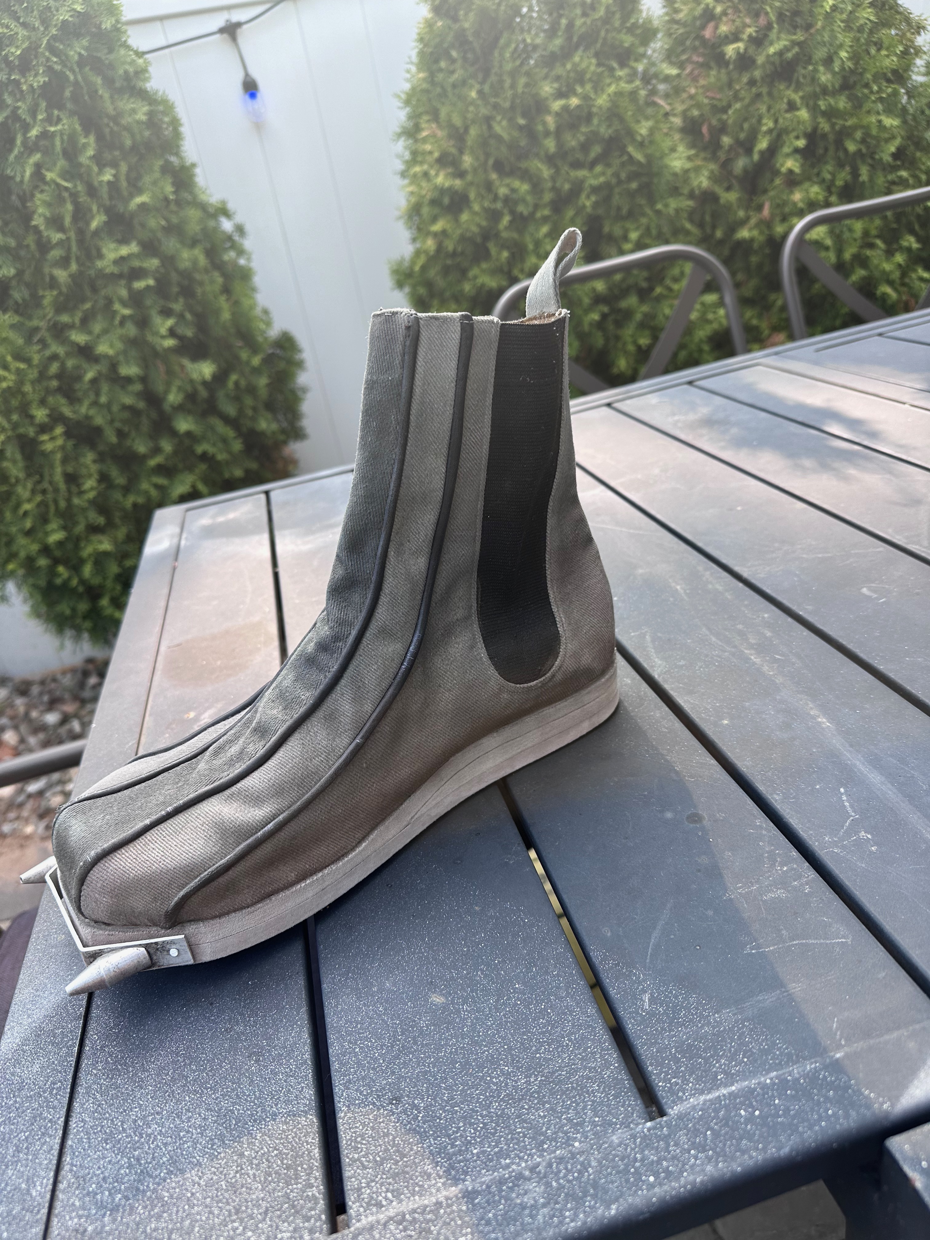

  7. The boots employ the use of stiffeners in the toe and heel to keep their iconic shape.

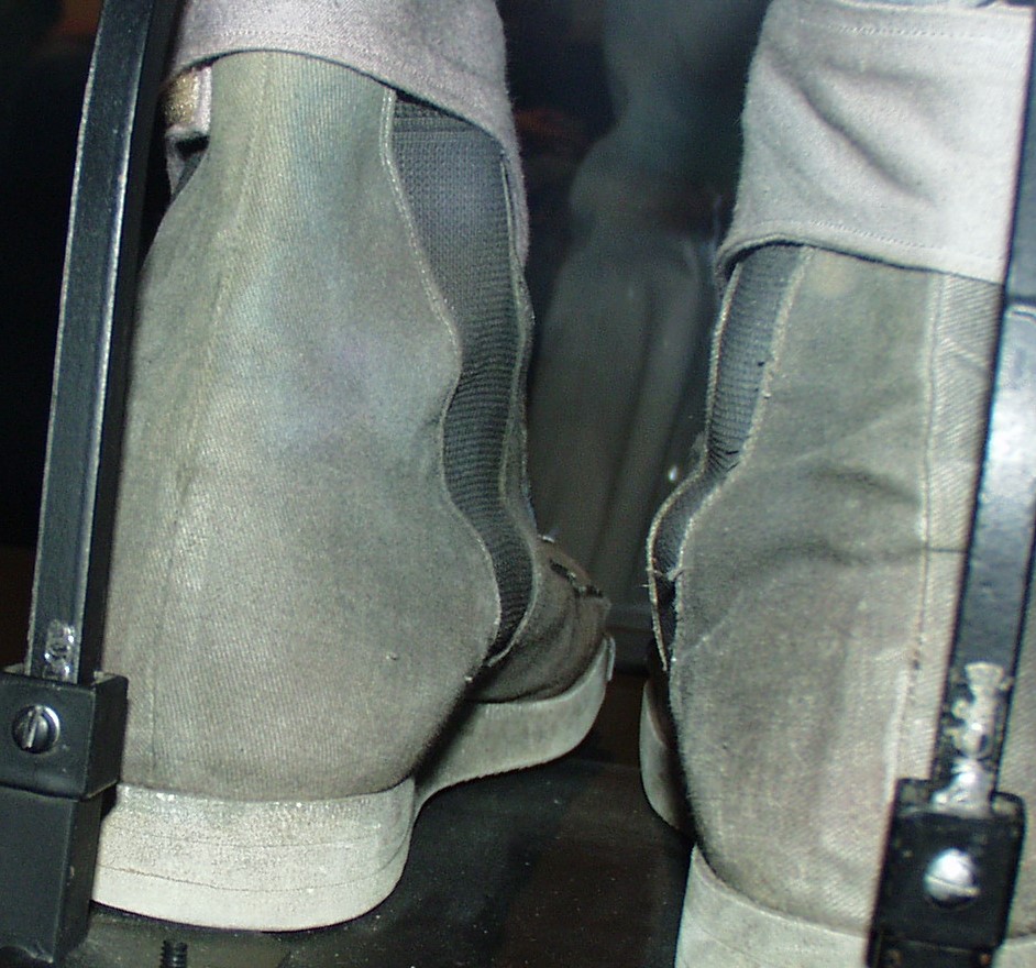

  8. The back of the boots have no backstrap. That's the extra strip of fabric that is topstitched over the seam at the back of the boots to strengthen them.

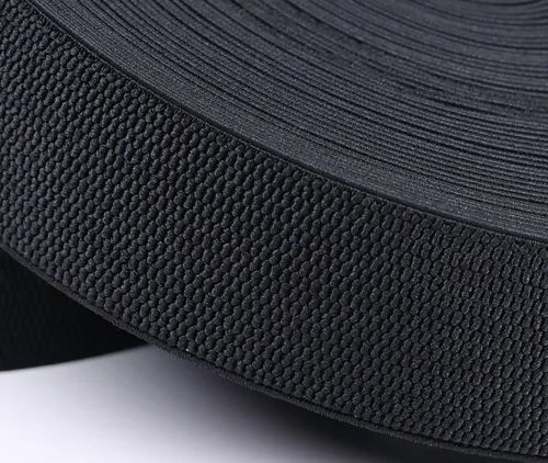

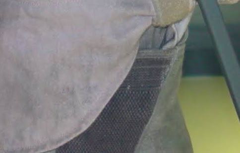

  9. The elastic (at least on the "clean spot" pair confirmed to be used in ESB) is woven with a honeycomb pattern, you can see what that looks like below and compare it with the rest of the pictures.
    Polyester Black Honeycomb Elastic Tape, Size: 2 inch at Rs 8/meter in Surat
    Interestingly, I just noticed that the ROTJ (idk what version, I only know ESB lol) pair from the last point does not have this honeycomb pattern. It just has a standard woven pattern you find on ordinary elastic. Interesting inconsistency. Side note, I cannot for the life of me find honeycomb woven elastic that comes wide enough for these boots (I measured ~5" according to my shoe last model), so if anyone could help me out sourcing some elastic for these boots, that'd be great.
  10. Keeping on the topic of stitches, the elastic has two rows of topstitching around it. This seems pretty common on Chelsea boots.

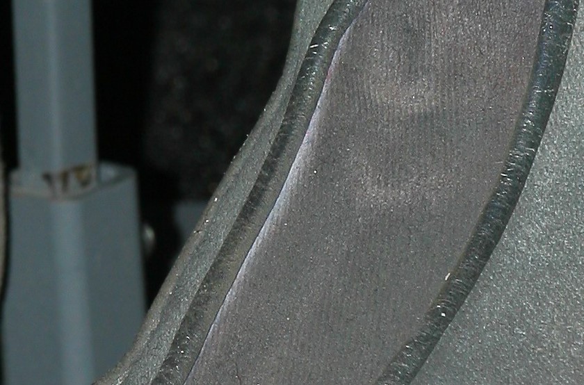

  12. There is the ghost of a seam down the exact middle of the boot. This is probably a seam in the lining, but I have no idea what its purpose is. Perhaps the piping is only attached to the outer layer of canvas?

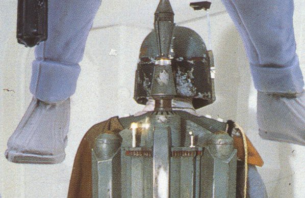

  13. I already said this in passing during the intro post, but the boots have two short pull tabs at the very top of the shoe around the opening—one at the front and one at the back.

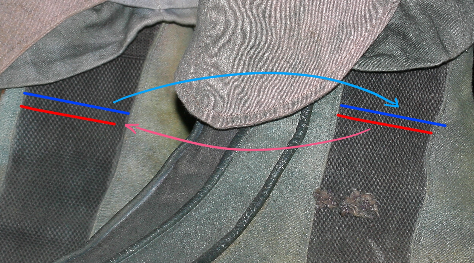

  15. The U-shaped elastic section looks like it is slightly wider on the inside of the boot than it is on the outside. I know “looks like” isn’t good enough, but it’s the best we have.
    In fact, the parallax should be working against these measurements here.
  16. The bottom layer of the sole is not perfectly flat. Obviously, there’s a toe lift, but besides that, near the halfway point of the shoe, where the middle layer of the sole begins to taper off, the bottom layer rises slightly before falling level again. This could be due to the middle layer not being cut perfectly to the curve of the top layer, or due to the shape of the midsole. There’s no way to know for sure as far as I’m concerned. It's also only on the inside "side" of the shoe.
    The fact that it's so consistent makes me think that the shape of the midsole is what causes this lift. Side note, that last picture was taken from Ord Mantell’s ESB build thread, and I know that it’s from the Executor Bridge scene, in fact I know where the B+W version of it is, but I have no clue where he got a color version of that photo in such a high resolution. I can’t find it anywhere.

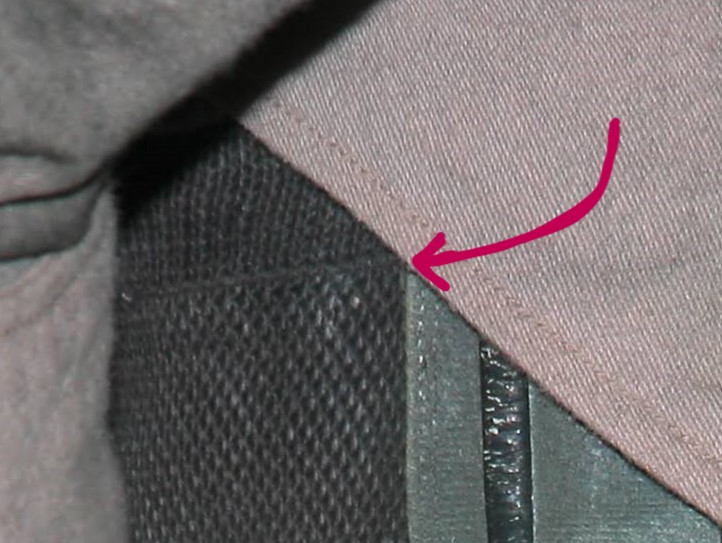

  17. Interestingly, there is a horizontal seam in the U-shaped sections ~½” from the top of the boot, bridging two pieces of elastic. I originally thought this was because the elastic wasn’t tall enough to make it to the top of the boot. I now think this was done because the U-shaped section angles forward too much, meaning that the top of the elastic would not be flush with the top of the boot. I think I can even see the lower piece of elastic’s grain angles forward compared to the top.
    Here you can also see the top of this section has some fold-over elastic sewn to the top of it. I'm not sure what kind of stitch they used, it could be a normal zig-zag stitch, or it could be a cover stitch that you need a specialty machine for. I can't tell because nobody takes pictures of these crevices.
    Also, remember how we were talking about honeycomb weaves earlier? Well, this top section has a standard weave, so that's interesting.

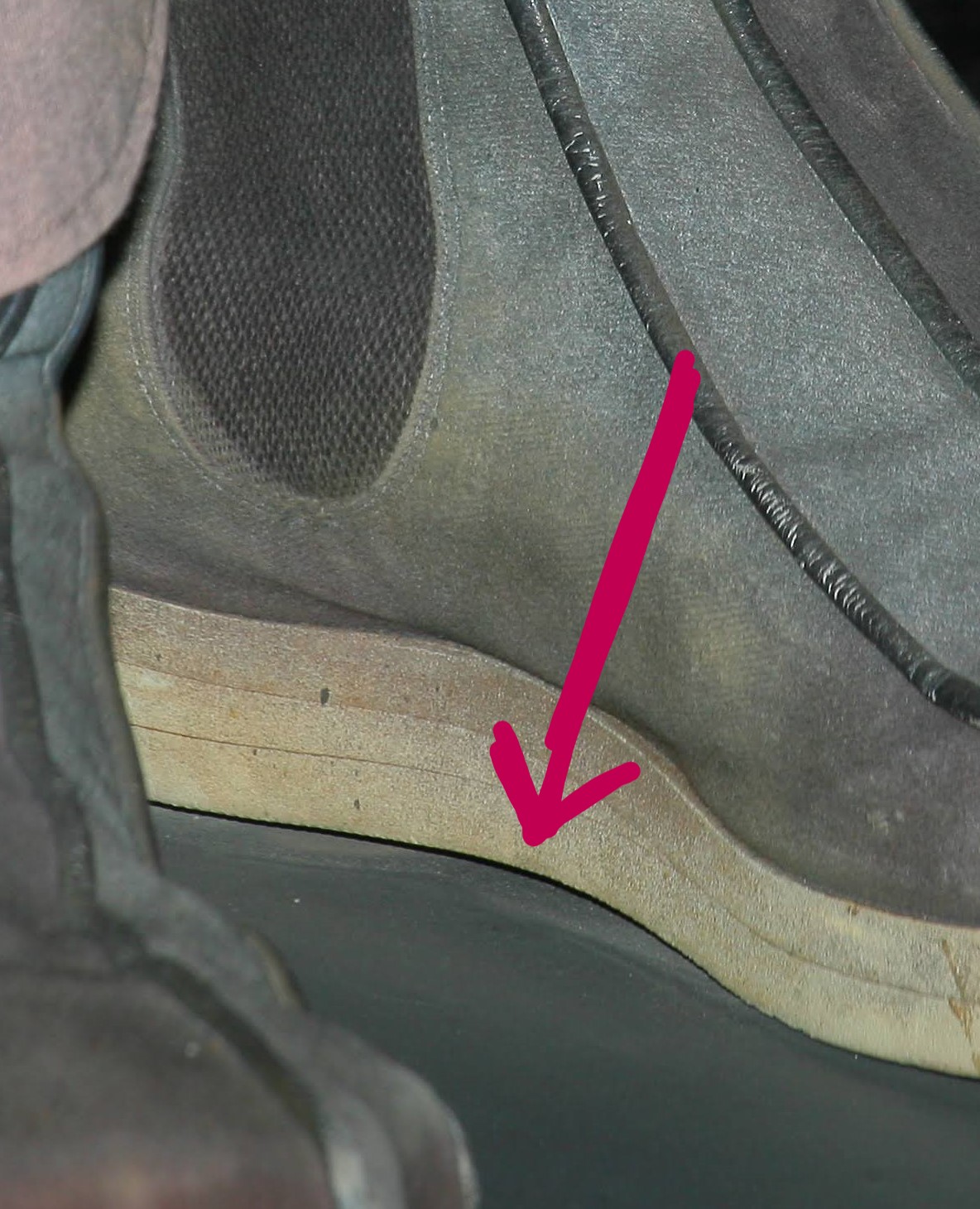

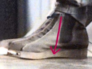

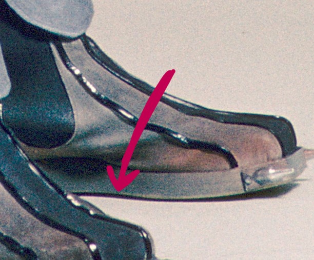

  18. The outer shape of the sole appears to slope downward slightly near the back.

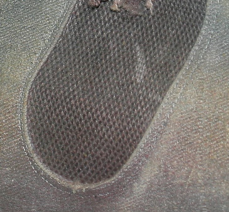

  19. The texture on the bottom of the sole may have been a separate sheet of rubber that was attached to the bottom layer. This is because if you look EXTREMELY close, the bottom layer IS thicker than the other two. The seam between the bottom layer and the texture must be microscopic if it is there, but I have confidence that it is, since I can't really think of another way this could have been done.

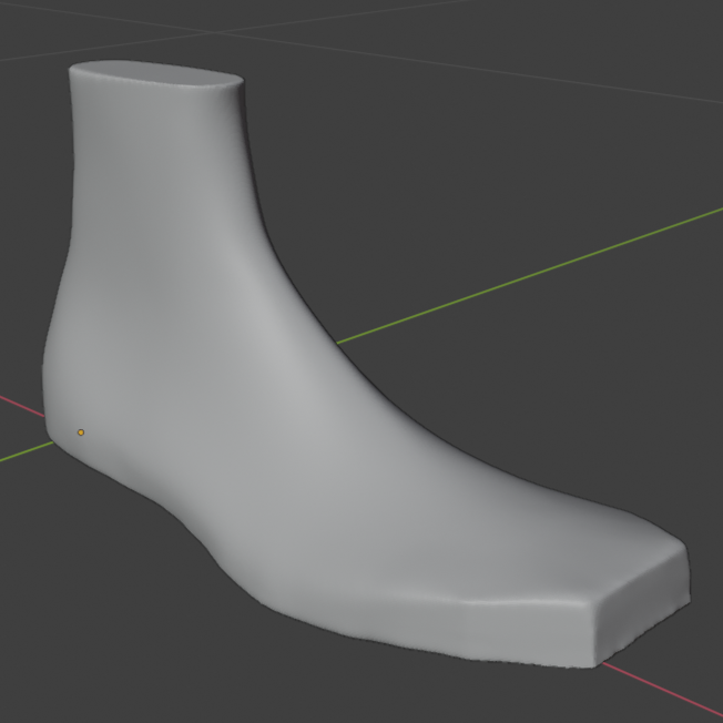

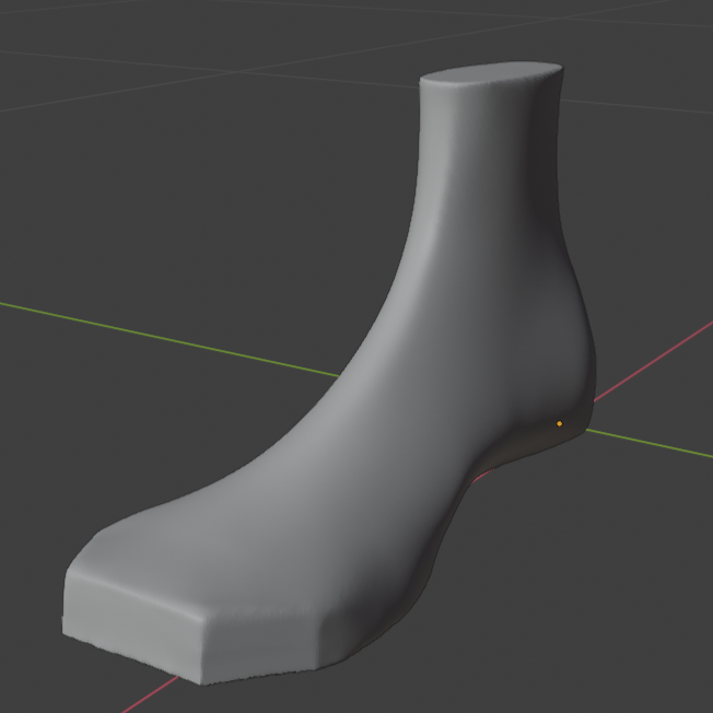

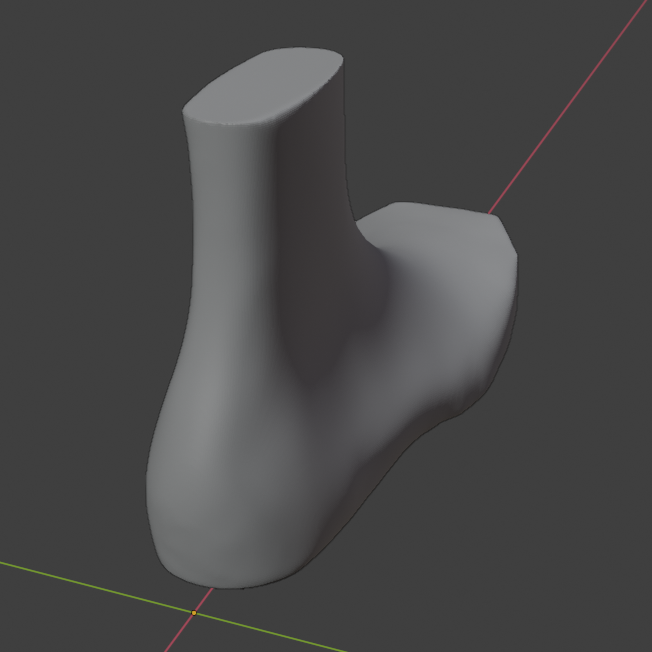

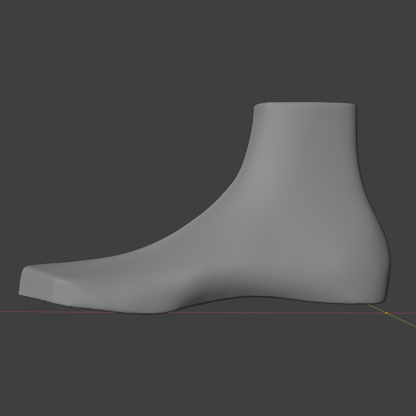

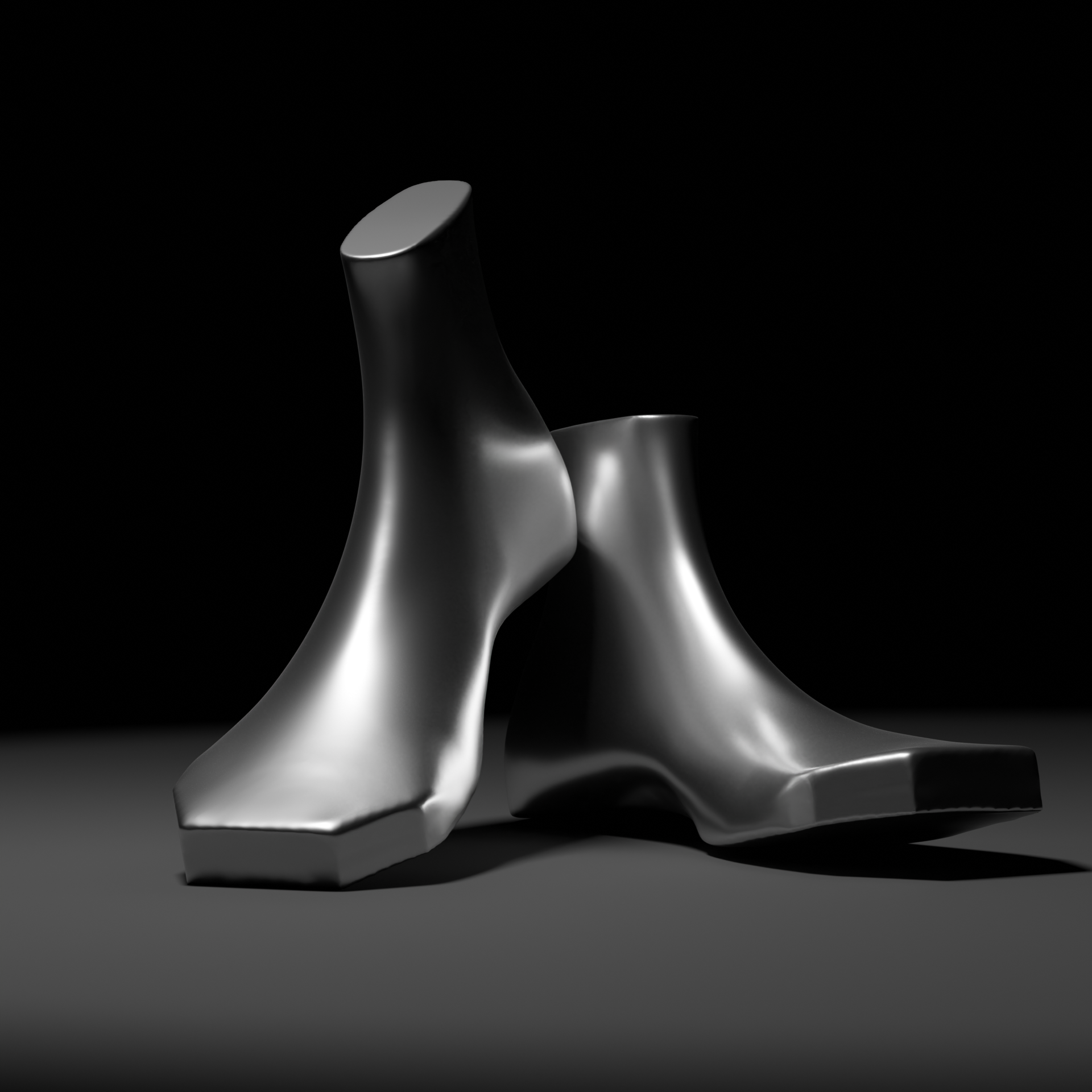

Here's the first development to start out this boot-making project, I've designed the last!
I always thought “There has to be a website or program where I can plug in my measurements and desired shoe style and get a 3D model of a last generated from that.” Well, it turns out that does exist, it's just really expensive. You have to put in an order and they model your last and even take revision requests. All that, and you only get the MODEL, not a print. Apparently, in the year of our Lord, 2024, we as a species are still making shoe lasts by hand even on computers. I mean, I can generate a model of an entire human body based on measurements, but you mean to tell me I can’t do the same with a single foot? I don’t know. What I ended up finding was a free last model on Thingiverse. It looked like a good base to start from; it had a nice toe and heel lift, the size was close, and it was free. Did I mention that it was free? Anyways, it was also free, which helped.
I threw the free last model into Blender as well as RafalFett’s toe spike model, which the spikes I own are based off of. I guess now is a good time to mention that since I’m making these boots for myself, I’m making them for my spikes—these steel ones that a friend of my dad welded for me last year.
I know they aren’t the most accurate ones ever, but I honestly love these spikes more than any other money could buy. Maybe if I end up enjoying shoemaking, I’ll get my hands on a more accurate pair of spikes and do another set of boots just for them.
Anyways, I took to modeling the toe box first, then I extended the top of the last to match my estimations for the height of the boot. I got these “measurements” from the PP2 photoshoot, where the model was too tall for the flightsuit and you can sometimes see the top of the boot.
I then joined the toe box to the last and got sculpting. I was mainly trying to smooth out the shapes and make any adjustments based off of my slew of reference images. Stuff like the shape of the heel, the slope of the shoe’s front from all angles, and the curve of the midsole, which I think was the thing causing that little lift in the sole. Here’s the final product after a few hours of digital sculpting which I am really proud of.
Now I bet a good portion of you just went "Who the hell's ankle is that skinny?" but there is a reason for that... I think...
I guess I was a bit misleading. The last obviously can't dictate what the final shoe will look like when someone's wearing it. I've never seen a shoe last this height that doesn't have that thin little ankle, and I believe it's so that the ankle hugs tighter and doesn't flop around your leg. So yeah, your leg will stretch out that ankle section and make it not so skinny looking.

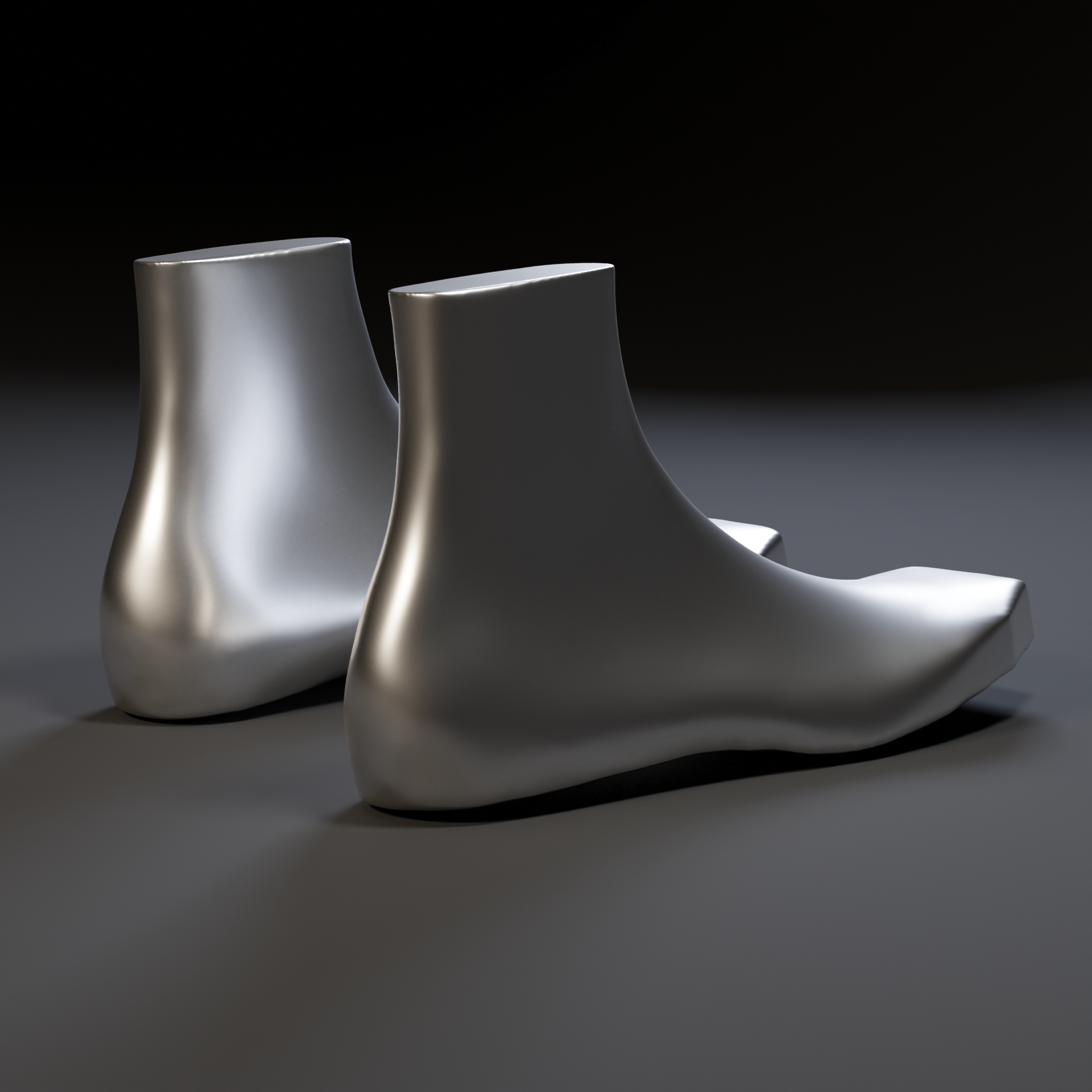

To top it all off, here’s some sexy renders that I made of the last…

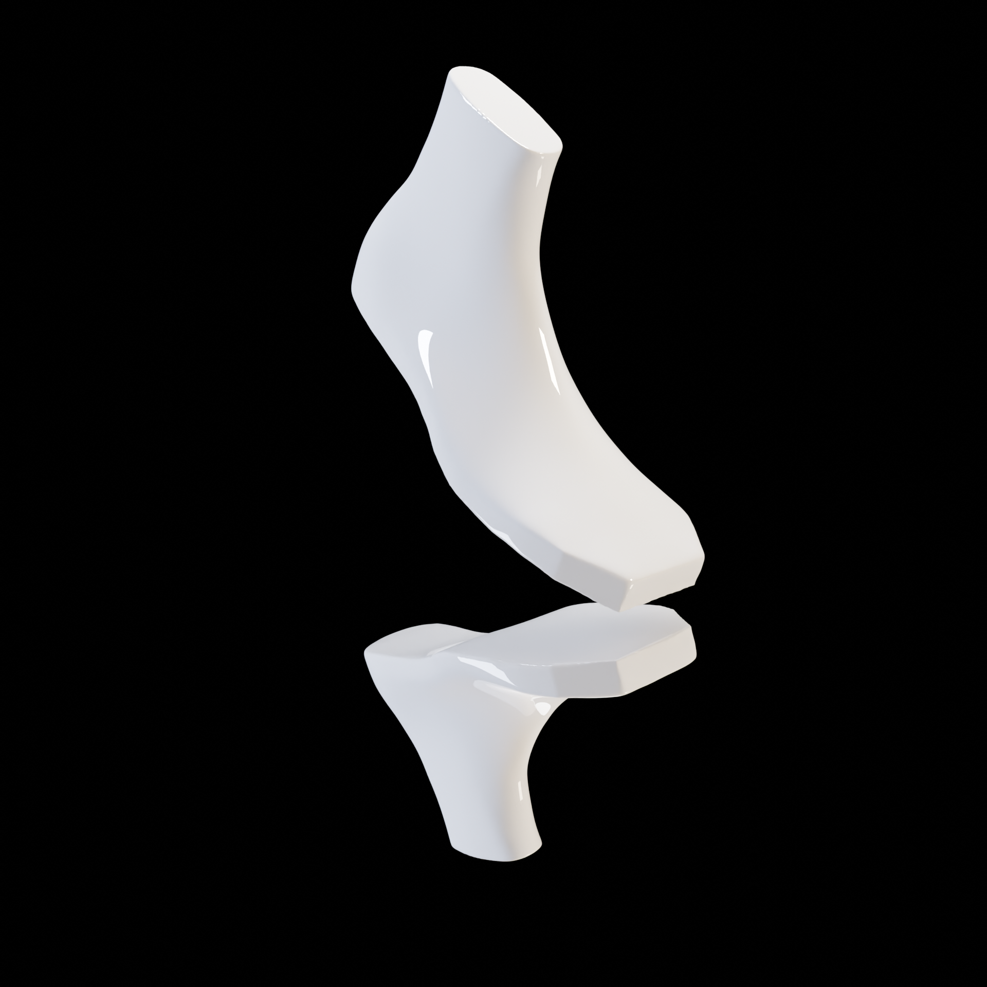

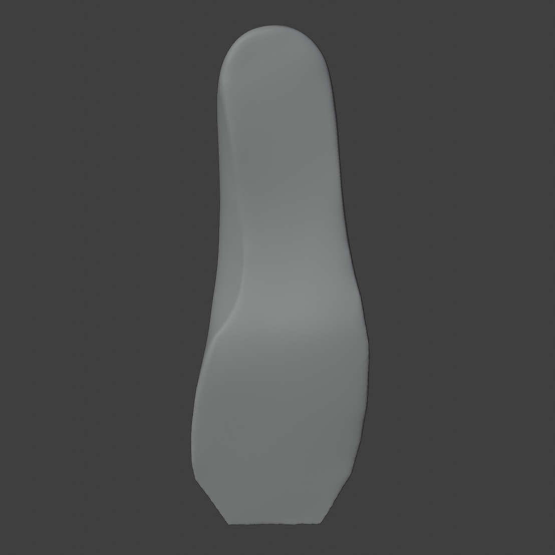

Update, I printed the last a while ago, and the verdict is that it needs more work. Obviously. I guess Boba Fett's shoe last wasn't built in a day. I'll see if I can make a comprehensive list of notes of things to change, but the main thing was that it was way too long. Other than that, some minor shape adjustments are in order. I've also been slowly adding some points to the notes page, so check those out if you want.
Here's Prototype Boba Fett Shoe Last No. 2!

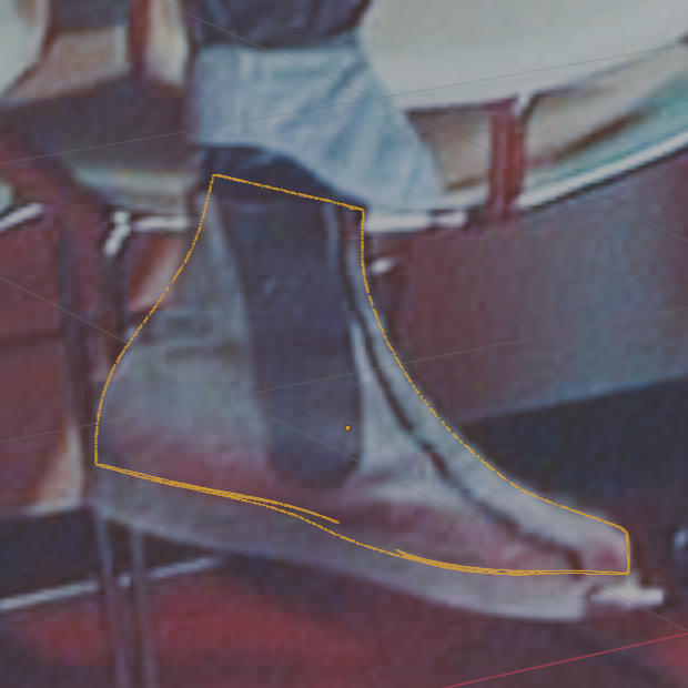

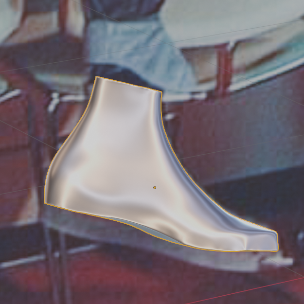

Here's some nice comparison shots with the PP2 boot - the orange outline is the outline of the model
Changes this time around:
1. I made it significantly shorter lengthwise
2. I adjusted the shape of the heel so that it changes shape depending on the angle you look at it like the original does
3. I adjusted the curve of the shoe's top? What do you call that? The bridge of the foot?
Changes to make for next version:
1. The shoe should be ever so slightly shorter lengthwise
2. The shoe should be shorter in height
3. The heel shape needs further adjusting
4. The curve of the sole needs work - the curve is too sharp where it transitions from 3 - 2 layers
5. I don't think the arch dips inward as much as I thought it did, so I need to adjust the shape of the sole.
6. Smooth out stuff for the final version

Here's the same PP2 comparison with the new and improved Third Boba Fett Shoe Last Prototype...
It may look like the bottom curve doesn't line up but that's because you can see the other side of the model where the curve starts earlier. We're looking at the partial orange line that deviates from the outline to compare it to the PP2 boot. It looks like the only thing to tweak is the very bottom of the shoe at the very front, that's kind of a weird shape. Other than that, I'd say we've got ourselves a pretty good boot model! I'll make those changes and get some better renders of it tomorrow.

Oh, well I guess by "tomorrow" I meant like 2 weeks from then lol. Here's some renders of the final last for now (that sounds redundant lol)
The next step in the process is to print this one out and see if there's any issues, then I can start patterning out the fabric and get this show on the road!
