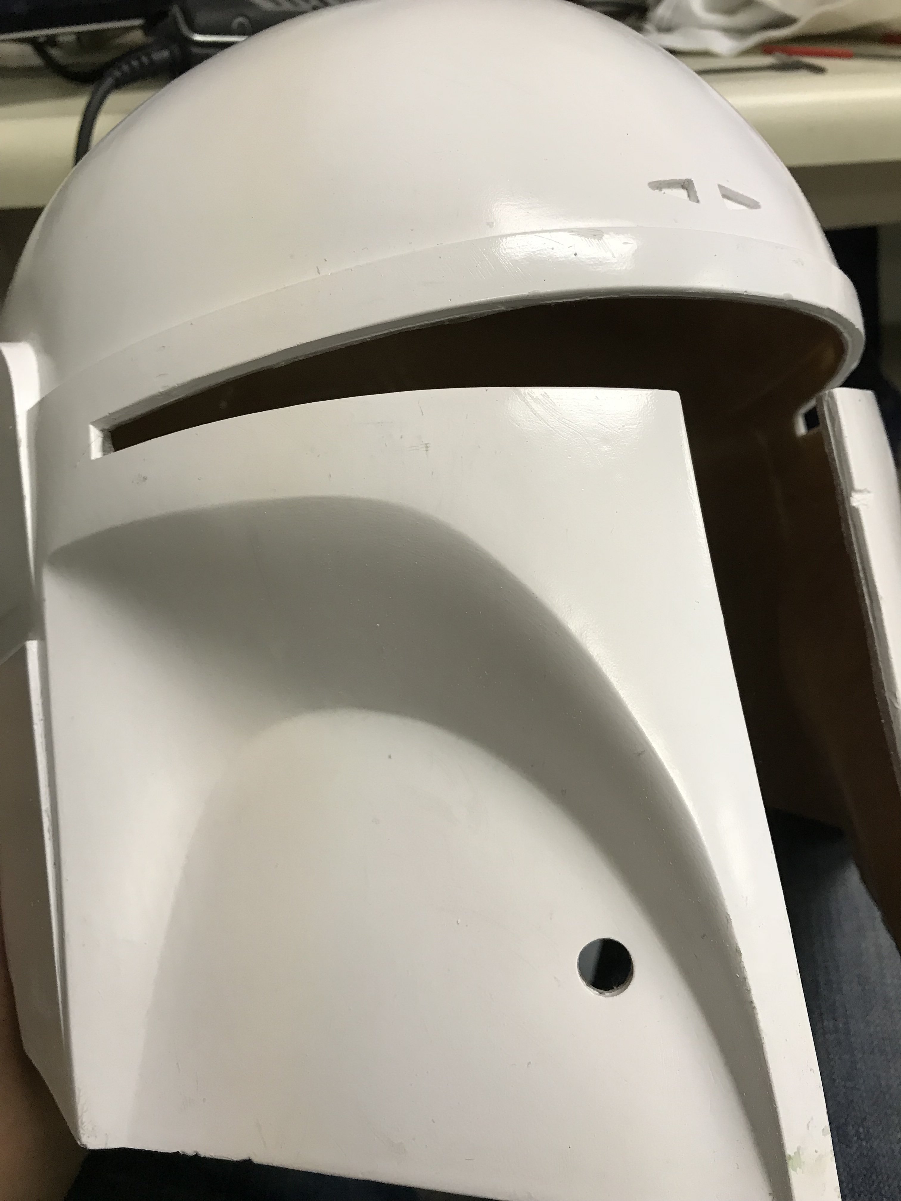

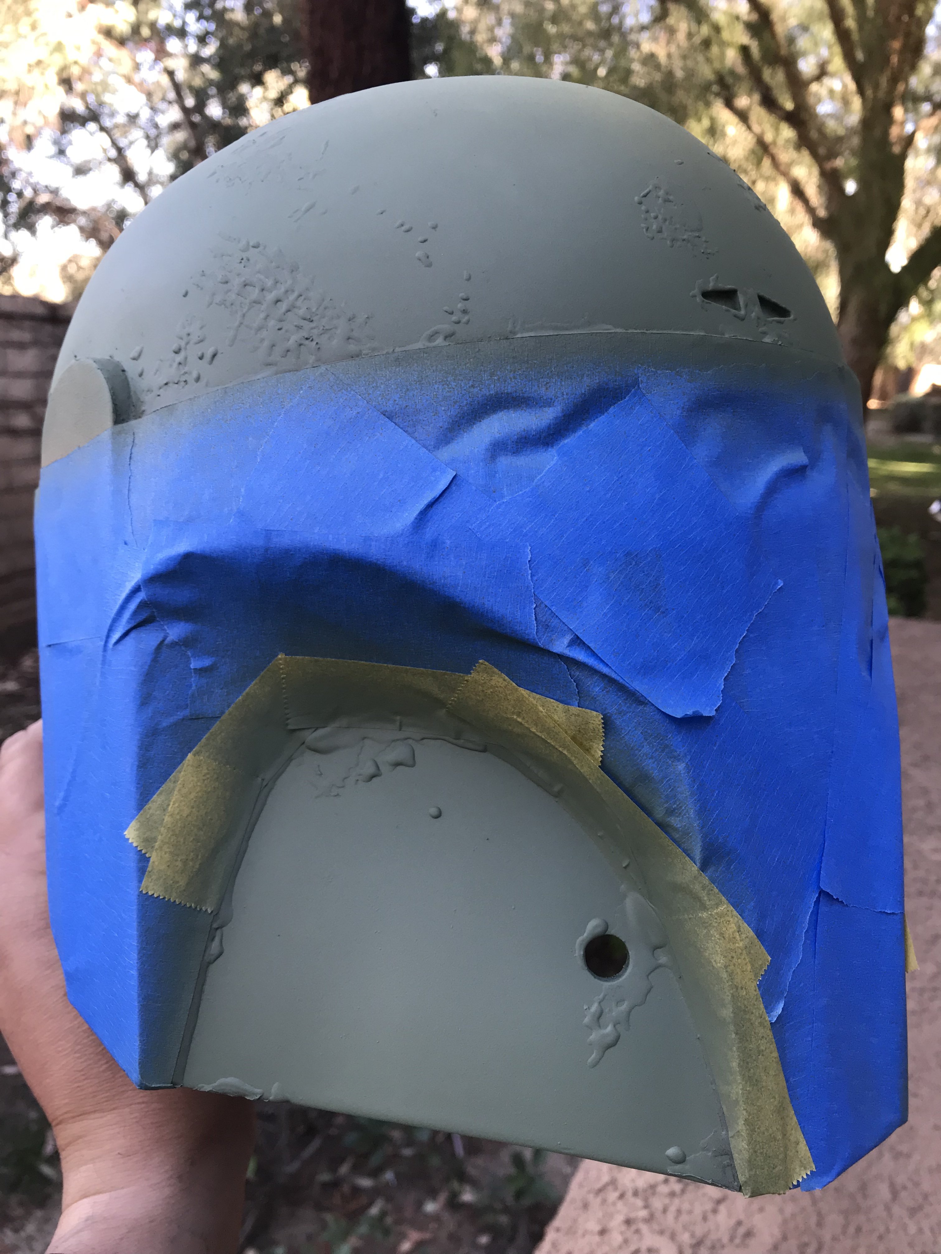

Today, before work I had some time to kill so I brought my bucket and drummer with me to do a little cutting. I started by trimming the bottom edge of the bucket of the excess edge and resin. I did this with a diamond cutting wheel, being careful of the blade and going slowly. From there out came the “T” visor and used a sanding disk to flatten and level the edges. Also hit the corners with a good old fashion file to work the corners of the visor and mandibles.

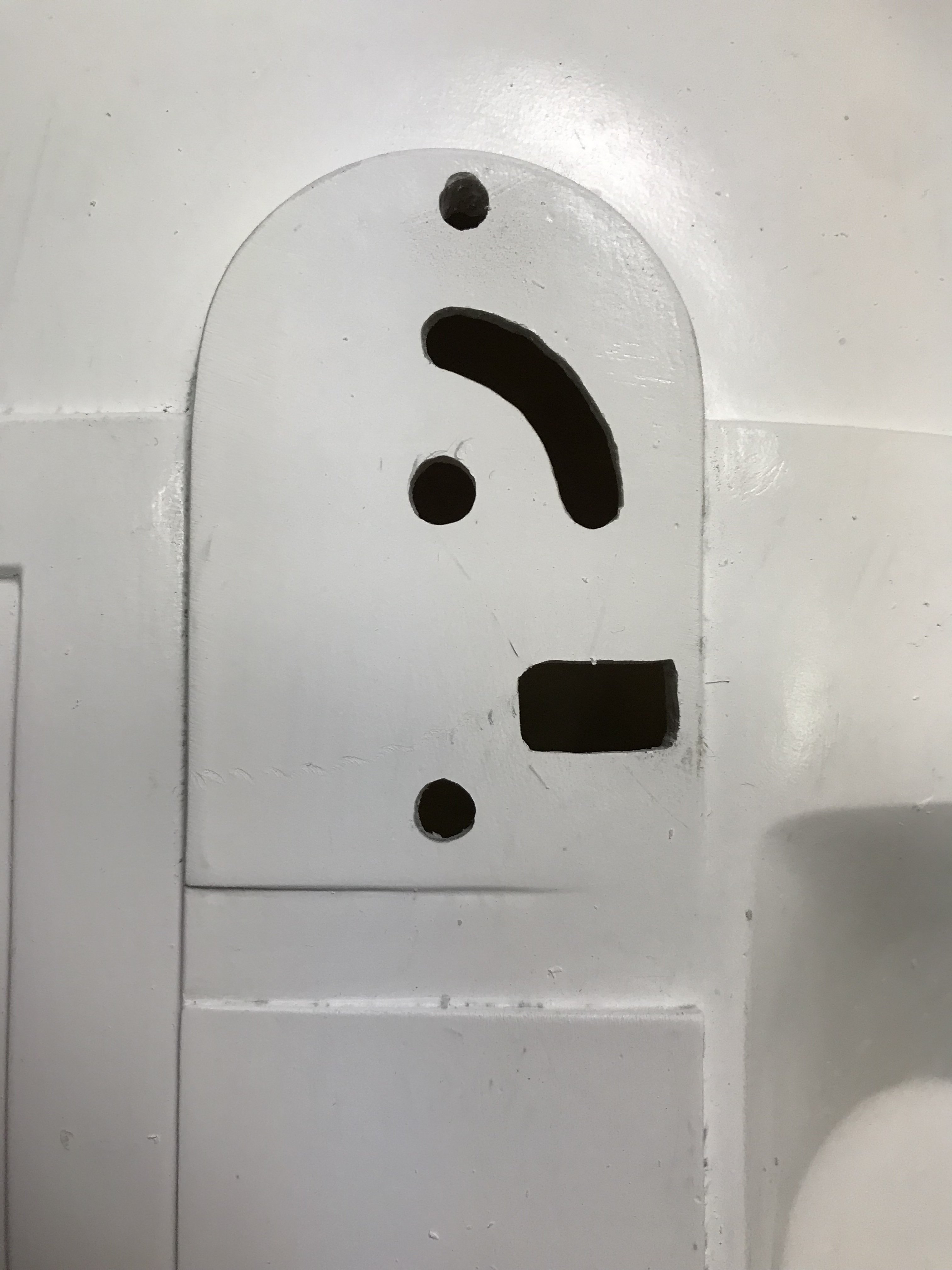

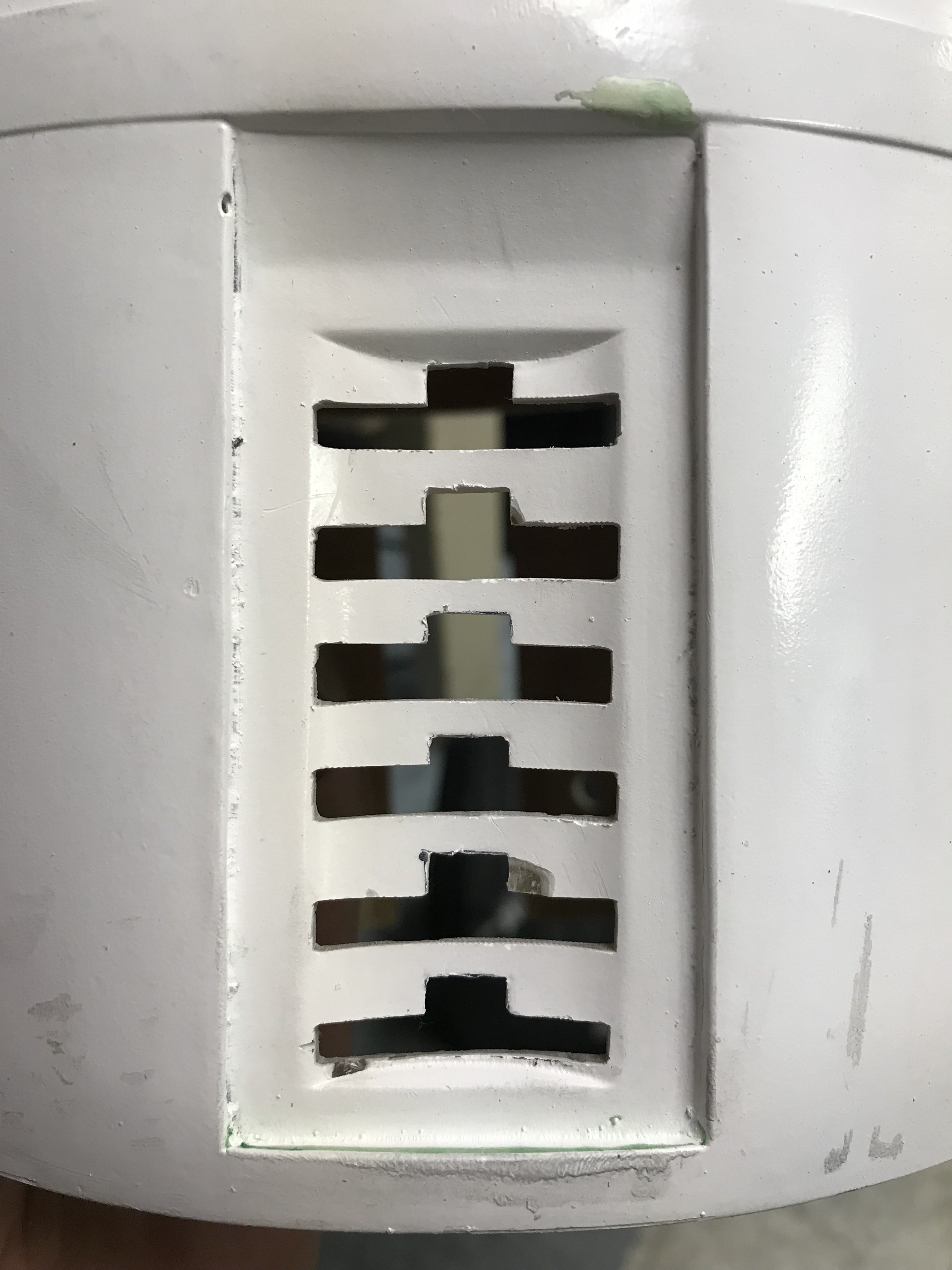

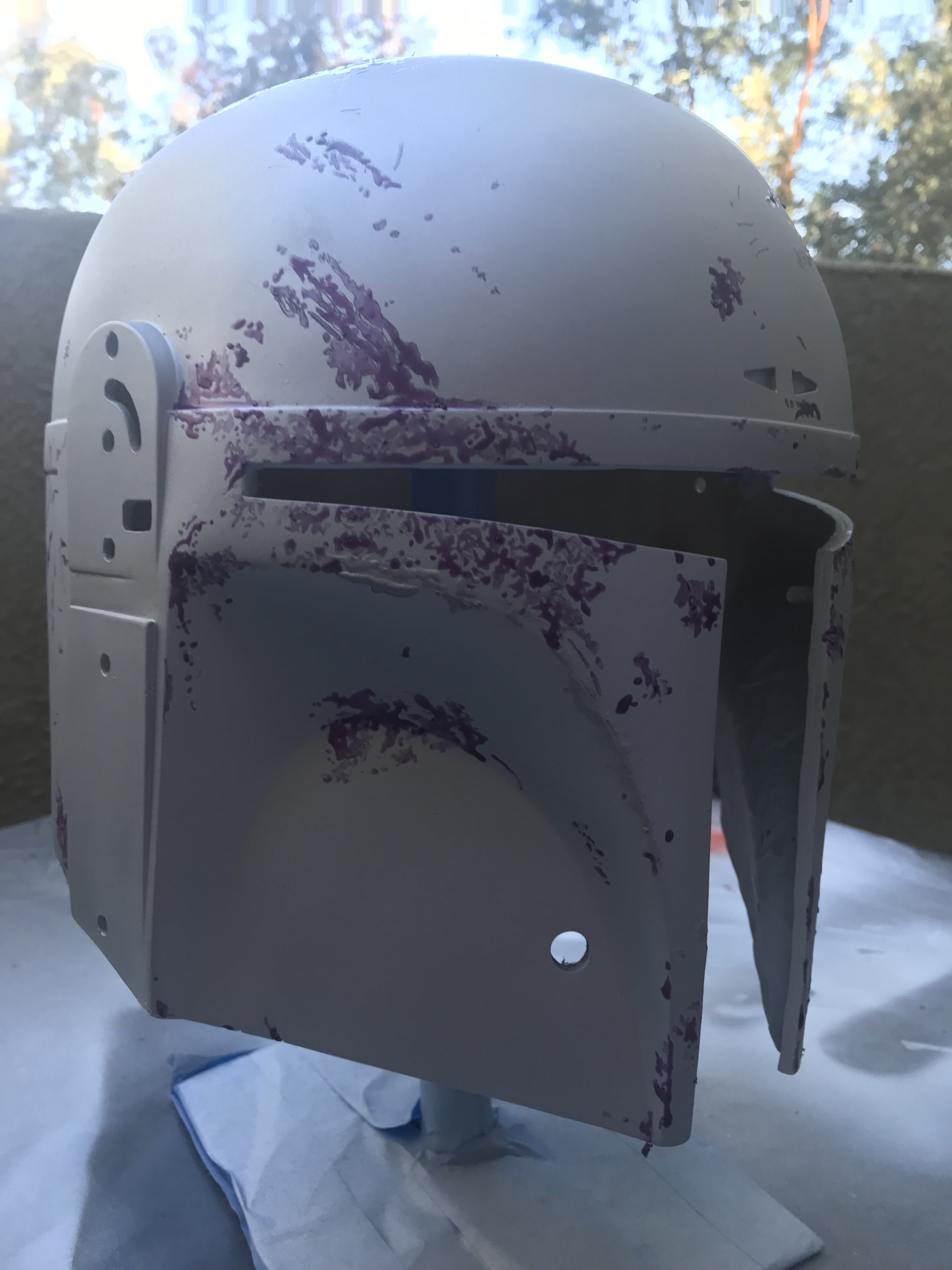

37751D8B-8CE7-4A62-8AF2-C222503C9A77.jpeg 9BC76521-7800-4440-892A-E15A001F9C8D.jpeg D2F5EE31-15C3-493F-BA0B-5C26F1415BCD.jpeg I had some extra time today before work, so put a little work into the bucket. I started with drilling out the Borden hole. Simple and easy. I have a real Borden to install there but was a little curious about how far it was supposed to stick out? Just looking into the future. Then I moved on the the key holes on the back. After cutting out the first one, had the idea of using a sharpie to color in the key slots to help guide what to cut and keep it clean. Worked great but a few pieces of gel coat popped and I have to repair that tomorrow.

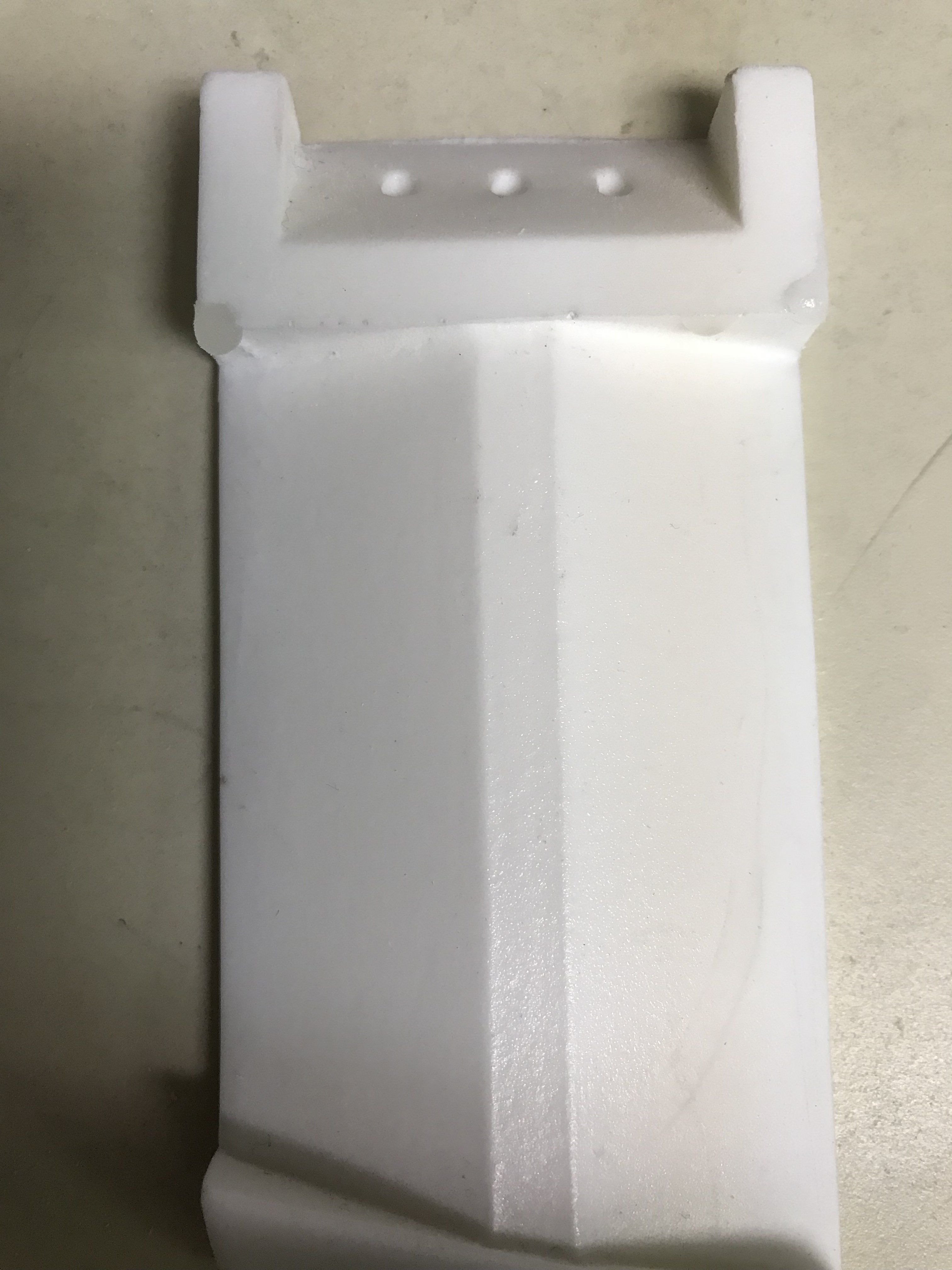

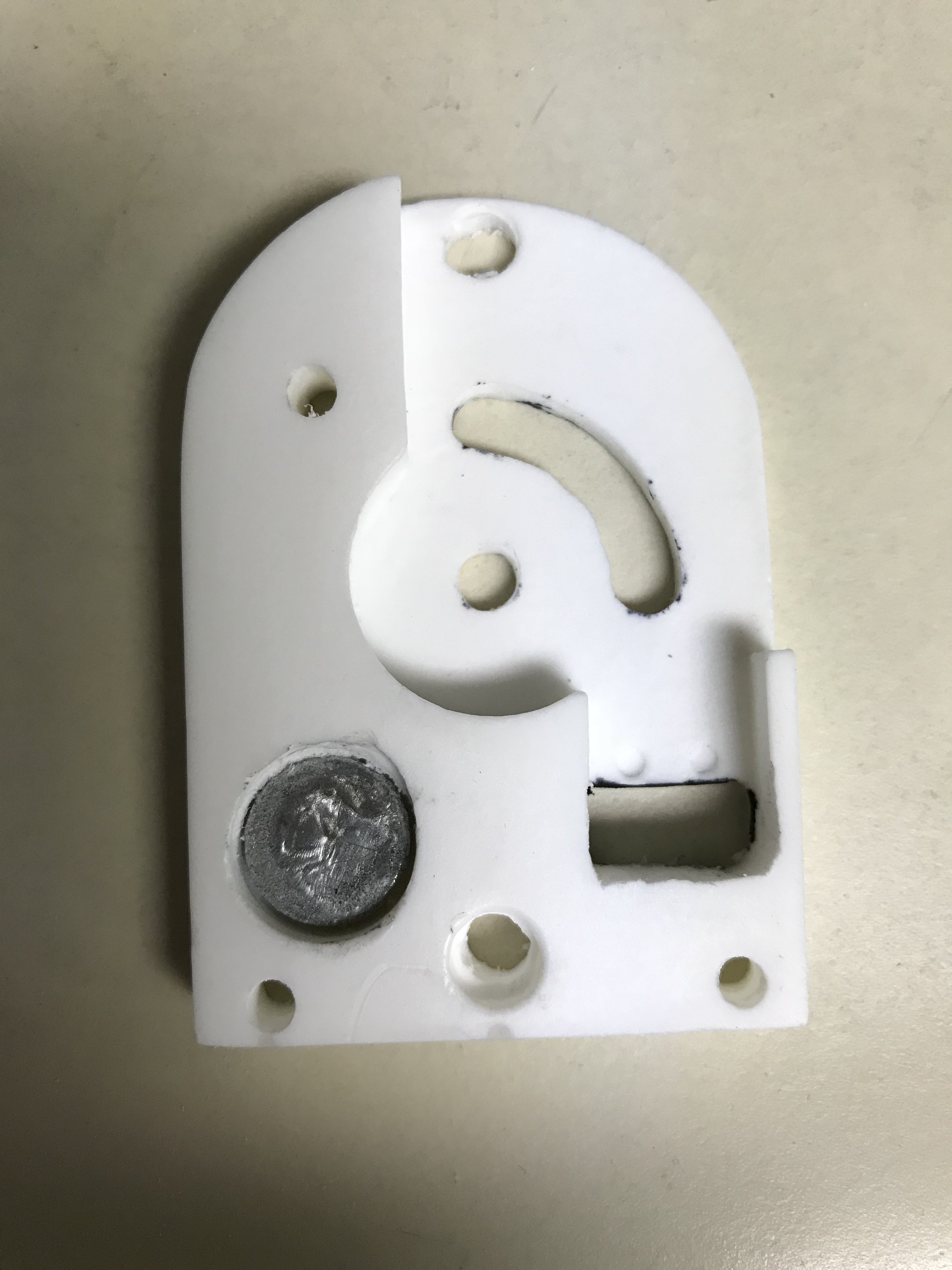

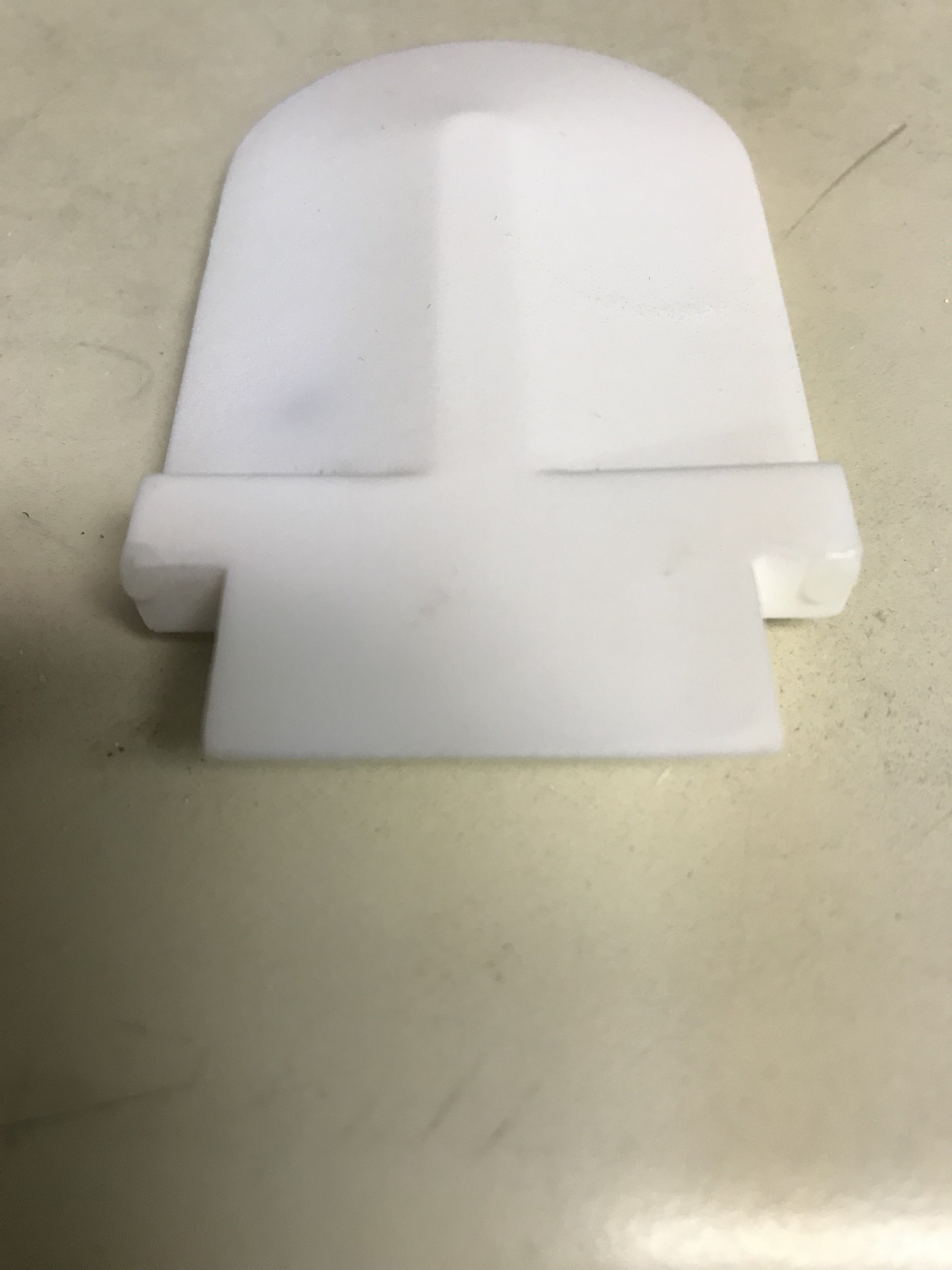

525840C0-FEE2-4BAC-B122-DC8D79ED6FEE.jpeg 5F073CA7-C5DC-4FD7-997F-1C9BEBDEB8DE.jpeg 9ADEF329-09A8-4934-877C-73EE6CD8929A.jpeg A72F7AD2-0641-487D-87AA-E2CB579A61DD.jpeg 47986D16-D1E1-4669-9C26-E4E692DA50C5.jpeg The thing about working in the film industry is your days can start at 7am on Monday and by Friday start at noon. Mix that with insomnia and you get some time to work on your passion! So went in early and opened up some of the holes in the bucket for the range finder ear piece. Cleaned up the edges for the cast ears pieces and started filling in some holes and chips in the ears and key holes on the back of the helmet. Waiting for those parts to dry and then resend to complete the clean up. Still have to figure out how I wan to attach the ears on before priming. Looking at trying a new method for that part then the normal bolt through.
EAF50F4E-583A-4D2B-B87A-6933C4076357.jpeg 8589A270-A19D-4D62-BED8-BFB10D941E29.jpeg DB55620E-5645-4D9A-91EE-B143C6CC9D9C.jpeg A200D478-8C68-4338-A696-2EE1C8FF4542.jpeg FA3D52D8-6A9A-455D-890B-674FB00E881F.jpeg 911153F9-922C-4DB4-B123-3B8A3215CCC9.jpeg 5A269F00-51D4-4568-99A7-A9E54057FACC.jpeg C6A5ADCE-0B70-4B02-A267-761A0C2FA33F.jpeg CB9CC69D-7C5D-4C30-8DBC-68000BFC6A53.jpeg 9F69CED3-72B5-4985-97C1-812A288C77A8.jpeg A44A6688-586F-4D41-B2BC-017BFD8A1ABC.jpeg 2BA4030E-A84C-4B3D-A112-882631C2CE76.jpeg 8B8491E3-9986-43D2-8508-1A48470B5D03.jpeg AC89DD84-3F34-4947-B655-E323034B4DD9.jpeg 7076EB1B-61EF-473E-A376-C3DB22E35CE4.jpeg 53E2F8EC-5773-4472-AAAC-E9385206D5CA.jpeg 07B3ADF8-5A8D-494E-9A0A-AA6901094A8C.jpeg 74D2E881-C807-4474-BDF4-6B55AA4E89E6.jpeg A95122C4-466E-4D1C-90D2-34F96C17318E.jpeg 7915612D-3469-443F-9FD4-F8D9F4C99ECB.jpeg 650274BB-9261-4923-B768-A57975B16ABE.jpeg It’s been a while since my last post. I’ve had trouble finding the time to work consistently on this with my jobs hours and family. I’ve done some work on it this over the last few months so now I hope to catch everything up. I started to paint my helmet with an older style paint up then decided to start over and follow Terminal Fettlers paint up. I did a reprime in white instead of grey and and then did a off white coat. Added silver and grey then masked off dome cheats and rear panels to add another grey coat followed by purple. I’m hoping to lay down the red for the visor, mandibles and trim areas tomorrow.

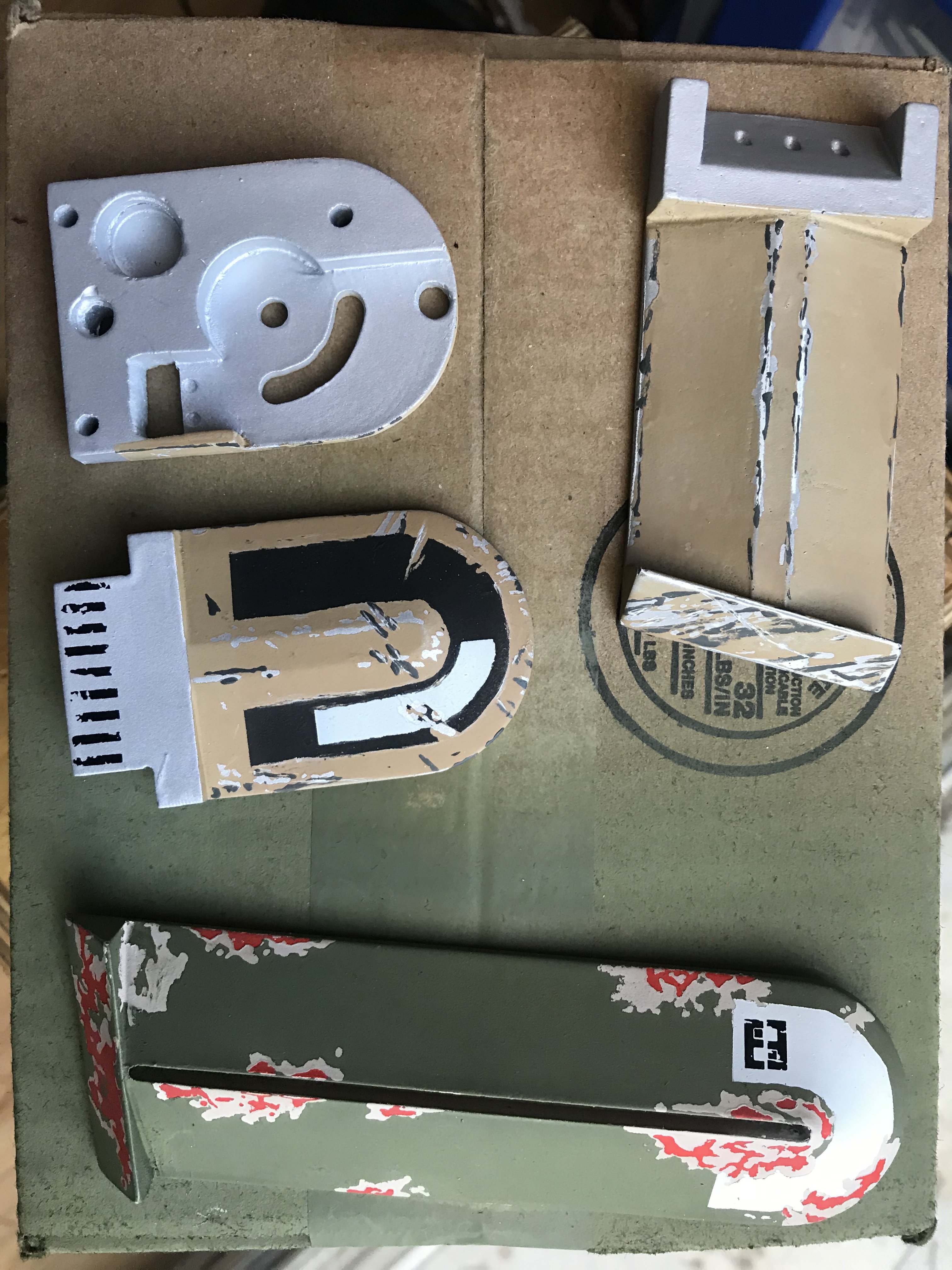

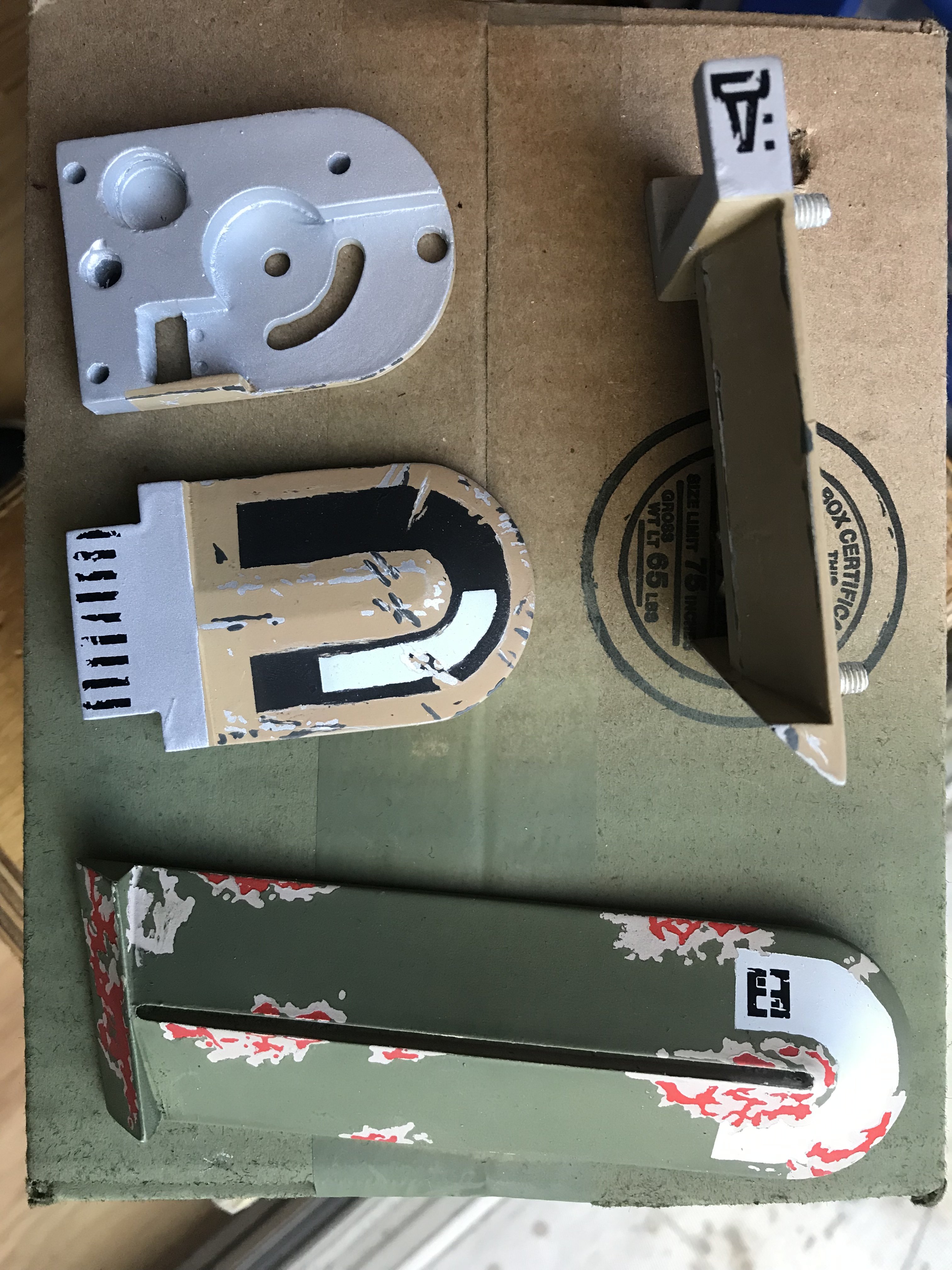

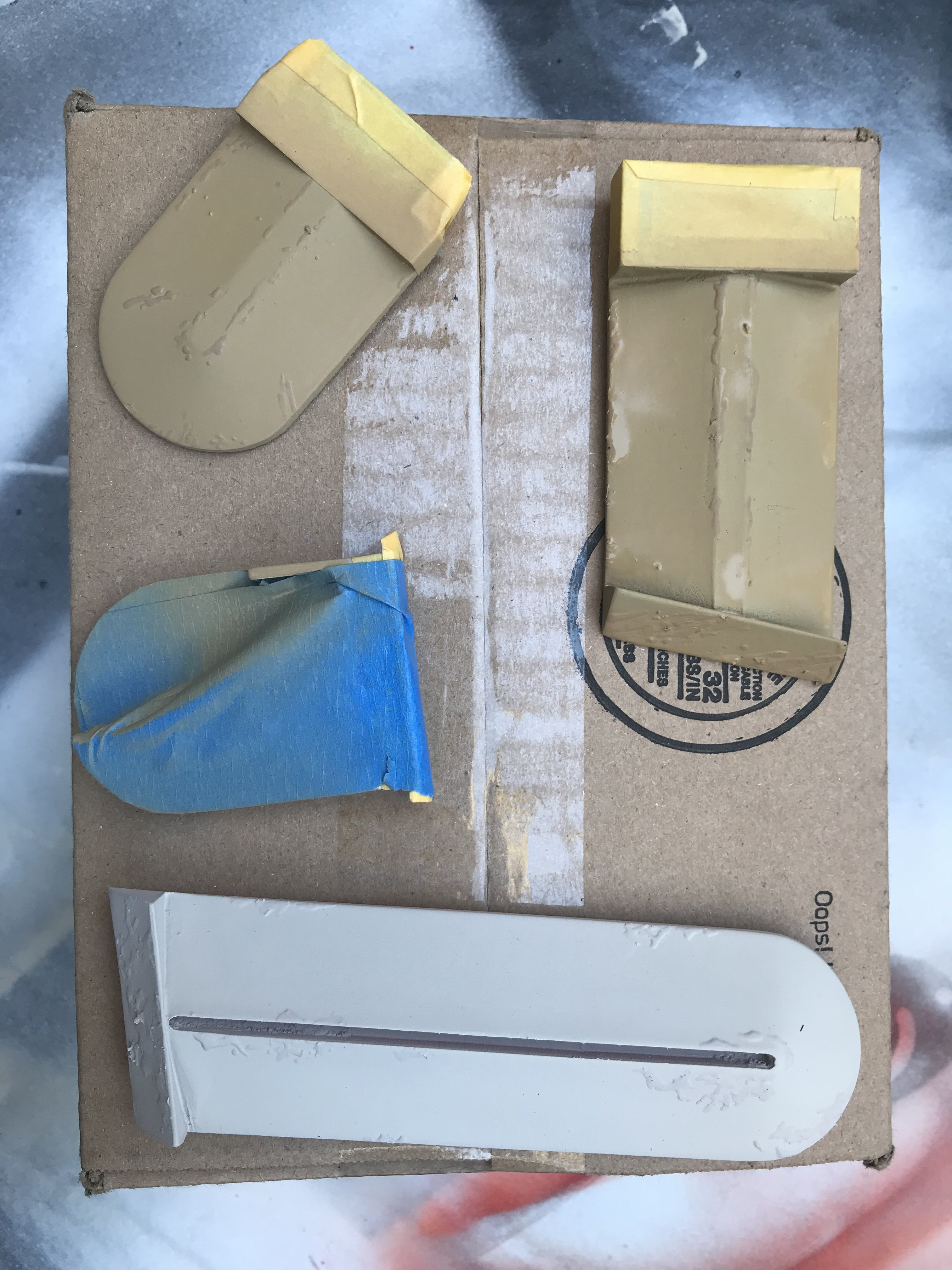

I’ve kept the ears separate and did both sides paint ups. They are now complete except one detail on the right upper ear which is the ‘dot and t’ mark as well as weathering which I will do at the end to the whole helmet. I’ll include pictures to show what I have done for the process and it’s current state.

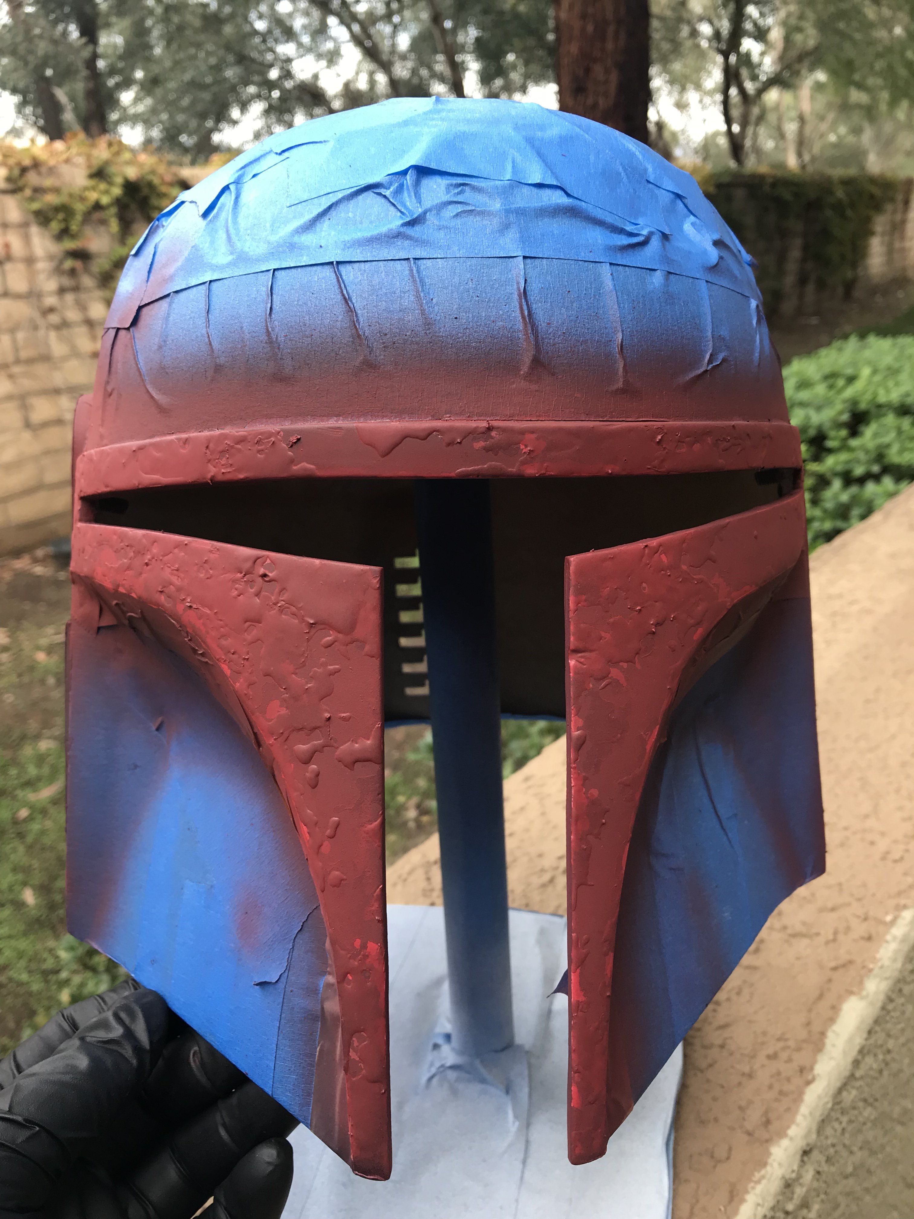

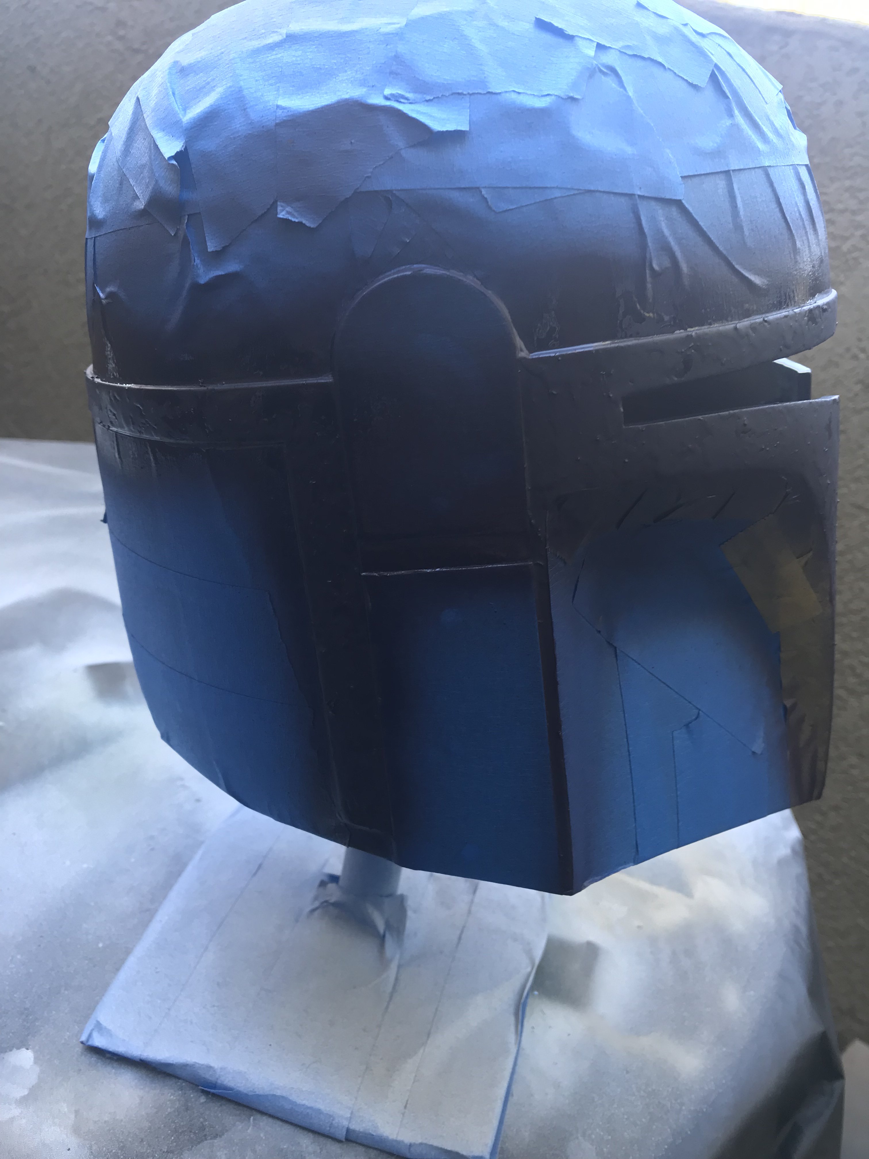

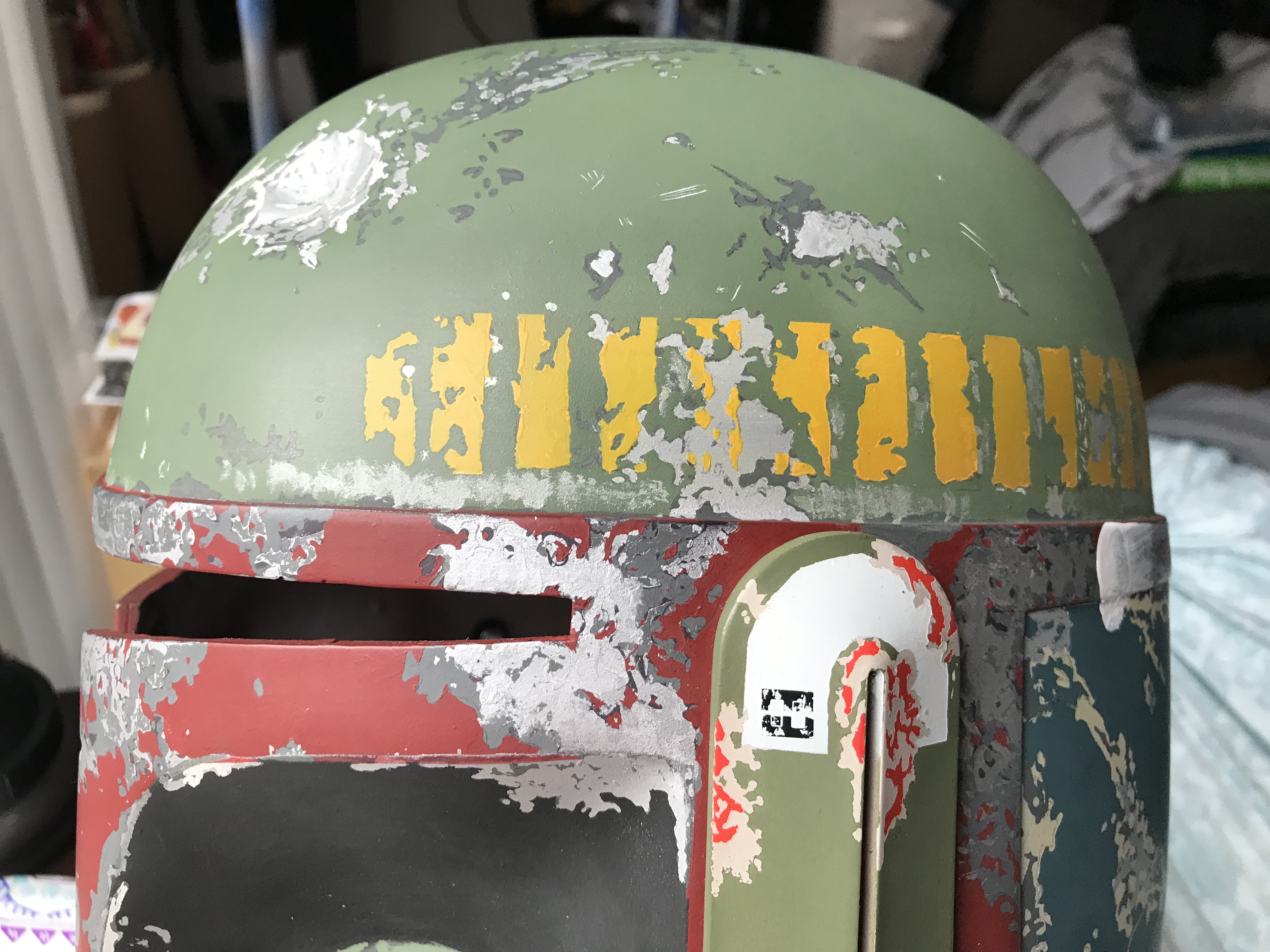

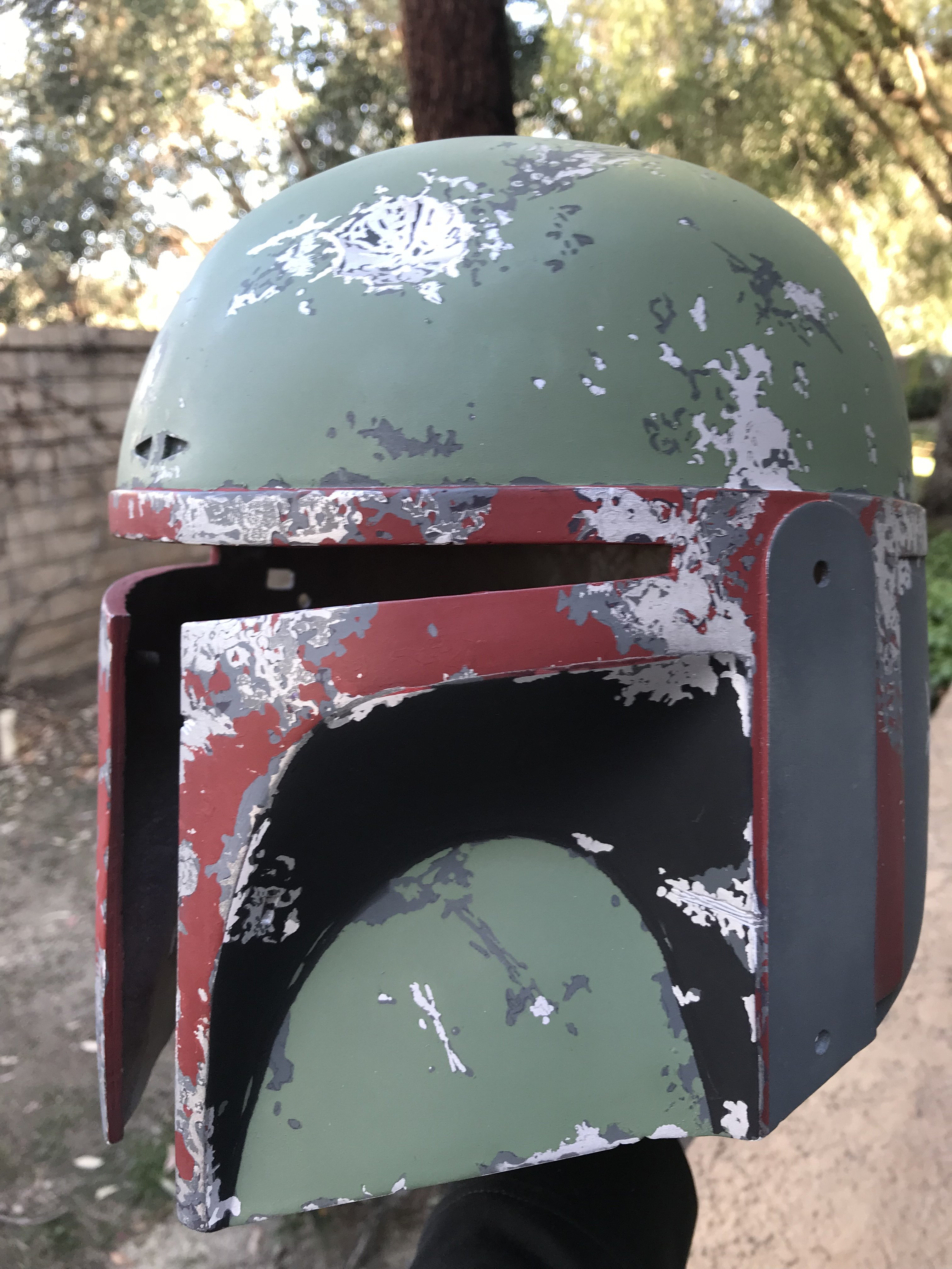

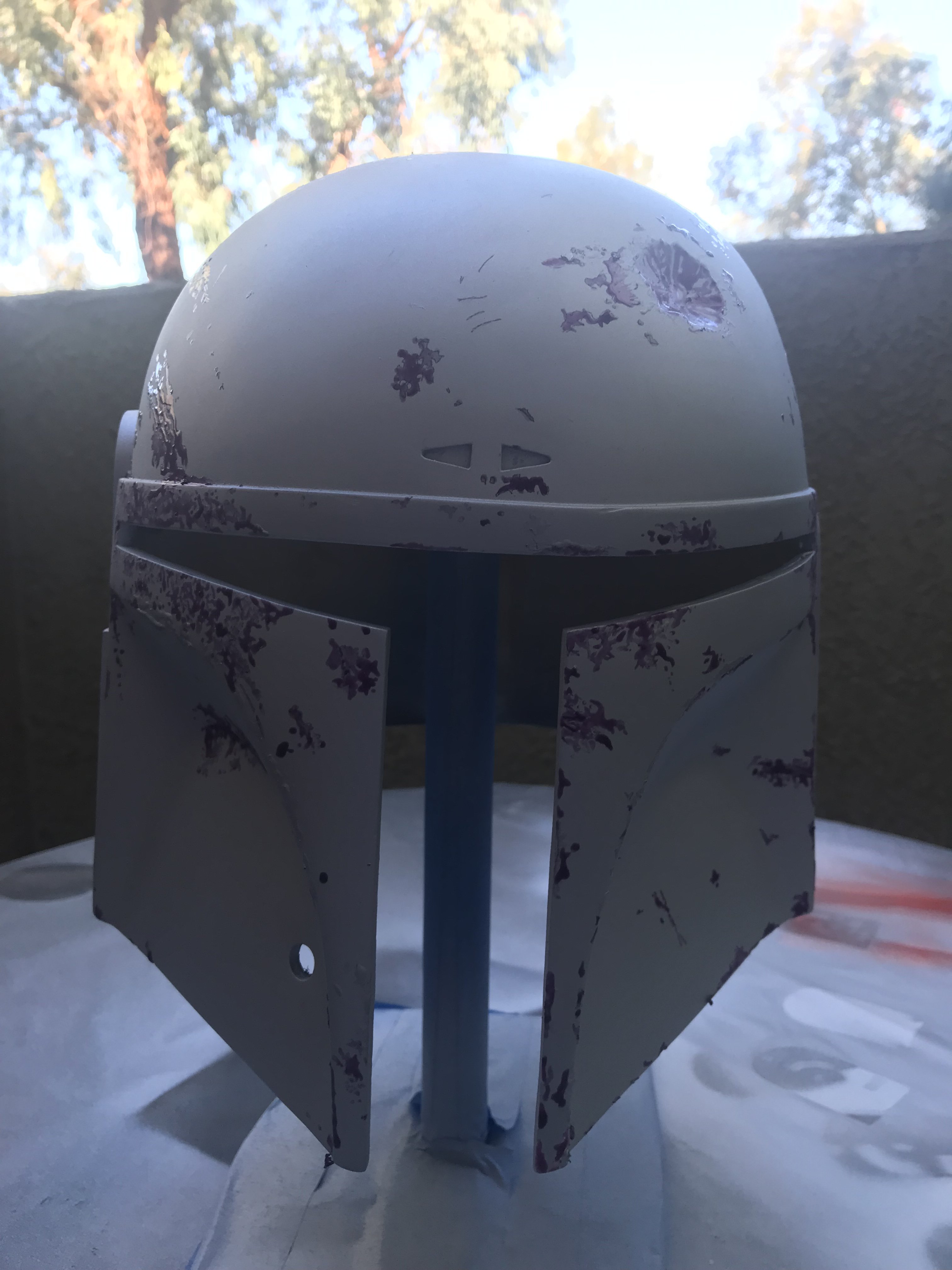

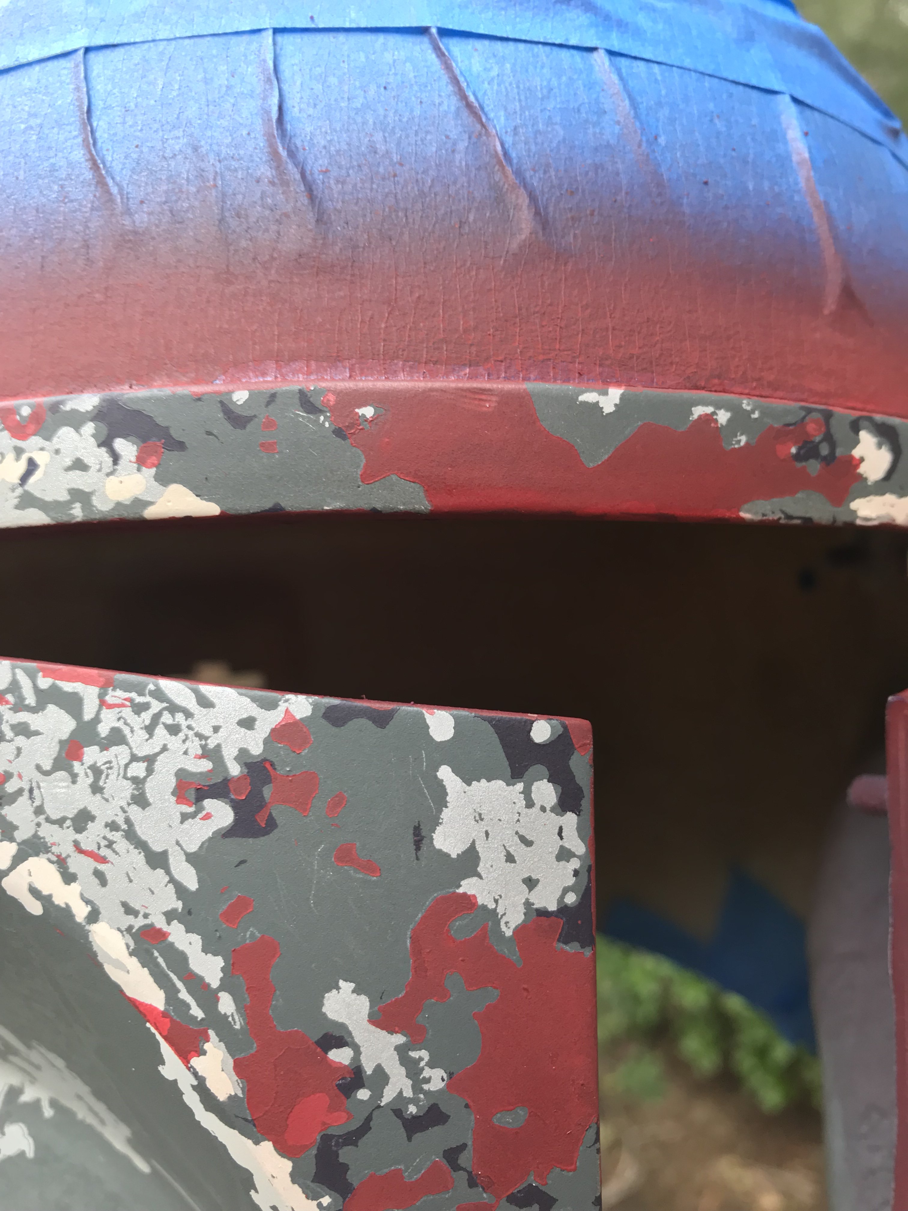

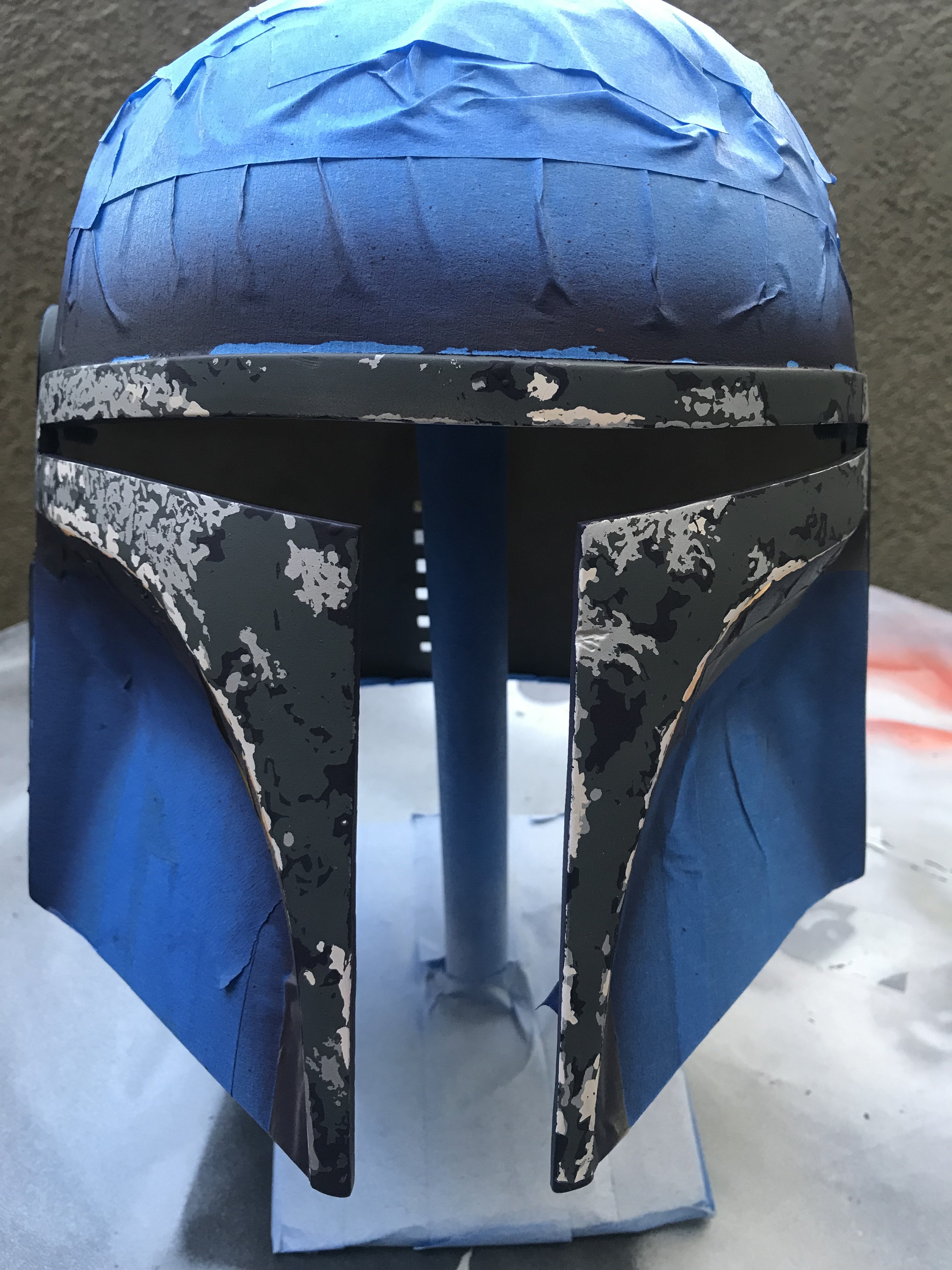

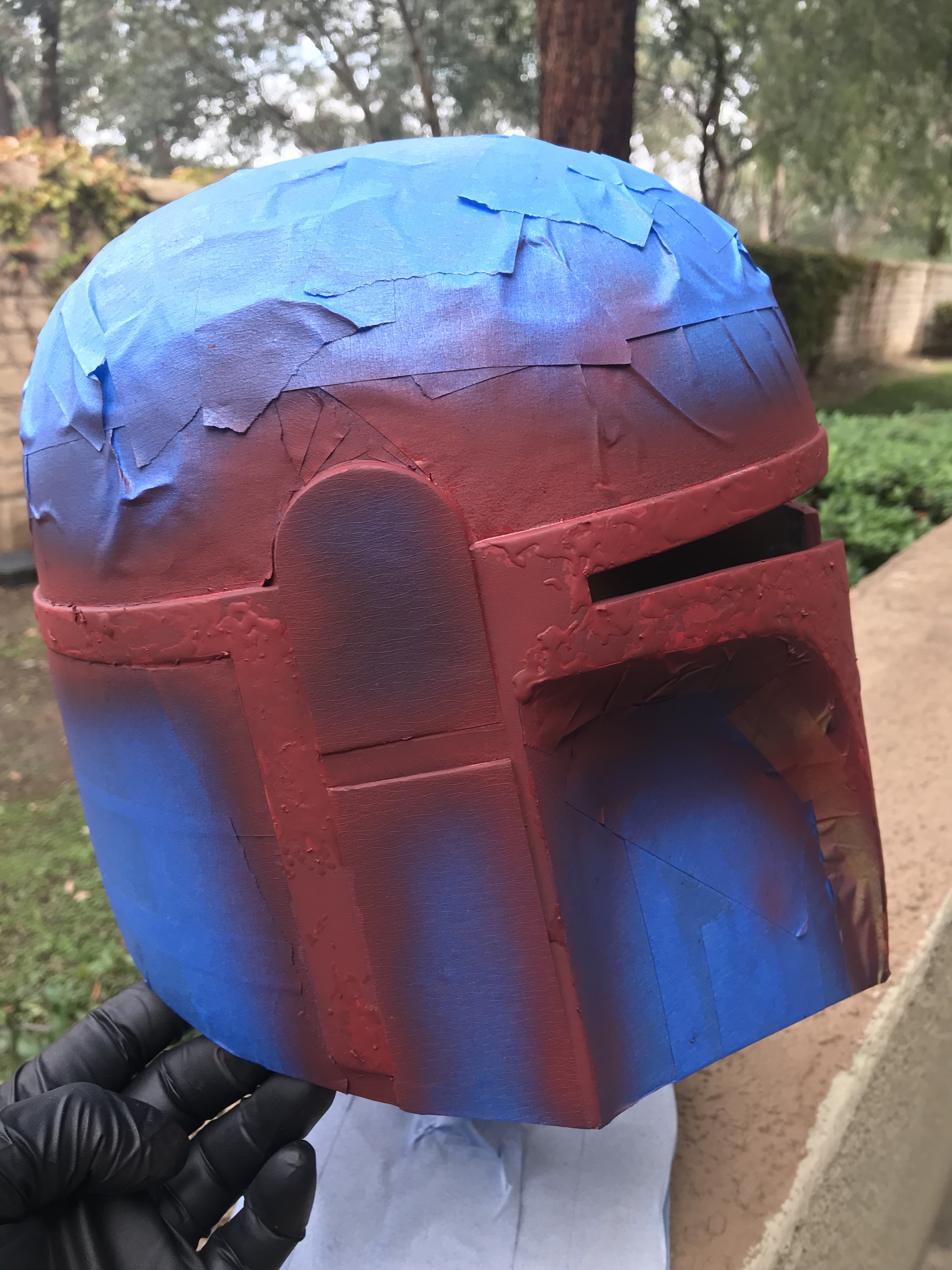

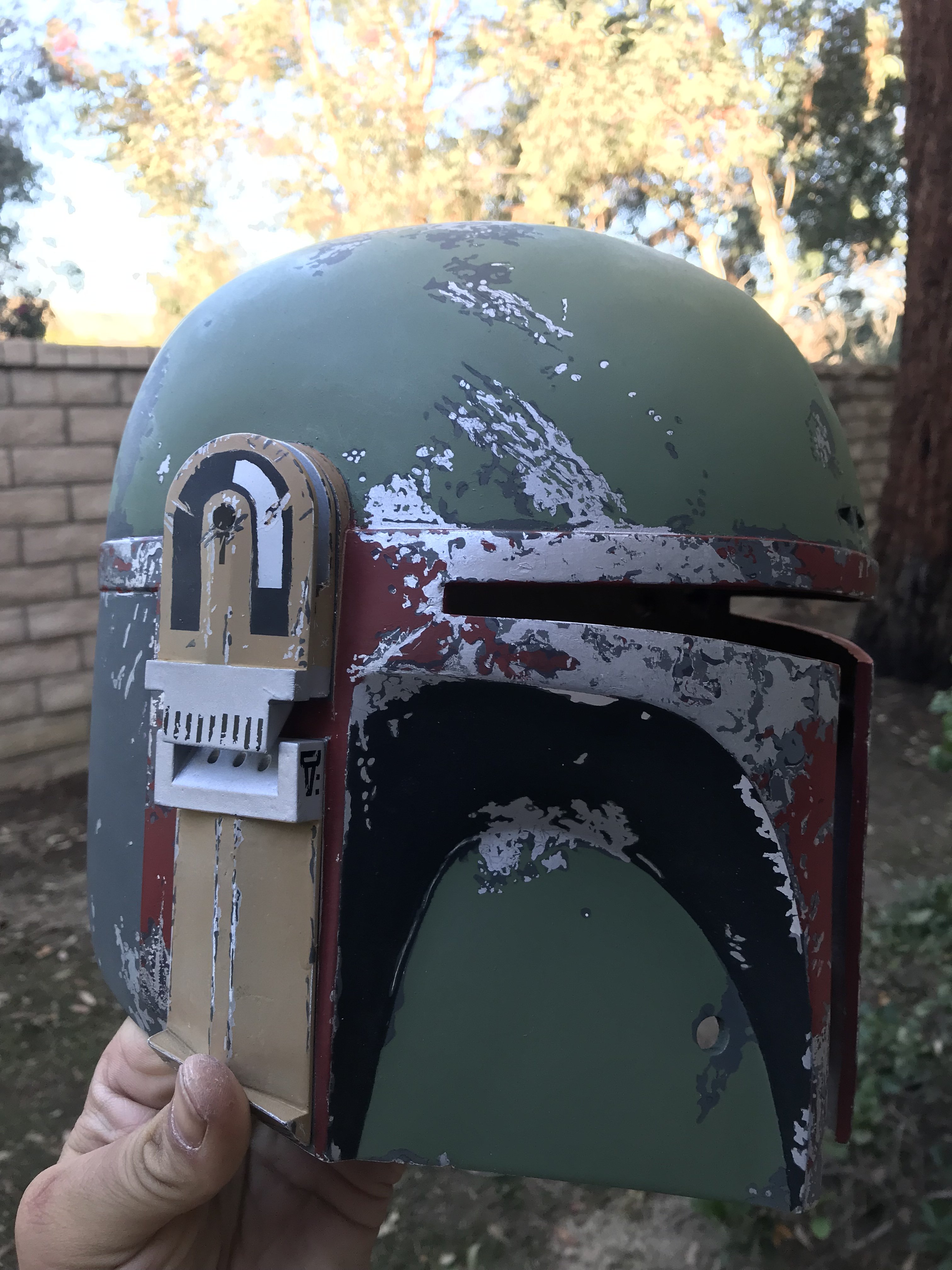

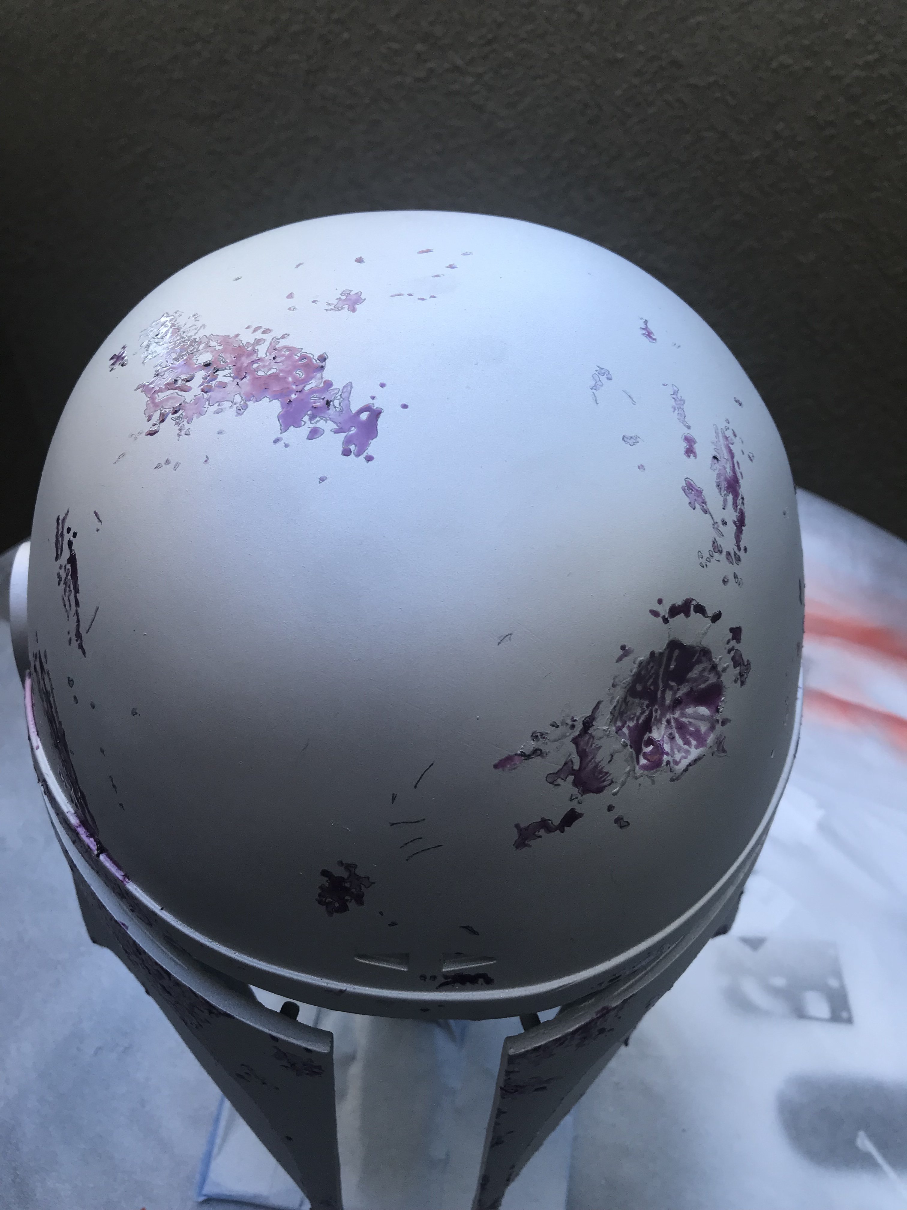

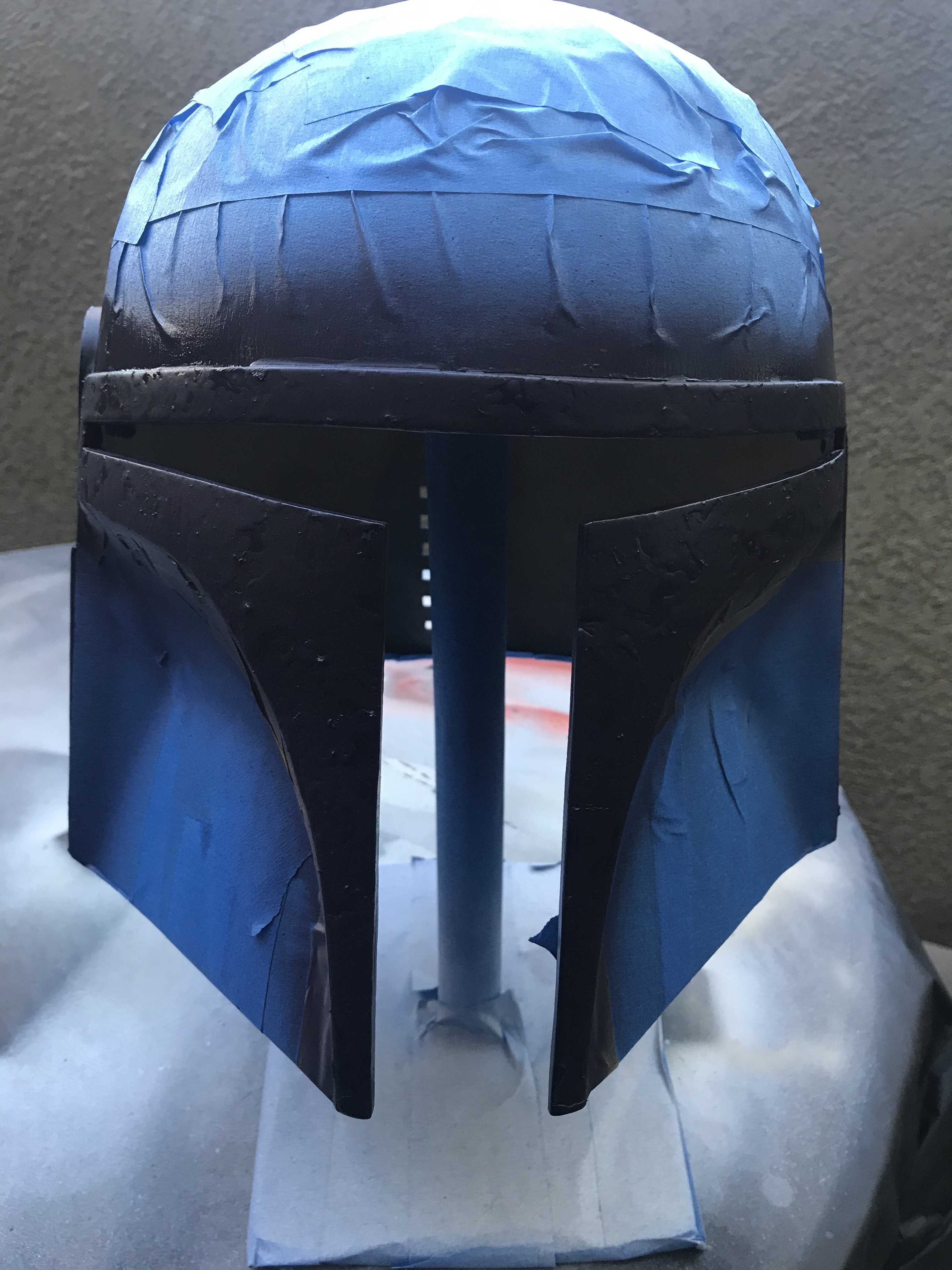

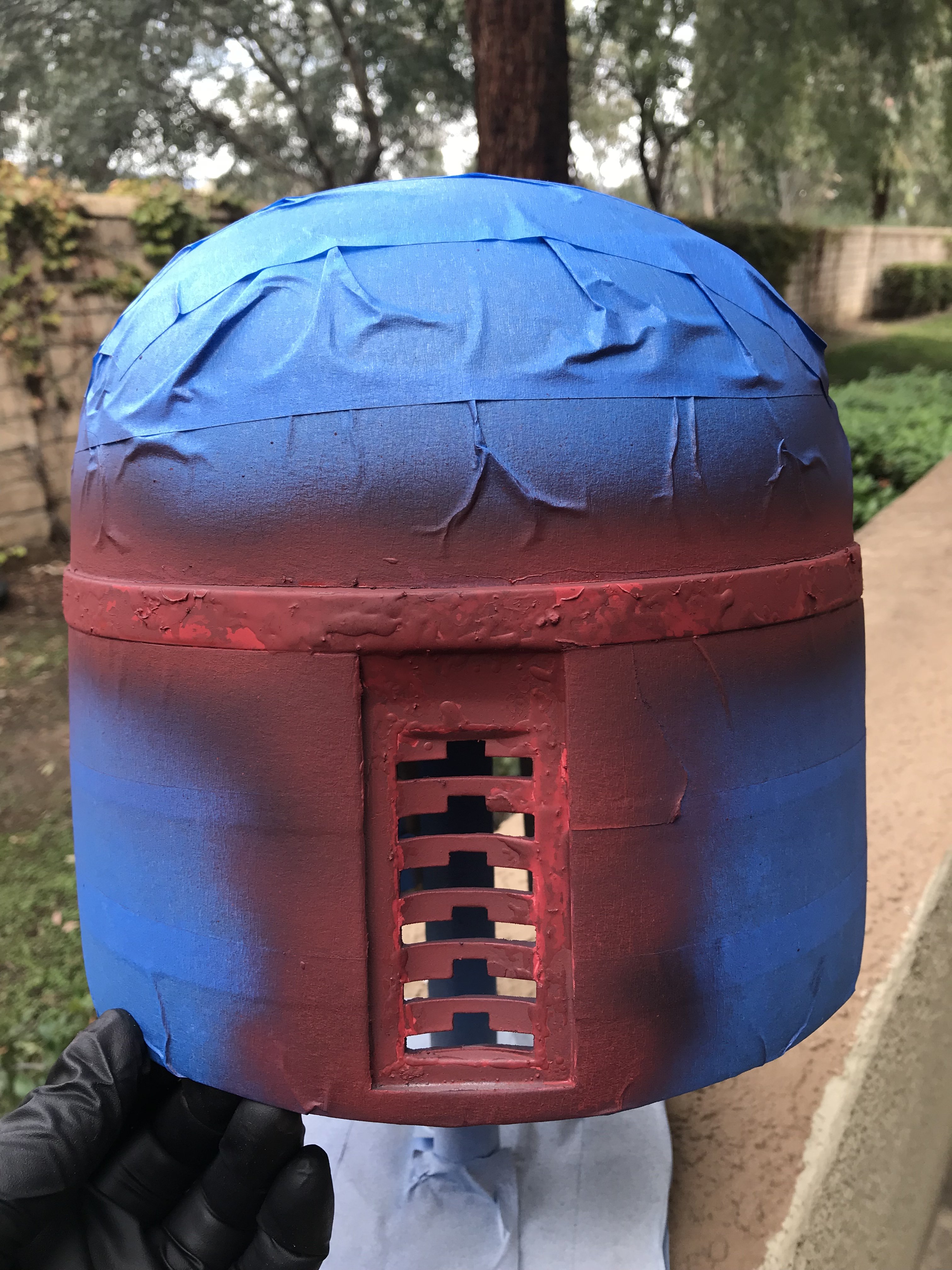

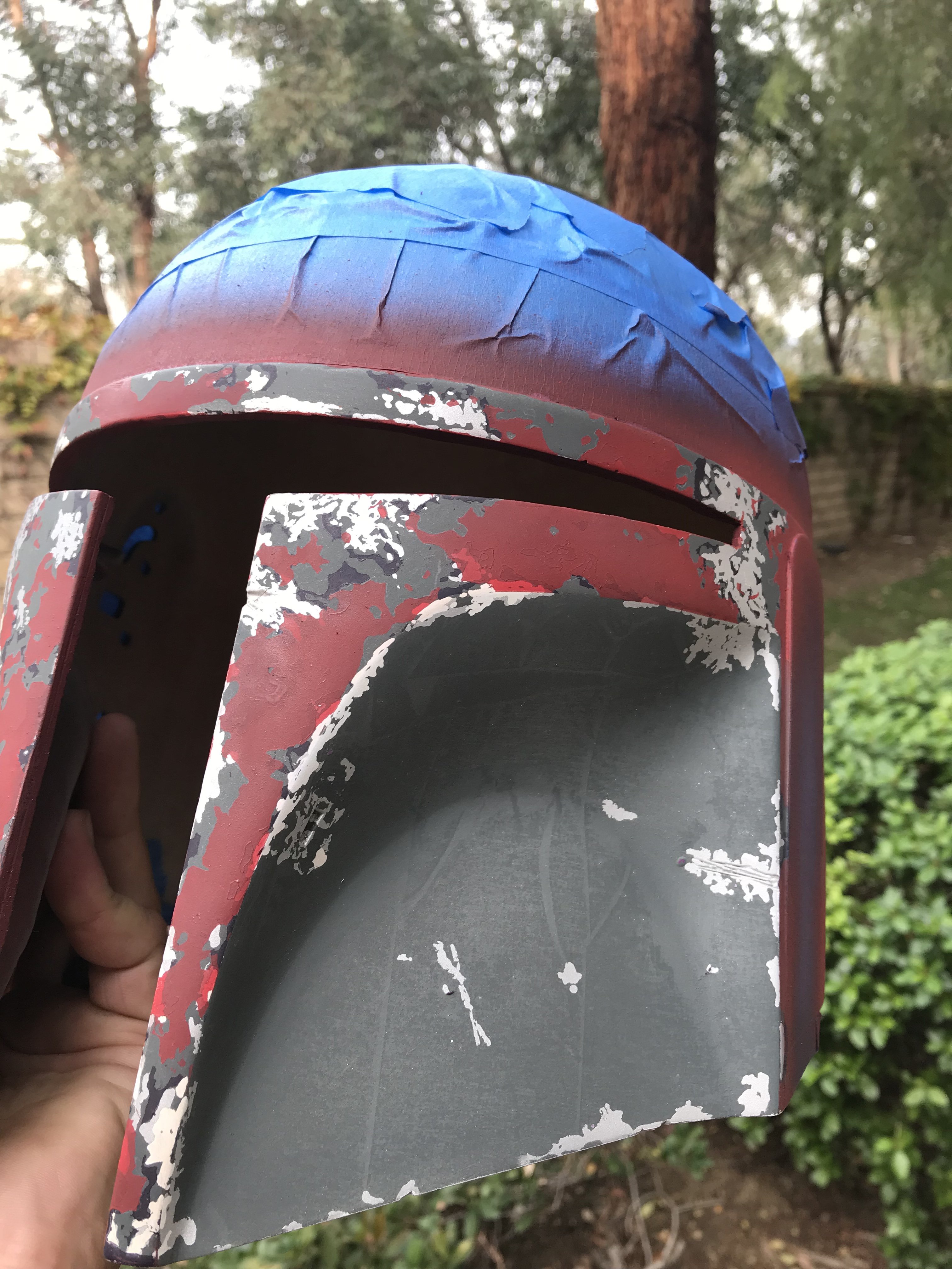

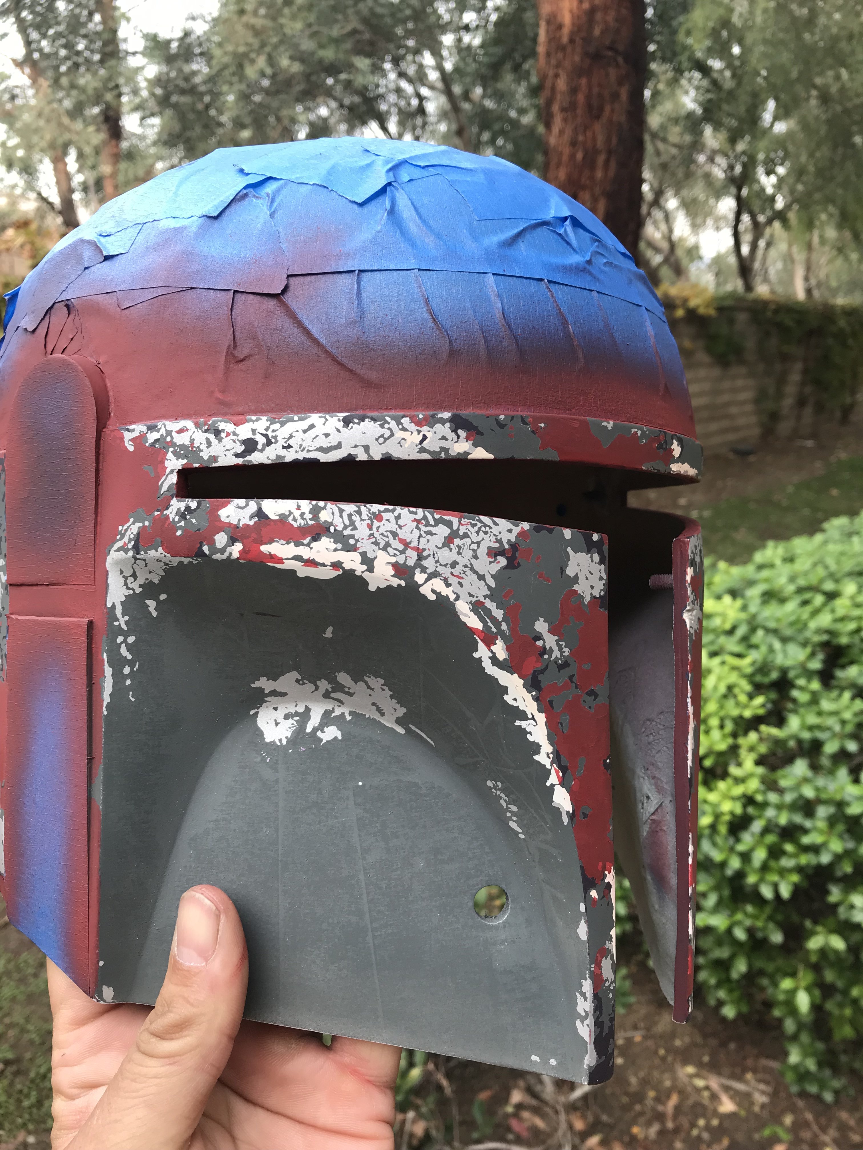

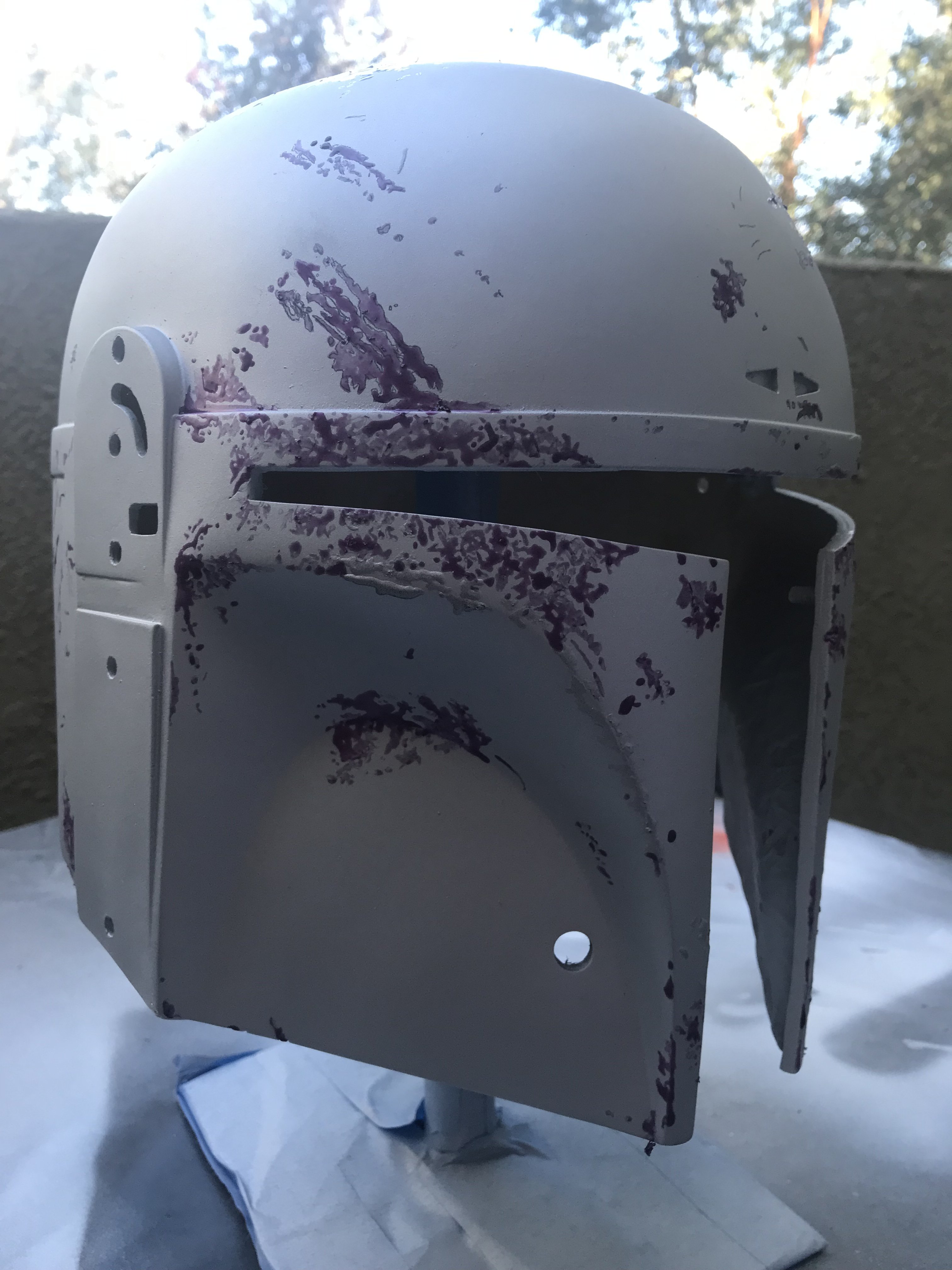

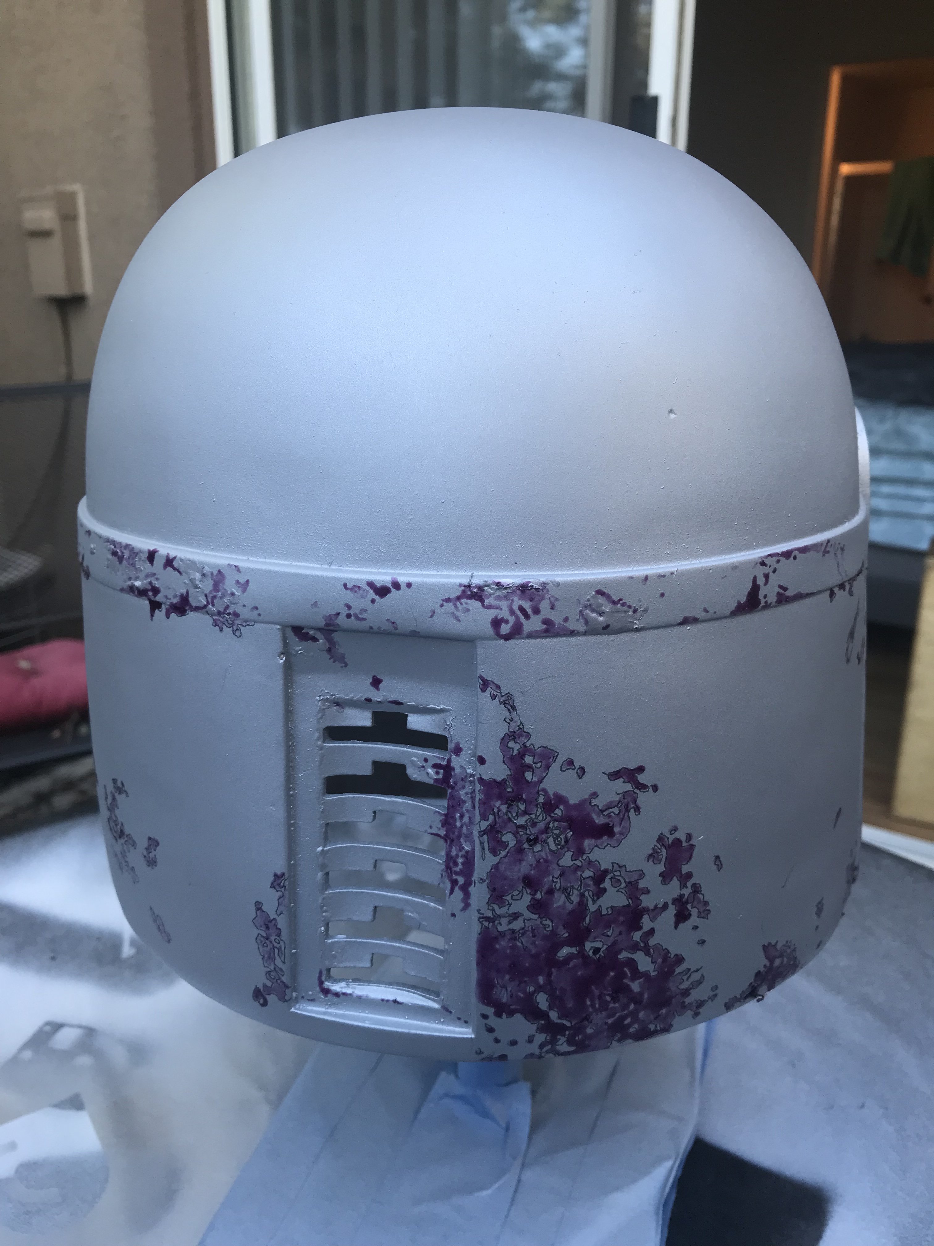

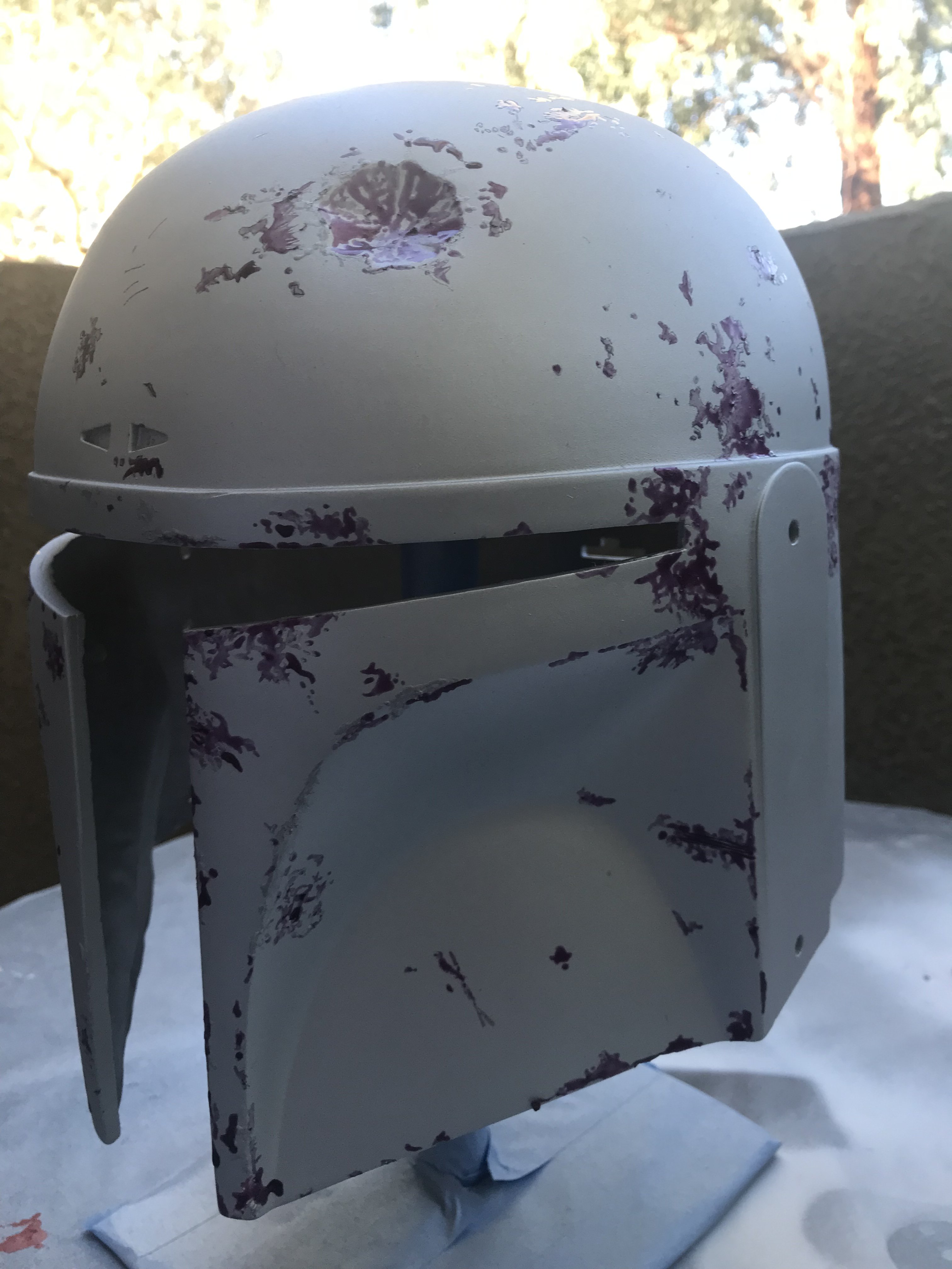

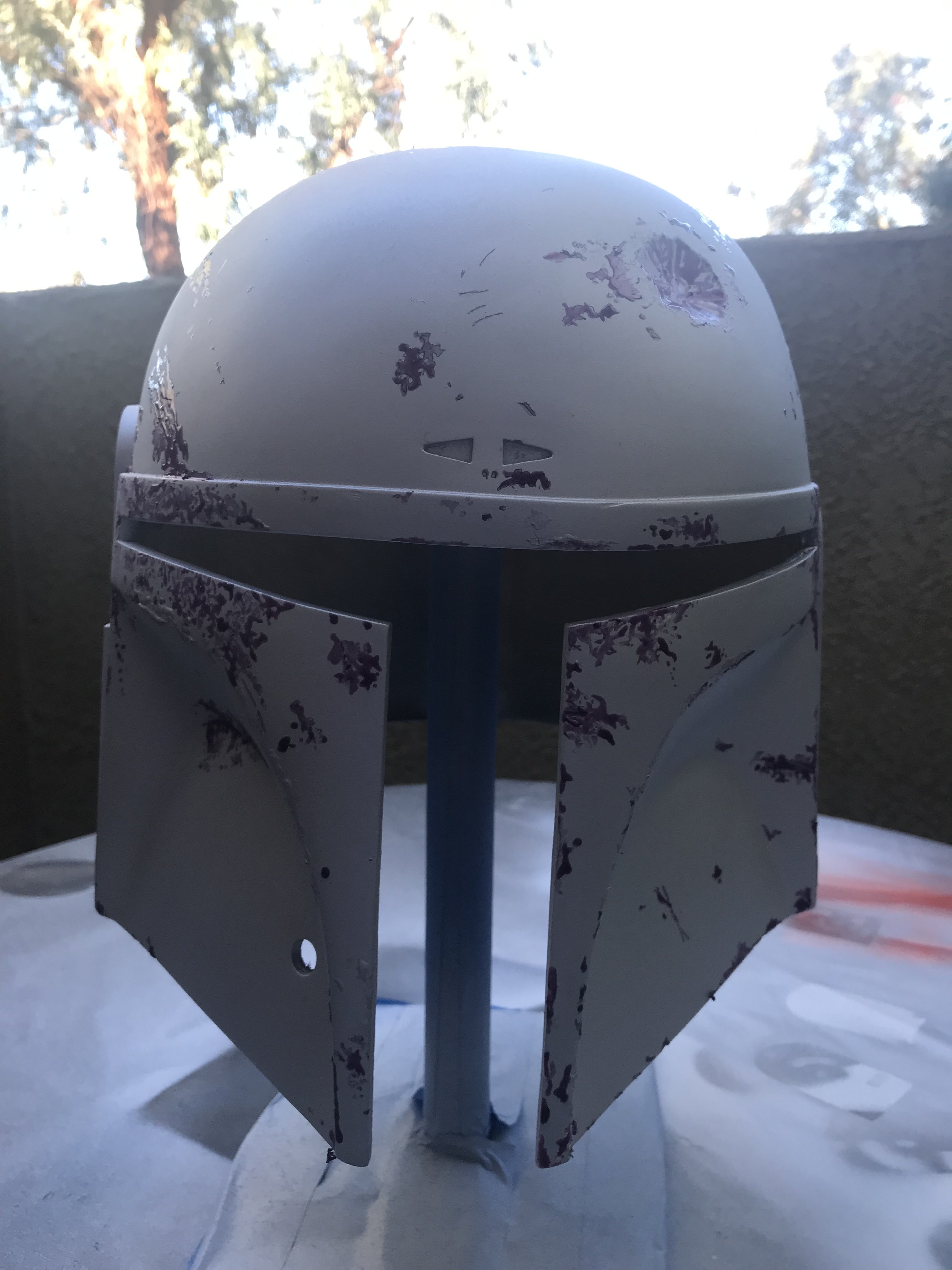

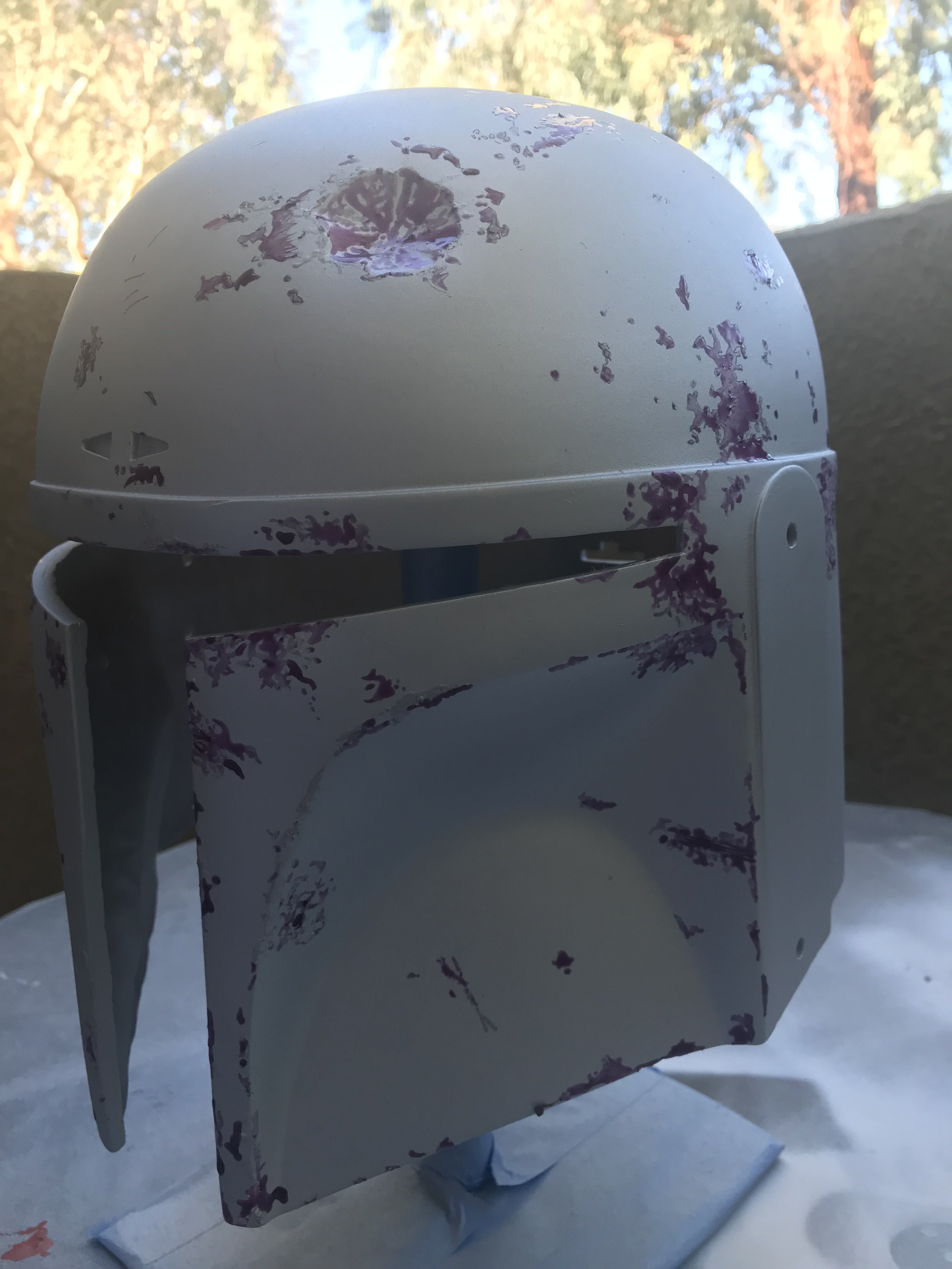

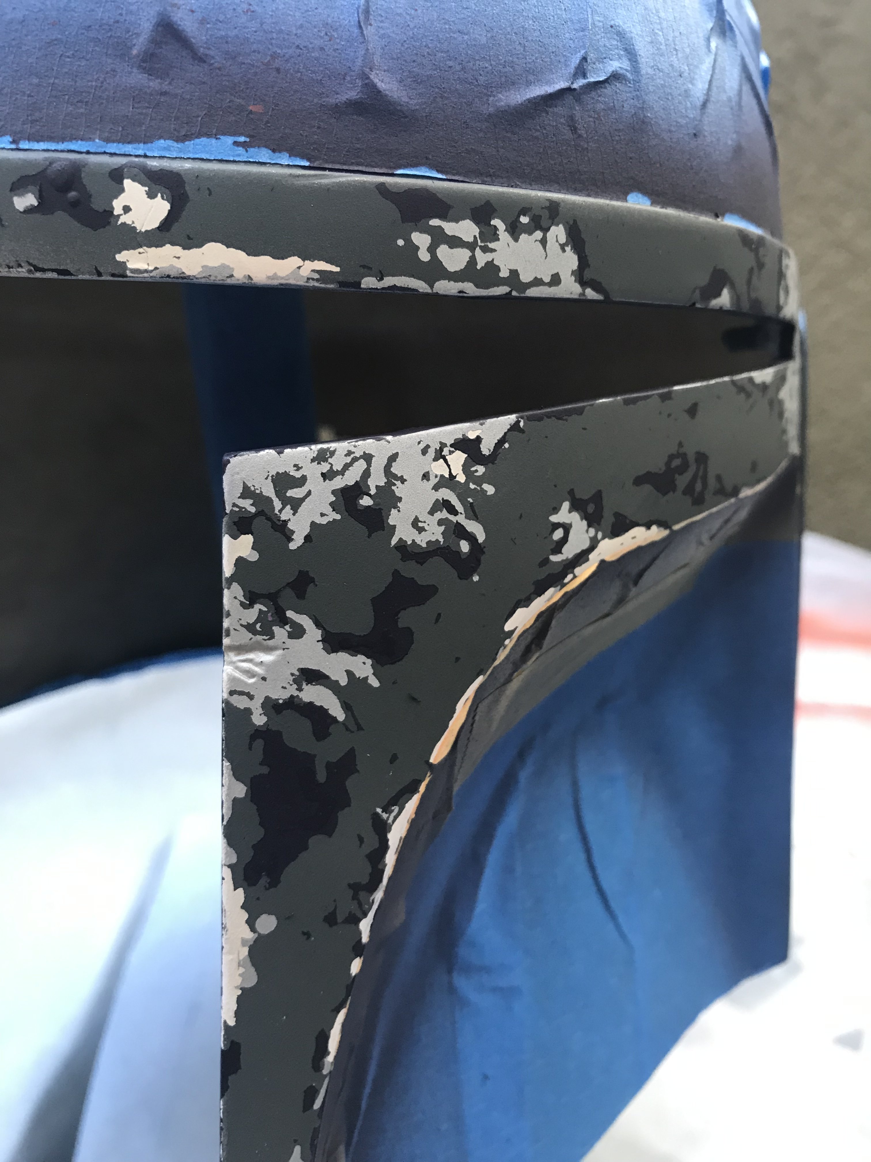

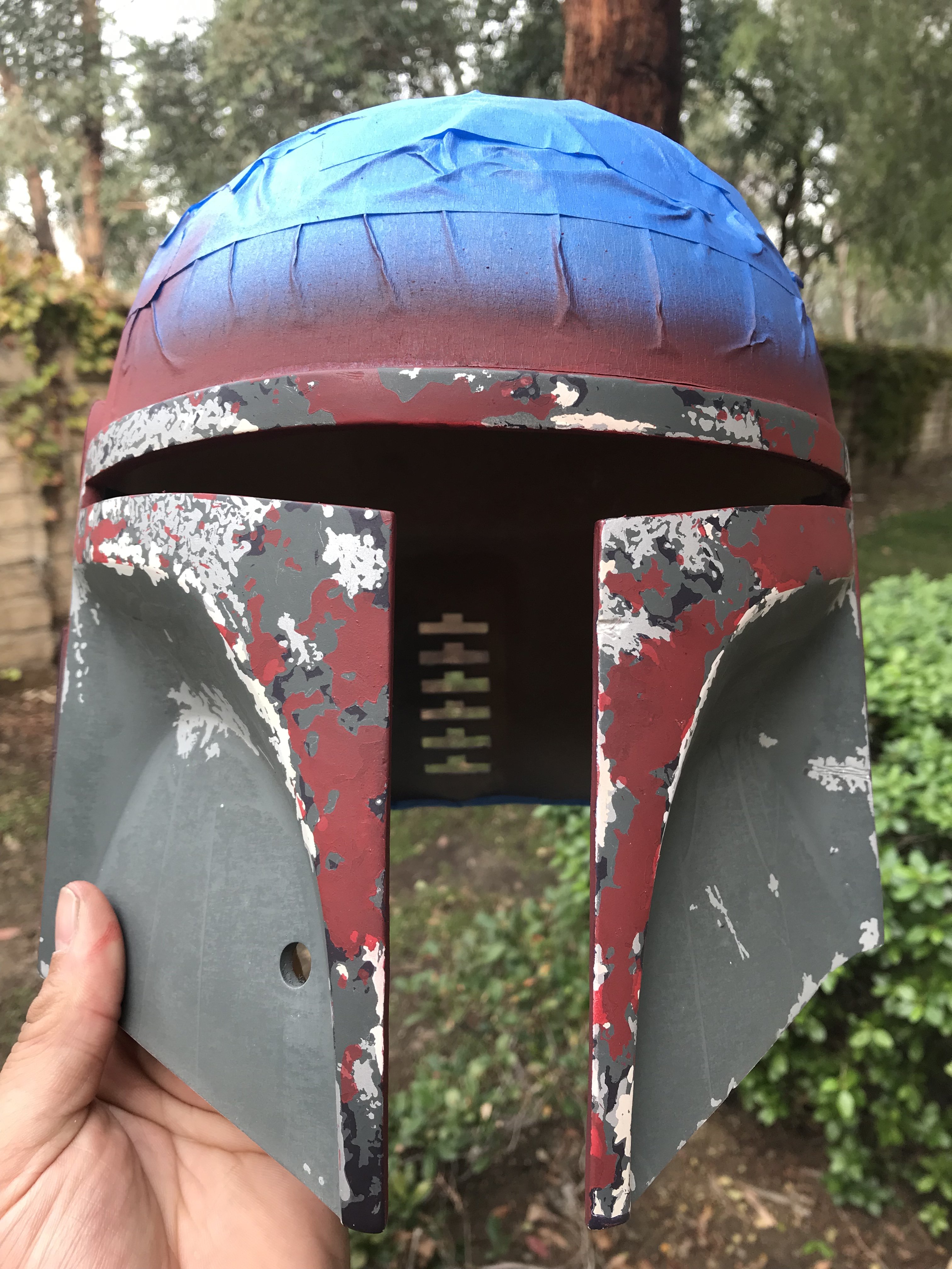

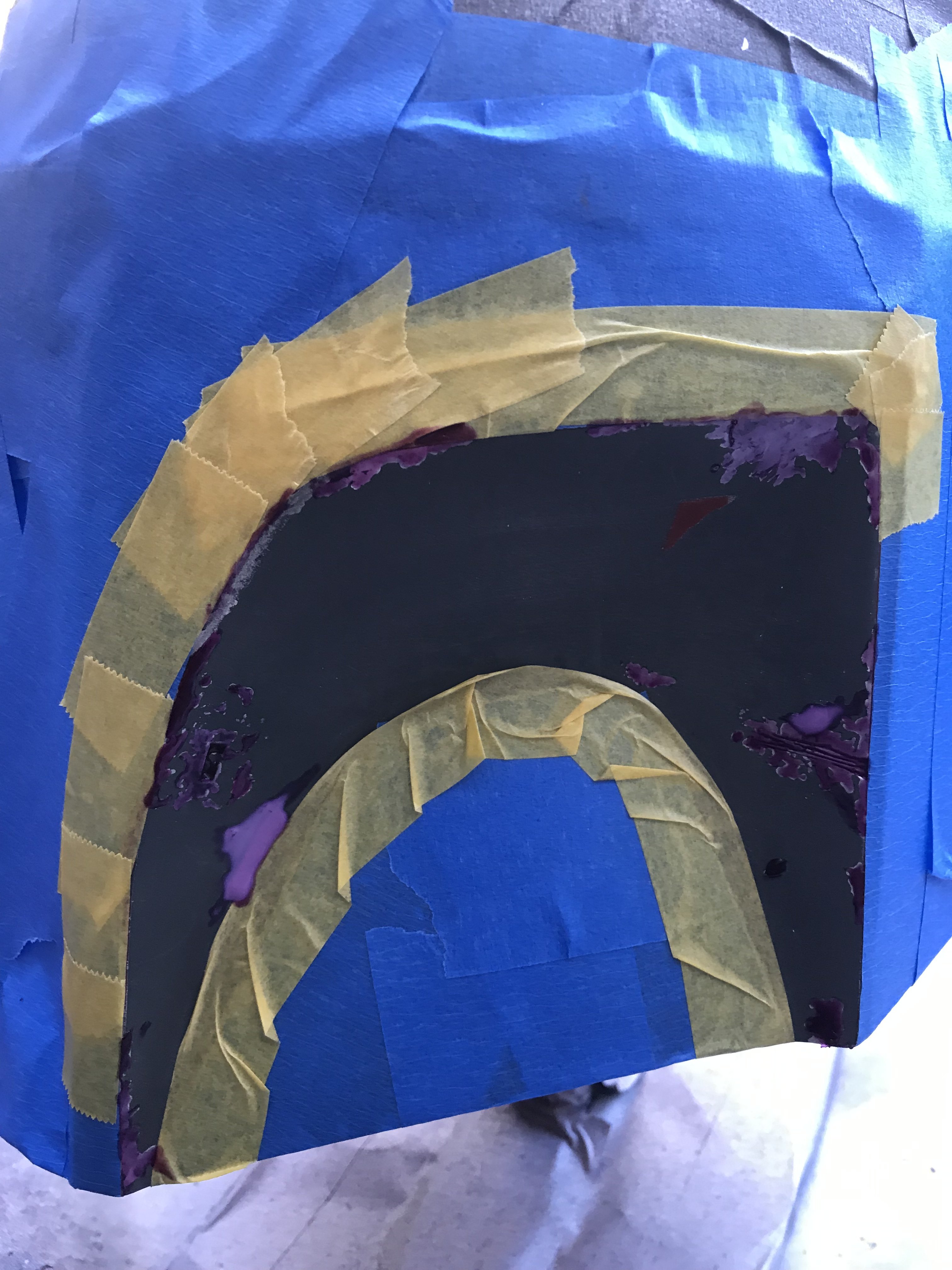

3E32EA03-FB11-4EF4-ABF3-AF441B7554FD.jpeg D0801B9A-DFCD-4FDB-965C-C8C8406E1929.jpeg 414EABFD-BAD2-40DA-9F1A-2A6446F3F32B.jpeg A1B93444-7655-476F-99F9-09E6AA00F06B.jpeg 536AAD85-9D2B-4BBB-A87A-4B00FA04082F.jpeg 923B339D-B247-4779-9429-7D82659B86B4.jpeg DF1A6C9B-86BE-4A7D-914A-88A8C0647C21.jpeg FD822A6A-9B70-4577-BFC2-D5E19686865B.jpeg 3ECB134B-F331-4870-B31D-55966BF73AD7.jpeg 3085C1B2-9C1C-40B8-9462-2DA7862D24BD.jpeg Finally was able to dedicate a bit more time to my paint up. I painted the trim and mandibles in the humbrol red (73) and felt the color had too much purple in it. I red painted the red with a blend of the red (73) and red (60). This provided a better tone and complimented the base colors better. Then I masked and painted the upper cheeks with the black (33). I let that dry and removed the masking from the dome and lower cheeks. Put frisket on the grey and silver damage in the dome and lower cheeks and taped off all other areas with tape. Hopefully tomorrow will afford me the chance to paint those areas with the green (78)

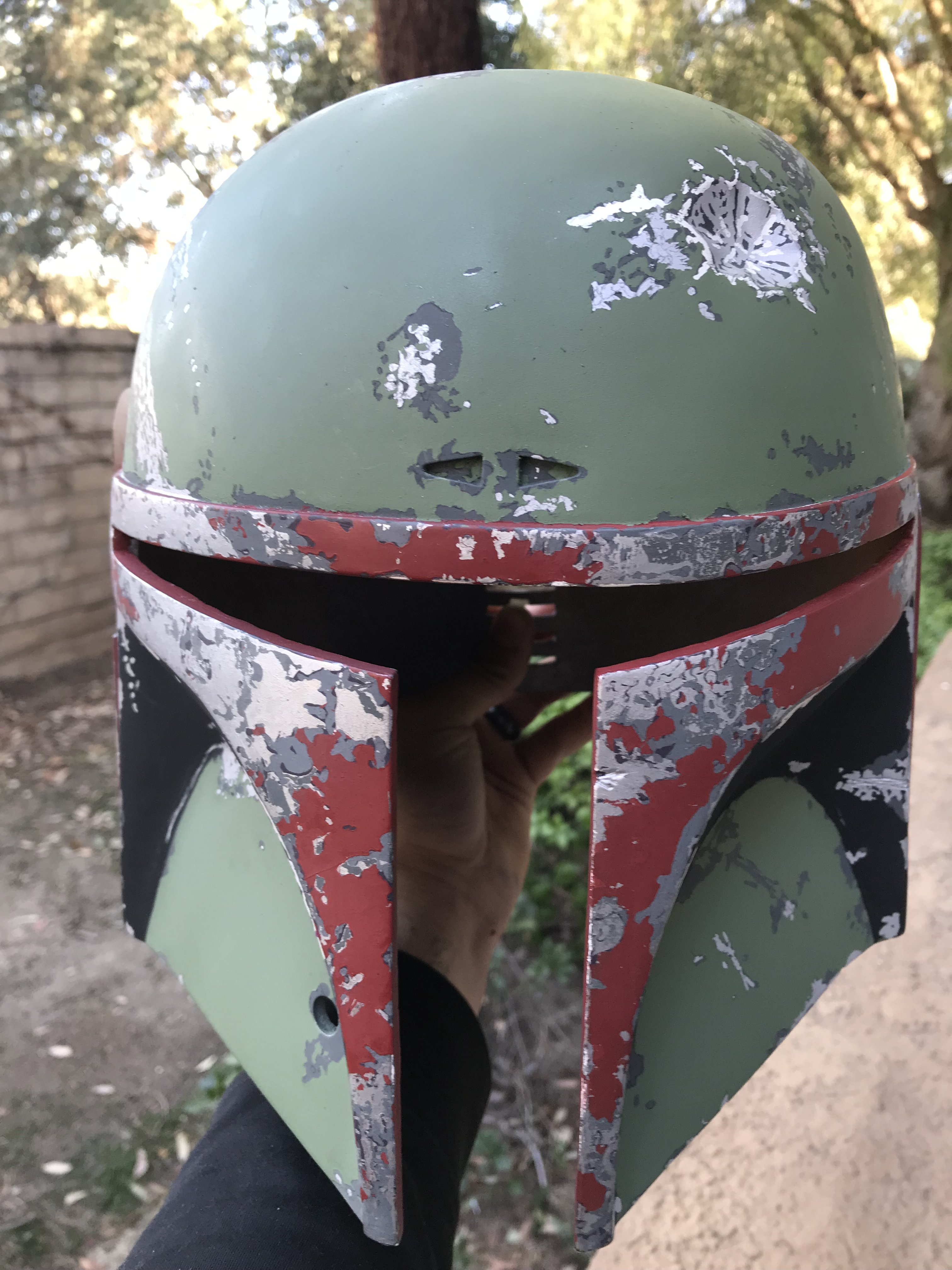

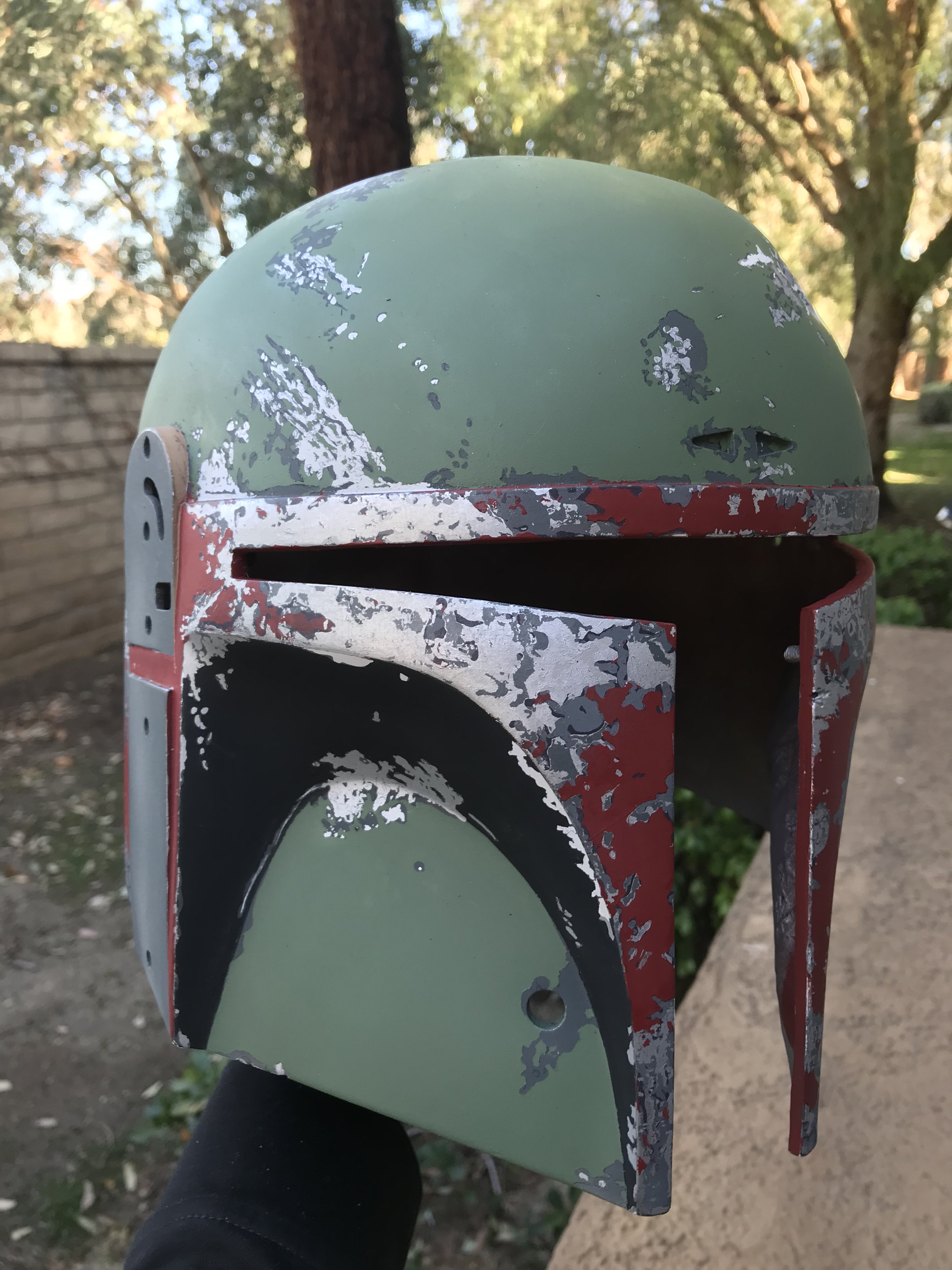

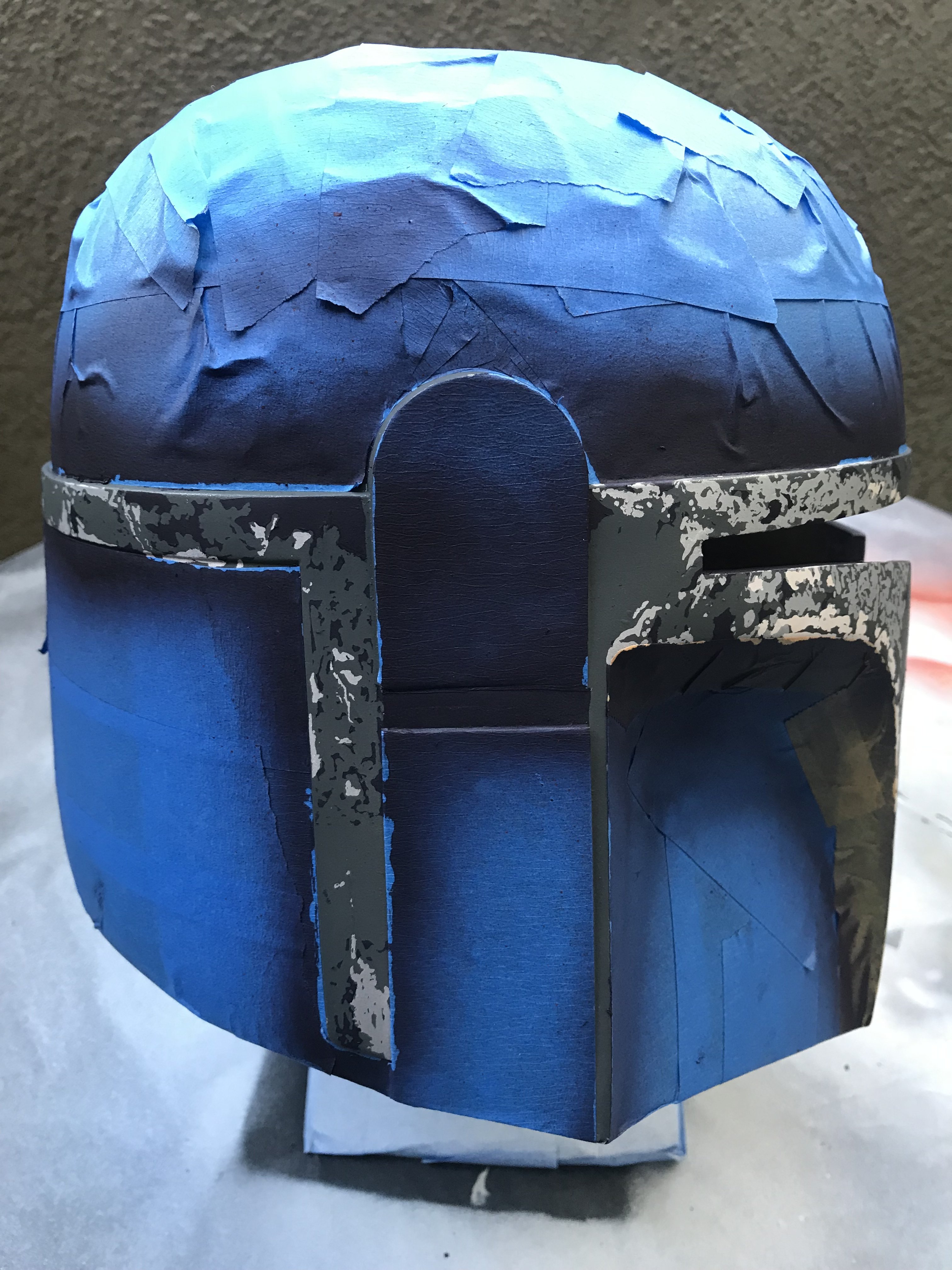

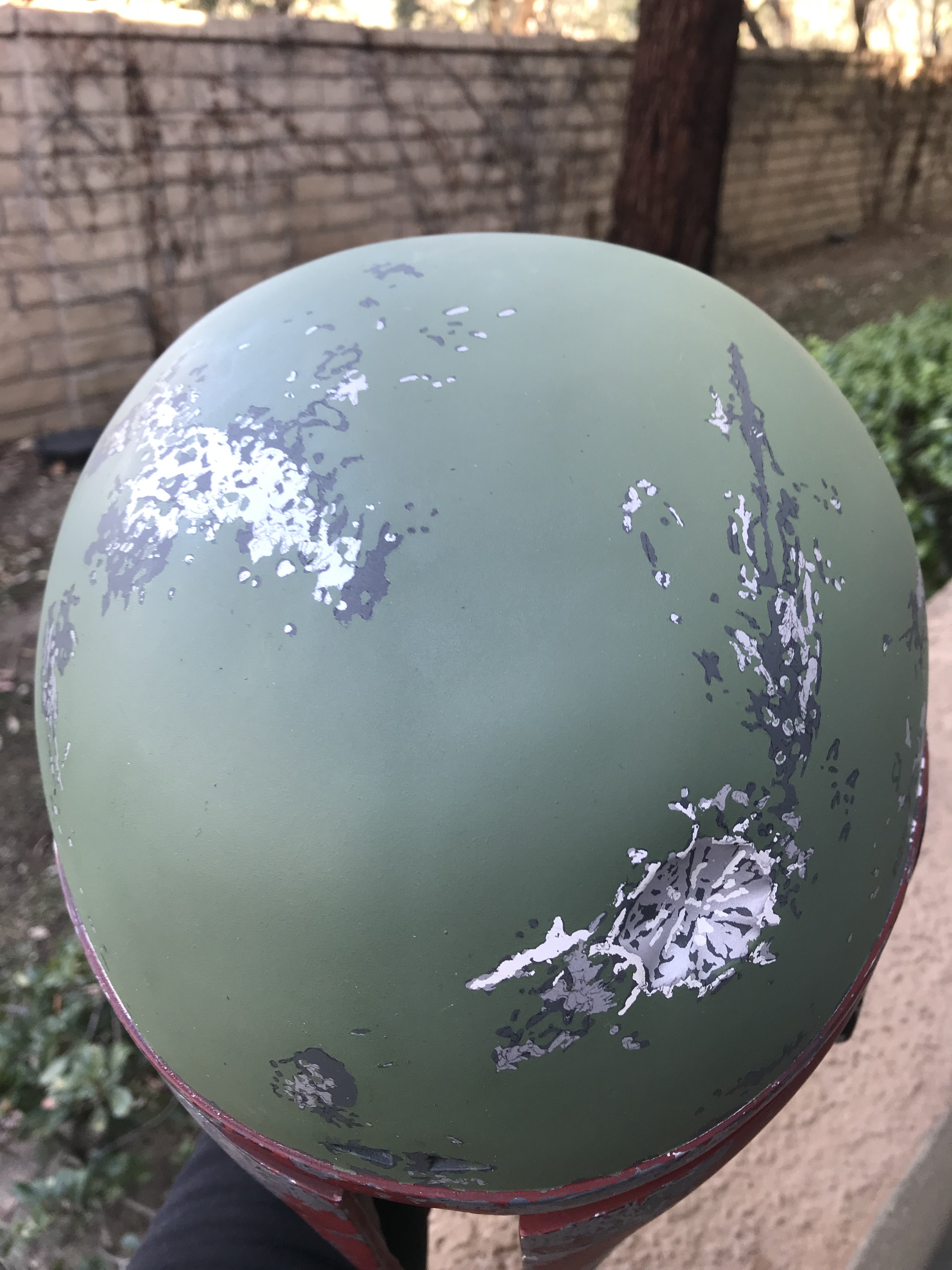

Well, with the upper cheeks masked off and the lower cheeks and dome unmasked, I laid down the green (78). I let this dry for a few hours and got excited so I peeled the frisket off as well as all the tape to take a good look at my progress. I have to say that I’m super happy with where everything is at so far. There is a lot of detail work to do still but the overall look is something I’m happy with. Still need to do a buff but will wait a little longer to do that before masking everything but the back panels off to do that area.

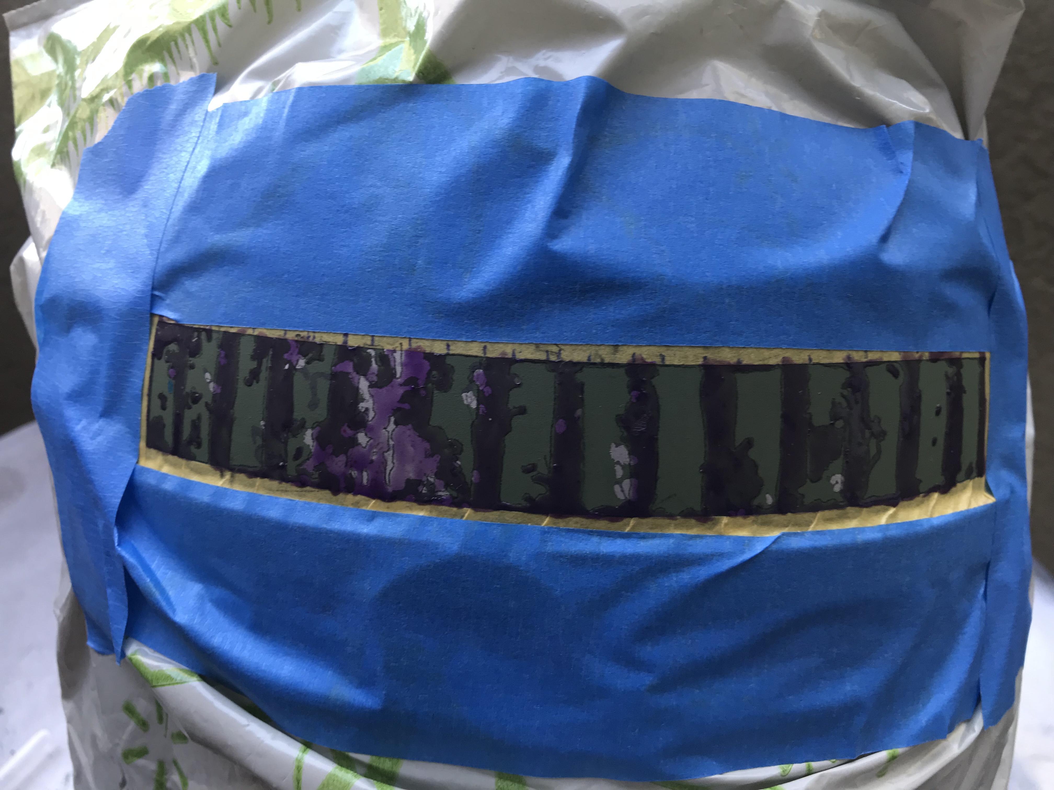

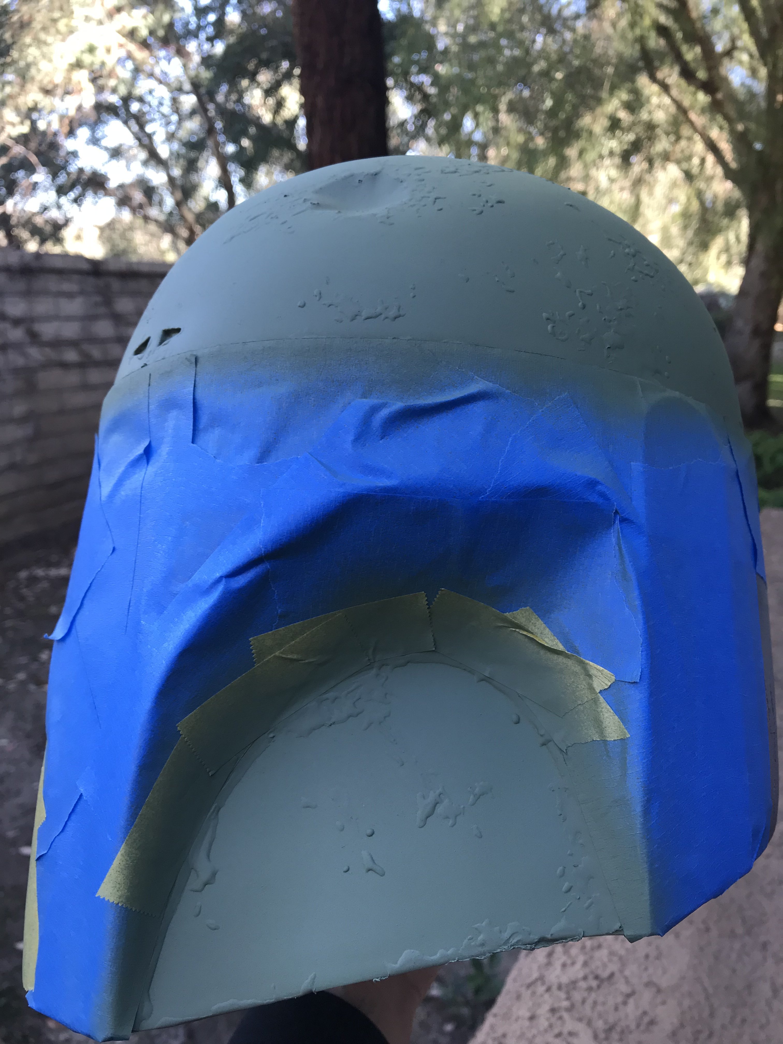

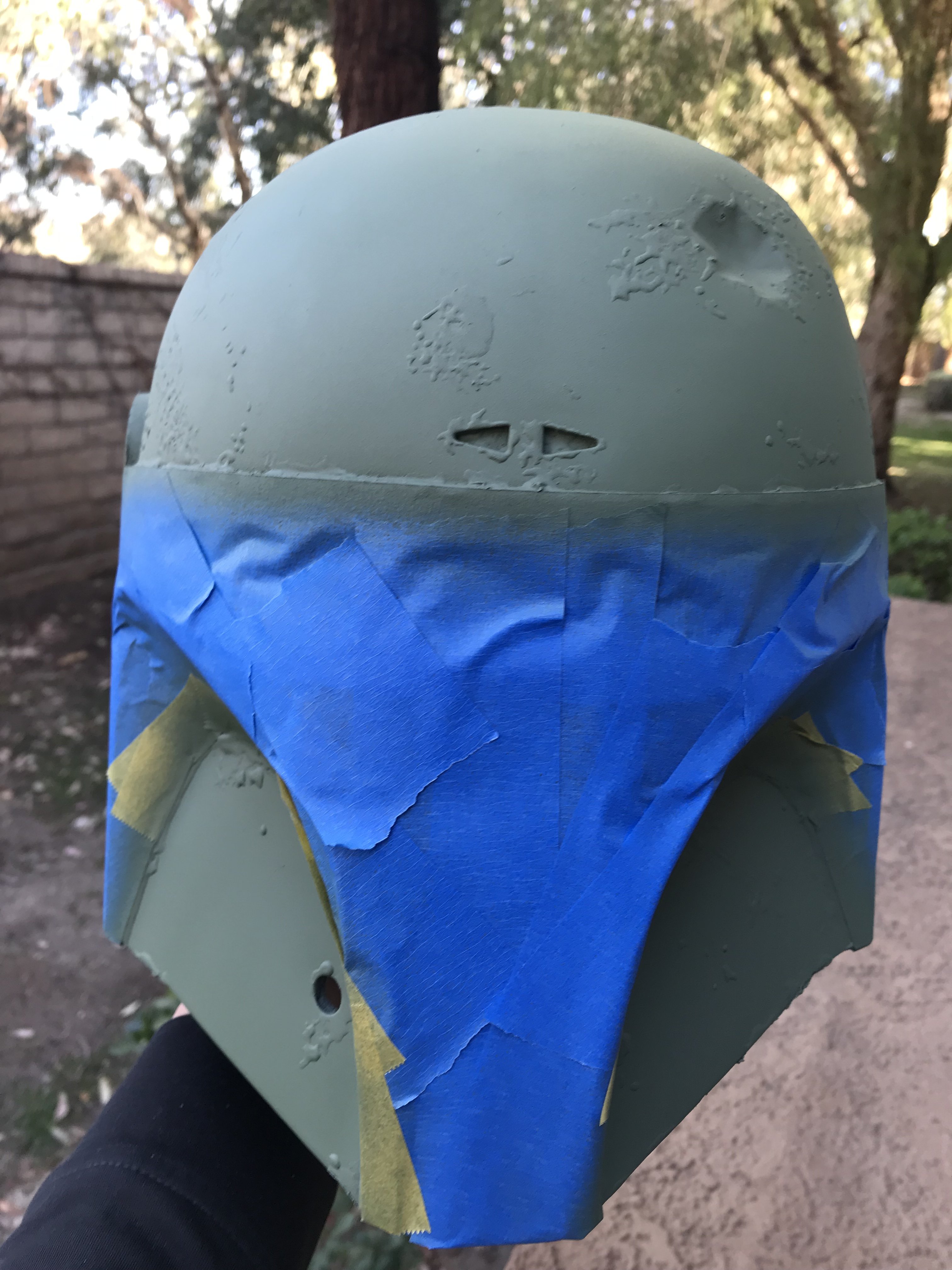

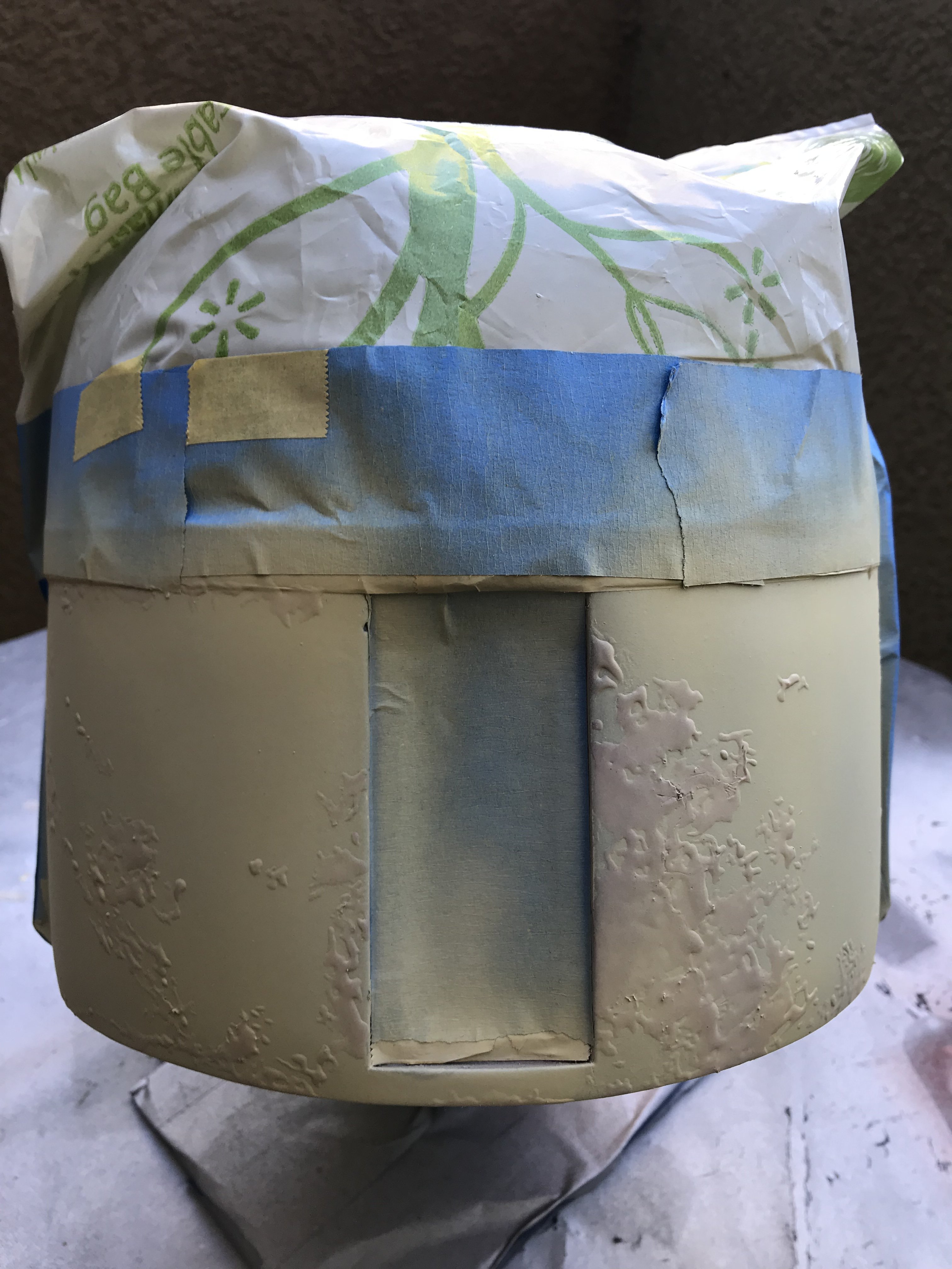

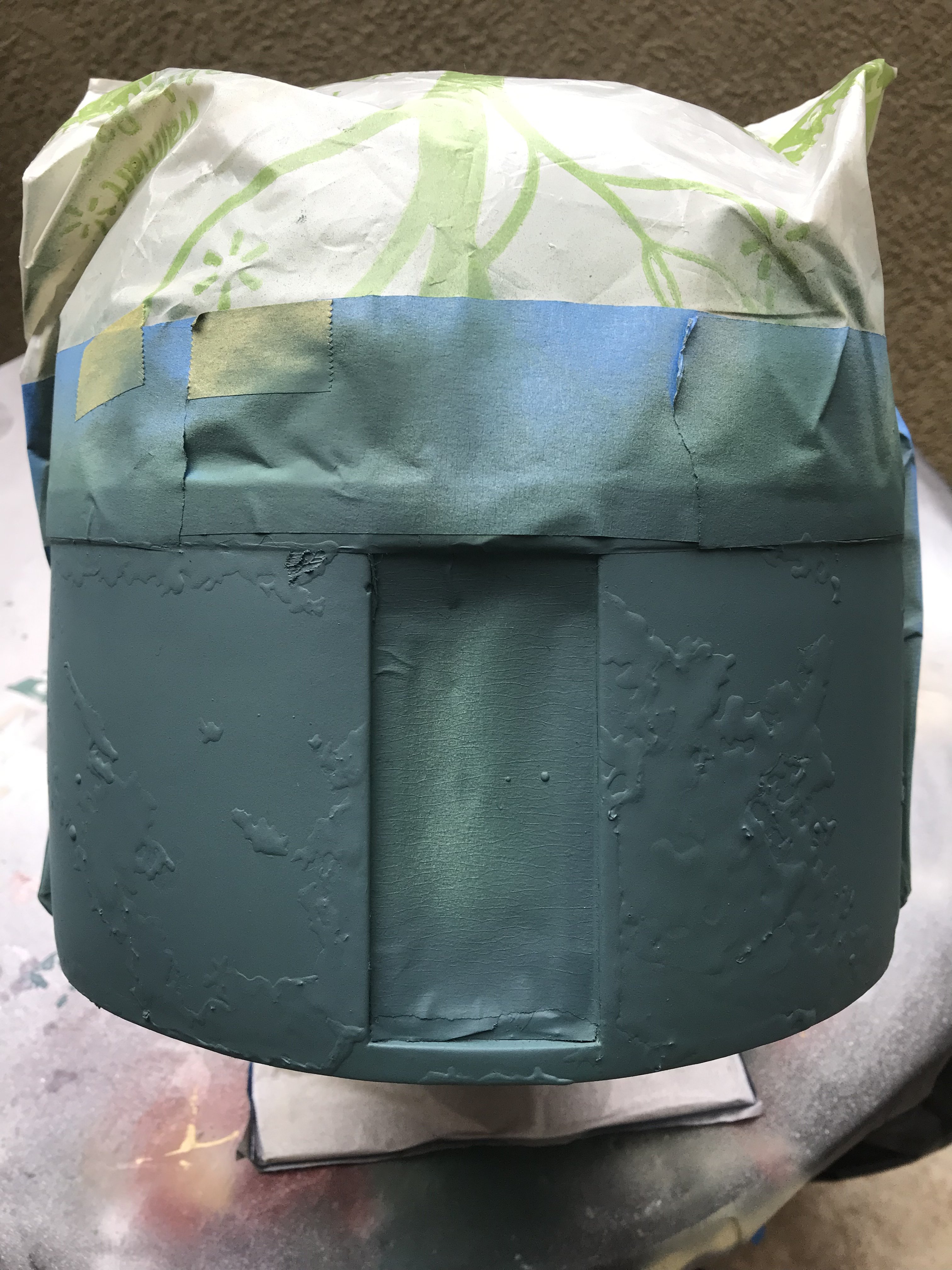

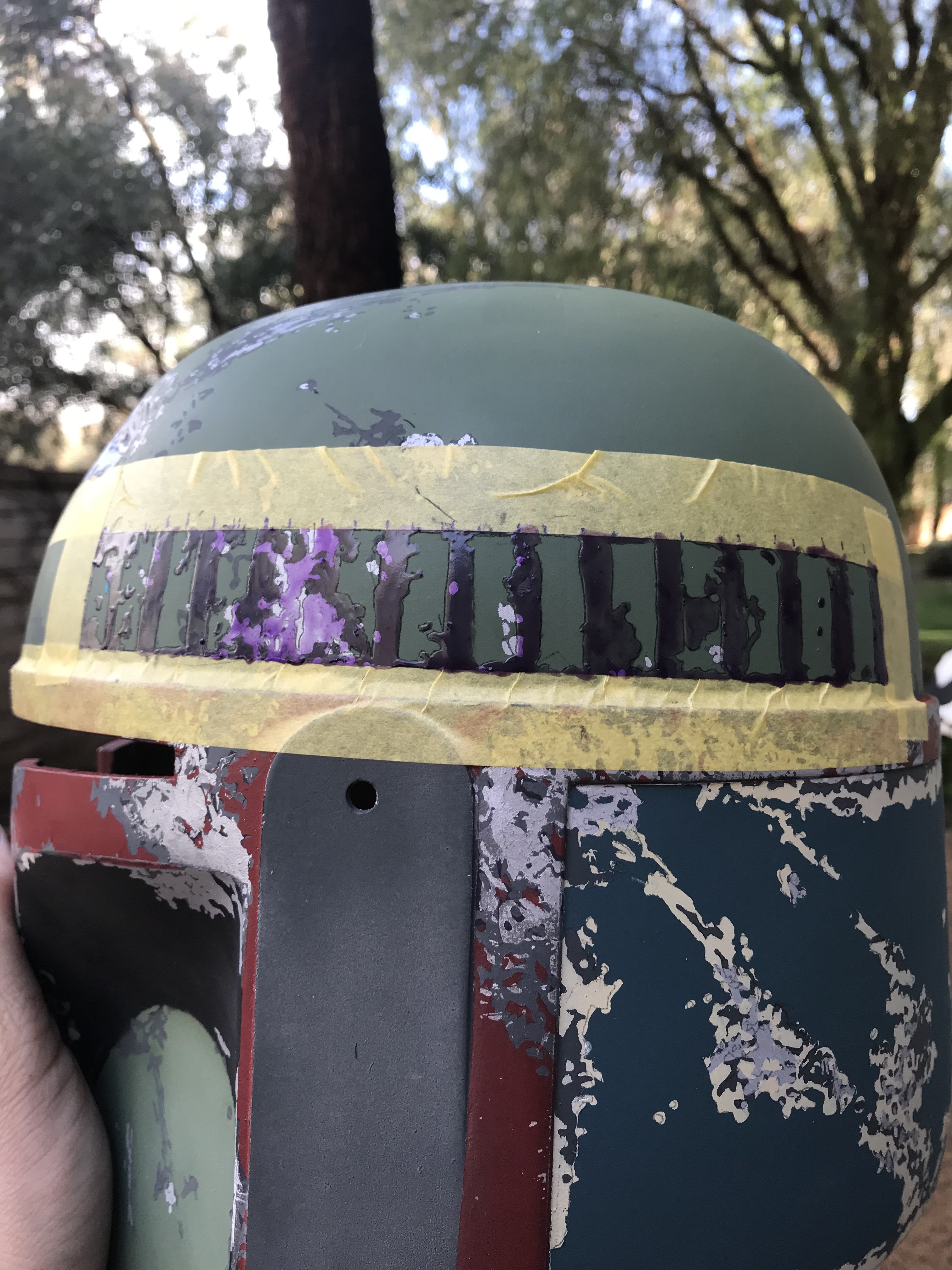

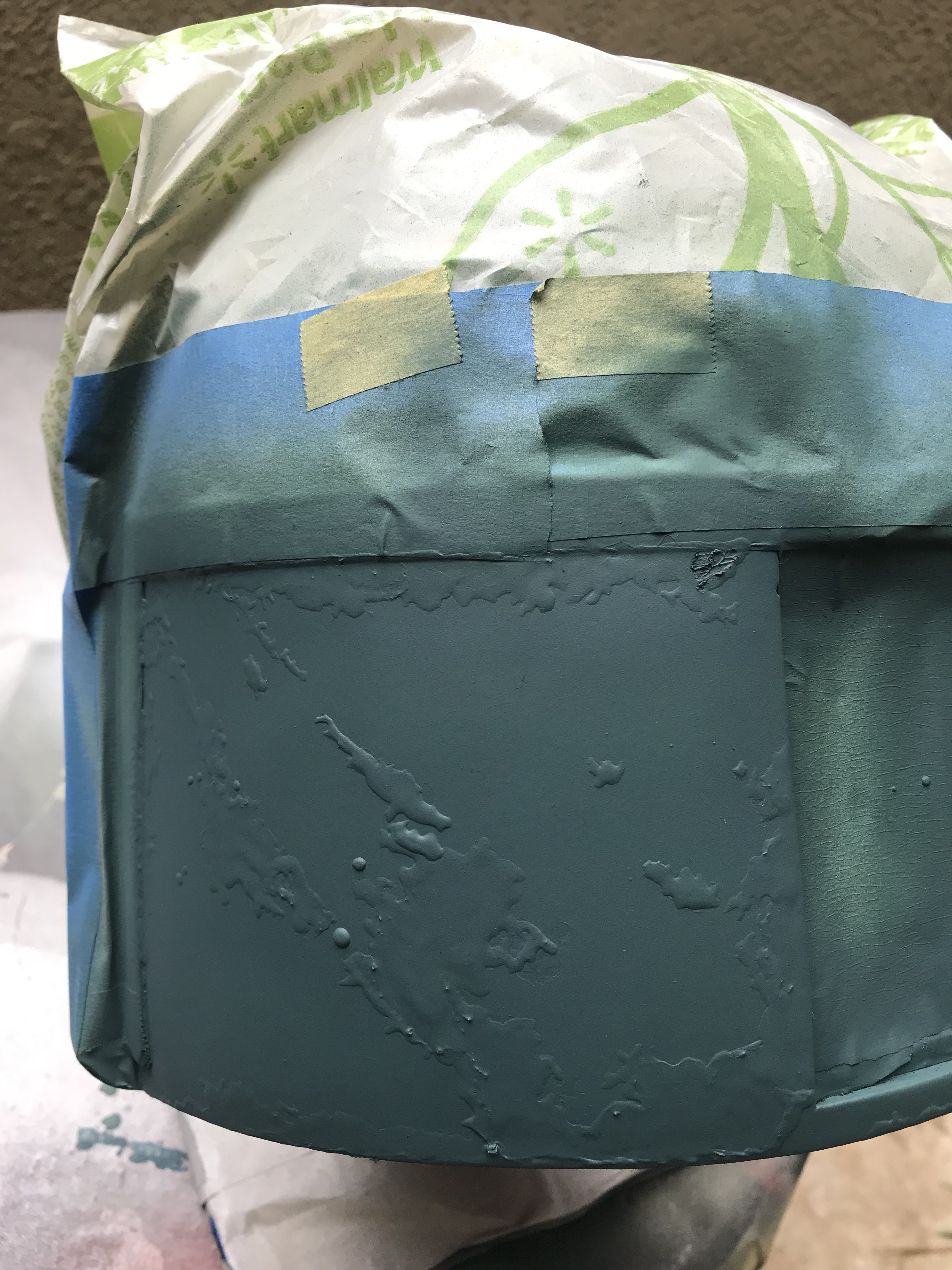

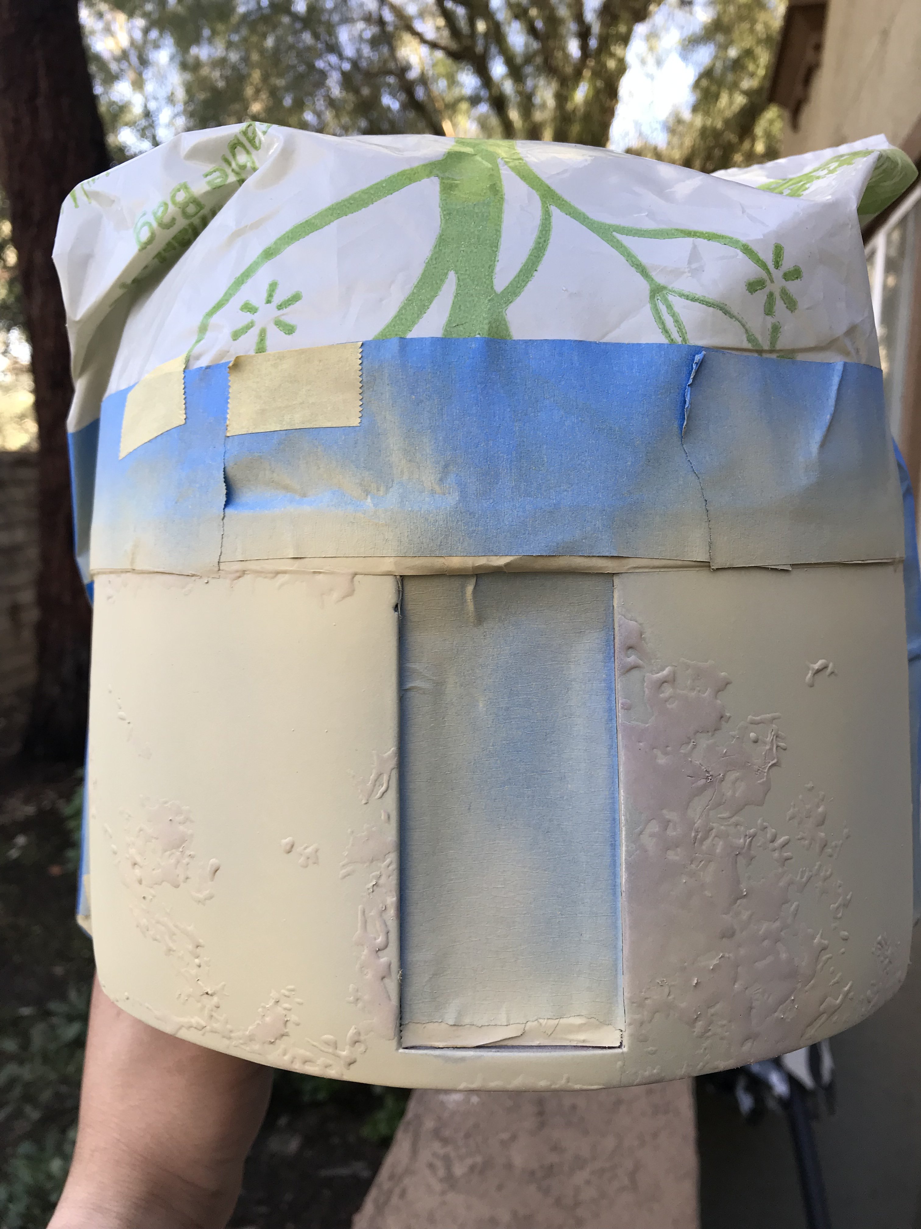

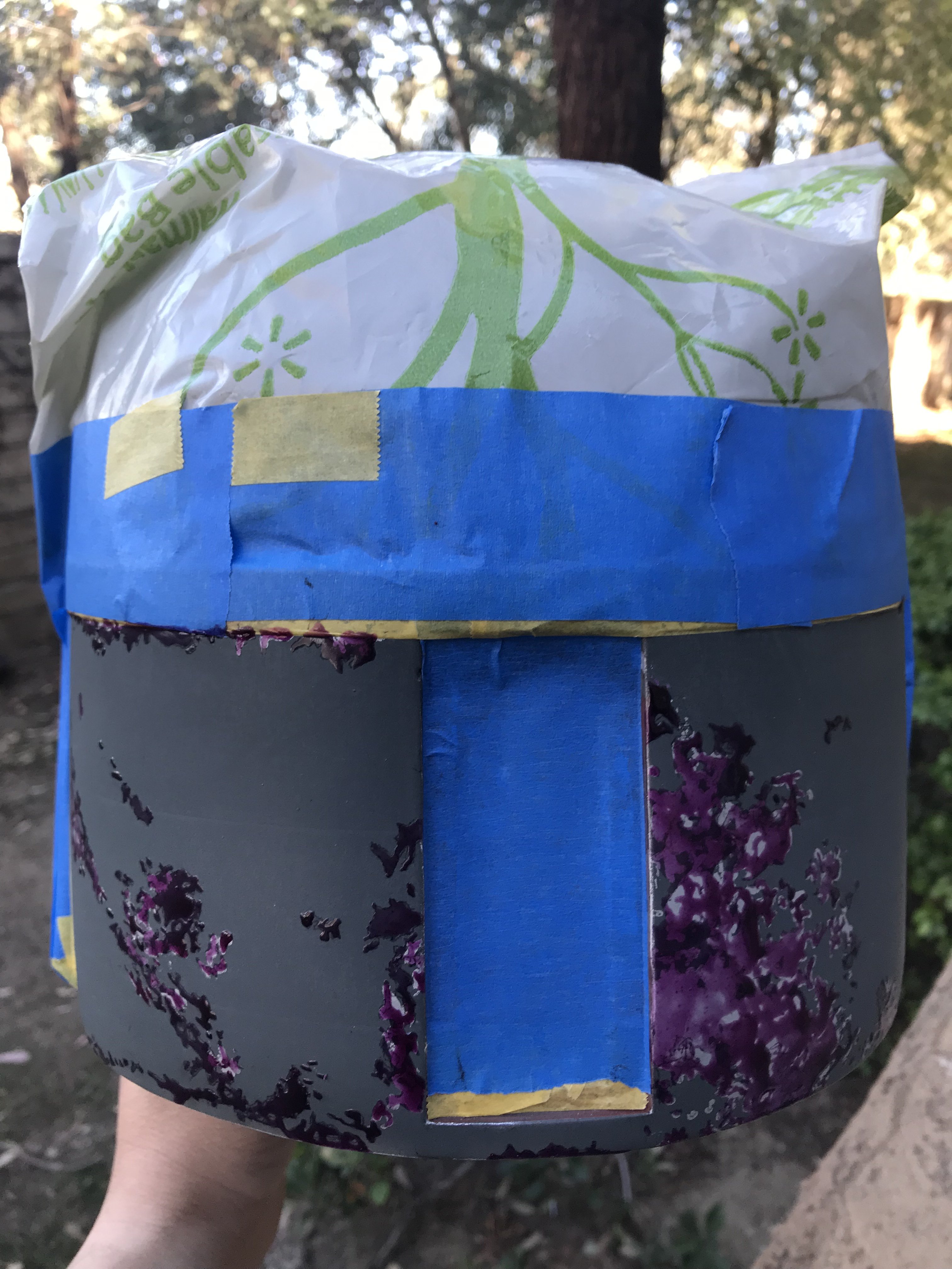

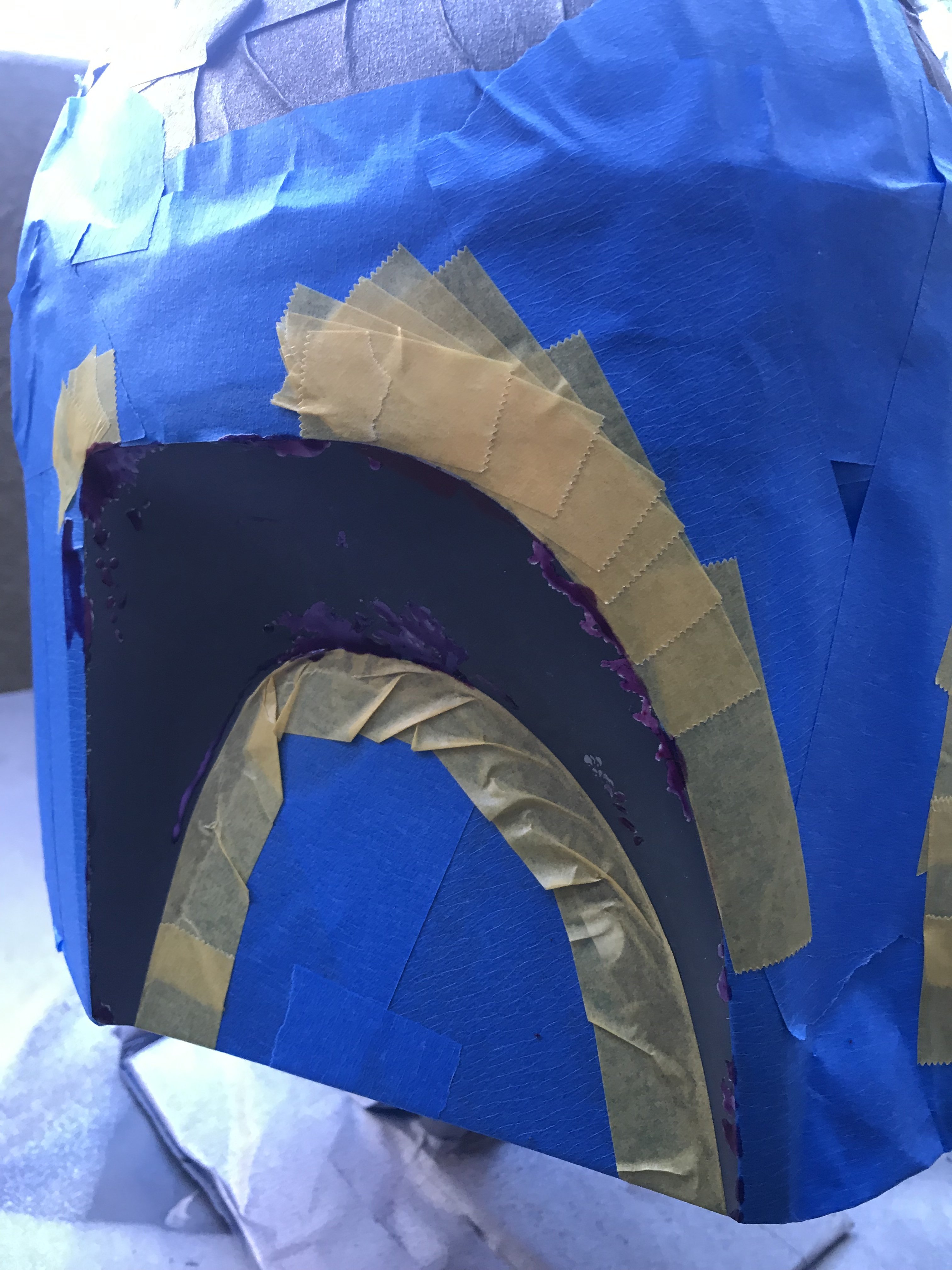

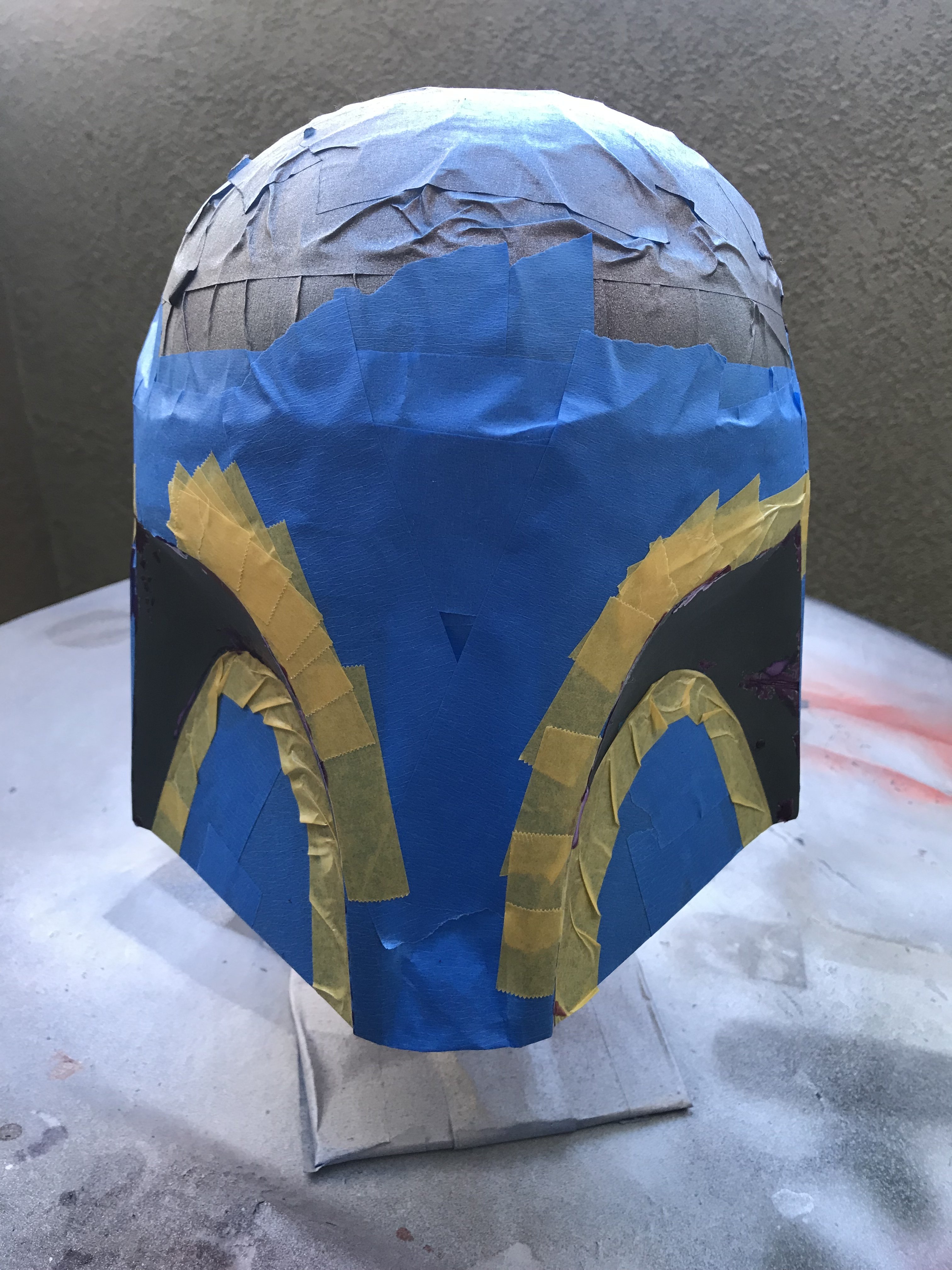

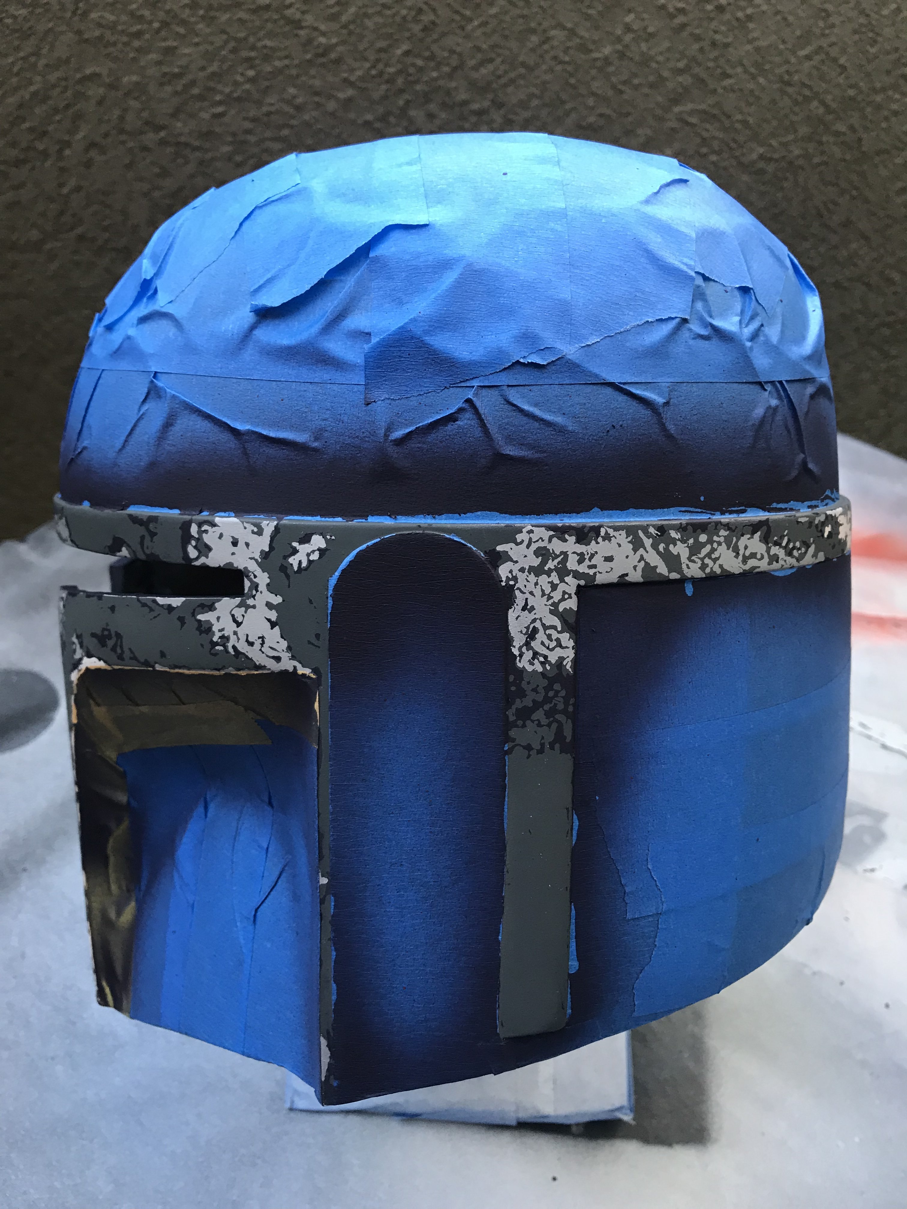

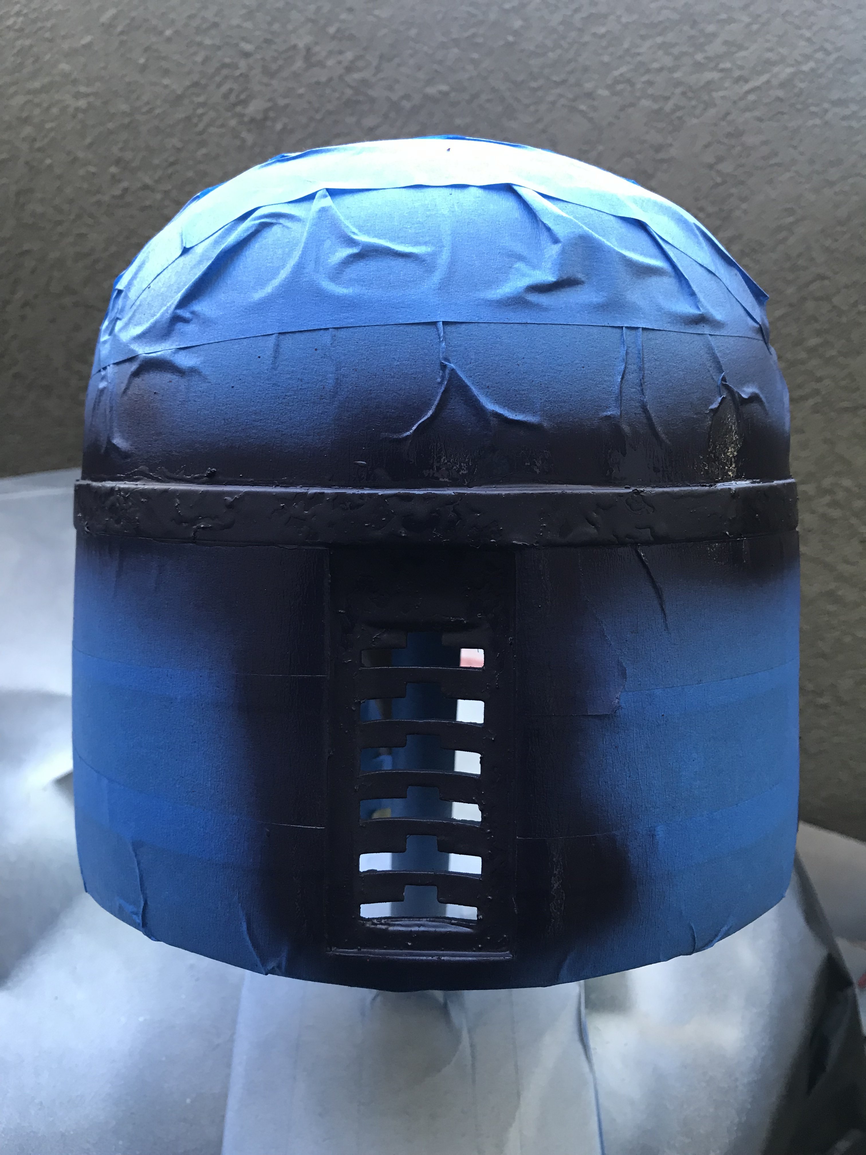

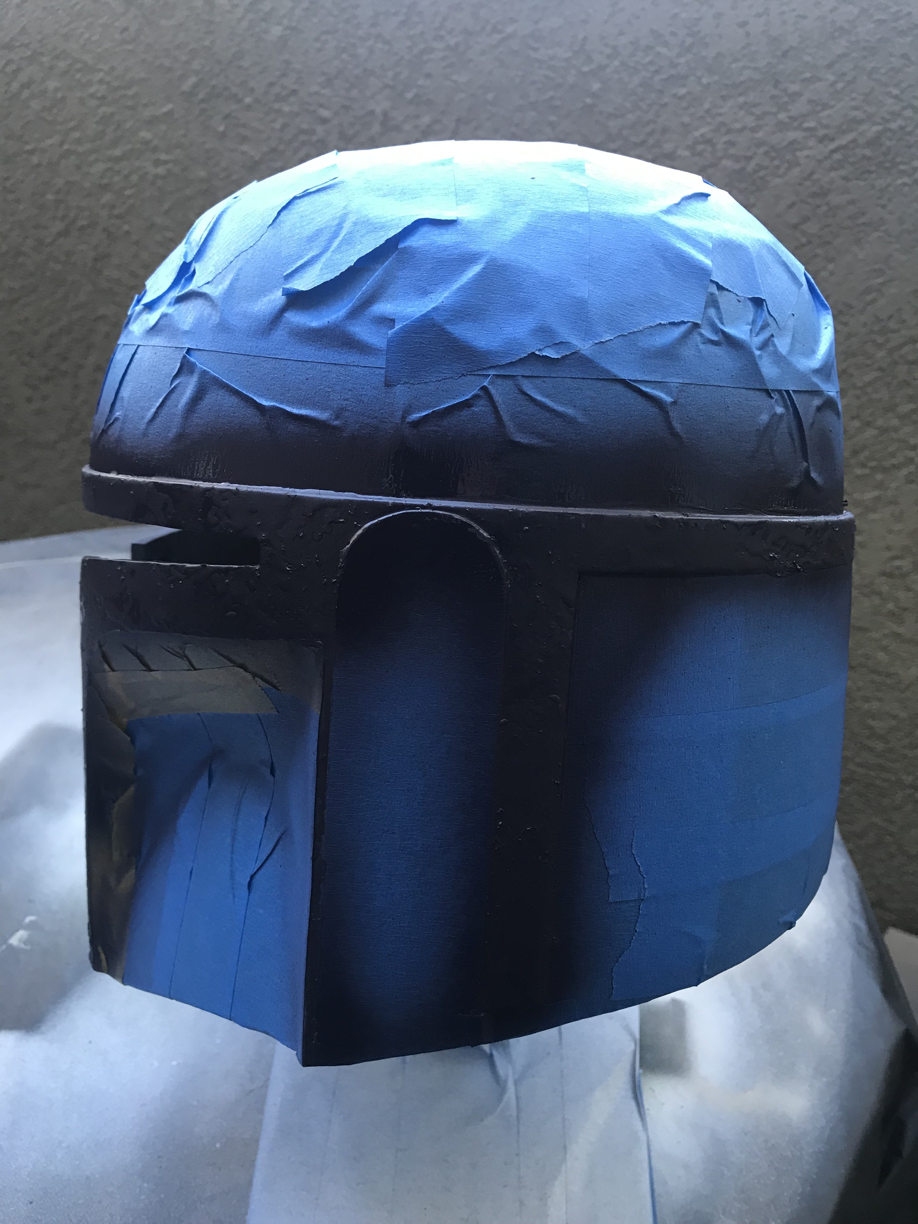

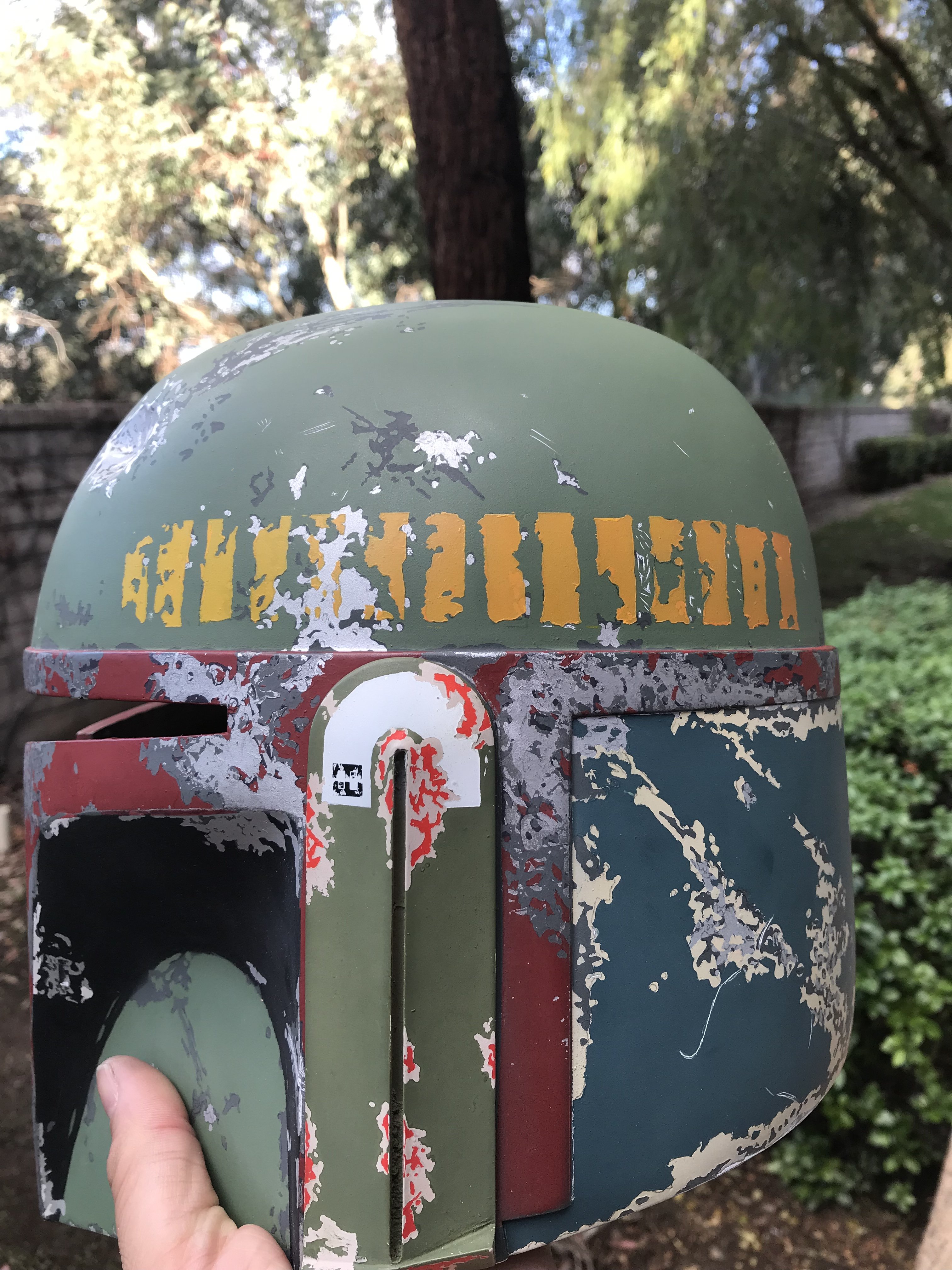

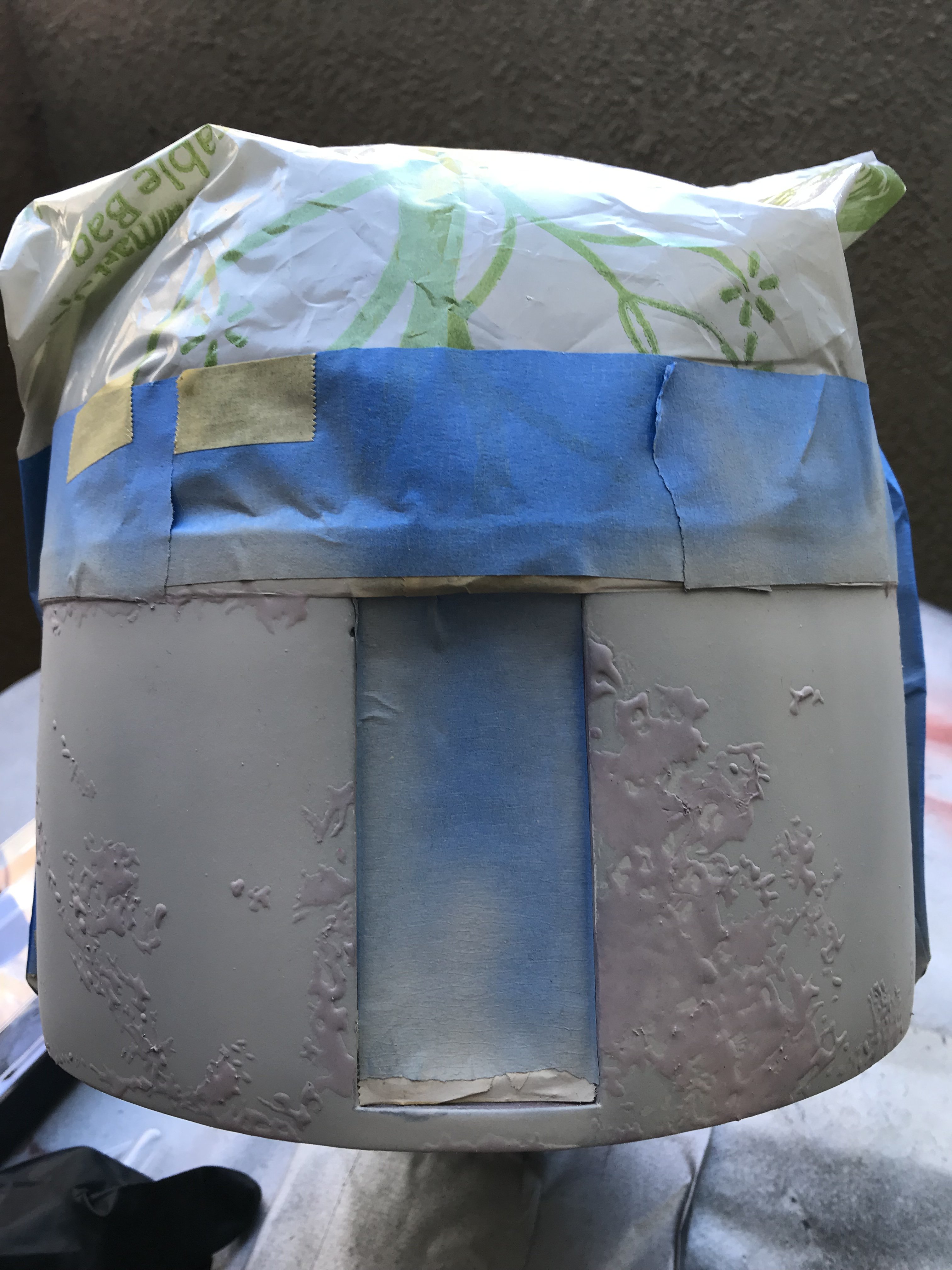

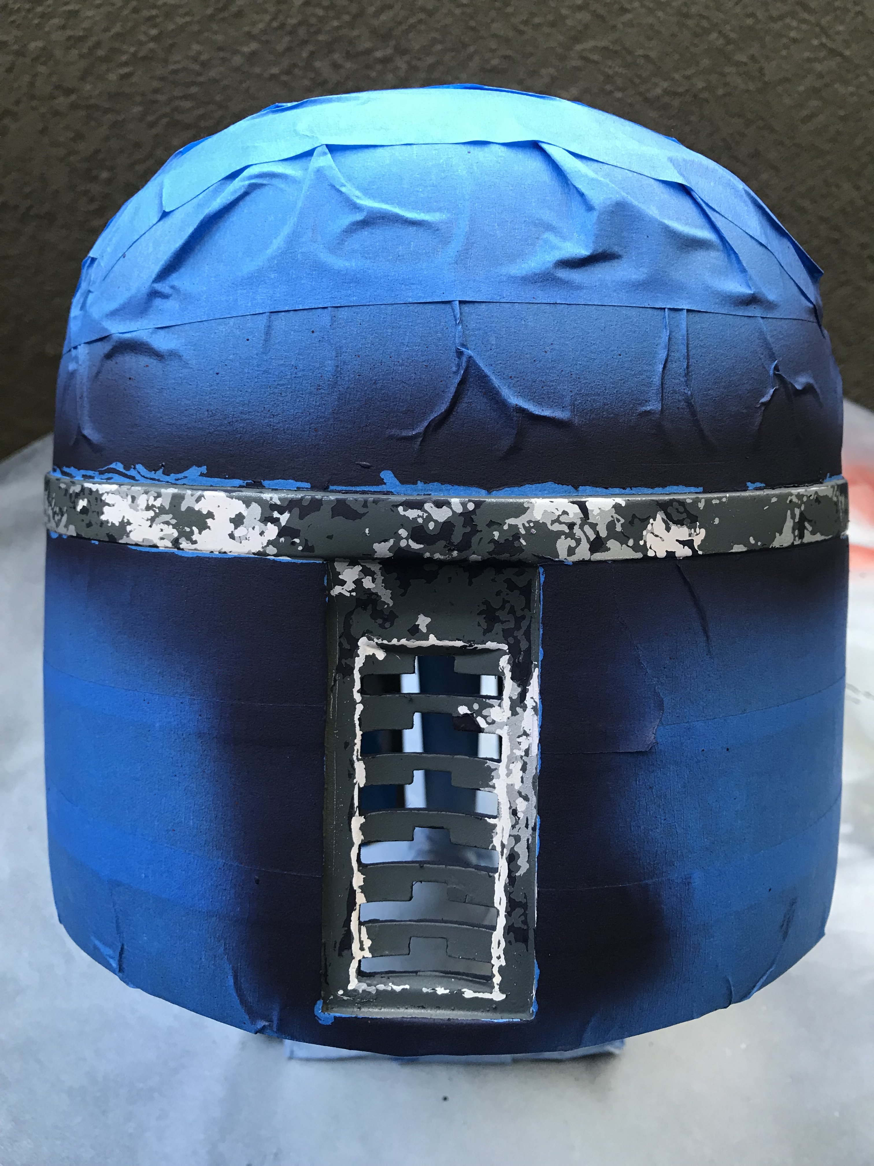

18BD6CCD-5B9B-4F04-AA07-F7231905366E.jpeg DDA2B1DD-BF5C-4426-8356-BD964118462D.jpeg E2135C84-8636-44B9-90D9-C128B99ABFBC.jpeg 7CE47386-0DD9-42AB-8EF6-28015ED6B394.jpeg 91A7EC9F-4E80-4762-80E9-A6579BC6A6D1.jpeg 0FA11C43-14EC-4B36-A1B0-A8112D0498FF.jpeg FE1BC4F3-0004-47BD-A83A-06A4F571C89A.jpeg 8119C6FF-EFE0-4397-9763-7527D7361A3F.jpeg E467770A-7FAC-443E-A085-305AAD4E0D56.jpeg B2C4A68B-FFA9-4FB9-916D-ECB6663F23F8.jpeg Well, over the past few days I was able to get started on the back of the helmet. Masked the hey and silver and put down some light grey and beige for another layer. Then masked those parts off and got ready for some blue green! As you can see, the fist mix of the Humbrol green 76 and blue 96 was a little too green. So I remixed the original color with more blue to get a meter match. Good thing I kept the first color fix and had extra to make the adjustment easier. Can’t wait till tomorrow to peel, and damage a bit then start the kill stripes!

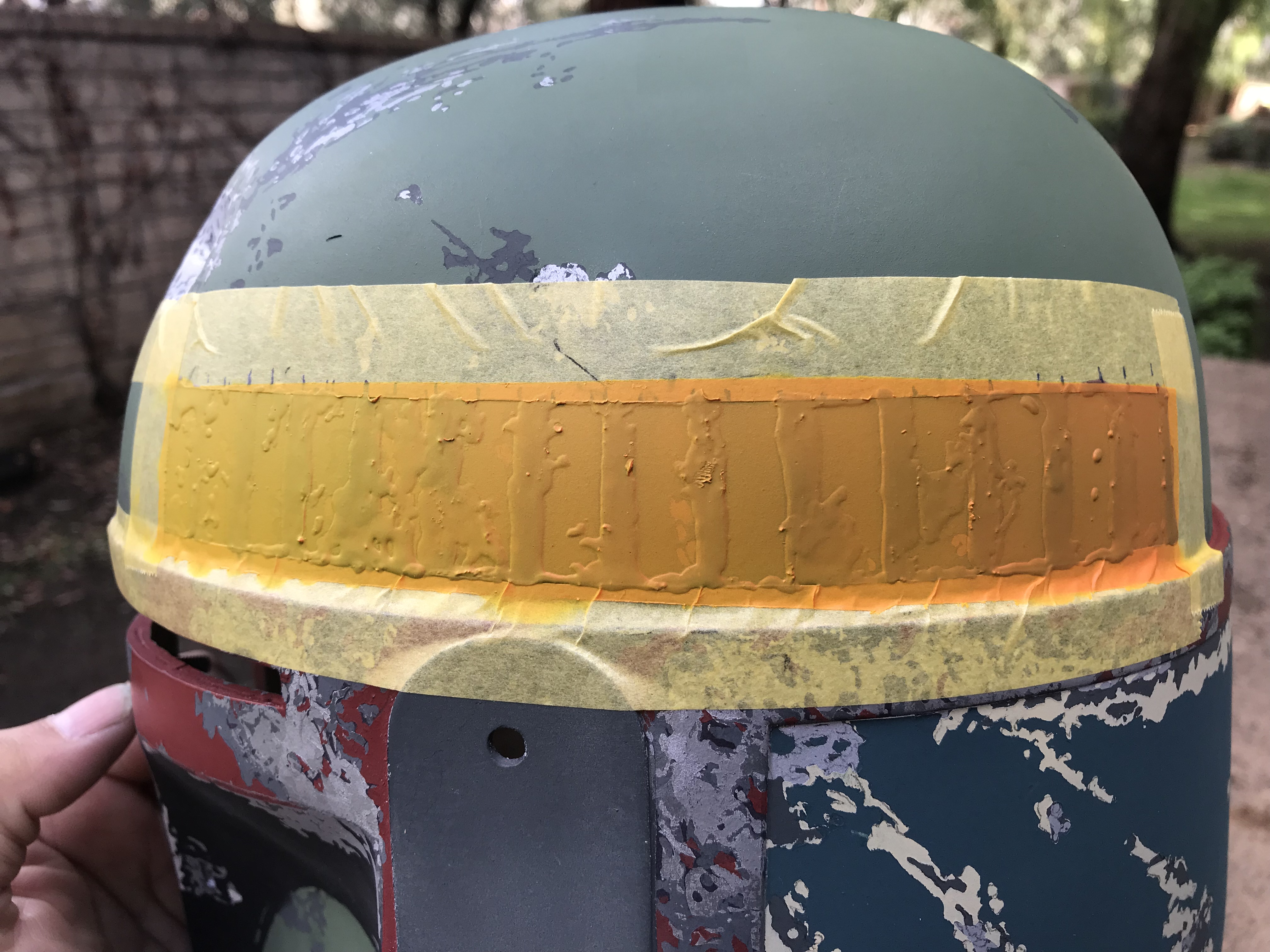

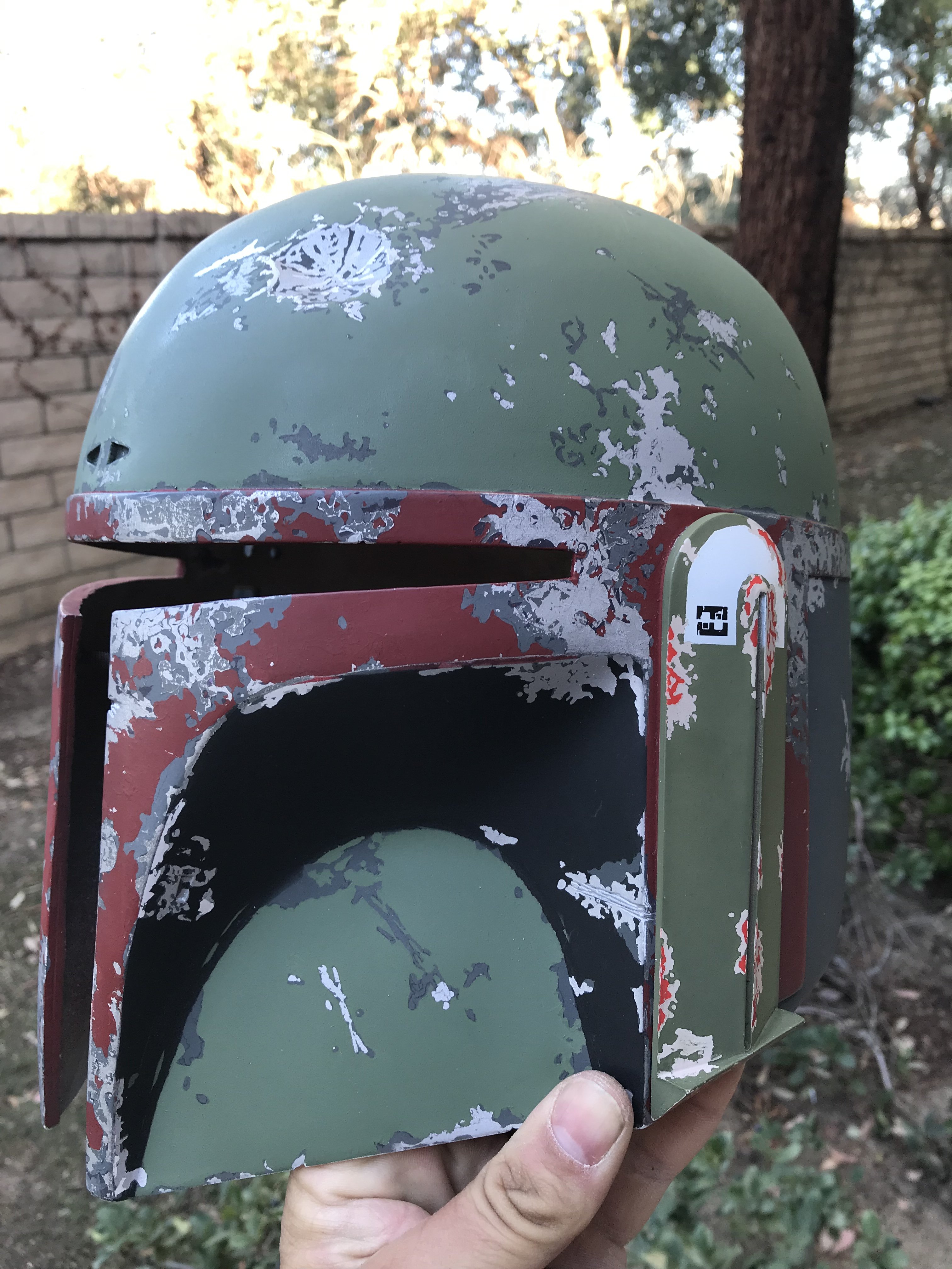

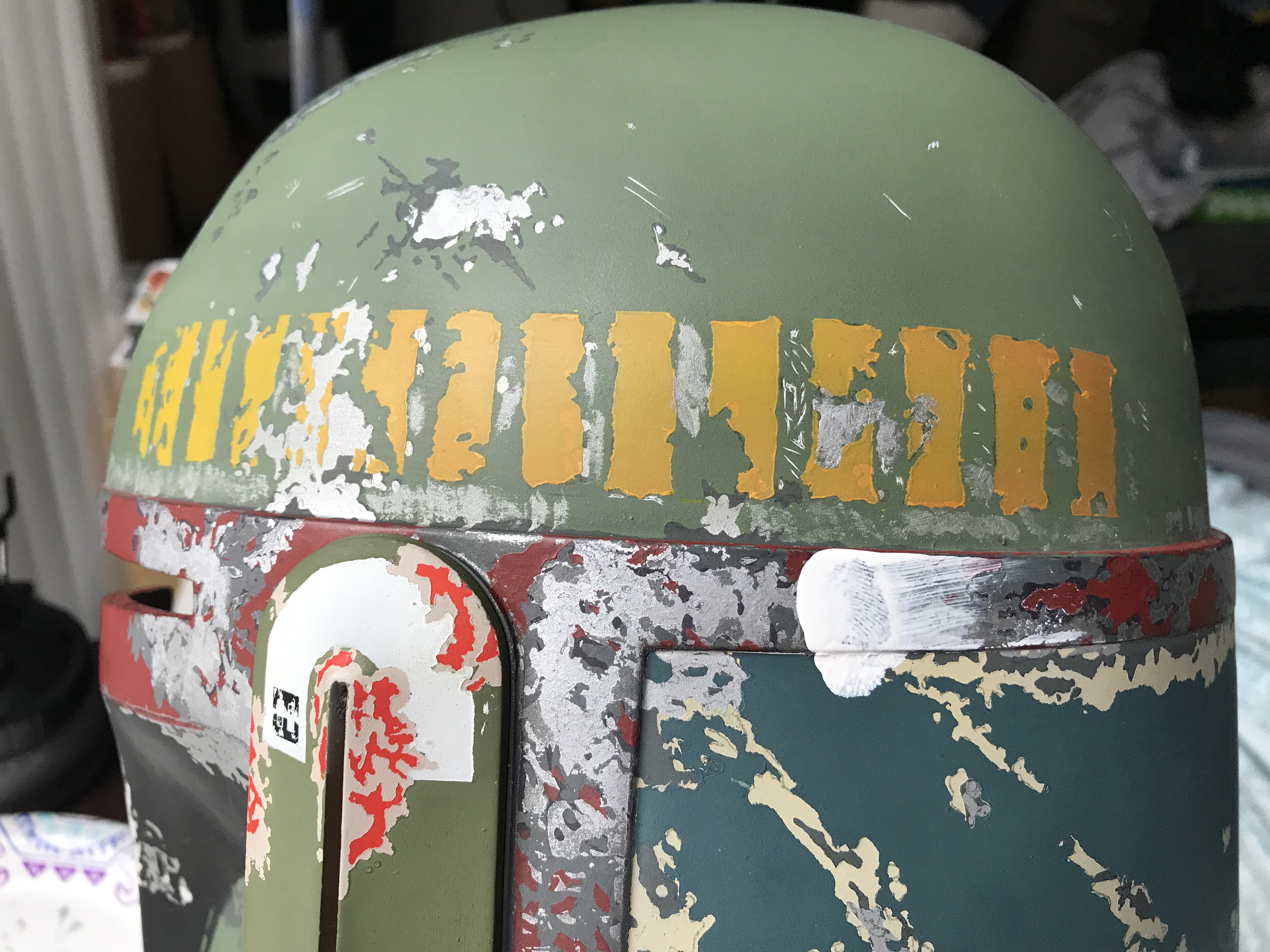

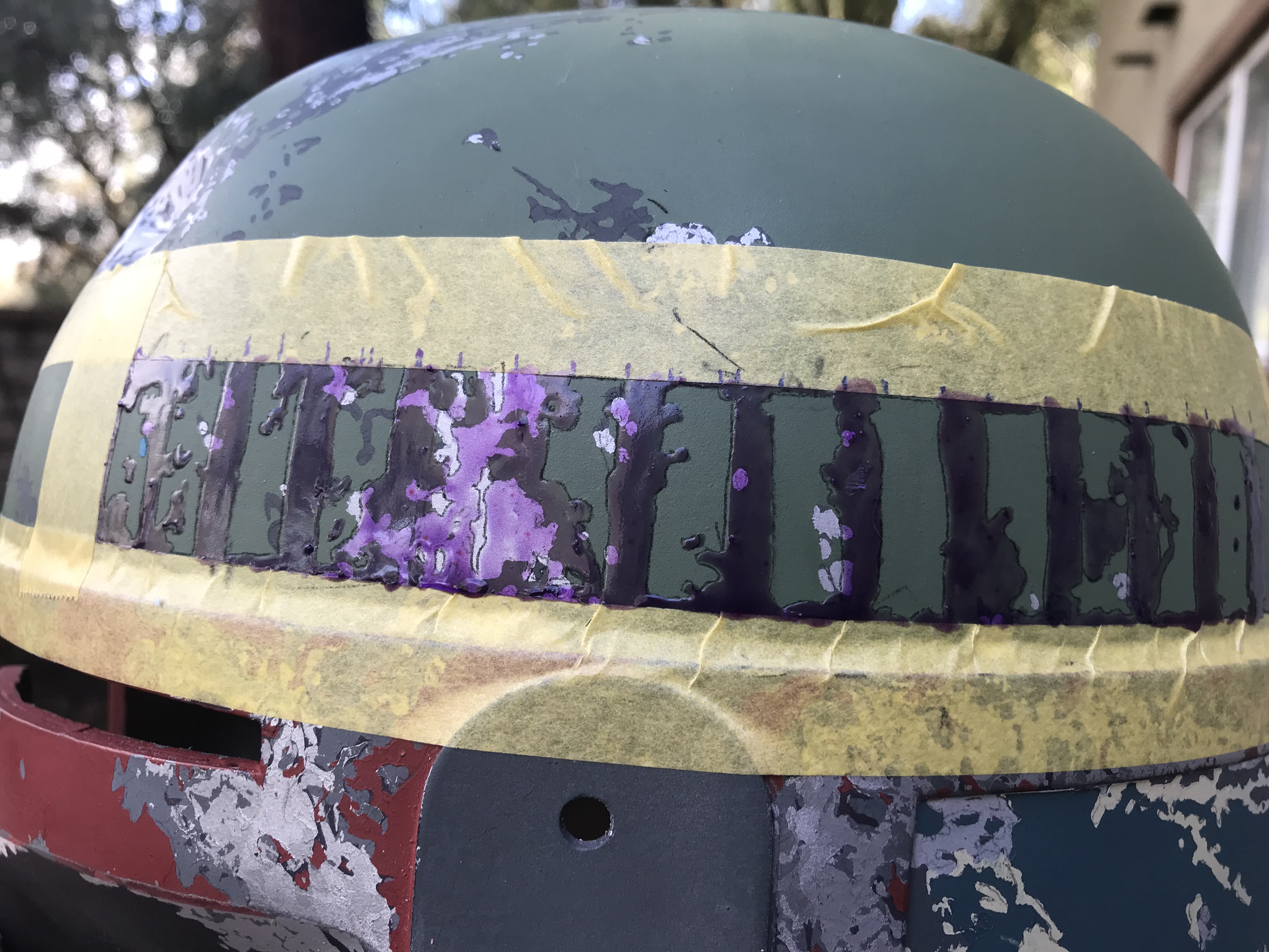

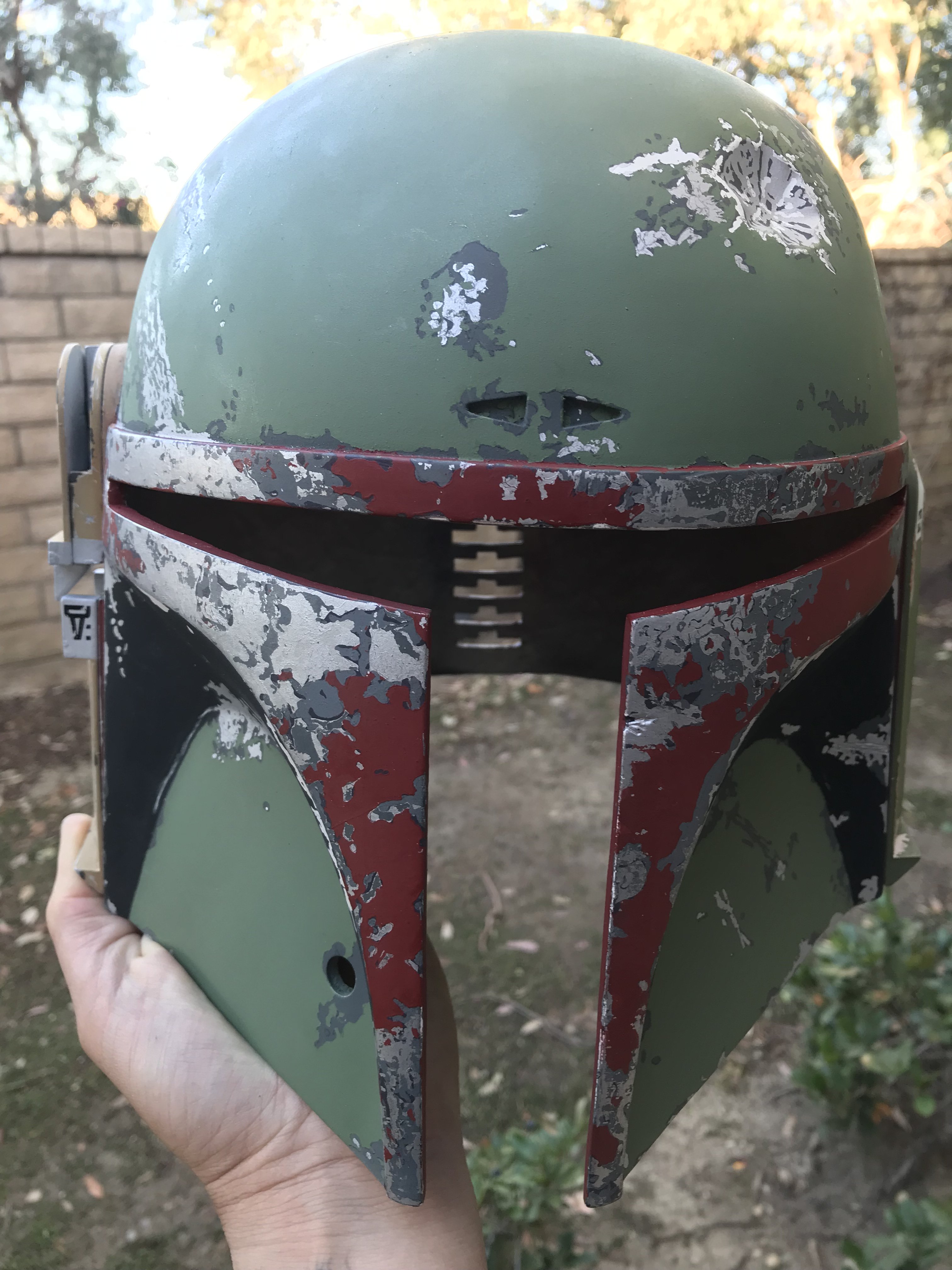

0A9E383F-3664-4A50-B19D-105675A06DCB.jpeg 82EE8EDC-E727-4BA1-9D5C-4AB5CDFF73F9.jpeg B30FBCE0-275F-47E3-8B91-650EEE883255.jpeg F1B4D8DC-3596-40DE-918D-6A244B72048B.jpeg F0DFFA92-E1BF-4DC8-8F9F-B411873069AD.jpeg 75C13519-2F37-40C2-9BD3-AA2CE4112E25.jpeg So, back got peeled and kill stripes got mocked up. They were also painted and peeled as well. I like the fade but after looking at it it is a little off. At this point I am happy with the overall paint up for my first attempt. I would make a few small-ish corrections to ge closer to be ESB exact but, I think I learned a lot and would be more confident in my next attempt. All that’s left on this one is weathering and extras.

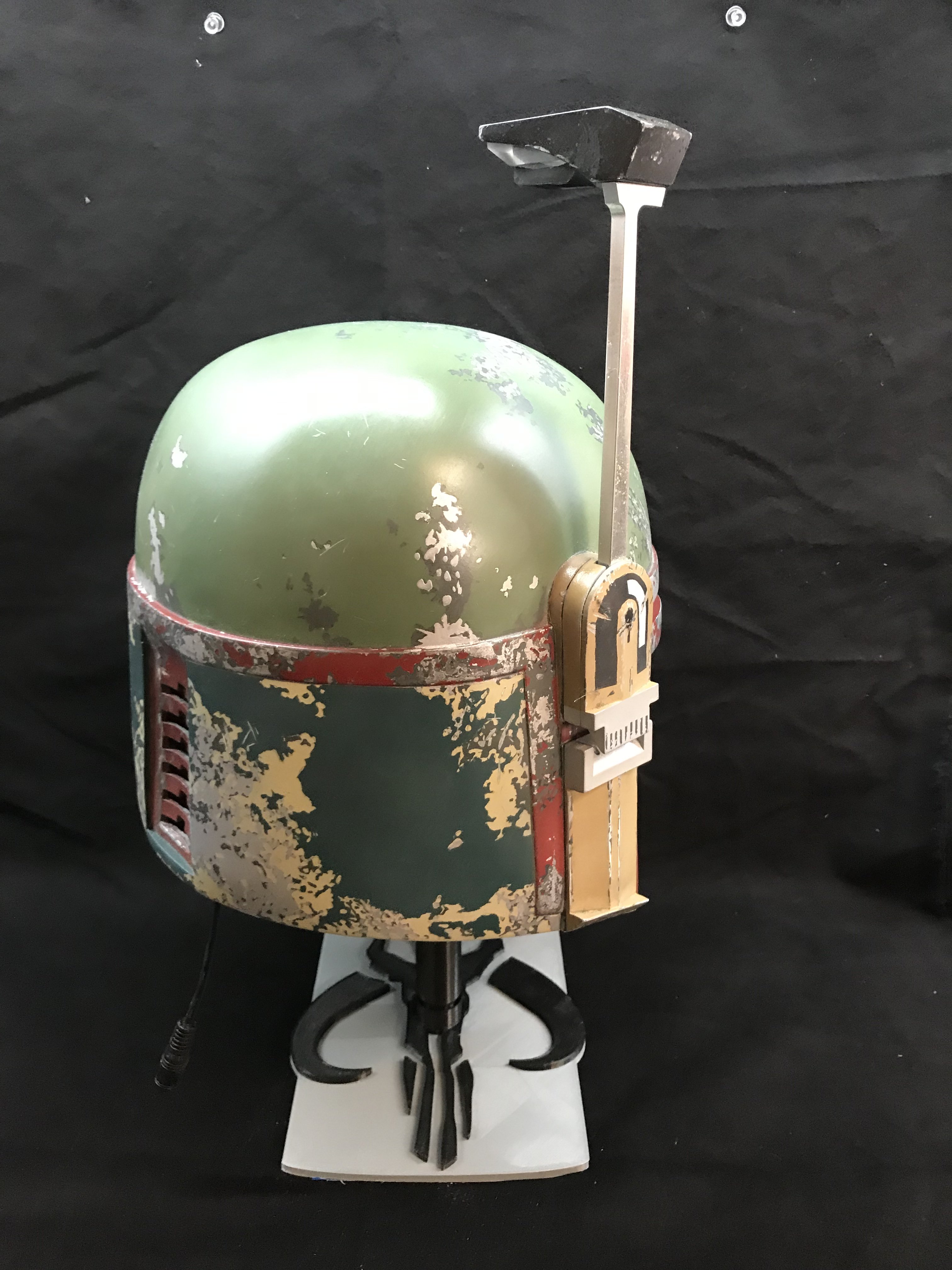

Today I added some of the finer brush detail on my bucket. On top of that I finally added the infamous finger print smudge! I was kinda nervous doing this but, it had to be done! And I’m pretty happy with it. I will hit it with wire wool and bring the tone down a bit with aging. I posted a video of me doing this on Instagram too. @gripjames

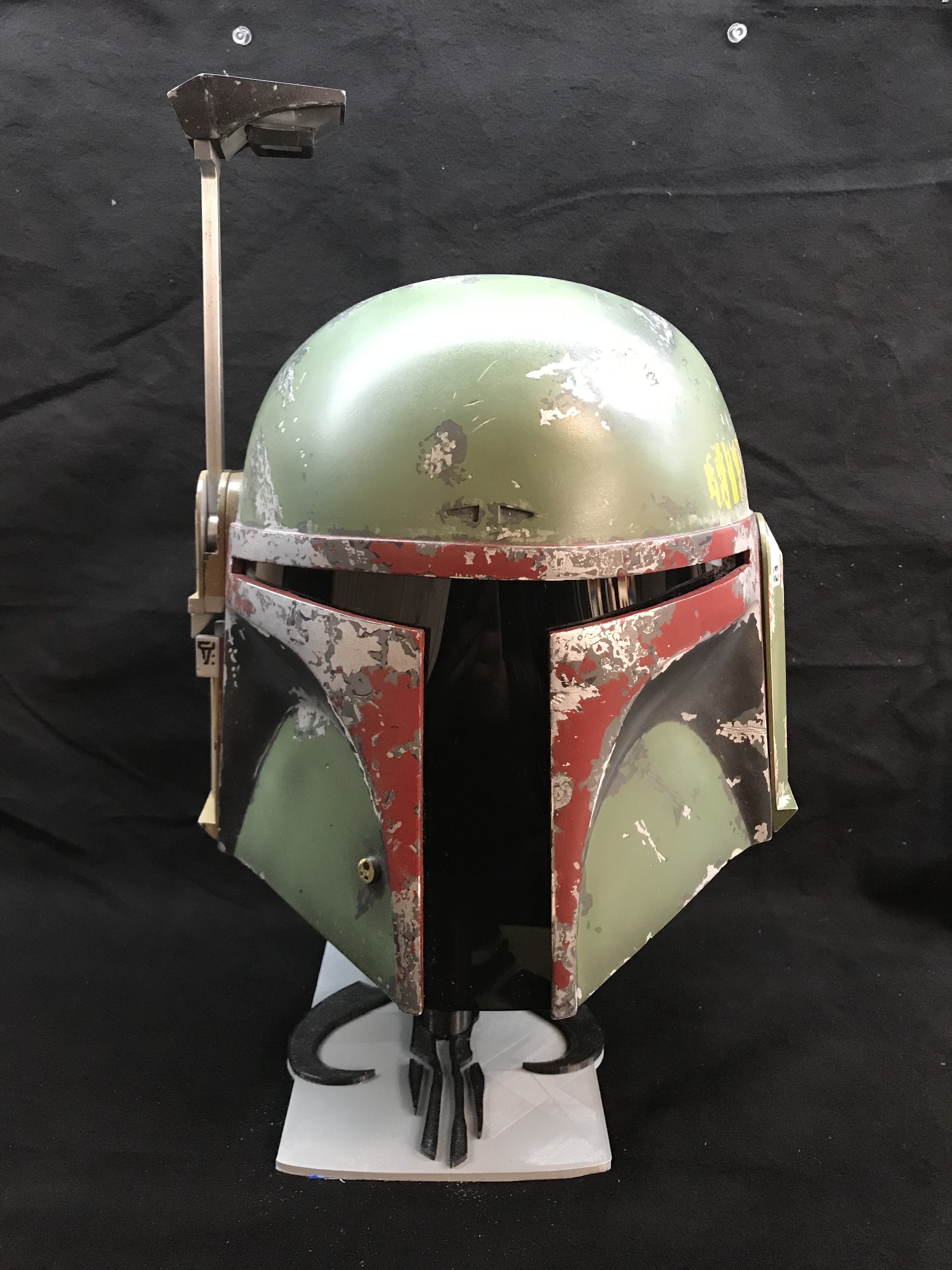

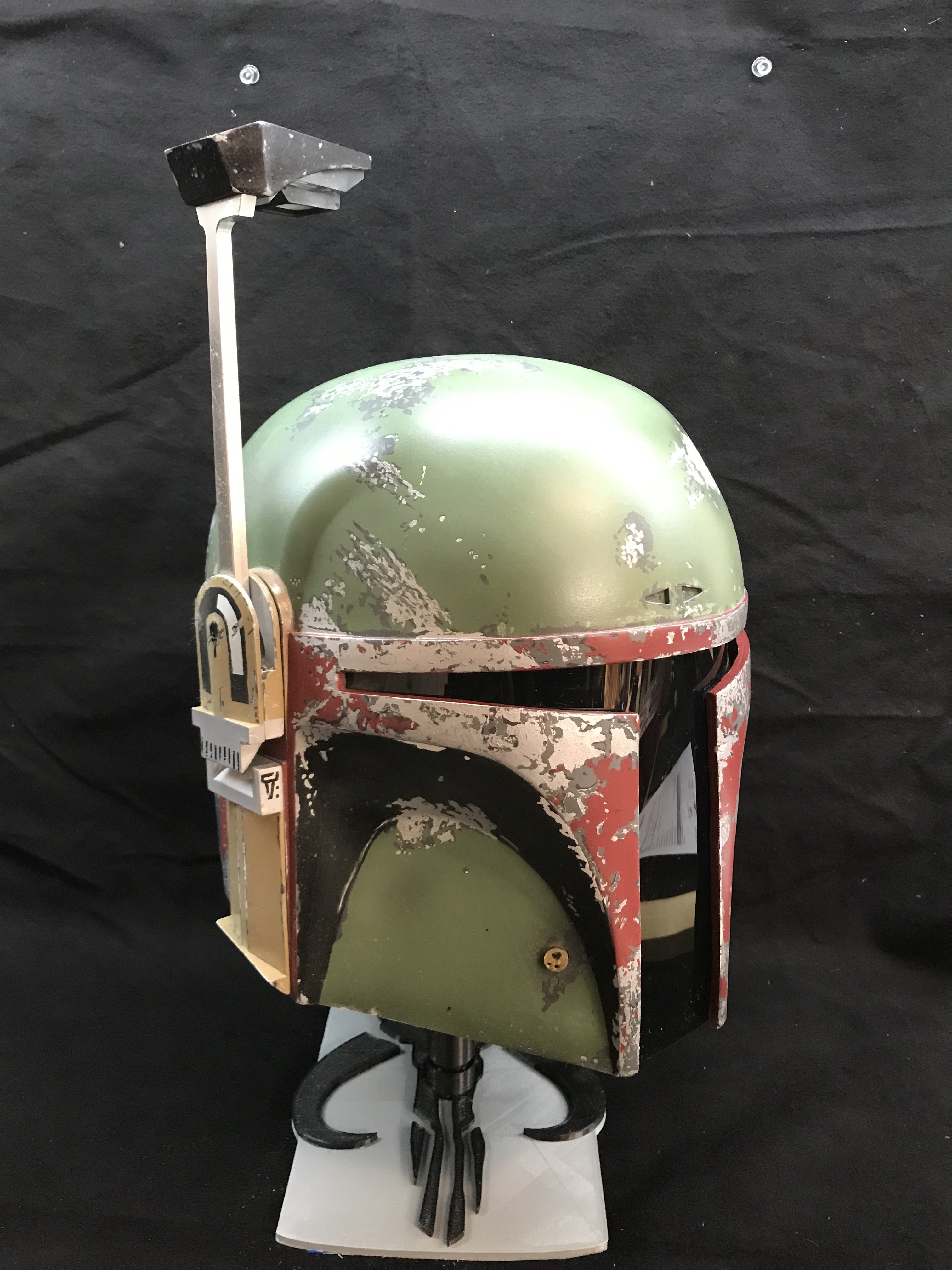

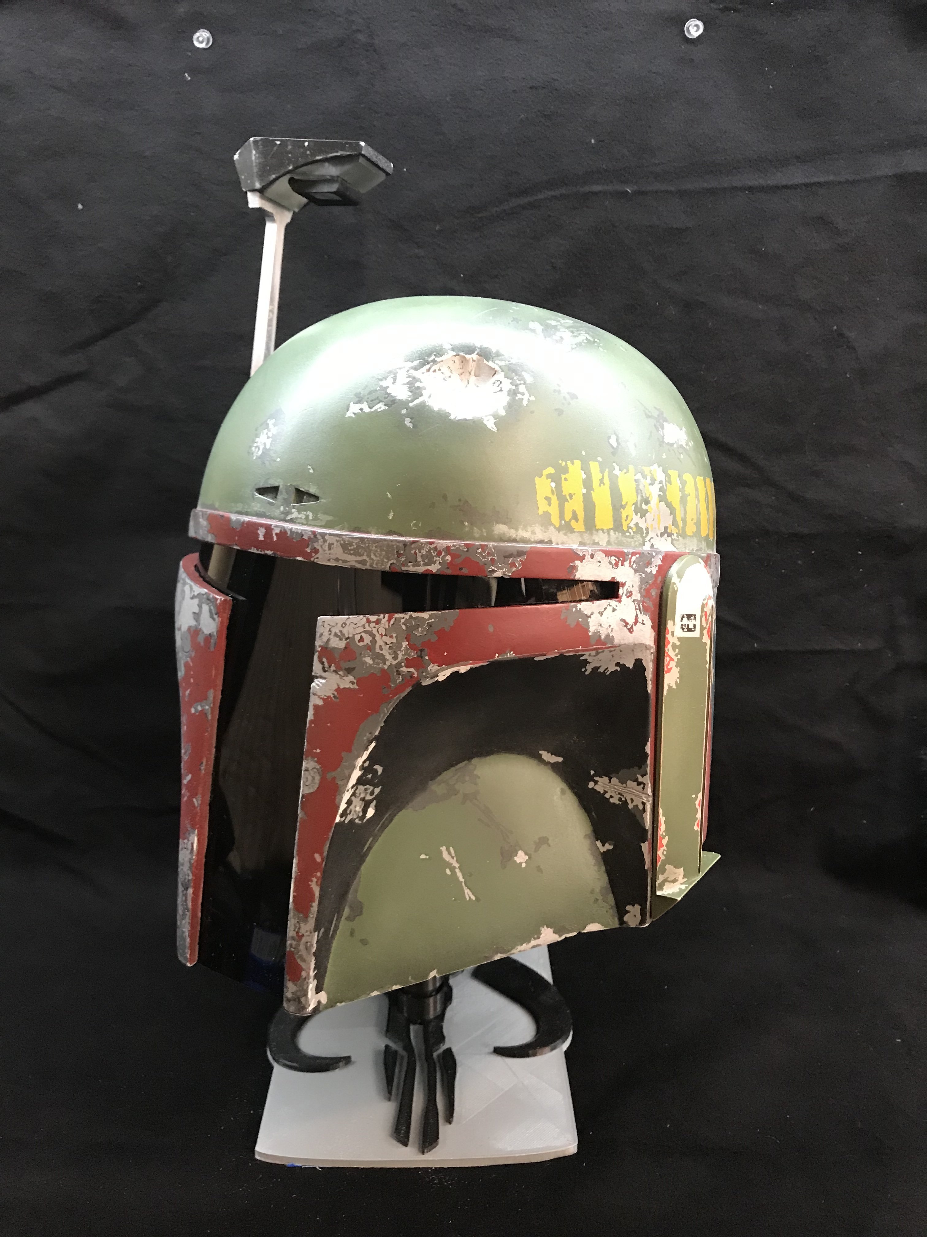

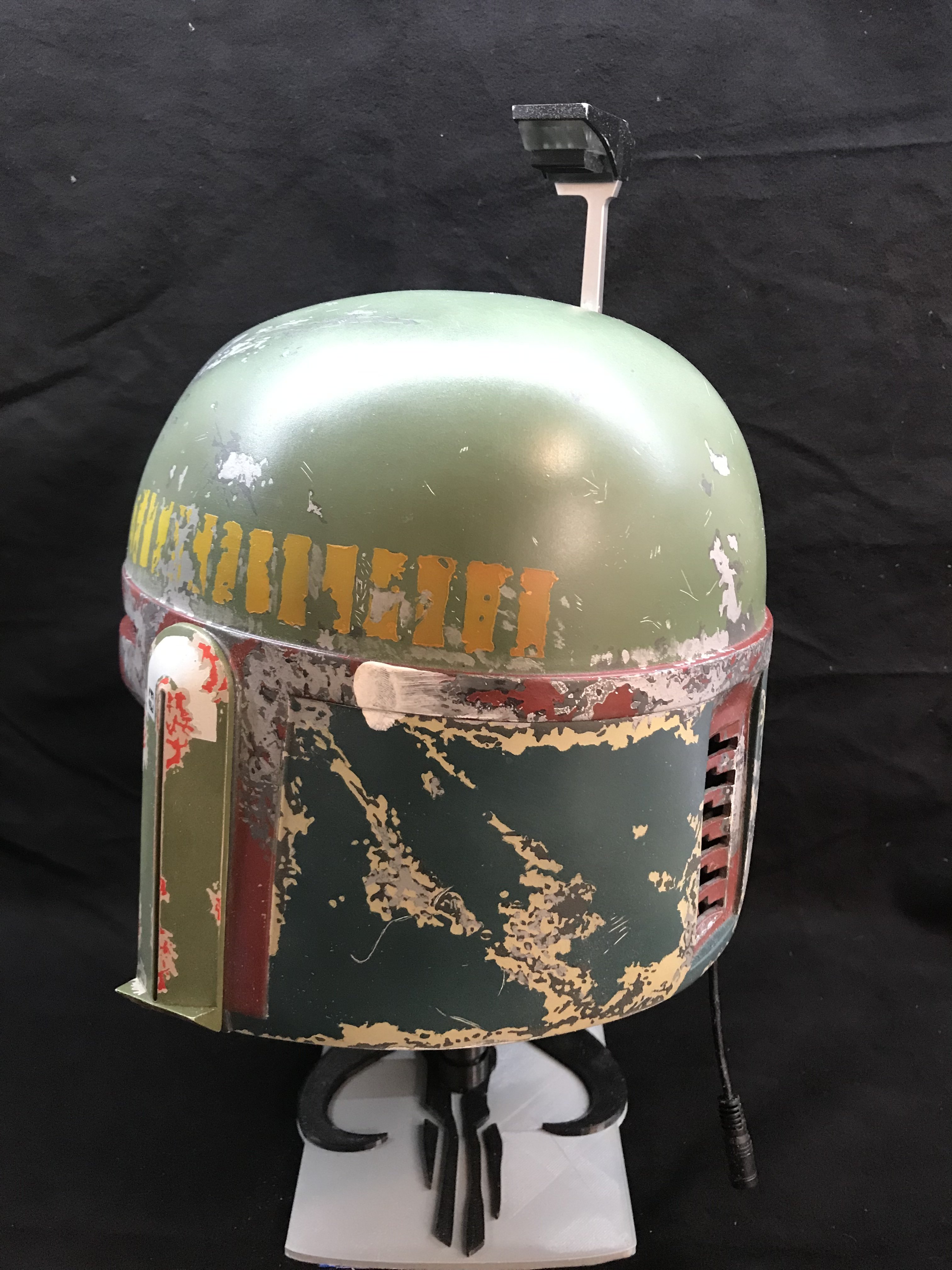

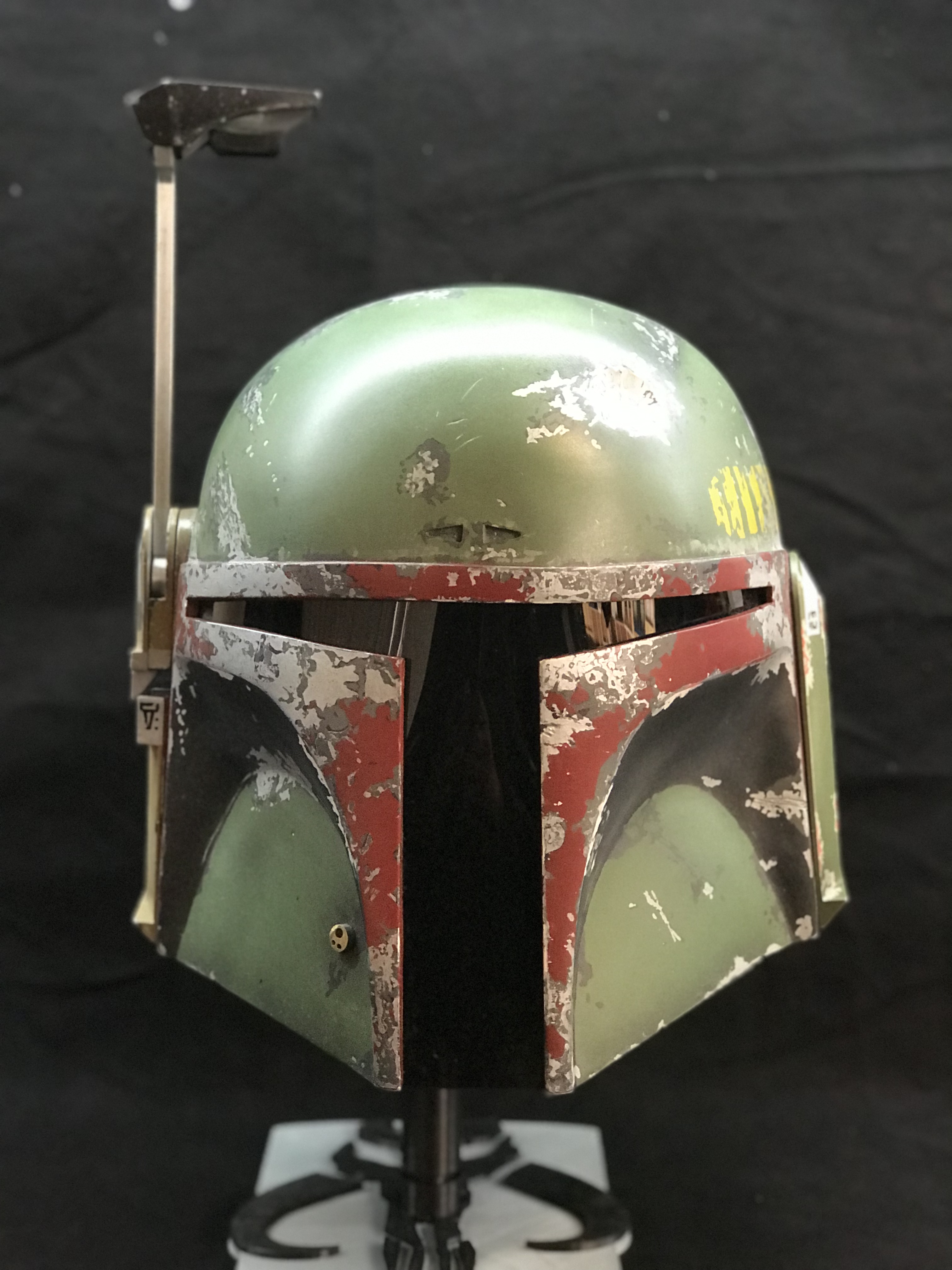

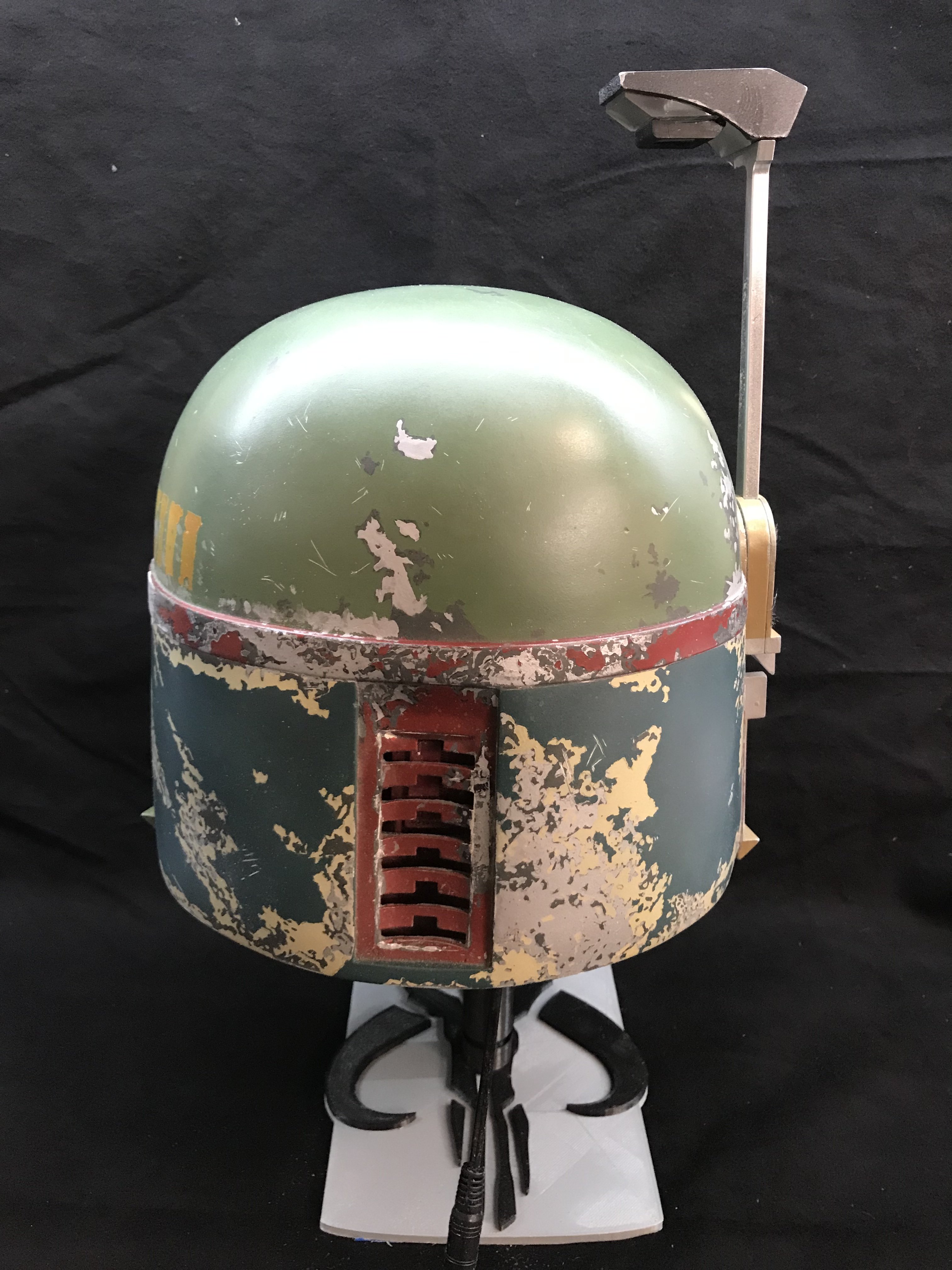

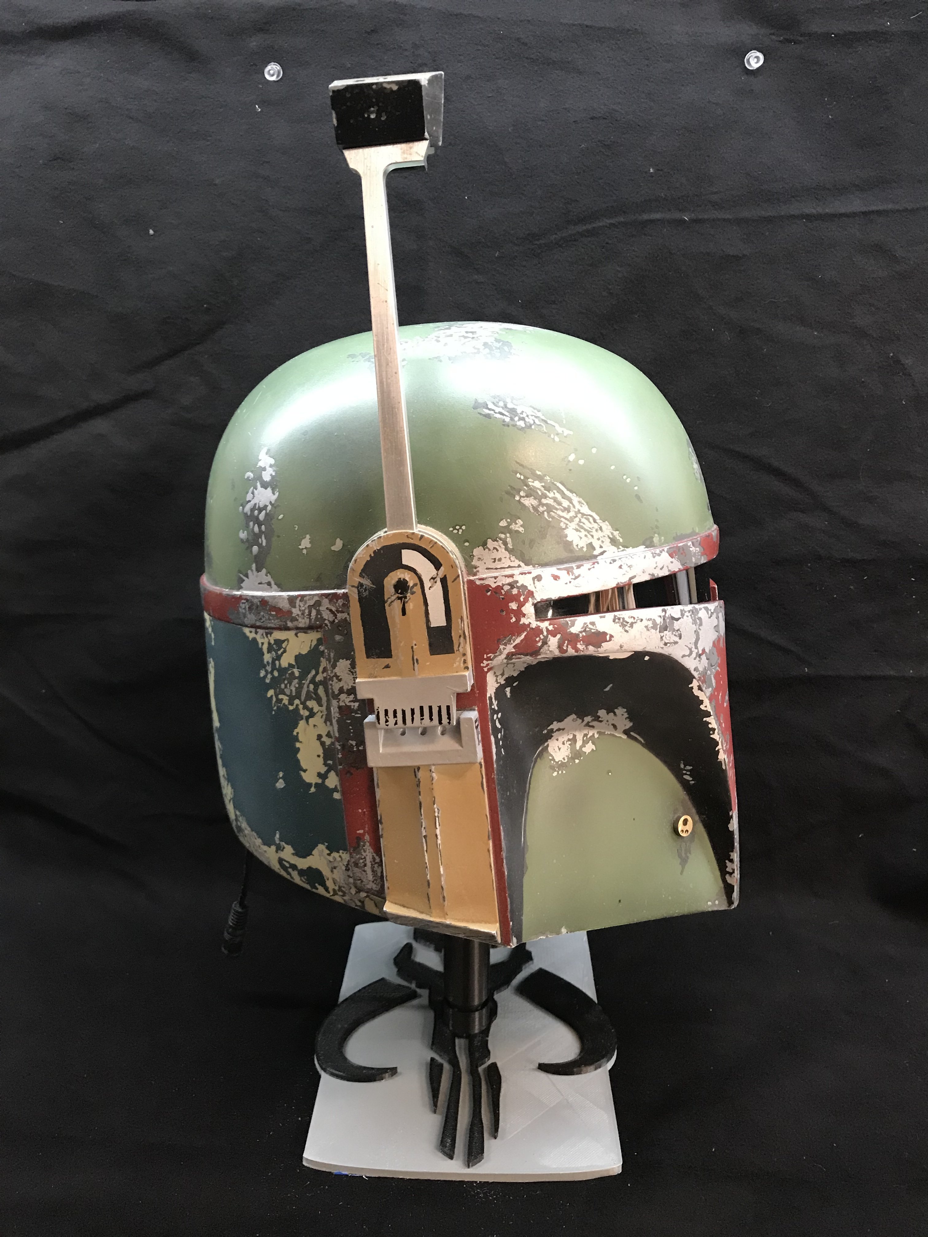

A2015EB9-2A79-4EA1-800E-8B1105036ADE.jpeg 5826F985-0A0A-4BC7-9654-CD78F8A1EBBC.jpeg 5109EF93-E8A8-4F01-93EE-1F33DA14ABEF.jpeg 525BF48F-6FF2-4024-B4AF-65474C822332.jpeg 902329A1-8FA5-4869-AC6B-A70CCBB07830.jpeg D5531712-4A12-4EFC-ADC3-F1E18A558105.jpeg C32C16B0-F6A2-4651-9797-07C4EEC85851.jpeg 1857EA93-4839-48F2-8C96-551C7611F9C4.jpeg 7A1F4659-DBE2-4C23-8971-771DD87E43AC.jpeg So I believe I have finally finished the work on my helmet. I’ve waited a while with getting final weathering and details worked out as well as adding the electronics for the rangefinder lights,motors, fans and padding. I was not going for 100% movie accurate overall but movie look with trooping practicality. I think fir my first build and paint up I did a good job and look forward to doing others in the future. Now it’s time to concentrate on the rest of the costume!
