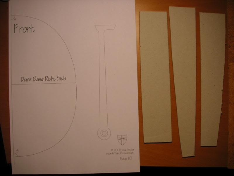

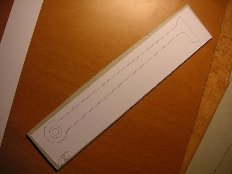

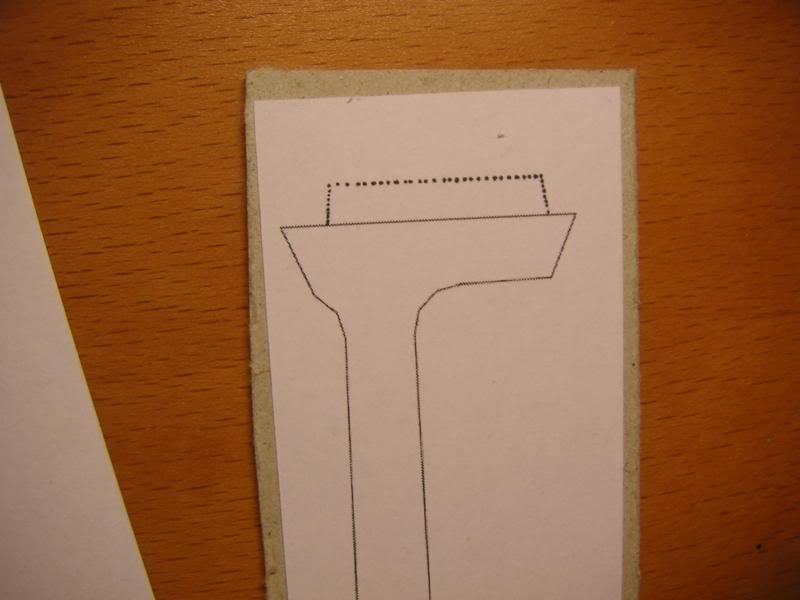

I start off with transferring the template on page 10 of the WOF templates:
Placing it on a adequate sized piece of cardboard:

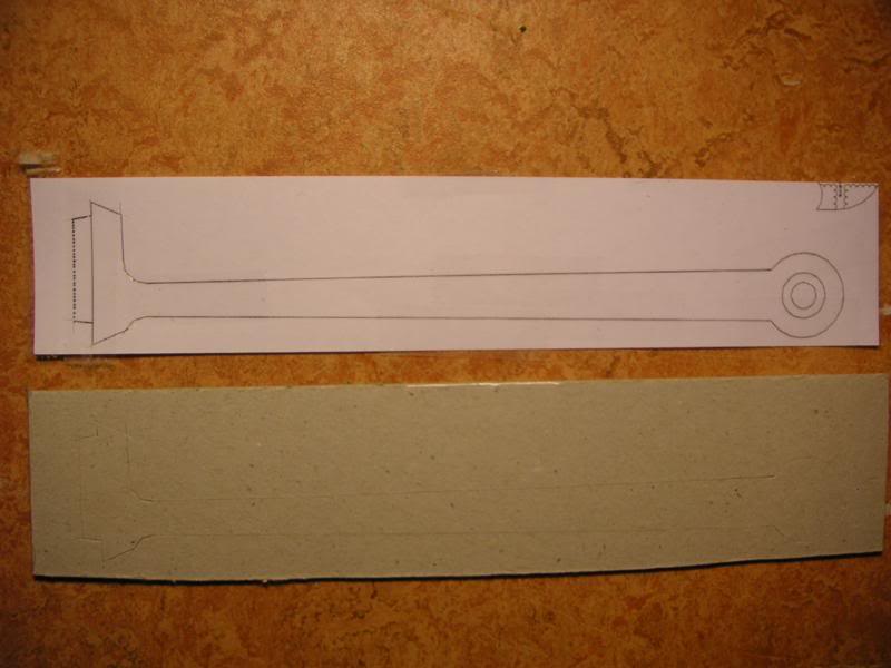

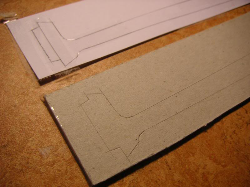

I decided to add an extended piece to the top of the stalk for easier and sturdier connection to the topper later on.
Here you can see the transfer in the cardboard. I did it by just cutting the template into the carboard lightly:
More detail:
Cutting the outline:
Detail shot. The way to get a smooth curve is by cutting several times through the board. Don't try to cut through it using to much force.

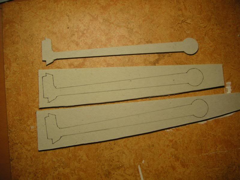

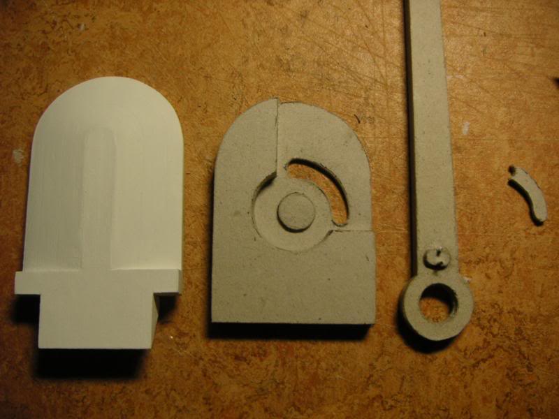

Drawing out the other two layers using the firstly created piece:

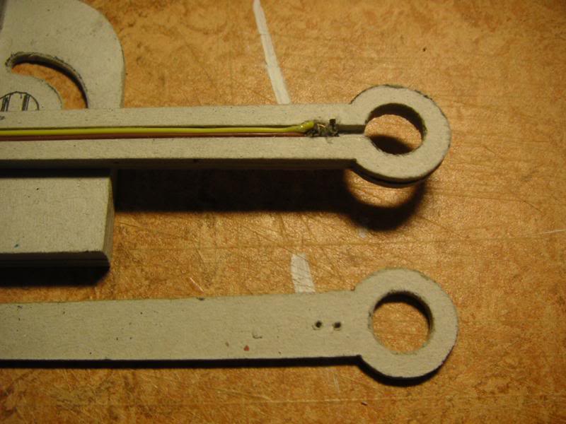

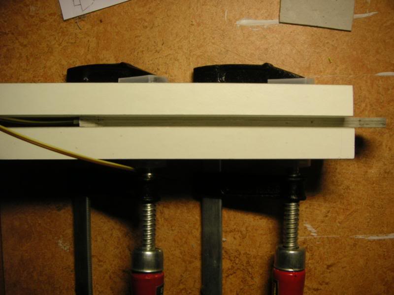

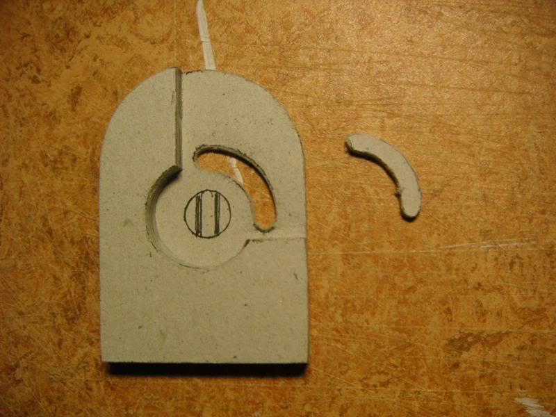

And presto. The center piece is already prepped for wiring as you can see here. A small gutter has been cut out.
In this pic I glued the center piece and the bottom piece together:
And I cut out the hinge hole on the top part:
And the other parts as well:

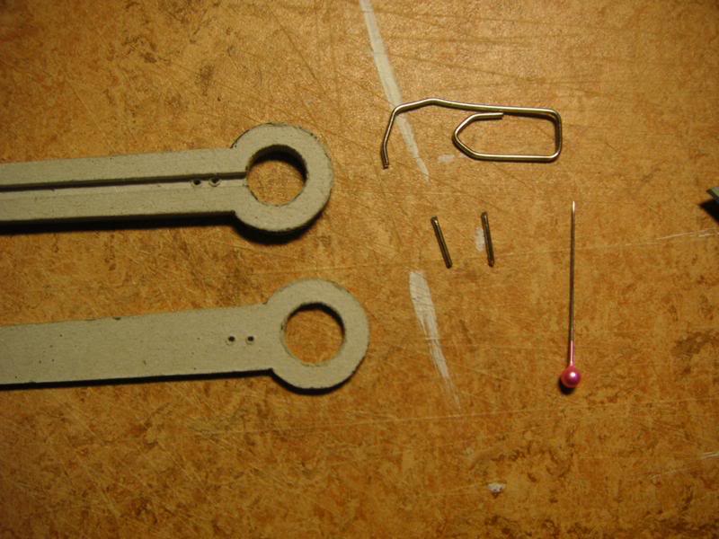

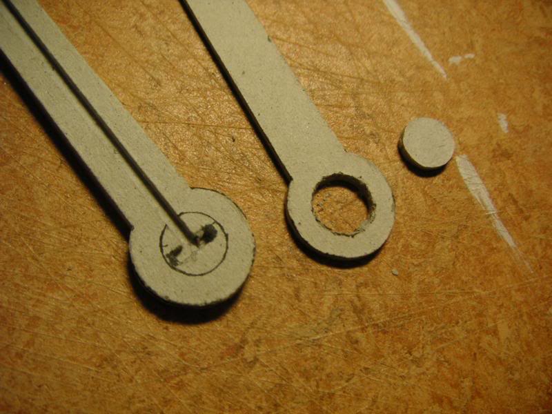

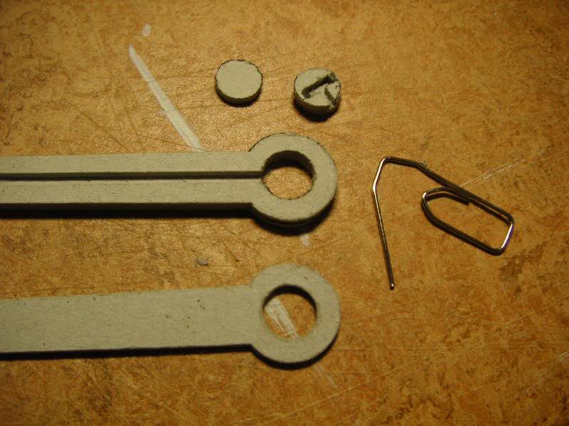

I also prepped the ear piece to which the stalk will be hinged:

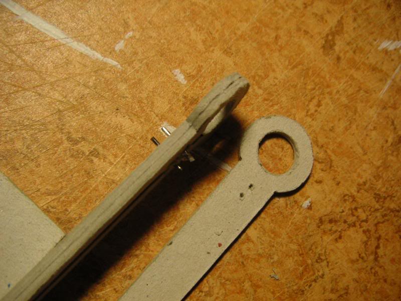

And here comes the tricky part. I cut two small pieces from a paper clip which will function as connectors. With a needle, I punched two small holes in both stalk parts in which the paperclip sticks will fit.
I soldered the two electricity wires to each of the paperclip sticks. The sticks are pushed through the holes as such:
This picture shows what I was aiming for (and trying to explain, but pictures say more than words:lol:):
The merely glueing the top layer to the rest and pressing it firmly....
....gave this result:

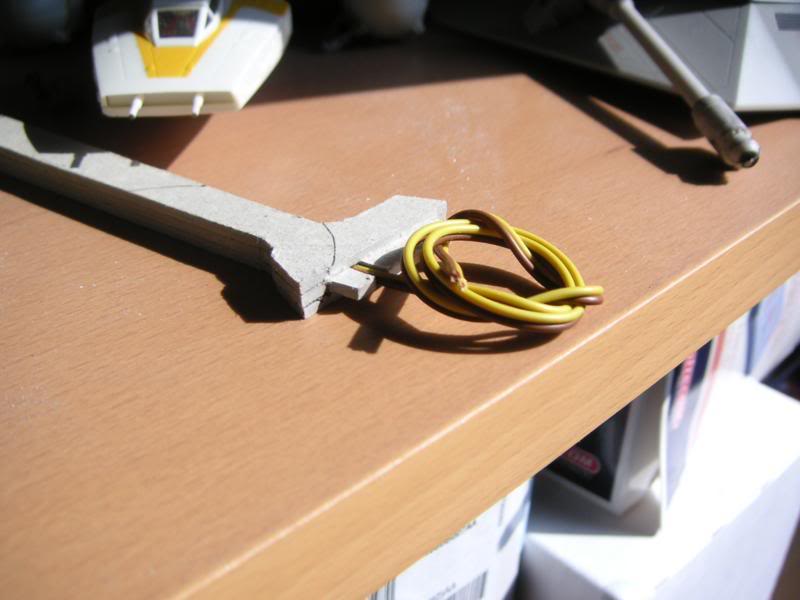

Better visibility in sunlight:

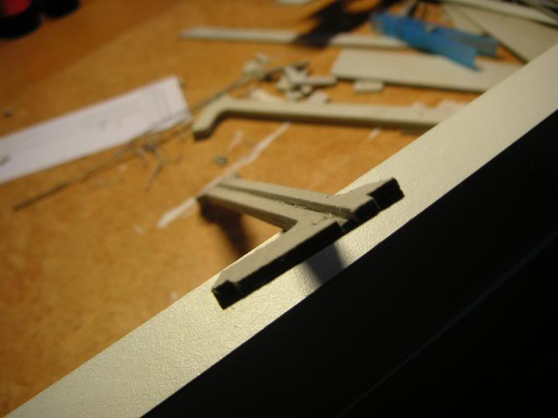

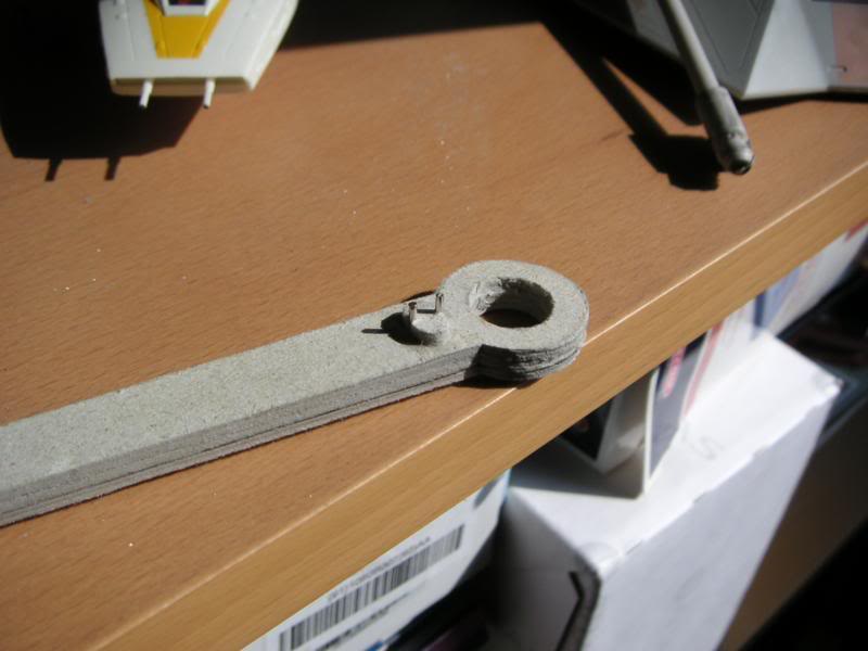

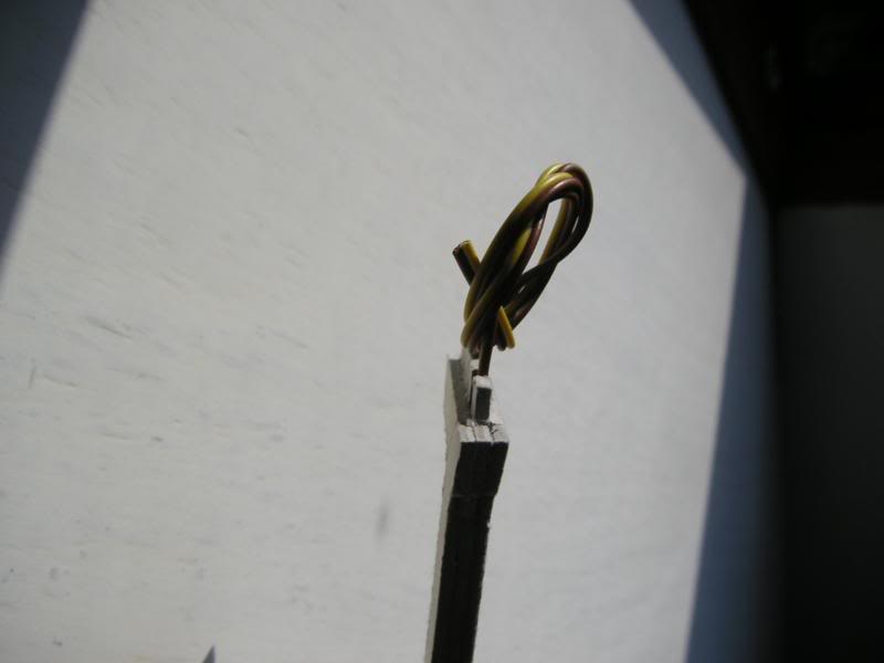

Notice only the center layer carries the extended support piece (it will all be clear once I connect it to the topper):
Side shot:
And also notice the supportive "dot"of cardboard glued in between the two extruding paperclip sticks:

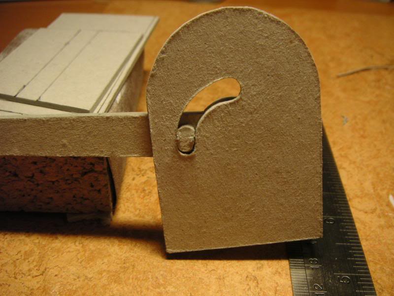

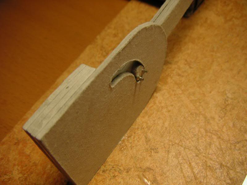

Just to emphasize:

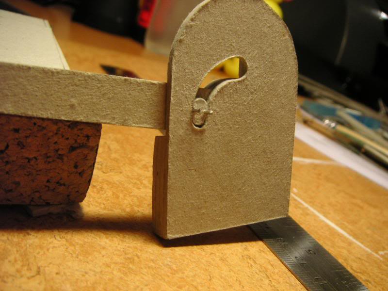

When the stalk will be in place (right ear) the two sticks will serve as power on/off switch.
Inside the bucket I will construct points of contact which will be conducting the current when the stalk is lowered:
Perhaps this all will be a lot more clear once final construction has been done.:confused
