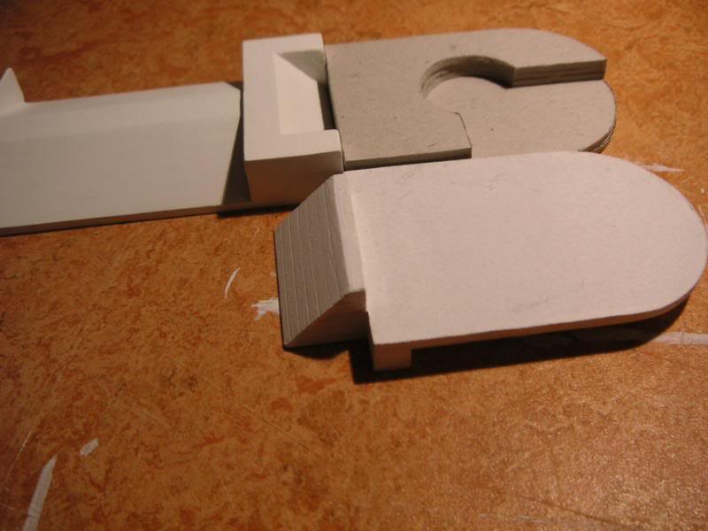

Yeah, I sort of left out the MTE for the ear cap, since it is easier to handle when sanding this piece. The angle is cut at the last stage of the process.
Well, look for yourself in this short update:

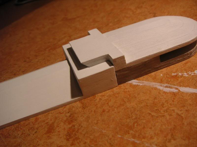

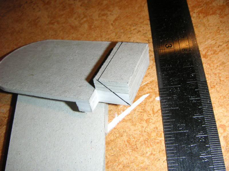

After sanding the surface to a smooth (enough) finish, I cut three layers of board to size and glued them to each other like this:
These layers form the angled bottom part of the cap, so I glue them to the cap like this:

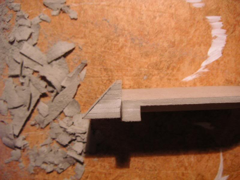

Then I draw out the angle where the material needs to be cut and start cutting with a sharp knife.
It doesn't take too long before sanding can commence and results in this:

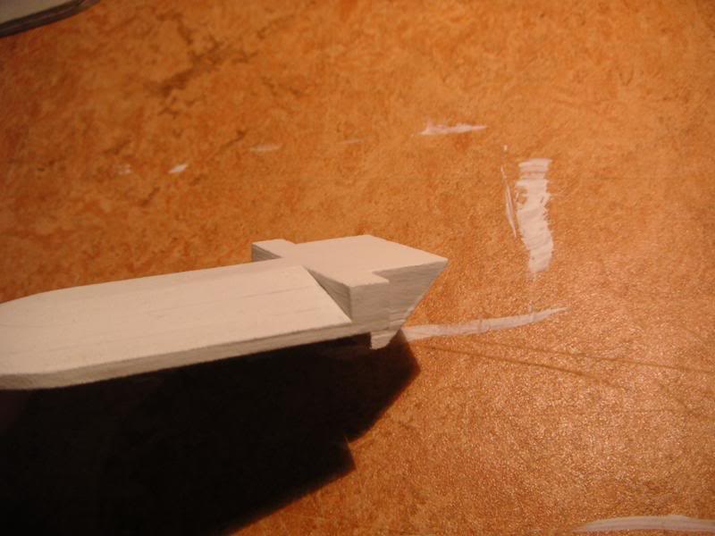

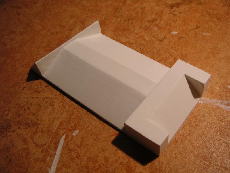

I put on a first thin layer of sealing agent and make a test fit on the lower ear piece. Perfect match!
I never expected to get such sharp edges with cardboard:

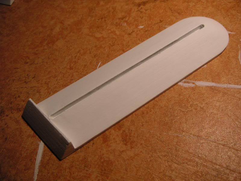

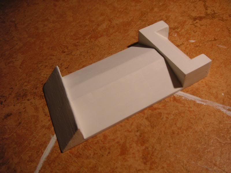

The lower ear piece after sealing:
And the left ear piece:

Concerning the sealing, I diluted the Gesso with about 20% tap water in order to get a smooth finish. Undiluted Gesso causes a grainy finish, which you probably don't want.
Putting on about 4 to 5 thin layers with fine sanding (Grade 400) in between each layer will suffice.
Where needed I also used light weight filler to smoothen/straighten the surface; before sealing that is.

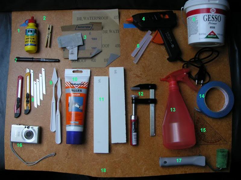

1. Quick drying white glue (glue for wood type of materials)
2. A couple of clothes pins
3. Sanding paper, rough to fine grade (180 to about 400 grade)
4. Hot glue gun, as an alternative for 1
5. Hot glue sticks
6. Gesso primer for sealing/primering the finished bucket; US: Minwax Polycrylic Sealer
7. A fine tip ink pen, for drawing templates onto the cardboard
8. A hobby knife with plenty of re-fills
9. Sculpting knifes, for applying filler
10. Filler! This particular type is for filling holes in walls; US: Bondo Car Body Filler
11. Two pieces of flat-surface wooden planks, for flattening the ear areas (see described in post #9 above)
12. An old-fashioned glue clamp, preferably a couple of these
13. A misting bottle, for spraying the cardboard moist
14. Blue painter's masking tape; the tape is blue, not the painter
15. A ruler of some sort
16. A good camera as your best witness, share the progress!
17. An acrylics paintroller
18. A big piece of linoleum to protect your wife's (or mother's) kitchen table from cutting pieces of cardboard ;)

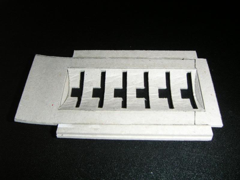

Well, here it is. A very small update for the building of this cardboard helmet. It's not much but at least gives you something to fiddle with as it involves quite some intricate detail and skill (mostly patience and a sharp knife actually).

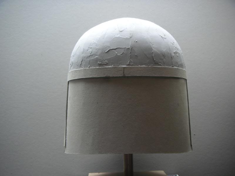

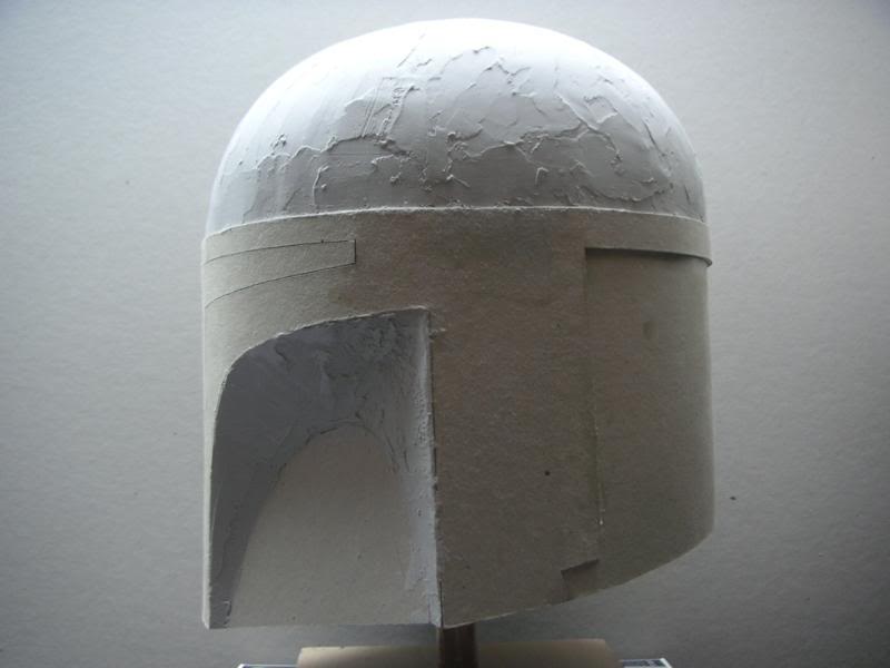

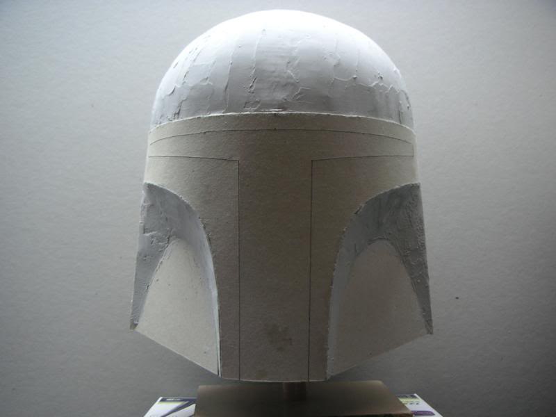

First I started applying filler to the cheeks and helmet dome. Keeping the filler sculpting knife moist helps smoothing the filler surface a lot:
I tried to get the filler as smooth onto the dome and cheeks as possible, so the sanding part will be a lot easier.
But before sanding, this should be left to dry completely for at least 24 hours. So that gave me some time to focus on preparing the keyhole area.

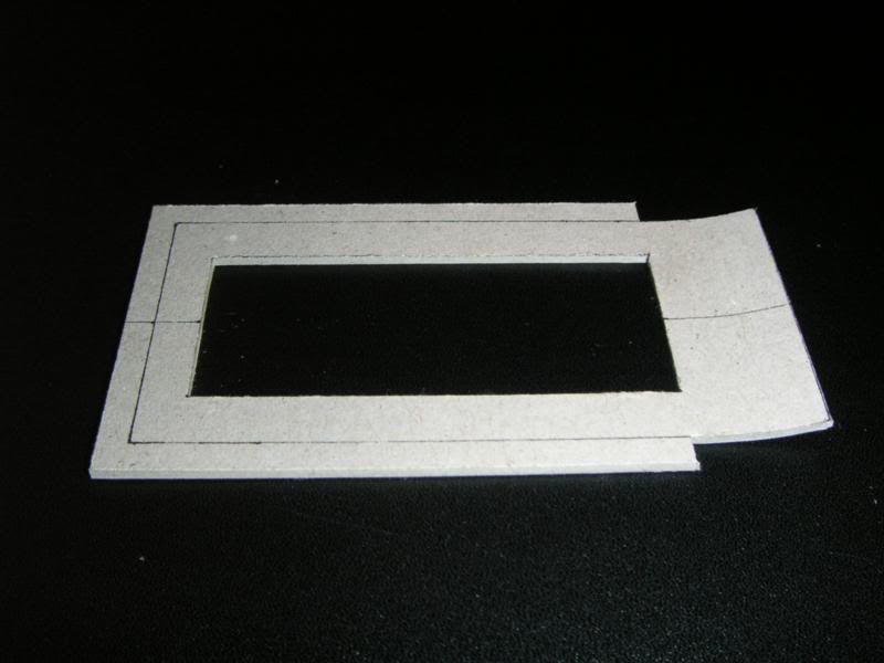

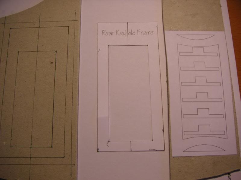

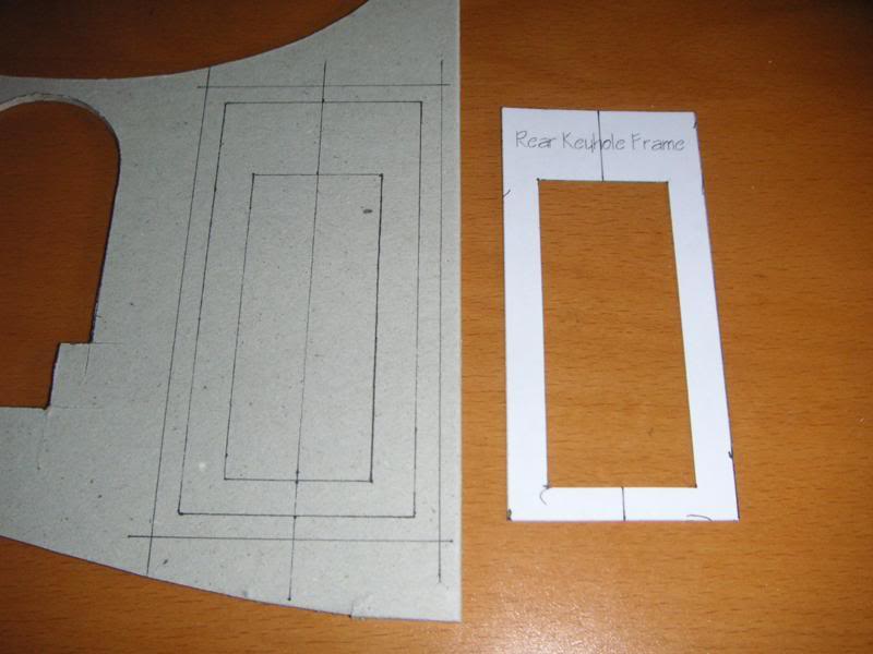

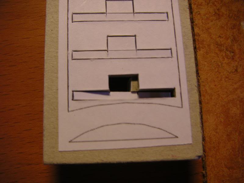

I drew out the pattern from the keyhole frame template onto some cardboard and left some extra trim around the edges (for support when glueing inside the bucket).
Also, I glued the keyhole template itself to a piece of cardboard:

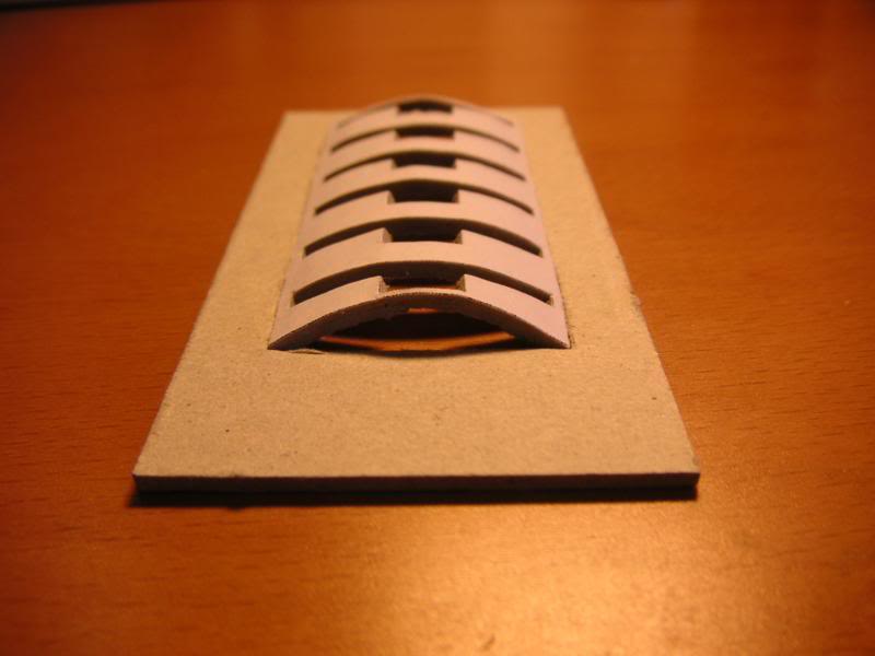

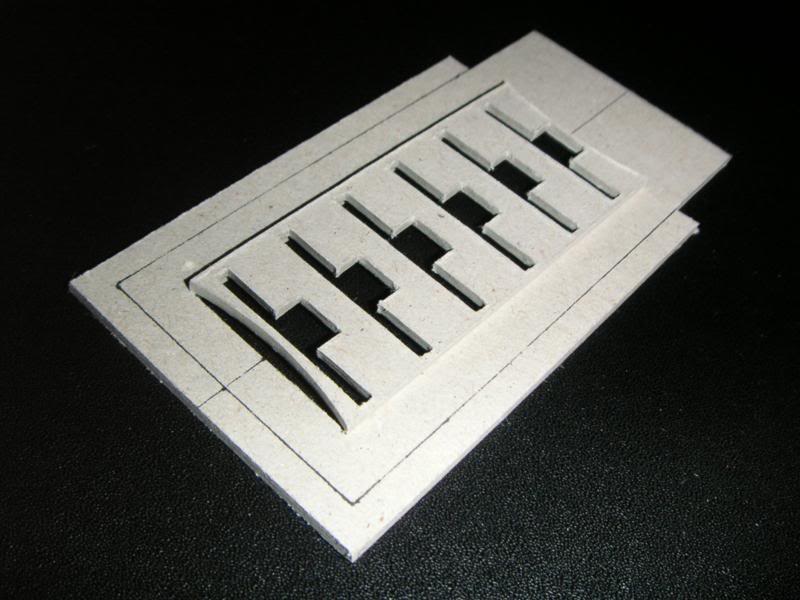

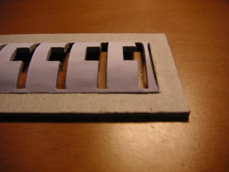

Then it was simply cutting the cardboard layer by layer. I did this very carefully because the resulting keyhole piece is very delicate:

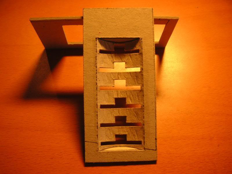

Some finer detail:
One keyhole fully cut:

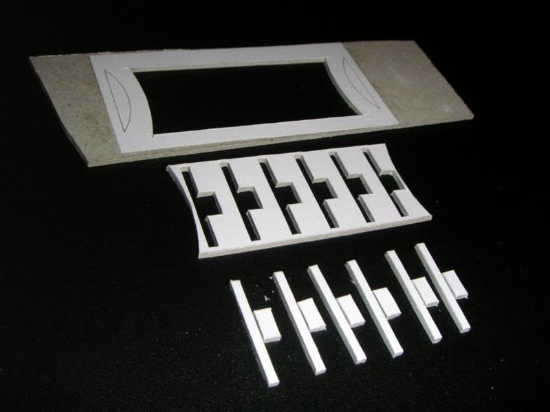

And presto, the entire vent:

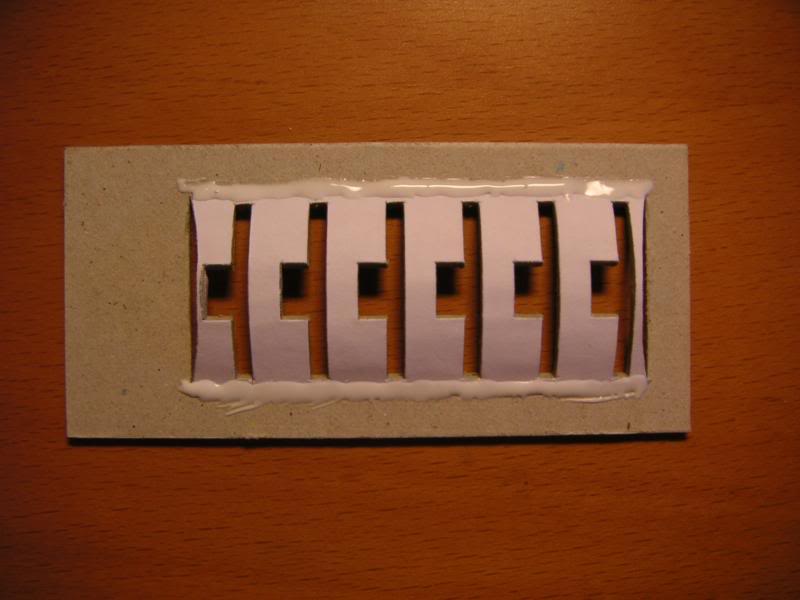

It doesn't fit into the frame yet as you can see. That's because it needs to be bent into a curved shape.
So after a light spray with tap water, the bending resulted in this shape:
It is worth stressing that you should not moisten the cardboard too much as this will result in the cardboard losing its composure. Especially the very thin edges will break easily if you use too much spray water.
I kept the paper side (still glued to the cardboard) on the inside of the keyhole:
Then I just applied some white glue to the inside at these places:
In this picture you can see that the top of the keyhole frame also has a slight curve outward:

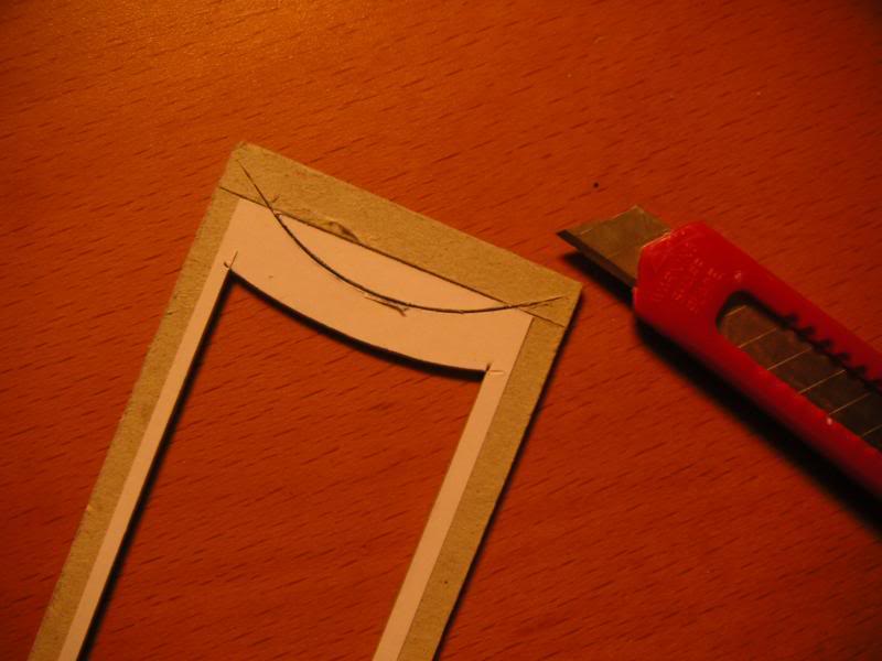

The last two bits are also cut from the glued-on template:
Also glued in place this is the result (notice that for this one I forgot the extra trim):
But some spare cardboard glued to the long edges also does the trick:
The edges of the keyhole connecting to the frame still need to be filled up to get a seamless piece.
