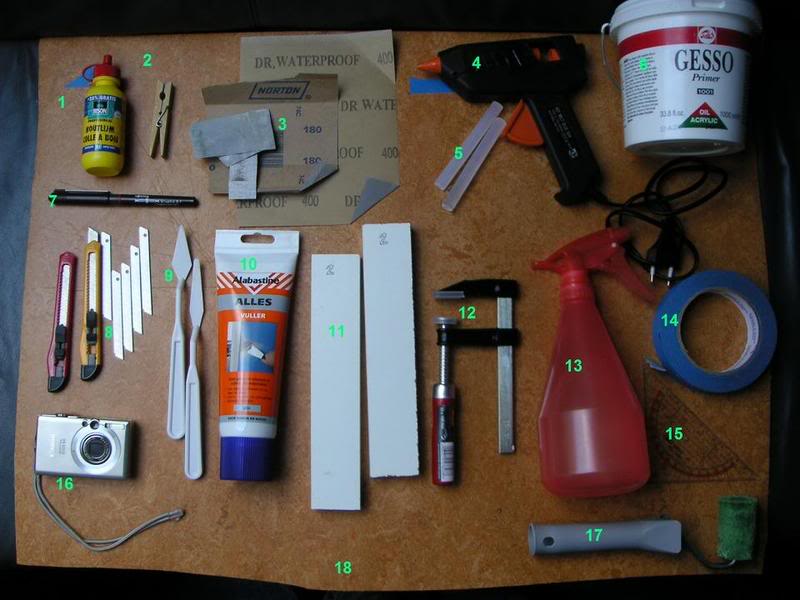

Work is in progress, but before I continue with that, I thought it would be interesting to provide a list of materials and tools I use in the process. So here it is:
1. Quick drying white glue (glue for wood type of materials)
2. A couple of clothes pins
3. Sanding paper, rough to fine grade (180 to about 400 grade)
4. Hot glue gun, as an alternative for 1
5
. Hot glue sticks
6. Gesso primer for sealing/primering the finished bucket; US: Minwax Polycrylic Sealer
7. A fine tip ink pen, for drawing templates onto the cardboard
8. A hobby knife with plenty of re-fills
9. Sculpting knifes, for applying filler
10. Filler! This particular type is for filling holes in walls; US: Bondo Car Body Filler
11. Two pieces of flat-surface wooden planks, for flattening the ear areas (see described in post #9 above)
12. An old-fashioned glue clamp, preferably a couple of these
13. A misting bottle, for spraying the cardboard moist
14. Blue painter's masking tape; the tape is blue, not the painter
15. A ruler of some sort
16. A good camera as your best witness, share the progress!
17. An acrylics paintroller
18. A big piece of linoleum to protect your wife's (or mother's) kitchen table from cutting pieces of cardboard ;)
19. A big sheet (70 x 100 cm) of 2 mm thick grey cardboard, paperboard or whatever it's called; I bought this in a store where they use this to seal off the back side of a framed painting or photograph; don't use corrugated cardboard though!; US: Single Layered Mat Board
20. Wizardofflight templates! Available for US Legal and Euro A4 paper
21. An example lid, to set yourself a goal of how you want it to look like
These are the most important materials and tools I use and came up with 'till now.
So go ahead and fabricate that lid! Show your progress with as many pics as you can! But most important of all: HAVE FUN doing it!
