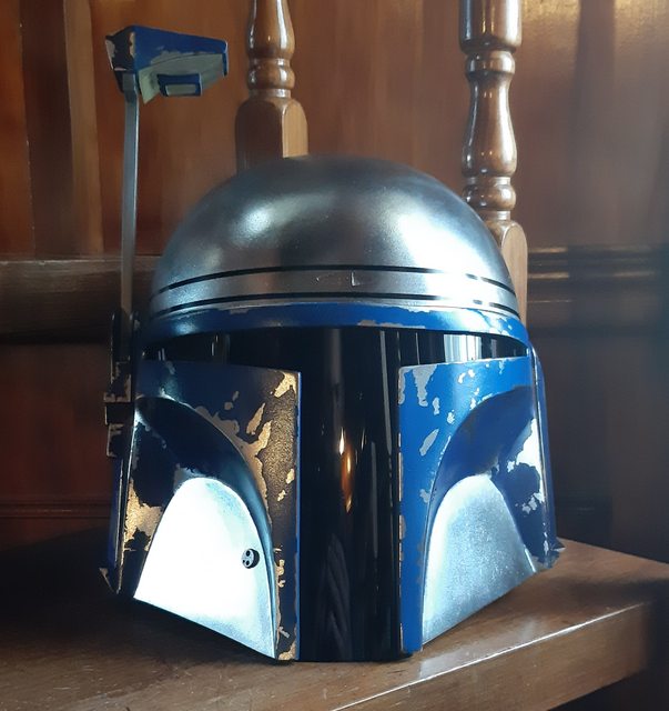

I just picked up this gorgeous Fett Pride helmet (thanks again @Darth_Nickel ) and as I already have a few standard BF helmets, I thought of making a fully distressed 1313 helmet.
First thing to do is fill in the dent:

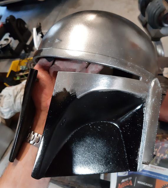

For the beskar look, I'm using the chrome nail polish powder method (see more on this method here: Mando Armorer Helmet refinished using Nail Polish Powder!)
I used a black gloss spray paint for the underlayer, then added the chrome powder, starting on the top dome:

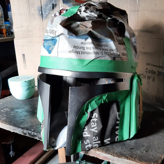

The top edge made for a natural transition for painting, so I masked off the top with newspaper, spray painted and added the next layer of chrome powder:
All finished and ready for painting:
Stay tuned...

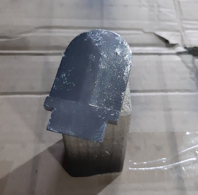

Starting the painting... practicing on the ear piece.
Here it is after the chrome powder:

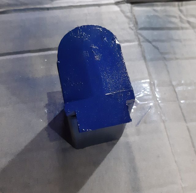

Next, I dabbed on some petroleum jelly on the spots I wanted to keep silver:
Spray painted some dark royal blue:
After the paint had completely dried, I wiped off the petroleum jelly with a soft cloth and voila!

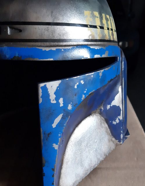

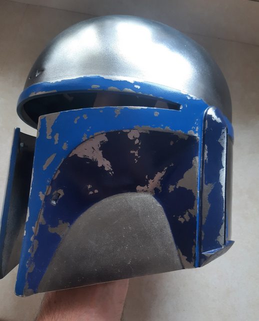

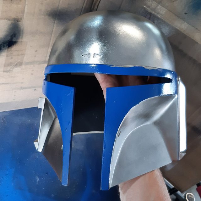

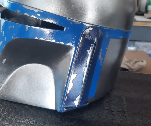

Starting the fun stuff... masking off for the light blue parts:
Adding the petroleum jelly (I did most with my fingers, but used a Q-tip to add some thinner "scratch" effects):
Lots of spraying:
Removed the masking:
Rubbed off the jelly, first with a cloth, then a toothbrush... and finally with my fingernail for extra scratchiness as the blue paint did a pretty good job of covering the jelly in some spots:
Close-up of the realistic chipped paint effect (SO much better than painting silver on top of a color):
Soon... the dark blue parts! :)

Some more work... first on to the ears. Masked off and jellied:
Sprayed with a darker blue and jelly removed:
Masking the mandibles:
Jellied and spray painted:
Masking removed. This is when I generally use a heat gun to speed up the drying of the paint. It's a little tricky as too much heat can actually cause the jelly to liquify and start running (which isn't terrible, but it can sometimes cause the paint to run) or worse... the paint can harden over the jelly and actually become difficult to remove.
Coming along!

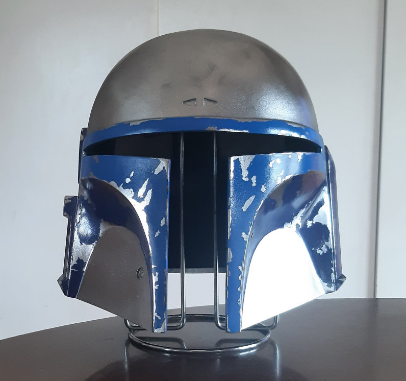

Indy Magnoli
Added some automotive pinstriping and put all the parts back onto the helmet:
Next step is the grungy distressing! :)
I'm also debating adding a few kill stripes, but not sure how that would look on top of the pinstriping.

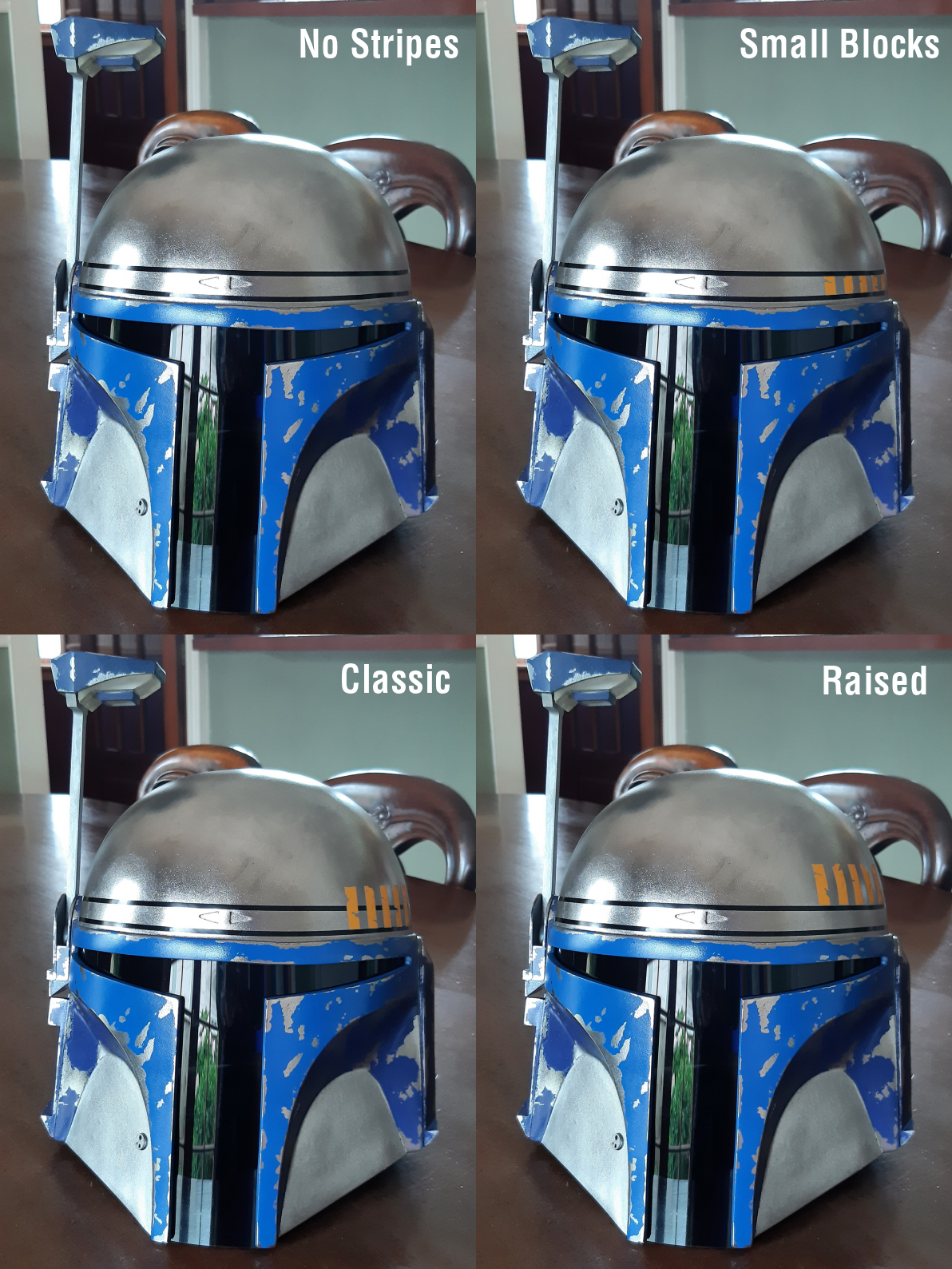

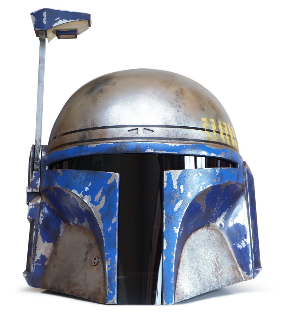

Ok... looking for some feedback/ideas about adding the kill stripes. Should I try painting them over the pinstripes? Or should I place them higher on the helmet above the pinstripes? Should I just not add the kill stripes? The 1313 artwork does not have them, but I thought this might tie in better
Indy Magnoli
Here are a few ideas:
They all look better than I thought they would... and they'll tie in even better once I add the grungy distressing. So.. what do you guys think?
BudaFett
Hi I’m Bobert!
TDH PREMIUM MEMBER
I go with classic with the weathering breaking up the killstripes with normal damage and help from the black stripes if that makes sense.
Indy Magnoli
After a bit of deliberation... I've decided to go with classic stripe placement!

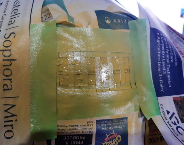

I decided on six kill stripes. Here it is masked up:
I used petroleum jelly again for the paint chipping effect, making sure to get on the edges of the piping... then spray paint on top:
The final result:

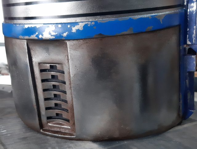

I started the distressing process by applying dark brown (raw umber) acrylic with a brush to all the recessed edges:
I also started building up layers of acrylic black along the bottom edges of the "metal" with a sponge as well as on some of the blue parts. I kept working shades of brown and black along the dome with sponge and brush, then wiping with a soft cloth to get different effects. Lastly, I added some lighter tan spots throughout the surface with a stiff brush, stippling for a more dirty look.
Here's the final beauty shot:
You can see the full resolution photo at imgur to see all the detail. This has quickly become one of my favorite helmets in my collection! Thanks to everyone for your input and encouragement.
