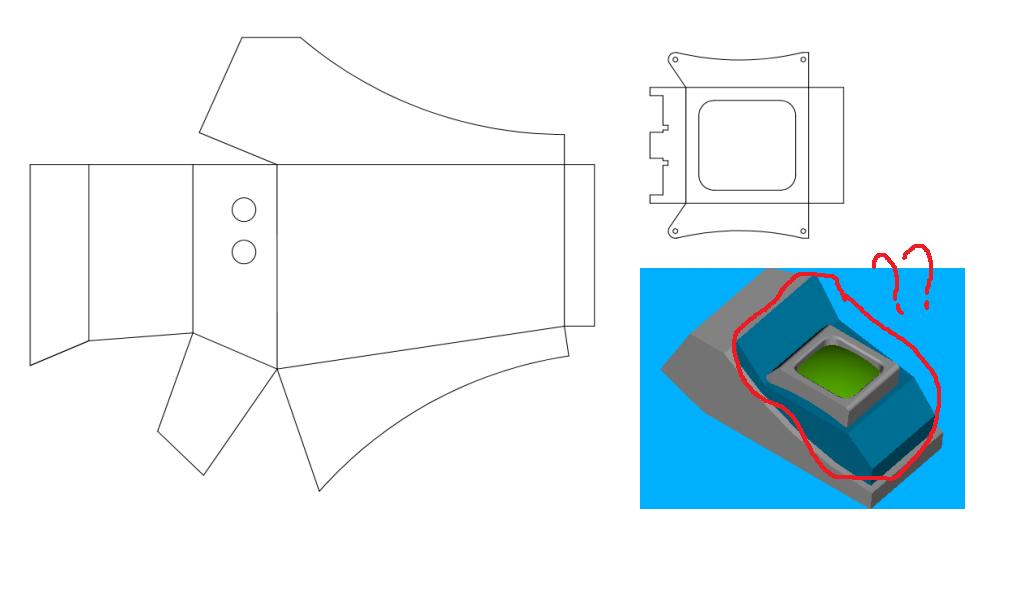

i am currently working on a scarthbuild :D my first! and i cannot find the blue part of the rangefinder? In the templates I can only find two pieces. Any help would be much appreciated. Thank you! :)
Someone correct me if I'm wrong, but I think the lens itself is molded of a solid material, like Lucite or another type of plastic.
Are you using Alan's 2006 Revision A Rangefinder templates? If so, it shows the dimensions for the lens....
Rob
I made this file over a year ago when I did my WOF helmet (since than I did my own helmet templates). This is based on Alan's (WOF) work and I think it's already on 1:1 scale.
Yep those are the templates. On one page it says rangefinder lens with a bunch of measurements but I dont really understand :(
Can anyone maybe explain?
I think you're supposed to either mold it yourself, or carve it out of plastic. If your adventurous, you could cut the individual pieces out of cardboard and assemble it yourself, or use RafalFett's 1-piece unit above.
Rob

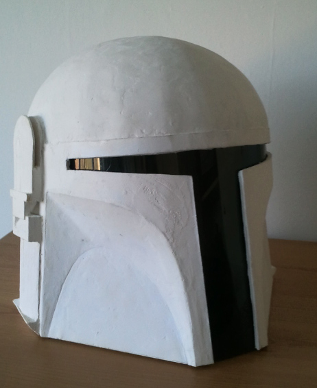

Been 3 years since i last done anything with my build. Finally got a visor for it. Still needs some filling and I need to make a rangefinder still along with maybe coating the whole thing to strengthen it a bit.
I suppose spray paints are the way to go when it comes to doing the paint job, i'll be doing a cutom job with this one.

I have been working on my build now for a god bit. It's taught me quite a bit about patience! I am working on my second cheek structure (molding and shaping) Anyway - I tried the drywall putty... i know! i know! I just used a very tiny bit to fill in my gaps. Its going to be fine. I will begin with bondo in a bit. i have reservations about it though. Cardboard and bondo... Bondo is so thick and sticky... I just hope its not too heavy and cumbersome for my little baby. PS This helmet fits me great.
Here is another one with the recent cutouts and you can see the bit of drywall spackle - i plan on sanding as much off as possible - I will get brave and use the bondo.
The cheeks are just sitting there getting the feel for their new home.:cheers
Its funny - the pictures don't do it justice... i will continue working and post more pics soon. Thanks for all the assistance WOF and Antman - you compliment each other nicely.:thumbsup:
