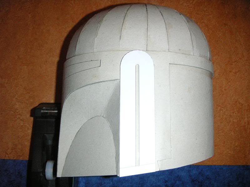

All glued parts should have now dried sufficiently. Let's do a little inspection of what we have already. Remember that I cut an angle to the cheekbones before glueing them in? This pic shows why:
It definitely paid off. You can also see the mask layer on top of the bucket. This makes quite a rigid composition.

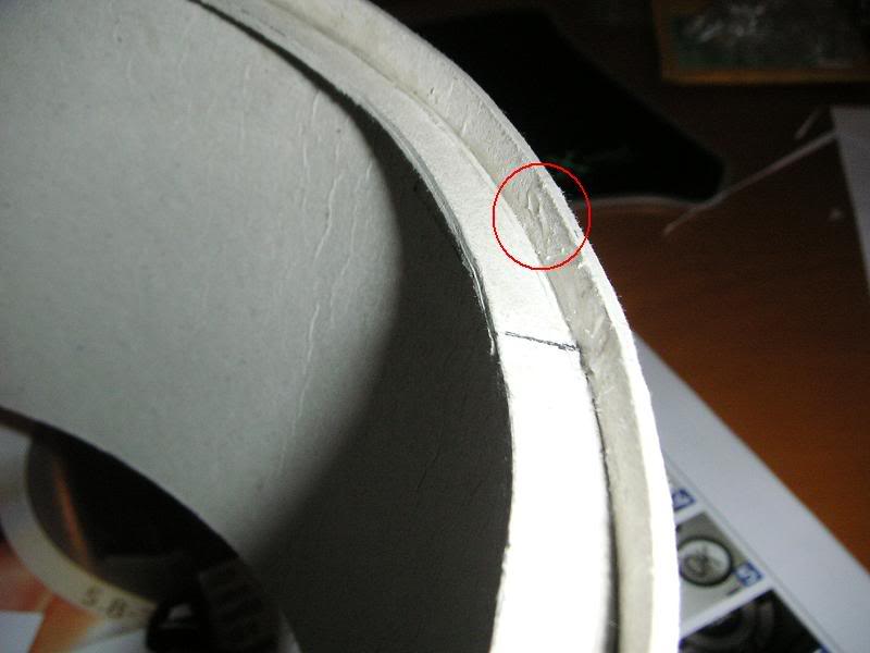

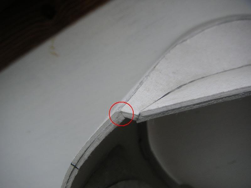

And as you also might remember (if not, just scroll up) I used the "Inner Surface" template for the bucket which is a bit smaller in height compared to the mask template. And that is apparent from this picture:
When glued on correctly, it creates sort of a rim or ledge (red circle). Now this is makes it easy for the base of the dome triangles to adhere to, as will be apparent later on.

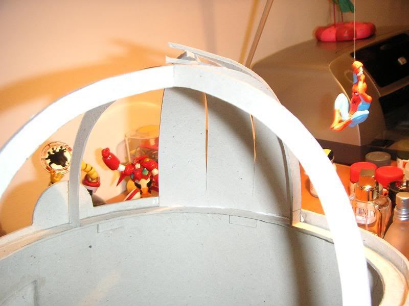

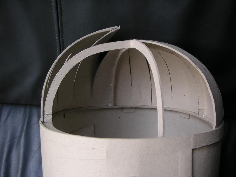

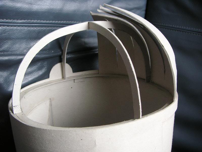

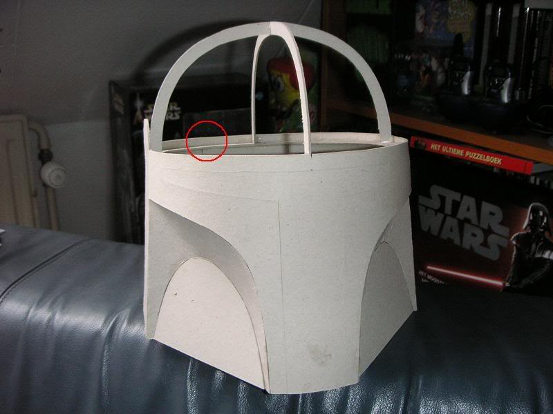

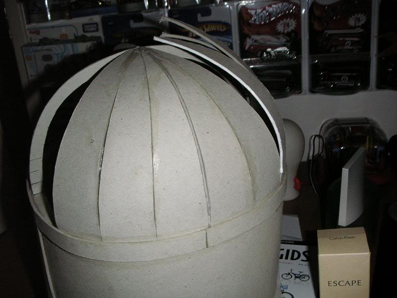

For practical reasons I took off the dome frame arches previously. Now it's time to glue them back on:
So now it is time to get busy on the dome triangles! They had plenty of time to dry up so let's use those babies.;)

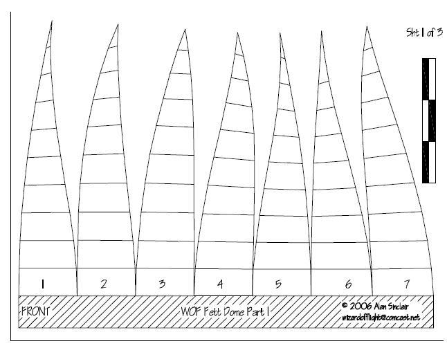

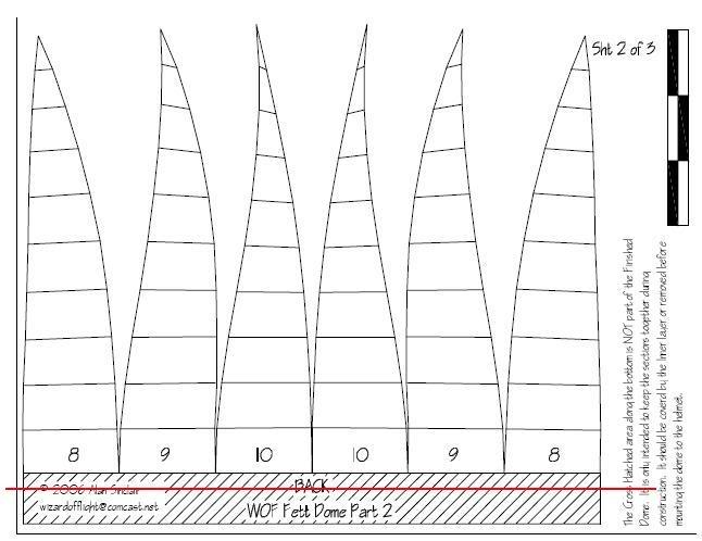

I start off with the cardboard piece I made from this template:

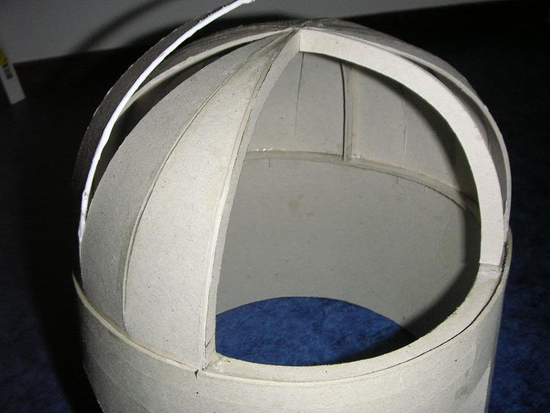

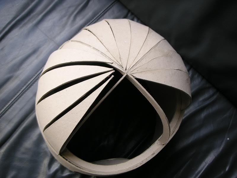

This one forms the back of the dome, and I split it up half (three sections each) and glued them on the inner ledge of the mask:

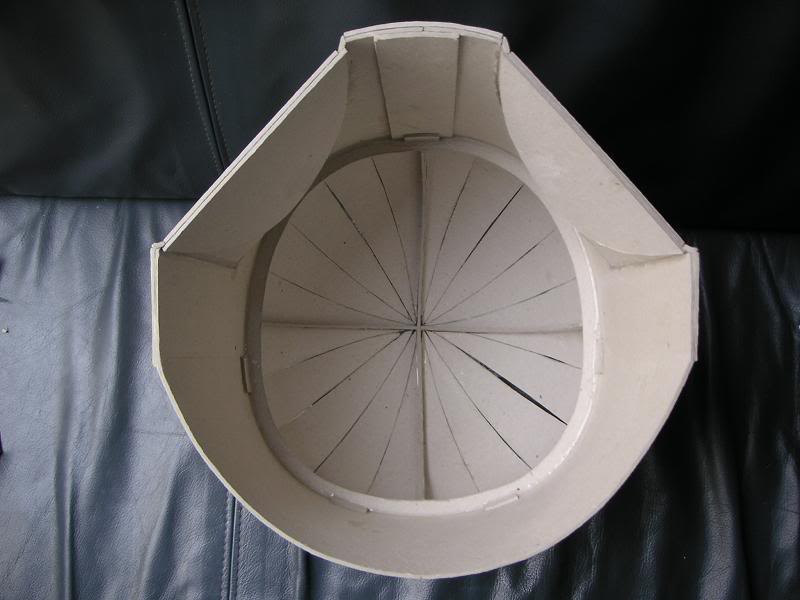

Inside view:
As can be seen from above photograph, I left just a little more length on the bottom part of the triangles. This exactly compensates for the aforementioned rim/ledge. So the actual length (arched area in the WOF template) which I leave on the triangle bottom, is the same distance from the dome base ring to the top of the mask edge.
To illustrate, this is where I cut the bottom (red line):
This excess material is covered by and glued to the inner mask edge. That same extra length I also incorporated for the dome form rings:

Okay, let's proceed to glue the triangles to one another; start by glueing both triangles marked number 10 (see WOF template) to the dome frame ring. Then the adjacent triangle number 9 gets glued to number 10, and number 8 to number 9. But take the time to let each part dry thouroughly before you glue it to the next. Use your fingers to mold and shape the triangle in the required curve when glueing. Again, patience is the key here.

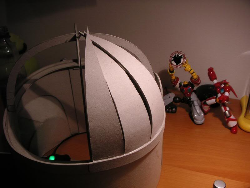

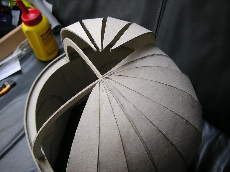

I just continue in the same fashion for the rest of the triangles; start to glue from the dome frame rings and then connect to adjacent triangle parts.

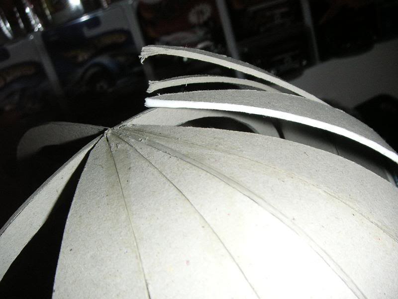

The pre-shaping with the misting bottle paid off nicely :thumbsup:. It makes it easier to glue the parts together:

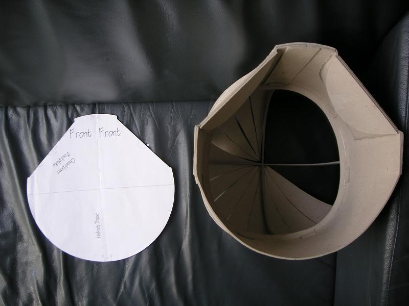

By this time I always seem to remember the template part which I forgot to incorporate earlier!:o
Here it is:

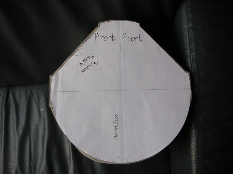

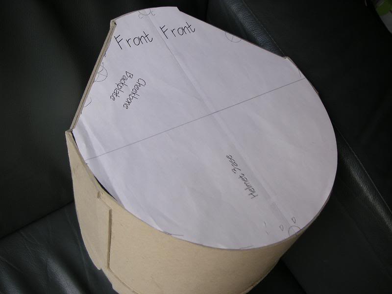

Taped together as depicted, WOF template pages 11 and 12 form the "Helmet Base". This particular template helps in determining the bottom shape of the bucket, as does the "Dome Base" (pages 9 and 10) for the top shape. During the shaping of the wet cardboard Inner Surface, the main form of the bucket is somehow automagically created. So now let's test to see if it makes the correct fit:
It duz, it duz!!:thumbsup:
If it wouldn't have, just use the misting bottle and spray the bucket a tiny bit moist and shape it accordingly.

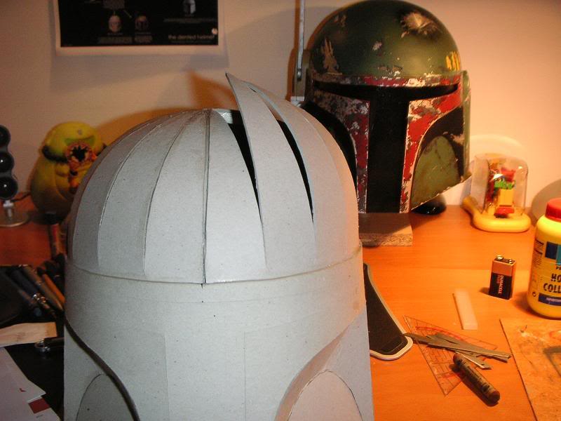

Only a few more triangles to go:
Almost there....

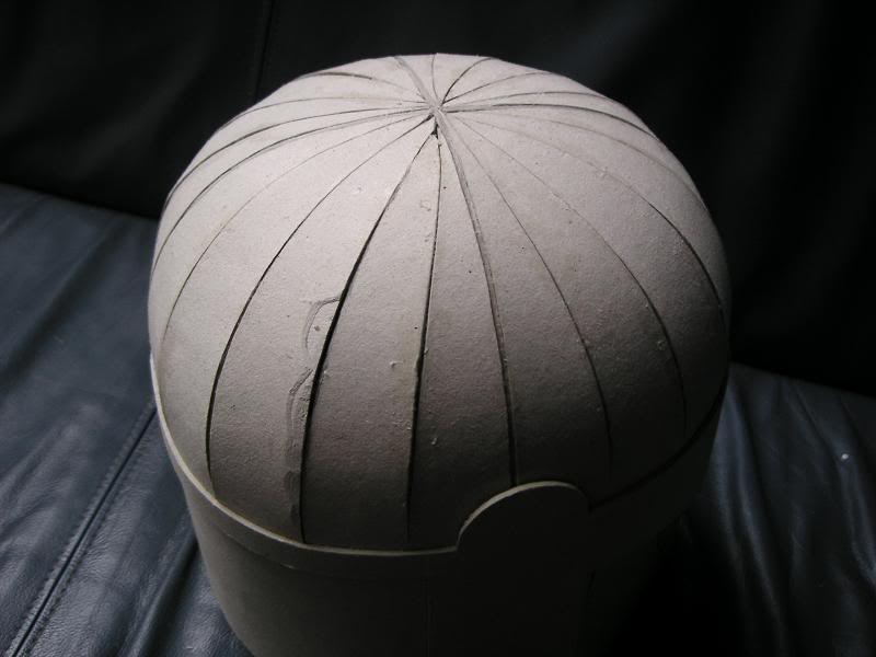

And shazam! The dome is complete!:D

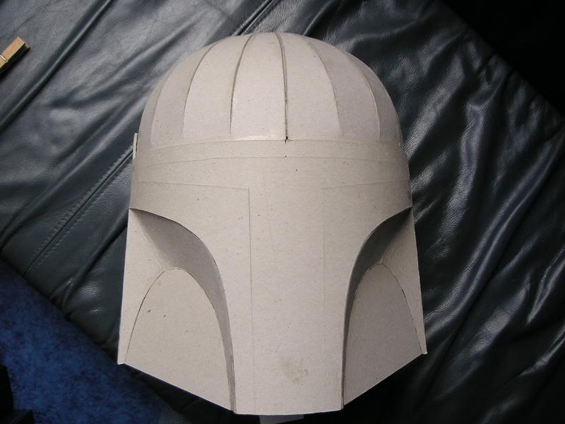

The basic shape looks okay to me:

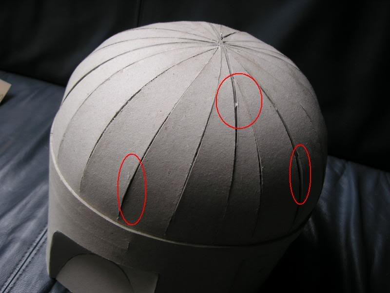

Here you can see that (even:lol:) I messed up a bit :facepalm. Some triangles where not glued symmetrically, so I had to compensate but cutting excess material away. But this should not be a big showstopper since the dome will receive a thick coat of filler anyway.
The areas marked red are to be corrected by either cutting away or by filling up. Keep confidence. It will work out okay.
Inside view:

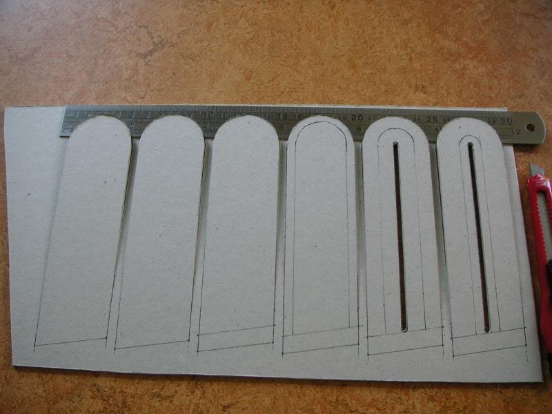

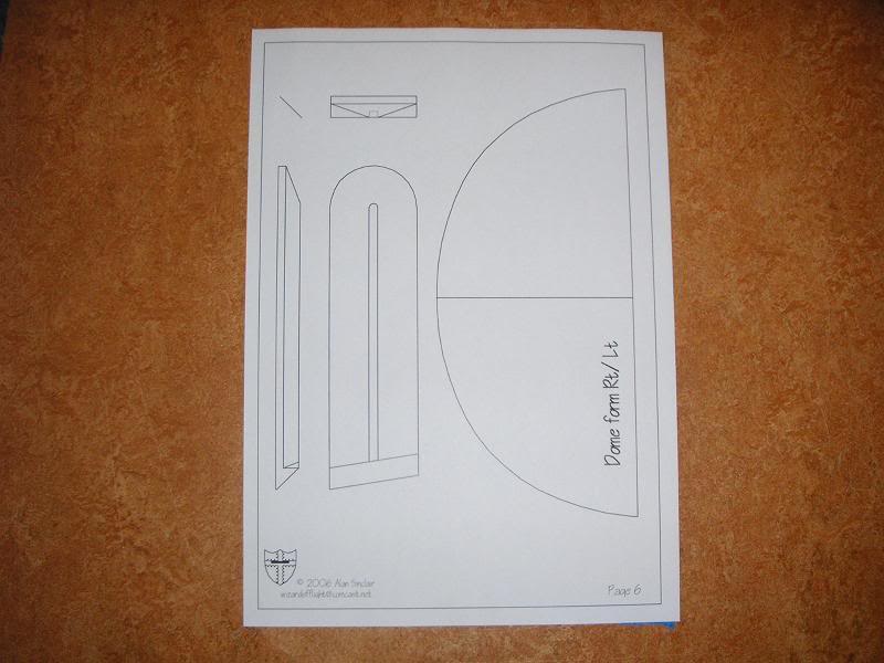

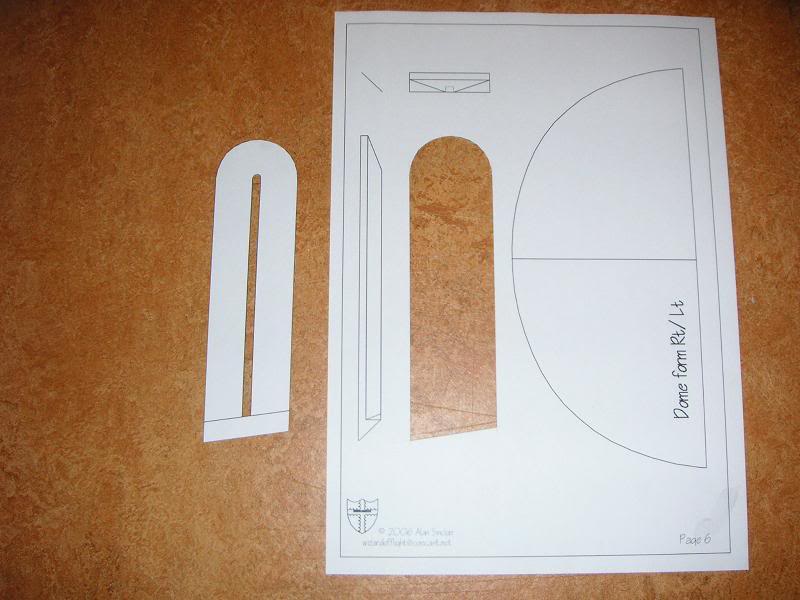

First I start off with this WOF template (page 6):

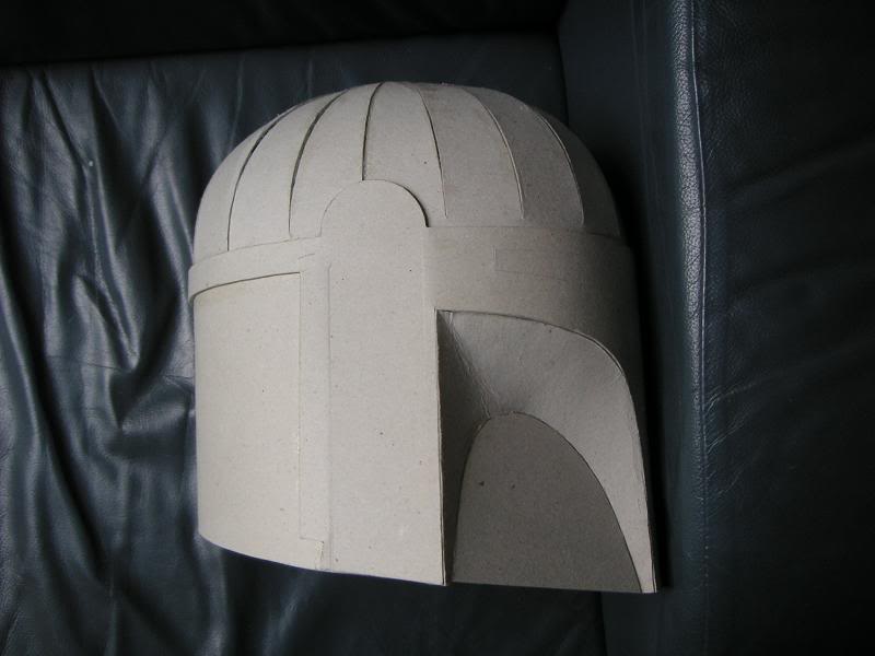

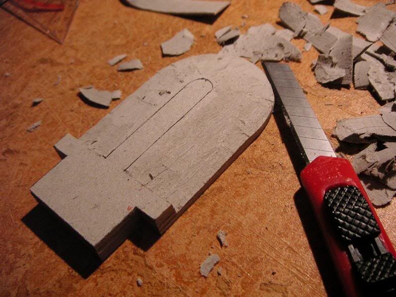

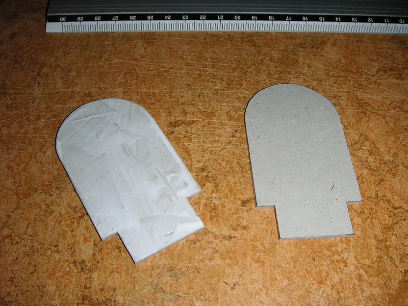

I cut out the template for the left ear, and also the gutter in it, and make a test fit on the bucket:

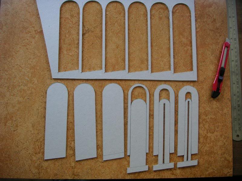

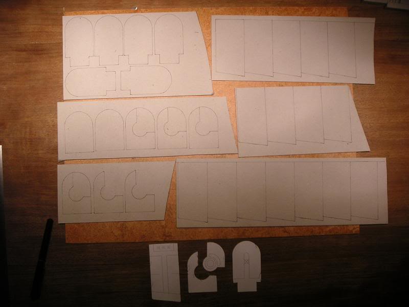

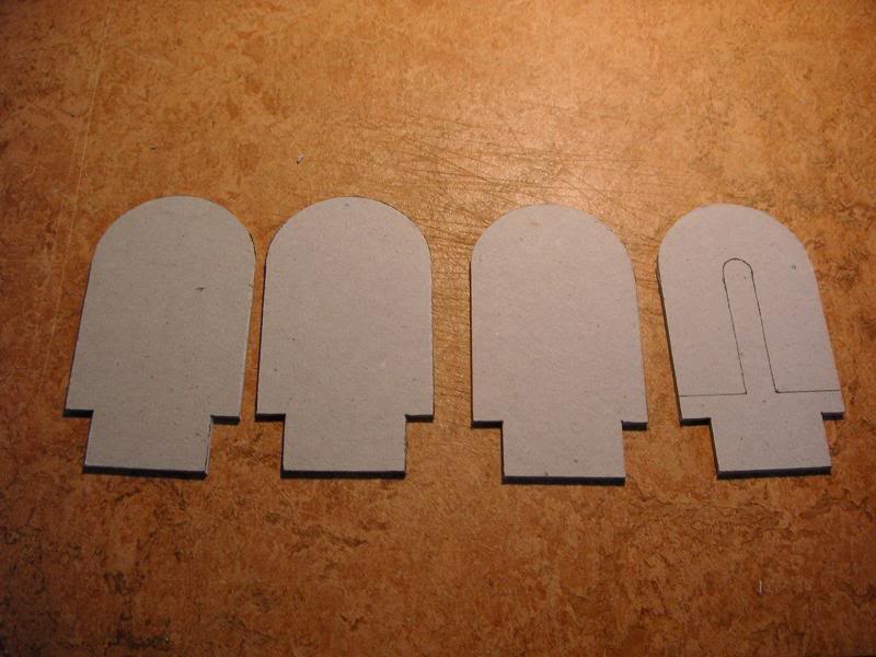

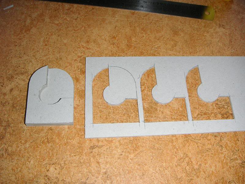

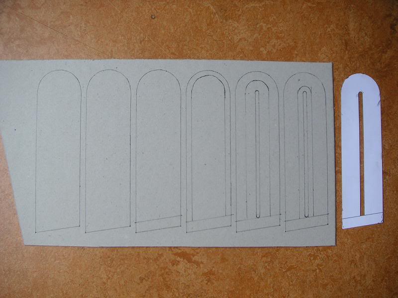

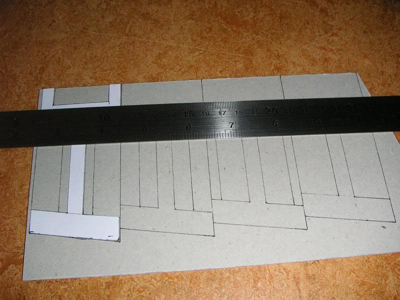

Next I transfer the template six times on a piece of cardboard as such:

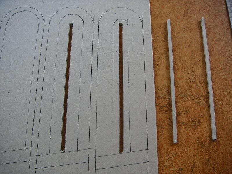

From two pieces, I cut out the gutter part as depicted here:
Then I start cutting as precise as possible on the outlines:
Because the ear will have a surface angle I precut the material which needs to be sanded off anyway:

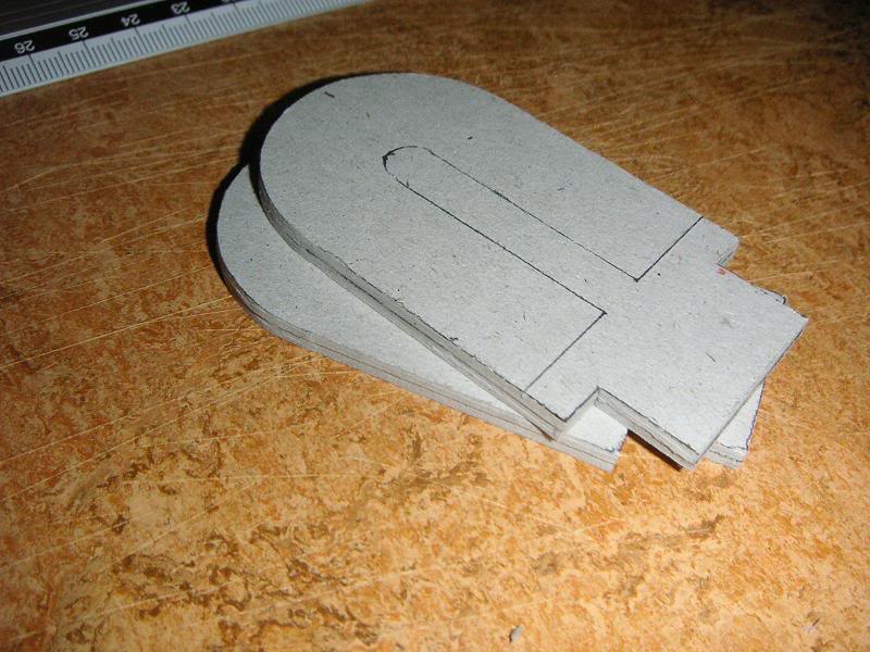

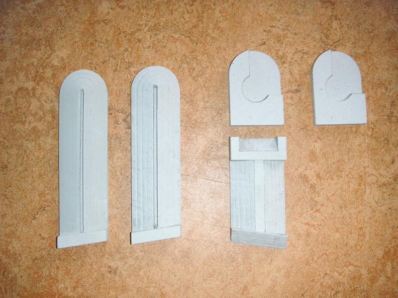

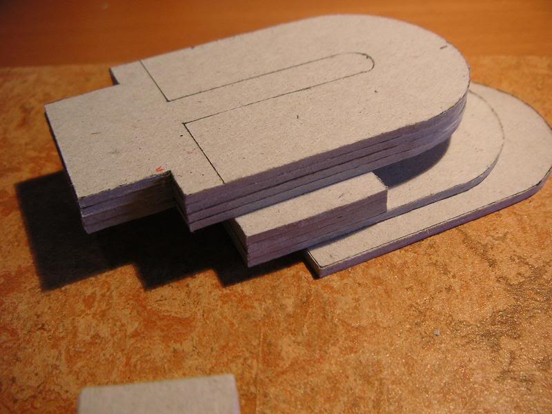

Stacked, the layers form this shape:
To be cut and sanded until it looks like this:

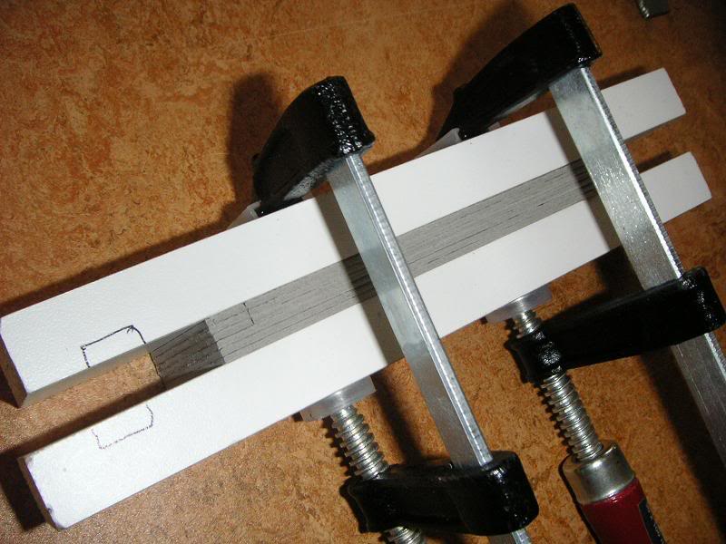

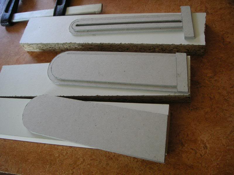

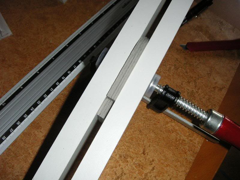

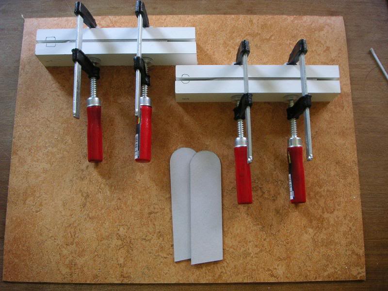

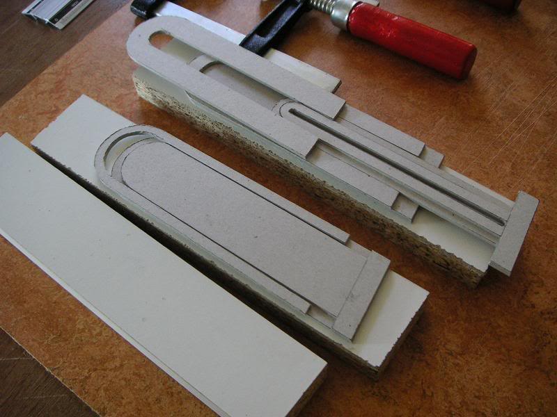

I glue two layers at a time together and press 'em including the supporting material:
Then those two are glued to eachother the same way:

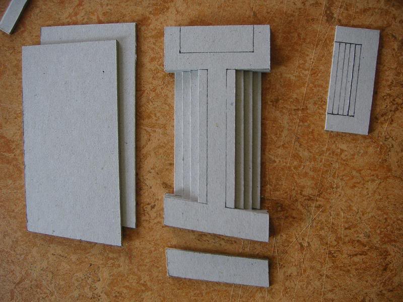

While this is drying I prepare for the R/H ear sections by cutting out the templates (page 7) and transferring them to cardboard. I drew plenty of shapes (because secretly I'm doing a second bucket simultaneously)8):
I start cutting out the easiest part which consists of 4 layers (three shapes as depicted in next pic, plus the back-plate) and glue them together in the same way as described above. :
The edges of this piece are sanded (grade 120-150) until smooth and straight.

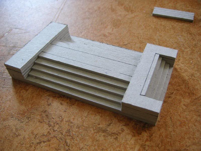

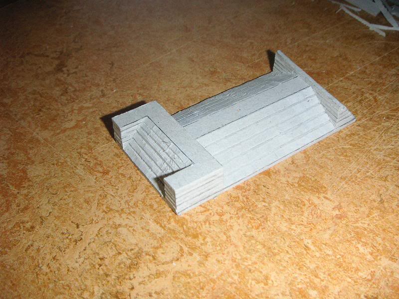

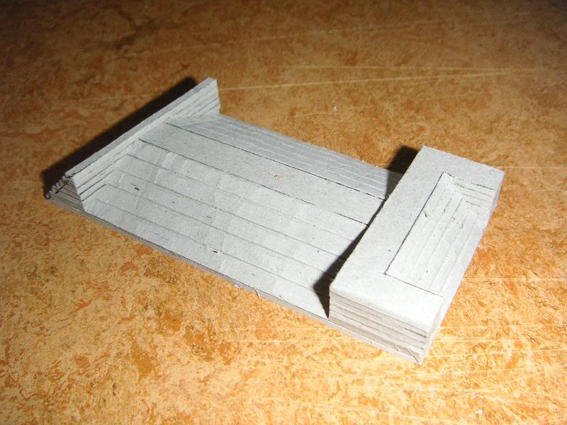

Next I tackle the most intricate and complex part (to me at least) which consists out of 7 layers. The design looks quite simple but has so many
angles and sharp edges to it, it needs full attention when constructing it:

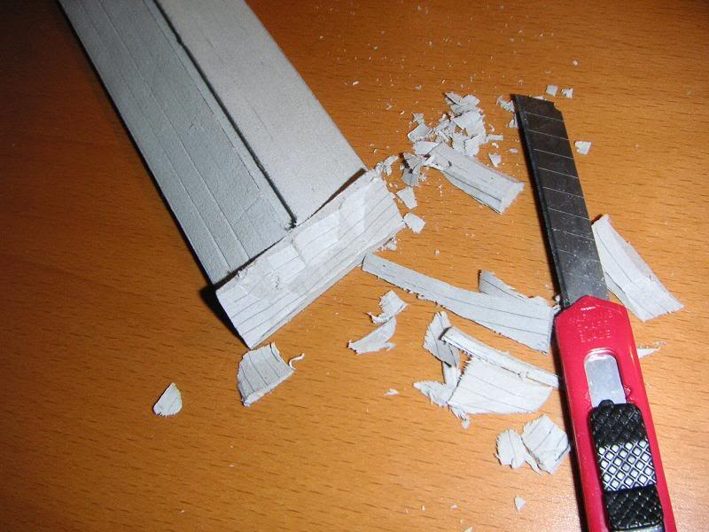

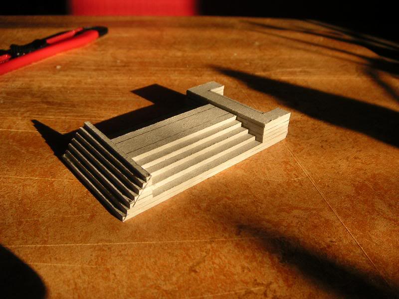

The basic idea is the same as with the left ear piece; cut away material which you are going to cut away anyway as if you were sculpting the shape from a solid piece of stone or something.

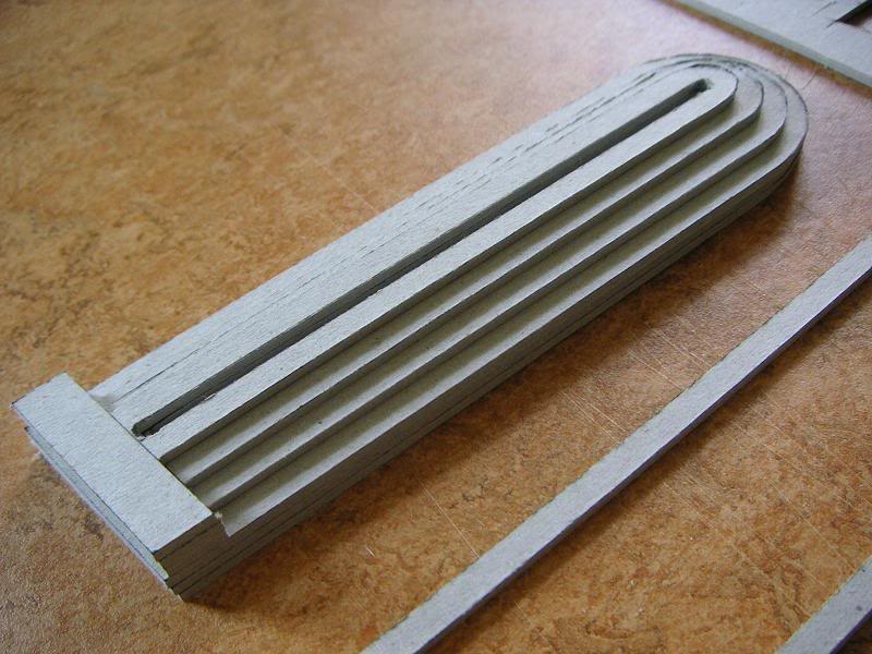

Building up the layers:
And all of the prep'ed layers stacked look like this:

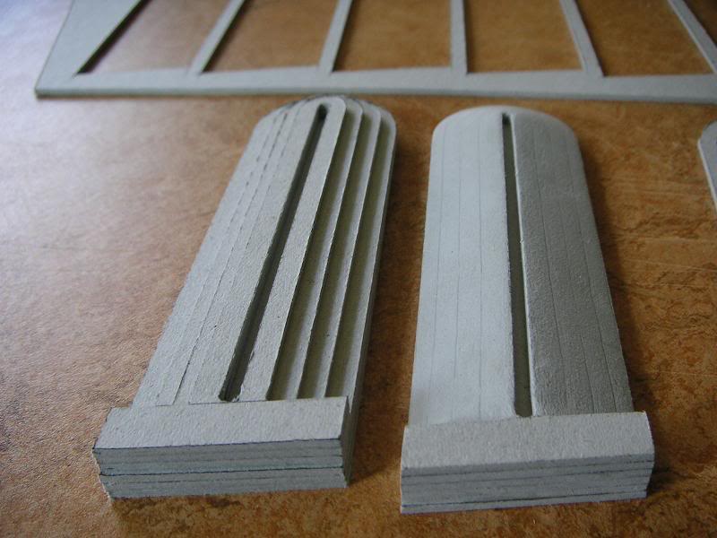

So then it's just glueing them together and shaping 'til the desired shape appears:
Here's the lot so far:

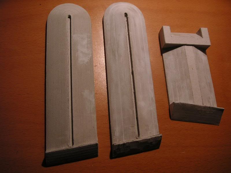

Finally it is time to create the "ear cap", built up out of 4 layers:
White glue all over the place:
Two layers at a time:
Good old glue clamps&blocks:
The cap goes on top of the firstly created right ear piece:
Shaping the angle is the same story; use a fresh sharp knife to roughly cut away excess material being careful not to cut away too much:
All it needs now is some sanding until smooth and I'm set to put on the first layer of sealing agent. But that is for next time.
