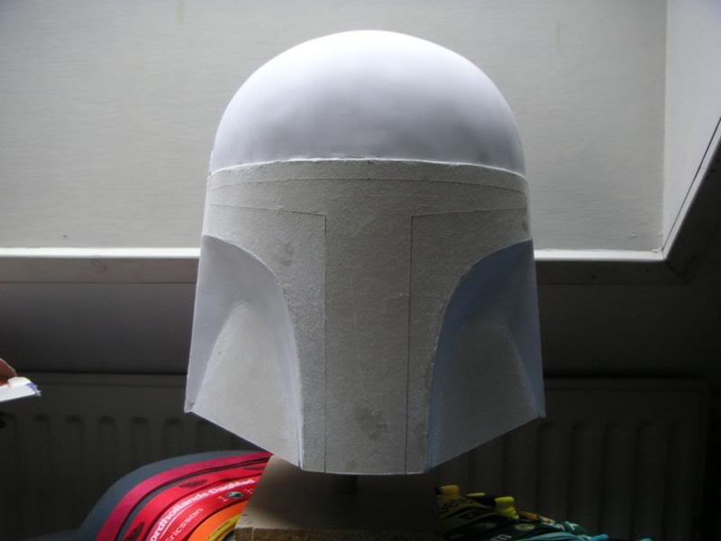

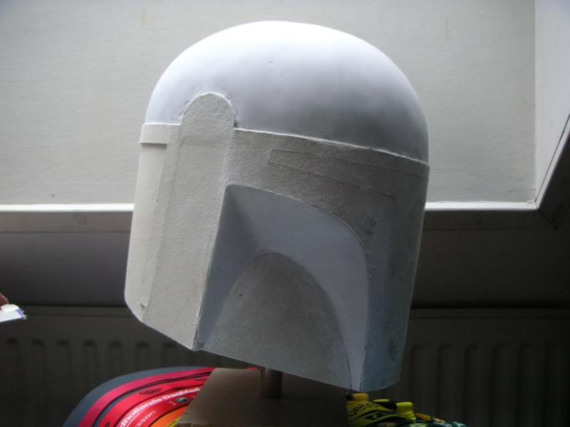

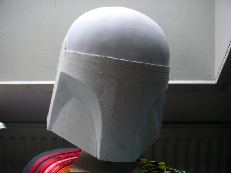

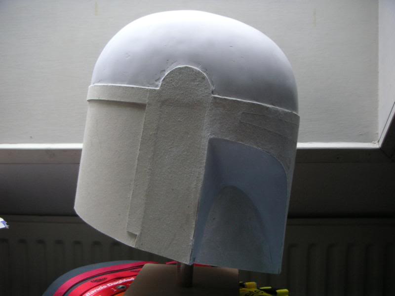

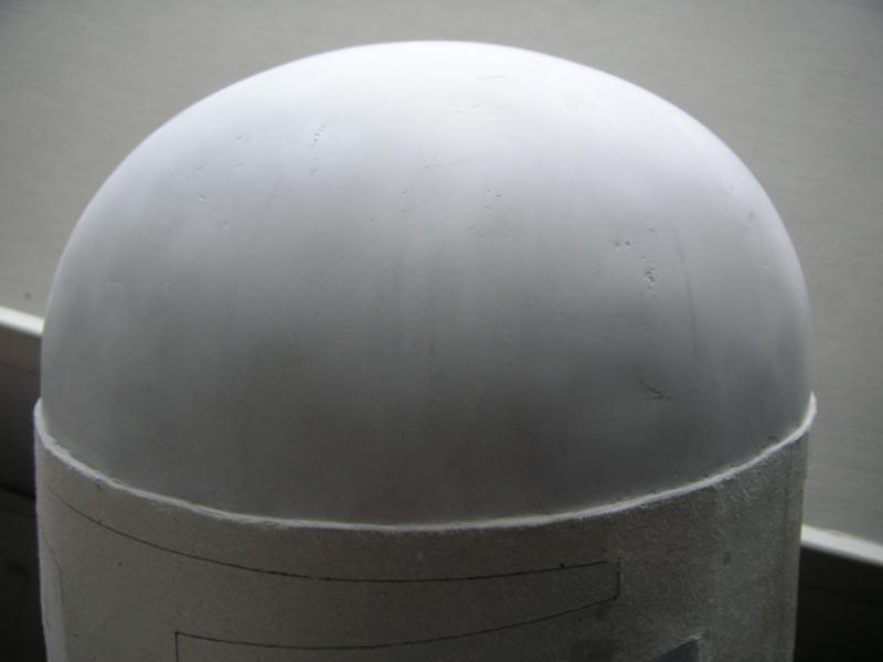

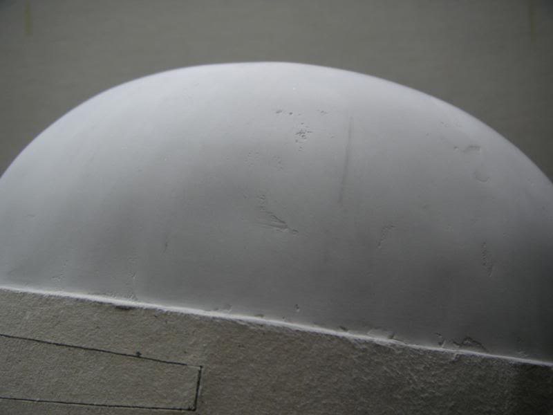

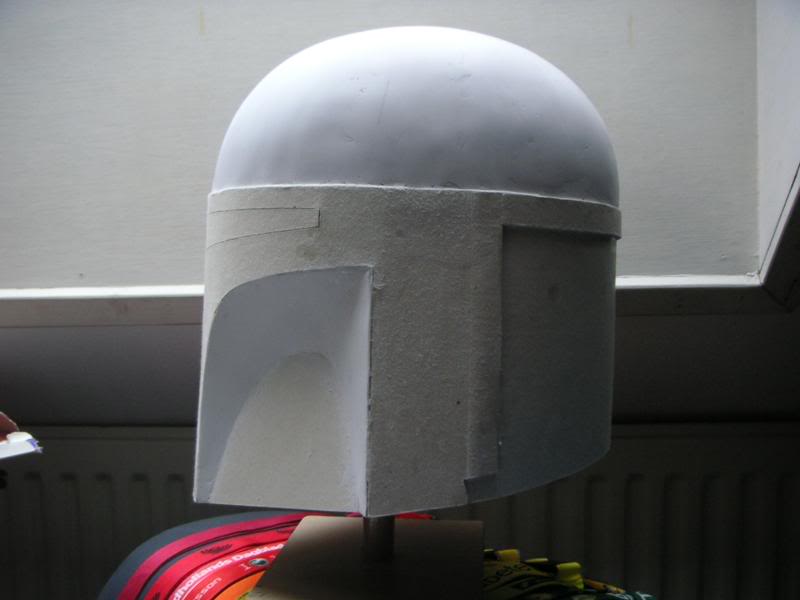

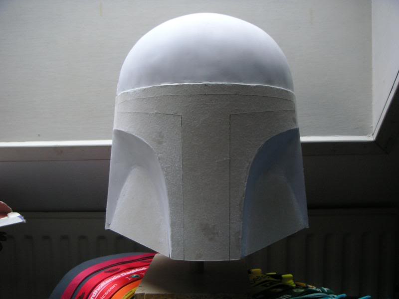

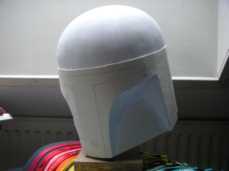

As promised a while ago, here is a progress update of the sanding process. This, for me, is the most time consuming part of all steps an also the most boring part. I also want to stress the fact of applying the paste (Bondo-like stuff) should be done as smoothly and precise as possible. Thus, the sanding will go a lot easier and less corrections of bumps and lumps are needed.
Now let's get to the pictures:
Looking a lot smoother than when I started ;) :

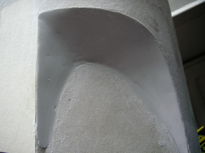

A close-up reveals that some areas need some additional filling:
The cheek area detailed view:

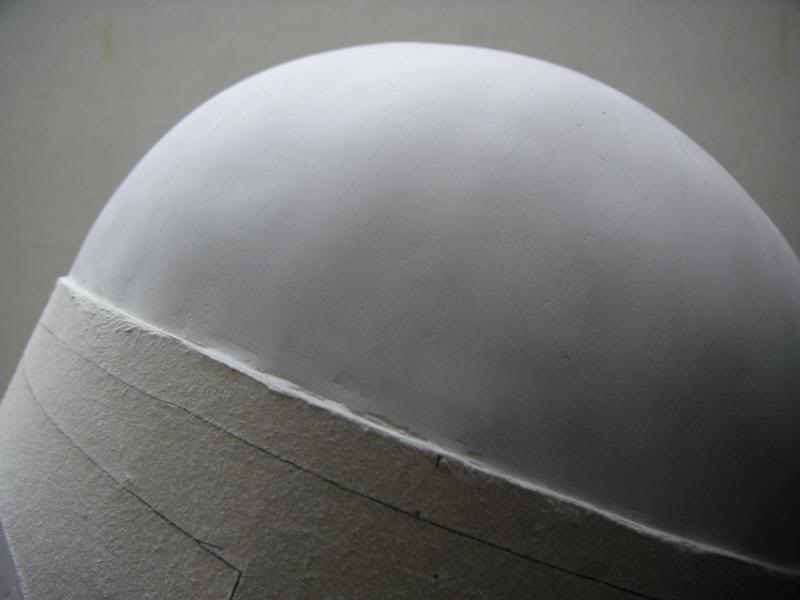

The right-ear area also need some fine-tuning:

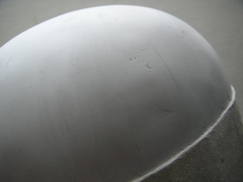

Oops! Forgot a spot ;) :
But overall, it looks cool:
Now starts the iterative process of filling the uneven areas and sanding smooth again.
