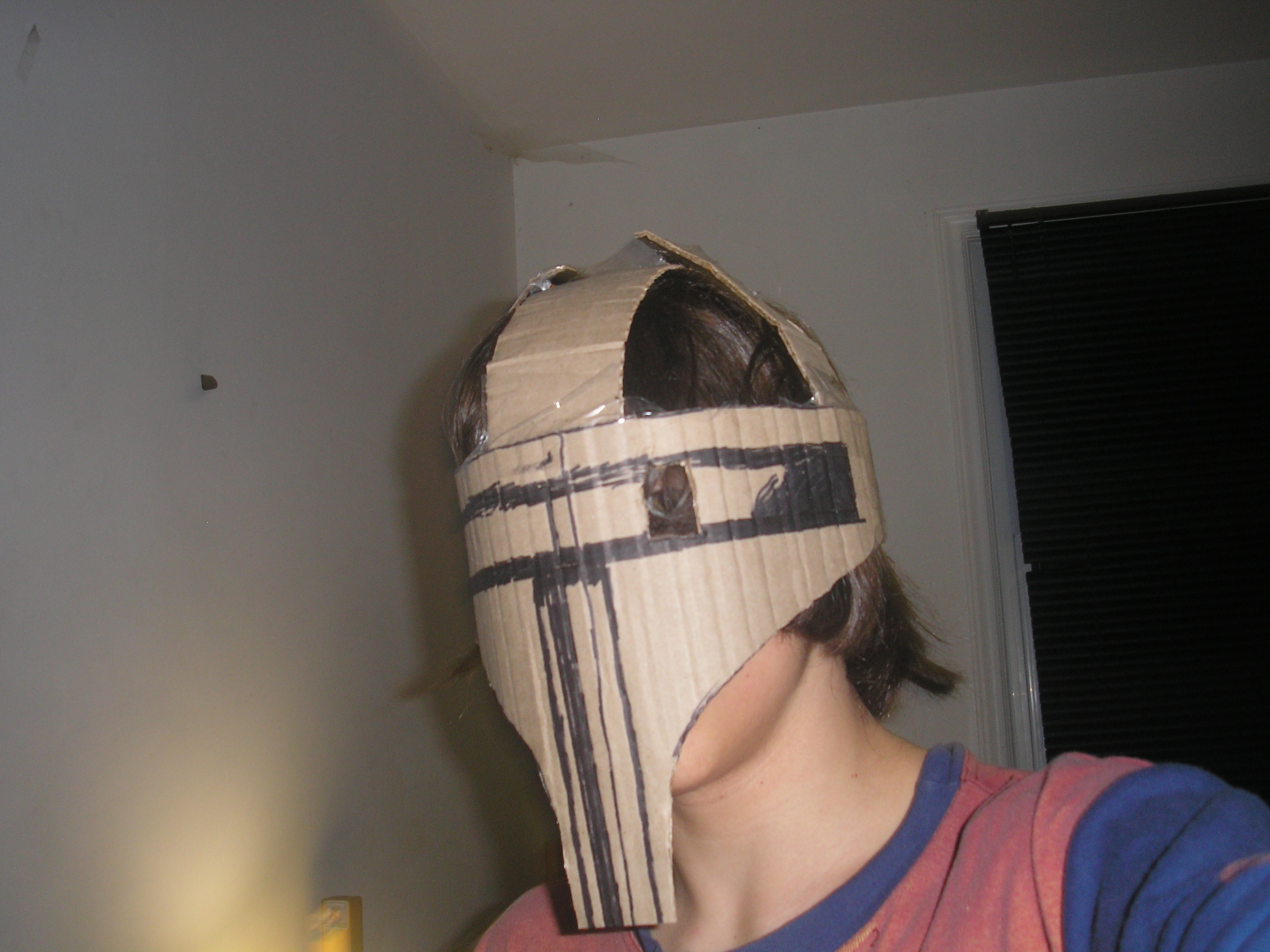

Now I just actually dove into my helmet my armour itself is almost complete, save knee, and collar armor, I plan on posting pictures after I'm done painting and bending and all the good stuff.

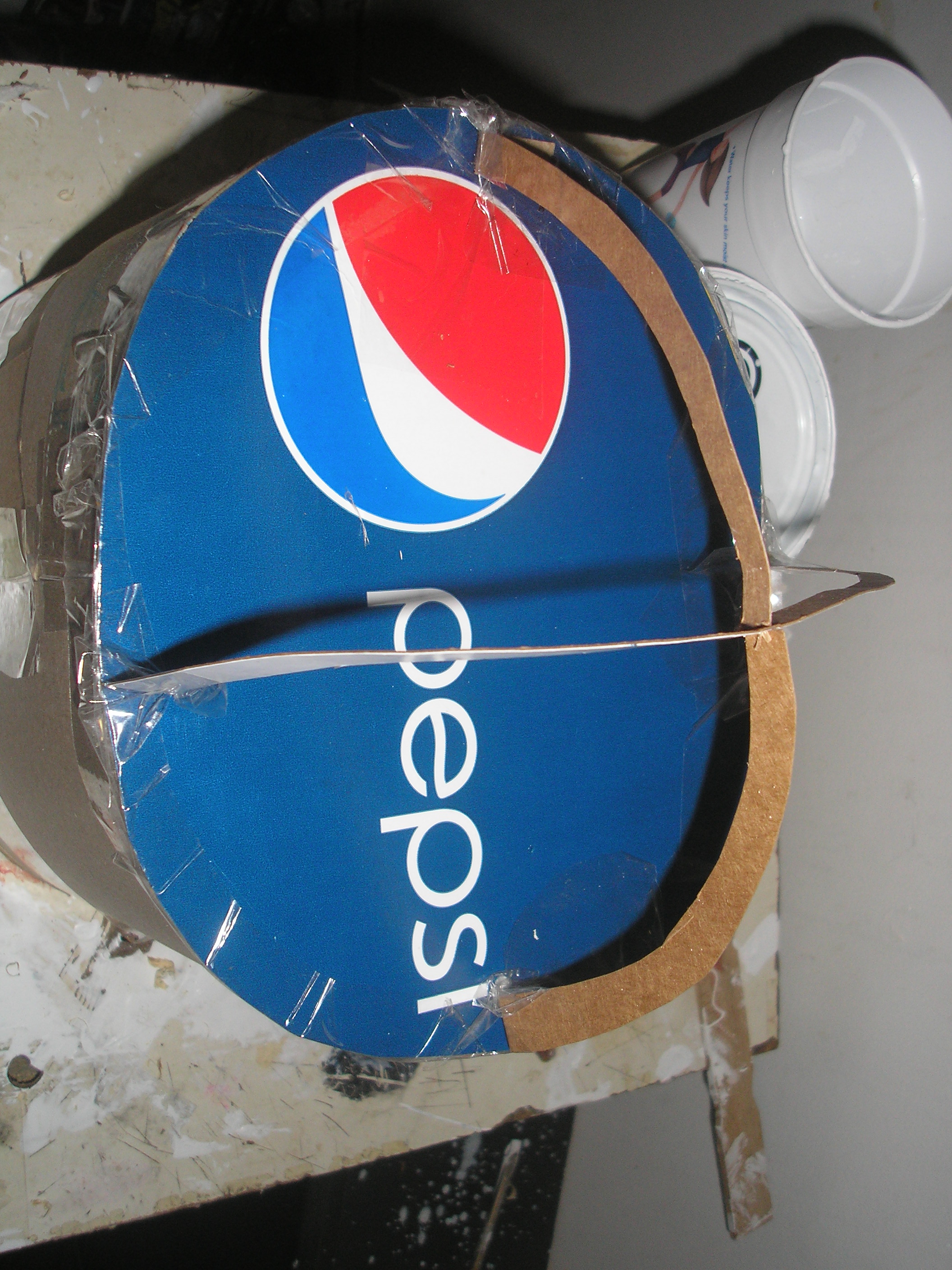

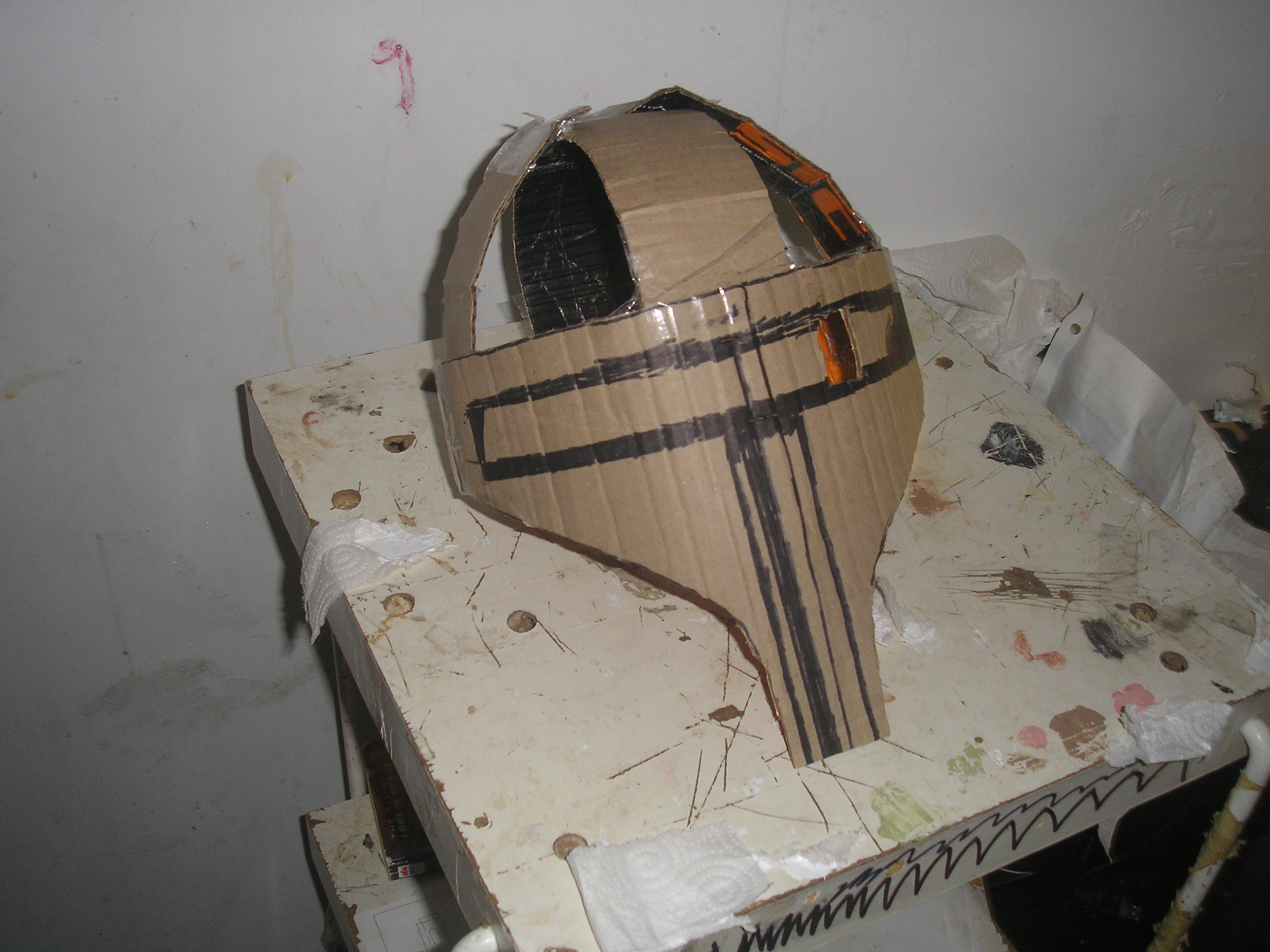

The hole in the visor was to make sure the visor area was exactly where my eyes are... it is.

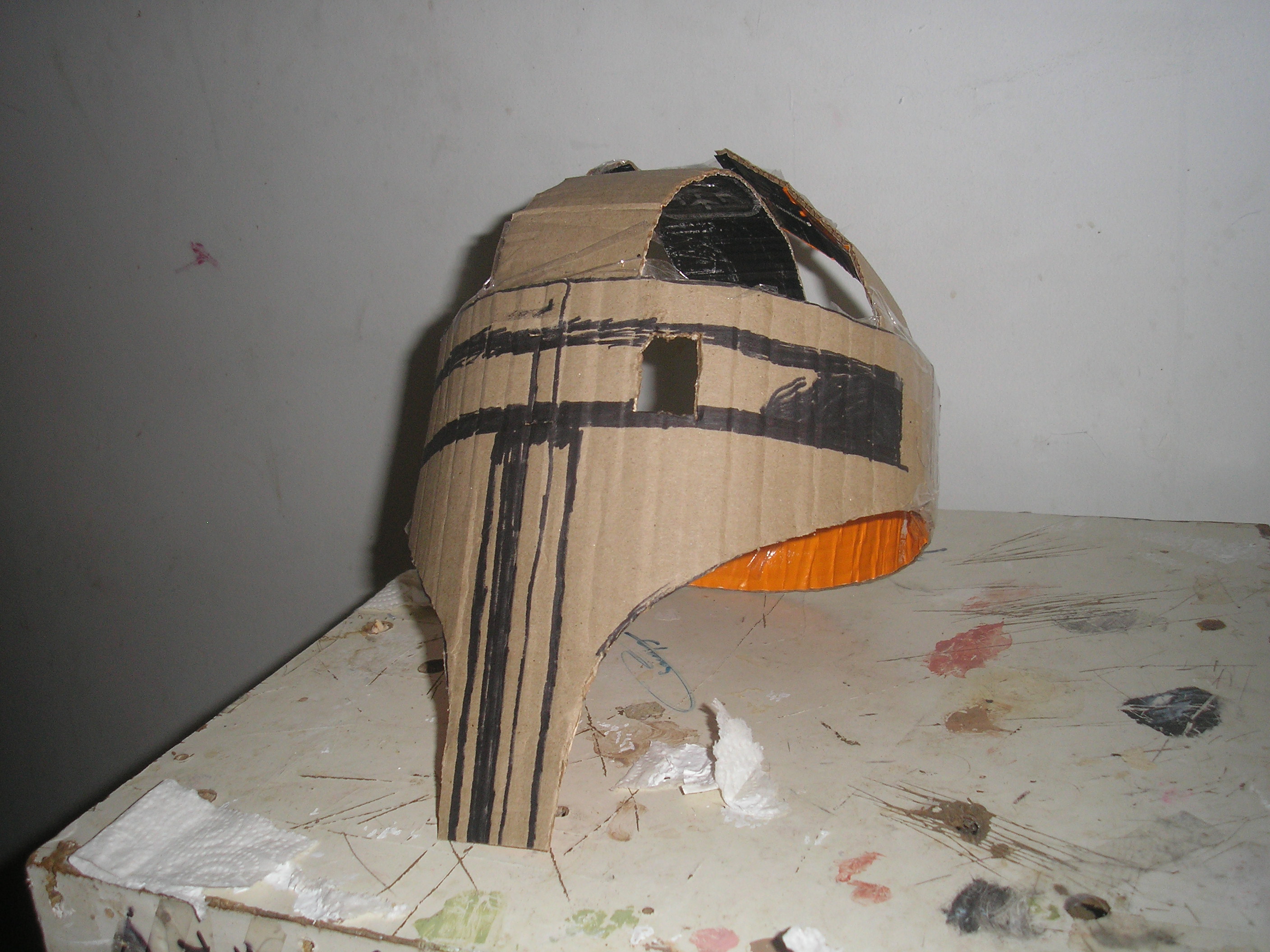

The Third pic shows how long the helmet it, for added sinisterness

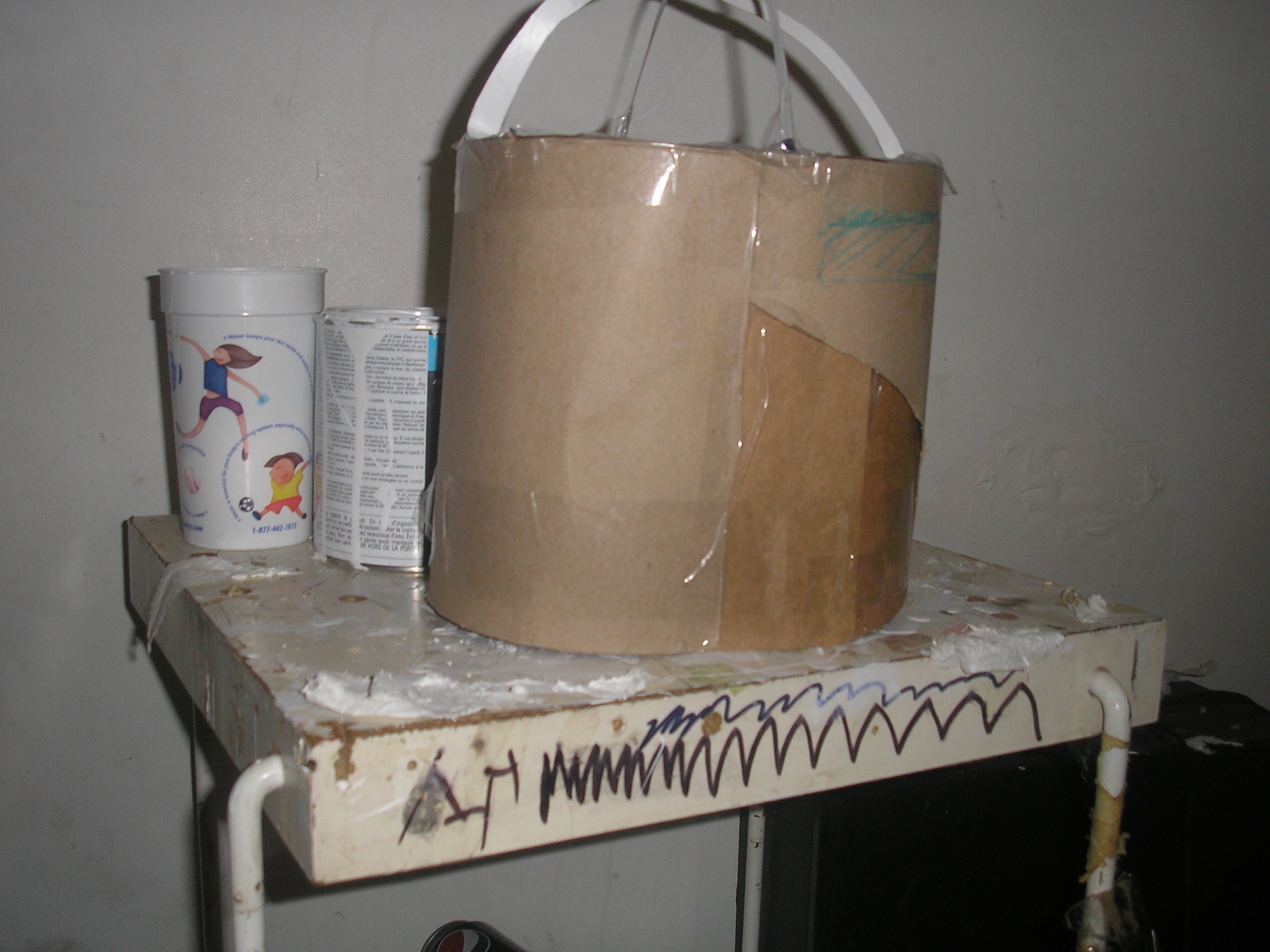

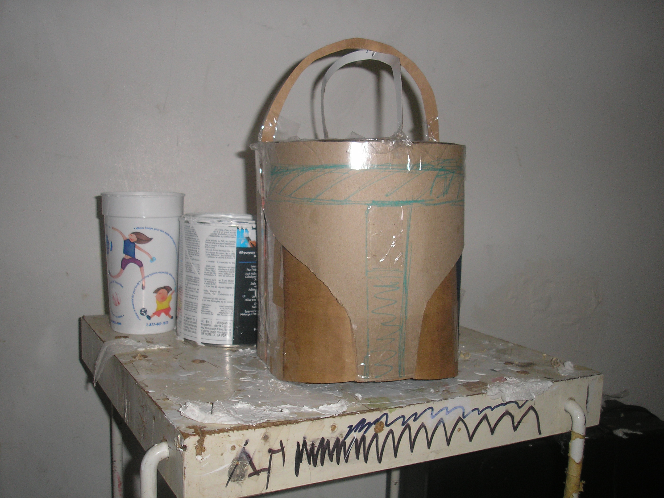

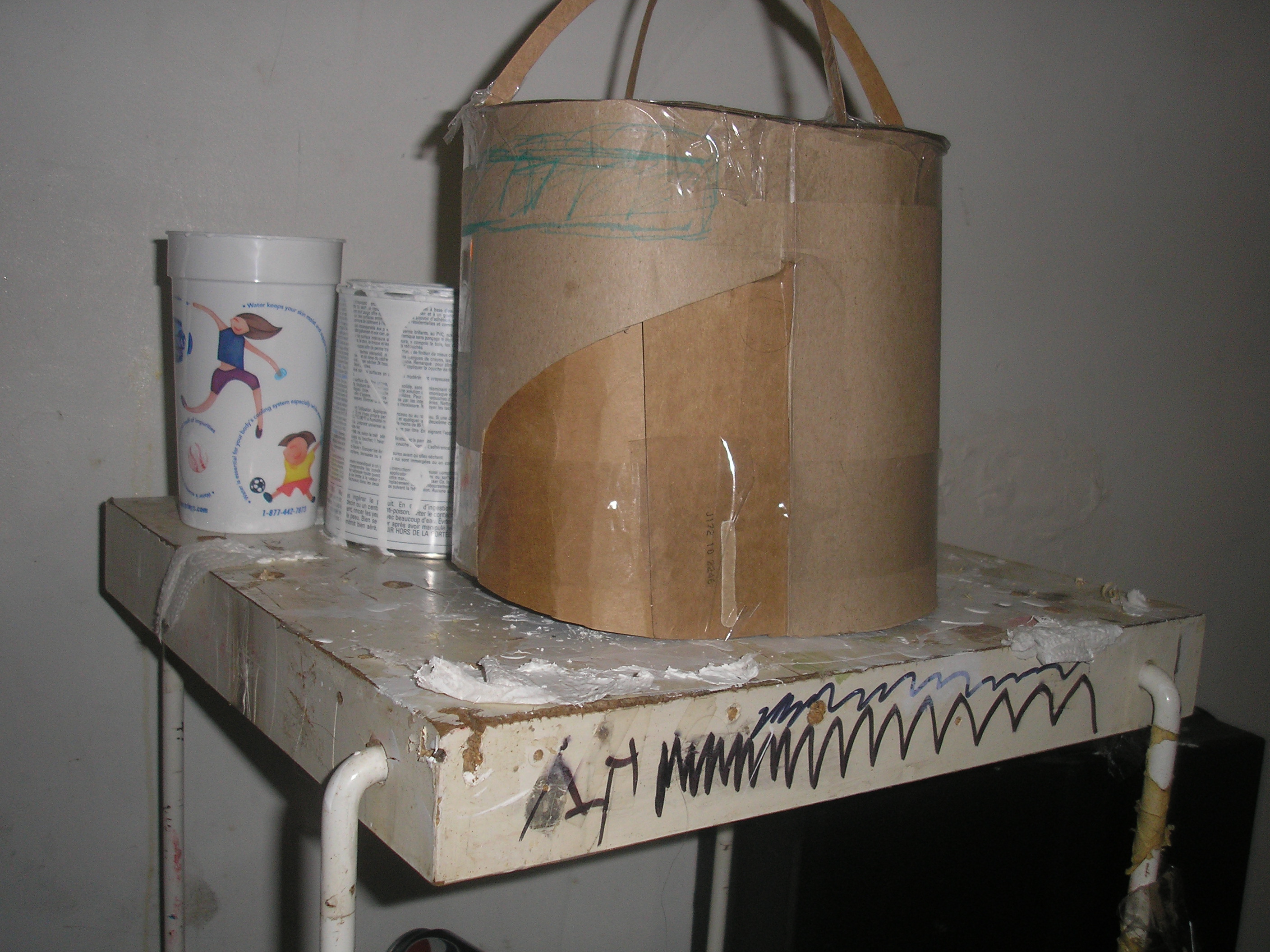

Now, The cardboard part has been scraped. it was more or less of a template to see if it would fit, and now I have a cereal box helmet, that requires a dome, The image is almost done

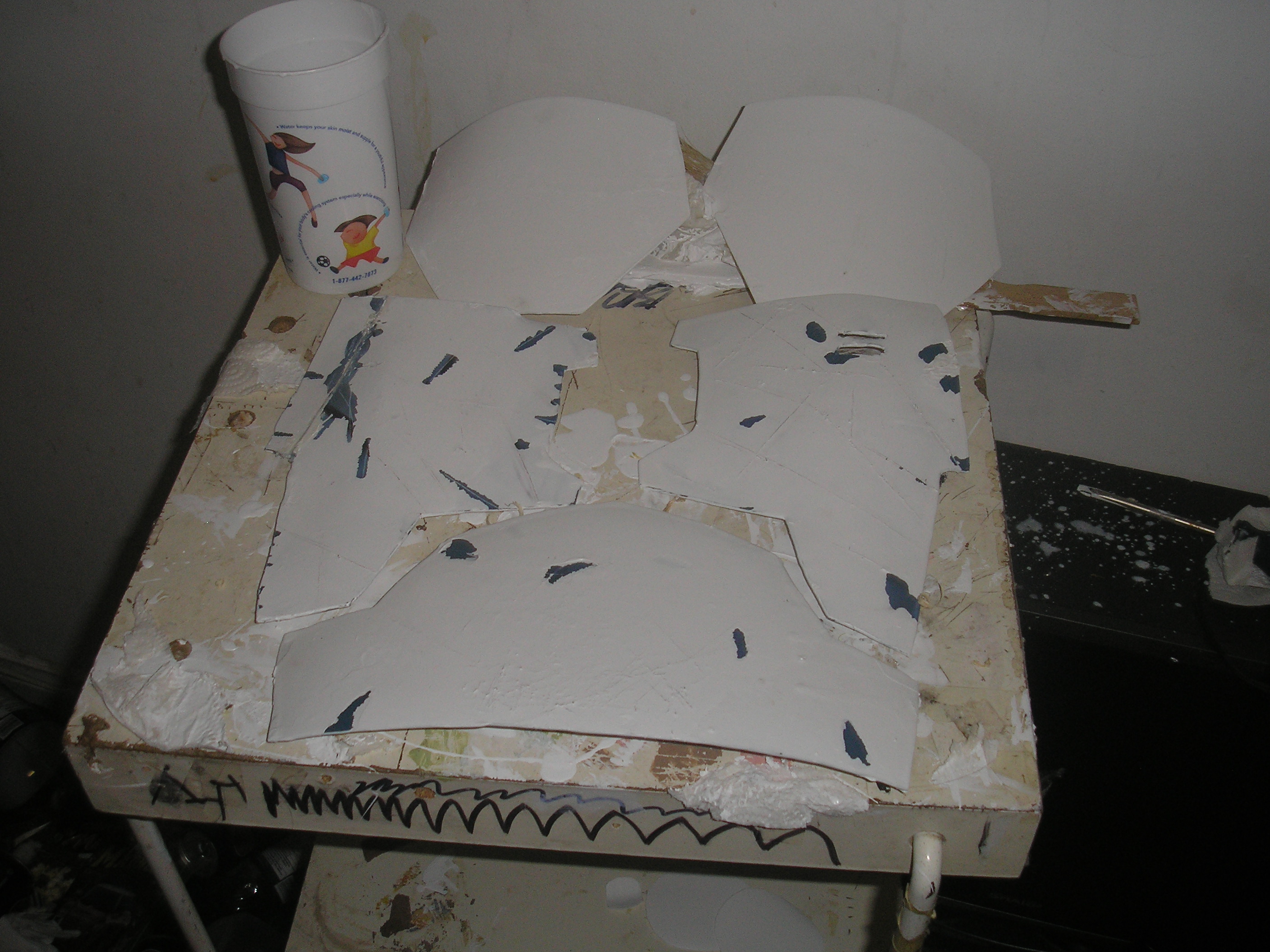

Heres the Bucket so far, tips? Im not using any templates so its all scratch built, so I need assistance on the dome, And well Theres the incomplete chest, I used Paint and primer all surface paint to paint it, and dug in with my nails to do where Im gonna have Paint chips.... and you can see all the scratches and all that, I just went with the flow and yes, there is a chest medallion, I just can't find it
Ok, as far as the dome goes, use the WOF dome templates and--using paper or a low-wieght card stock--VERY CAREFULLY cut out the entire thing and tape it together. What I like to do after it's all together and taped is turn it upside down and brush a coat of resin on the inside, let that set, then do one on the outside. That usually gives it enough stregnth to work with. :) I'm gonna find a few threads on helmets and a few links to good helmet tutorials (yes, one of them will be mine if I can find it :p ;) )
