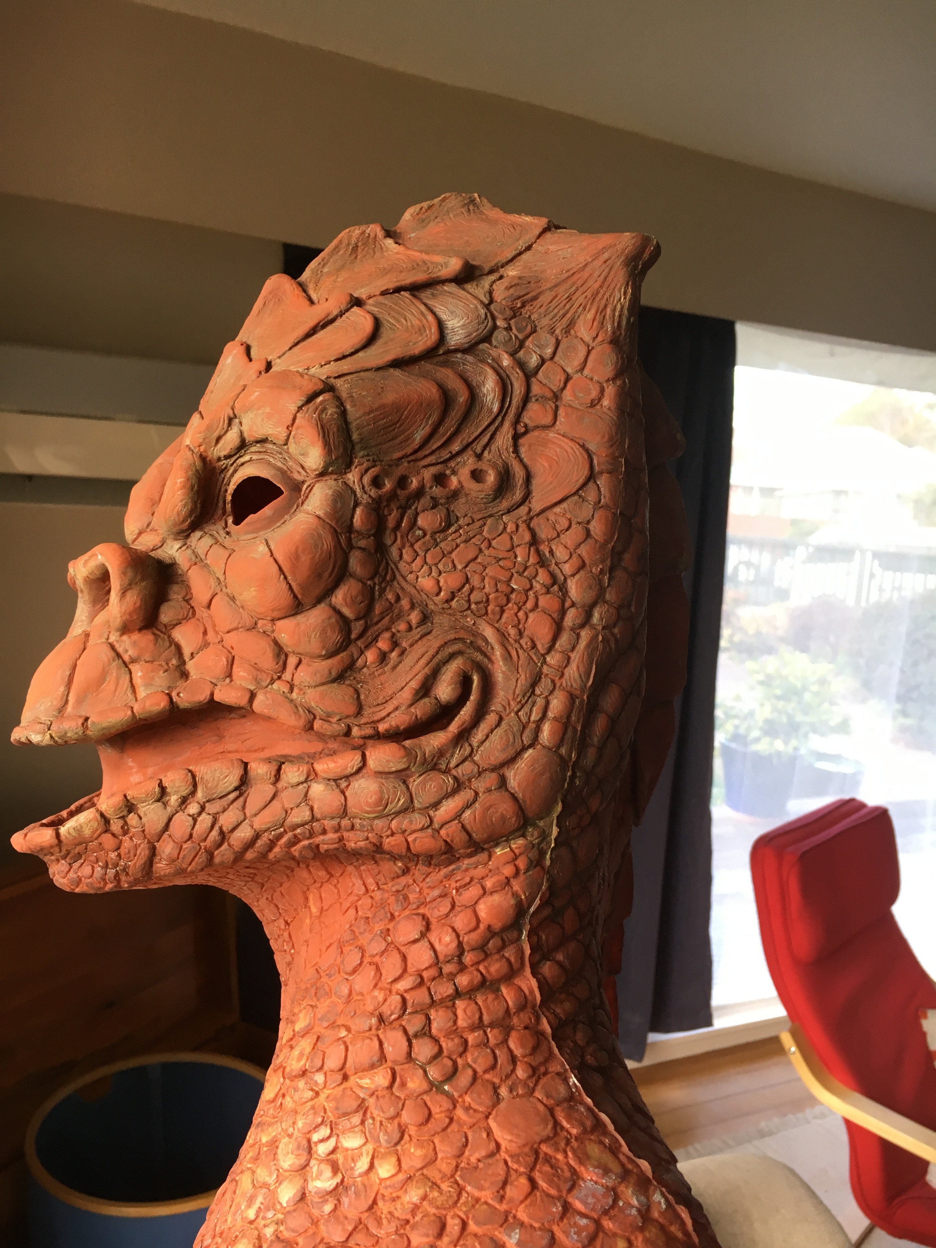

Back into it after a not so wee break, pulled the sculpt out of temporary storage from moving house. There was a slight bit of damage but nothing major.. just a few scars(damage from my little boy attacking the monster with a ruler sword...), so tempted to keep them....

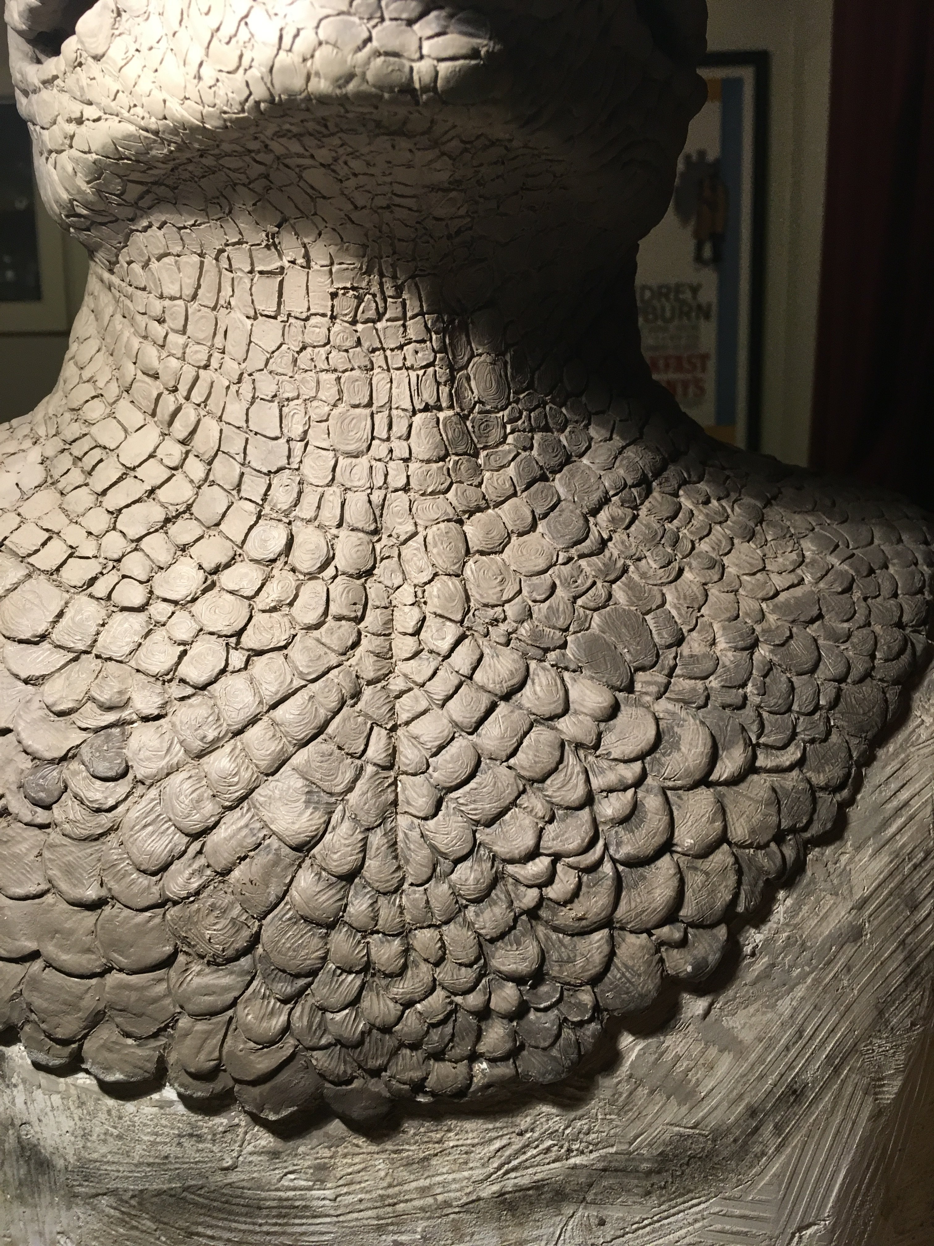

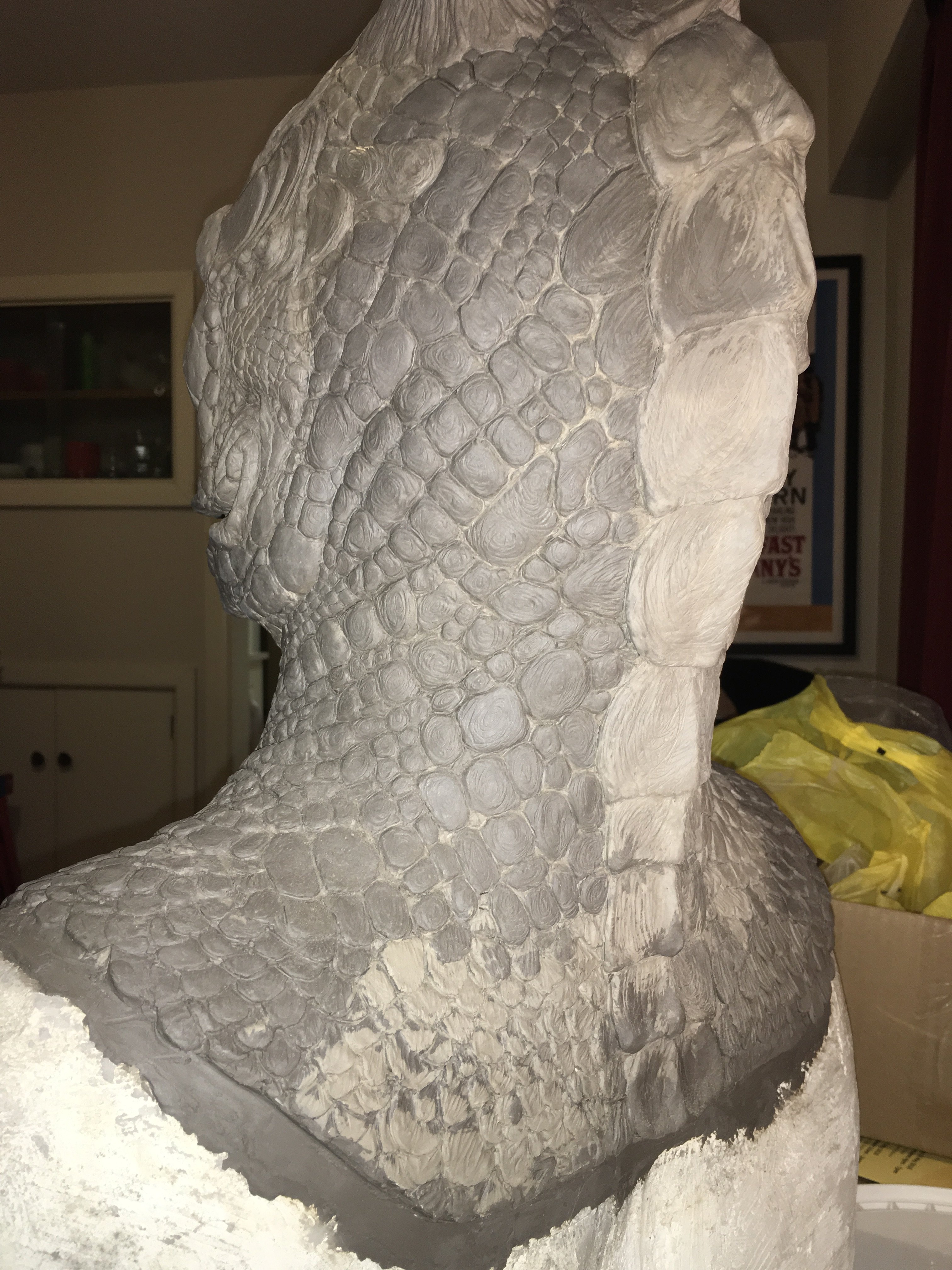

After some clean up,tidying scales... and scar repair ;) it’s now all about adding in those details I love so much, and with the clay all nice and leathered from storage, it a good time to get everything nice and fine...
Last update on the sculpt before moulding:)
It’s taking what seams like forever to add the details into every one of Bossk’s scales, sure I could have stopped and had them all smooth to save a lot of time, but real scales are not smooth, they all have texture to varying degrees.

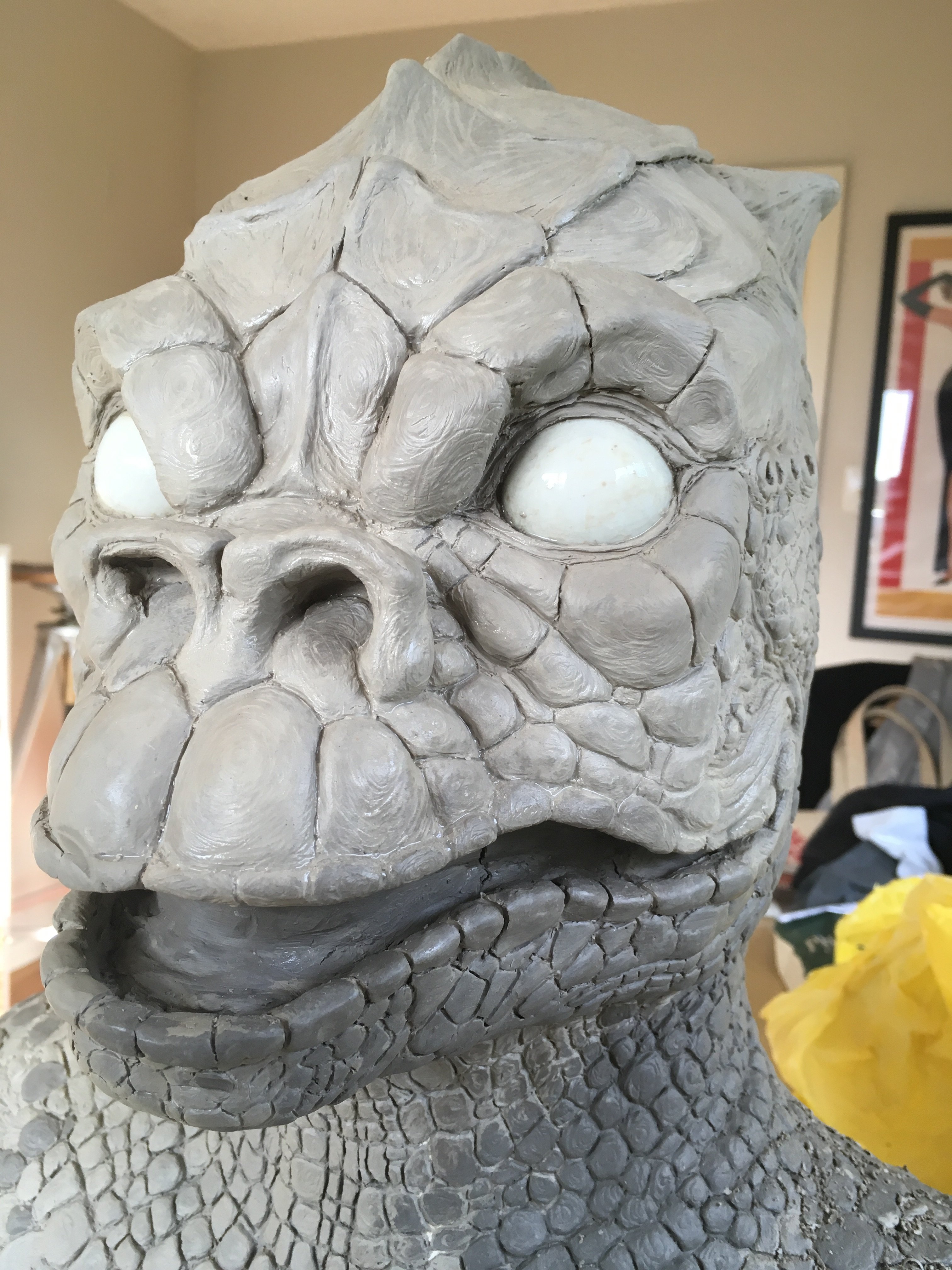

Oh, I found what could be suitable eyes....
Will experiment and see if I like them, I have a few different ways of doing them in mind....
Those should work well for you. I use them on my alien sculpts. If you have a need for tinting them black (I know you don't for Bossk) you can use Testors black window tinting spray paint. Apply it in super light coats.

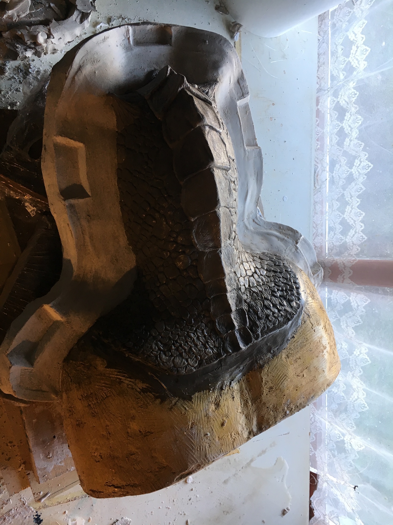

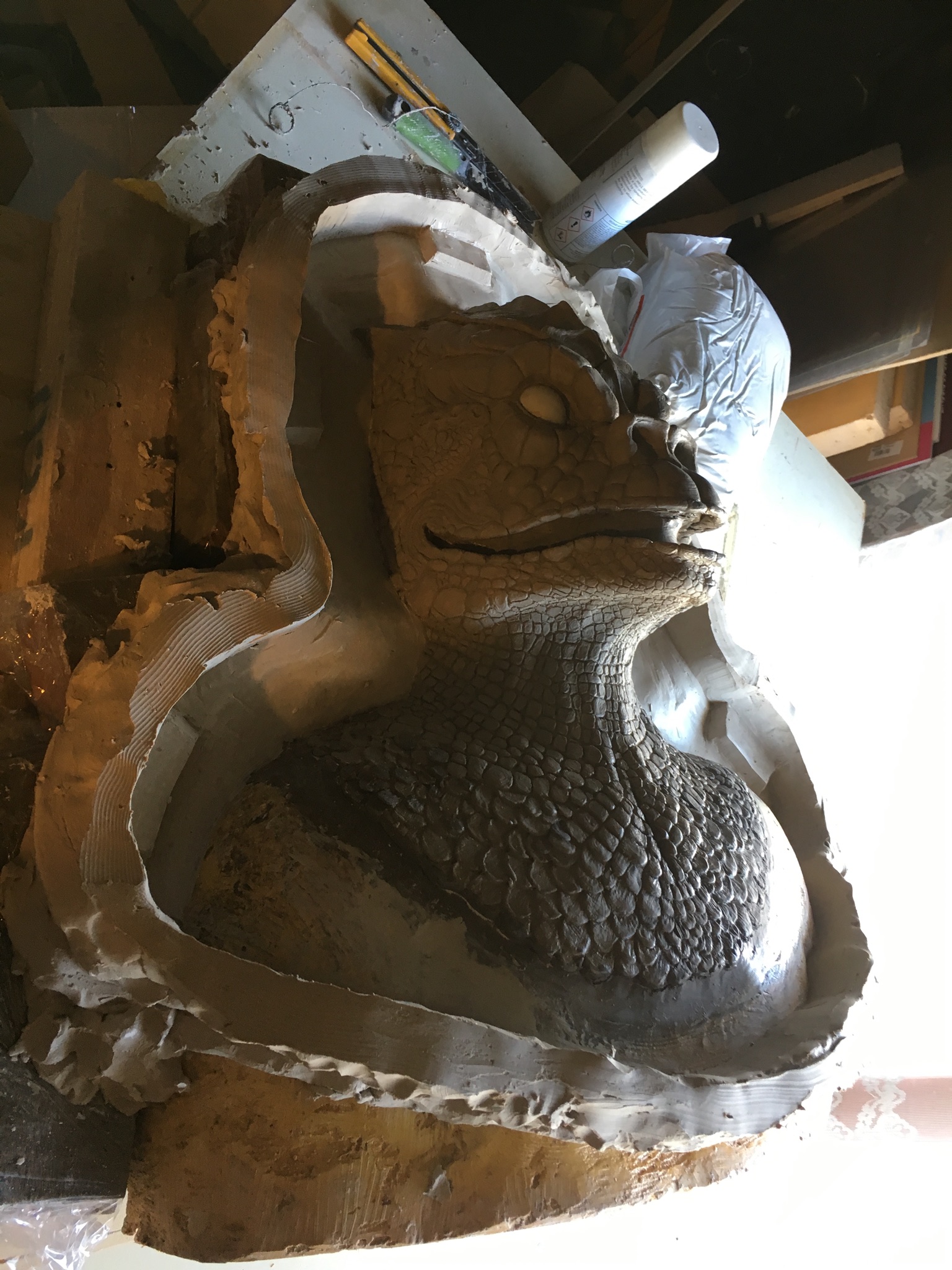

Mould done and dusted.... always a bit scary covering all that hard work up...

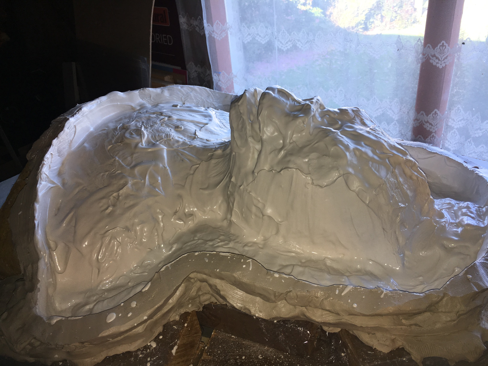

First layer of Hydrocal, nice and thick, should capture all those details.
I have gone with Hydrocal over Ultracal as it is better for mask making, though not as strong. I could have used stardard casting plaster but i find it is to soft and easily damages, also standard plaster is coarser than the Hyro/Ultracal so doesn’t capture the detail as finely.

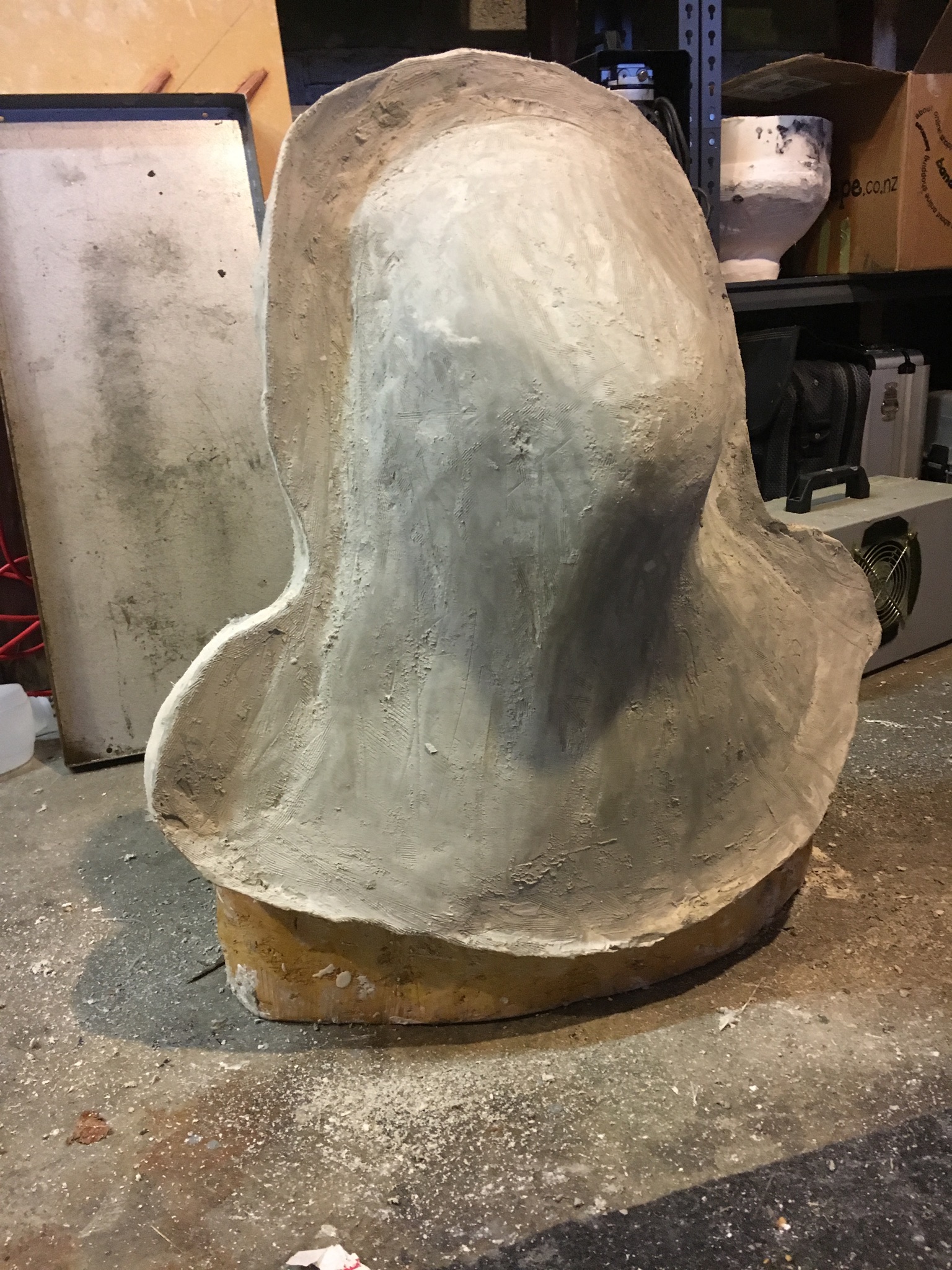

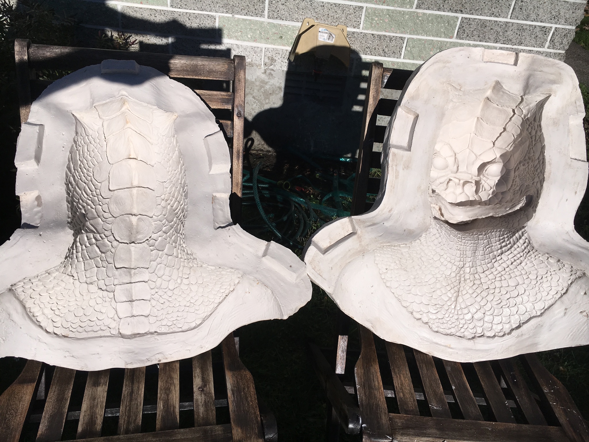

All finished. Now to demould and clean out all the clay.
I’ll do a small test pull for fun and then cast the jaw area so i can begin working on the teeth.

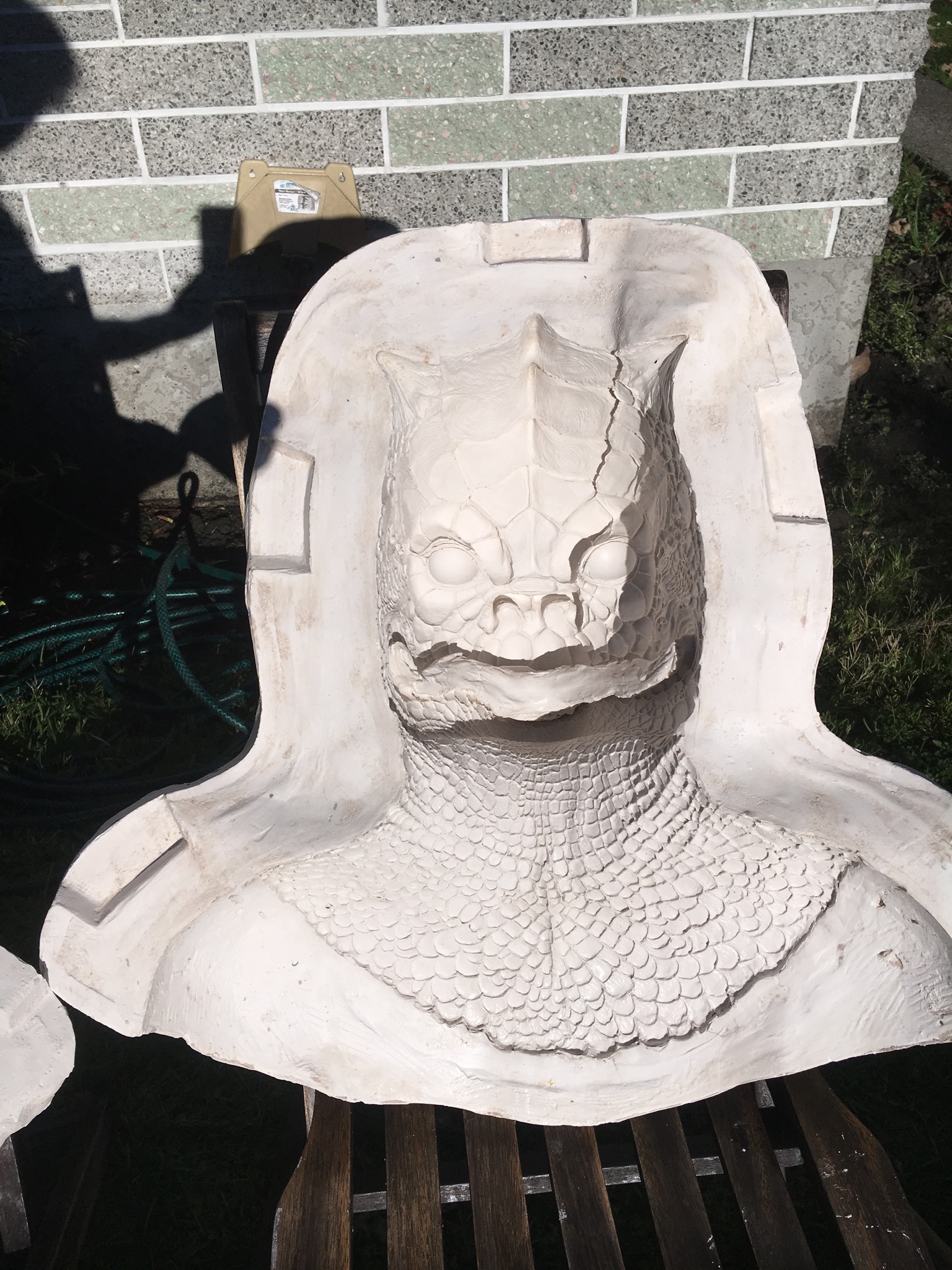

Soon I can begin on the jaw and teeth area and it will start looking more like the Bossk it’s meant to be :)
Well here’s the first test pull, this one is a bit orange and not Bossk green
