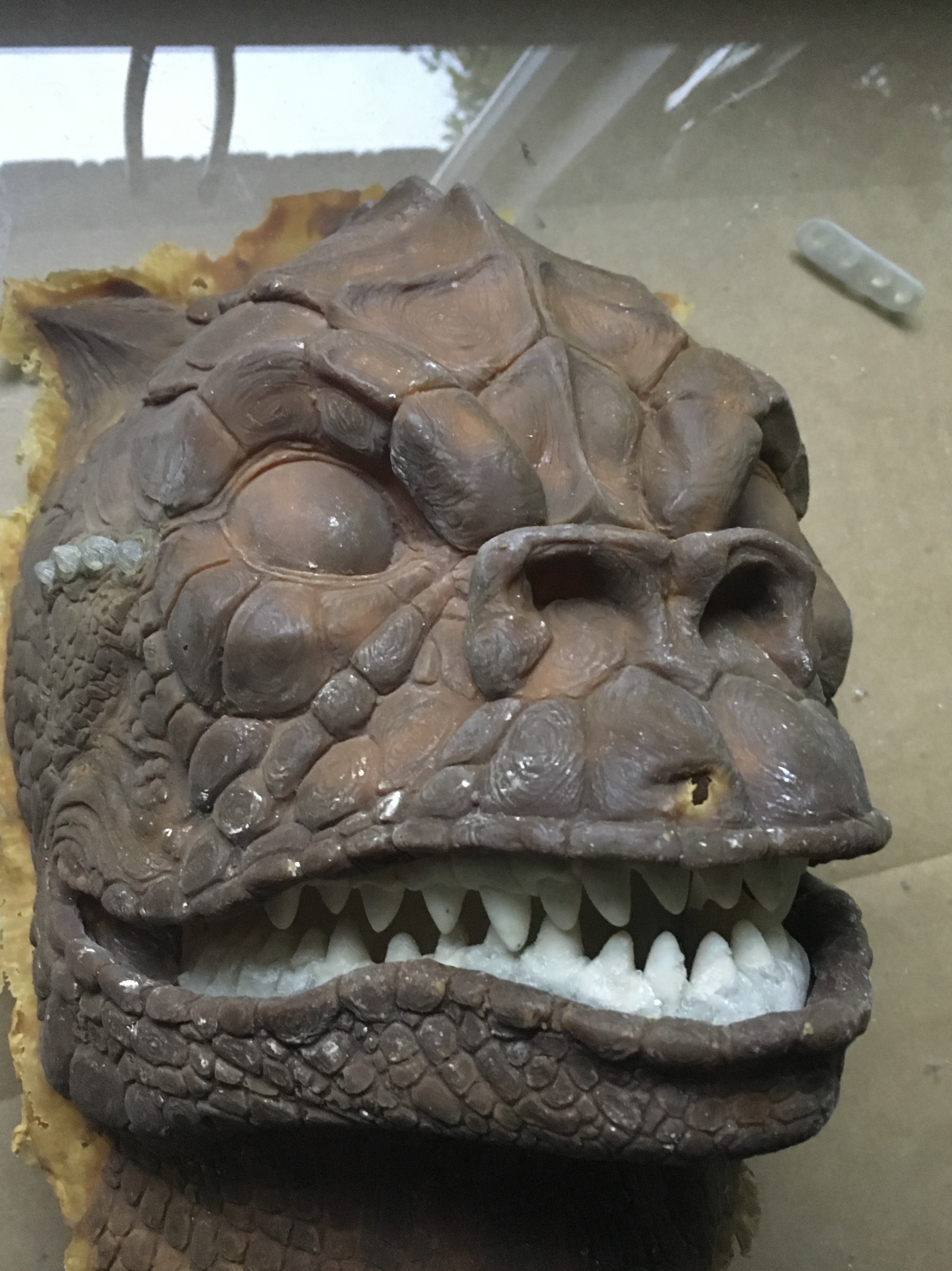

Just a very quick paint up on the test pull with some teeth glued in for effect. The eyes are just cutouts on this I’m not worried about finishing this one off completely as said just a test...

Thank :) this is just one I’m playing around with, I personally don’t like the look of it yet, second pull will be better and I hit it with my airbrush instead of paint brush so the colour will be more accurate.

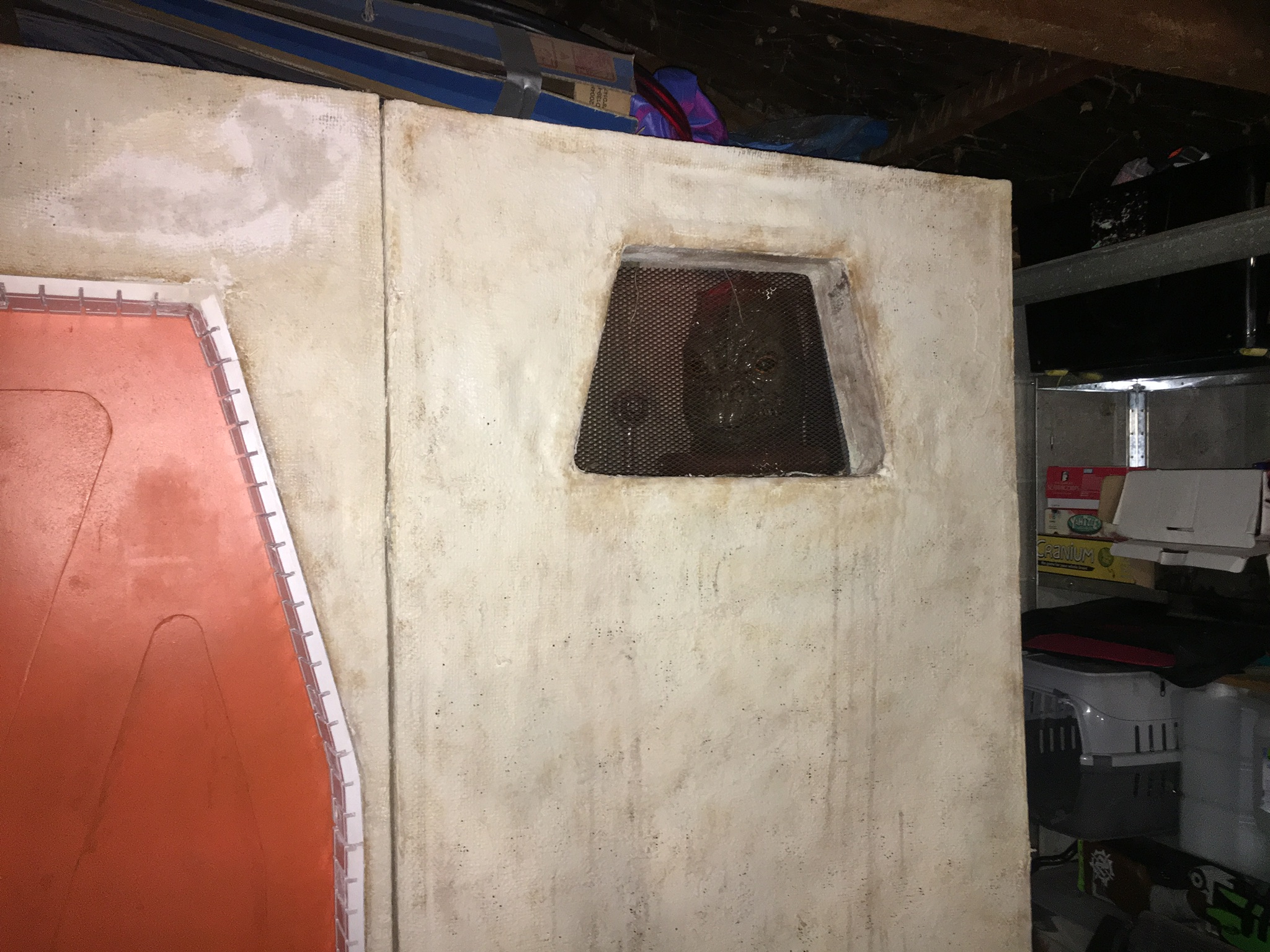

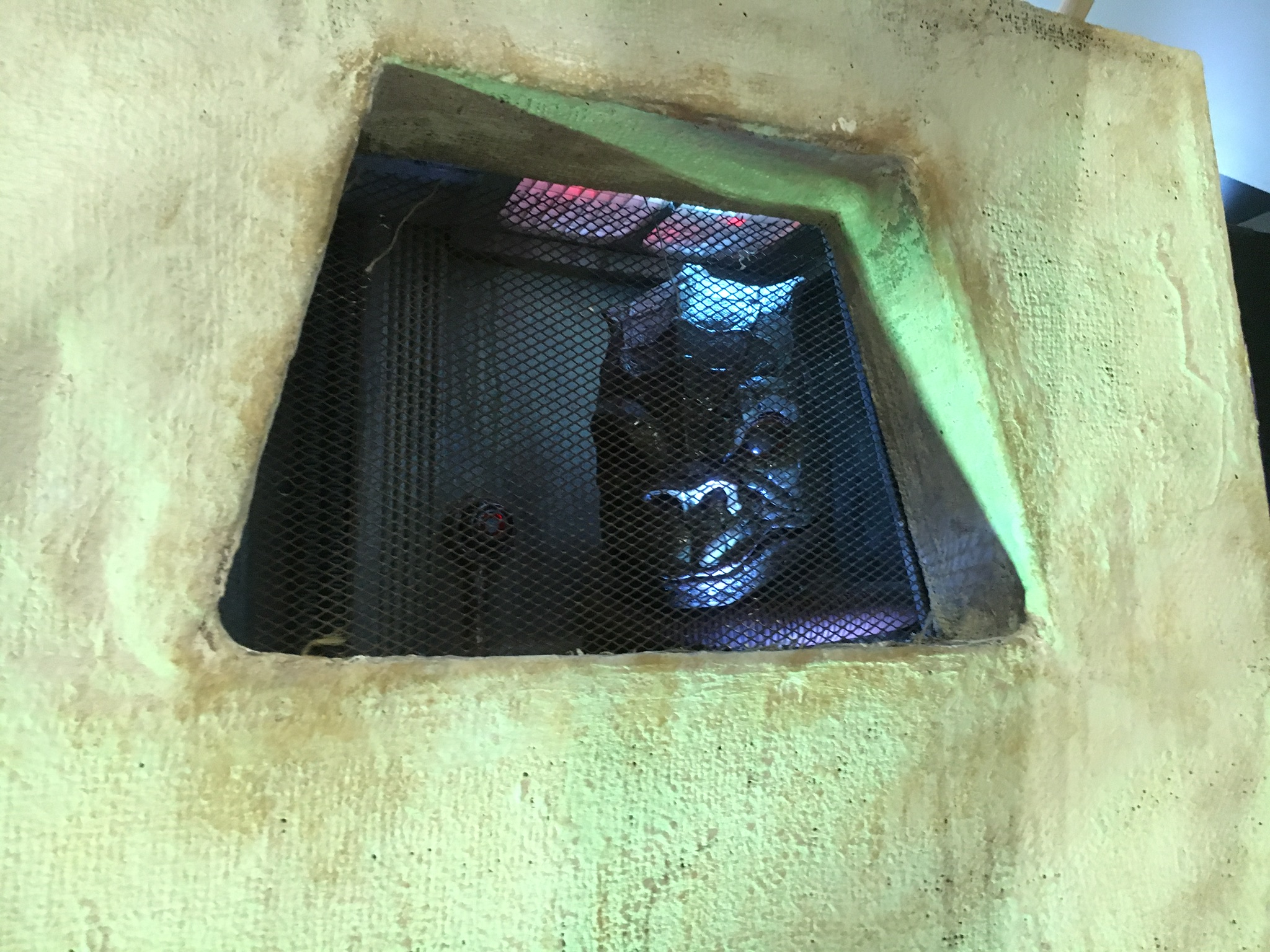

Setting up my test mask to hidout in a local 501st outpost display for a weekend Con. I have been helping out getting it ready and Bossk just adds a nice touch. Should look great all set up...
Here’s the test fit to see how it looks..
In place and ready to watch the crowds...

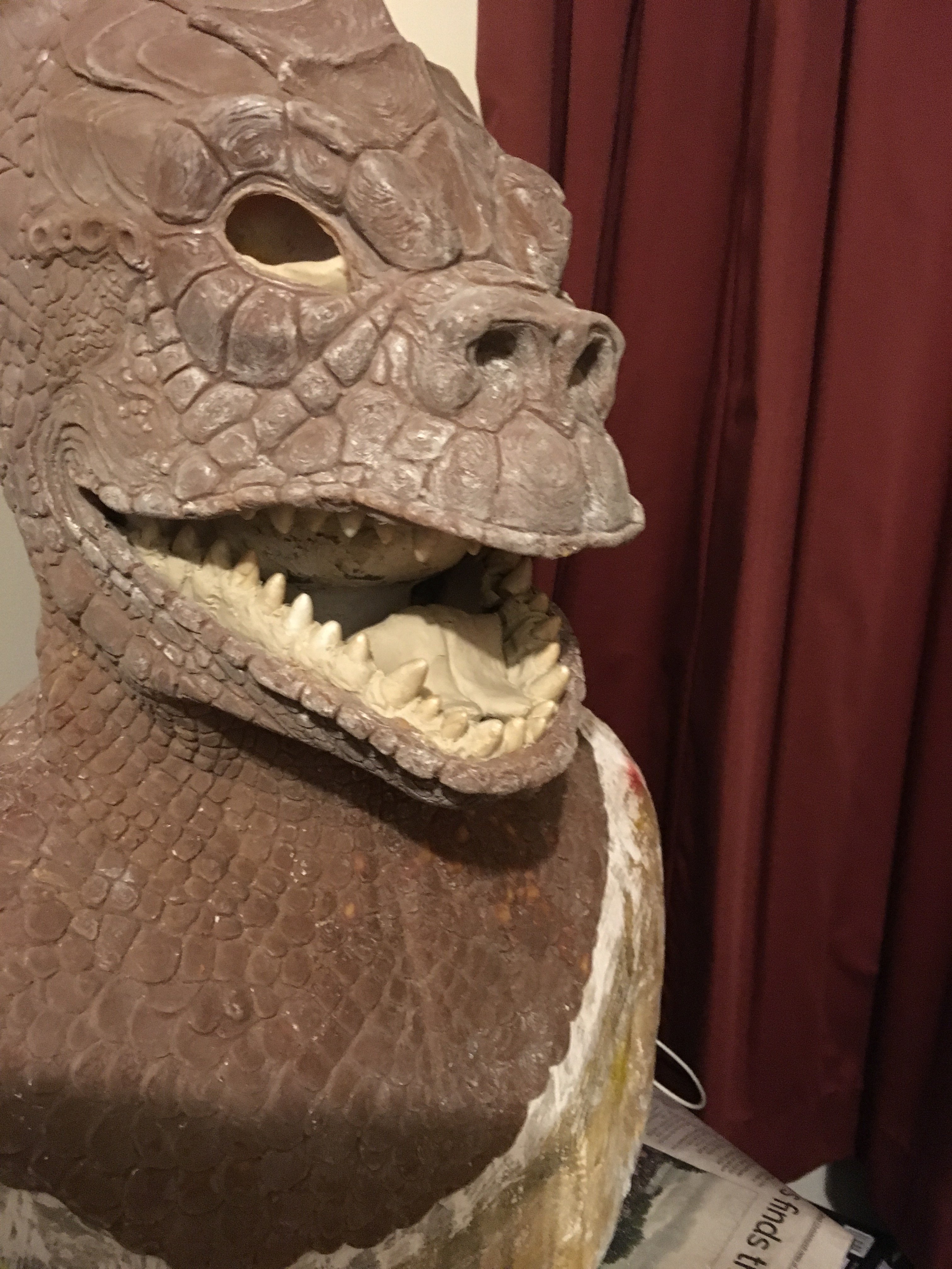

This has been on the backburnner for a wee while, so I thought I best crack on with the final faze... the mouth.
I have gone about this a bit backwards and it’s proving to be a tricky pain in the @#$ . getting this to sit how I want is frustrating... but I. Being persistent and I’ll get there in the end....
Just working out the right shapes and teeth layout. I have done a quick tongue to see how it looks... not too bad so far, for all the frustration it’s giving me... :-)

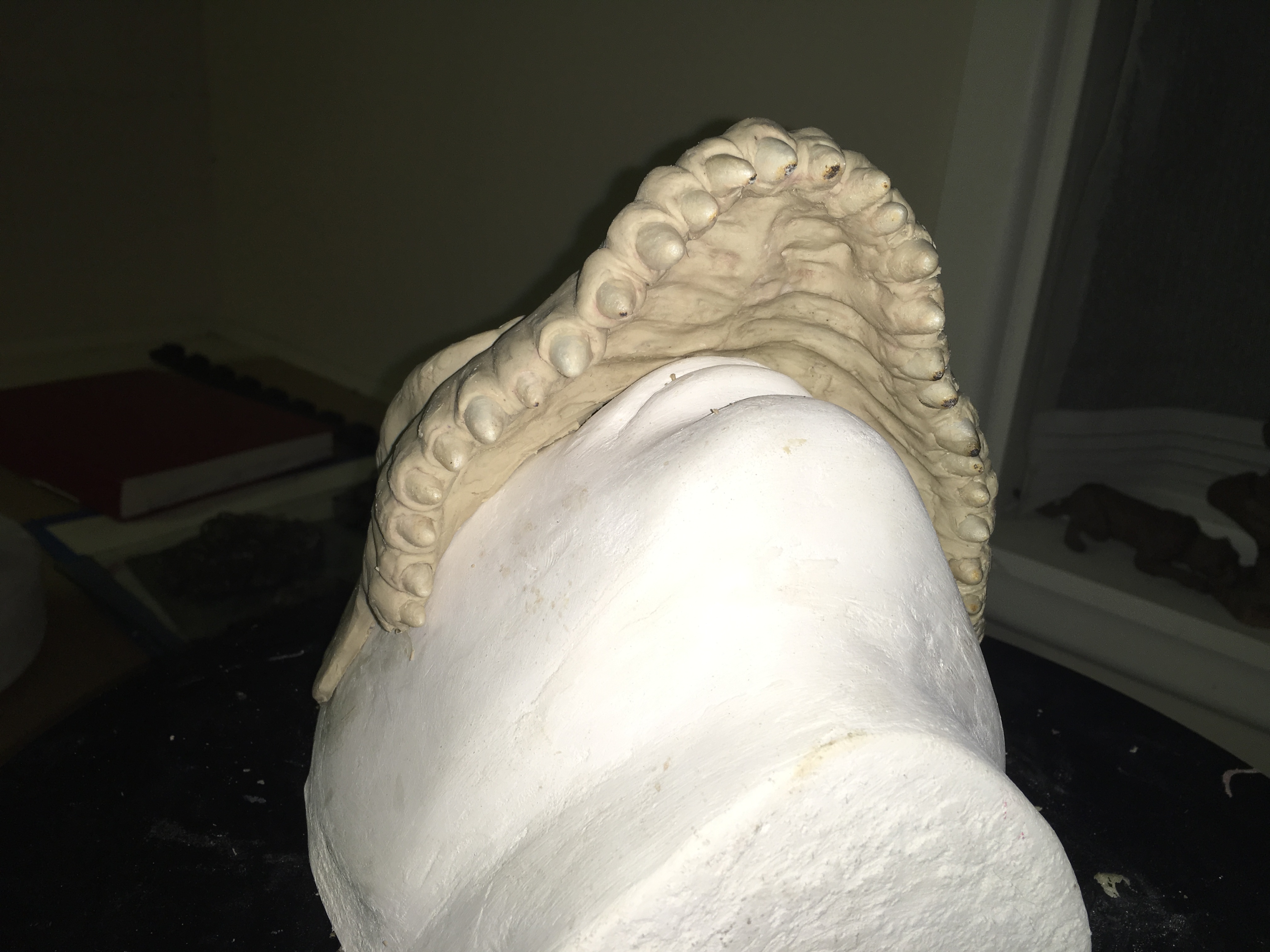

This has been on the back burner for a while. Work, workload has been keeping me busy; but now i must complete the last additional details and work out the last of the mechanics for the jaw...
Reverse sculpting the jaw and teeth has worked out to be a headache... And I accidentally brock the lower jaw... serves me right for using too soft clay:cautious:
So lower jaw has been put to the side and i have concentrated my effort on the upper jaw. Once I’m happy it will go off to my moulding room to be moulded and cast...then using newly cast jaw.I’ll redo the lower
....sometimes i hate being a stickler for detail or near perfection:confused:
Almost ready to mould..

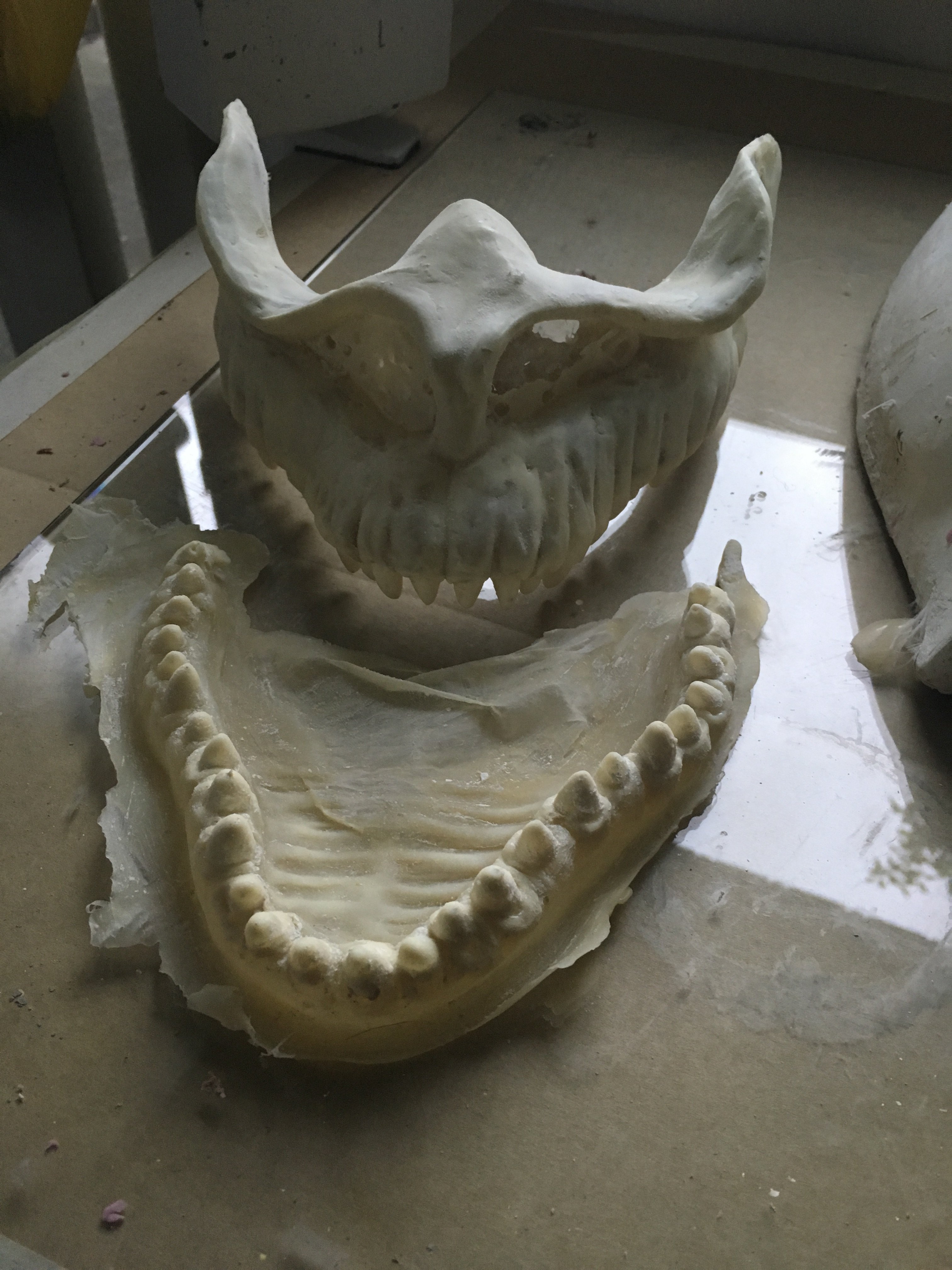

Who would have thought the teeth placement was so specific....
the first set of teeth i made were completely wrong, I made them to long, thin and pointy. This is not the case though as they are mote rounded on the screen used mask. It’s nice to see they put those extra details in for a background character in the canteena.

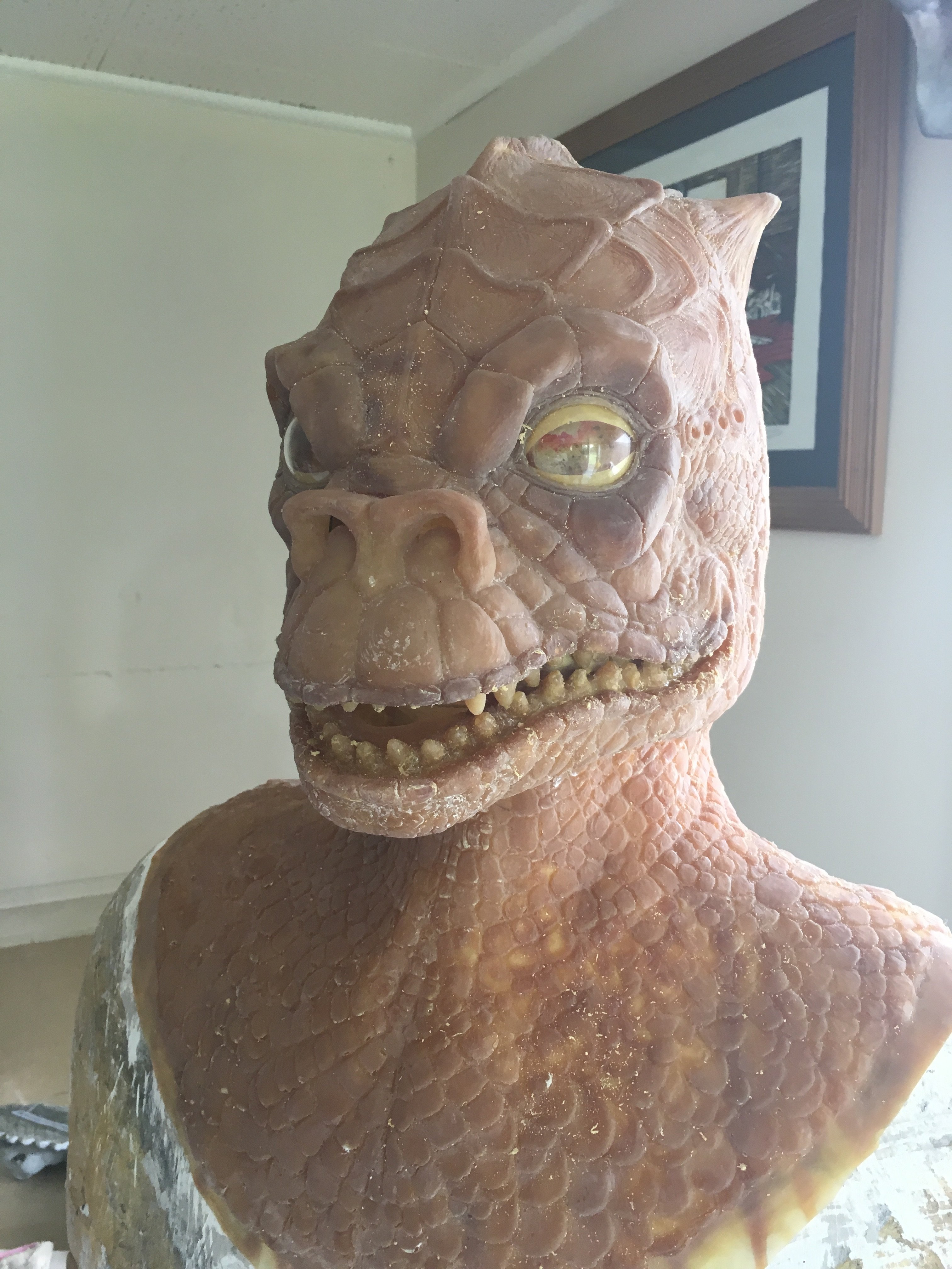

I have tweaked the colour of my latex mix, and am a bit happier with the result... a more closer to Bossk and not as dark as my previous mix.
I have done some work on the eyes and the inserts. Previously they were glued in, now they sit happily in a pocket. Which makes them look tidy and is easy to take them out an insert new lenses....

And I threw some silicone over the upper jaw I sculpted (in the too soft clay) and cast a prototype to see how it works and give me something solid to sculpt the lower jaw against.... then just for the extra work I took a casting of the teeth in plaster, so I can do latex pulls as latex has issues drying in silicone moulds. It dries but at a v..e..r..y slow rate...
