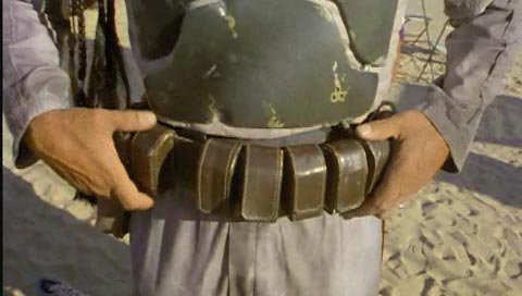

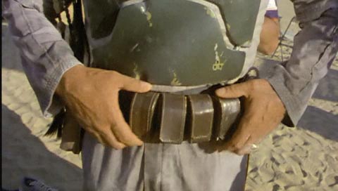

Not that I'm trying to make a case for smaller pouch heights...but Jeremy must have big hands. :) Check these grabs from the buckethead movie. For me to grip my 4" high pouch like that is just about maxing out my range, and I've got 4.5" from my first knuckle on my pointer finger to the "v" where my thumb meets my hand.
Each strand of the girth belt is 5/16" tall. The total height of the girth belt (14 strands) is 4-3/4". There's your scale reference, look at Brak's pic and do the math.
