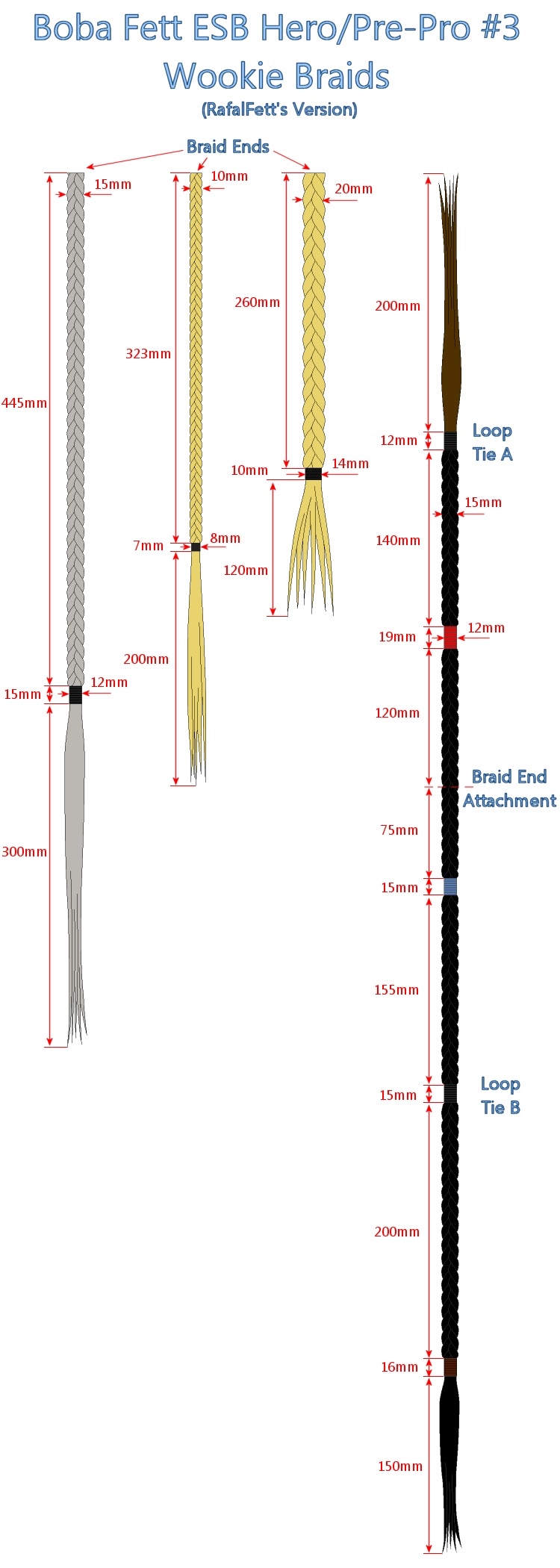

In this I used Rafal’s measurements from this.
Everything is in MM and Americans don’t know what that means. But alas there is the internet.

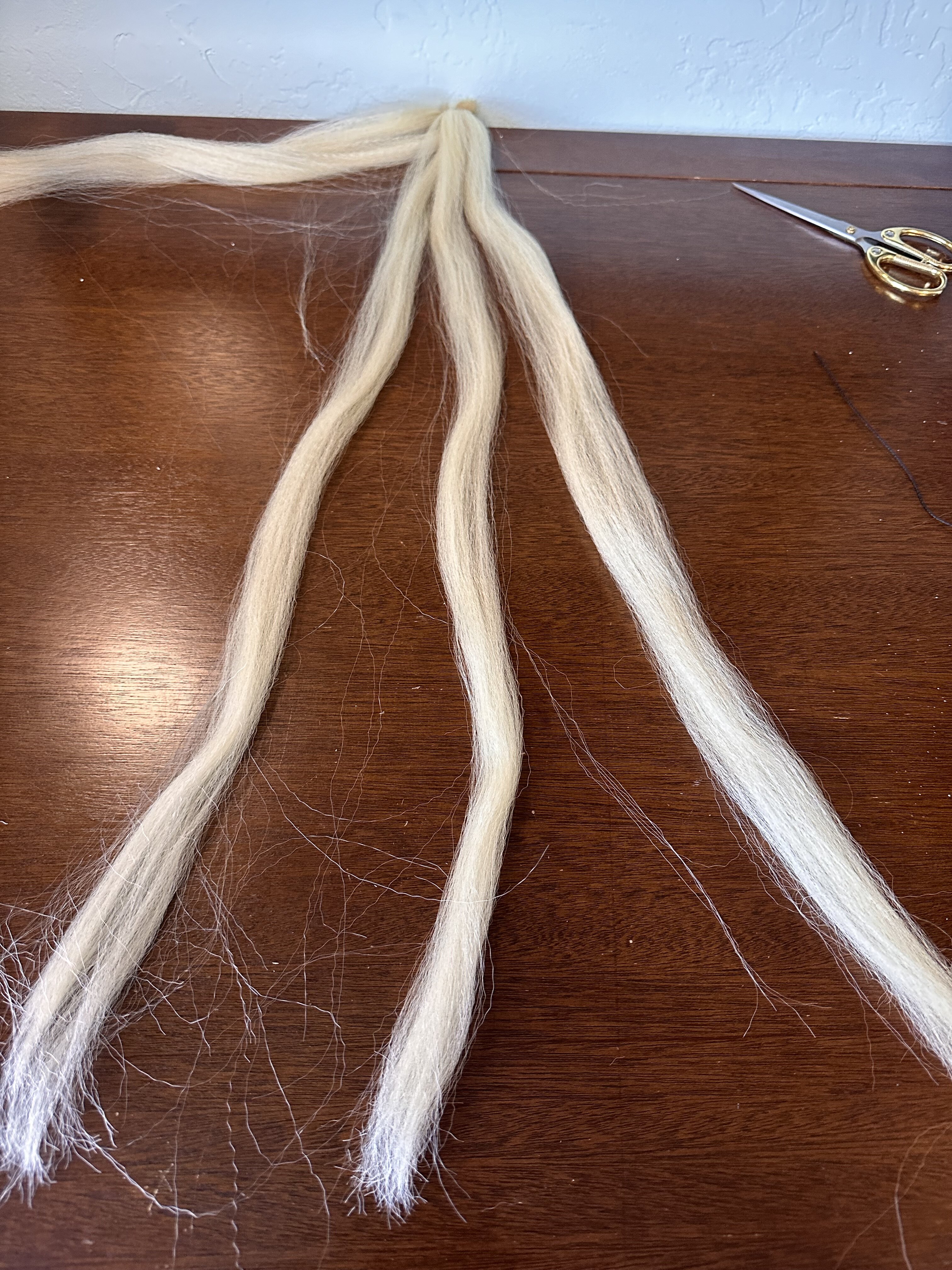

Before starting I rinsed each extension set in my sink with apple cider vinegar and warm water. I learned this from a YouTube tutorial. There is an alkaline on synthetic hair, also the wet hair is easier separate to size than out of the package dry hair.

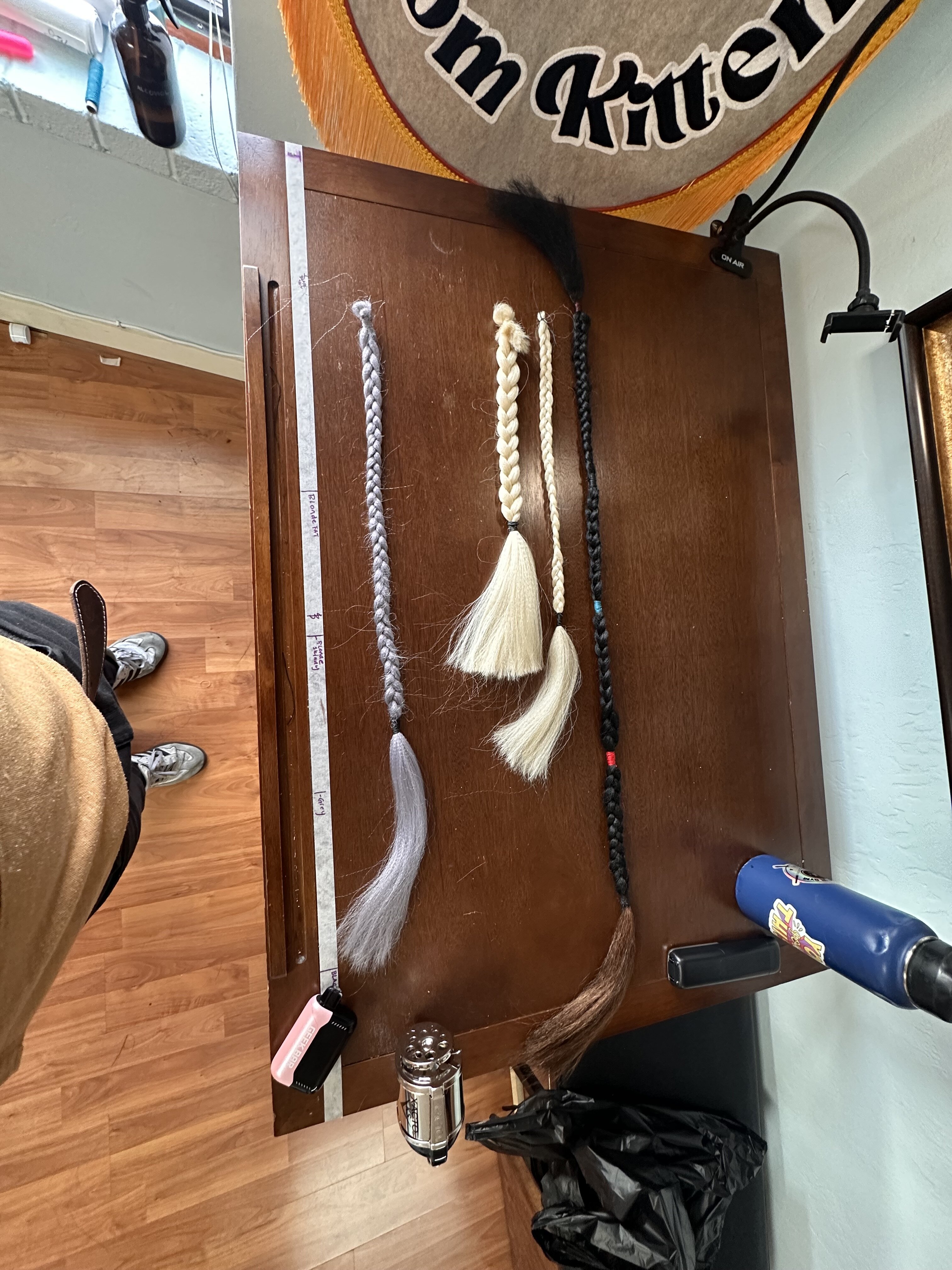

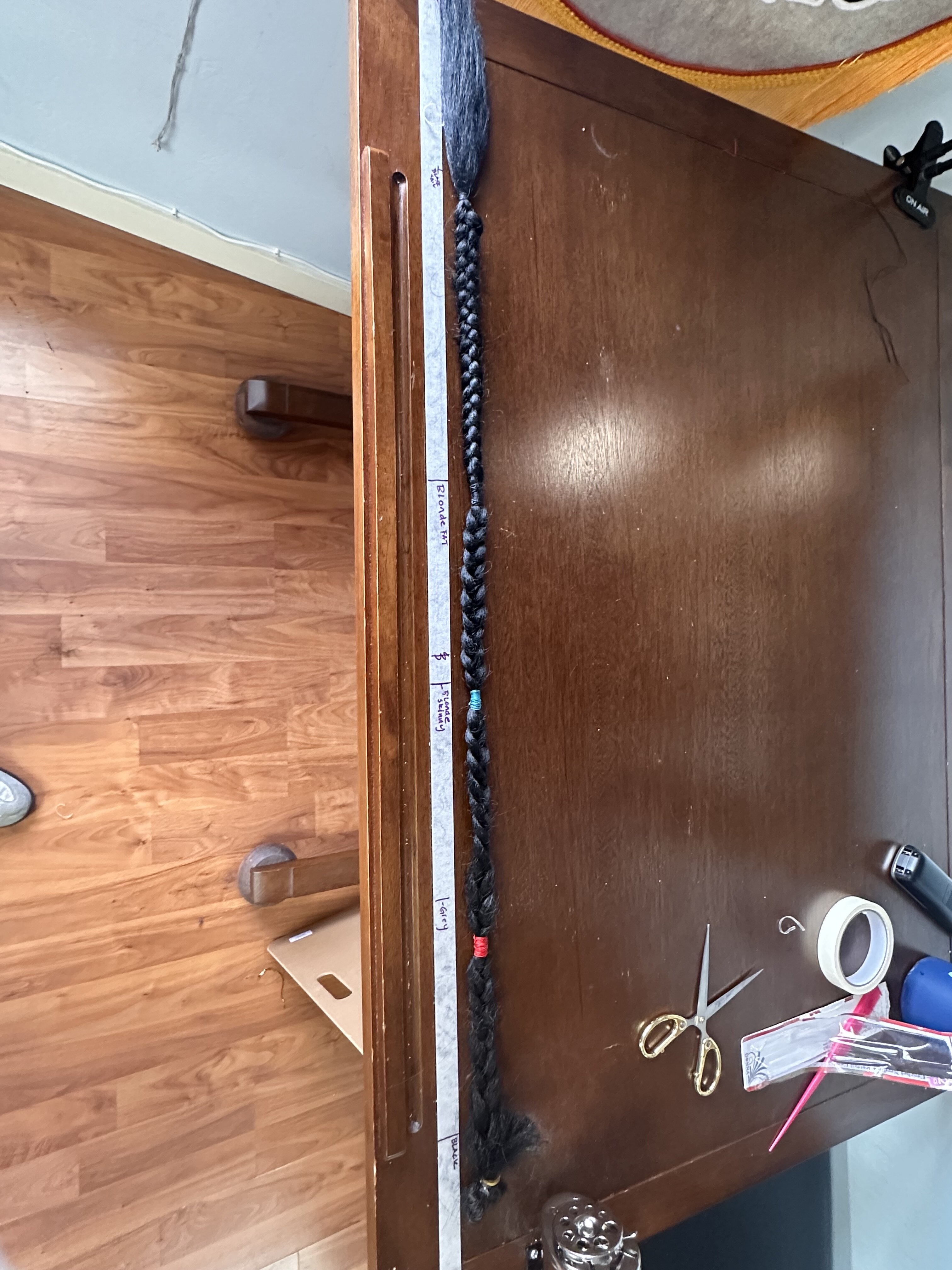

Then I found a workspace and laid out a piece of tape marked with the measurements Rafal createdIMG_3540.jpeg it looked like this.
After this photo I also made a vertical one with denotations for where the ties would be and the length of the ends.
The black braid was the full extent of the extensions so I had to separate them (the grey and blonde I separated still attached to the rubber band of the extension set.)
So after I separated them I used a small rubber band at the ends to keep them nice and together with less worry about the loose strands getting all tangled.
Then using tension at the back of my drafting table I braided them (braiding is easy, and there are TONS of videos of different ways to do it. I’m not sure if in the 70s they used a specific method, but I imagine they just did it the normal way)
::Note:: on several reverence photos I have seen that (especially) the thicker blonde braid has some uneven twists in the braiding, you can achieve this by twisting the strand in the other direction and changing from looping over the center braid to under it for that braid. It pushes it out to the side a bit more and skews it. Then just continue back to the way you have been doing it.
Ultimately it looks like this.

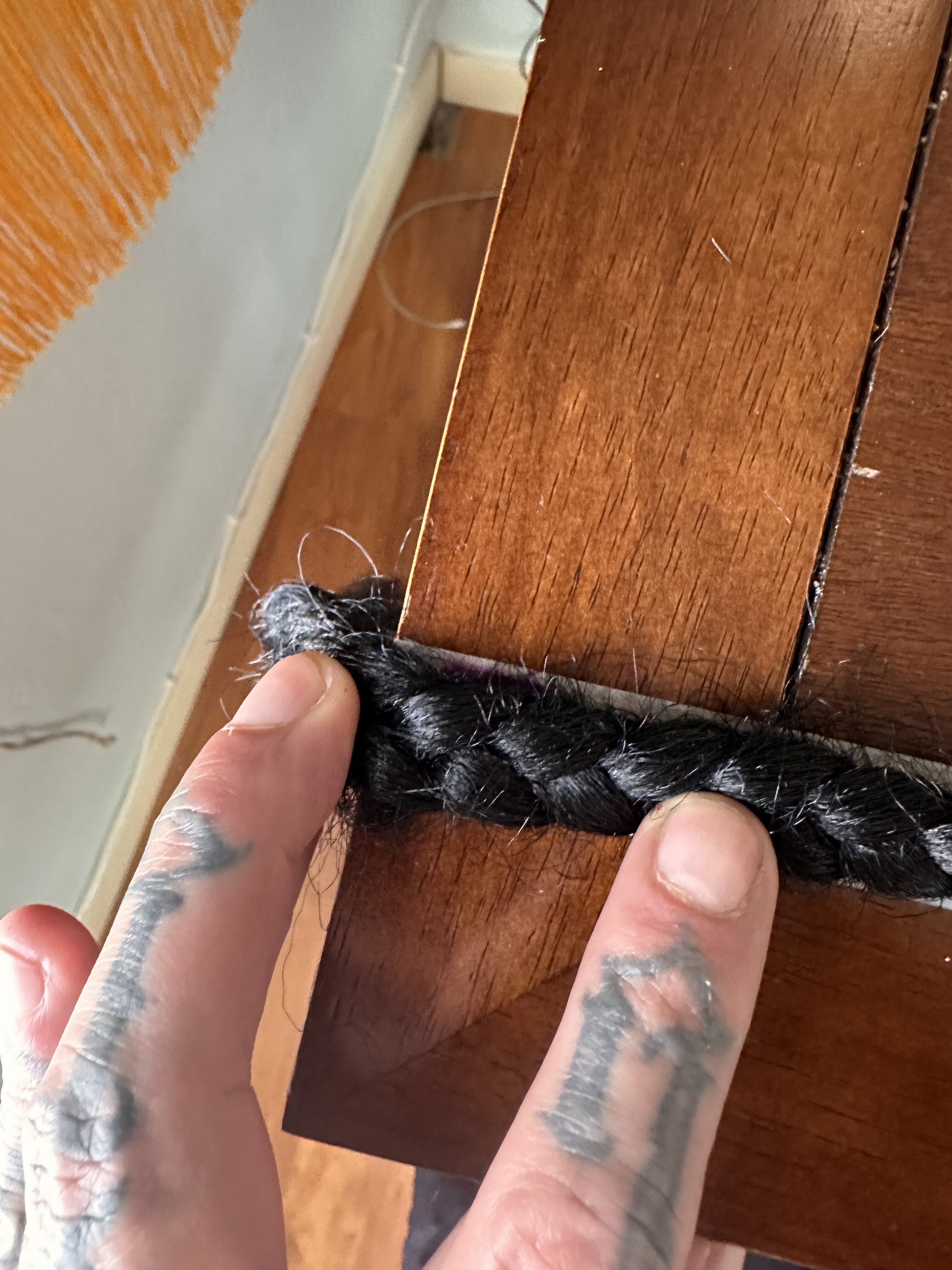

IMG_3543.jpegThe thickness was achieved doing a little test with some clips from the brown hair, since I didn’t need all of it. It is 15mm pretty evenly throughout
Another note, give your self about another inch or so over the correct size when cutting your braids, you lose length while braiding so if you measure EXACTLY before you braid, you will ultimately fall short.

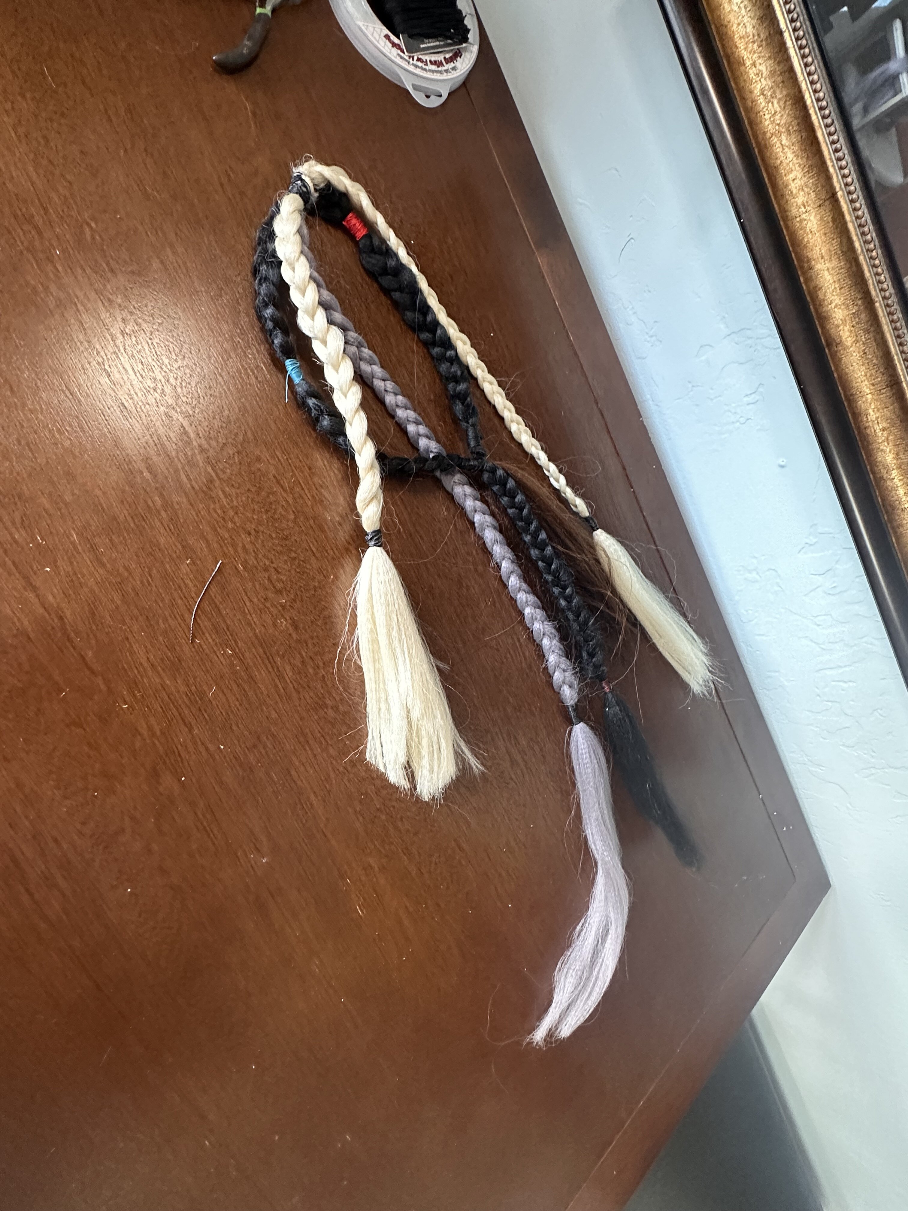

Anyways, at the end of it all I attached the length of brown hair to the other end of the black with a few simple ties, then attached that with more sturdy tie to the other end of the loop, of the black braids. Then used a bit of fishing line and black cord to secure everything together.
Using a bit of Got 2 B hair glue and wax, I smoothed out the loose ends.
Later I will probably take a curling iron to the silver to get that whole curly-cue thing everyone loves.
