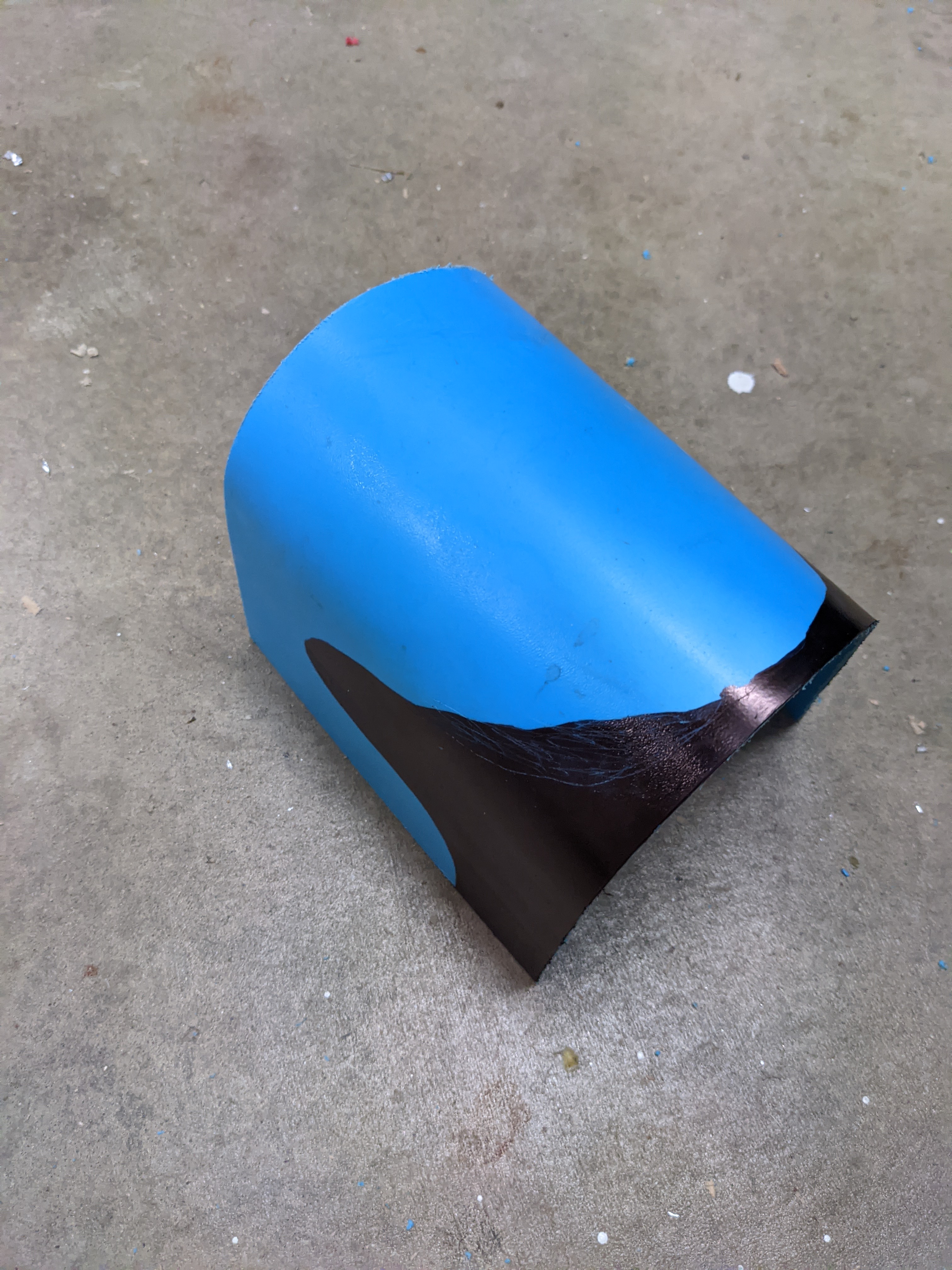

A failed attempt at knee armor:
Day 1:
I started on the knee armor. The rough plan for all of the armor pieces is as follows:
  1. Heat form a plastic base for the shape
  2. Cut out the piece
  3. Form a piece of leather to match
  4. Glue the leather to the plastic
  5. Trim the leather to the edge of the plastic (maybe I'll try to fold it over the edge?)
  6. Clearcoat?
  7. Paint/weather

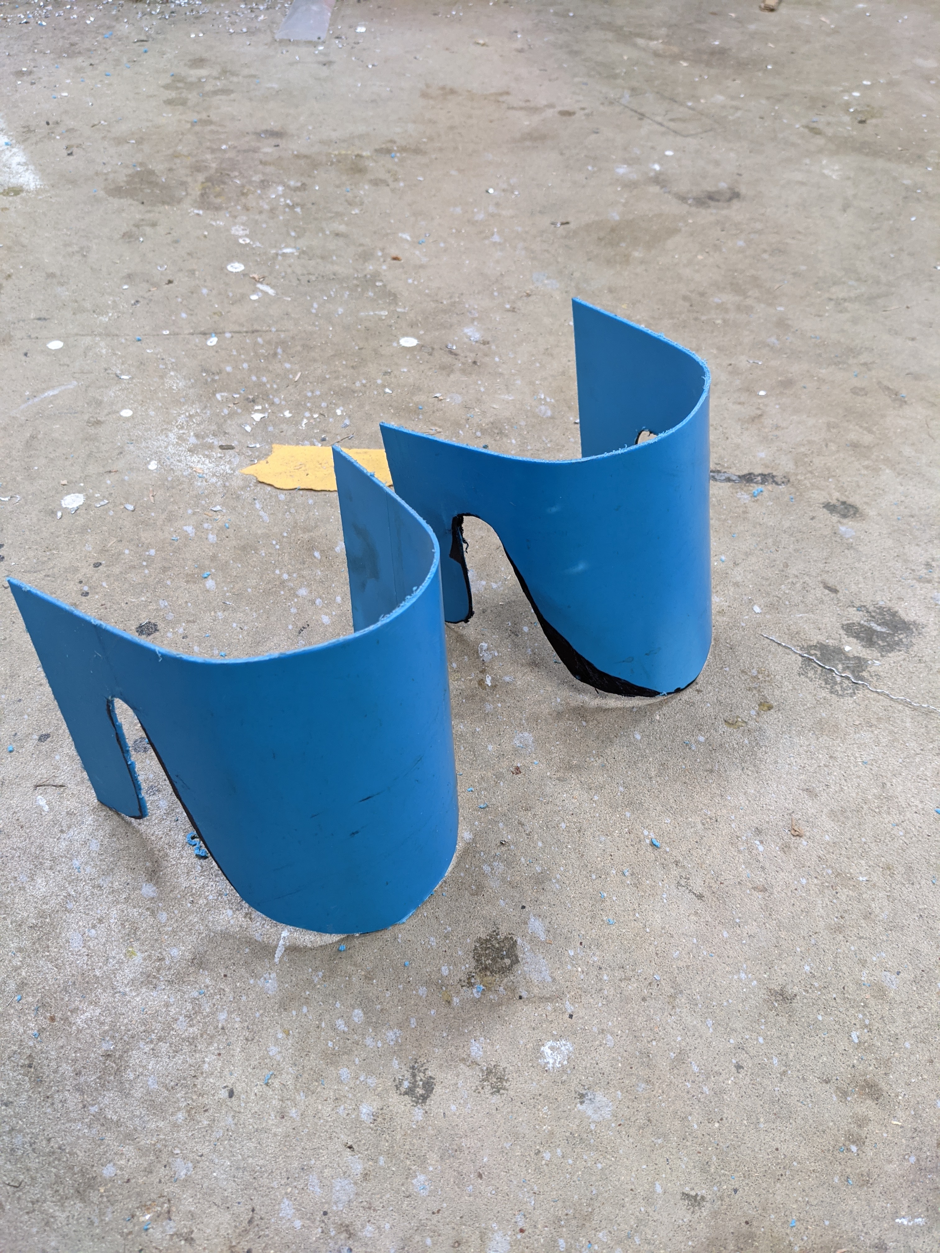

I cut some plastic out of a sterilite container and formed it with a heat gun on a PVC pipe. Then I took it to the band saw to make the edges even-ish and split it in half-ish:
Then I looked at the 501st front and rear references and marked out how I wanted to cut one of them. (I messed up so I also scribed in the sharpie where I wanted to be):
Cutting time:
And then there were two:
(Yes, I know they aren't symmetrical. I don't think anybody will notice without seeming really awkward...)

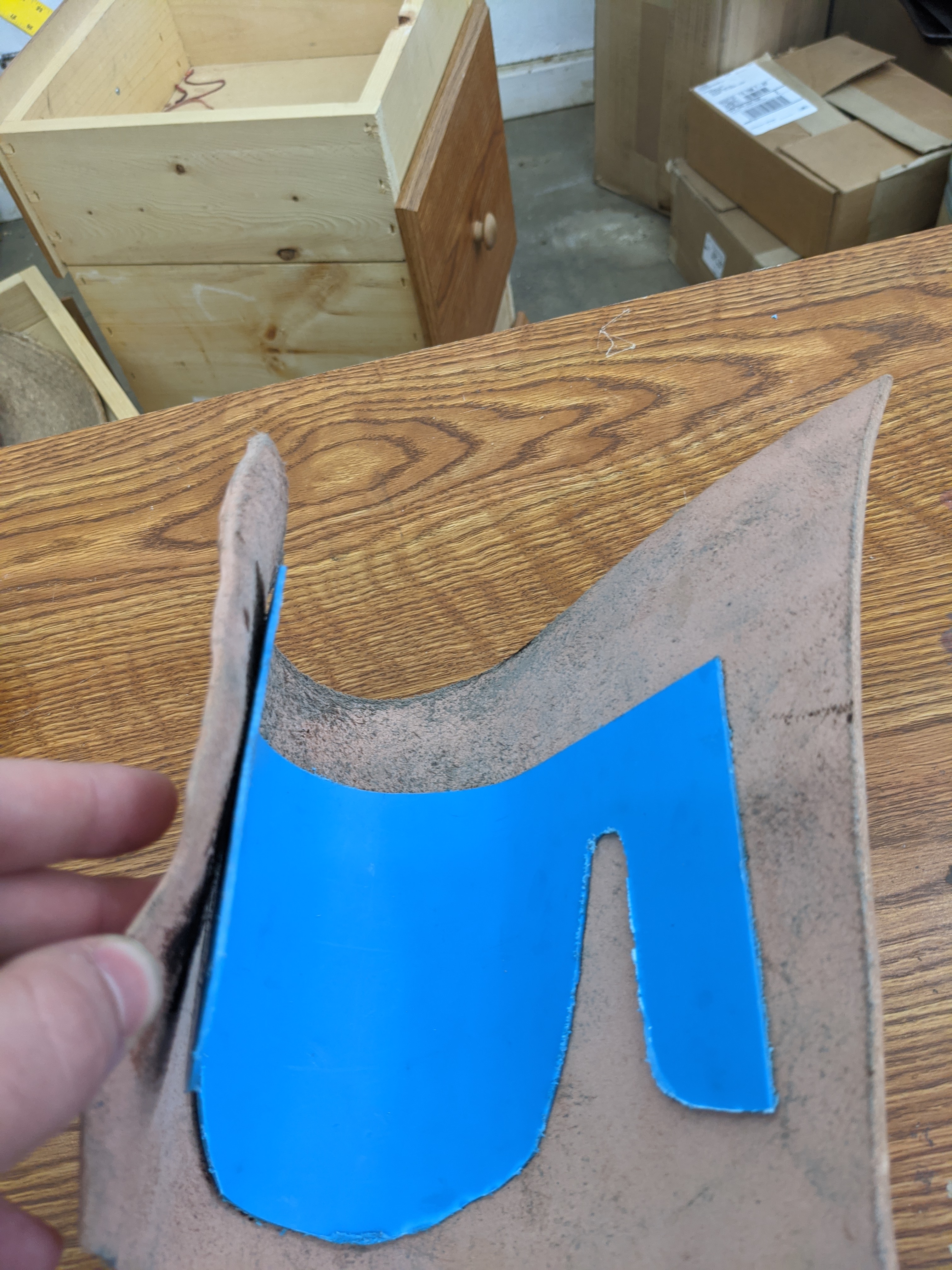

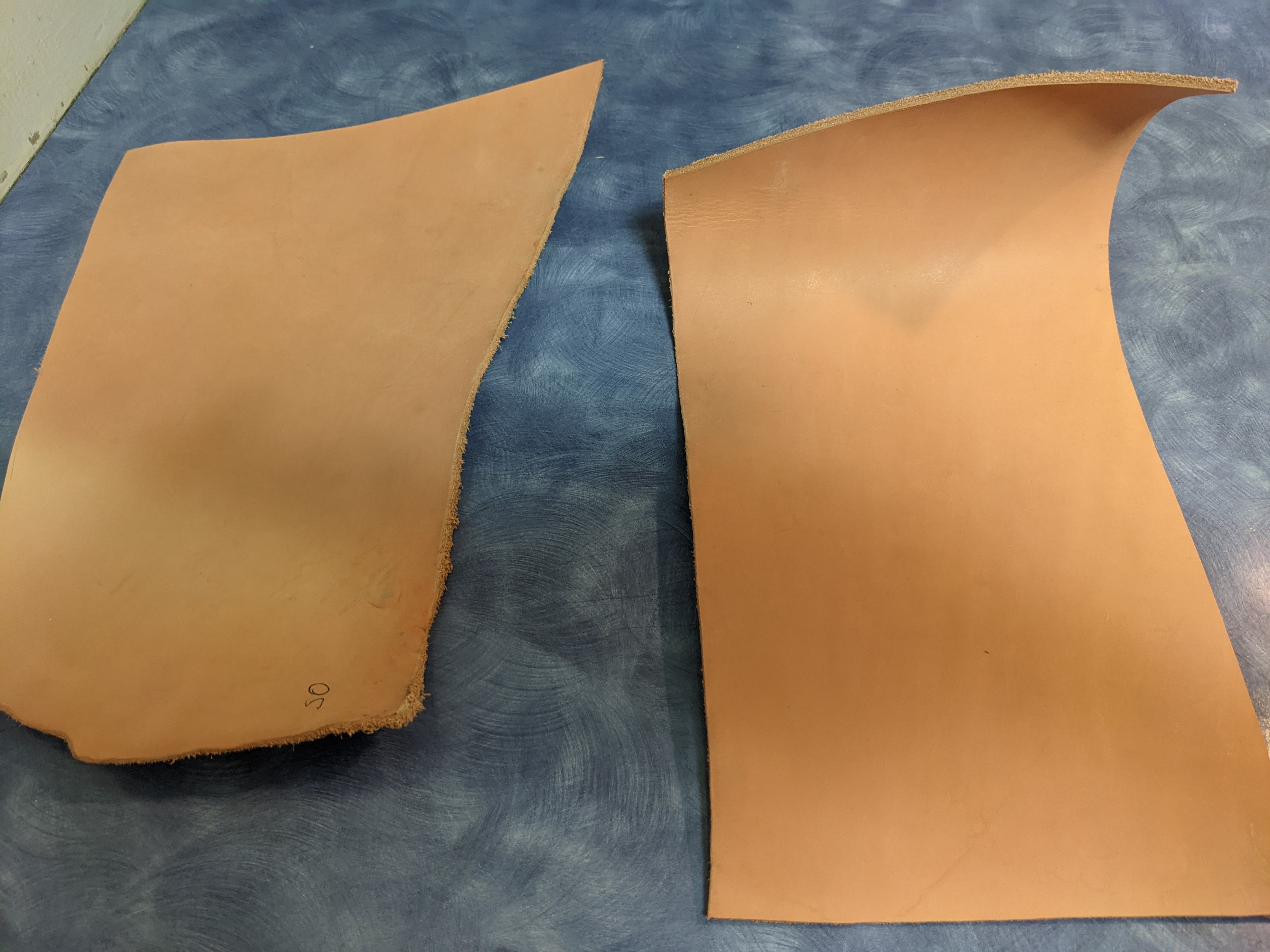

I cut out a couple pieces of vegtan cowhide:

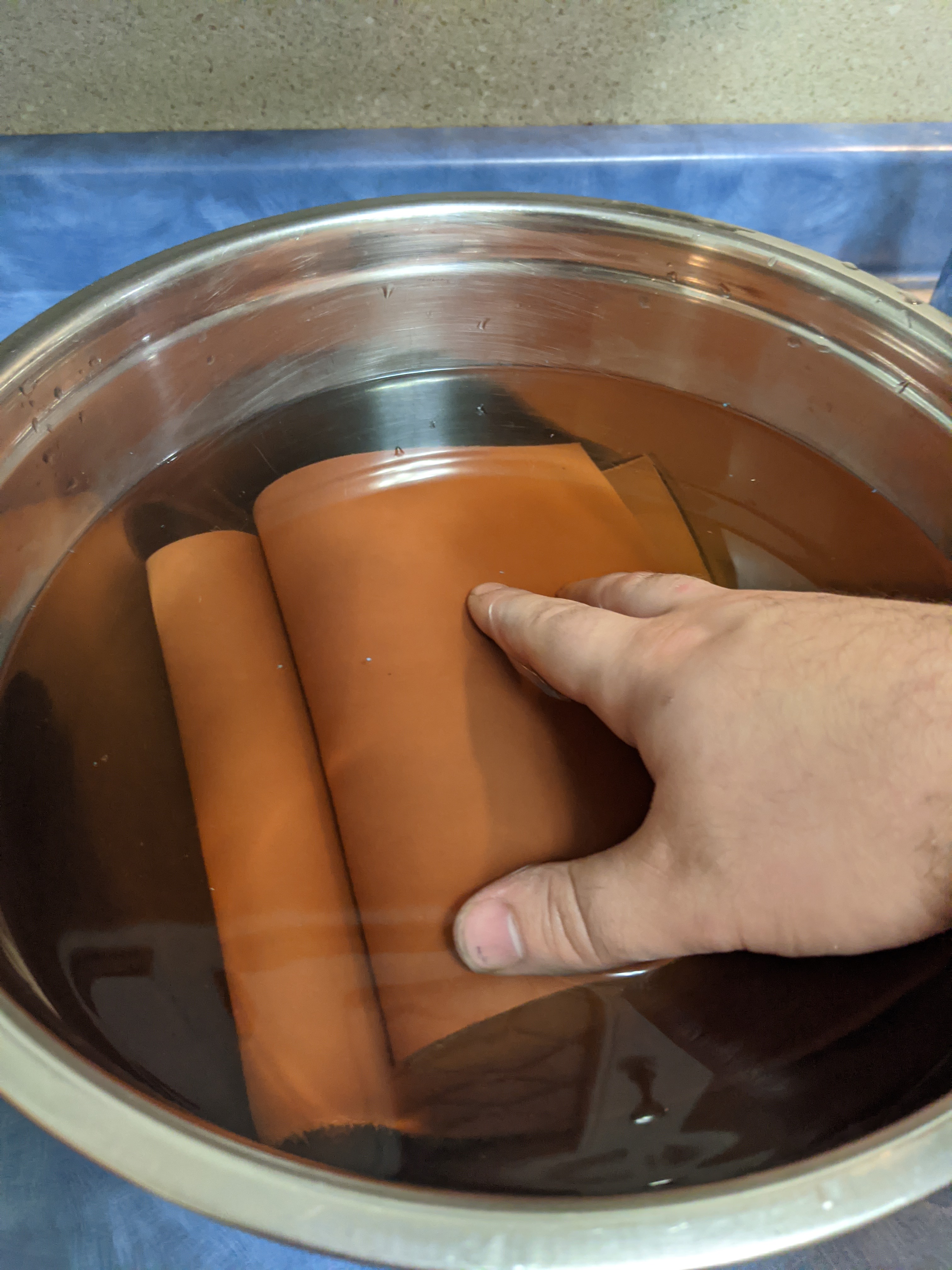

And then soaked them in hot water for five minutes (just hot from the tap, no boiling or else it will become extremely brittle).
Note that it will start to fizz when you first put it in. That is the air escaping and for some reason it becomes way more pliable and when it dries it will retain its shape.
(I had to hold it below the water level)

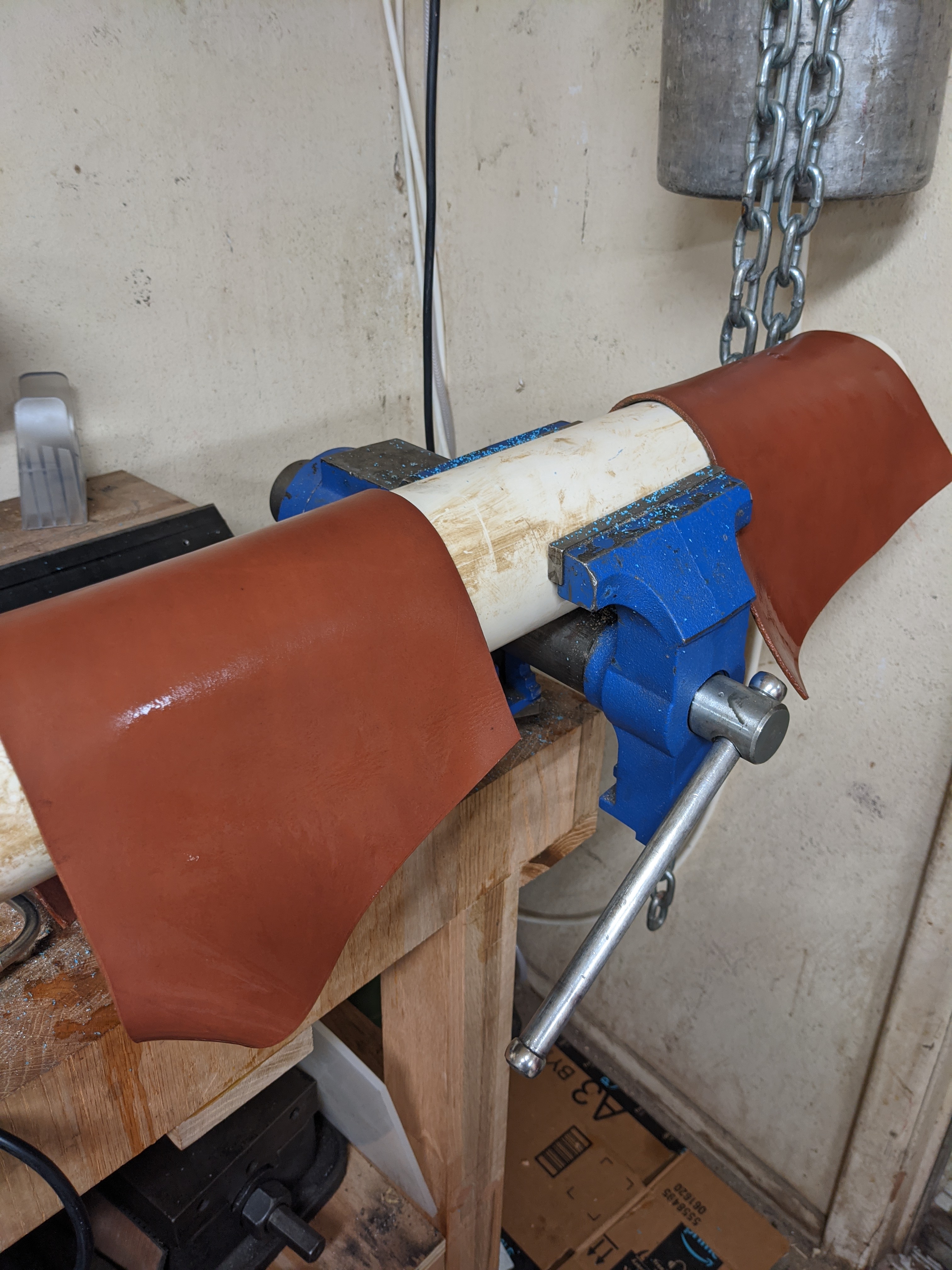

I then hung them to dry on the same pipe as before:
Now I need to wait overnight and then tomorrow morning I can glue the leather on. Once I get the knees to the point where I have a metallic base coat, I will start forming the plastic for the rest of the armor.
I'll take any advice and/or constructive criticism you throw at me!

You may have problems getting paint to stick to your sterilite knees. When I was making my Fett, I went to a local sign shop and was able buy scrap PVC sheet and some styrene. They often just gave me stuff. You can heat and form it. I takes paint well, you can sand it add bondo...
A sign shop is where I got my sintra back in the day when I made my scratch build. They sold me some small pieces for just a few bucks.
I didn't think to sand the plastic before trying to epoxy the leather on.

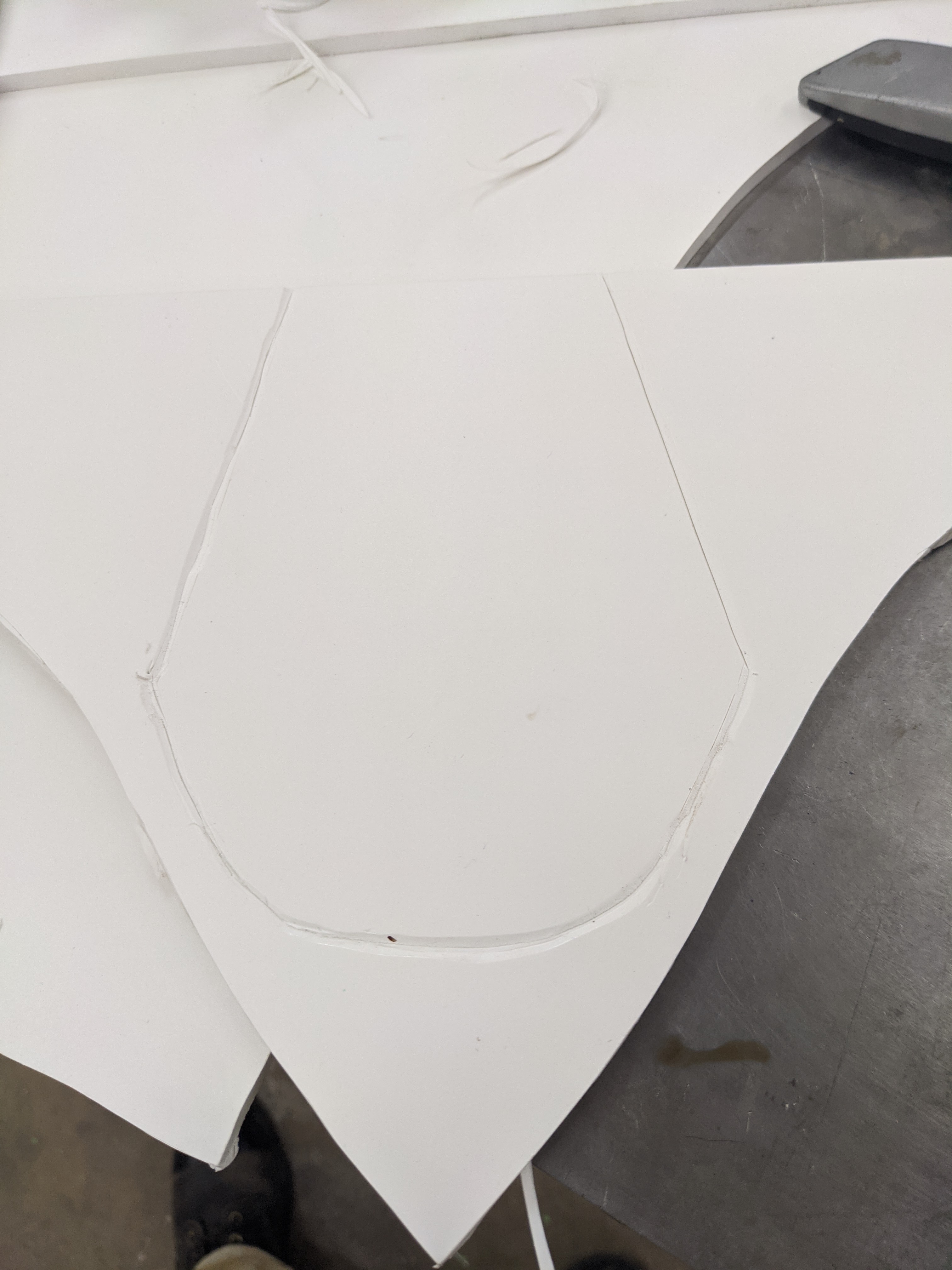

After that failure, I did some research on sintra and it seems that it isn't that different from normal foam core from a craft store so I grabbed a couple of sheets at hobby lobby.

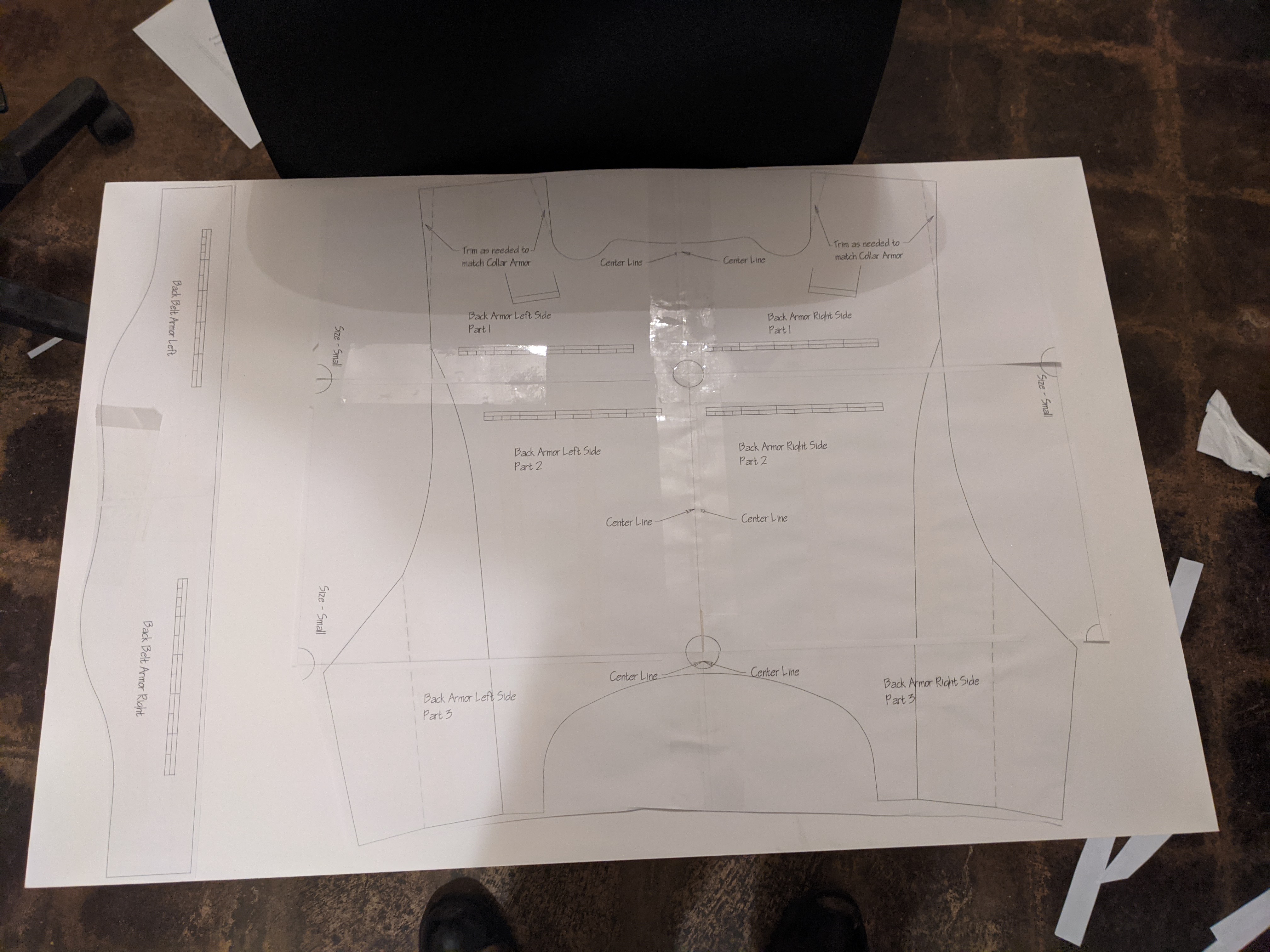

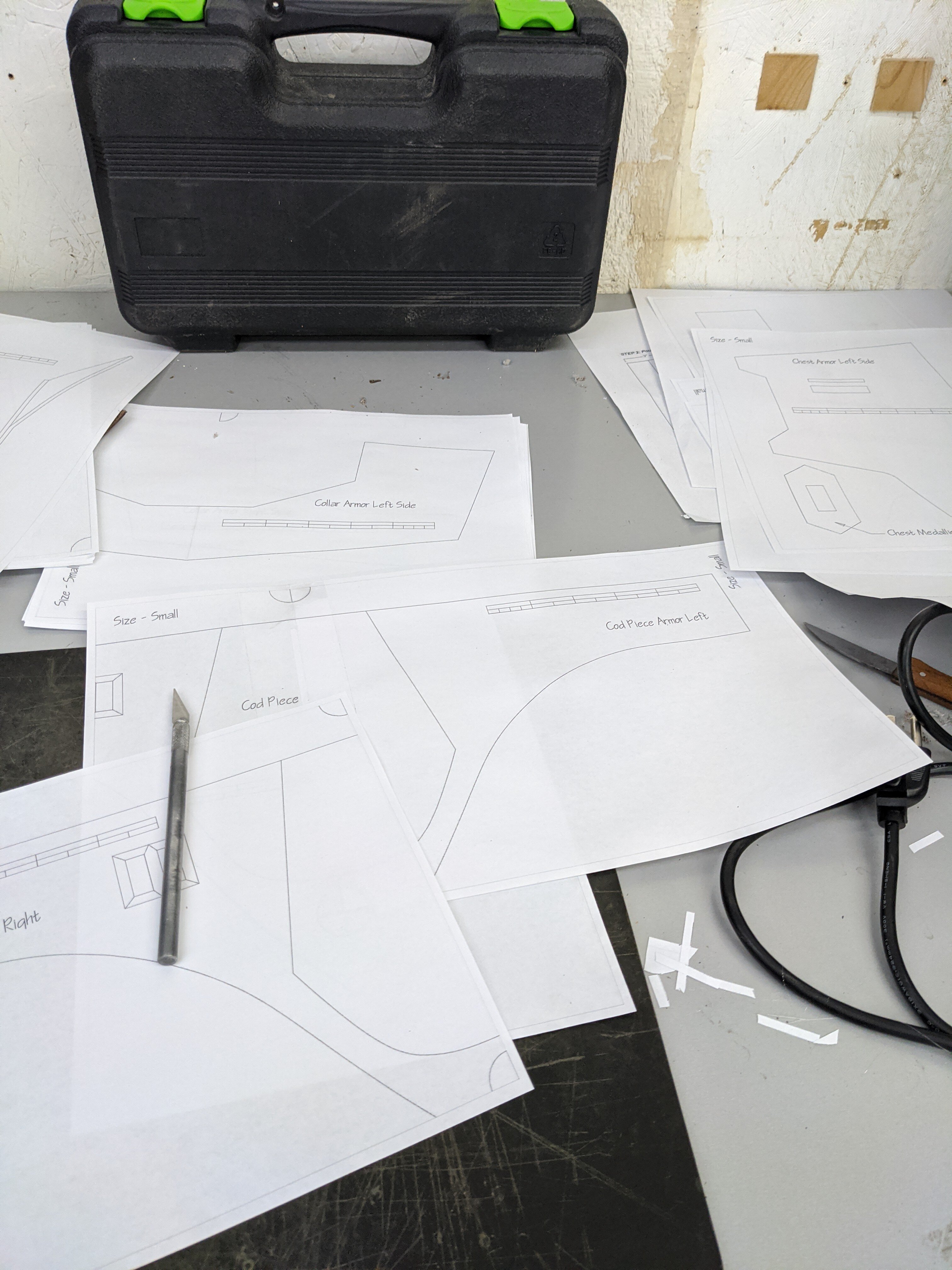

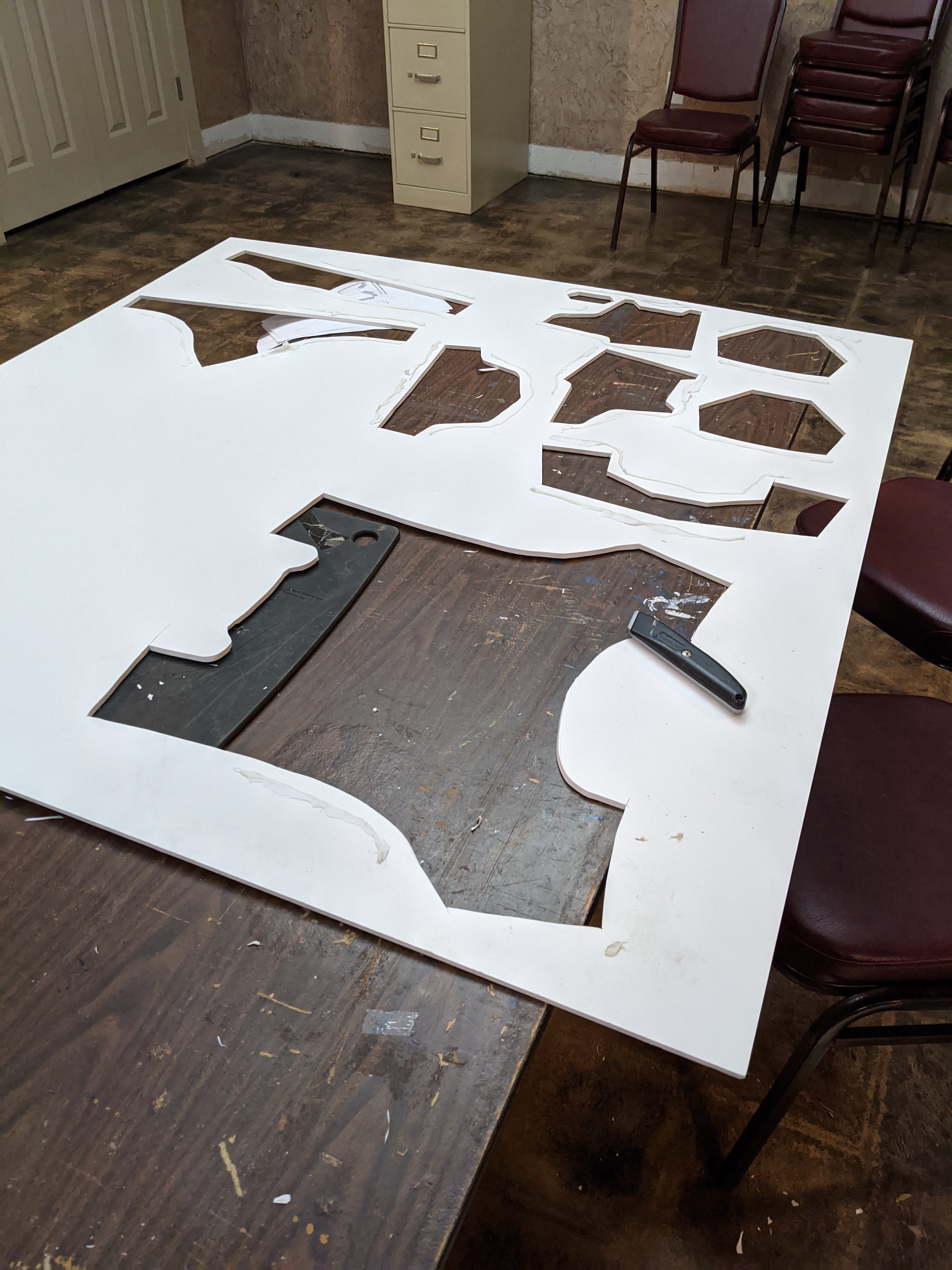

I printed the wizardofflight templates for the armor and spliced/taped/mounted it all onto the foam core:
It's getting late, so I'll pick this up tomorrow. I'll cut them out and start heat-forming them.
I only got two sheets so I don't have enough space to fit the knees. But that's okay though because I don't understand the templates yet.
Foamboard has a paper exterior while Sintra board has a PVC exterior. You will not be able to form foam core, it will just crease.
Okay, that makes sense. I'll still give it a try because I can't call any sign shops until Monday at least, but if it doesn't work that would be why.
I have a zoom meeting until about 11:30, so I won't be working on this until then.
Best regards,
- TheLavaMelon
Well, life happened so I was delayed further.
And it didn't work. I could bend it with heat, but the thickness became extremely uneven.

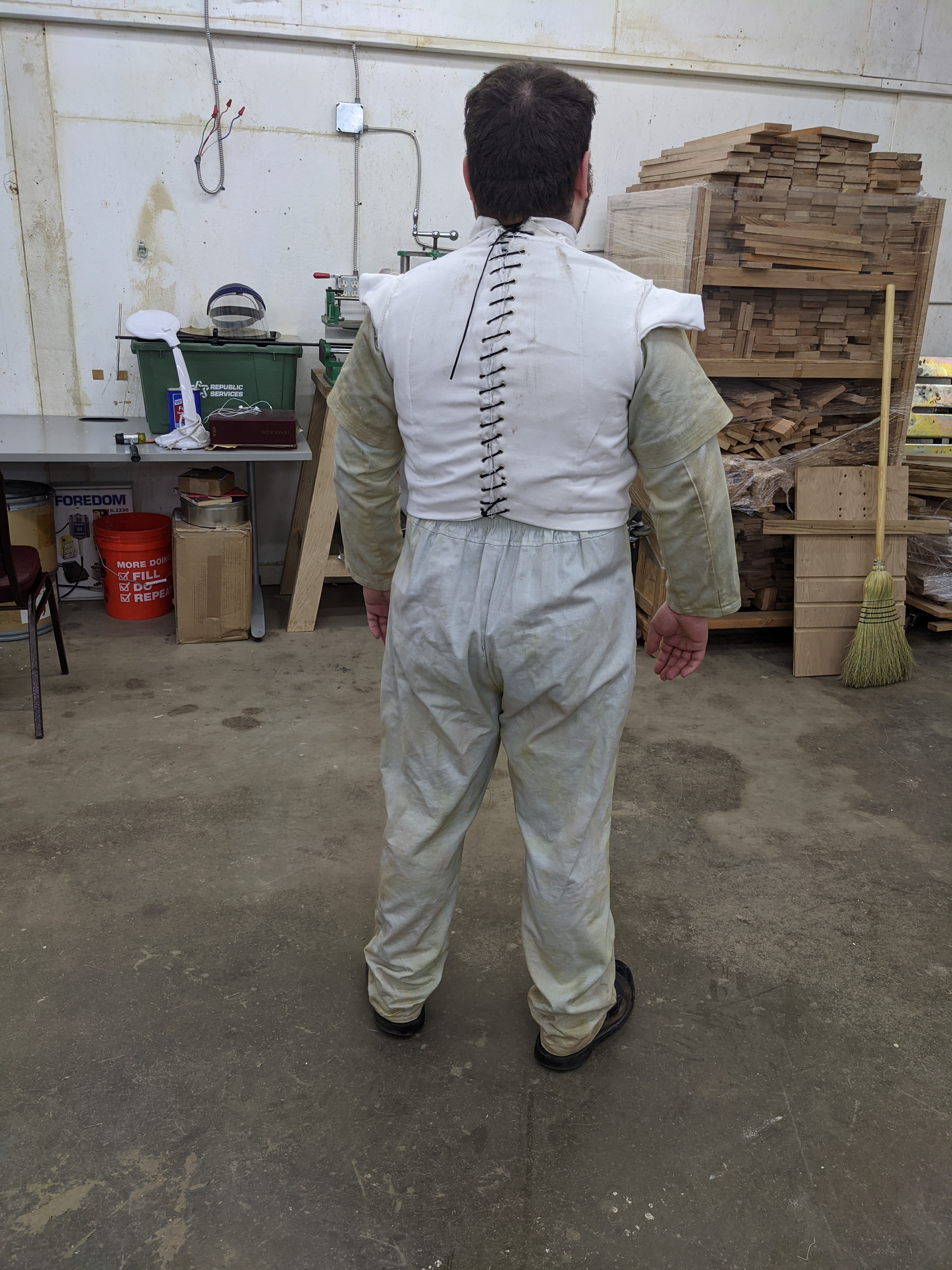

After two failures with the armor in a row, I started on the soft pieces. I drew out the template for the flak vest:
The next couple of days were spent cutting out the pieces and assembling it (flight suit purchased from joe, he thinks it's an old Bobamaker ROTJ suit):
This picture was taken Wednesday, and I was using some stretchy fabric so that I could put it on and take it off like a t-shirt. As you can see the collar was not looking good. I also didn't realize that I wasn't supposed to have a seam in the center. I'm hoping nobody else notices...
The next day (Thursday) I switched to a spiral lacing:
Much better.

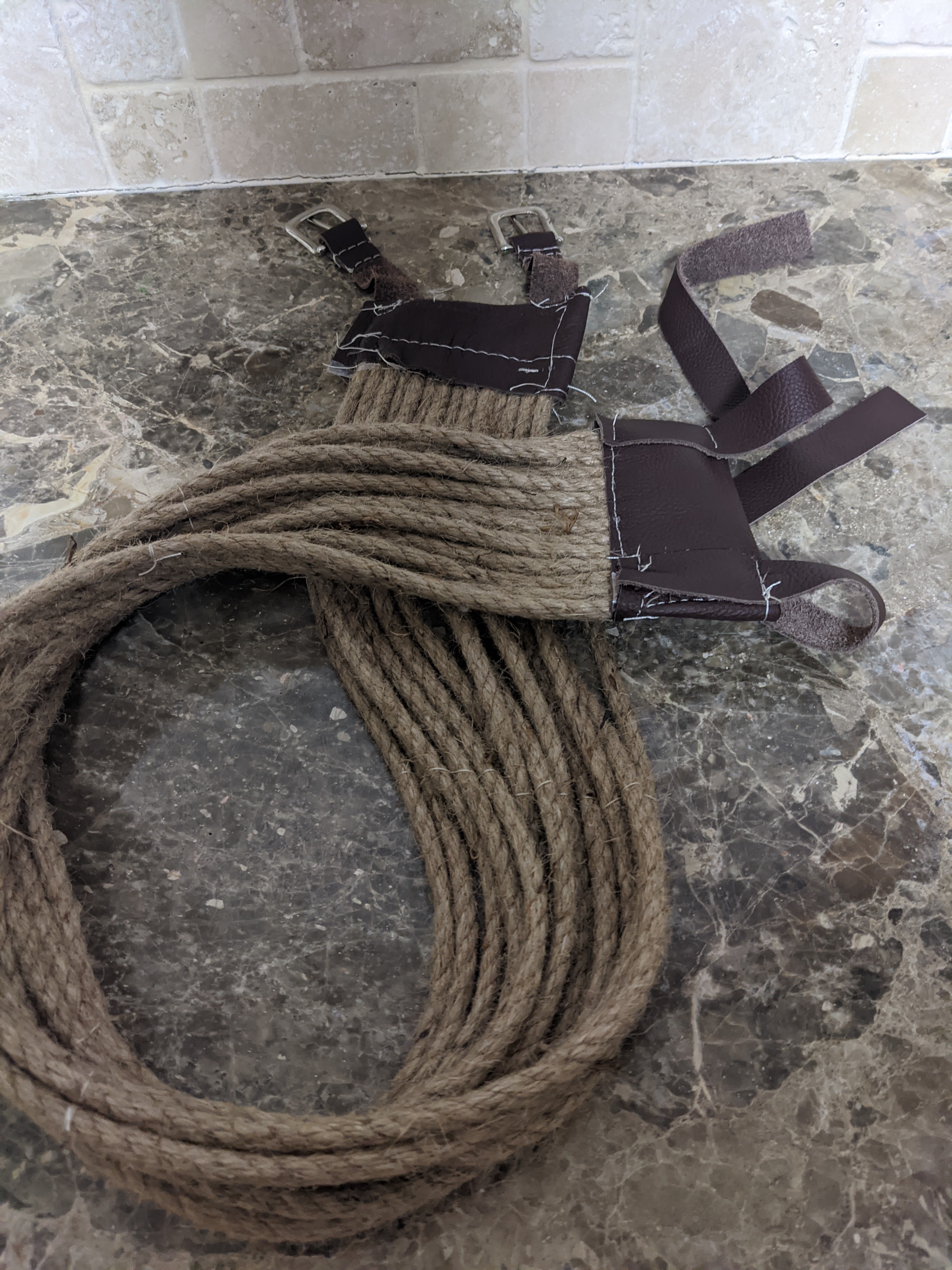

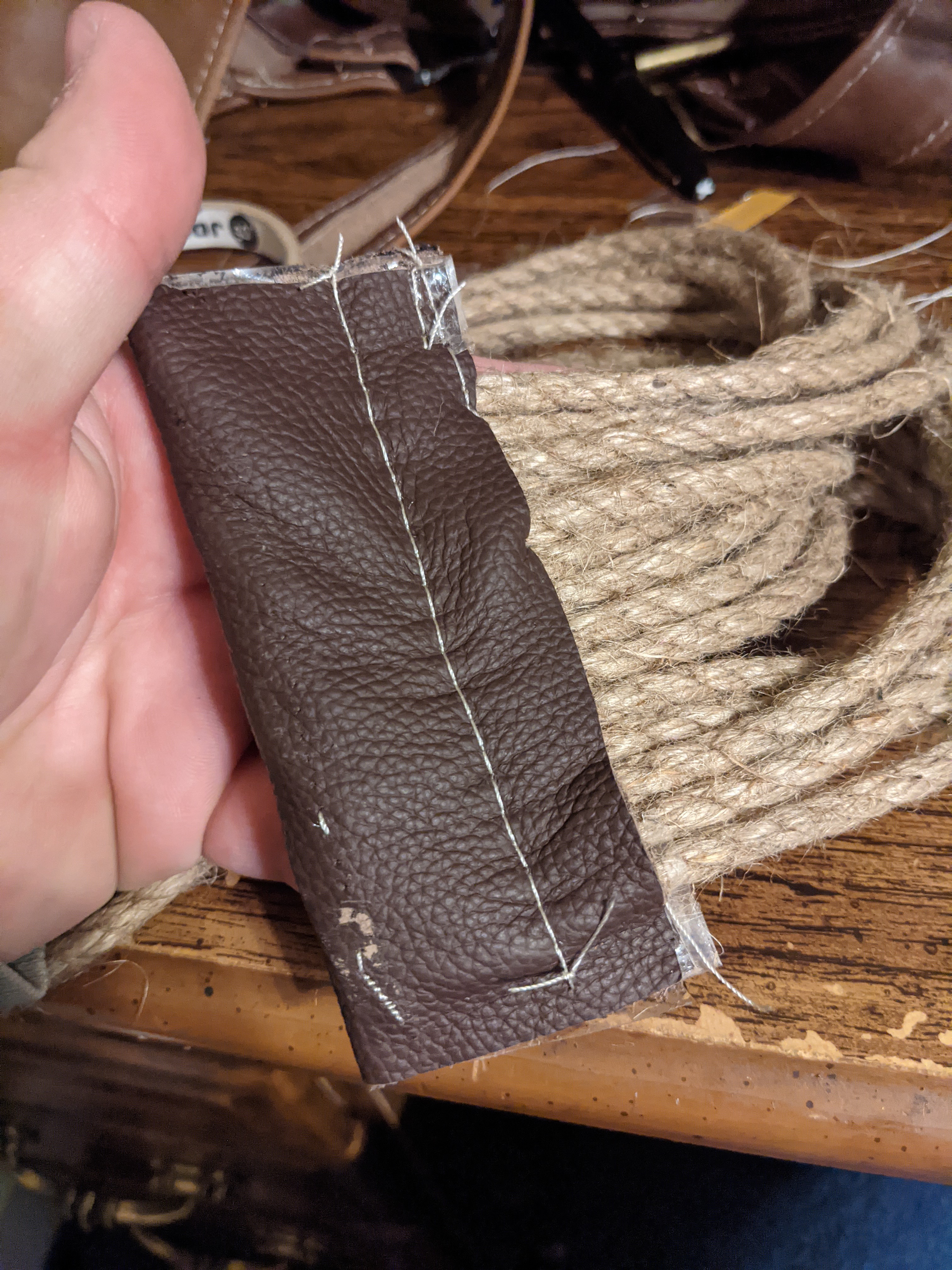

Then on Friday, I made the girth belt:
I did dye the rope, but somehow forgot to take a picture.

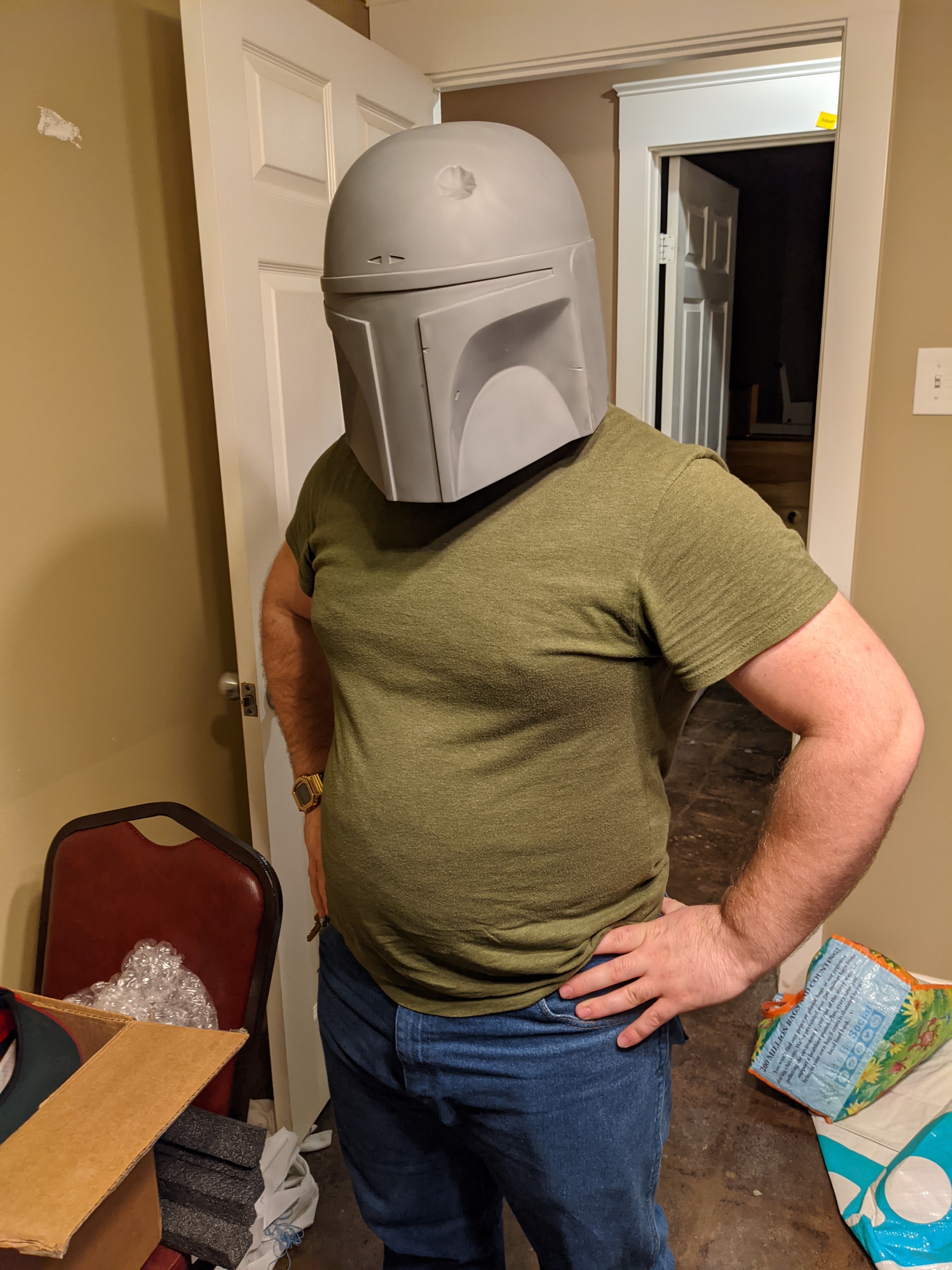

Later that night I was getting excited and opened up the helmet I ordered from ToEleven:
This just made me more excited. At Midnight. :)

I re-did the armor templates and cut out the armor:
Now to heat form it!
And now, I have some questions:
I have printed the knee templates, but have no idea how they are supposed to go together. Does anybody have instructions? Is wizardofflight still around?

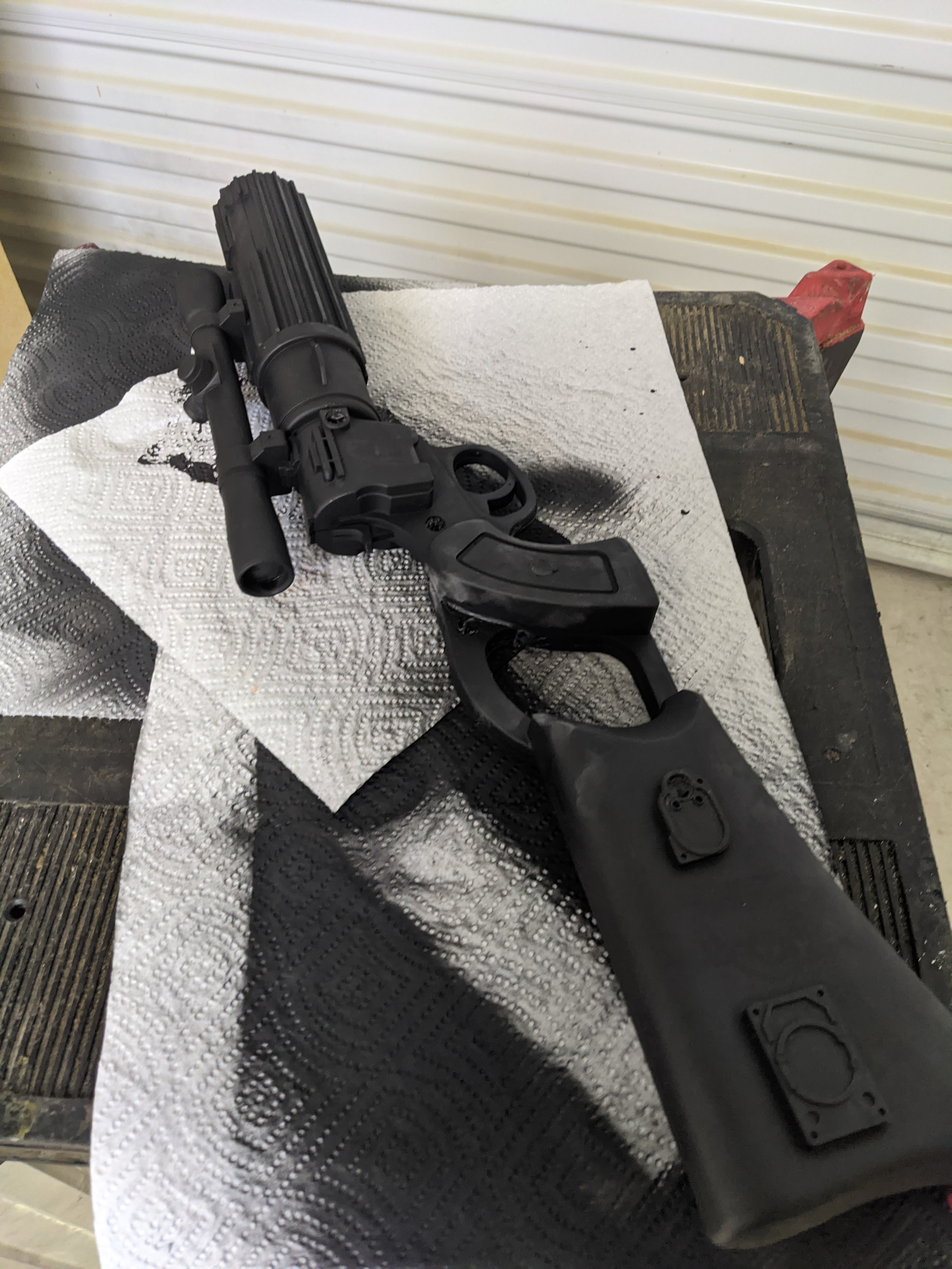

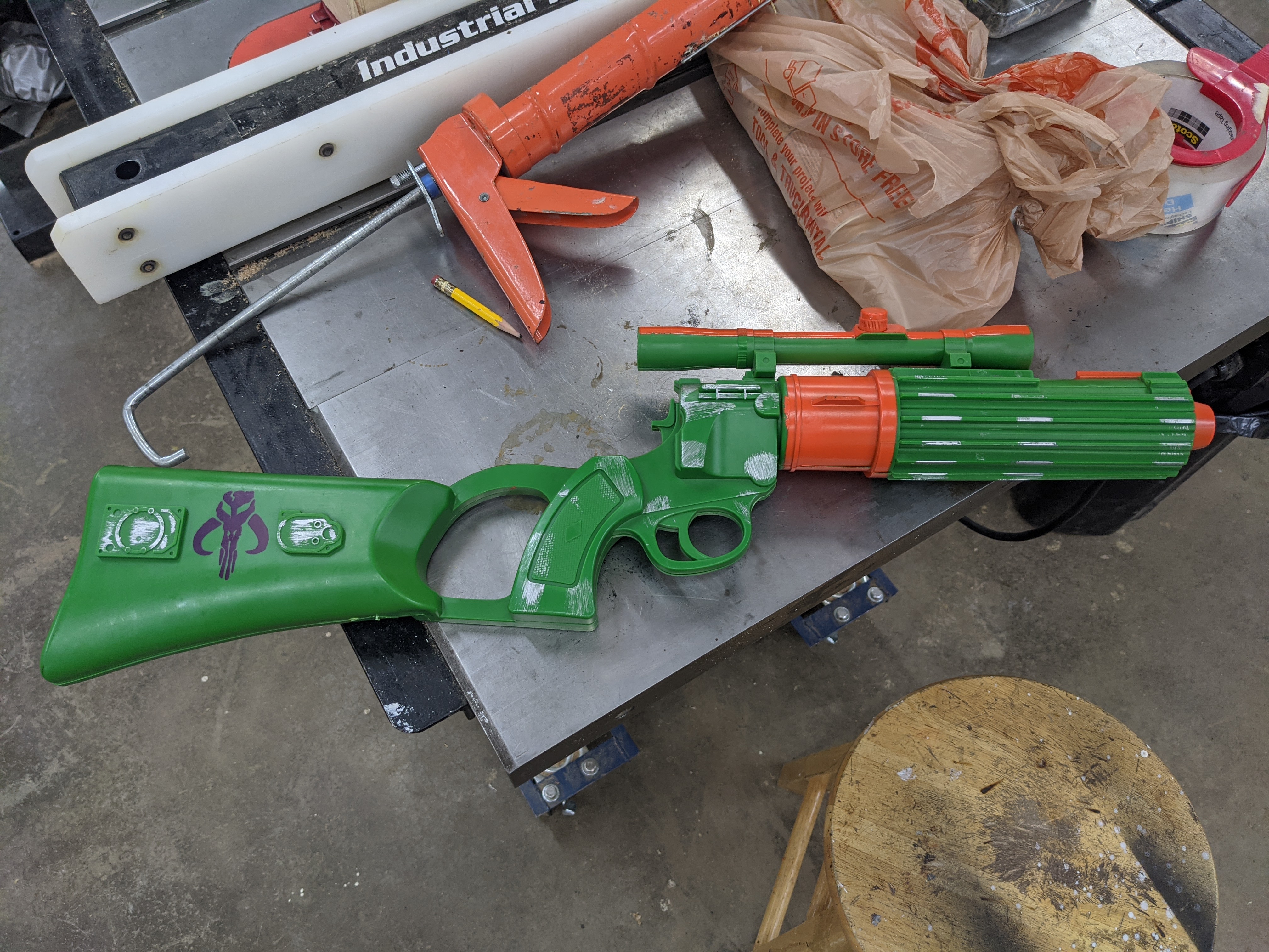

Anyway, I have some updates. Yesterday (Monday) my Rubies gun came in:
It is super flimsy, so I filled it with caulk to stiffen it up. It actually worked pretty well, but I ran out. I'll get some on the way to work tomorrow.
This evening, I went ahead and painted it. I used a Rustolium flat black enamel:

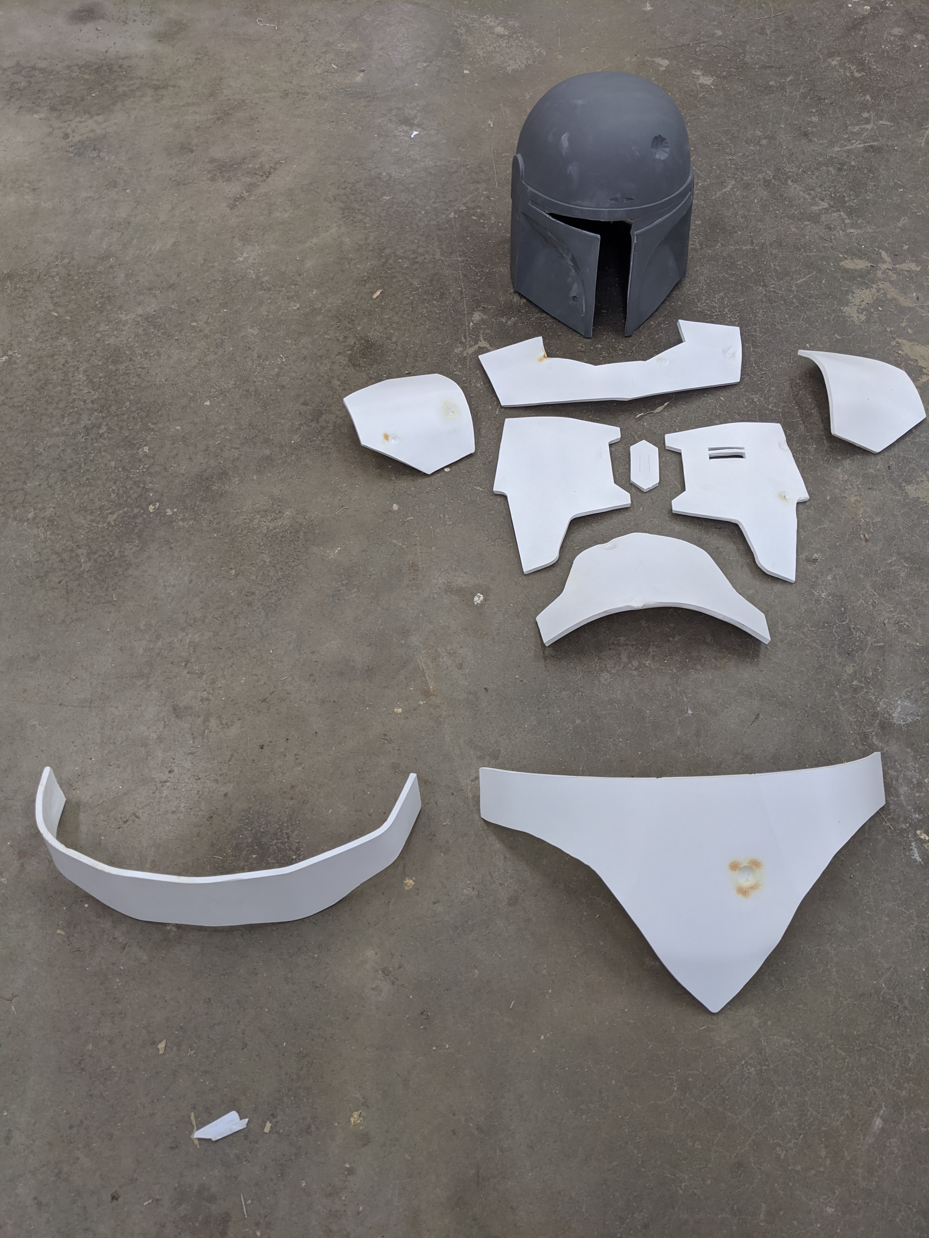

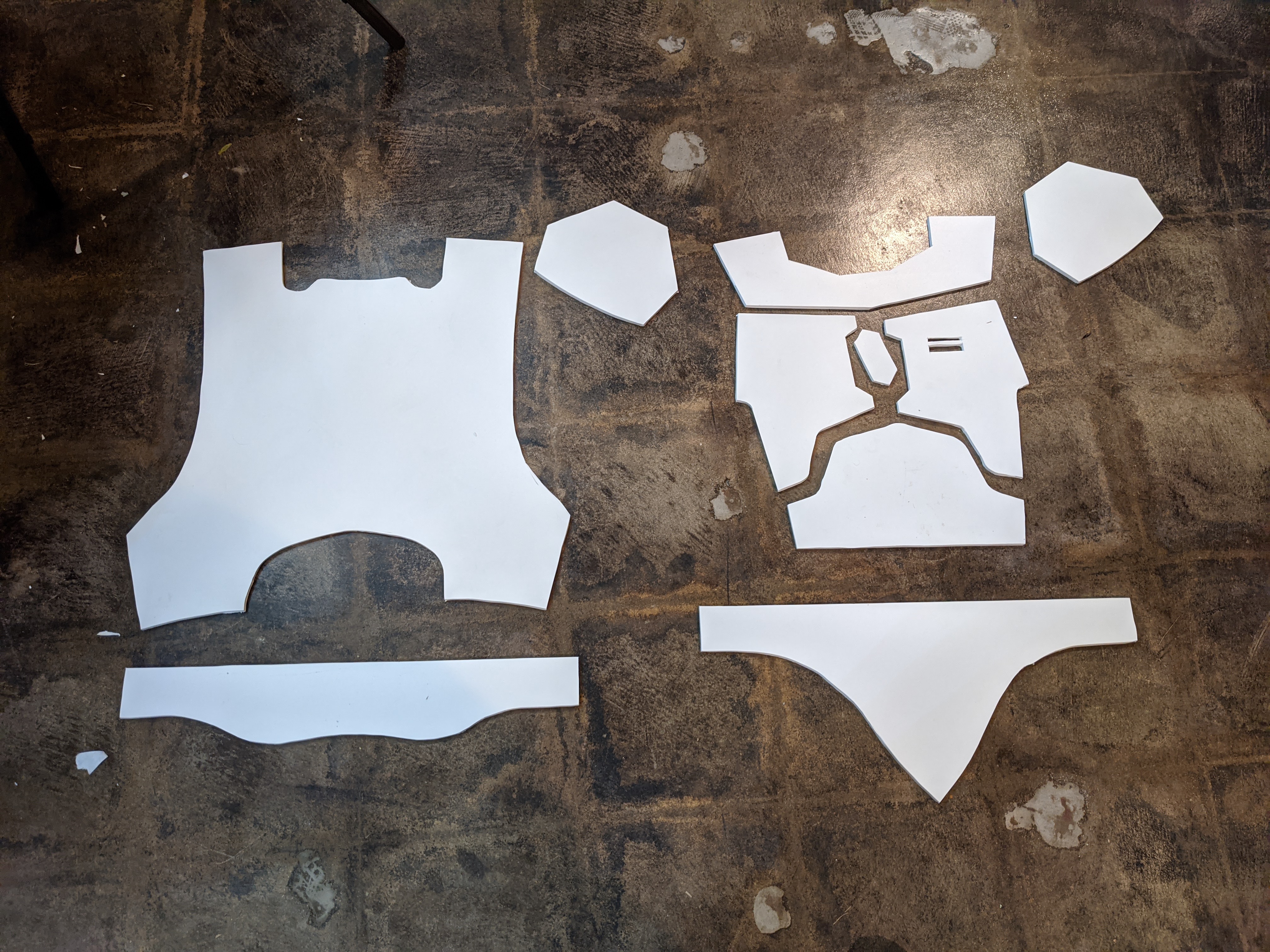

While the paint was drying, I started heat-forming the armor.
I read in a manual for working with Sintra that for sharp bends you want to put a notch in the backside:
I actually ended up with a deeper groove with a much sharper angle to get the right effect on the cod piece.
I was very pleased with the results and got almost all of the armor done in an hour:
For the helmet I used a hack saw to get most of the visor out, but my brother reminded me that he has a flex-shaft (basically a dremel on roids designed for jewelry work). I should get the rest of the prep work on the helmet done tomorrow and I can put a base coat on all of the armor.
