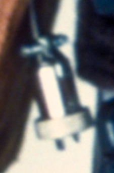

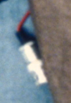

Does anyone have an idea of what these parts could be? To me the two silver plugs might be microphone connectors but I haven't found a match yet. The jetpack clip looks like two black plastic swivel clips taped together.

The jetpack part is a alligator clip for strapping. We haven't found the right one yet. The other two are electrical connectors. The one coming out of the tan pouch appears to be a BNC. Haven't sourced the orange pouch one yet. I think it's another audio style connector.
That clip makes so much sense now. I'll look through some military surplus sites to see if I find a match.
That would be great. Me and several others have been searching for quite a while. As you may assume, that's how the cape gets held on.

Im not 100% sure what the hip pouch cables are for. The tan one could be a BNC to battery for the chest display or a microphone amp. Orange one could be a microphone amp as well.

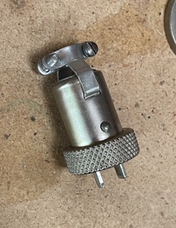

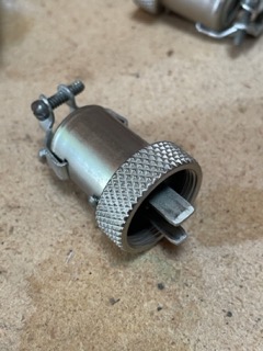

I believe you are correct, the middle one is probably an old style mic connector like this...

Which I believe connects the helmet mic to the ab speakers. I got some because I saw them on PP2, too.
I've always thought the other type there is maybe a BNC. But it's just a guess.
