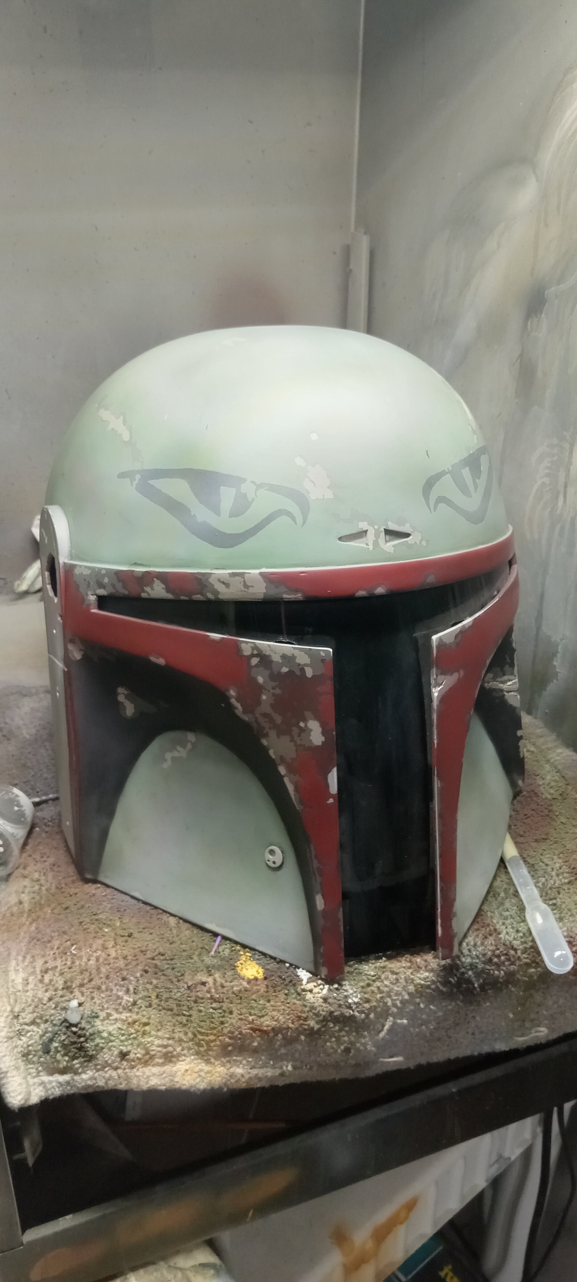

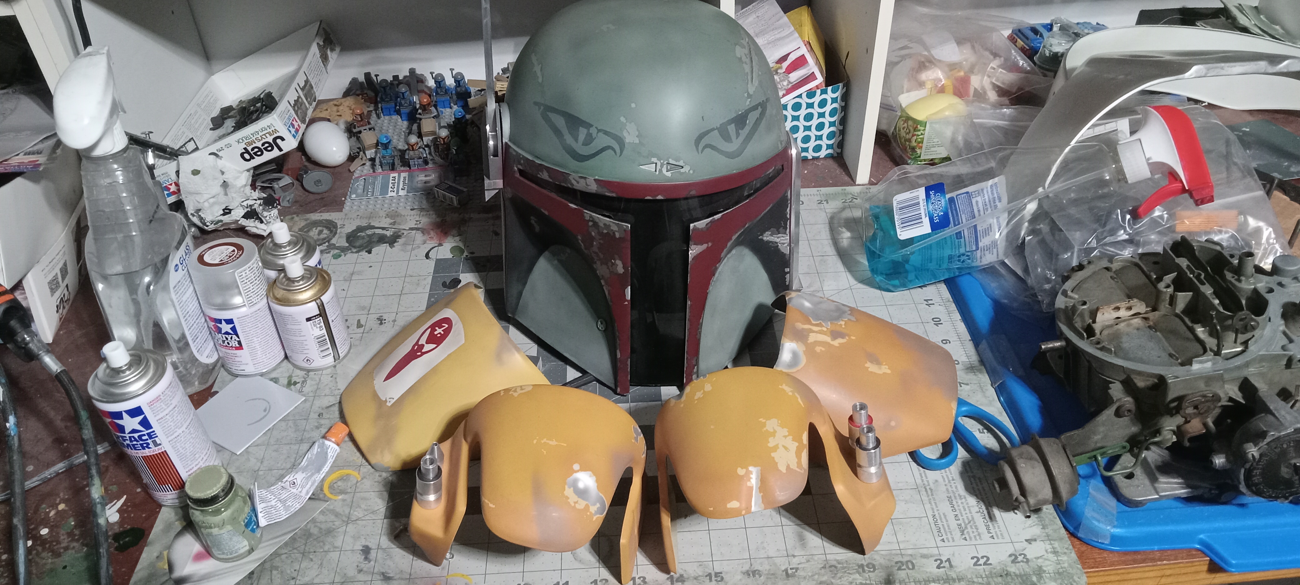

I making this thread to share what I have learned about trying to paint up a PP1 in the hopes it will be able to help others.

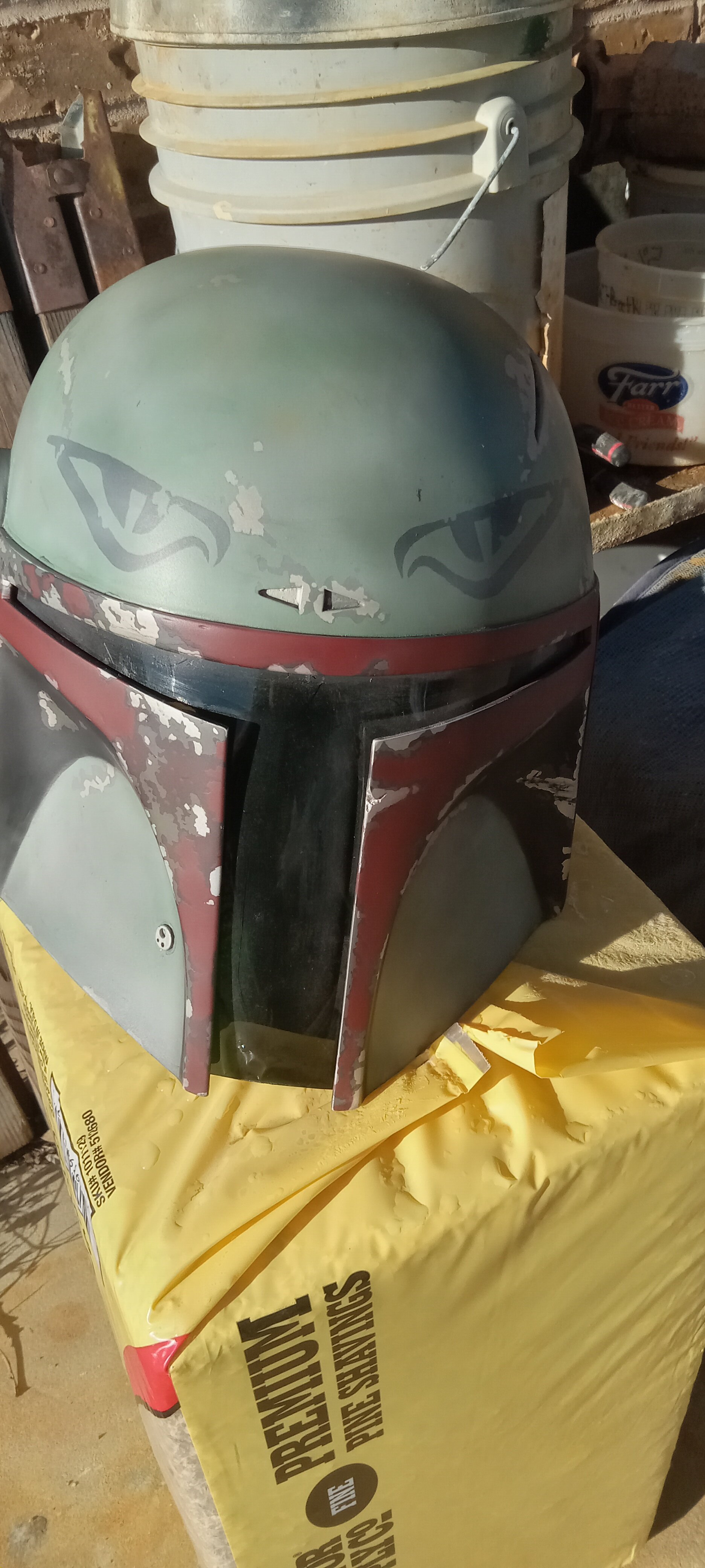

Firstly, the Helmet. I used all Archive X paint. For the most part it looks to be the same base colors as the ESB.
These are in my opinion, the most color accurate photos of the PP1 helmet. The light green on the dome and cheeks are heavily weathered with very light almost white greys. Under bright, direct light the helmet almost looks white.

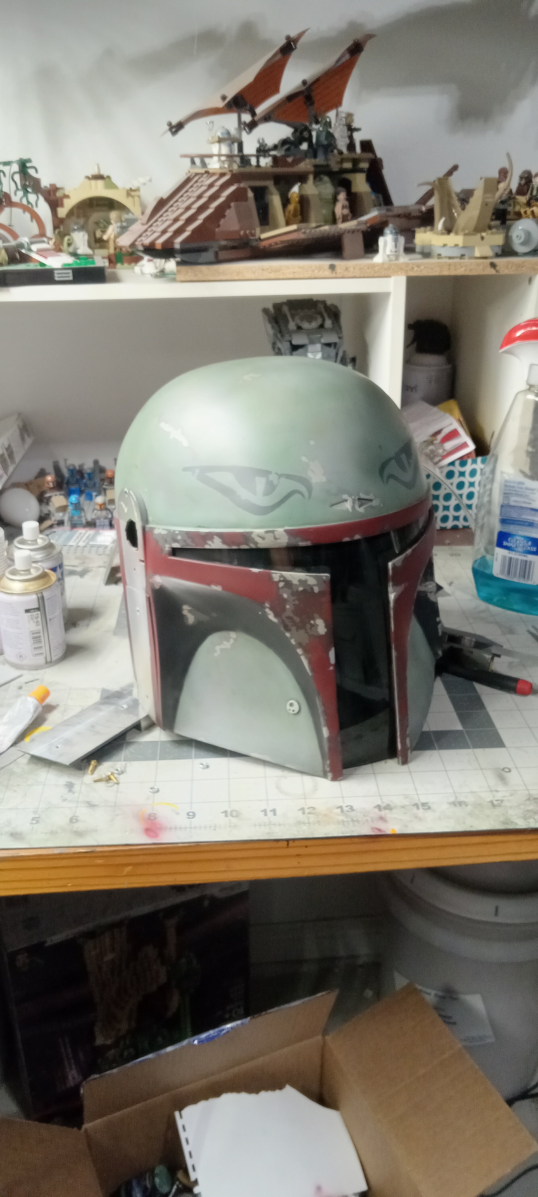

Here is my paint up under similar direct lighting as the photos above. I used mainly SP Lettering Grey to weather with a light touch of Alliance White.
My phone isn't the best at picking up the colors. The red looks brighter than it really is.
The one major potential difference is the back panels color. In many of the photos in the gallery on this site they look to be the same dark green/blue as the ESB. But in this photo it shows it is a green more similar to the back panels of the ROTJ/Sandy helmets.

This looks to me to be a somewhat accurate color of the back panels. If anyone has better picture of the back of the helmet send it my way.
But I am going to modify my helmet so it matches this picture.

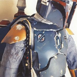

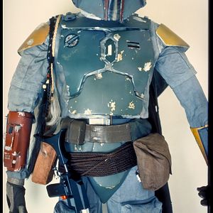

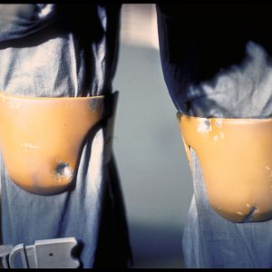

These are the Photos I used for reference. For lack of better color references/ photos, this is what I came up with.
For the Knees:
The grey weathering looks Identical to Lark Light Grey.
For the light damage color around the silver Reefer White with some Depot buff mixed in matches almost perfectly.
A layer of SP Armour Yellow followed by Misting/Shading with a mix of Mud and Reefer Orange to get the off orange color. Then finally a very light misting around the outer edges of a mix of Reefer Orange and Rust to get that darker outer color.
Right Pauldron:
Same as knees but the final Orange/Rust mix gets misted over the whole plate evenly.
Left Pauldron:
Depot buff + SP Armour Yellow mix for base color. Sp Light Lark Grey for weathering. Mud and SP Armour Yellow can work as well.
Thats what I have For the pauldrons and knees. Next the gauntlets. Then the really tough one, the main armor color.

On to the gauntlets. This post is going to be short as I don't have the gauntlets on hand to paint. But will expand as I figure stuff out.
Boba Fett First Prototype Costume

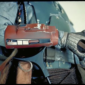

Right gauntlet:
Looks to me to be Caboose red with black and a medium grey misting.
Left Gauntlet:
Now this one is a little trickier. And there are no good color photos of the top of the gauntlet, so that will be mostly guesswork.
The grey weathering looks like SP Light Lark
The light damage around the silver on the bottom shell looks to be the same color as on the knees and right shoulder.
The base Yellow I believe is Reefer Yellow. In the third and fourth picture the gauntlet matches the Reefer yellow paint swabs perfectly.
As evidenced in the first photo it looks like there may be some orange misting. But the ever changing colors of the pictures make that difficult to tell.
The gauntlet looks to be colored somewhat similarly to the knees but not nearly as orange.

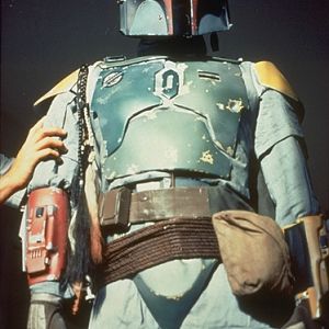

When we take in to consideration the blue hue they might possibly be southern and reading green.
To me the collar and diamond are the same color but the right chest plate is a slight lighter green over another.
Left chest plate and ab plate are layered as follows -
Bright silver
SP/ UP Armor Yellow
Rust
Coach Green
Dot of Dark Green
Misted with grey

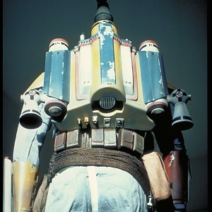

Jetpack -
Reefer White
Amtrak Blue
SP Armor Yellow
SP Lettering Grey
Caboose
Engine Black
Grey Misting

how confident are you that its SP not UP armour yellow?
My list I would say isn't exact yet but from what I've been comparing it comes close to the true colors we see in the ESB promo.
esb used UP and I believe you're right about the promo. it's so hard to tell on non-color corrected images. SP is much tanner and UP is more of a primary yellow. IMO for mine I will be using UP because it is more vibrant, and the suit seems very vibrant to me. it will be a closer match to the photos than the real thing when I do mine, I think.
Very true. I've been comparing the colors between bottle samples instead of the swatch cards because I find the swatches to be somewhat inconsistent. UP looks like a fantastic choice as well and I'll likely be using it still for other parts such as the knees maybe. I plan to create a new swatch card as well.

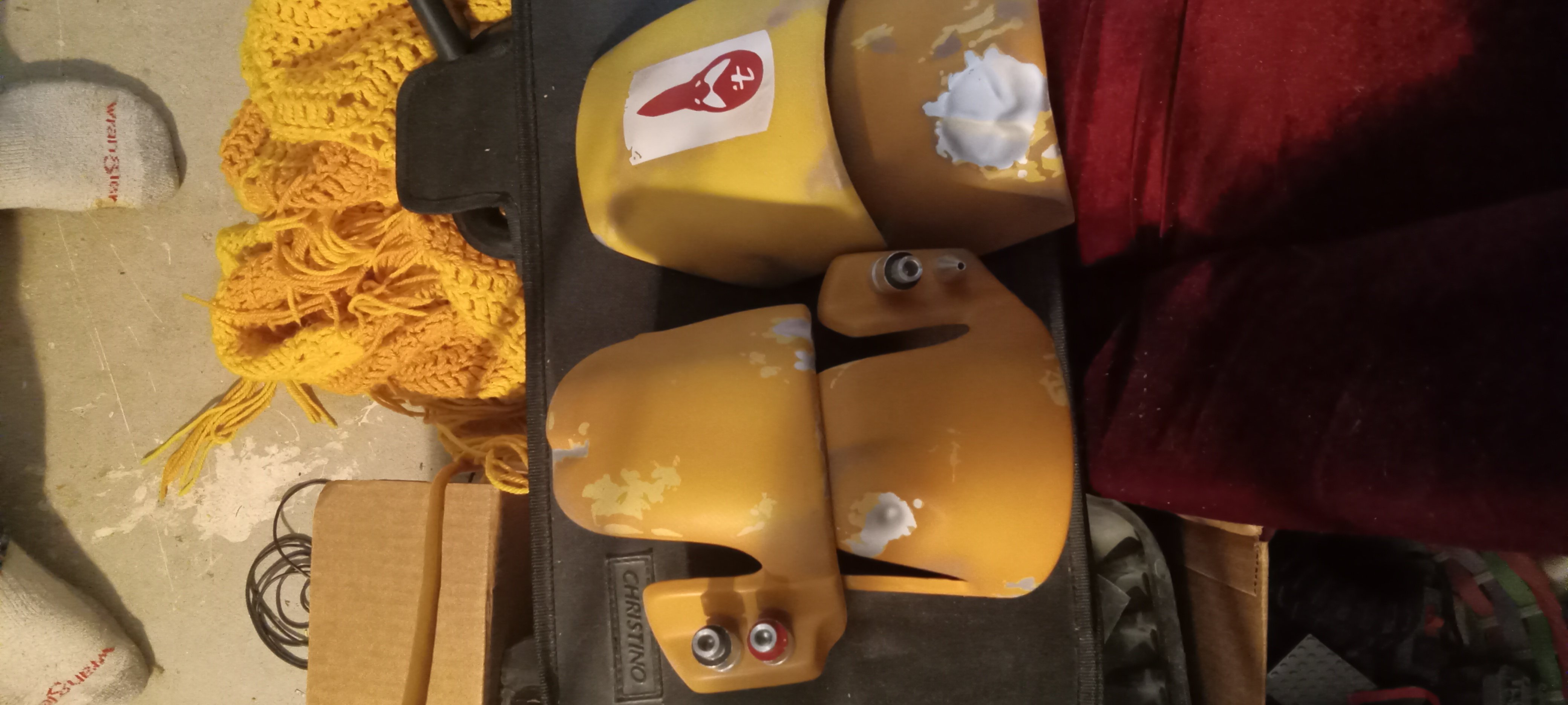

You were correct about the yellow. This is a swatch of some SP compared to coach green and Reefer yellow. It is much more tan than I anticipated.
